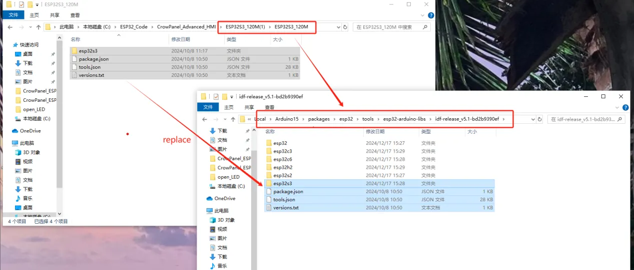

After completing the Esp32 download, replace the files in that directory;
Open the "ESP32S3_120M"(https://drive.google.com/drive/u/1/folders/1npWkVzctd7e0Y6H5hahk8uxGhy9idxCz) file we provided, copy a copy of the file from that folder to the following path in ESP32, and replace it;
(C:\Users\14175\AppData\Local\Arduino15\packages\esp32\tools\esp32-arduino-libs\idf-release_v5.1-bd2b9390ef)
Note: "ESP32S3_120M" is a recompiled official file that has enabled PSRAM high-speed communication mode, and the improved refresh rate is just one of its optimizations. If not replaced, the maximum can only reach 80M, and after replacement, the maximum is 120M.
