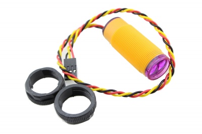

This infrared distance switch features a high-sensitivity photoreflector to perform distance detection function,ranging from 3cm to 80cm. When the infrared light emitted by the emitter gets reflected on a surface that blocked it, the phototransistor can pick up the signal for distance calculation. Also a potentiometer for adjustment is arranged for easy and clear use. It is small, easy to use/assemble, and inexpensive. Useful for robotics, interactive media, industrial assembly line, etc.
Model: SOD00380S
  • Power supply: 5V
  • Current: 100mA
  • Range: 3-80cm adjustable
  • Red: +5V
  • Yellow: Signal
  • Black: GND
  • Wire length: 20cm

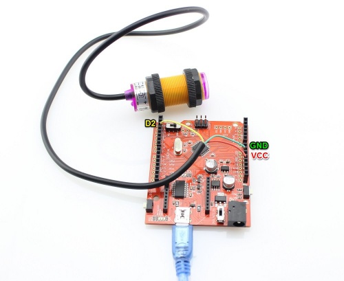

Connect this sensor to your Arduino/Crowduino digital pins( D2 for example). When there is an object behind this sensor, the output would be low. Adjustable infrared sensor1 hardware1.jpg

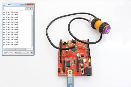

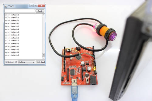

2.open the serial monitor , and set the baudrate to 9600, you will see the output changes with the object behind this sensor or not.
Infrared Sensor Switch test result.jpg Infrared Sensor Switch test result1.jpg
