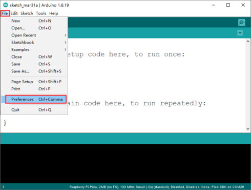

3. Click "File" -> "Preferences" on the menu bar to pop up the preference setting interface.
4. Click the icon on the far right of the Additional Boards Manager URLs column, enter https://github.com/earlephilhower/arduino-pico/releases/download/global/package_rp2040_index.json in the pop-up window, and add RP2040 Arduino IDE development board URLs.

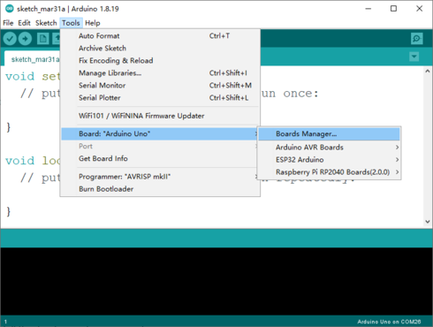

5. Click "Tools" -> "Board:..." -> "Boards Manager..." in the menu bar to enter the Boards Manager interface.
6. Enter "RP2040" in the search box, select "Raspberry Pi Pico/RP2040" and install the development environment.
It should be noted here that when selecting the development environment version, do not choose the latest one. It is recommended to choose version 2.6.0.
7. After the environment is successfully installed, if you find "Rasperry Pi RP2040 Boards" in the Arduino IDE development board management, it means that the environment is successfully built.

1. For the first use, you need to set up and select the correct development board. Click "Tools" -> "Board:..." -> "Rasperry Pi RP2040 Boards" -> "Rasperry Pi Pico" in the menu bar, as shown in the figure below:

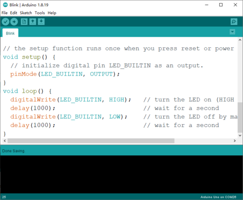

2. Connect the Lora RA-08H Development Board to the computer via a TYPE-C USB cable. When the development board is connected to the computer for the first time, a "RPI-RP2" USB virtual U disk will appear.
3. Here you need to burn a sample code in the opened Arduino IDE to convert the "RPI-RP2" USB virtual U disk into a "COM port". The sample code path is shown in the figure below:
The code after opening is as follows:
4. Click the download icon at the bottom of the menu bar to burn the code to the Lora RA-08H Development Board. After the code is burned successfully, COMXX (Raspberry Pi Pico) will be displayed in "Tools" -> "Port". Now you can program Lora RA-08H Development Board with Arduino IDE!

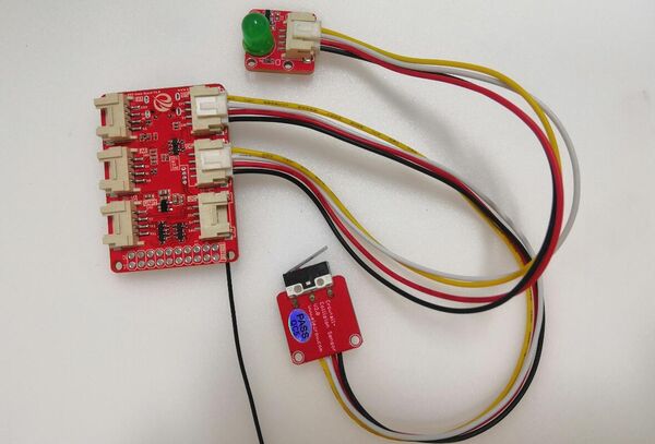

Example 1 - Switch Light
1.1 Connect the Crowtail-LED and Crowtail-Button to the D3 port and D2 port of the Lora RA-08H Node board respectively.
1.2 Open the "Switch_Light.ino" sample program in the Arduino IDE, and then click the upload program icon to upload the program to the development board.
void setup() {
pinMode(2, INPUT_PULLUP);
pinMode(3, OUTPUT);
void loop() {
if (digitalRead(2) == HIGH){
digitalWrite(3, HIGH);
else{
digitalWrite(3, LOW);
1.3 After the program is successfully uploaded, press the button, the led will light up; release it to turn off.

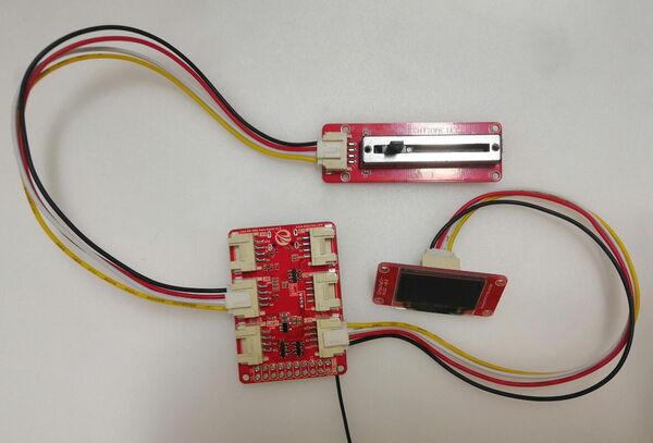

Example 2 - OLED Display
2.1 Connect the Crowtail OLED module and Crowtail linear potentiometer to the Crowtail I2C port and A0 port of the Lora RA-08H node board respectively.
2.2 Open the "OLED.ino" sample program in the Arduino IDE, and then click the upload program icon to upload the program to the development board.
#include "hardware/adc.h"
#include <U8x8lib.h>
#include <Wire.h>
int val;
U8X8_SSD1306_128X64_NONAME_HW_I2C u8x8(/* reset=*/ U8X8_PIN_NONE);
void setup() {
u8x8.begin();
u8x8.setFont(u8x8_font_chroma48medium8_r);//Small Font 16 Characters
u8x8.noInverse();//Normal
u8x8.clear();
u8x8.setCursor(5,2);
u8x8.print("Lora DEV");
u8x8.setCursor(1,4);
u8x8.print("VALUE = ");
void loop() {
int sensorValue = analogRead(A0);
delay(500);
u8x8.setCursor(9,4);
u8x8.print(" ");
u8x8.print(sensorValue);
delay(100);
2.3 After the upload is successful, when you slide the handle of the linear potentiometer, the OLED displays the current analog value in real time.

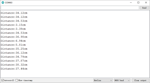

Example 3 - Ultrasonic Ranging
3.1 Connect the Crowtail Ultrasonic Sensor to the Crowtail UART port of the Lora RA-08H node board.
3.2 Open the "Ultrasonic_ranging.ino" sample program in the Arduino IDE, and then click the upload program icon to upload the program to the development board.
const int TrigPin = 9;
const int EchoPin = 8;
float cm;
void setup()
Serial.begin(9600);
pinMode(TrigPin, OUTPUT);
pinMode(EchoPin, INPUT);
void loop()
digitalWrite(TrigPin, LOW);
delayMicroseconds(2);
digitalWrite(TrigPin, HIGH);
delayMicroseconds(10);
cm = pulseIn(EchoPin, HIGH) / 58.0;
cm = (int(cm * 100.0)) / 100.0;
Serial.print("Distance:");
Serial.print(cm);
Serial.print("cm");
Serial.println();
delay(1000);
3.3 After the upload is successful, open the serial monitor to check the serial port printing.

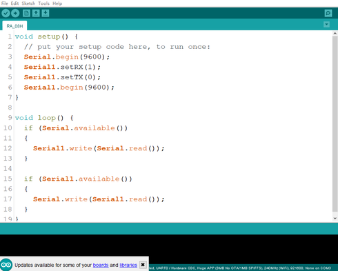

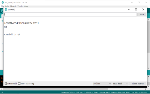

Example 4 - Communication between RP2040 and RA-08H
4.1 Open the "RA_08H.ino" sample program in the Arduino IDE, and then click the upload program icon to upload the program to the development board.
void setup() {
Serial.begin(9600);
Serial1.setRX(1);
Serial1.setTX(0);
Serial1.begin(9600);
void loop() {
if (Serial.available())
Serial1.write(Serial.read());
if (Serial1.available())
Serial.write(Serial1.read());
4.2 After the program is successfully uploaded, open the serial monitor and send the AT command "AT+CGSN?" to RA_08H.
4.3 After sending the command, if the monitor can display the returned "+CGSN=85521C0A02243201 OK" (the value returned by different RA-08H firmware is different), it proves that you can send AT commands through the Arduino IDE to control and set the RA_08H module.

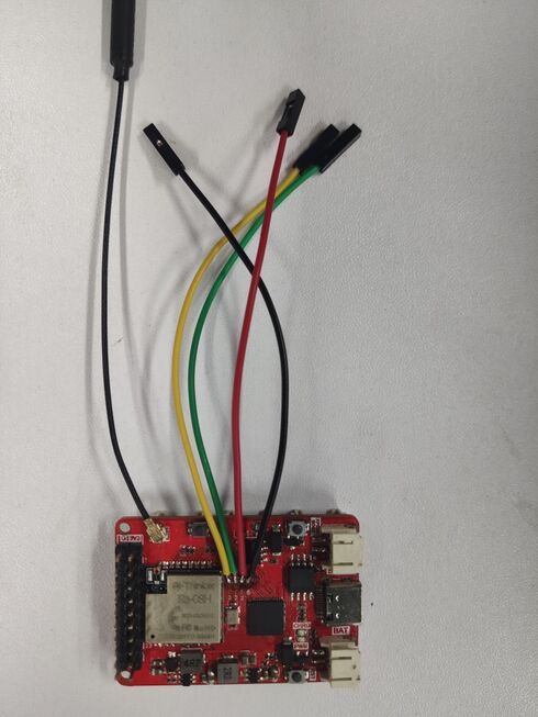

5.1Connect the leads according to the diagram.

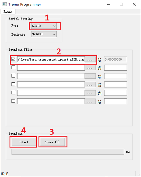

5.2First prepare the transparent firmware, and use the firmware download tool to download the firmware.
After connecting the wires according to the above instructions, unplug the RST pin on the module, open the firmware burning tool, select the firmware to be burned, click "Erase All", clear the original firmware in the module, and erase After success, click "Start" to burn the new firmware.
5.3Download the program for the two modules separately to realize the transparent transmission function.
