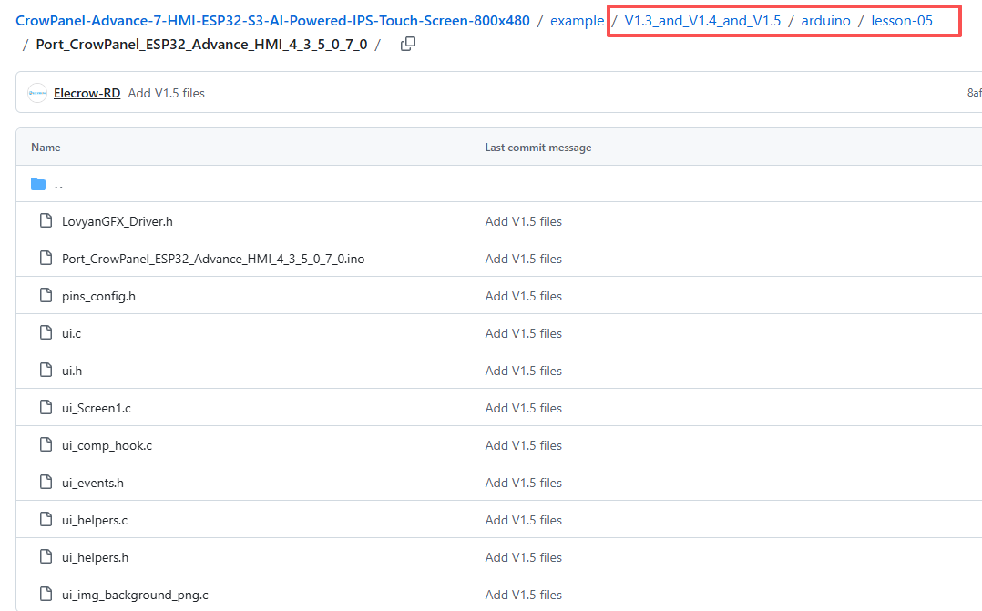

Click the link below to download the materials for this lesson.
CrowPanel-Advance-7-HMI-ESP32-S3-AI-Powered-IPS-Touch-Screen-800x480/example at master · Elecrow-RD/CrowPanel-Advance-7-HMI-ESP32-S3-AI-Powered-IPS-Touch-Screen-800x480
image-20260601114000073

Click on the link below to download the code for this lesson:
image-20260601114213939
