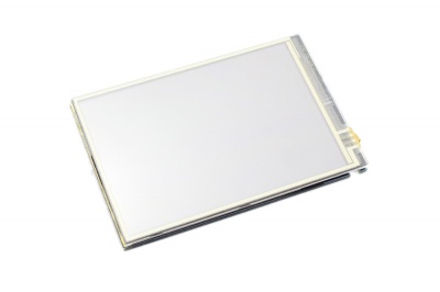

It is the cutest, little display for the Raspberry Pi. It features a 3.5" display with 480x320 16-bit color pixels and a resistive touch overlay. It's designed to fit nicely not only to the Pi Model A or B but also works perfectly fine with the Model B+.
