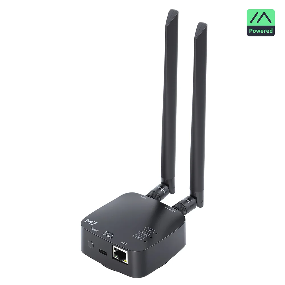

Introduction to the ThinkNode M7
The ThinkNode M7 is a LoRa gateway device based on the ESP32-S3 and LR1110.Compared with the ThinkNode M1, M2, and M5, the M7 supports not only native Meshtastic mesh communication but also MQTT Gateway mode. Using Wi-Fi or Ethernet, two LoRa networks located far apart can be interconnected to enable cross-network data forwarding. The M7 supports PoE power supply, 100 Mbps Ethernet, and wired/wireless networking, making it ideal for deployment as a fixed gateway.

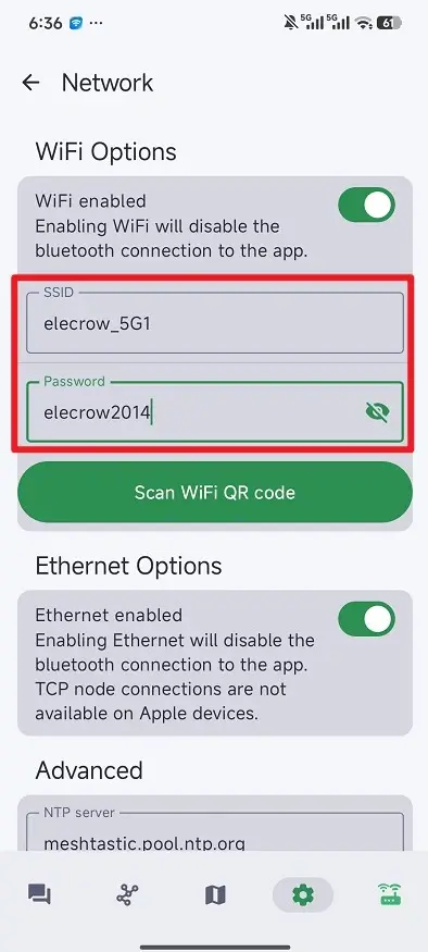

Wi-Fi Connection:
① Before using Wi-Fi, you must first configure the Wi-Fi credentials through either Bluetooth or Ethernet.
② In the network device settings, enable Wi-Fi and enter the router's Wi-Fi SSID and password. (Note: After enabling Wi-Fi, once Wi-Fi is enabled, Bluetooth management will be disabled..)
M7_mqtt_3
M7_mqtt_4

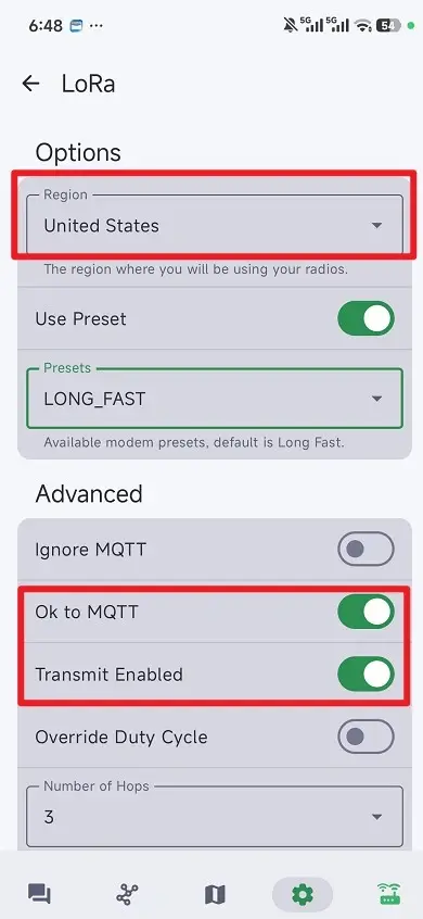

① In LoRa settings, enable the "Ok to MQTT" option and the "Transmit Enable " option. Keep other settings as per normal transmission configuration.
M7_mqtt_6
M7_mqtt_7
M7_mqtt_8

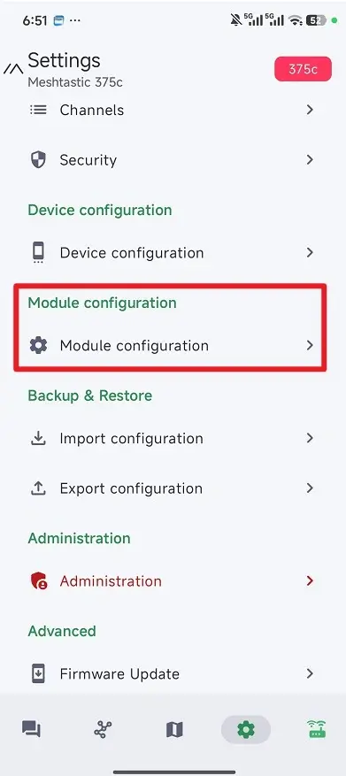

② Go to Module Configuration, then enter "MQTT Options". Enable "MQTT enabled ", " TLS enabled", and " Proxy to client enabled". Leave all other settings at their default values.. If they are not default, revert them to default. (Note: The MQTT configurations on both M7 devices must be identical. If communication fails, check these settings.)
M7_mqtt_9
M7_mqtt_10
M7_mqtt_11

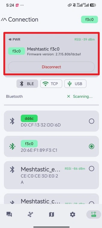

After opening the app, tap the icon in the lower-right corner and select the corresponding device.
meshtastic-1

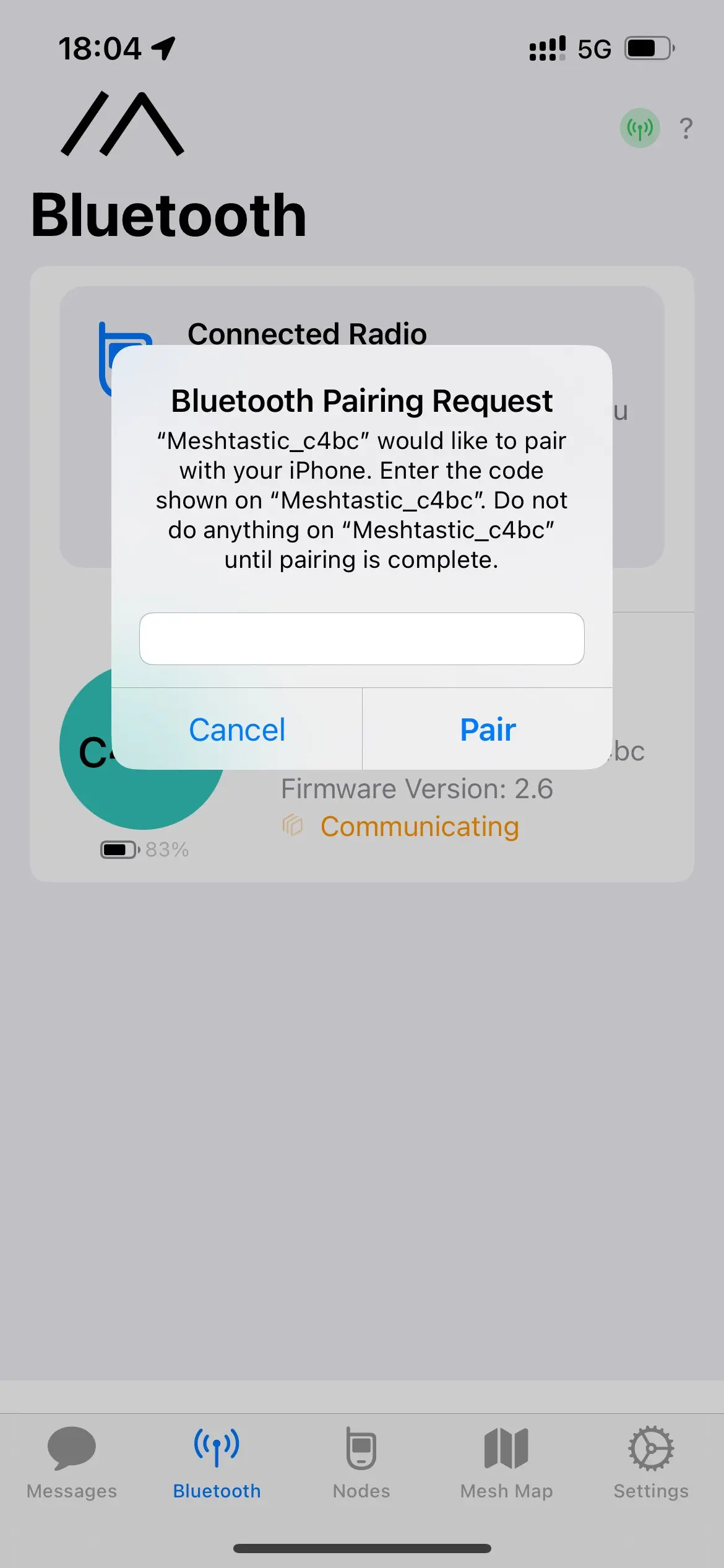

2)The default PIN for the ThinkNode M7 is “123456.” After selecting the corresponding device, an input field will automatically appear; enter the PIN to pair the devices.
meshtastic-2
3)If the connection is successful, some basic information about the device will be displayed.

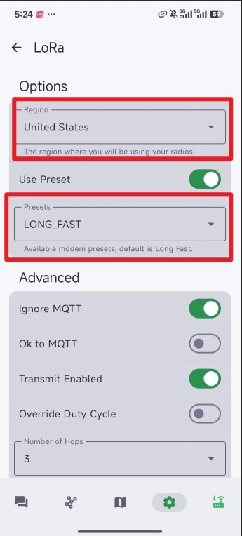

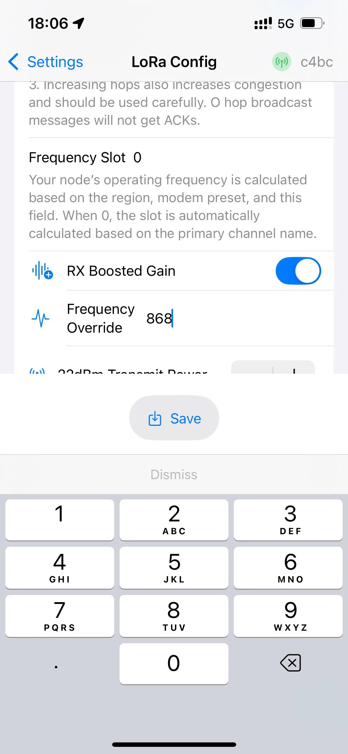

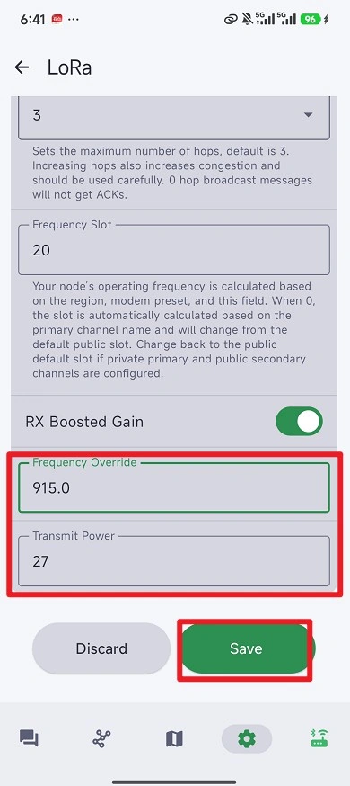

4) Go to Settings, set the LoRa region, and select the preset “LONG_FAST modem preset”. Leave the other options at their default settings, and enter the appropriate frequency value in the “Frequency Override” field.
meshtastic-4
meshtastic-5

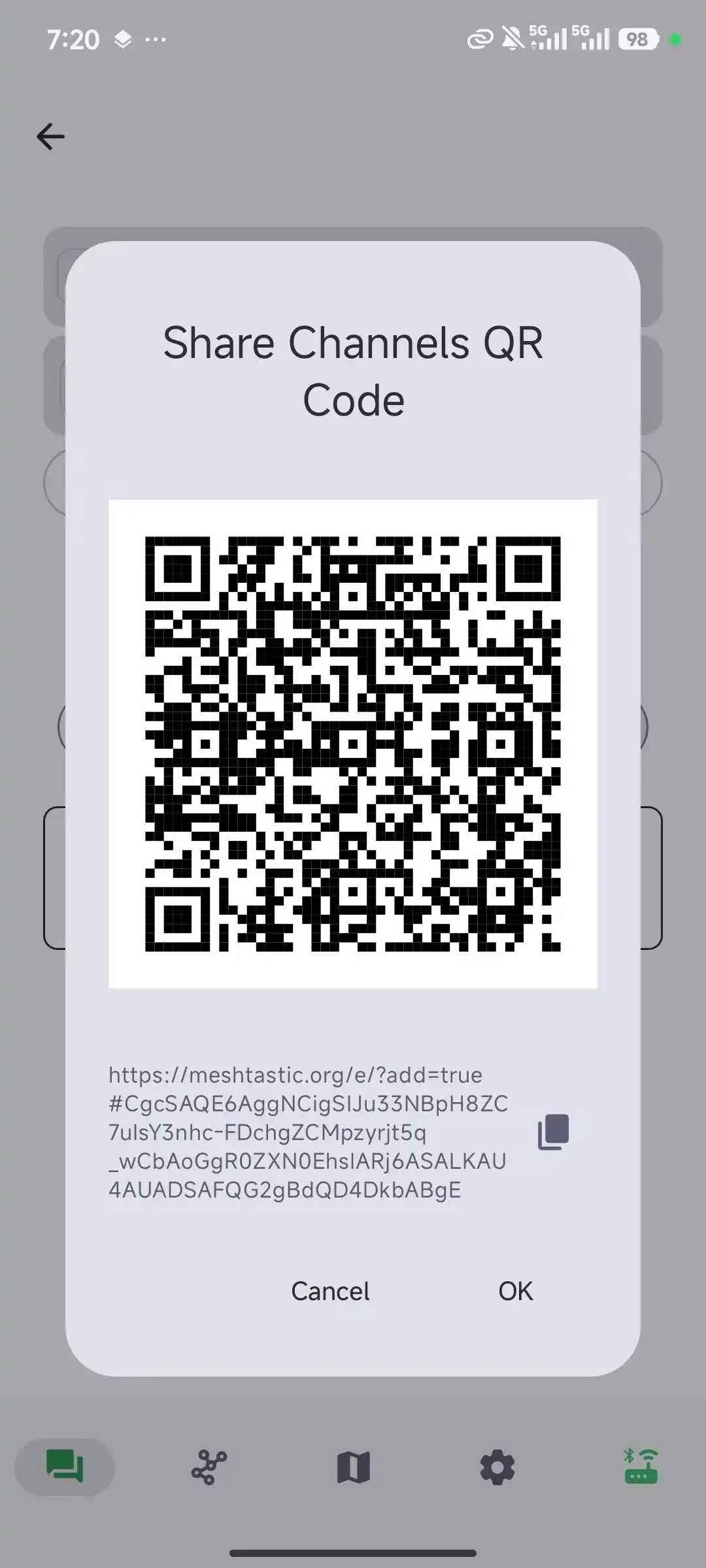

5)If two devices want to communicate, they need to join the same channel, this time you need to select the fourth of the five options above, the other end of the phone needs to join the same channel by scanning the code or entering the link, the channel can be customized name and so on.

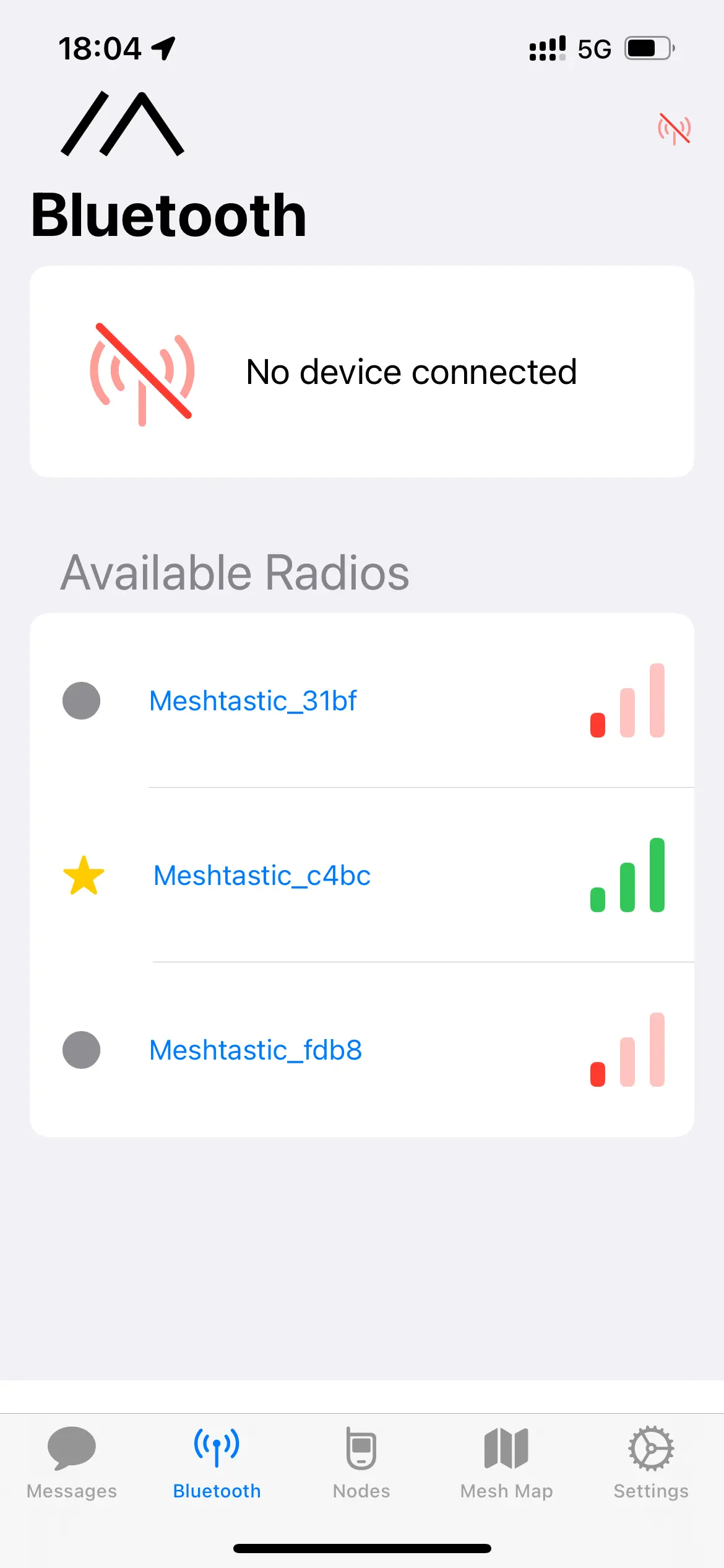

1)Open the app, tap Bluetooth on the home page and see the device you want to connect. Click on Pairing.
ios-1
ios-1

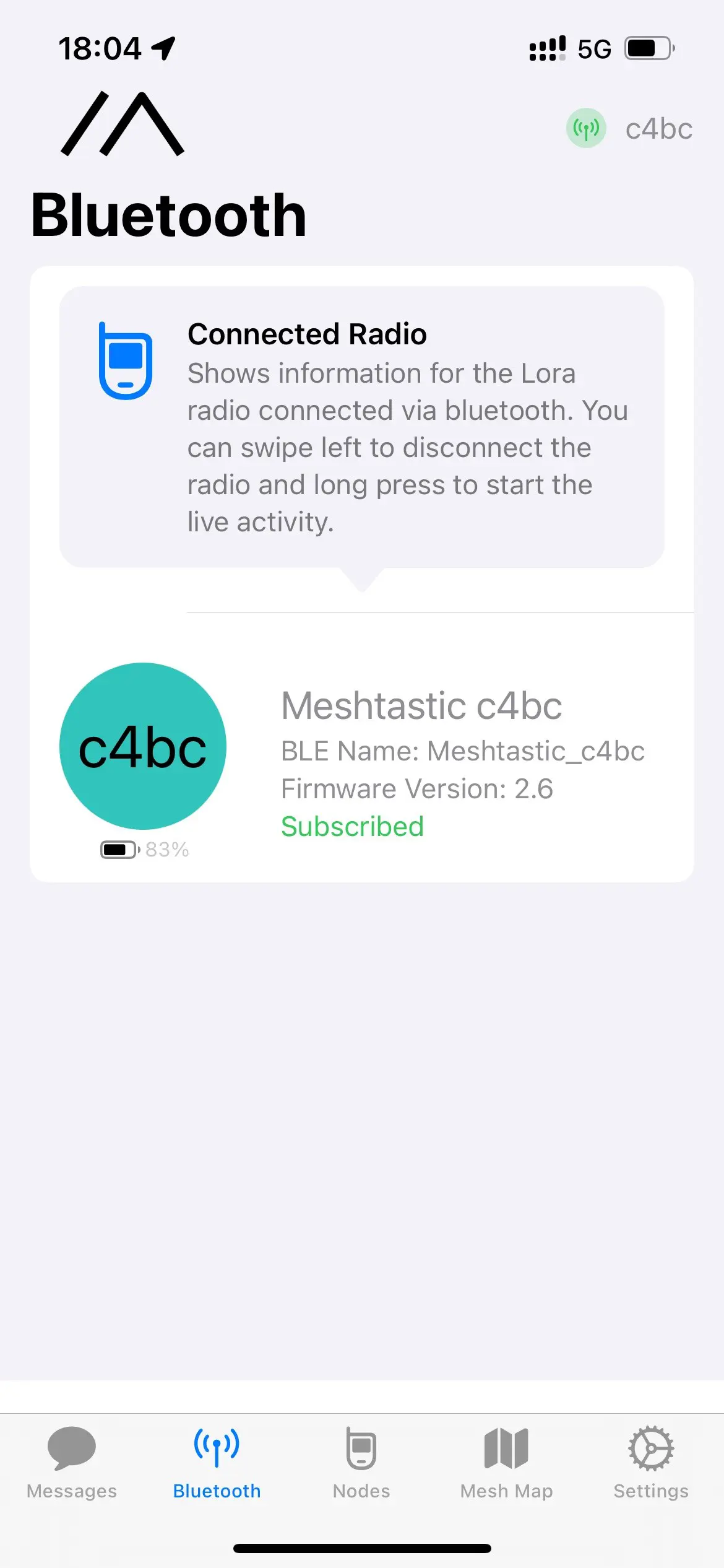

2)The default PIN is “123456.” Enter the PIN to complete pairing.
ios-3

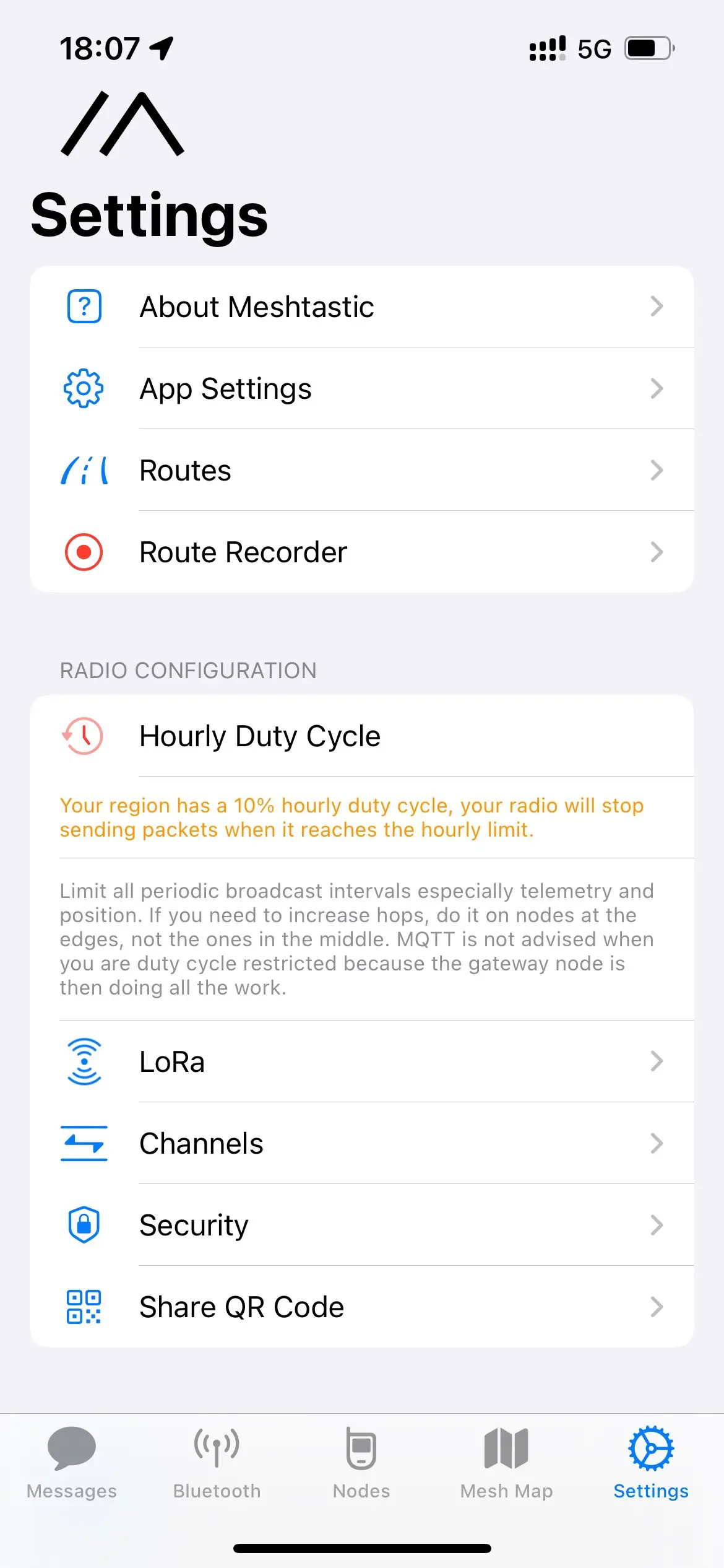

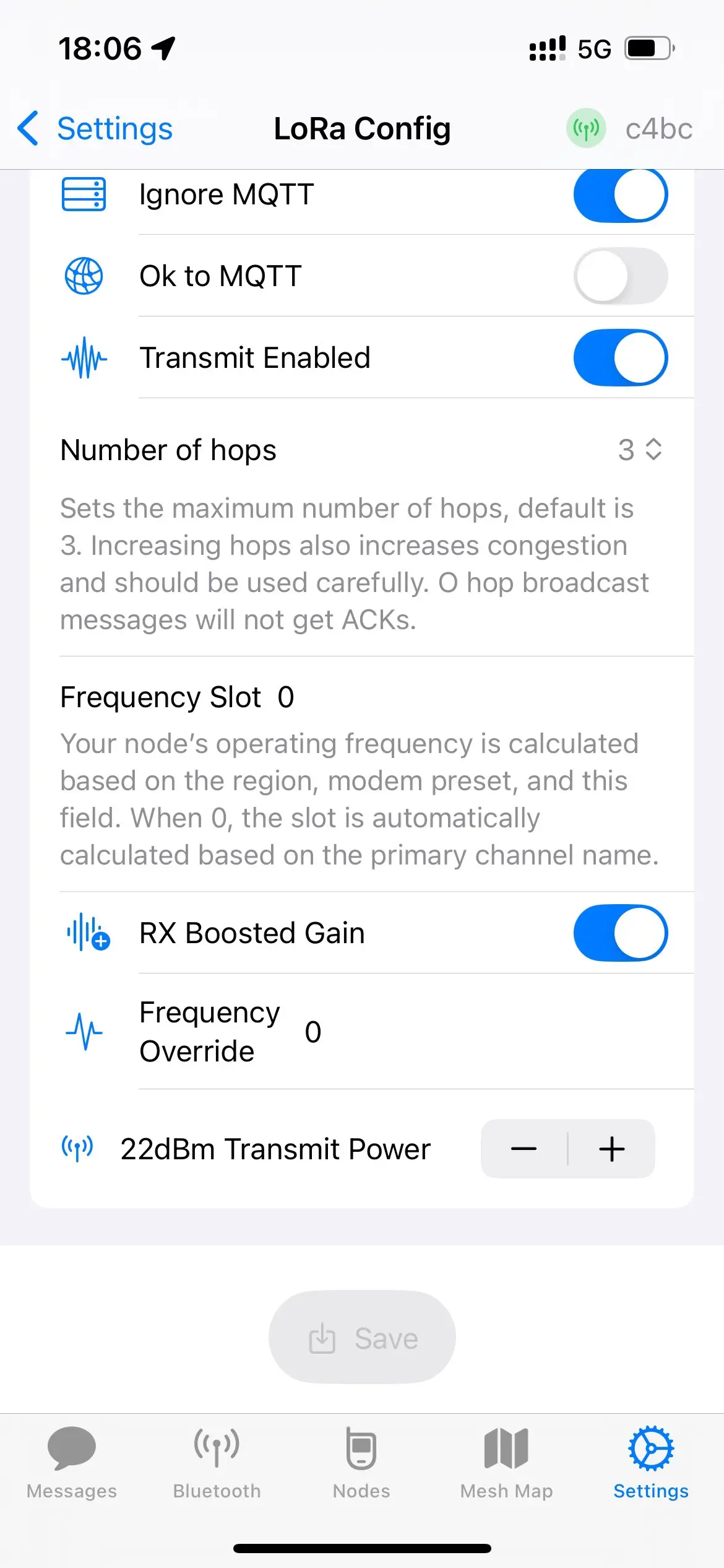

3)After successful Bluetooth pairing, You need to go to Settings and click on LoRa Settings.
ios-1

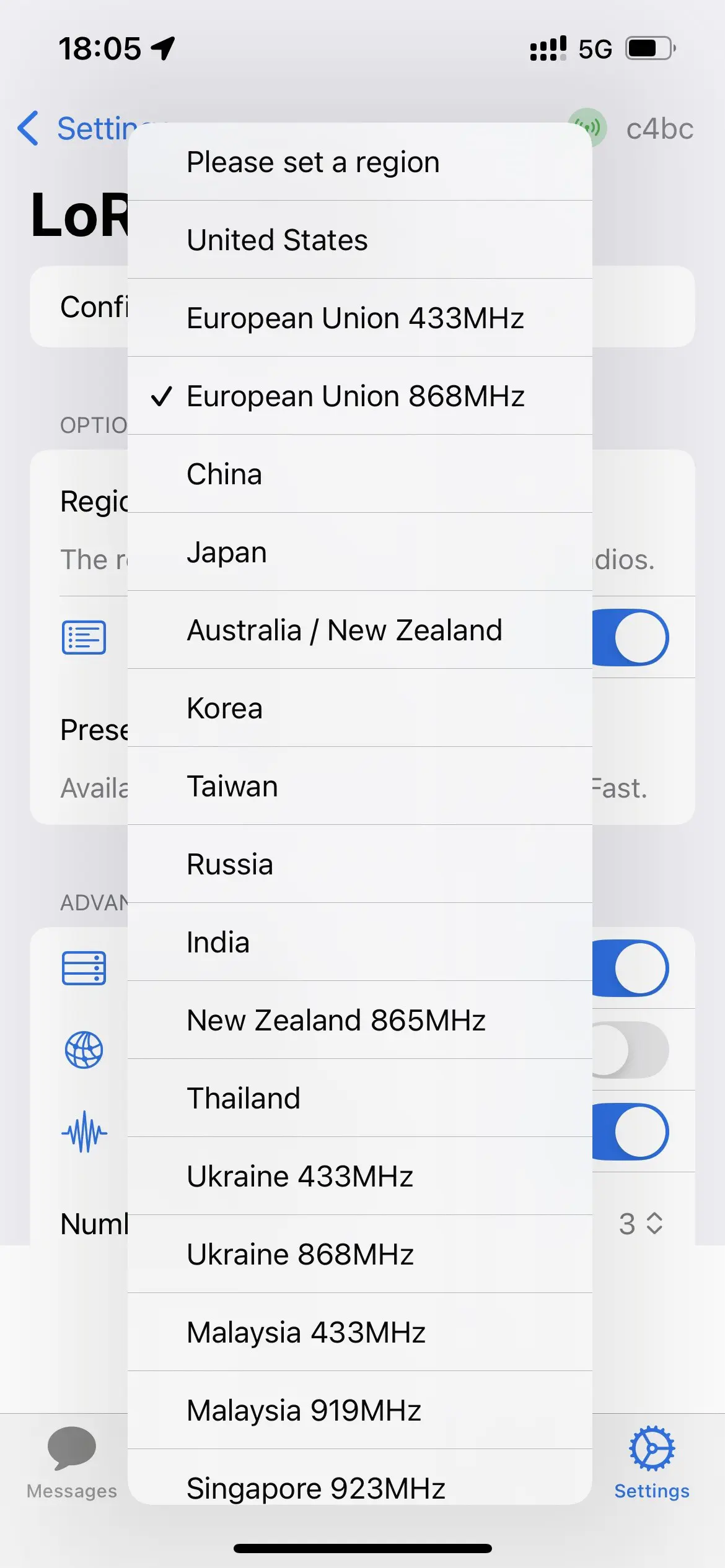

4) Set LoRa Region. and then scroll down to set the frequency. consistent with the previous settings for the region. Finally, check Ignore MQTT and save.

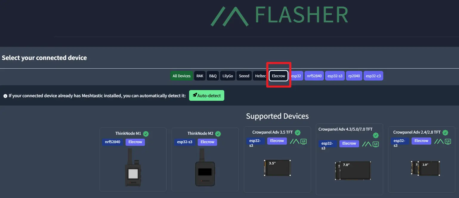

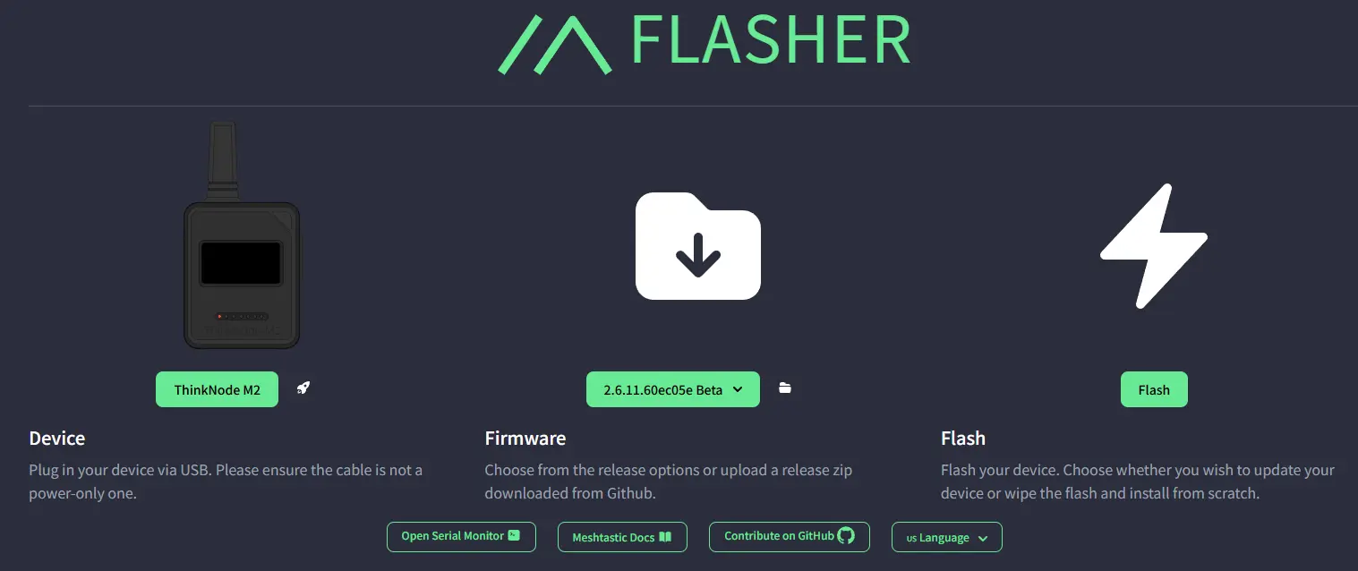

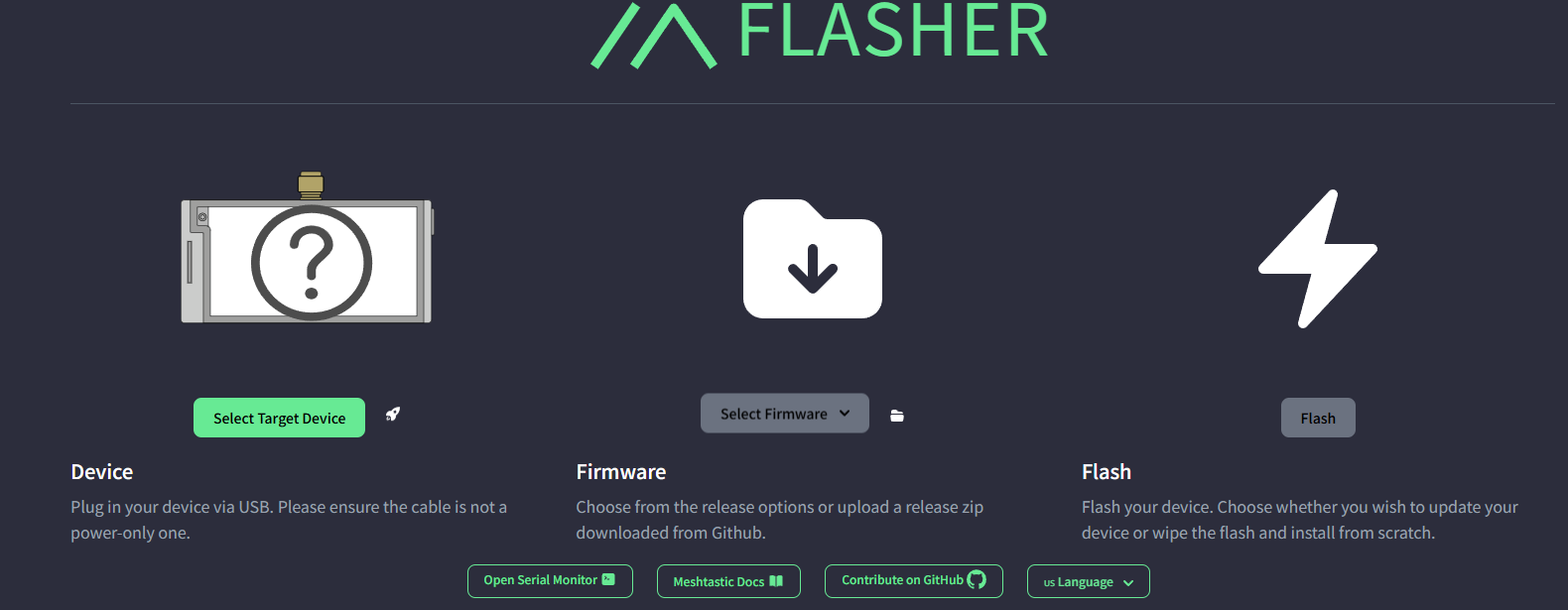

Updating/Flashing Firmware
ClickMeshtastic firmware(For now, please refer to the ThinkNode M5. Dedicated firmware support for the ThinkNode M7 will be available soon.)
firmware0
1,Select the corresponding firmware.
firmware1
2, follow the steps to download the firmware.
firmware2
