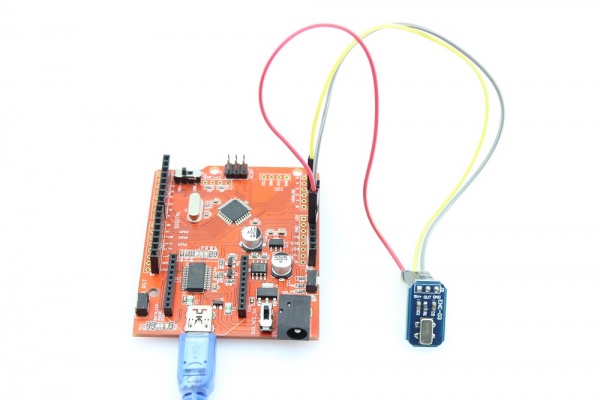

1.Hardware Connection 5V+--5V GND--GND OUT--A0
2.Upload the below code.

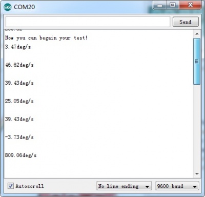

3.Now, it is time to the calibration. Put the sensor on your desk horizontally, and then press the Reset button on the Crowduino, and then Open the serial tool:
4.As you see the "Now you can begin your test", that means the calibration done. You can use the sensor now. Rotating direction can reference the following picture:
