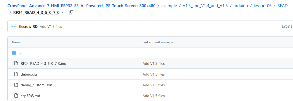

Open the READ folder.
image-20260601114819399
Select the corresponding size code to open.
image-20260601114919803
