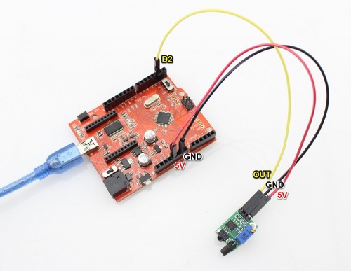

Connect this sensor to your Arduino/Crowduino digital pins( D2 for example). When there is an object behind this sensor, the output would be low.

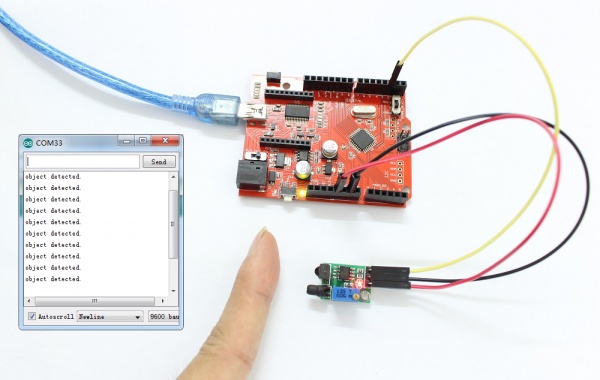

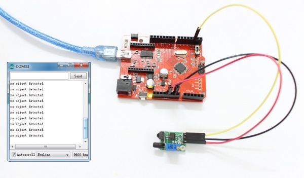

2.Open the Serial moniter, and set the baudrate to 9600, you will see the output change with the object behind this sensor or not.
