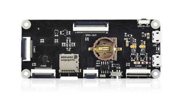

This binocular stereo vision expansion board is specially designed for Raspberry Pi Compute Module, compatible with CM3 / CM3 Lite / CM3+ / CM3+ Lite. Small in size but powerful in function. It features three CSI camera ports that can be connected by camera with different viewing angles or baseline value. It is flexible to build different Raspberry Pi stereo vision projects such as binocular parallax ranging, facial recognition, vivo detection, VR video recording and so on. Also, it has some common used ports like DSI and USB, it is convenient to be connected to LCD display and burning mirror directly. Moreover, it has peripheral interfaces like 24PIN HDMI and 36PIN GPIO are also supported through the FPC connector.
Model: RPA20901S
Features¶
- Comes with three camera ports
- DSI port allows directly connecting with DSI display
- With USB connector, convenient for burning mirror
- 36PIN GPIO connector for extending UART port and Raspberry Pi GPIO
- 24PIN HDMI extended connector for connecting with HDMI display
- 10PIN GPIO/I2C extended connector for connecting ICM20948 IMU fill light board
- Integrates DS1307 RTC chip and comes with CR1220 battery holder
- Comes with acrylic mounting plate and tripod adapter
- Compatible with Raspberry Pi Compute Module CM3 / CM3 Lite / CM3+ / CM3+ Lite compatibly

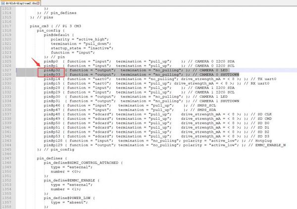

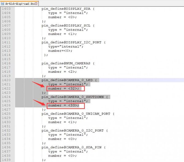

3)After downloading the device tree file, next, you need to modify the device tree file. The specific device tree is modified as follows:
Namely: Compared with the official device tree file, the specific modification is: the LDE and SHUTDOWN of Camera0 are changed from the original 4,5 pins to 32,33 pins.
4)After modifying the device tree file, compile the device tree file, the compilation method is as follows:
5)After compilation, a dt-blob.bin file will be generated. Just copy (replace) this file directly to the boot directory.

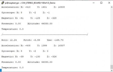

- 5. Test ICM20948
1) First download the sample program
2) Connect the ICM20948 fill light board to the STEREO expansion board through a 10pin cable
3)Turn on the I2C interface
Select Interfacing Options -> I2C -> Yes->OK
4) Check the I2c address
Two addresses of 68 69 can be detected, indicating that the module is connected normally Where 68 is the address of the RTC, 69 is the address of the ICM20948 chip
5) Run the following command to test ICM20948
After running the program, the terminal interface will print the information of the ICM20948 chip
Ctrl+c can close the program

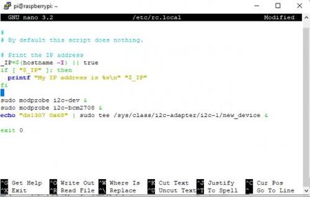

- 6. Test RTC
1)The STEREO expansion board has a RTC spare battery holder, you can connect to the CR1220 button battery, the battery needs to be purchased separately
2)Modify the rc.local file
Add the following statement to the front of exit0
sudo modprobe i2c - dev &
sudo modprobe i2c - bcm2708 &
echo "ds1307 0x68" | sudo tee / sys / class / i2c - adapter / i2c - 1 / new_device &
3) Reboot the system
4) After restarting, check the I2c address again, and you will find that the original address 68 has become UU, which is normal
