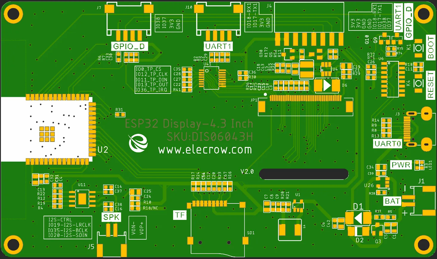

Pin Out
CrowPanel-ESP32-4.3-inch-pinout
Pin Name Description Connector Type
SPK Output audio signal,connected with speakers. The motherboard comes with a power amplifier chip circuit. PH2.0-2P
PWR Power LED.
RST Reset button. Push it to reset the system.
BOOT
GPIO_D Digital and artificial I/O interface. HY2.0-4P
TF Provide off-line save and extra storage space.
UART1 Build the communication among Logic modules, including serial communication module and print module. HY2.0-4P
BAT Connect with the lithium battery. (With the battery charging circuit) PH2.0-2P
UART0 Provide serial communication, supply voltage(transform USB to UART0) and serial information printing. USB-C
4.3-inch HMI Port Pin Number
GPIO_D IO37, IO38(Can be used to simulate UART or IIC)
UART1 RX(IO18); TX(IO17)
SPK(I2S) I2S-CTRL(3V3); I2S-MCLK(IO19); I2S-BCLK(IO35); I2S-SDIN(IO20)
SD Card Slot(SPI) MOSI(IO11); MISO(IO13); CLK(IO12); CS(IO10)
LCD Backlight IO2

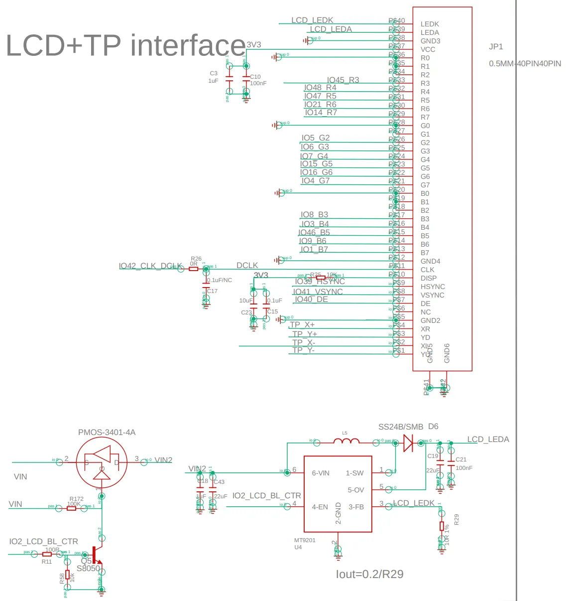

Schematic Diagram
ESP32-S3 and TFT display wiring pins
Schematic Diagram:
CrowPanel-ESP32-4.3-inch-diagram-1
Definition in the main program(If use LovyanGFX library):
#define screenWidth   480
#define screenHeight  272
class LGFX : public lgfx::LGFX_Device
public:
    lgfx::Bus_RGB _bus_instance;
    lgfx::Panel_RGB _panel_instance;
    lgfx::Light_PWM _light_instance;
    lgfx::Touch_XPT2046 _touch_instance;
    LGFX(void)
            auto cfg = _panel_instance.config();
            cfg.memory_width = screenWidth;
            cfg.memory_height = screenHeight;
            cfg.panel_width = screenWidth;
            cfg.panel_height = screenHeight;
            cfg.offset_x = 0;
            cfg.offset_y = 0;
            _panel_instance.config(cfg);
            auto cfg = _bus_instance.config();
            cfg.panel = &_panel_instance;
            cfg.pin_d0 = GPIO_NUM_8;  // B0
            cfg.pin_d1 = GPIO_NUM_3;  // B1
            cfg.pin_d2 = GPIO_NUM_46; // B2
            cfg.pin_d3 = GPIO_NUM_9;  // B3
            cfg.pin_d4 = GPIO_NUM_1;  // B4
            cfg.pin_d5 = GPIO_NUM_5;  // G0
            cfg.pin_d6 = GPIO_NUM_6;  // G1
            cfg.pin_d7 = GPIO_NUM_7;  // G2
            cfg.pin_d8 = GPIO_NUM_15; // G3
            cfg.pin_d9 = GPIO_NUM_16; // G4
            cfg.pin_d10 = GPIO_NUM_4; // G5
            cfg.pin_d11 = GPIO_NUM_45; // R0
            cfg.pin_d12 = GPIO_NUM_48; // R1
            cfg.pin_d13 = GPIO_NUM_47; // R2
            cfg.pin_d14 = GPIO_NUM_21; // R3
            cfg.pin_d15 = GPIO_NUM_14; // R4
            cfg.pin_henable = GPIO_NUM_40;
            cfg.pin_vsync = GPIO_NUM_41;
            cfg.pin_hsync = GPIO_NUM_39;
            cfg.pin_pclk = GPIO_NUM_42;
            cfg.freq_write = 8000000;
            cfg.hsync_polarity    = 0;
            cfg.hsync_front_porch = 8;
            cfg.hsync_pulse_width = 4;
            cfg.hsync_back_porch  = 43;
            cfg.vsync_polarity    = 0;
            cfg.vsync_front_porch = 8;
            cfg.vsync_pulse_width = 4;
            cfg.vsync_back_porch  = 12;
            cfg.pclk_active_neg = 1;
            cfg.de_idle_high = 0;
            cfg.pclk_idle_high = 0;
            _bus_instance.config(cfg);
            _panel_instance.setBus(&_bus_instance);
            auto cfg = _light_instance.config();
            cfg.pin_bl = GPIO_NUM_2;
            _light_instance.config(cfg);
            _panel_instance.light(&_light_instance);
            auto touch_cfg = _touch_instance.config();
            touch_cfg.x_min      = 100;    // タッチスクリーンから得られる最小のX値(生の値)
            touch_cfg.x_max      = 4000;  // タッチスクリーンから得られる最大のX値(生の値)
            touch_cfg.y_min      = 100;    // タッチスクリーンから得られる最小のY値(生の値)
            touch_cfg.y_max      = 4000;  // タッチスクリーンから得られる最大のY値(生の値)
            touch_cfg.pin_int    = 36;   // INTが接続されているピン番号
            touch_cfg.bus_shared = true; // 画面と共通のバスを使用している場合 trueを設定
            touch_cfg.offset_rotation = 0;// 表示とタッチの向きのが一致しない場合の調整 0~7の値で設定
            // SPI接続の場合
            touch_cfg.spi_host   = SPI2_HOST; //HSPI_HOST;// 使用するSPIを選択 (HSPI_HOST or VSPI_HOST)
            touch_cfg.freq       = 1000000;     // SPIクロックを設定
            touch_cfg.pin_sclk   = GPIO_NUM_12;     // SCLKが接続されているピン番号
            touch_cfg.pin_mosi   = GPIO_NUM_11;     // MOSIが接続されているピン番号
            touch_cfg.pin_miso   = GPIO_NUM_13;     // MISOが接続されているピン番号
            touch_cfg.pin_cs     = GPIO_NUM_0;     //   CSが接続されているピン番号
            _touch_instance.config(touch_cfg);
            _panel_instance.setTouch(&_touch_instance);  // タッチスクリーンをパネルにセットします。
        setPanel(&_panel_instance);

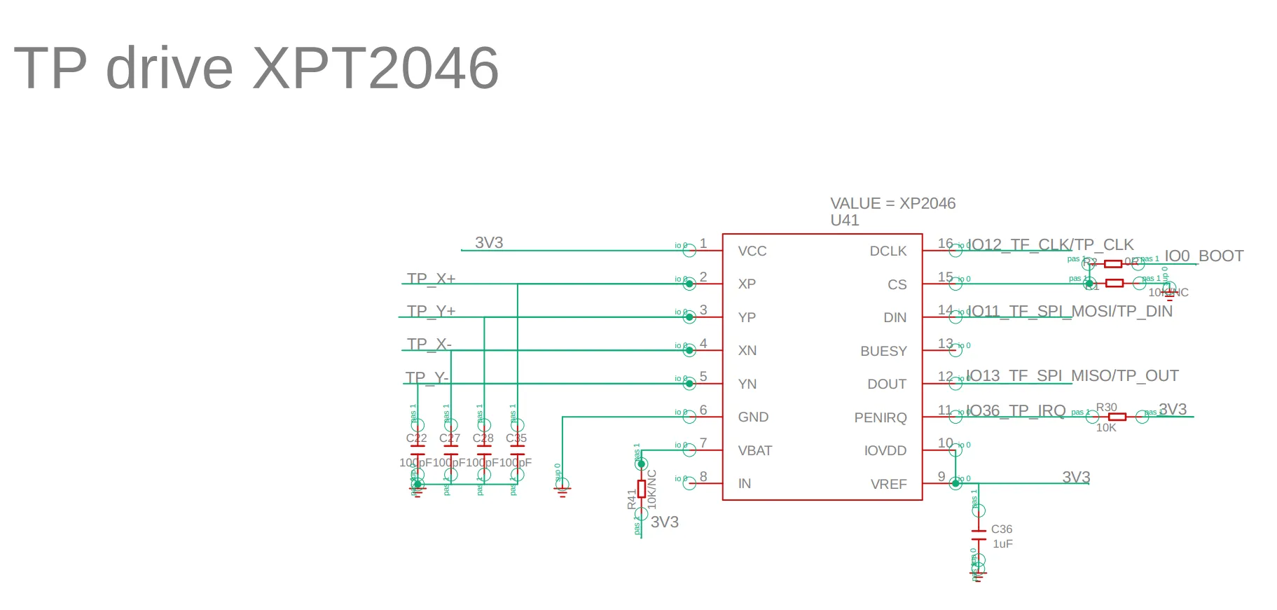

ESP32-S3 and touch driver wiring
Schematic Diagram:
CrowPanel-ESP32-4.3-inch-diagram-2
Pin definition in the touch.h:
#define TOUCH_XPT2046
#define TOUCH_XPT2046_SCK 12
#define TOUCH_XPT2046_MISO 13
#define TOUCH_XPT2046_MOSI 11
#define TOUCH_XPT2046_CS 0
#define TOUCH_XPT2046_INT 36
