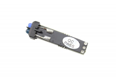

Introduction
The reflectivity of infrared light varies with the color and distance of the reflecting surface, According to this principle,Photosensor- Short Range utilizes a TCRT5000 reflective photosensor module to detect color and distance. When a light-colored object approaches,the signal intensity received by infrared reflective sensor increases and the indicator LED on board turns ON. When a dark-colored object approaches, the intensity decreases and the LED turns off. This sensor is a basic and widely used part in applications such as line-following cars, rotary speed detection, auto data logging on utility meters or other situations where color or distance contrast is sharp.

  • Operating voltage: 4.5 V - 5.5 V.
  • Digital output, 0 or VCC.
  • High resolution sensor;minumum detectable length: 1mm black line.
  • Effective distance:1-8mm,optimum:2.5mm.
  • Indicator LED on board.
  • Size:35*7.5*5mm.
  • Easy to use in obstacle sensoring; White/Black wire tracking
