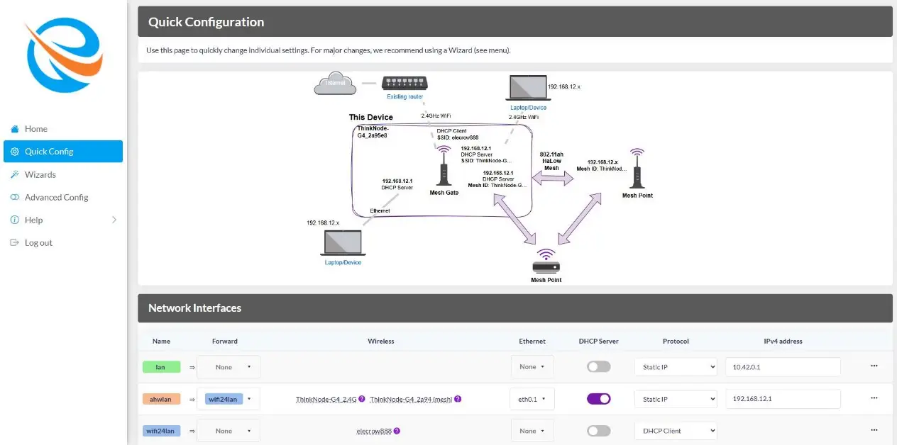

Wi-Fi HaLow Mesh Gate Mode

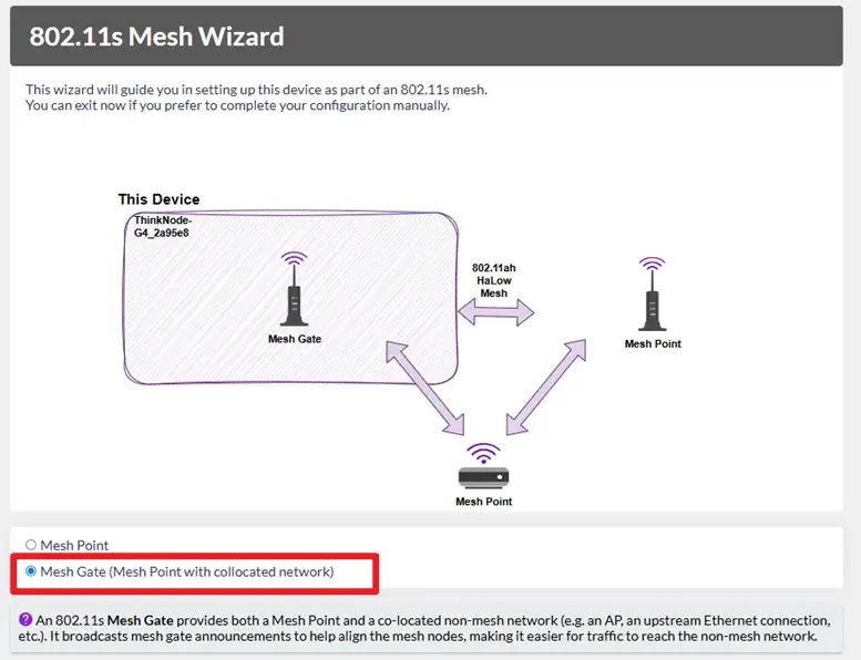

  1. Complete the "Gateway configuration pre-preparation";
  2. Select "802.11s Mesh".
g4_wi-fi_halow_mode_26
  1. Select "Mesh Gate", then click "Next".
g4_wi-fi_halow_mode_27
  1. Configure Mesh Network parameters:
  2. Mesh ID: The name of the Mesh network gateway.
  3. Password: The Mesh gateway password (Default: elecrow.com).
  4. Bandwidth: Higher bandwidth = faster speed/shorter range.
  5. Channel: Change to reduce interference.
g4_wi-fi_halow_mode_28
  1. Select Uplink Network (Options are the same as in AP Mode: None, Ethernet Bridge, Ethernet Router, Wi-Fi 2.4 GHz).Choose an “Upstream Network” connection type.This determines how
the access point(AP) connects to the network. Parameter descriptions:
None:your device will have a static IP address and run a DHCP server on all interfaces,the HaLow and non-HaLow network will be isolated from each other.
Ethernet-Bridge: your device and halow connected devices obtain IP addresses from your current upstream network.
Ethernet-Router: the halow connected devices obtain IP addresses from DHCP server on this device, and this device uses NAT to forward IP traffic.
Wi-Fi(2.4 GHz): the halow connected devices obtain IP addresses from the DHCP server on this device, and this device uses NAT to forward IP traffic.
Note: If you choose the "Wi-Fi(2.4 GHz)" mode, you can click "Scan" or enter the available Wi-Fi name and password in the fields;
g4_wi-fi_halow_mode_29
  1. Turn on "Enable Access Point". This device also provides a standard 2.4 GHz Wi-Fi hotspot. Set your 2.4 GHz Wi-Fi hotspot name and password,and make sure it is not the same as the Mesh gateway name from step4;
g4_wi-fi_halow_mode_30
  1. Remember your Mesh Gateway “IP address”, then click "Apply" to complete the configuration;
g4_wi-fi_halow_mode_31

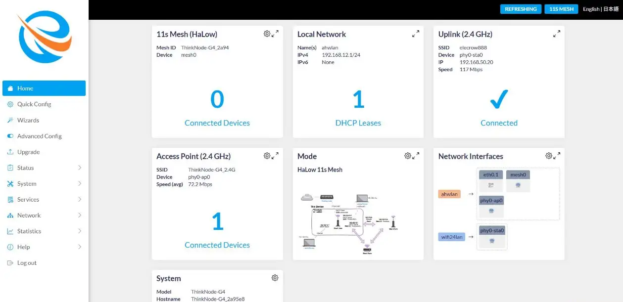

g4_wi-fi_halow_mode_10
  1. Connect your devices to the 2.4 GHz Wi-Fi hotspot.
g4_wi-fi_halow_mode_11
  1. Enter the IP Address in a browser to access the management UI.
  1. You can view various parameter information in the MeshGate’s admin interface;
g4_wi-fi_halow_mode_32

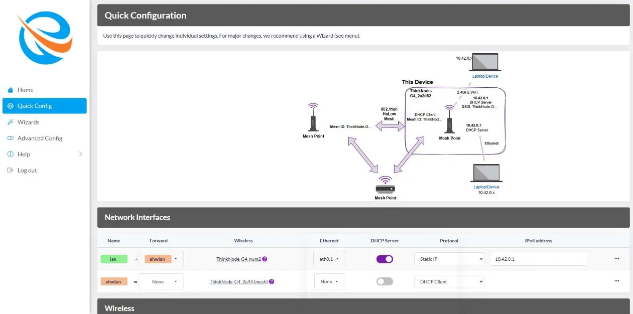

Wi-Fi HaLow Mesh Point Mode
  1. Ensure "Configuration Preparations" are completed.
  1. Select "Mesh Point", then click "Next". g4_wi-fi_halow_mode_34
  2. Enter the Mesh Gate name and password you wish to connect to. g4_wi-fi_halow_mode_35
  3. Select Traffic Mode .Parameter descriptions are as follows:
None: This device will have a static IP address and run a DHCP server on non-HaLow interface,the HaLow and non-HaLow network are isolated.
Bridge: non-halow devices obtain IP from your halow link.
Extender: non-halow devices obtain IP from the DHCP server on this device and this device uses NAT to forward IP traffic.
g4_wi-fi_halow_mode_36
  1. Turn on "Enable Access Point".This device also provides a standard2.4 GHz Wi-Fi hotspot. Set your 2.4 GHz Wi-Fi hotspot name and password,and make sure it is not the same as the Mesh Gate’s 2.4 GHz hotspot name;
g4_wi-fi_halow_mode_37
  1. Click "Apply" to complete the Mesh Point gateway configuration;
g4_wi-fi_halow_mode_38

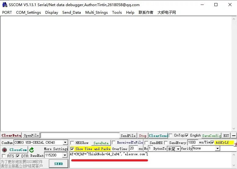

ESP32 Wi‑Fi HaLow module configuration
  1. Open a serial terminal tool (any serial tool works), select the corresponding port, and set the baud rate to 115200.
  2. Send: AT+CWJAP=“AP-SSID”, ‘Passphrase’; — where AP-SSID and Passphrase are the username and password for the Wi-Fi HaLow gateway, respectively. Please refer to the AP mode settings in the ThinkNode G4 Gateway Configuration manual. For example: AT+CWJAP=“ThinkNode-G4_2a94”, “elecrow.com”;
g4_wi-fi_halow_mode_43
  1. After sending, you will see the ESP32 Wi‑Fi HaLow Module attempt to connect to the Wi‑Fi HaLow gateway. When the connection is successful, you will receive the reply: “WLAN STA connected”.Then there is an IP address (for example: 192.168.12.126). Make a note of this IP address.
g4_wi-fi_halow_mode_44
