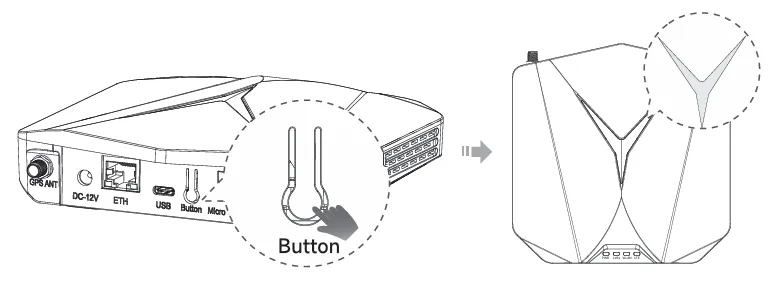

STEP1:Turn on the device's AP hotspot¶
Press and hold the button for 5 seconds until the top indicator light slowly flashes blue, then it will enter configuration mode.

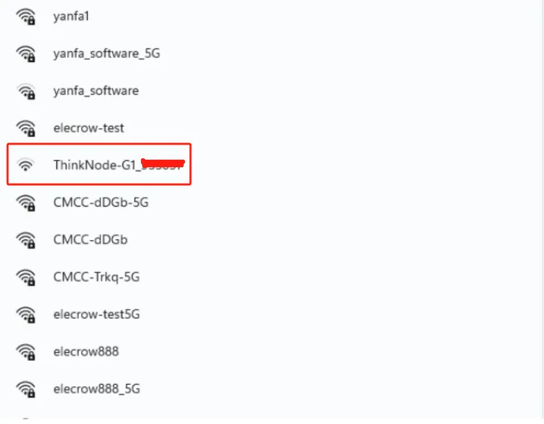

The name of the AP hotspot is ThinkNode - G1_XXXXXX (6 - digit MAC address). No password is required, and you can connect directly. Connect your computer or mobile phone to this AP hotspot.

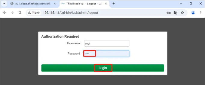

STEP3:Log in to the local console¶
Enter the IP address (192.168.1.1) in your browser to access the local console. Then, log in with the username "root", enter the password "root", and click the "Login" button.

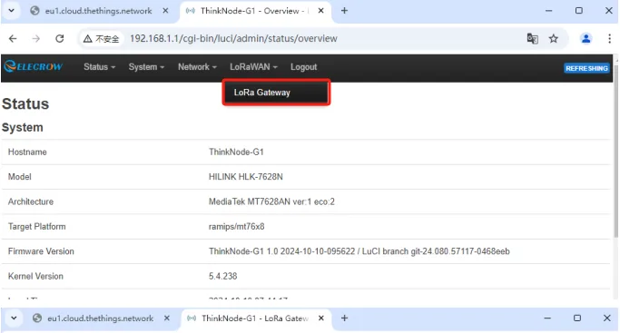

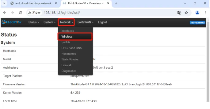

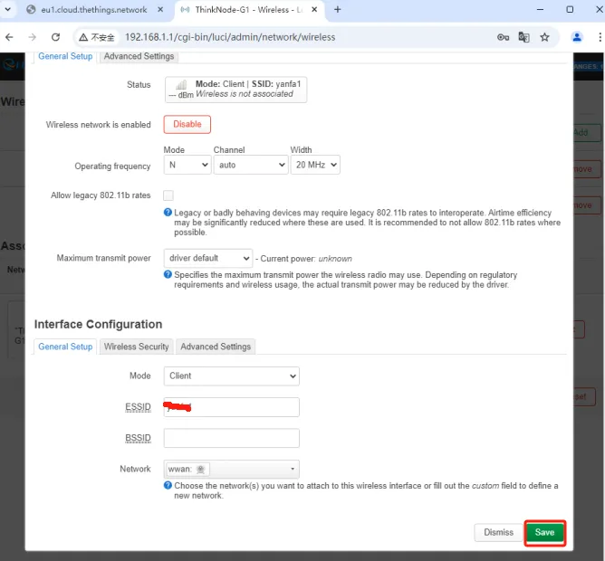

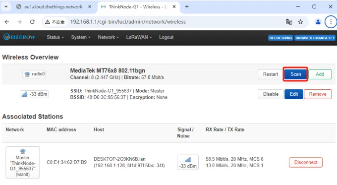

STEP4:Log in to the Luci page, and click Network - Wireless¶

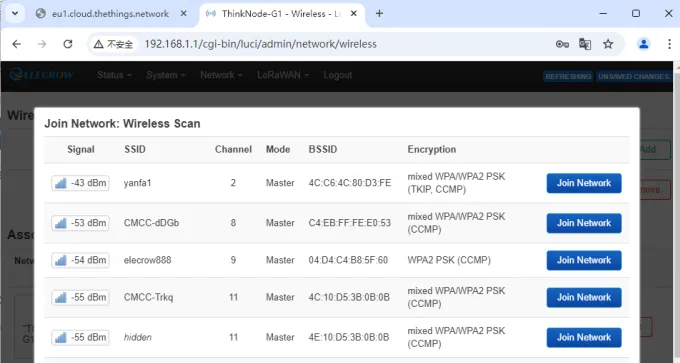

STEP5:Click the "Scan" button to scan for Wi - Fi.¶
STEP6:Select your Wi - Fi to join the network.¶

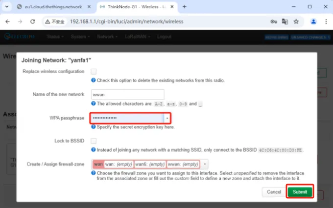

STEP7:Enter the Wi-Fi password, then click "Submit", and save the settings.¶

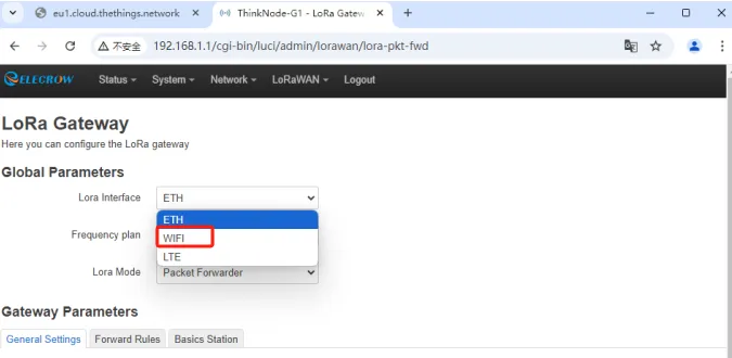

STEP8:Set the gateway's Internet connection method to Wi-Fi.¶

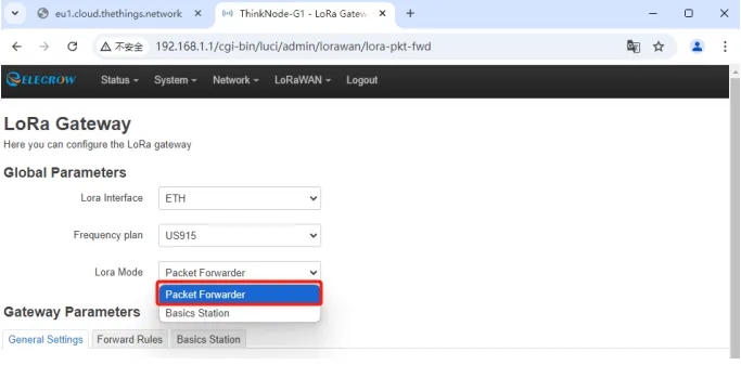

On the Luci interface, click "LoRaWAN" and navigate to the LoRa Gateway interface.
Select the network configuration mode as "WiFi".
STEP9:Set Mode to Packet Forwarder.¶

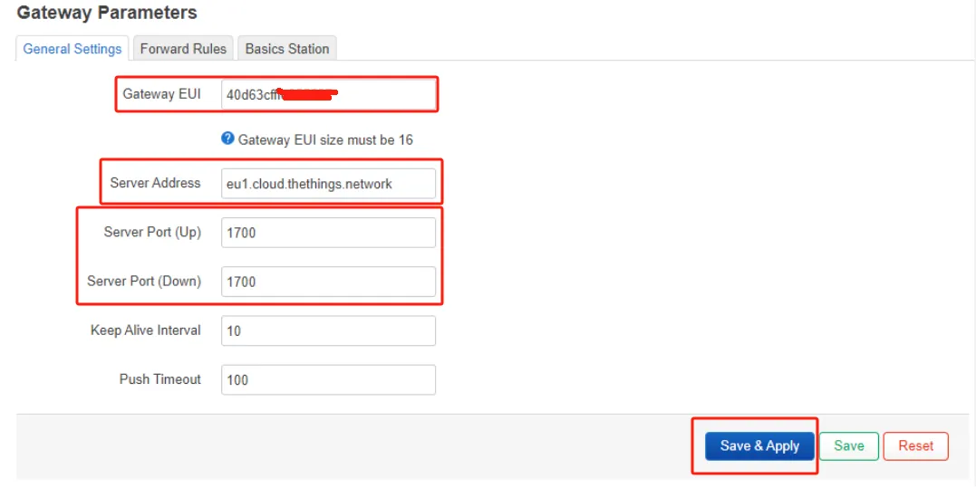

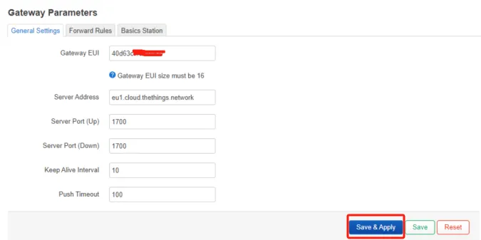

STEP10:Packet Forwarder Settings¶
1.Gateway EUI: It will automatically obtain the EUI of the connected gateway.
2.Server address: For the Semtech UDP packet forwarder, use "server-address". "server-address" is the address of The Things Stack deployment.
3.Server Ports (Up/Down): The uplink and downlink ports are typically set to 1700.
Other settings can be left as default or adjusted according to your requirements..

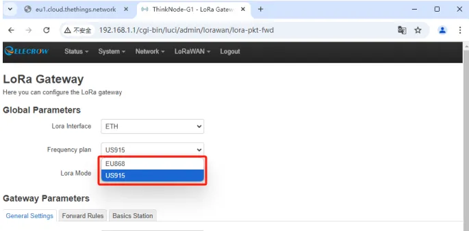

STEP11:Channel Plan Settings¶
Select the Region and Frequency plans according to the actual situation.
Then click "Save & Apply" to apply your settings.
Note: Remember the Gateway EUI here, which needs to be filled in on the TTN platform later.

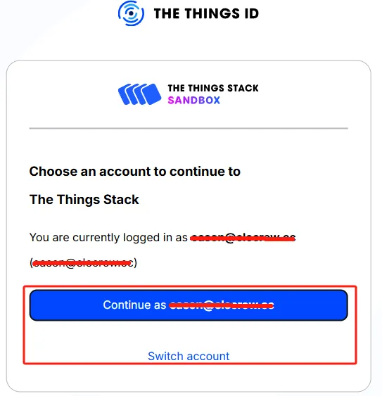

STEP1:Log in to The Things Stack (The Things Network). If you don't have a TTN account, please register first.¶

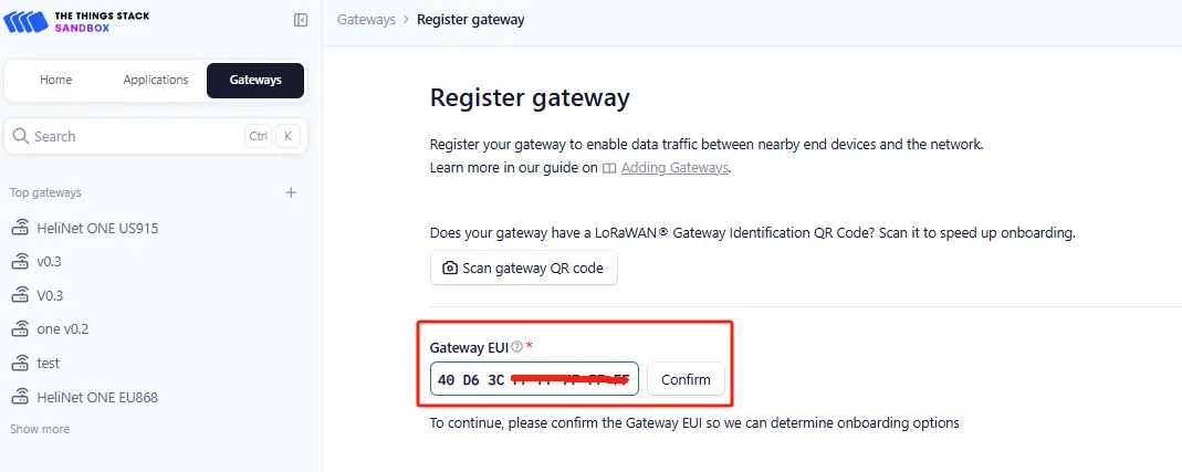

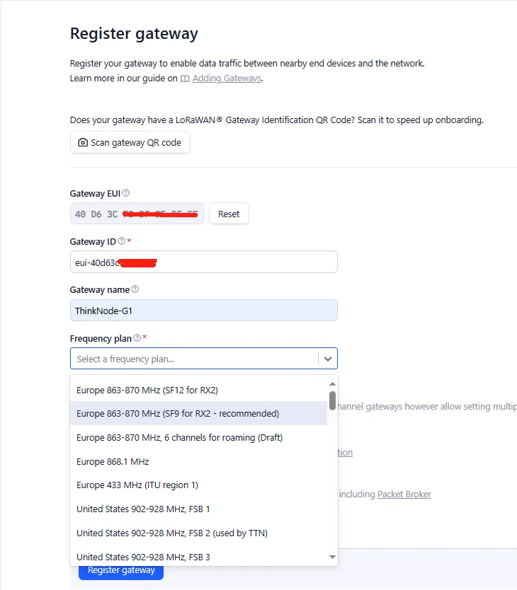

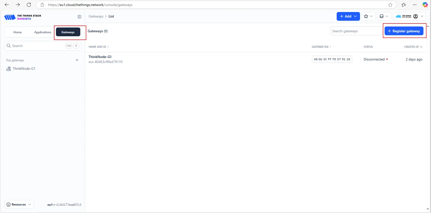

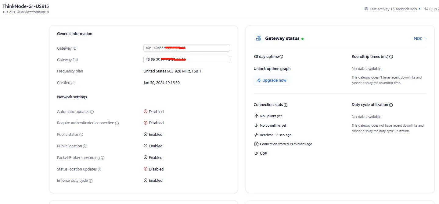

STEP2:Register the gateway, fill in the EUI, and click "confirm".¶
Gateway ID: It typically consists of letters (eui - "Gateway EUI") (The ID must contain only lowercase letters, numbers, and dashes).Note that the letters in "Gateway EUI" must be converted to lowercase.
Gateway Name: The name of the gateway.
Frequency Plan: Select the corresponding frequency according to your gateway version.

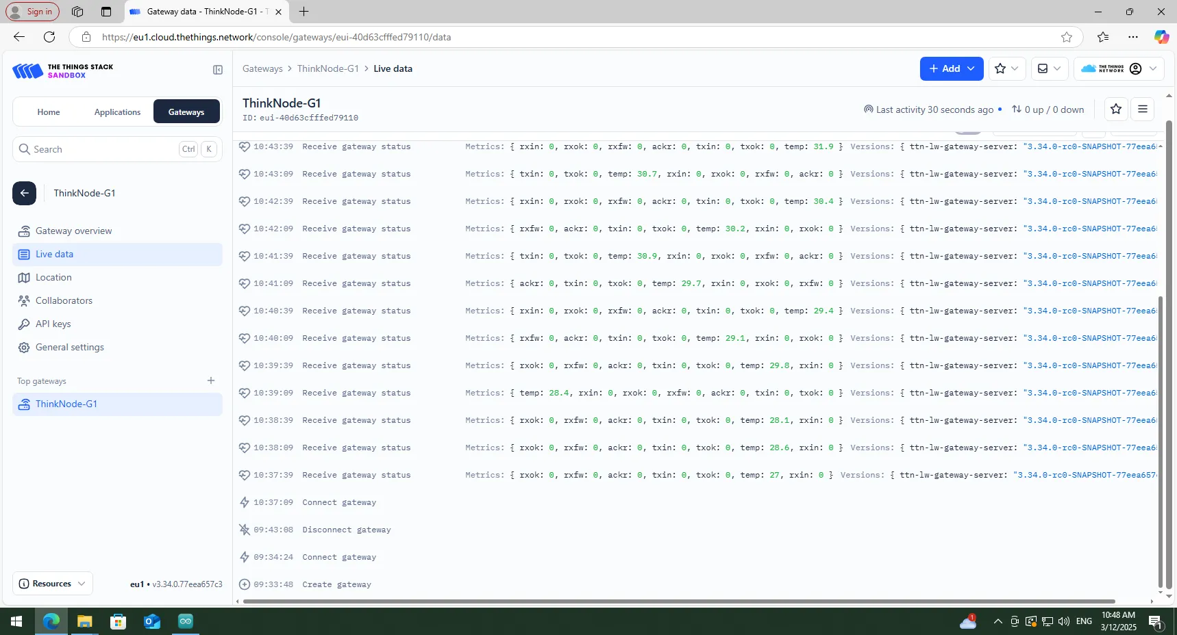

After successful registration, you can view the gateway in the overview.
Double - click the gateway settings button and wait for the gateway to restart. The gateway is now connected to TTN as a Packet Forwarder.

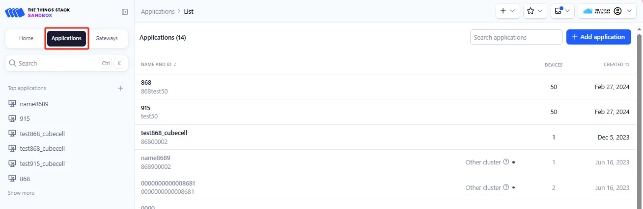

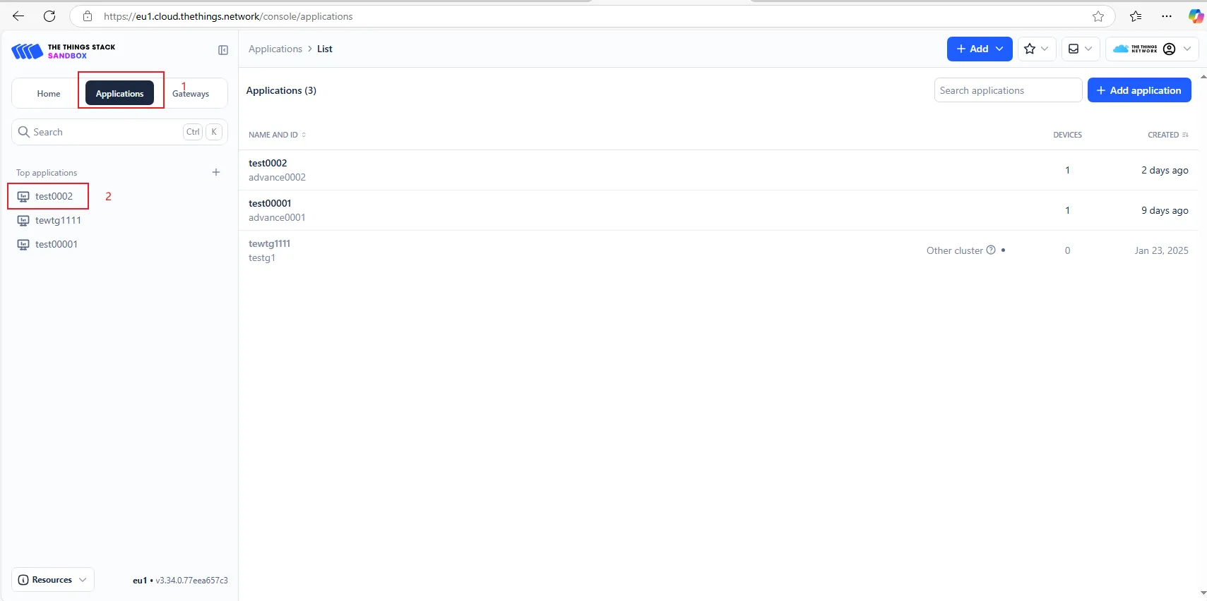

In the TTN server interface, click "Applications".

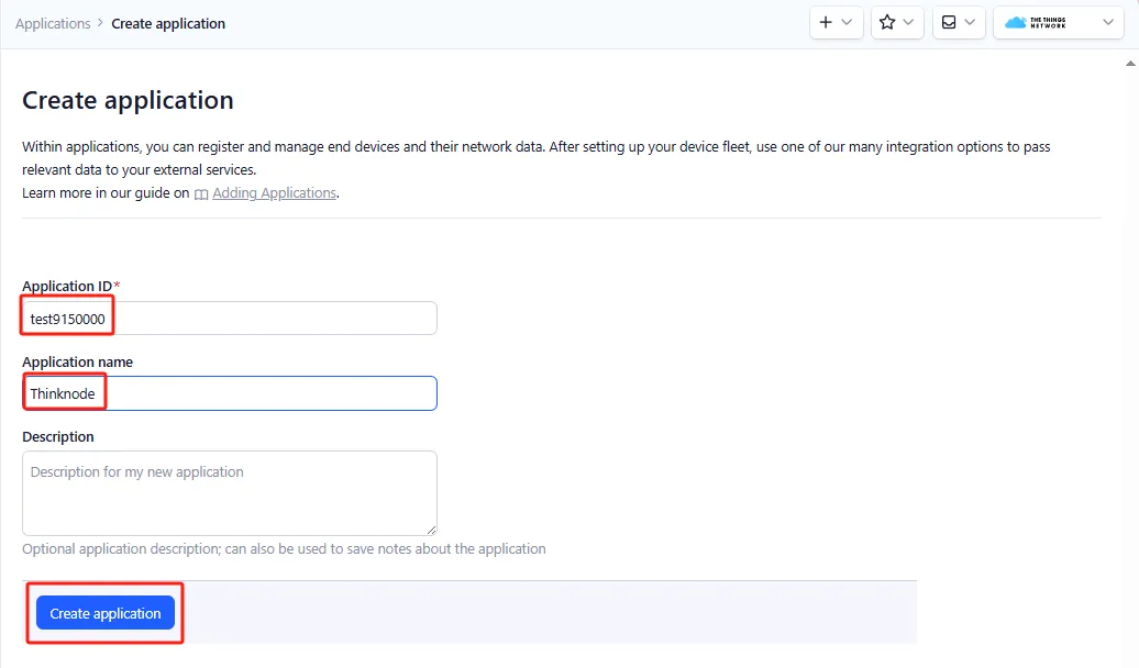

STEP2:Click "Add application" to start adding a node application.¶
Enter the Application ID and Application name, then click "Create application".

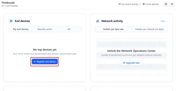

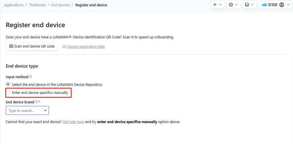

STEP3:Enter the application overview page, click "Register end device" in the lower - left corner to register a new device on the TTN platform.¶

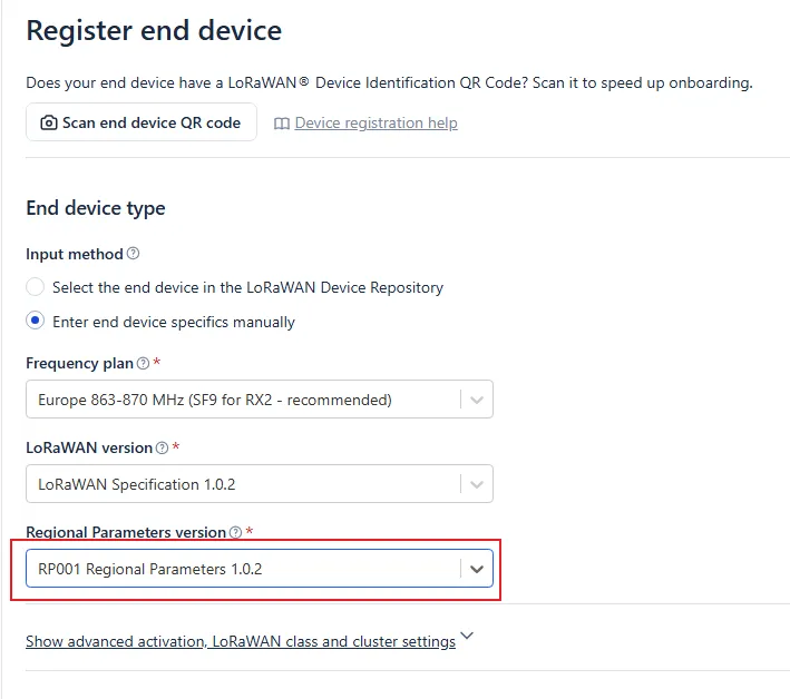

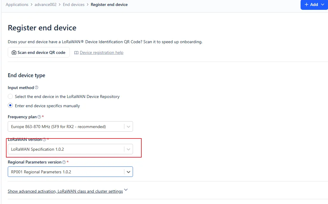

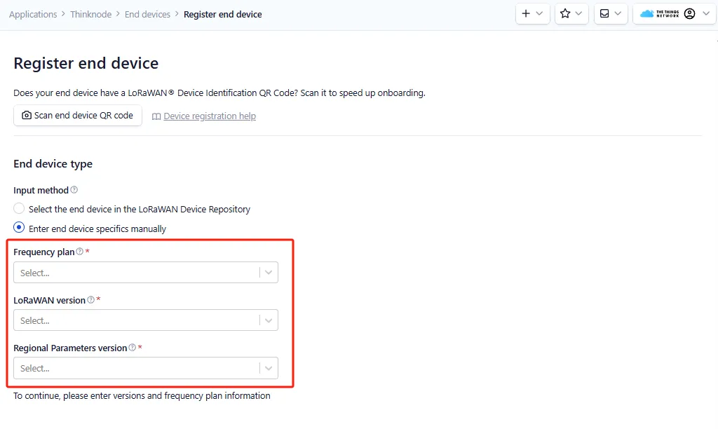

STEP4:In the "Register end device" page, click the "Enter end device specifics manually" option.¶

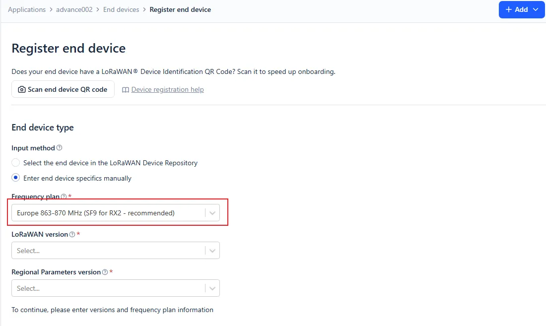

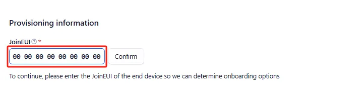

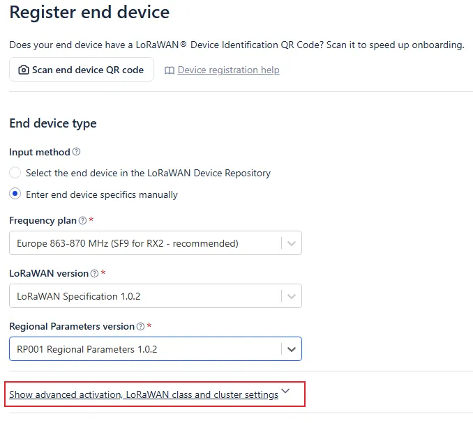

STEP5:Set the Frequency plan, LoRaWAN version, Regional Parameters version, and JoinEUI (APPEUI).¶
Note: JoinEUI is the same as AppEUI.¶
Set the Frequency plan.Note that the frequency band range should be consistent with the one used by the gateway.
Set the LoRaWAN version.
Set the Regional Parameters version.
Set the JoinEUI (APPEUI).

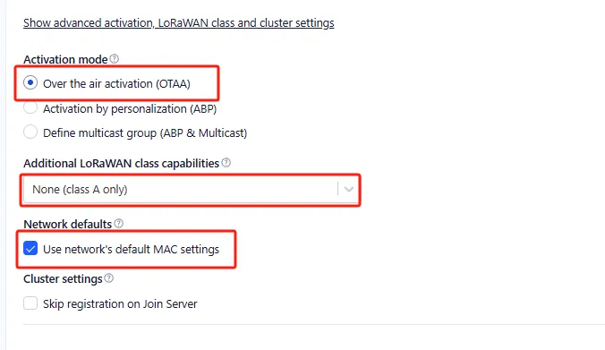

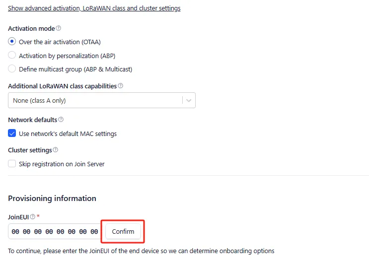

STEP6:Click "Show advanced activation, LoRaWAN class and cluster settings" to configure parameters such as the activation mode and the device operating mode.¶
· When the activation mode is OTAA
Configure it to OTAA mode (i.e., the default mode).
Then click "Confirm".

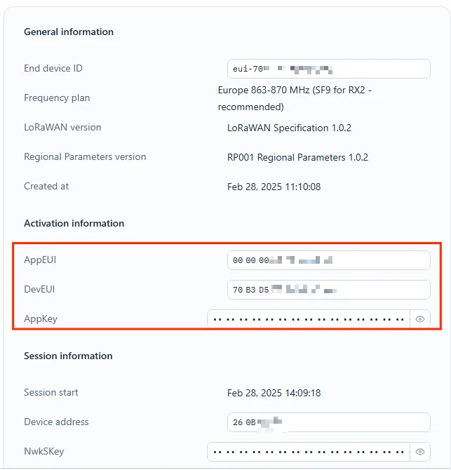

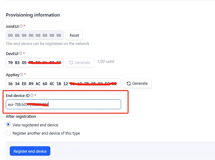

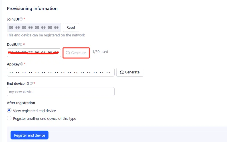

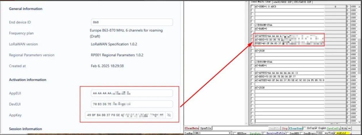

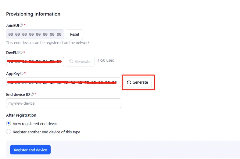

STEP7:According to the activation mode selected above, configure the corresponding device parameters as shown in the following figure:¶
Click "Generate" to automatically generate the DevEUI.
Click "Generate" to automatically generate the AppKey.
Enter the End device ID.
Click "Register end device".
Note: Save the content in the Activation information, which will be used when sending AT commands later.
The OTAA device registration was successful.

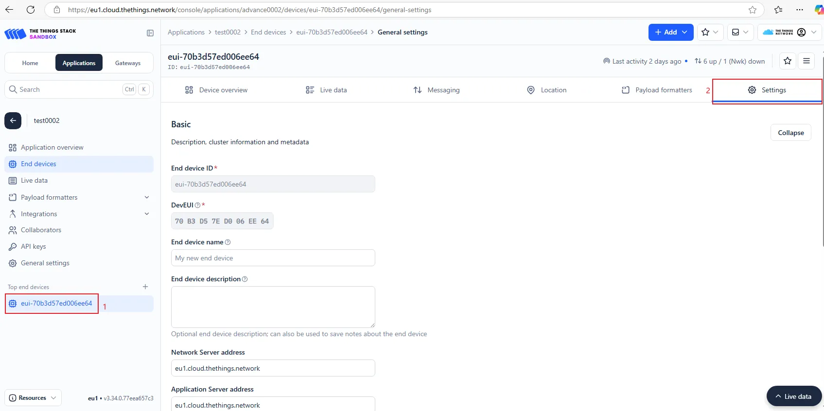

Click on Application -> Application Name
Click on node name->Settings

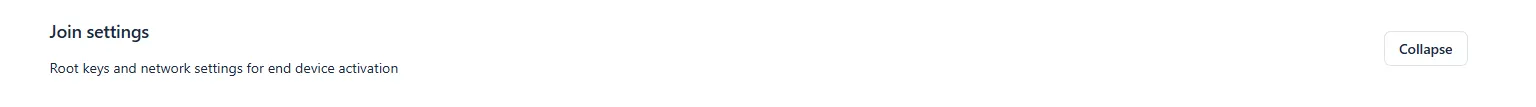

Pull down to the bottom of the page, Select Join Settings.
Enable "Resets join nonces"

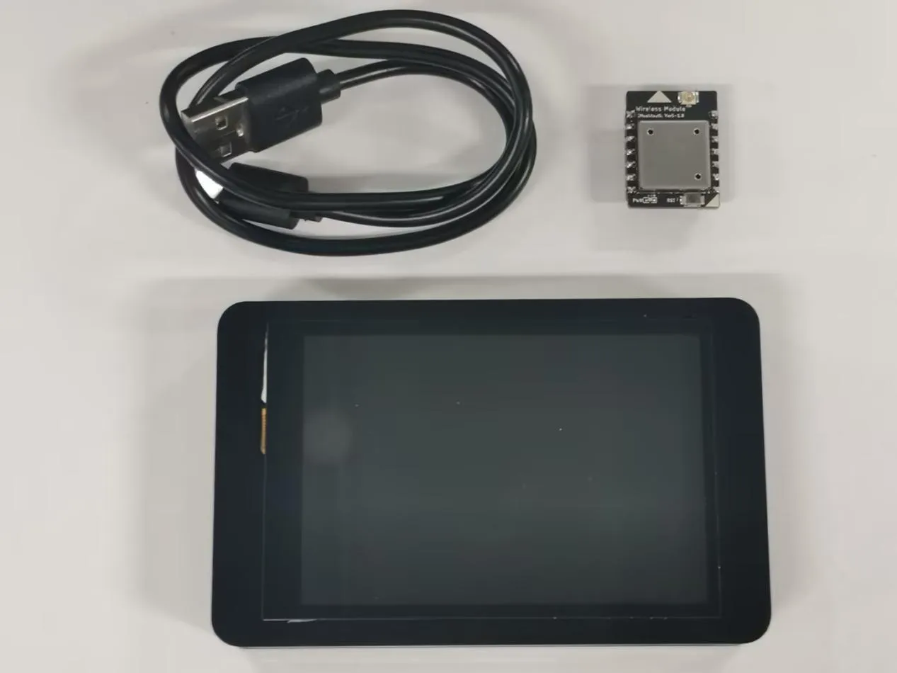

Hardware preparation:¶
- CrowPanel Advance HMI| ESP32-S3 AI-Powered IPS Touch Screen
- Wireless module-Meshtastic
TYPE-C USB cable

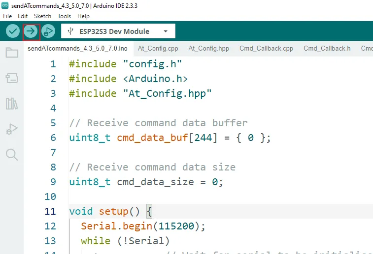

Configure the software program of the CrowPanel Advance AI Display to the USB-TTL communication mode (For the small-sized display, use sendATcommands_3.5_2.8_2.4, and for the large-sized display, use sendATcommands_4.3_5.0_7.0).
SSCOM Serial Port Tool
Configure the CrowPanel Advance AI Display for USB - TTL communication mode.¶

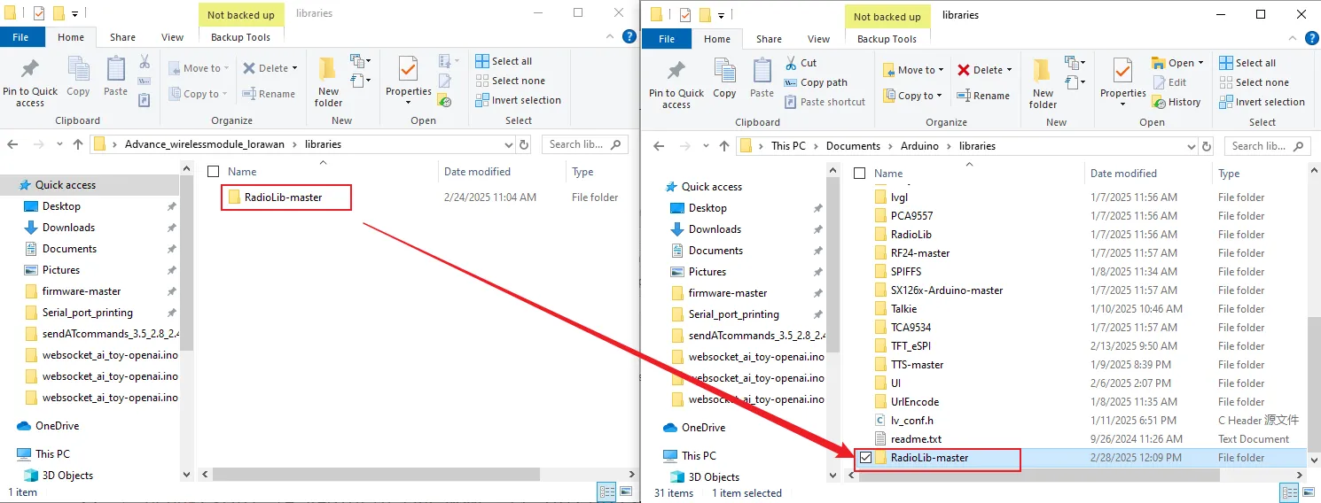

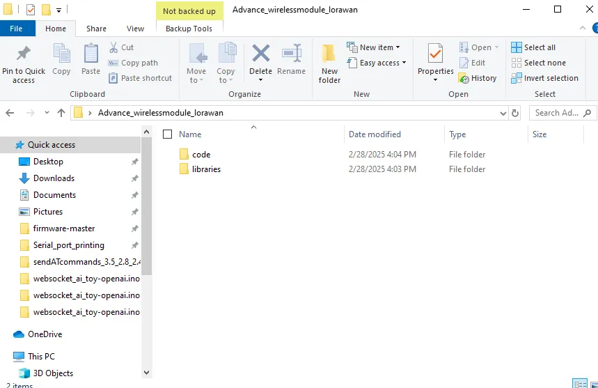

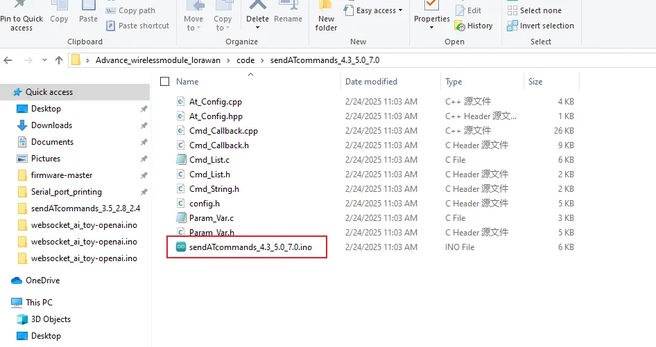

Open the folder attached to this tutorial. Inside the "code" folder are the codes for all sizes, and inside the "libraries" folder are the Arduino library files that are used.
First, put the library files into the sketchbook location of Arduino.
Open the code corresponding to the size of the display screen (in this lesson, the code for the large-sized display screen is taken as an example).

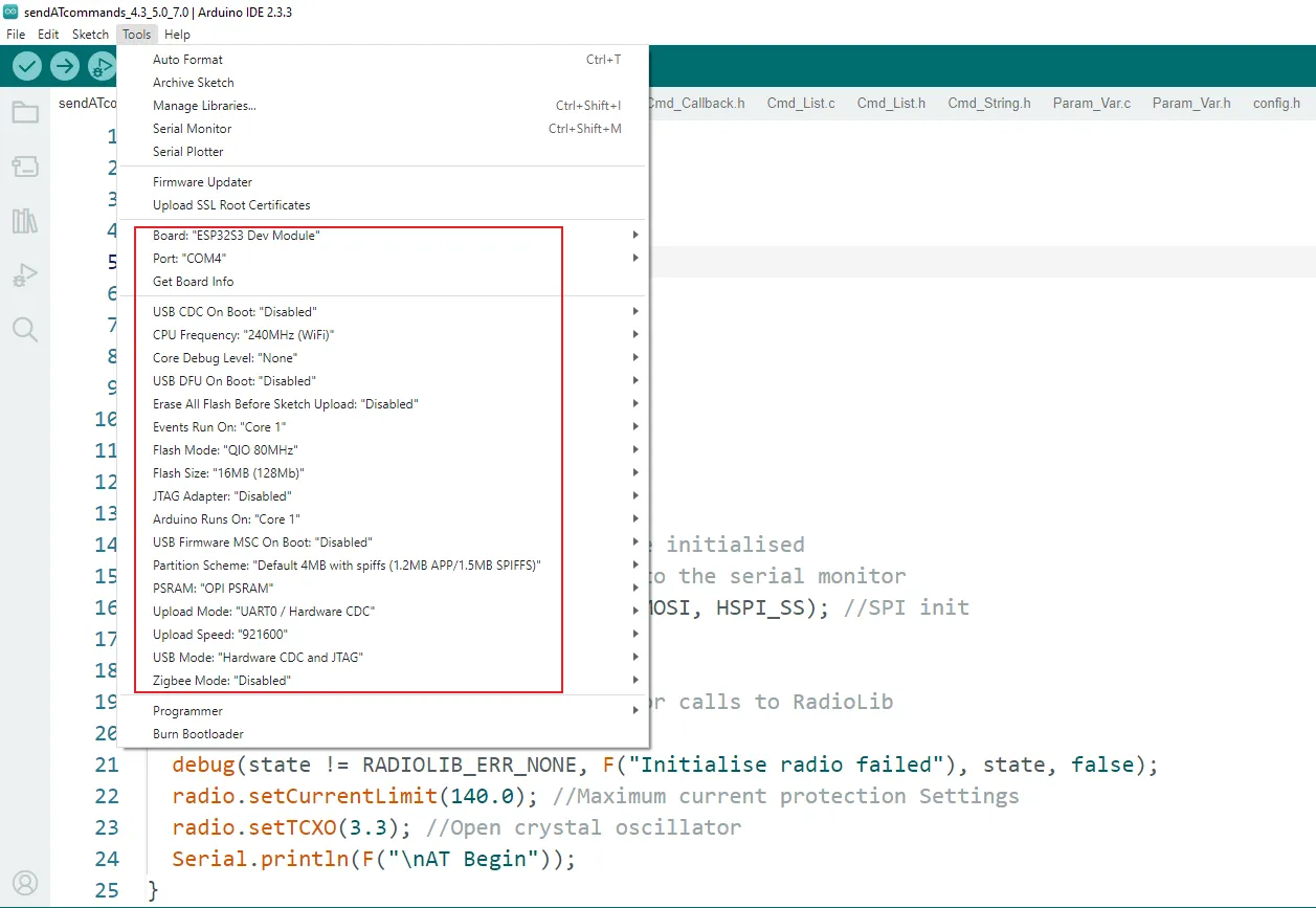

Insert the wireless module into the CrowPanel Advance AI Display, connect it to the computer, and configure the development board.
Click "Upload" and wait for the uploading process to be completed.

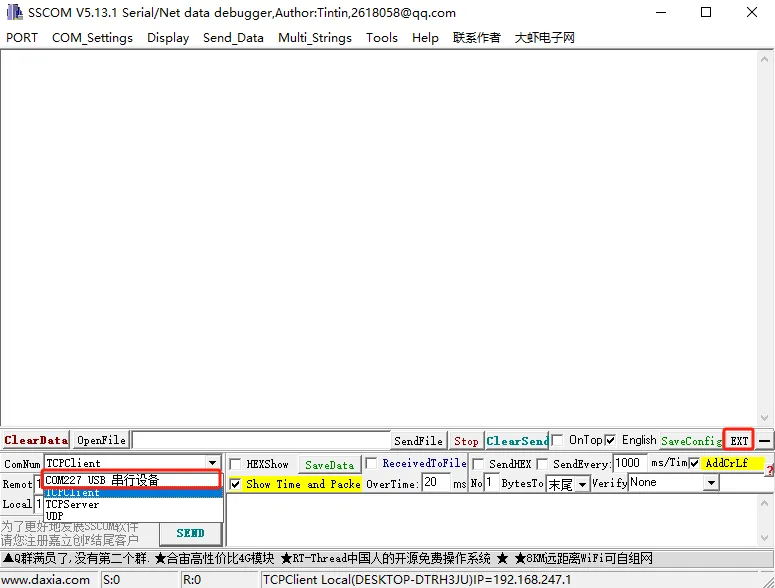

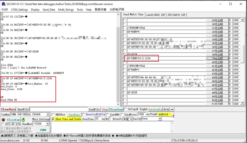

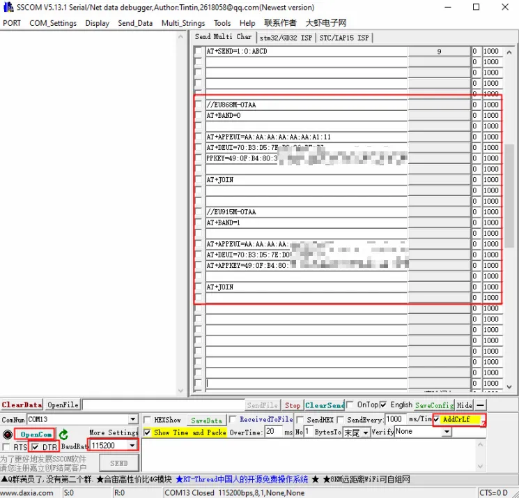

STEP1:Open the SSCOM serial port tool in the serial port assistant. Select the USB COM port recognized by the computer and click "EXT", as shown in the figure below:¶
STEP2:Make the following selections and input AT command information on the extended interface of the serial port assistant:¶
(1)Serial port Settings
1、Baud rate:115200
2、Check the option for adding carriage return and line feed in the serial port.
3、Open the serial port and select "Data Terminal Ready": Click "opencom" and only check the "DTR" option.
(2)Configuration steps for the node to access the single-channel gateway (send AT commands)
1、 Set the network access frequency band of the node: AT+BAND=0. (0 represents the 868 MHz frequency band, 1 represents the 915 MHz frequency band. The node has been configured in the eight-channel mode.)
2、Set the node's DevEui: AT+DEUI=70:B3:D5:7E:D0:06:**** (The red part corresponds to that on the TTN server).
3、Set the node's AppEui: AT+APPEUI=AA:AA:AA:AA:AA:AA:**** (The red part corresponds to that on the TTN server).
4、Set the node's AppKey: AT+APPKEY=49:0F:B4:80:37:F0:5E:6C:5C:B3:24:F5:B5:78:**** (The red part corresponds to that on the TTN server).
Here, you need to replace the DevEui, AppEui, and AppKey with those in the created OTAA node application.

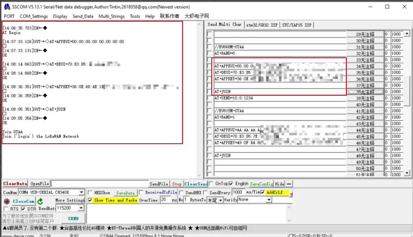

8、Set the node to start joining the network: AT+JOIN. After sending this command, you need to wait for the node to join the network. Only after the node has successfully joined the network can you send the next command, as shown in the following figure: The information printed by the serial port tool after the node has successfully joined the network:
Enter the above AT commands one by one in the extended interface of the serial port assistant. When you enter the "AT+JOIN" command, if the message "Join the LoRaWAN Network" appears, it indicates that the node module has successfully joined the network!
9、Start sending data: AT+SEND=10:0:1234 (Parameter description: The last parameter is the data to be sent, and only an even number of data can be sent).
The commands in the SSCOM serial port tool are as follows:

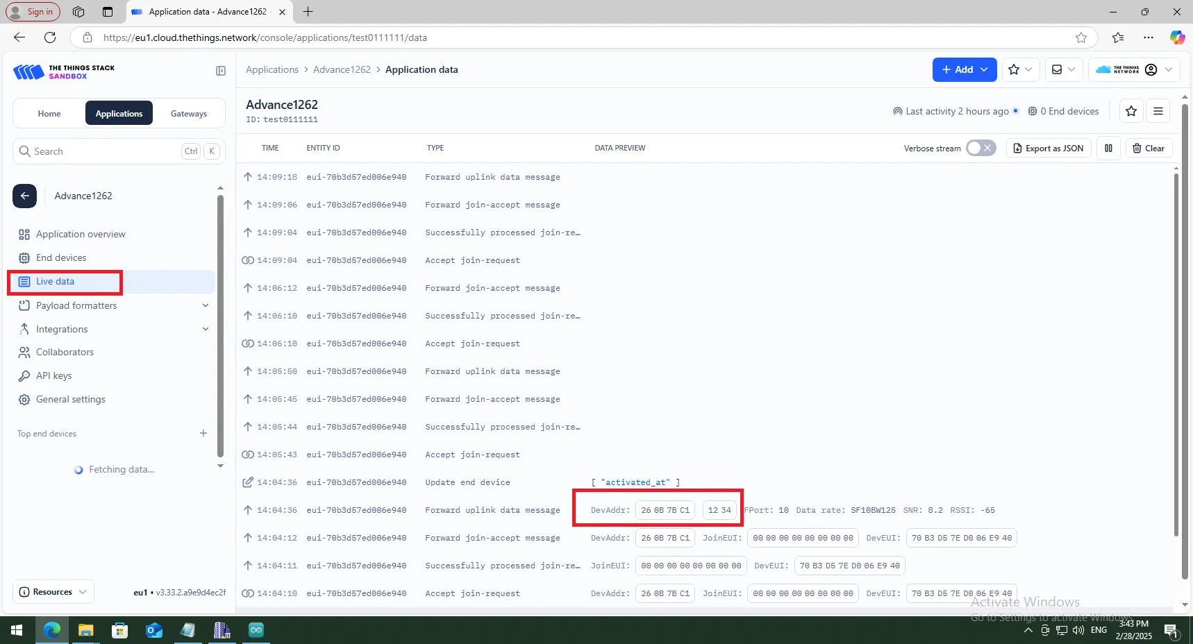

10、After sending data using the "AT+SEND=10:0:1234" command, you can view the data "1234" sent by the node in real - time in the "Applications -> Live data" section of the TTN server background.
