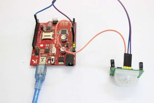

Connect this sensor to your Arduino/Crowduino digital pins( D2 for example). Adjust the RT&CDS to change trigger sensitivity and duration of the trigger signal.Set the module as retriggerable or un- retriggerable with the switch, when the H position, the module is retriggerable and is unretrigerred when the switch is in L position.

1.Copy and paste code below to a new Arduino sketch.
const int PIRPin = 2;// the number of the PIR Motion sensor pin
const int ledPin=13;//The led to indicate the motion
int PIRState = 0; // variable for reading the PIR Motion sensor status
void setup(){
pinMode(PIRPin, INPUT);//Use pin 2 to receive the signal outputted by the module
pinMode(ledPin, OUTPUT);
void loop() {
PIRState=digitalRead(PIRPin);
if(PIRState==HIGH)
digitalWrite(ledPin,HIGH);
else
digitalWrite(ledPin,LOW);
2.Upload the code,When someone moves before the sensor, the led on the arduino board light.
