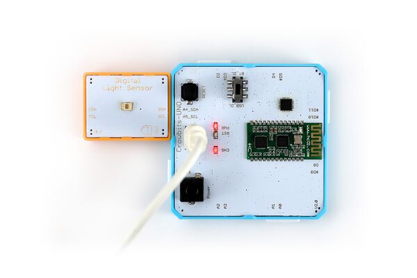

1. You need to prepare a Crowbits motherboard, such as Crowbits-UNO board.
2. Connect the module to the I2C interface on the Crowbits-UNO board, as shown in the figure:
