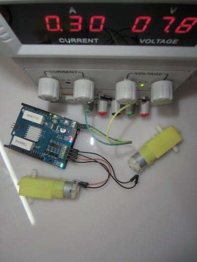

When using the shield to drive motors, sometimes you will want to get the actual drive current, for example, if the DC motors get locked by something, the drive current will get very large, maybe destroy the platform and DC motors. There are 2 current sample resistor on the motor shield, with resistance 0.5 ohm, with these resistor you can easily get the driver curernt.

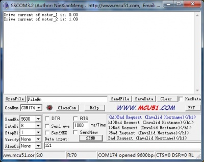

int sensor1= analogRead(A4);
int sensor2= analogRead(A5);
float motor1_current=(float)sensor1/1024*5/0.5;
float motor2_current=(float)sensor2/1024*5/0.5;
Serial.print("Drive current of motor_1 is: ");
Serial.println(motor1_current);
Serial.print("Drive current of motor_2 is: ");
Serial.println(motor2_current);
delay(4000); // wait for 4 seconds

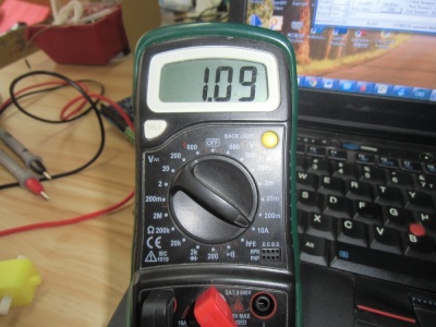

In this program, Arduino get the voltage on Resistors for each channel. And then convert the voltage to current with Ohm's law. The Drive Current measurement would be useful in applications such as tire locking monitoring.
As you see, the Arduino measured current with the sample resistor is very close to the multimeter measured current.
