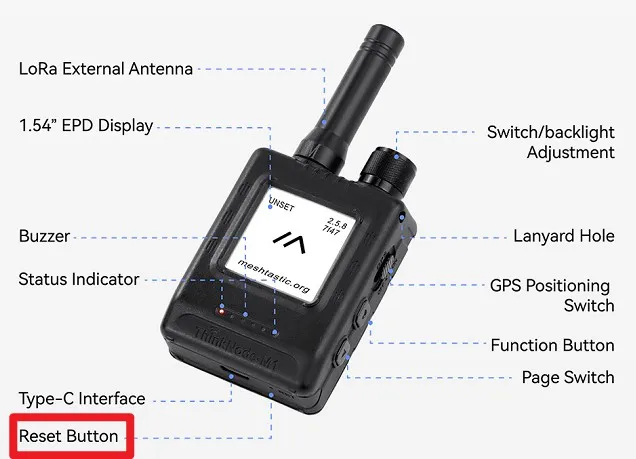

Hardware Overview¶
Switch/backlight Adjustment: You can control the brightness of the front light and realize the on/off function at the same time.
GPS Positioning Switch:GPS on or off.
Function Button: Function keys, click to send ping, double-click to turn on/off the front light; triple-click to trigger/off the buzzer; long-press to enter low-power mode.
Page Switch: Realization of the screen's page flip.
Reset Button: Use the card pin to press to reset, and double-click to enter burn-in mode.
Type-C Interface :Enables charging and firmware burning.
Status Indicator:
Blue light, blinks when buzzer is on (red and blue lights blink alternately).
Red light,red light is always on after power on,red light blinks when charging,always on when full,red light blinks when the battery is low,blinks when the buzzer is on(red and blue light blinks alternately),red light goes out when the power is off/goes into low power consumption.

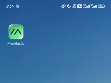

First go to the app store to download and install the Meshtastic APP

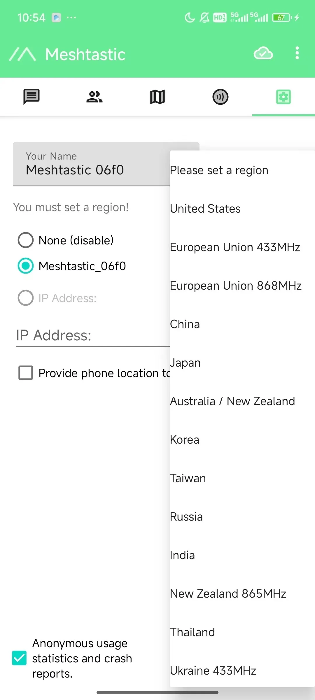

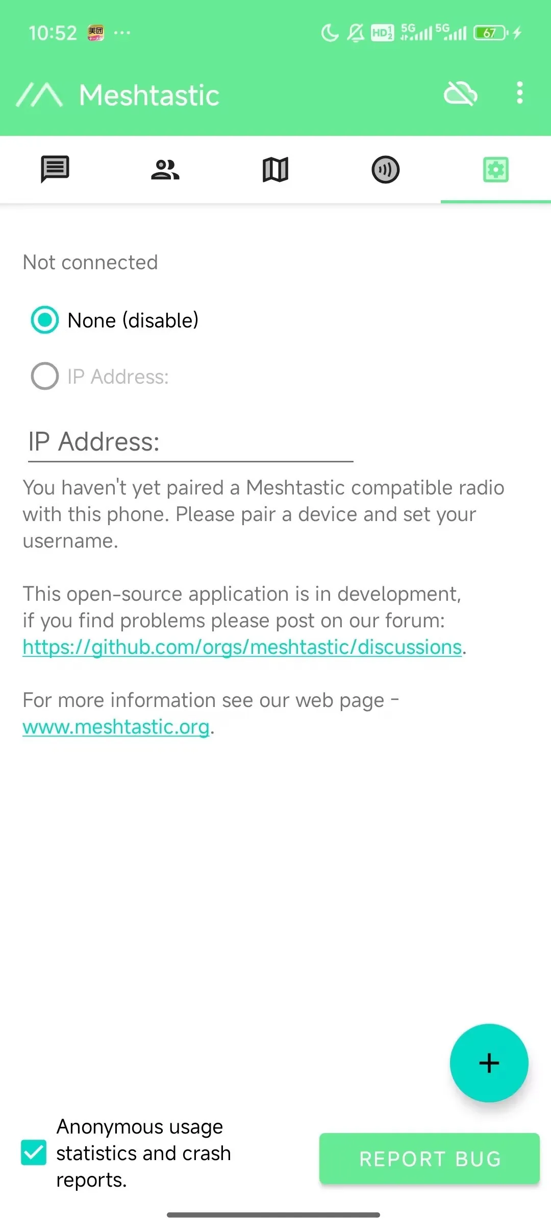

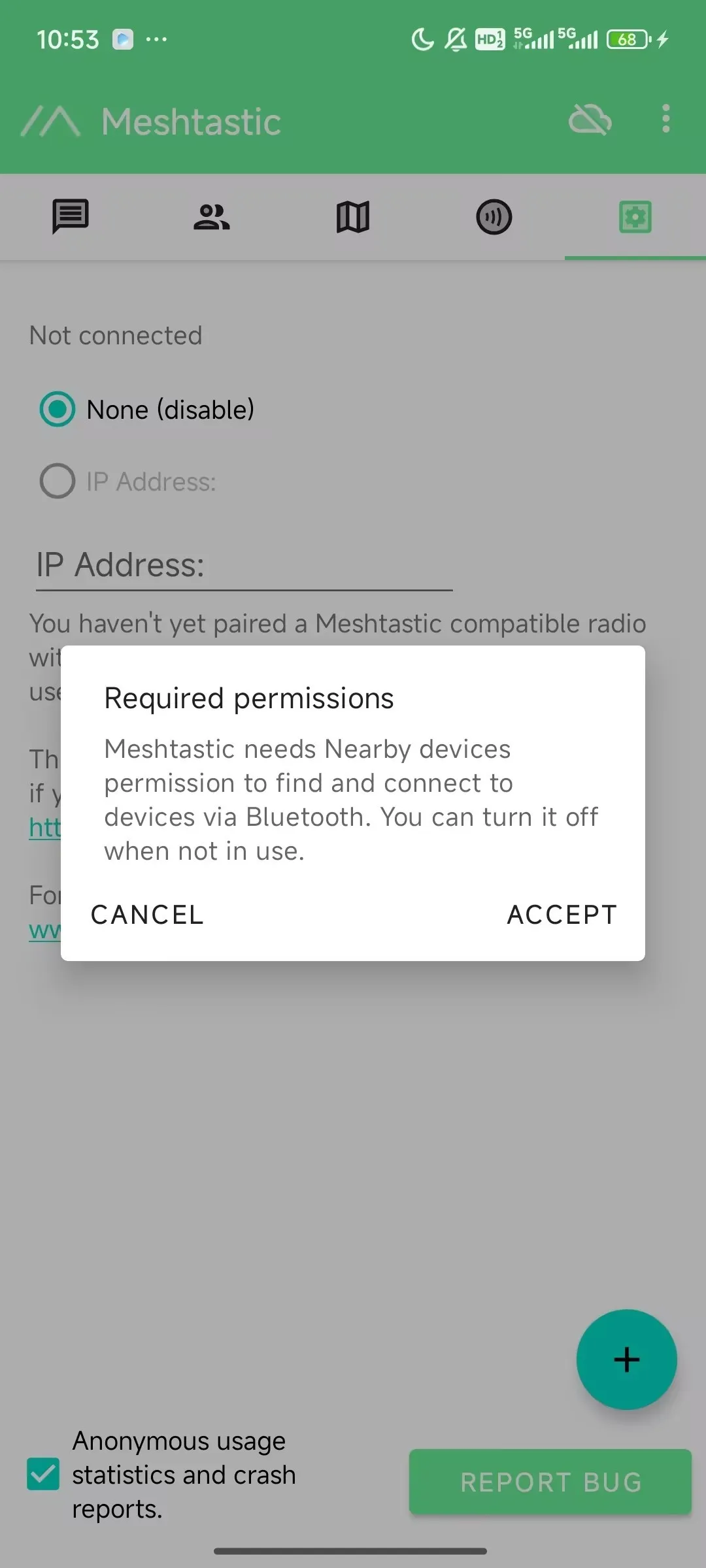

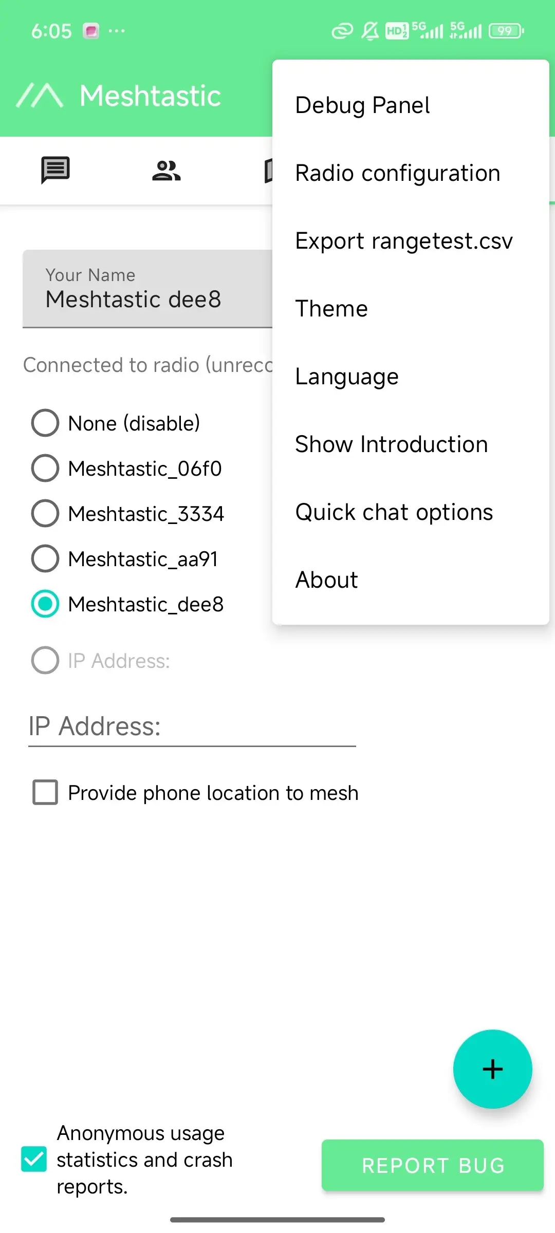

After opening the app, select the top far right and click on Configuration, click on the + in the bottom right corner to find the Meshtastic Bluetooth device.

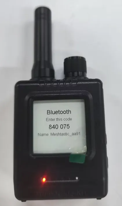

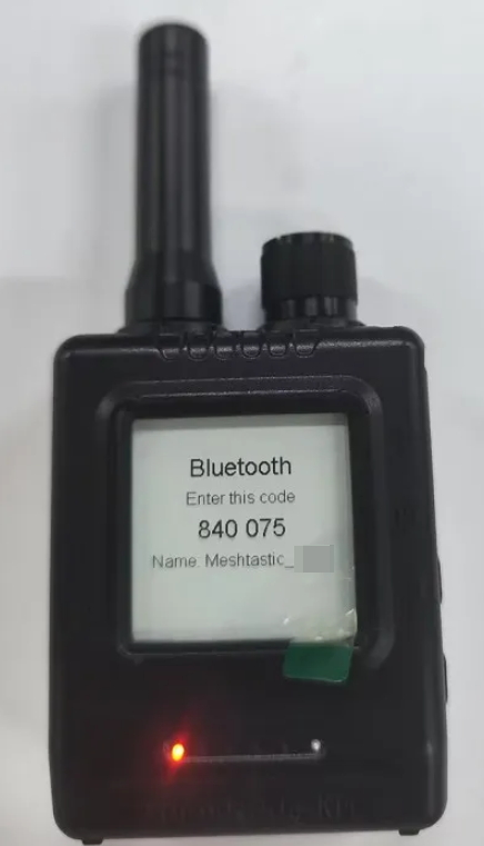

When the Meshtastic_xxxx device is searched, tap to enter pairing mode.
Enter this code on your cell phone

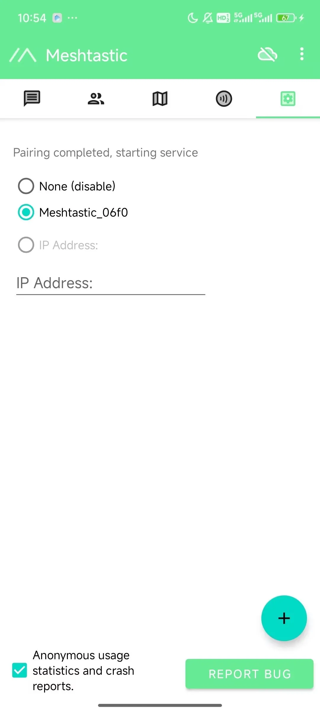

After successful Bluetooth pairing, you need to select a new region at the region again.

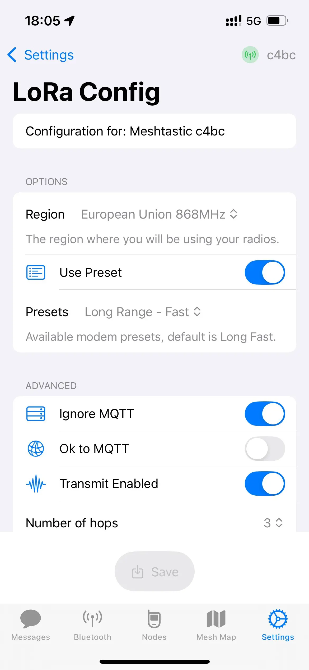

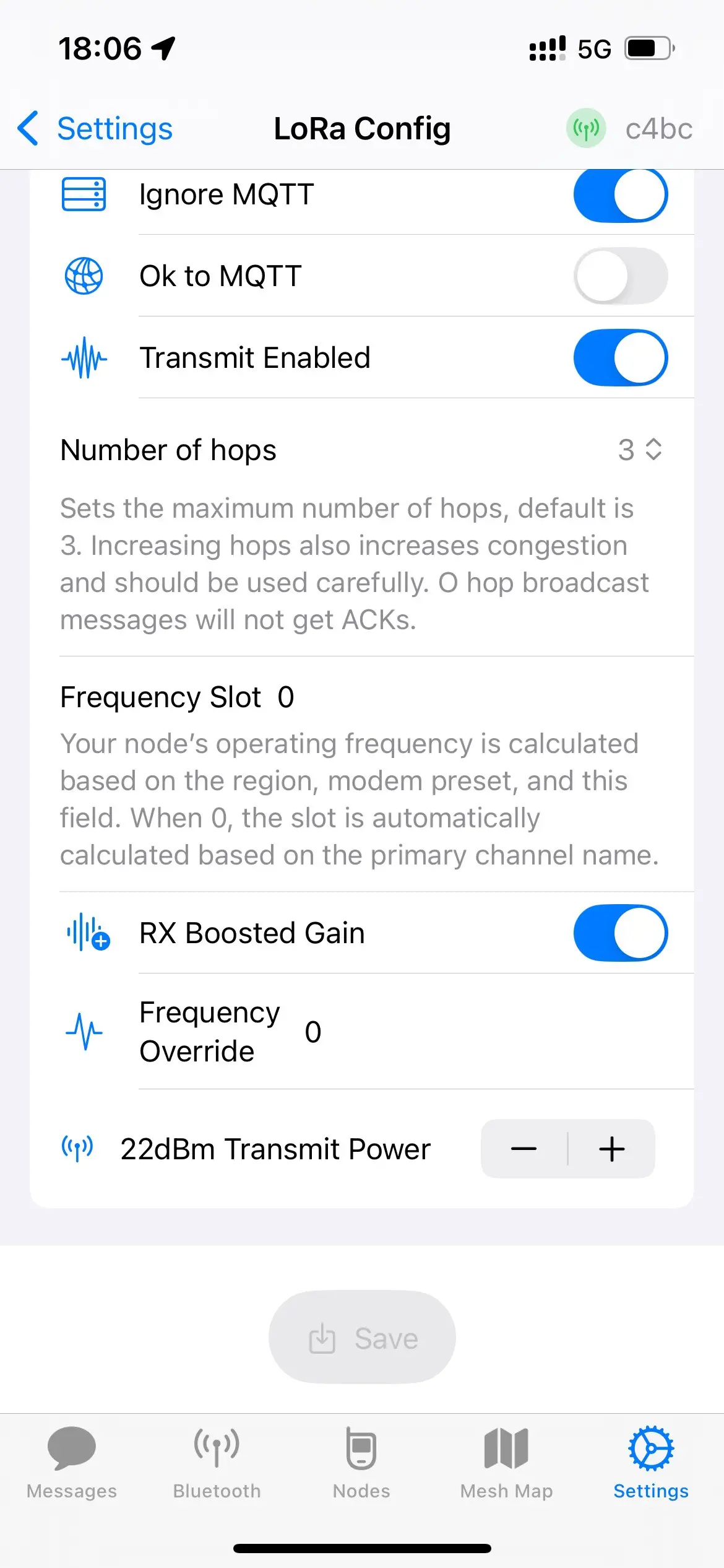

Set lora frequency, click on the upper right corner of the three points, click on “Radio configurtion”, and then click on “Lora”, scroll down to the ‘Add’ column, in the “Override frequency (Mhz)” at the corresponding frequency written.

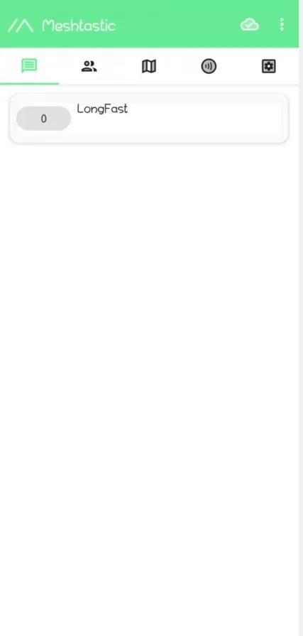

If two devices want to communicate, they need to join to the same channel, this time you need to select the fourth of the five options above, the other end of the phone needs to join to the same channel by scanning the code or entering the link, the channel can be customized name and so on.¶

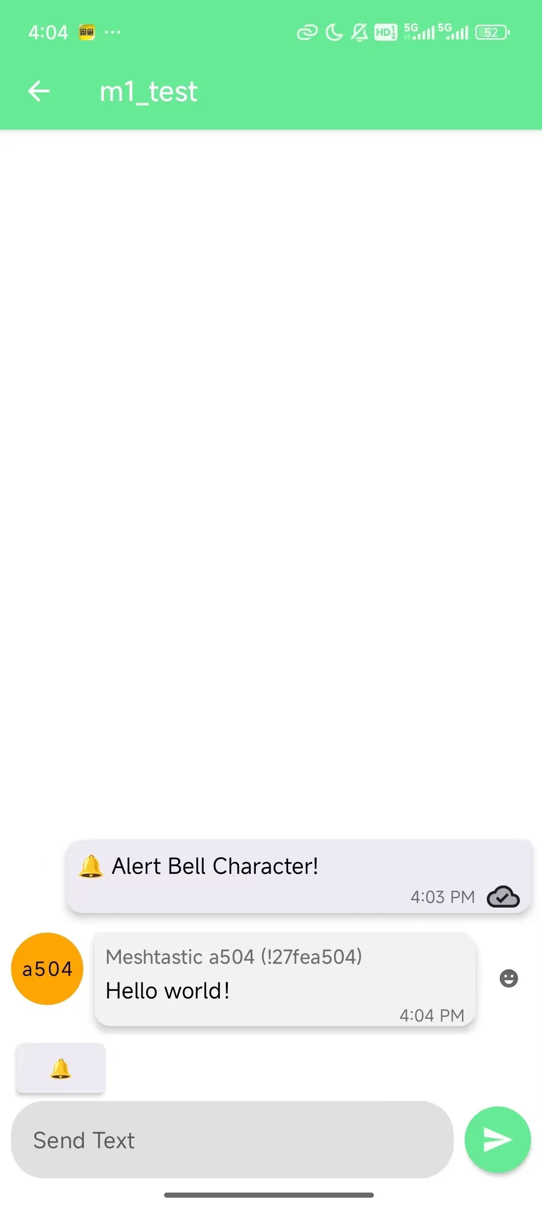

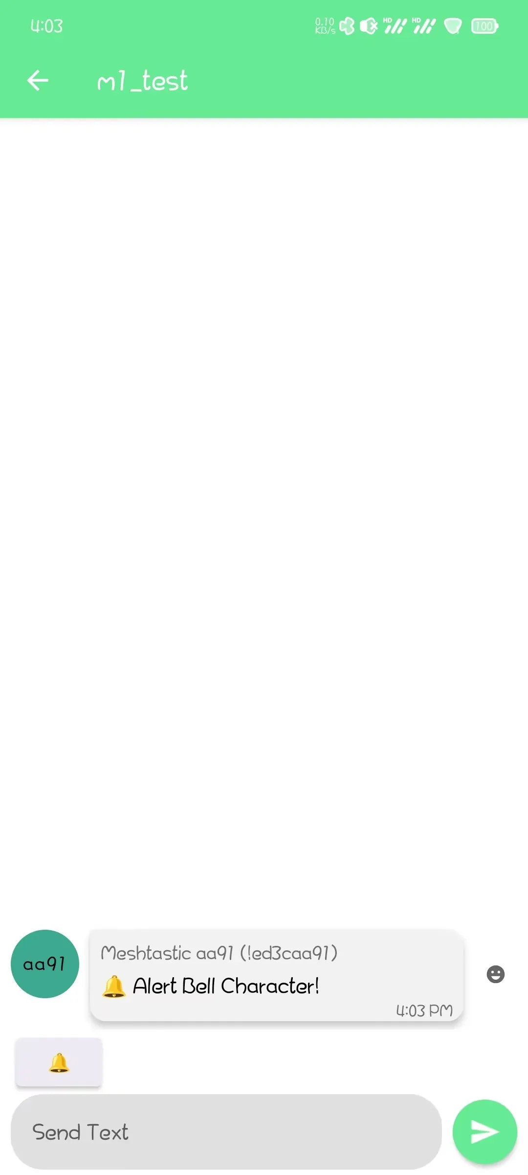

After joining, the two devices can now chat in the first screen by selecting Group Chat.
Mutual Messaging Interface.

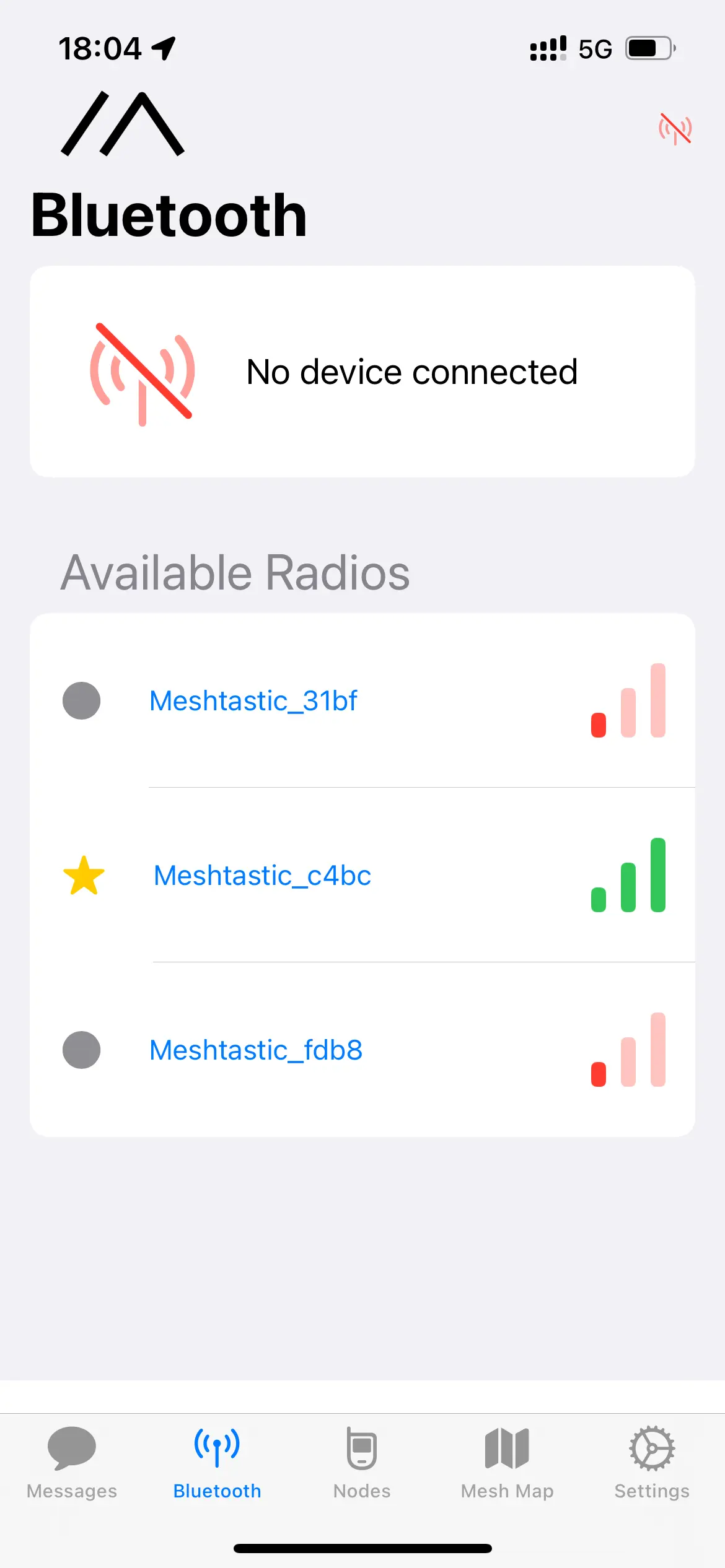

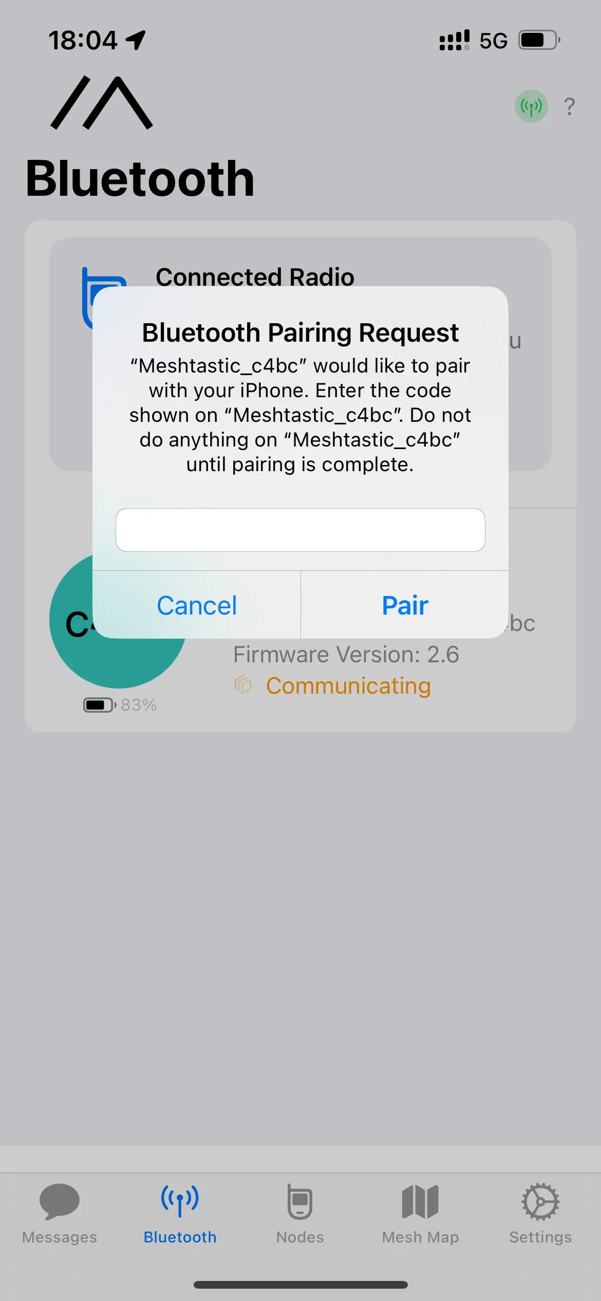

1)Open the app, tap Bluetooth on the home page and see the device you want to connect. Click on Pairing.
2)When the Meshtastic_xxxx device is searched, tap to enter pairing mode.

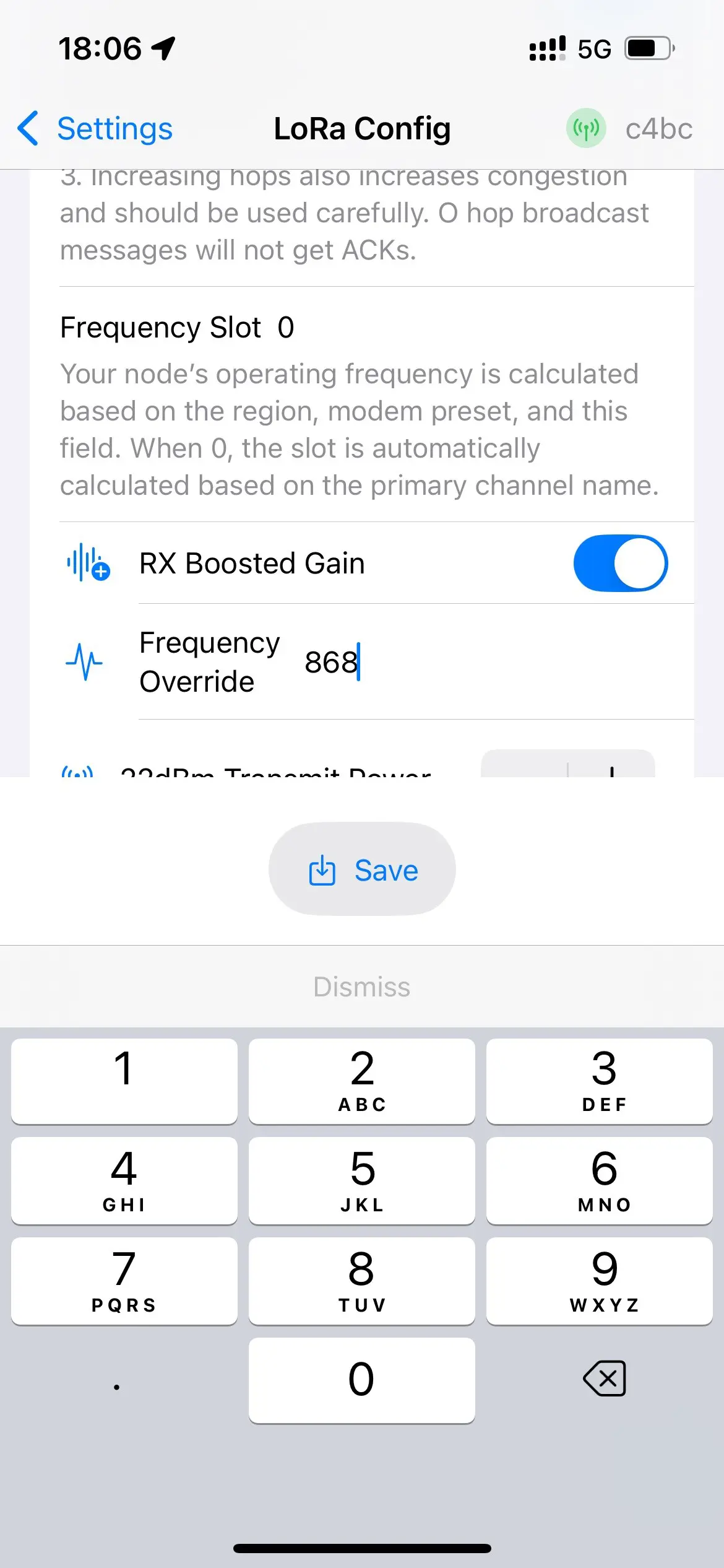

3)After successful Bluetooth pairing, You need to go to Settings and click on Lora Settings.
4) Set lora Region. and then scroll down to set the frequency. consistent with the previous settings for the region. Finally, check ignore MQTT and save.

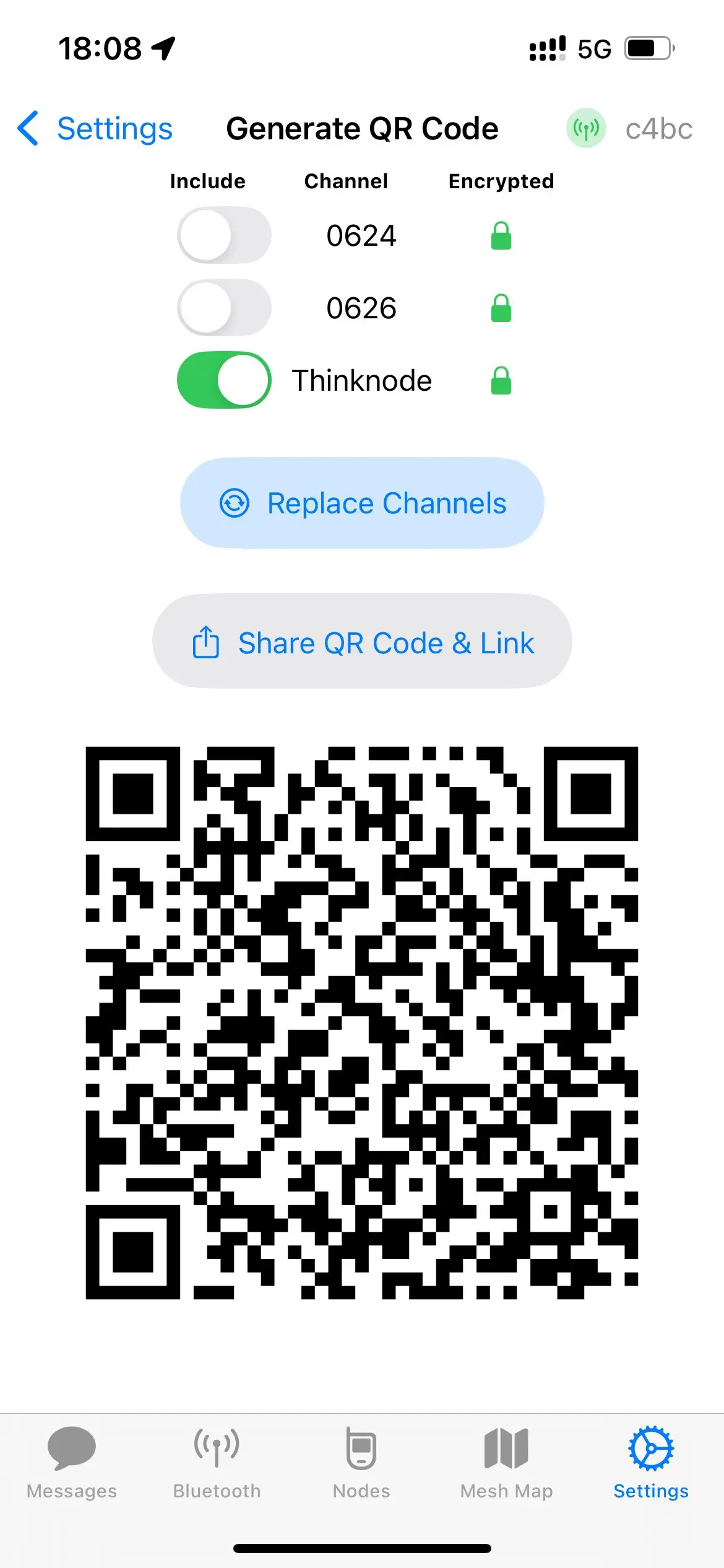

5)Go to the information page, select a channel and a QR code will appear, use another device to scan this QR code to enter.

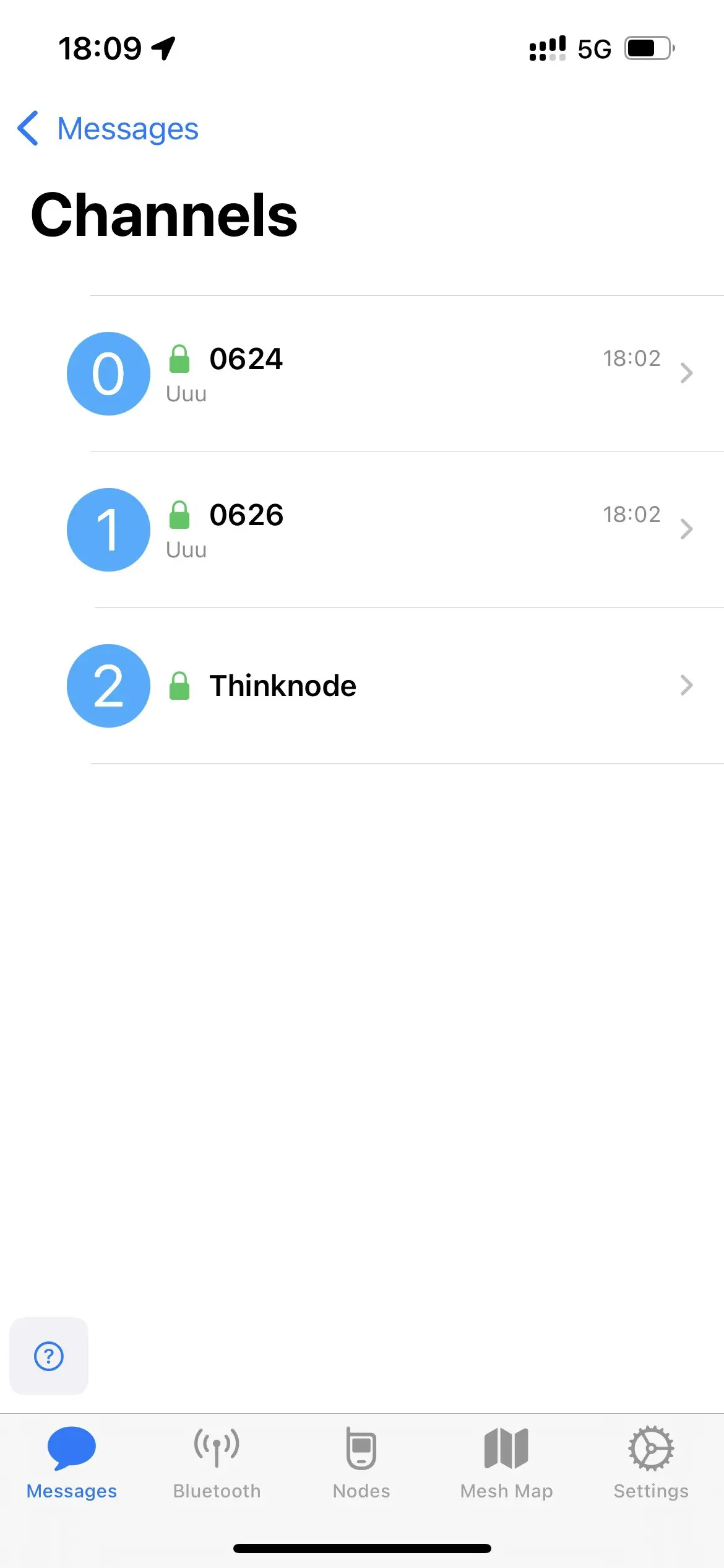

6)Join and start sending or receiving messages.

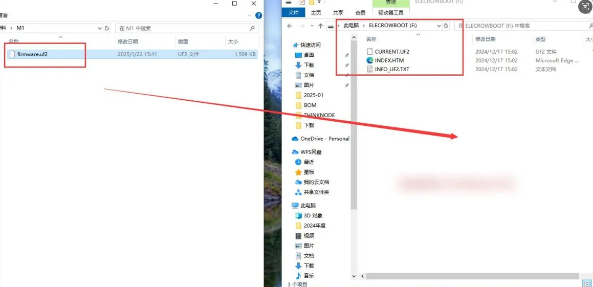

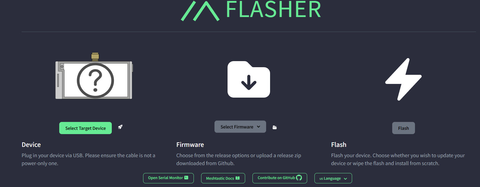

Burning Firmware¶
ClickMeshtastic firmware
1,Select the corresponding firmware.
2, follow the steps to download the firmware.
