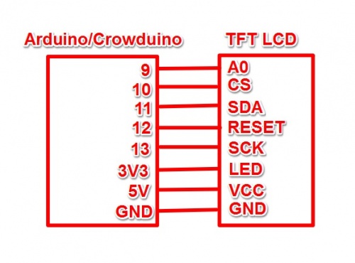

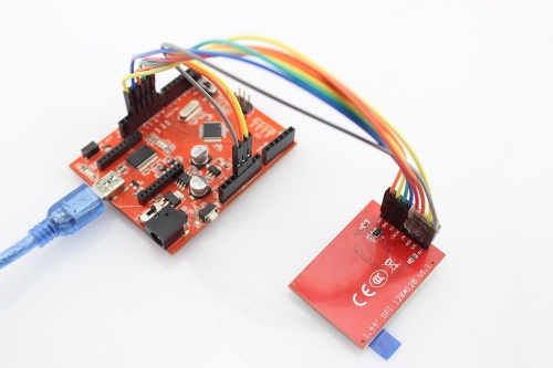

1.Hardware connection
2.Connect the board to PC using USB cable.

// All wiring required, only 3 defines for hardware SPI on 328P
#define __DC 9
#define __CS 10
// MOSI --> (SDA) --> D11
#define __RST 12
// SCLK --> (SCK) --> D13

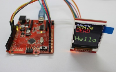

unsigned long testText() {
  tft.fillScreen();
  unsigned long start = micros();
  tft.setCursor(0, 0);
  tft.setTextColor(WHITE);
  tft.setTextSize(1);
  tft.println("Hello World!");
  tft.setTextColor(YELLOW);
  tft.setTextSize(2);
  tft.println(1234.56);
  tft.setTextColor(RED);
  tft.setTextSize(3);
  tft.println(0xDEAD, HEX);
  tft.println();
  tft.setTextColor(GREEN);
  tft.setTextSize(4);
  tft.println("Hello");
  return micros() - start;

5.Upload the Code,you shoule see the display of LCD.
