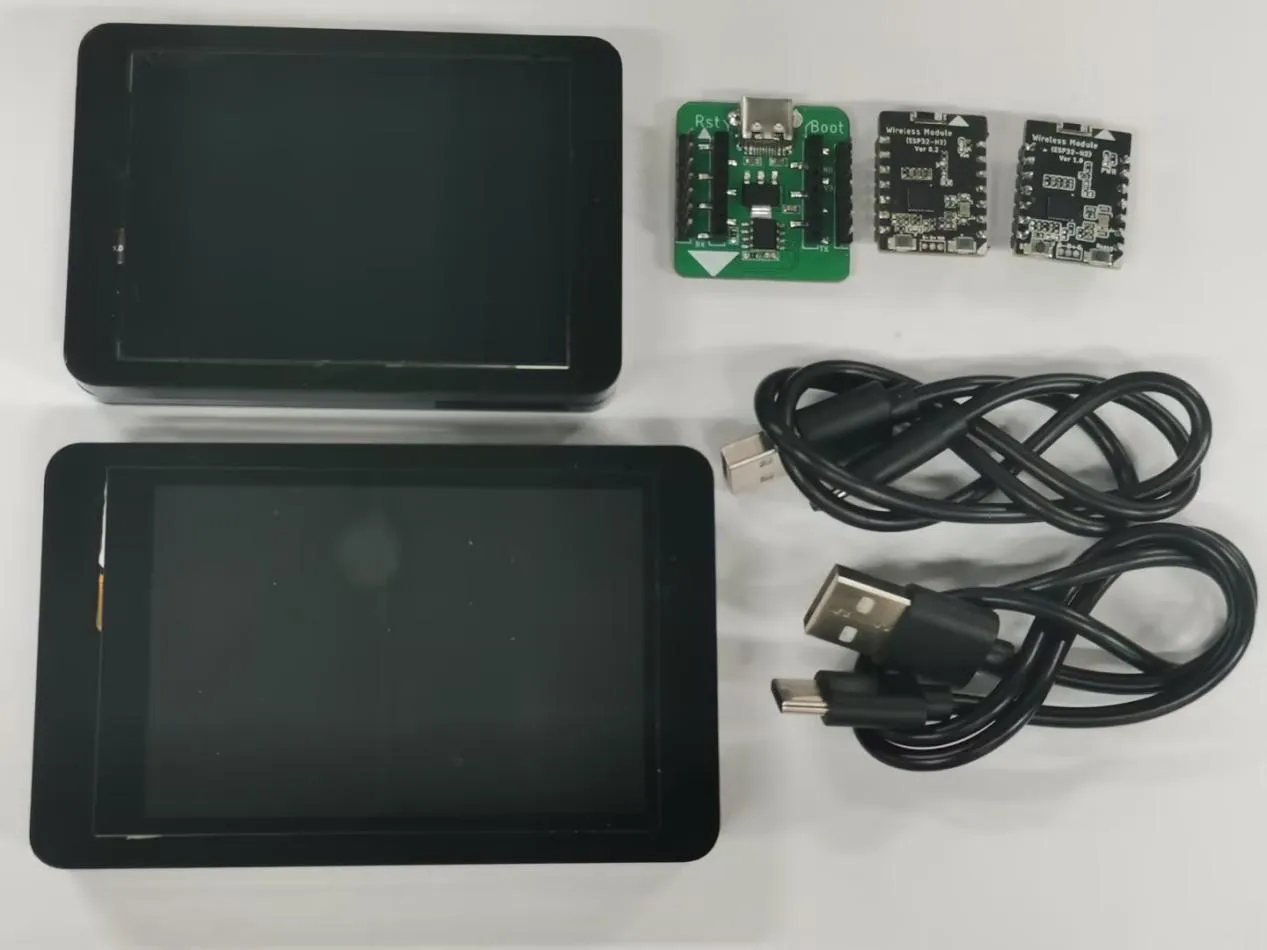

Two CrowPanel Advance HMI ESP32 AI Displays
Two ESP32-H2 modules
One of the ESP32 - H2 modules is configured as a ZigBee coordinator. As the core of the network, it is responsible for starting and managing the entire ZigBee network.
The other ESP32 - H2 module is configured as a ZigBee end device. It is used for data collection or performing control tasks, such as temperature and humidity sensor nodes, smart switch nodes, etc.
Programmer: It is used for burning the code into the ESP32-H2 module.
Two TYPE-C data cables

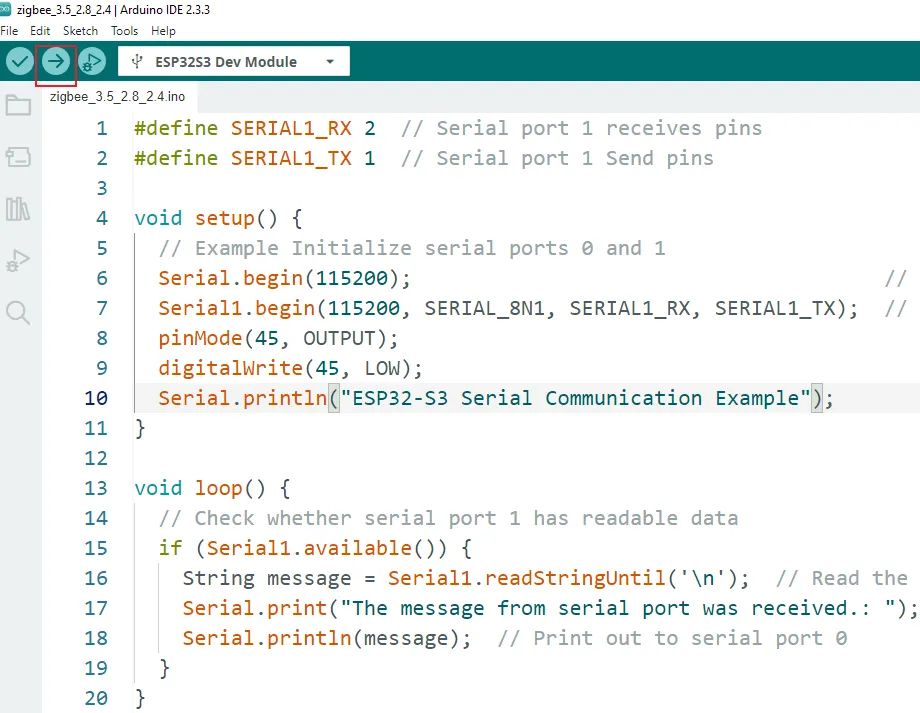

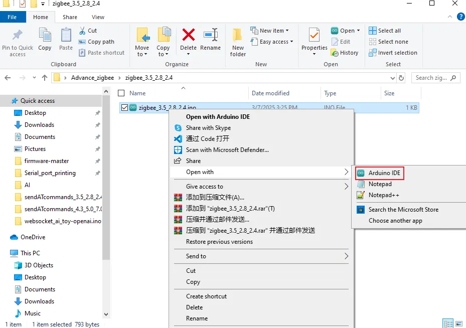

Open the folder that comes with this lesson. Right-click and use Arduino to open the code corresponding to the development board's model. The function of this code is to enable serial communication between the HMI Advance AI Display and the ESP32 - H2 module.
Note: In this lesson, we'll use the small-sized development board as an example. The operation process for the large-sized one is the same, except that you need to set the function select keys to 01.¶
Connect the Advance development board to the PC.

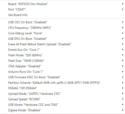

Select the corresponding hardware configuration.
Click "Burn" and wait for the burning process to complete.

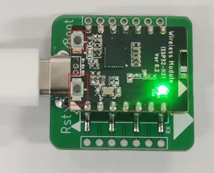

Insert the ESP32-H2 module into the programmer, and connect the programmer to the computer.
First, press the boot key, then briefly press the reset key, and finally release the boot key to make the module enter the waiting-for-burning mode.

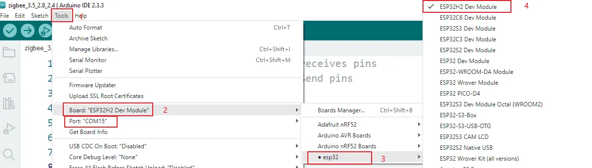

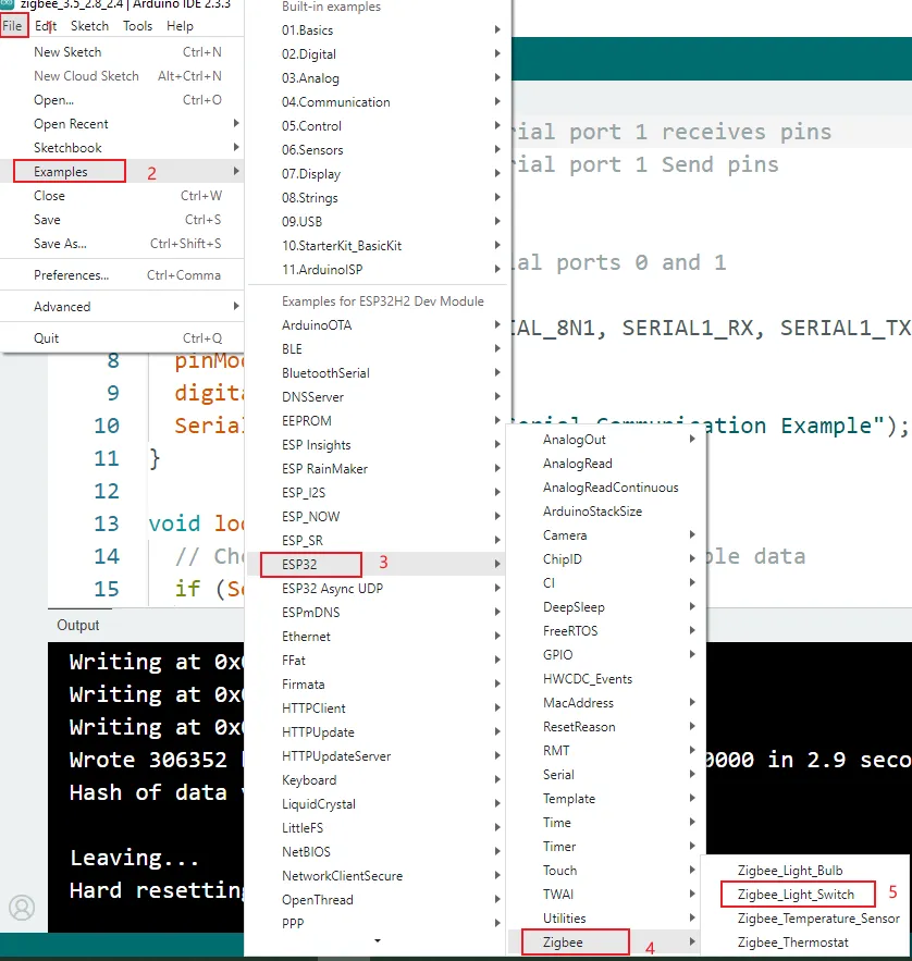

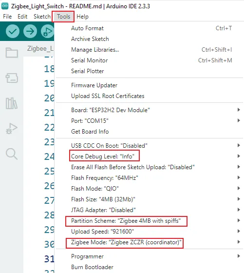

Open Arduino and select the corresponding development board (ESP32-H2 Dev Module) and the corresponding port.

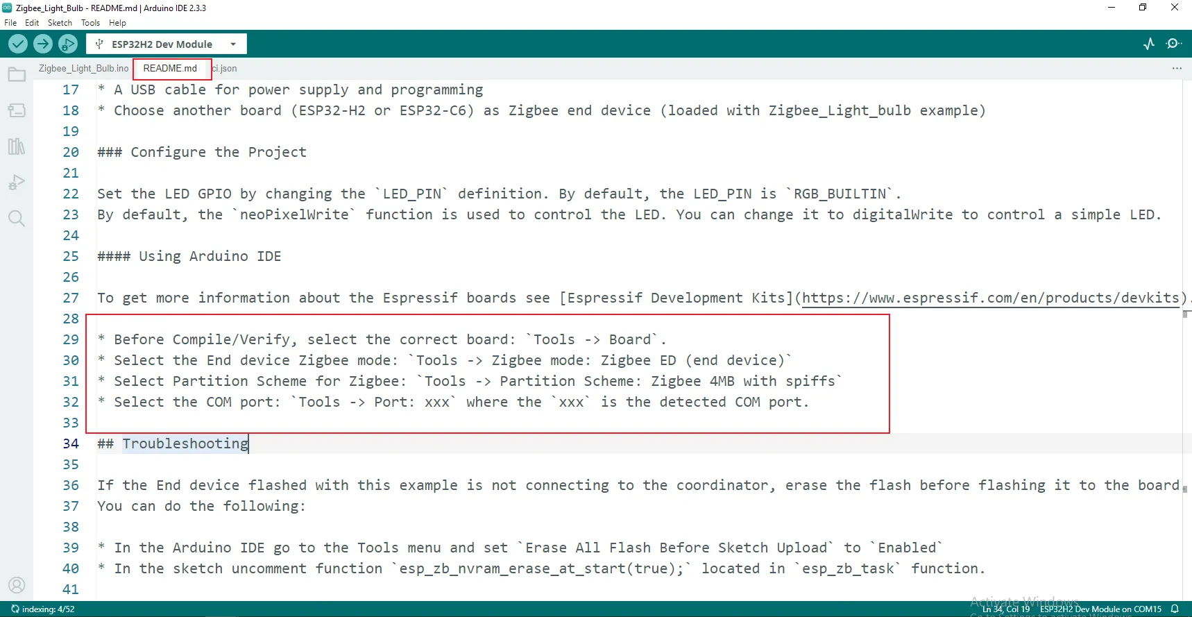

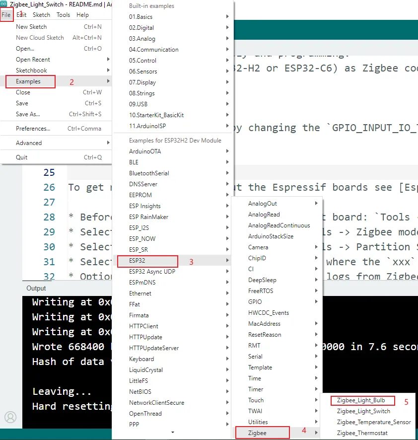

Open the official sample routine that comes with the development board.

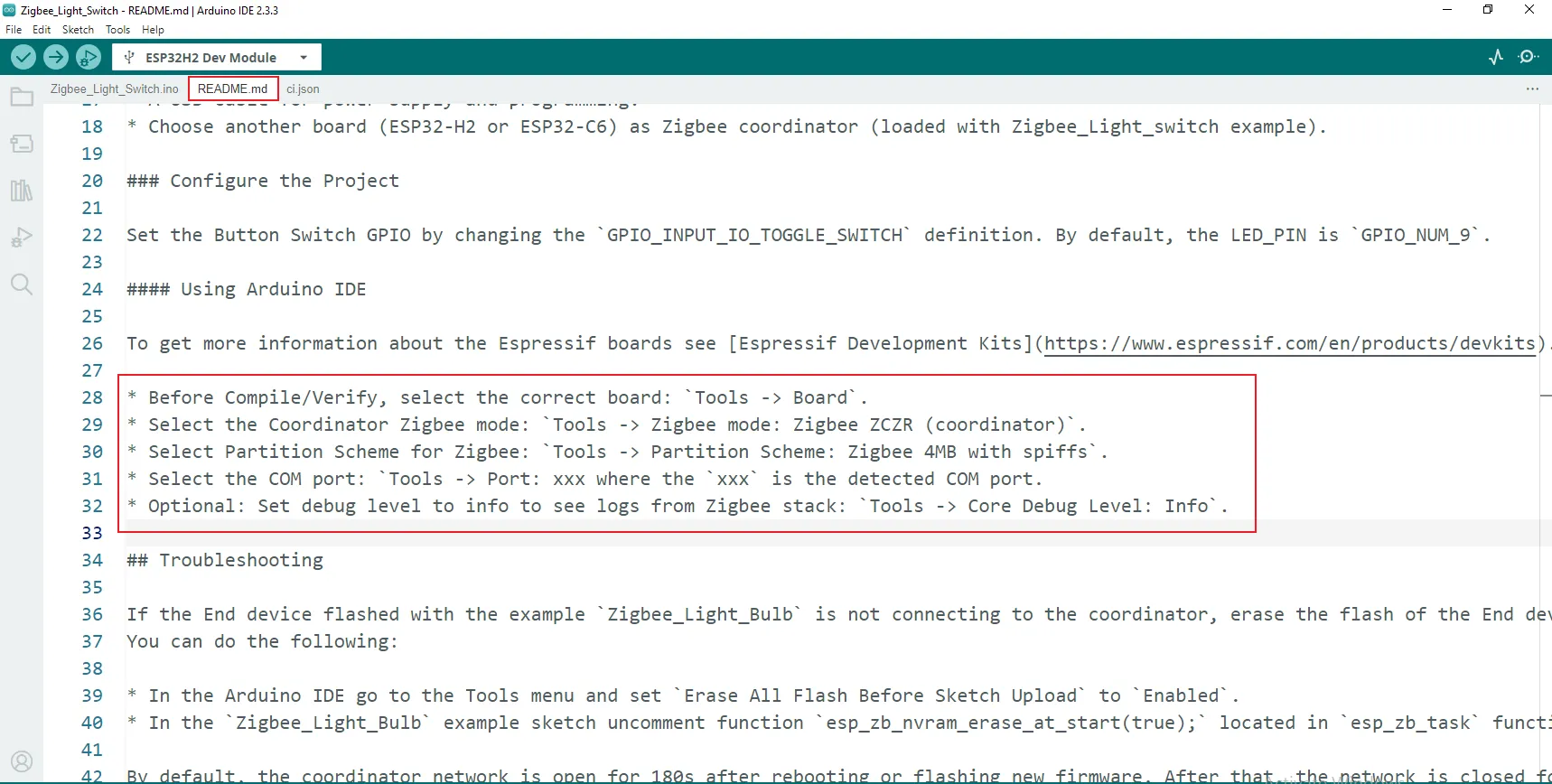

Configure the development board options according to the comments in the code.

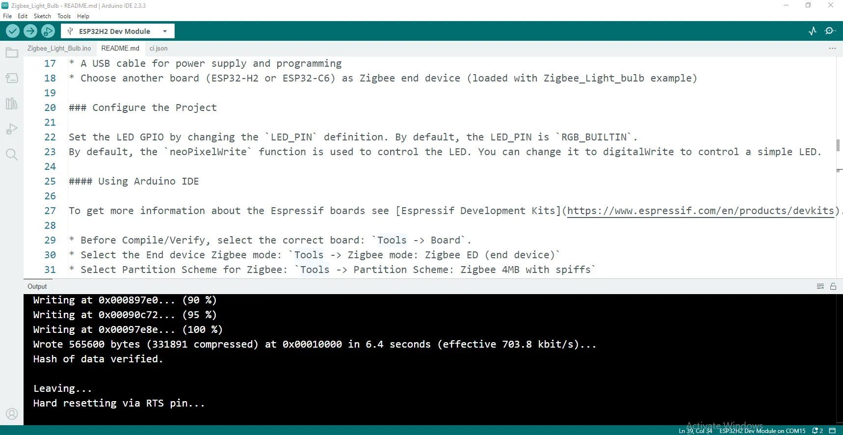

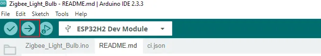

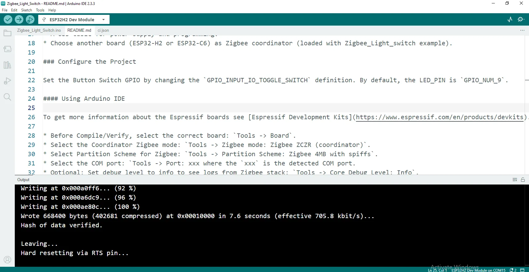

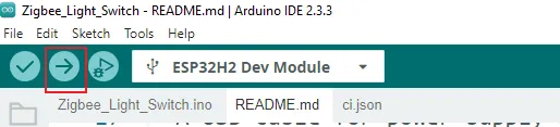

Click "Burn" and wait until the burning process is completed.

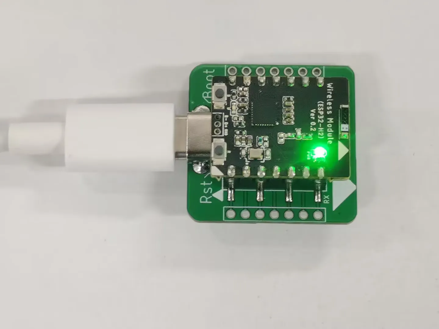

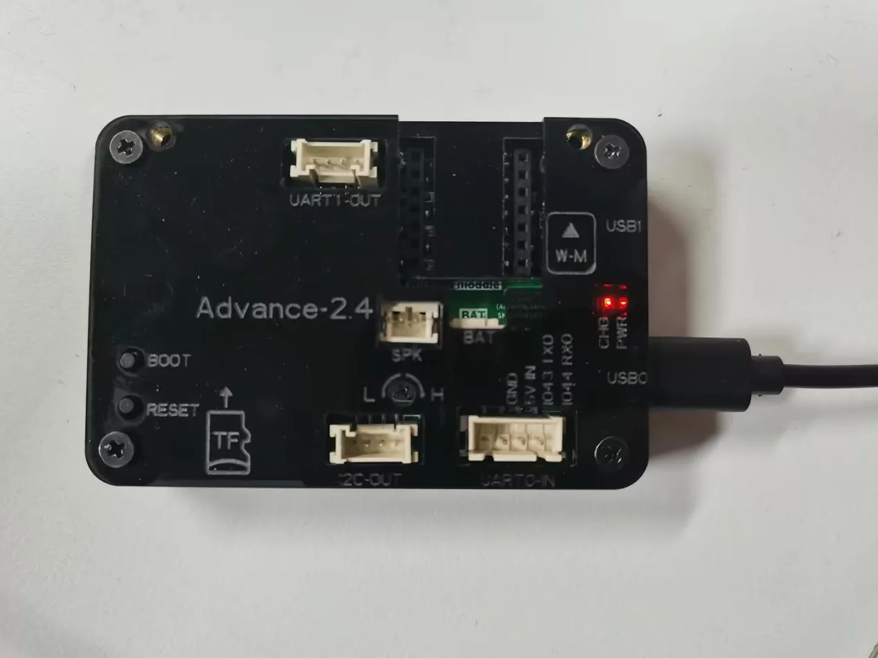

Hardware connection: Insert the ESP32-H2 module into the wireless module of the HMI Advance AI Display. Then, connect the HMI Advance AI Display to the computer. After that, you can see the serial - port printing information of the HMI Advance AI Display. At this time, the coordinator will start the ZigBee network according to the burned program and wait for the terminal devices to join.

Open Arduino, and select the corresponding development board (ESP32H2 Dev Module) and the corresponding port.
Open the official example program that comes with the development board.
Click the "Burn" button and wait for the burning process to finish.
Insert the ESP32-H2 module into the wireless module of another HMI Advance AI Display. Connect the HMI Advance AI Display to the computer.

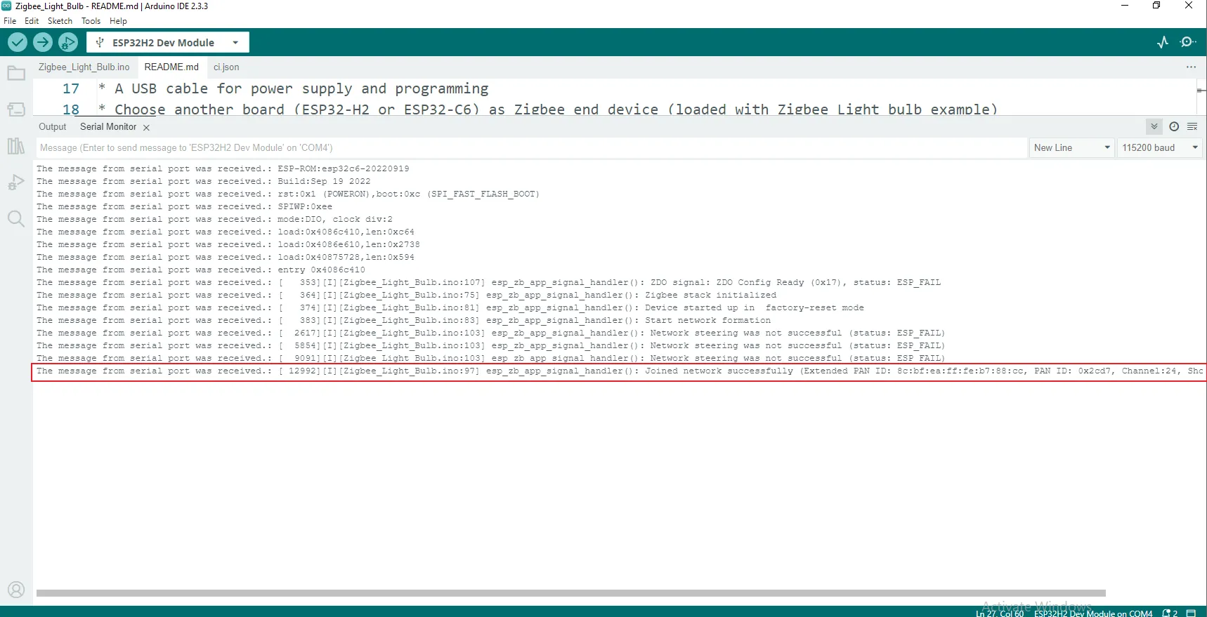

You can view the serial port printing information of the HMI Advance AI Display. After relevant configurations are completed and meeting the specific conditions, at this moment, the terminal device automatically joins the ZigBee network.

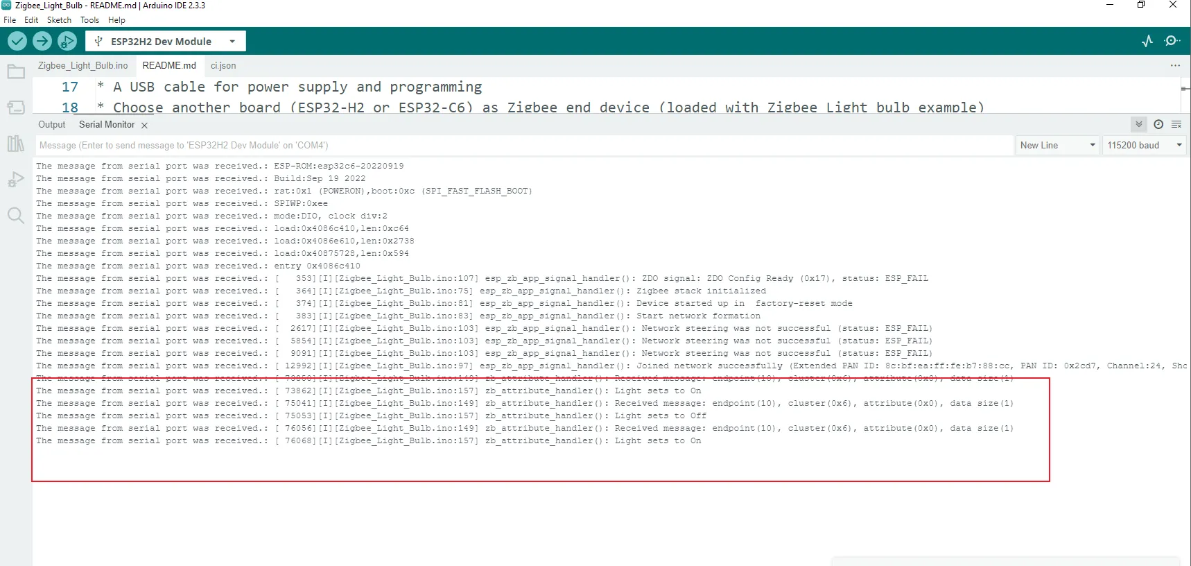

If the boot key of the coordinator is pressed, due to the pre - set program logic, the terminal will print out "turn on the light" or "turn off the light". At the same time, the terminal can also drive the light bulb connected to the terminal device to turn on or off.
