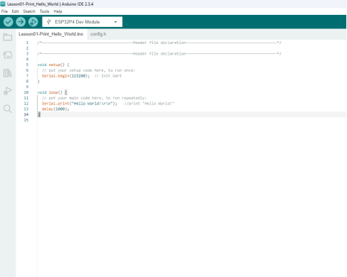

After the installation is completed, open the Arduino IDE.
First, randomly open a project.

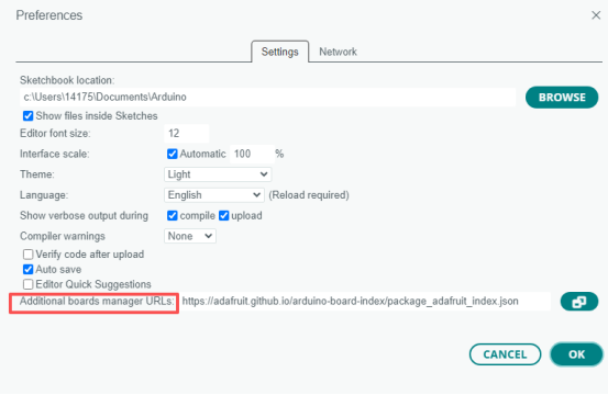

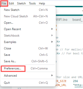

Go to "Preferences".
70_image_02

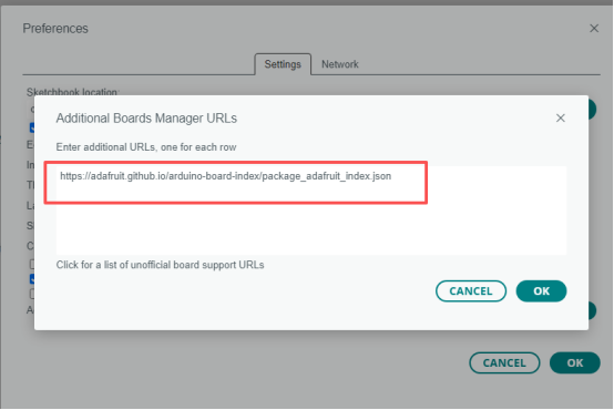

Configure "Additional Boards Manager URLs"
70_image_03
Add this in.
https://adafruit.github.io/arduino-board-index/package_adafruit_index.json

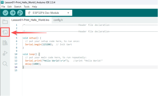

70_image_04
First, click on "board manage" on the left side.
70_image_05

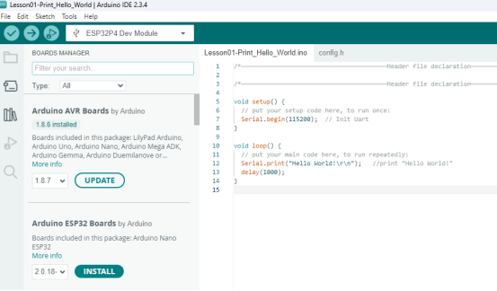

After opening
70_image_06
Search for ESP32 and download it (the version we were using for development at the time was 3.0.2)

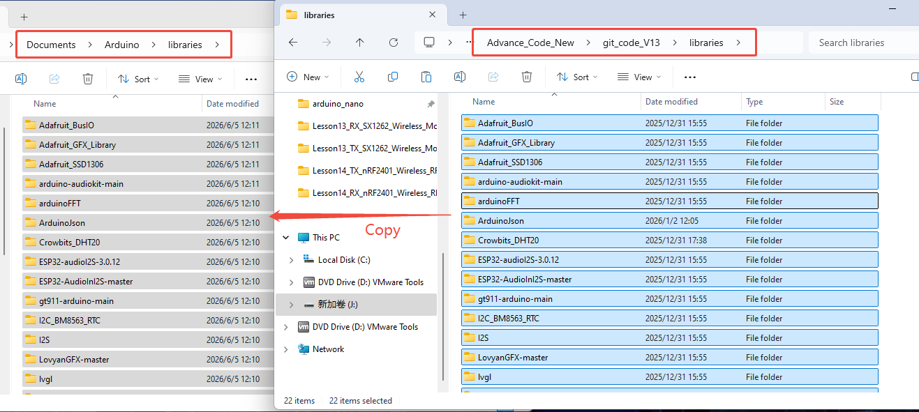

Before getting started, we first need to download the library files required by the development board and place them in the corresponding C/Users/your-username/Documents/Arduino/libraries directory on your computer. You can find the location of your Arduino workspace by navigating to File → Preferences in Arduino IDE, as shown below.
Download link:
CrowPanel-Advance-7-HMI-ESP32-S3-AI-Powered-IPS-Touch-Screen-800x480/example/V1.3_and_V1.4_and_V1.5/arduino/libraries at master · Elecrow-RD/CrowPanel-Advance-7-HMI-ESP32-S3-AI-Powered-IPS-Touch-Screen-800x480
Enter this path and check the location where the library files are stored.
70_image_07
70_image_08
After determining the location where the library files are stored
Copy all the library files contained in the downloaded "libraries" file to the "C:\Users\Username\Documents\Arduino\libraries" folder on your local computer.
For example, the operation shown in the figure:
70_image_09
Note: If there is no "libraries" folder in your path, please create one yourself.
