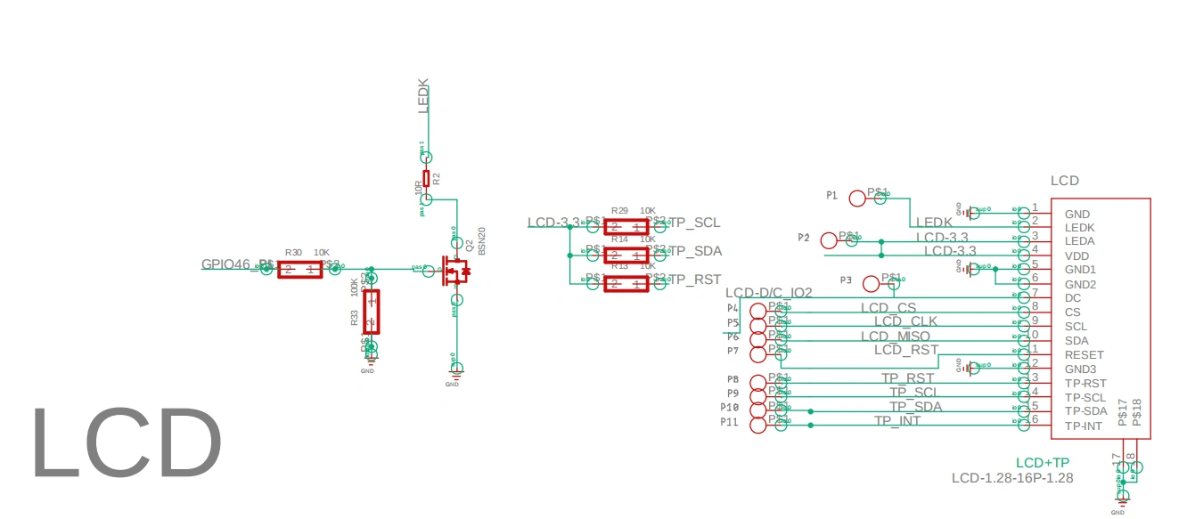

Schematic Diagram:¶
ESP32-S3 with display and touch schematic diagram
Schematic Diagram:

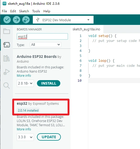

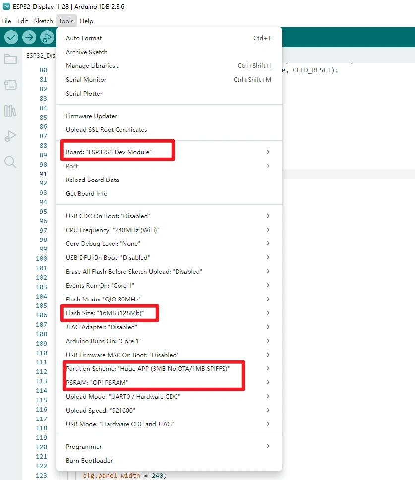

Get Started with Arduino IDE¶
Please note that the version of esp32 supported by the sample code provided with this product is 2.0.14.

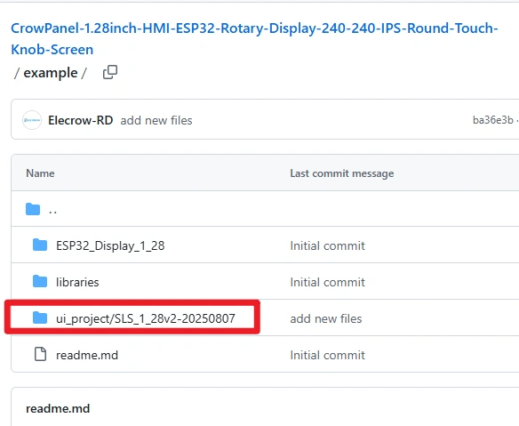

UI engineering files and code resources currently available on GitHub:¶
CrowPanel-1.28inch-HMI-ESP32-Rotary-Display-240-240-IPS-Round-Touch-Knob-Screen

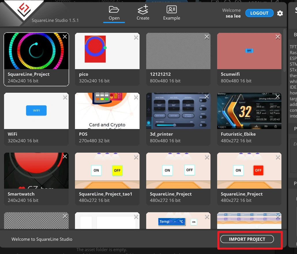

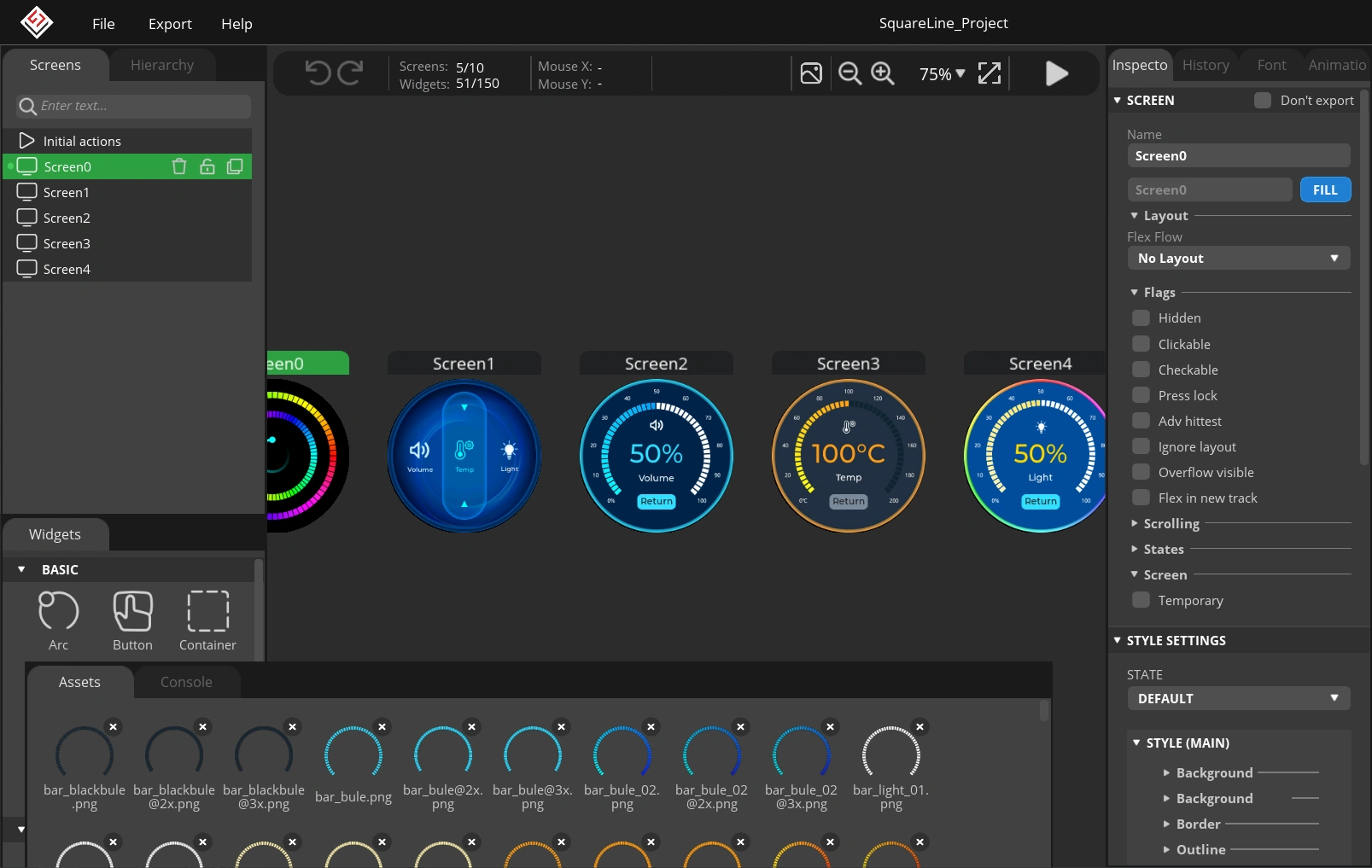

Importing UI projects using SquareLine Studio:¶
Click “Import Project” in the lower right corner to import the UI project we provided.
After importing, the project will appear in the list. Double-click to open the factory.

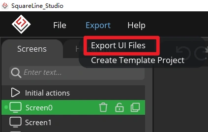

You can directly export UI files, use the UI files we provide, or modify the UI project yourself to customize your settings.

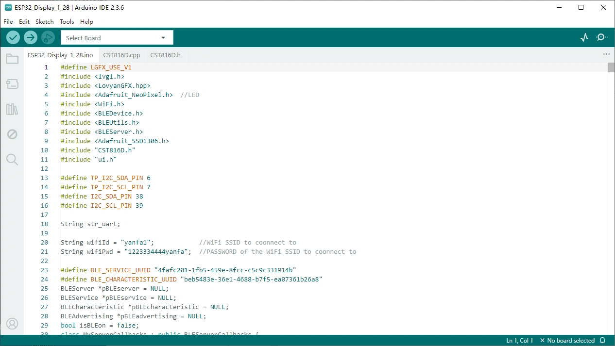

Main program introduction section¶

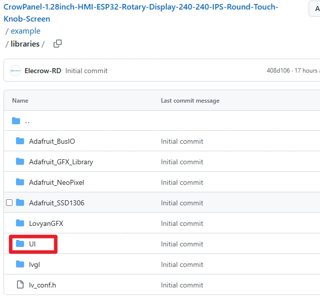

Click on the GitHub link
to download the code, and use Arduino to open.
to download the library and UI files we provide, and place these files in the libraries folder..

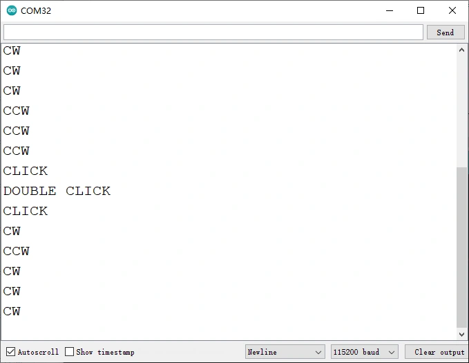

④User Interaction Flow¶
Main Interface Operations¶
Rotate to Select: Rotate the encoder on the main interface to select a function (volume/temperature/brightness).
void encTask(void *pvParameters) {
while (1) {
// Read the current state of CLK
currentStateCLK = digitalRead(ENCODER_A_PIN);
// If last and current state of CLK are different, then pulse occurred
// React to only 1 state change to avoid double count
if (currentStateCLK != lastStateCLK && currentStateCLK == 1) {
current_screen = lv_scr_act();
// If the DT state is different than the CLK state then
// the encoder is rotating CCW so decrement
if (digitalRead(ENCODER_B_PIN) != currentStateCLK) {
if (abs(last_counter - counter) > 10) {
continue;
position_tmp = 1;
} else {
position_tmp = 0;
counter--;
currentDir = "CW";
processEncoder();
// Remember last CLK state
lastStateCLK = currentStateCLK;
Single Click to Enter: Click the button to enter the corresponding function interface

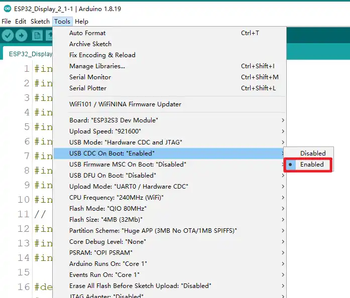

After completing the installation of the ESP32 board according to "Get Started with Arduino IDE" and the installation of the library according to "Install Libraries", open the program and connect the CrowPanel 1.28inch-HMI ESP32 Rotary Display to the computer via a USB-C cable.
Select Board: click "Tools" -> "Board" -> "esp32" and select "ESP32S3 Dev Module",Under the "Tools" menu, see "Flash Size" select 16MB(128Mb); "Partition scheme" and select "Huge APP(3MB No OTA/1MB SPIFFS)"; "PSRAM" select "OPI PSRAM"
Note: The factory program here contains a lot of content, and the app0 partition is too small. It needs to be repartitioned. Refer to this document for partitioning instructions.¶
modify sizes of app0 and spiffs.pdf
3.Select Port
4.Upload the code: click the "Upload" icon to upload the code.

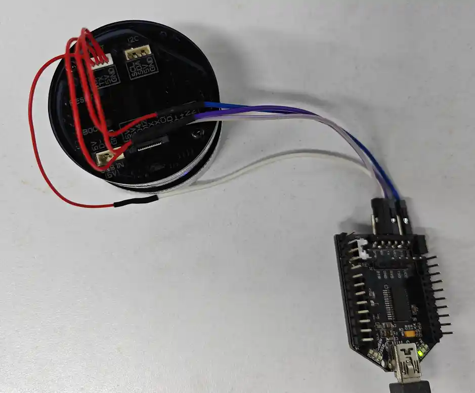

Before downloading any program, you must press the boot button before powering on, Then select the corresponding serial port number to download the program.
①When using the USB-5v-IN port for direct program download, if you need to send or receive data via the serial port, you must enable “USB CDC ON BOOT” in the download settings section of the tool.
②When using UART to download programs, a USB-to-TTL converter is required. When viewing serial port data, there is no need to enable USB CDC on boot.

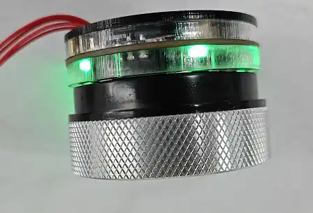

RGB_CODE:¶
The example provides the minimum required RGB LED control, including three basic effects: solid color, running light, and breathing light.

Display effect:¶

Encoder sample program, which only outputs the rotation direction (CW/CCW) and button clicks (single click/double click) to the serial port.
#define ENCODER_A_PIN 45
#define ENCODER_B_PIN 42
#define SWITCH_PIN 41
volatile unsigned long lastPressTime = 0;
volatile int clickCount = 0;
const unsigned long debounceTime = 20; // ms
const unsigned long doubleClickTime = 300; // ms
void IRAM_ATTR buttonISR() {
static unsigned long lastInterruptTime = 0;
unsigned long interruptTime = millis();
if (interruptTime - lastInterruptTime > debounceTime) {
if (!digitalRead(SWITCH_PIN)) { // active low
lastPressTime = interruptTime;
clickCount++;
lastInterruptTime = interruptTime;
int currentStateCLK = 0;
int lastStateCLK = 0;
void setup() {
Serial.begin(115200);
pinMode(ENCODER_A_PIN, INPUT);
pinMode(ENCODER_B_PIN, INPUT);
pinMode(SWITCH_PIN, INPUT_PULLUP);
attachInterrupt(digitalPinToInterrupt(SWITCH_PIN), buttonISR, CHANGE);
lastStateCLK = digitalRead(ENCODER_A_PIN);
Serial.println("Encoder Minimal Demo (A=45, B=42, SW=41)");
void loop() {
// Read encoder A
// Detect rising edge on A
if (currentStateCLK != lastStateCLK && currentStateCLK == HIGH) {
bool ccw = (digitalRead(ENCODER_B_PIN) != currentStateCLK);
if (ccw) {
Serial.println("CCW");
} else {
Serial.println("CW");
// Click / Double-click detection
if (clickCount == 1 && millis() - lastPressTime > doubleClickTime) {
Serial.println("CLICK");
clickCount = 0;
} else if (clickCount >= 2) {
Serial.println("DOUBLE CLICK");
clickCount = 0;
} else if (clickCount > 2) {
clickCount = 0;
delay(10);
