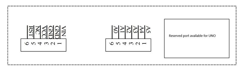

- Reserved port&GVS on top

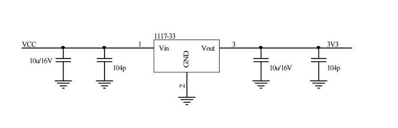

- Voltage ragulator:5V to 3.3V

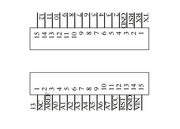

- Slot for NANO board

- Reserved port available for UNO at the bottom
