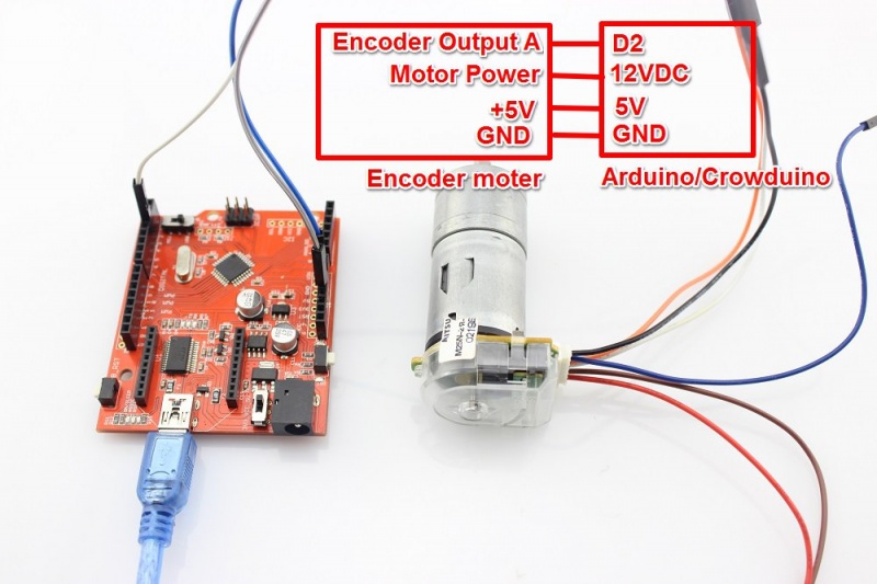

Hardware Installation
Encoder Gear Motor-25MM 95RPM hardware.jpg Encoder Gear Motor-25MM 95RPM hardware2.jpg
Demo c0de
1.Download the library File:Encoder Gear Motor Library
2.Unzip it into the libraries file of Arduino IDE by the path: ..\arduino-1.0\libraries.
3.Open the code directly by the path:File -> Examples ->MsTimer2 ->Encoder_Gear_Motor.
#include <MsTimer2.h>
#define ENCODER_A_PIN 2
long position;
long speed=0;
void setup(){
  MsTimer2::set(1000, flash);
  MsTimer2::start();
  pinMode(ENCODER_A_PIN, INPUT);
  attachInterrupt(0, read_quadrature, CHANGE);
void loop(){
   Serial.print("speed: ");
   Serial.print(speed/334, DEC);
   Serial.println("rmp");
   delay(1000);
void read_quadrature(){
  if (digitalRead(ENCODER_A_PIN) == LOW){
      position++;
void flash()
     speed=position;
     position=0;
4.Open the monitor of Arduino IDE, you can see the speed of the motor.
