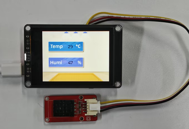

If the temperature value collected by your temperature and humidity sensor exceeds 30 ℃, the light bulb will automatically light up; If the temperature drops below 30 ℃, the light bulb will automatically turn off. (You can modify the temperature threshold yourself, this is only for the convenience of observing the results)

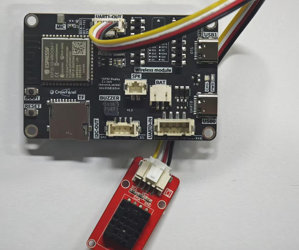

If you are using the 2.8-inch or 2.4-inch version of the product, you need to pay special attention to the issue of IIC device address conflicts. The IIC address of the onboard touch driver chip is 0x38, and the default IIC address of the DHT20 temperature and humidity sensor is also 0x38. When you connect the DHT20 temperature and humidity sensor to the IIC-OUT interface, since both devices use the same IIC address, an address conflict will occur, resulting in the devices being unable to communicate normally. In this situation, the system will give priority to ensuring the normal operation of the touch driver chip. Therefore, the touch function will not be affected, but the DHT20 temperature and humidity sensor will be unable to read data properly. To solve this problem, we suggest connecting the DHT20 temperature and humidity sensor to the UART1-OUT interface for use. This will prevent IIC address conflicts and ensure that the temperature and humidity sensor can operate normally. Additionally, it is important to note that the UART1-OUT interface actually provides two GPIO pins (IO17 and IO18) that are available for user use. You can use them as regular GPIOs and connect some peripherals that only require one or two IO pins.
For example, when connecting an LED light, IO18 can be used as the control pin, and the on/off state of the light can be controlled by the program.
It should be noted that the UART1-OUT interface only provides two GPIO pins, namely IO17 and IO18. Therefore, it is only suitable for peripheral devices that occupy a relatively small amount of IO resources. If certain modules require the use of more GPIO pins, such as SPI devices which typically need multiple signal lines including SCK, MOSI, MISO and CS, then they cannot be directly connected and used through the UART1-OUT interface.
2.4" 2.8"¶
And when initializing the temperature and humidity sensor, specify the IIC pin used for initializing the temperature and humidity sensor.
Use
Wire1(GPIO17 for SDA and GPIO18 for SCL).
4 Hardware connection¶
For the 2.4-inch and 2.8-inch versions of the product, since there is an IIC address conflict between the onboard touch driver chip and the DHT20 temperature and humidity sensor, this tutorial uses the UART1-OUT interface to connect the DHT20 temperature and humidity sensor.
During actual use, we reconfigured IO17 and IO18 as IIC communication pins, with one serving as SDA (data line) and the other as SCL (clock line), thus enabling communication with the DHT20 temperature and humidity sensor. This not only ensures the normal operation of the touch function but also allows for the normal reading of temperature and humidity data.

Phenomenon display
