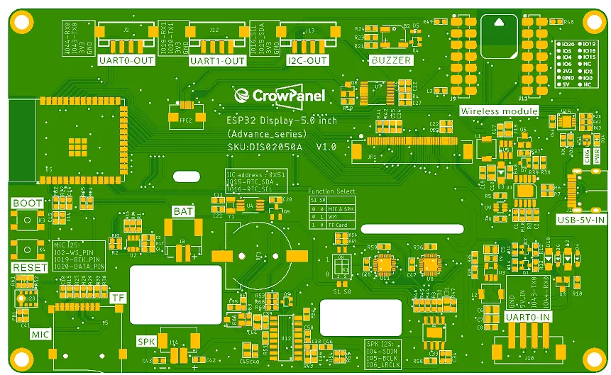

Pin Output:
advance-5.0
Functional description
Functional description of the product's internal interfaces:
Pin Name Description Connector Type
SPK Output audio signals to connect to speakers. The main board comes with a power amplifier chip circuit. PH2.0-2P
PWR Power LED.
RST Reset button. Press it to reset the system.
boot
UART0-OUT Builds communication between Logic modules, including the serial communication module and the print module. HY2.0-4P
UART1-OUT Builds communication between Logic modules, including the serial communication module and the print module. HY2.0-4P
UART0-IN 32 KB (ATmega328) of which 0.5 KB used by bootloader XH2.54-4P
I2C-OUT Establish communication between the microcontroller and peripheral devices. HY2.0-4P
BAT Connect the lithium battery. (with battery charging circuit)(3.7v-4.2v) PH2.0-2P
Product External Interface Functions:
5.0-inch HMI port pin number Electrical Characteristics
UART0-OUT RX(IO44); TX(IO43) RX; Output voltage: 3.3V
Output current: 1A max.
Use: Power supply output and communication.
UART1-OUT RX(IO19); TX(IO20) RX; Output voltage: 3.3V
UART0-IN RX(IO44); TX(IO43) RX; Input voltage: 5V ± 5%. 5.5V max.
Input current: 2A max.
Purpose: Power supply input and communication.
I2C SDA(IO15); SCL(IO16) ; Output voltage: 3.3V
SPK I2S_LRCLK(IO6);I2S_BCLK(IO5);I2S_SDIN(IO4); Maximum output current: 20mA
Signal type: 3.3V logic level, digital control signal
SD Card Slot MOSI(IO6); MISO(IO4); CLK(IO5); CS(3.3V) Maximum output current: 20mA
LCD Backlight PCA9557PW-IO1 Maximum output current: 20mA
I2S MIC MIC_SD(IO20);MIC_WS(IO2);MIC_CLK(IO19) Maximum output current: 20mA
BUZZER IO8 Maximum output current: 20mA

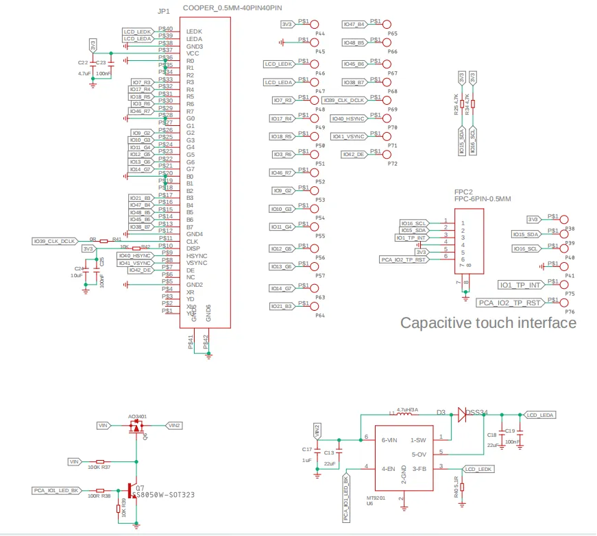

Schematic:
ESP32-S3 and ISP Display Wiring Pins:
advance-5.0

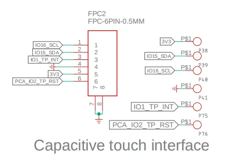

ESP32-S3 and Touch Driver Wiring:
i2c address: 0x5D.
advance-5.0

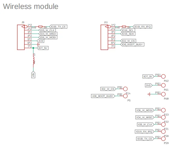

ESP32-S3 and wireless module wiring pins:
advance-5.0

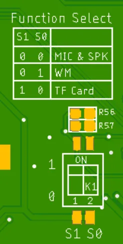

Schematic diagram of function selection:
advance-5.0
Switching Function Keys:
S1 S0 effective function
0 0 MIC&SPK
0 1 WM(wireless module)
1 0 TF Card

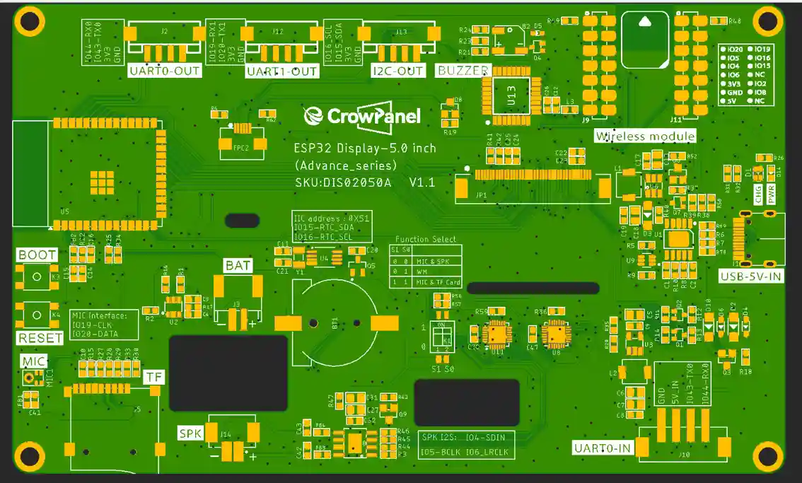

Version 1.1
Pin Output:
advance5.11-1
UART0-OUT RX(IO44); TX(IO43) RX; Output voltage: 3.3V Output current: 1A max. Use: Power supply output and communication.
UART1-OUT RX(IO19); TX(IO20) RX; Output voltage: 3.3V Output current: 1A max. Use: Power supply output and communication.
UART0-IN RX(IO44); TX(IO43) RX; Input voltage: 5V ± 5%. 5.5V max. Input current: 2A max. Purpose: Power supply input and communication.
I2C SDA(IO15); SCL(IO16) ; Output voltage: 3.3V Output current: 1A max. Use: Power supply output and communication.
SPK I2S_LRCLK(IO6);I2S_BCLK(IO5);I2S_SDIN(IO4); Maximum output current: 20mA Signal type: 3.3V logic level, digital control signal
SD Card Slot MOSI(IO6); MISO(IO4); CLK(IO5); CS(3.3V) Maximum output current: 20mA Signal type: 3.3V logic level, digital control signal
LCD Backlight P3.5(STC8H1K28) Maximum output current: 20mA Signal type: 3.3V logic level, digital control signal
Backlight Adjustment P1.1(STC8H1K28)
I2S MIC MIC_SD(IO20);MIC_WS(IO2);MIC_CLK(IO19) Maximum output current: 20mA Signal type: 3.3V logic level, digital control signal
BUZZER P2.7(STC8H1K28) Maximum output current: 20mA Signal type: 3.3V logic level, digital control signal
TP_RST P1.7(STC8H1K28)

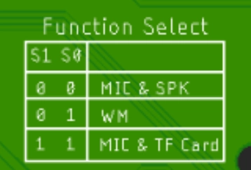

advance5.11-2
0 0 MIC&SPK
1 1 MIC&TF Card

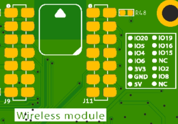

advance5.11-3

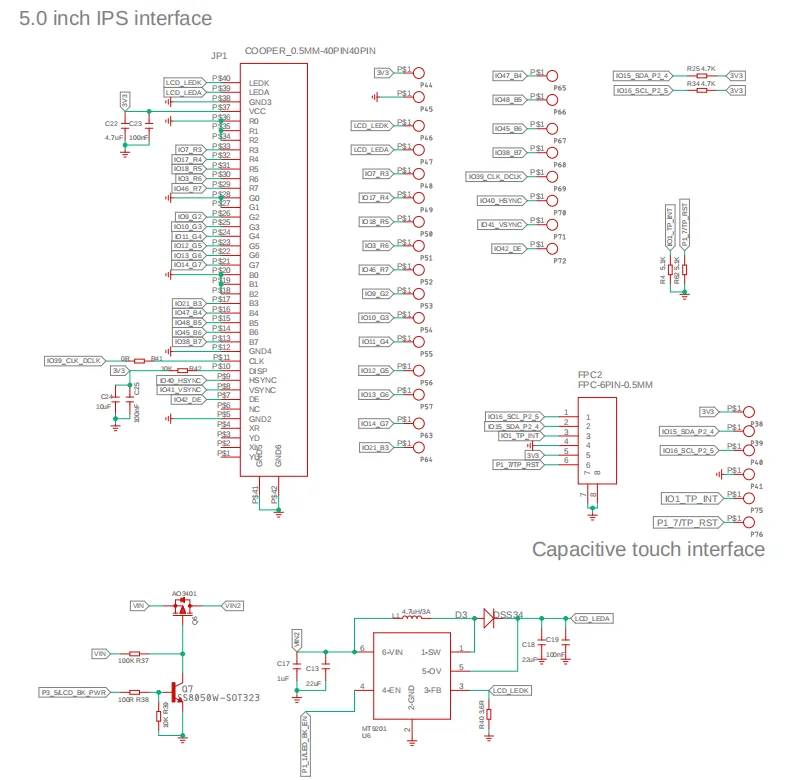

Schematic:
advance5.11-4

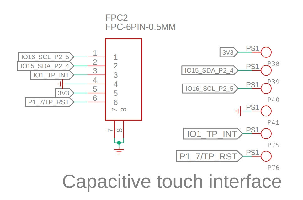

i2c address: 0x5D.
advance5.11-5
