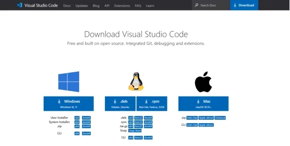

Search for Visual Studio Code download on Google or enter the https://code.visualstudio.com/download, select the version compatible with your computer system and download Visual Studio Code installer. In this instructions we are selecting Windows.
Double-click the VSCodeUserSetup file to install the Visual Studio Code.

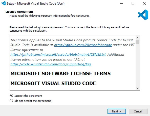

Accept the license agreement and go next.

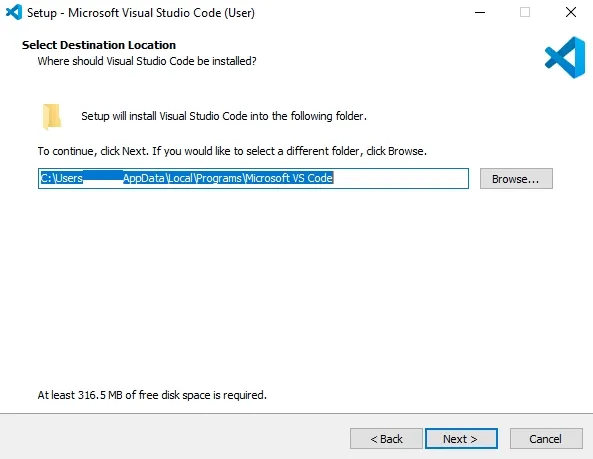

Accept the default location or click 'Browse...' to change the installation location.

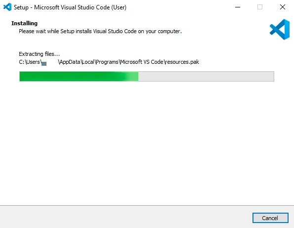

Click install and waiting for the installation ...

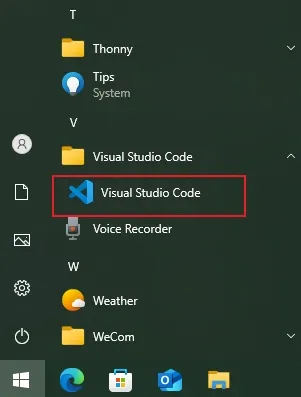

Click 'Finish' to exit the installation and (by default) launch Visual Studio Code:

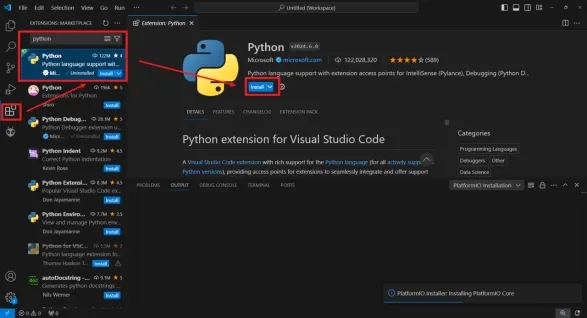

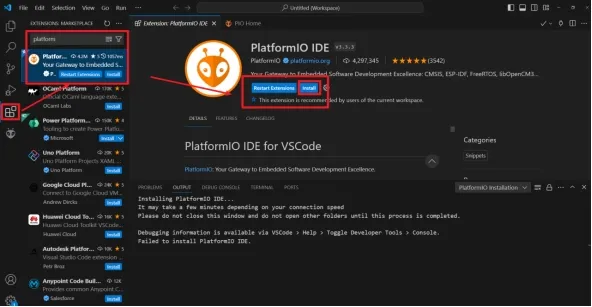

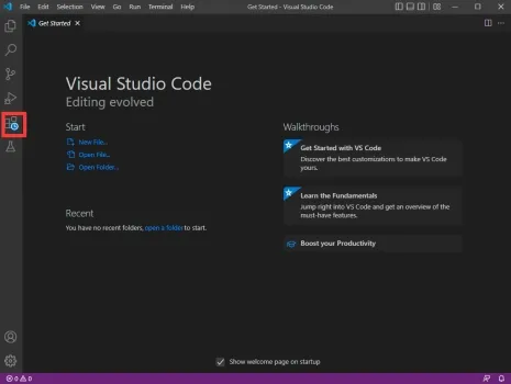

Open Visual Studio Code and open Extension Manager.
Install Python¶
Search for 'Python' and install.
Install PlatformIO¶
Search for 'PlatformIO' and install.

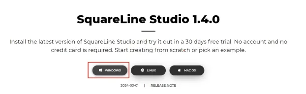

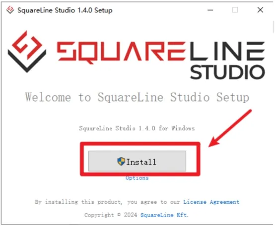

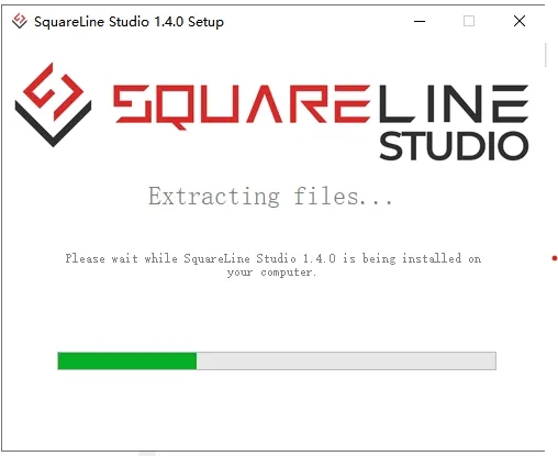

Download the version 1.4.0
Click install.
Wait for installation.

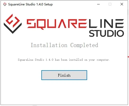

Installation finish.

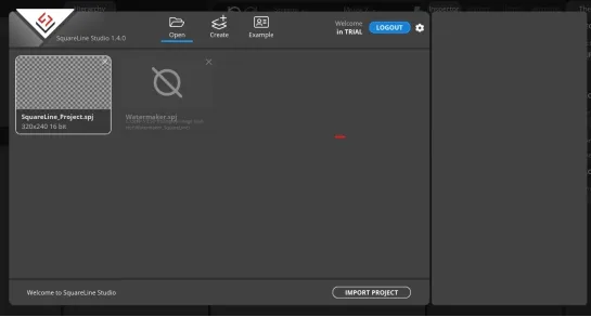

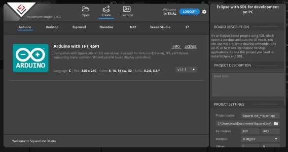

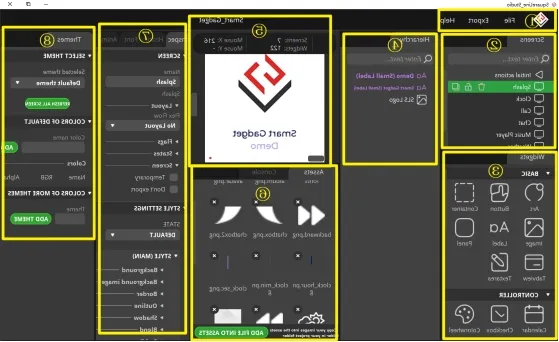

Open the software
Note:Please select the corresponding resolution and color depth according to the screen specifications.
①Toolbar, including File, Export, and Help. Basic file operation bar, create or open files, export UI files and other operations. Click help and there are related introductory documents.
②Screen bar, the project screen will be listed here.
③Widget area, all widgets are here and can be selected and used according to project needs.
④Hierarchy area, it will show every widget used in each screen.
⑤This area shows the actual display effect, you can adjust the widgets or screen here.
⑥Material column, the added materials are displayed here.
⑦Setting bar, where you can make basic settings for each part, including the basic attributes and trigger operations of the part.
⑧Theme bar, different themes can be set.

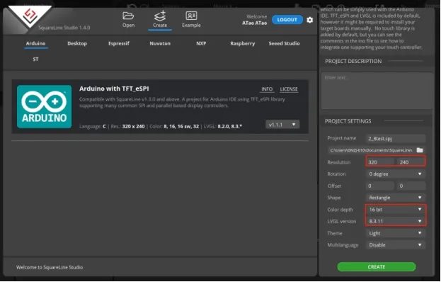

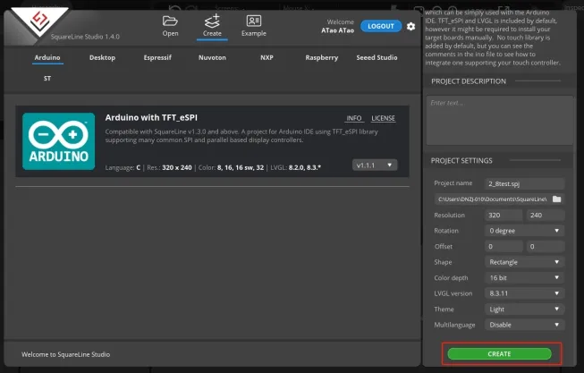

5.1 Create a new SquareLine Studio project.¶

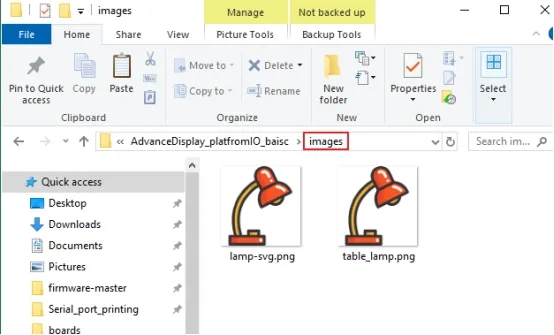

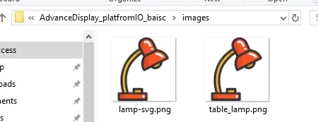

Here, I take a 2.8-inch screen as an example. After determining the resolution, I fill it in
The file download address is https://drive.google.com/drive/folders/1Qw7hdW862upBigarI11btgl4cQkr0vpe?usp=sharing
Table_1amp image sizes are available for 3.5-inch, 4.3-inch, 5.0-inch, and 7-inch screens.

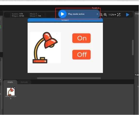

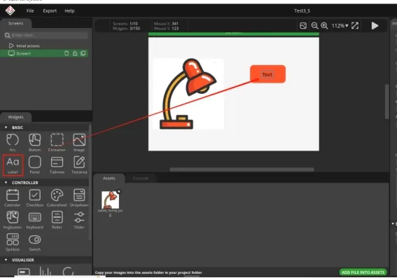

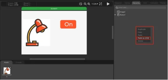

5.2 Add functions to the buttons to enable them to turn on and off lights¶
Select 'event' to add in the right sidebar.
After selecting, click ADD.
After adding, run

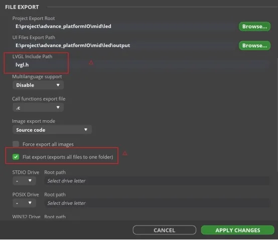

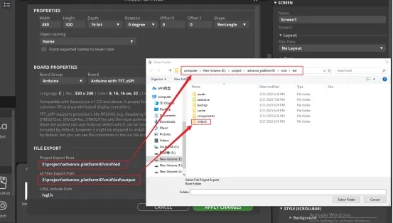

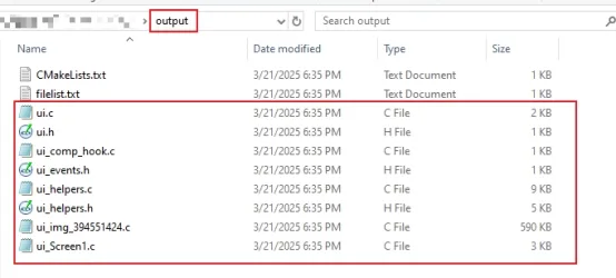

5.3 UI interface design completed, exporting UI files for easy use in subsequent code¶
Click on Project Setting
Set export path.
Complete the setup and export file.

Double-click to open Visual Studio Code.

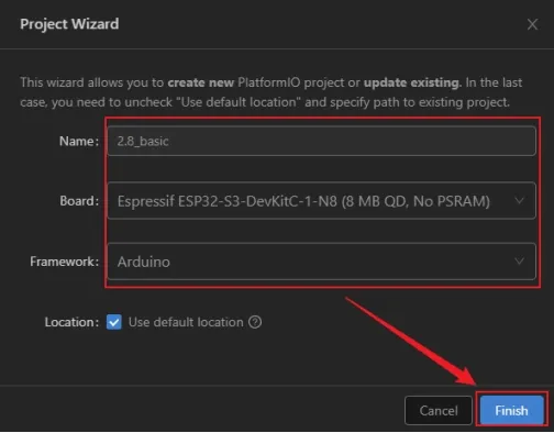

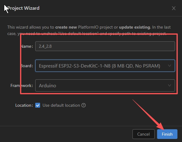

Click the PlatformIO icon, click QUIK ACCESS 'Open', then click '+New Project'.
Add a project name. Select "Espressif ESP32-S3-DevKitC-1-N8" for the board and Arduino for the framework.(In this lesson, the 2.8-inch development board is taken as an example.)

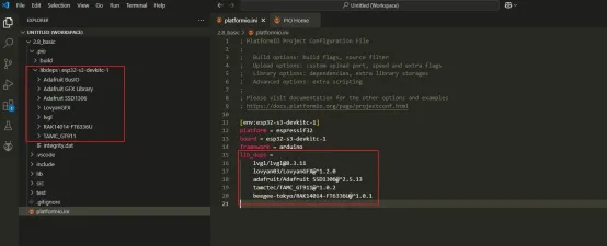

6.2 Add the necessary libraries to the PlatformIO project.¶

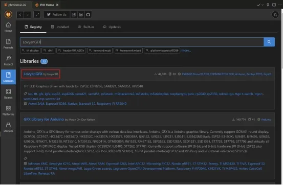

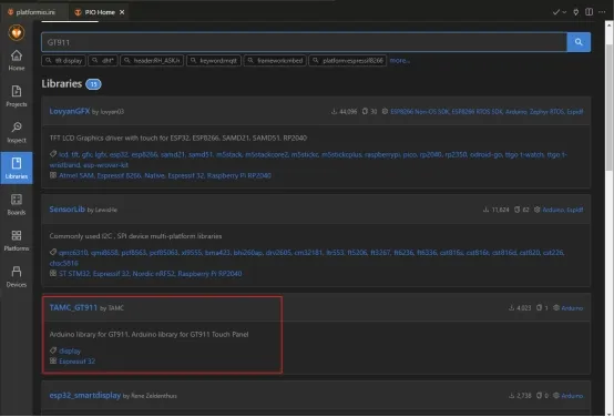

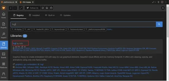

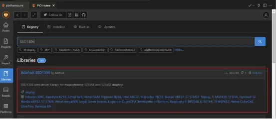

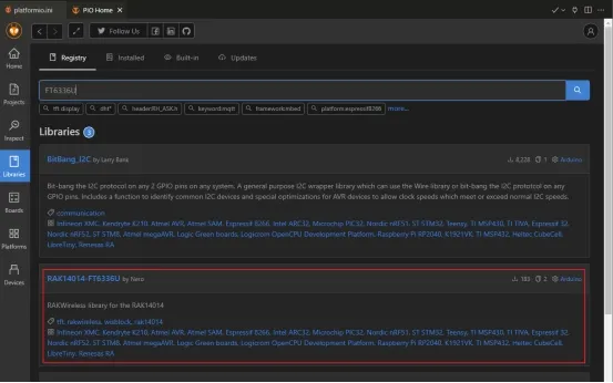

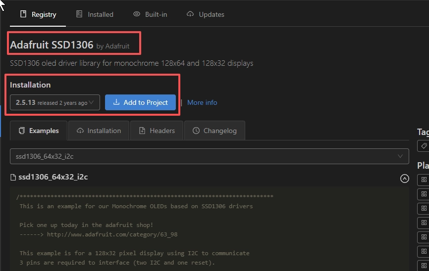

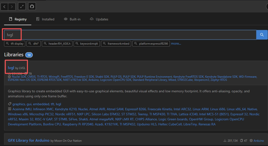

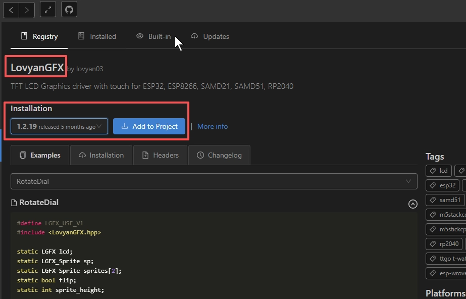

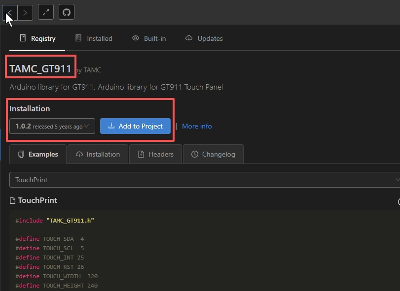

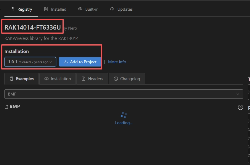

Click the PlatformIO icon, click ‘Libraries’, then search for the following libraries.
① Lvgl
② LovyanGFX
③ Adafruit SSD1306
④ TAMC_GT911
⑤ FT6336U

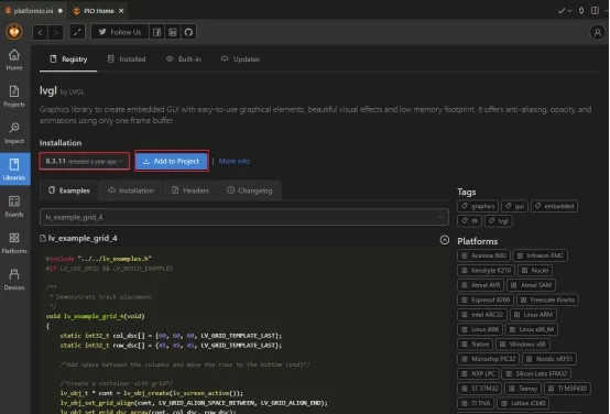

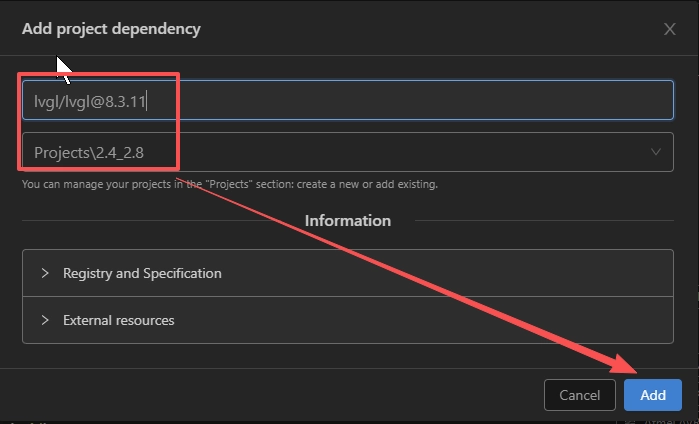

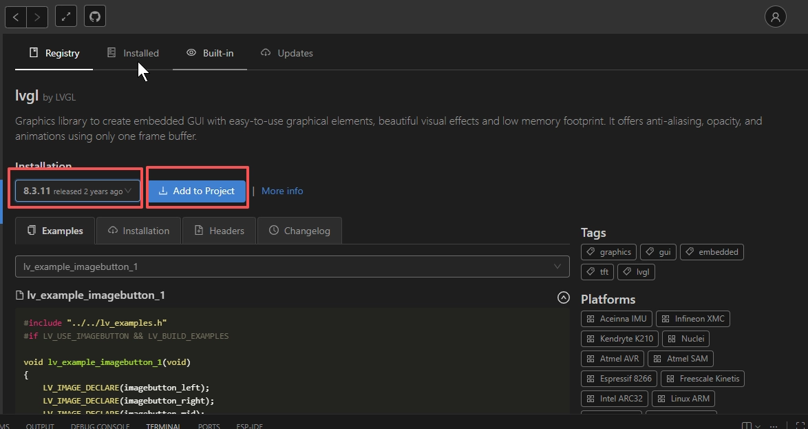

Click on the LVGL library.

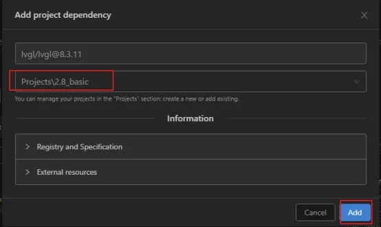

Select version 8.3.11 (which needs to correspond to the version selected when creating the project in SquareLine Studio), and click "Add to Project".
Select the corresponding project name and click "Add".

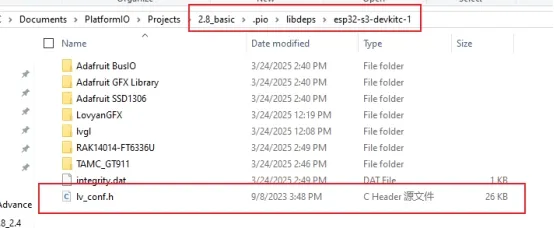

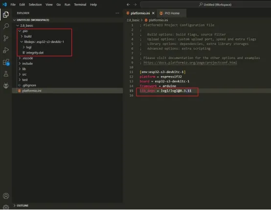

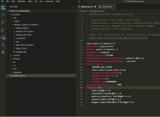

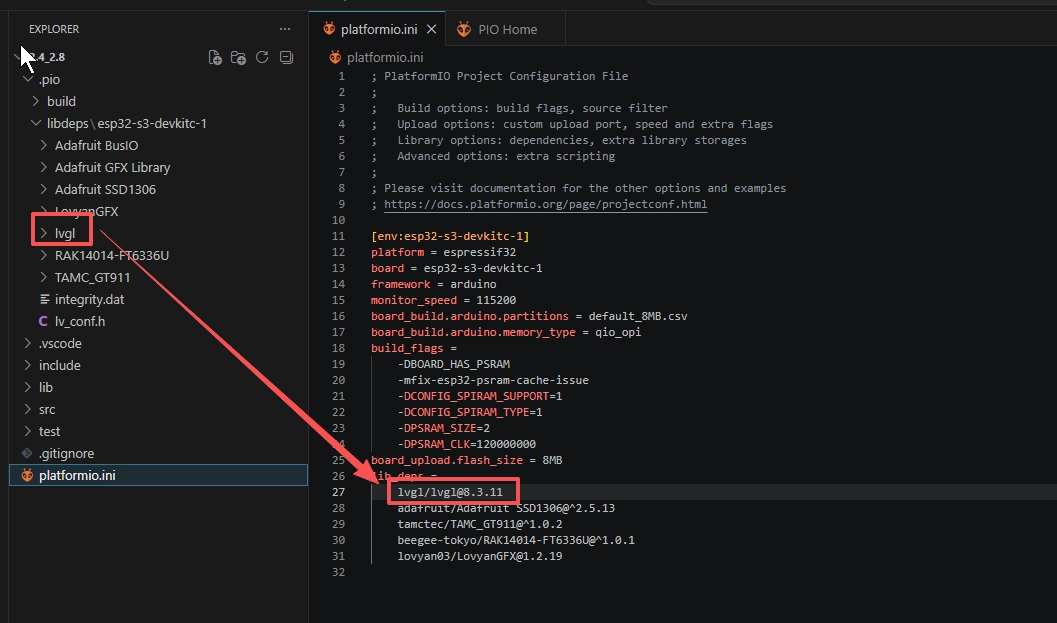

If the library is successfully added to the project, the interface will automatically jump to the PlatformIO.ini file and automatically generate the project dependencies.
Note: If the platformio.ini file remains unchanged, but the library that has just been added is present in the pio->libdeps->esp32-s3-devkitc-1 folder, then click on "Compile". The PlatformIO plugin will pop up a window prompting you to change the library dependency link in the platformio.ini file.
Repeat the above steps and add the remaining libraries one by one (just select the latest version by default for the library versions).
After all the required libraries have been added, the PlatformIO project will be as shown in the following figure.
Place the lv_conf.h we provide to the path: .pio\libdeps\esp32-s3-devkitc-1-myboard in the project folder.

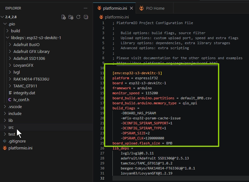

6.3 Add the chip configuration to the PlatformIO project¶
Open the platformio.ini file. This file is the configuration file of the PlatformIO project, which is used to define information such as the project's build environment, upload options, and library dependencies. Copy the following development board configuration into this file.
monitor_speed = 115200
board_build.arduino.partitions = default_8MB.csv
board_build.arduino.memory_type = qio_opi
build_flags =
-DBOARD_HAS_PSRAM
-mfix-esp32-psram-cache-issue
-DCONFIG_SPIRAM_SUPPORT=1
-DCONFIG_SPIRAM_TYPE=1
-DPSRAM_SIZE=2
-DPSRAM_CLK=120000000
board_upload.flash_size = 8MB

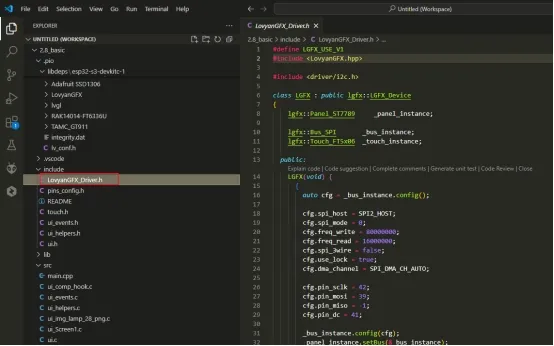

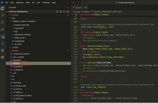

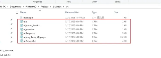

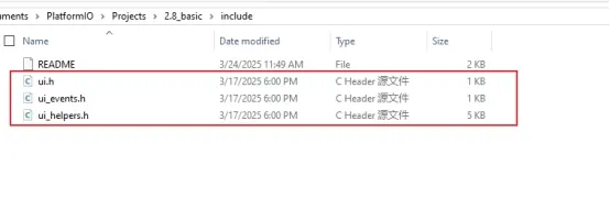

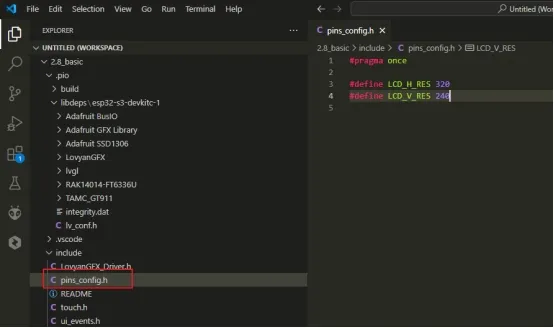

Find the UI source files and header files generated by SquareLine Studio.
Copy the.c file in the UI file to the src folder of the PlatformIO project.
Copy the.h file in the UI file to the include folder of the PlatformIO project.

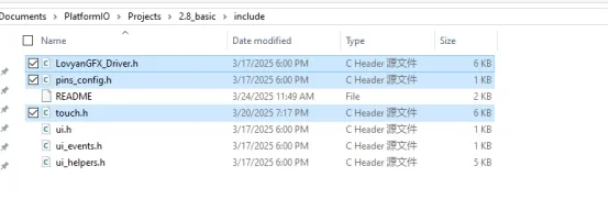

Similarly, add the display driver and pin definition header files to the include folder.

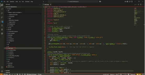

6.5 Write the main program in main.cpp¶
In PlatformIO, the.cpp file is an extremely crucial C++ source file. It serves as the core carrier for implementing program logic. It can define various functional functions to complete specific tasks, and it can also implement classes and objects, organizing the code with the object-oriented programming concept.
In terms of interacting with hardware, the.cpp file enables the writing of driver code to initialize, read from, and write to hardware devices such as sensors and actuators. Additionally, it allows for the writing of interrupt service routines to respond to hardware interrupts.
Moreover, the.cpp file supports modular development. Different functional codes can be encapsulated within it, which facilitates code reuse. In a multi-person team development scenario, different team members can be assigned to write different.cpp files, thereby improving development efficiency and the maintainability of the project.

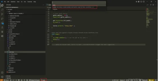

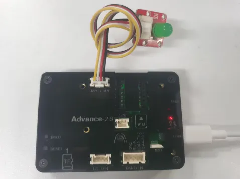

Connect the light bulb at the UART1 interface

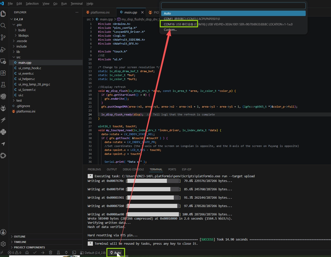

Select the corresponding serial port.

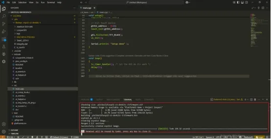

Click this button to build.
Wait for the compilation to be completed.

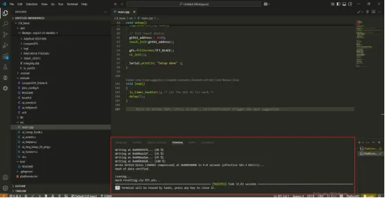

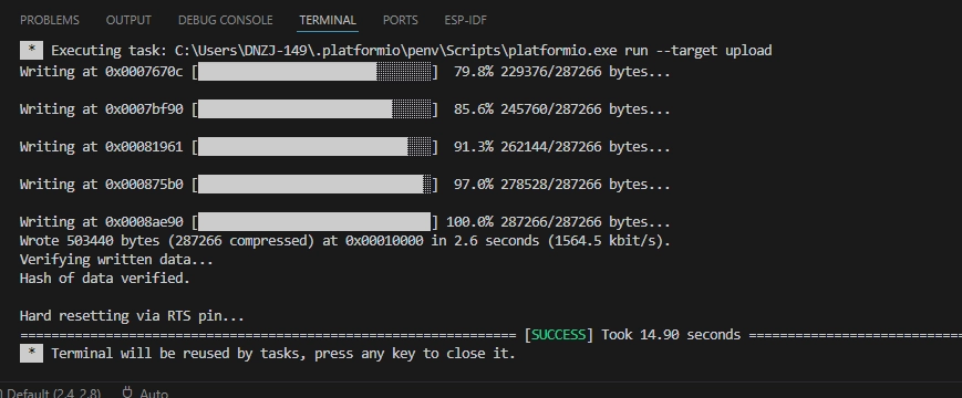

Click to burn.
Wait for the burning process to be completed.

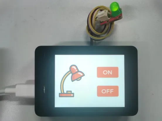

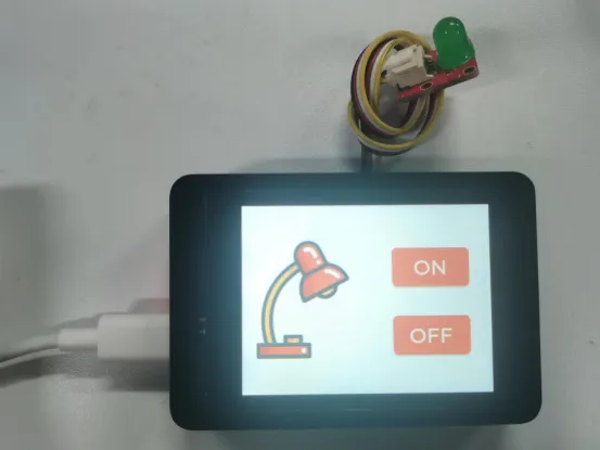

So you can see the UI interface you just designed.
You can click the On and Off buttons to control the on/off of the lights
