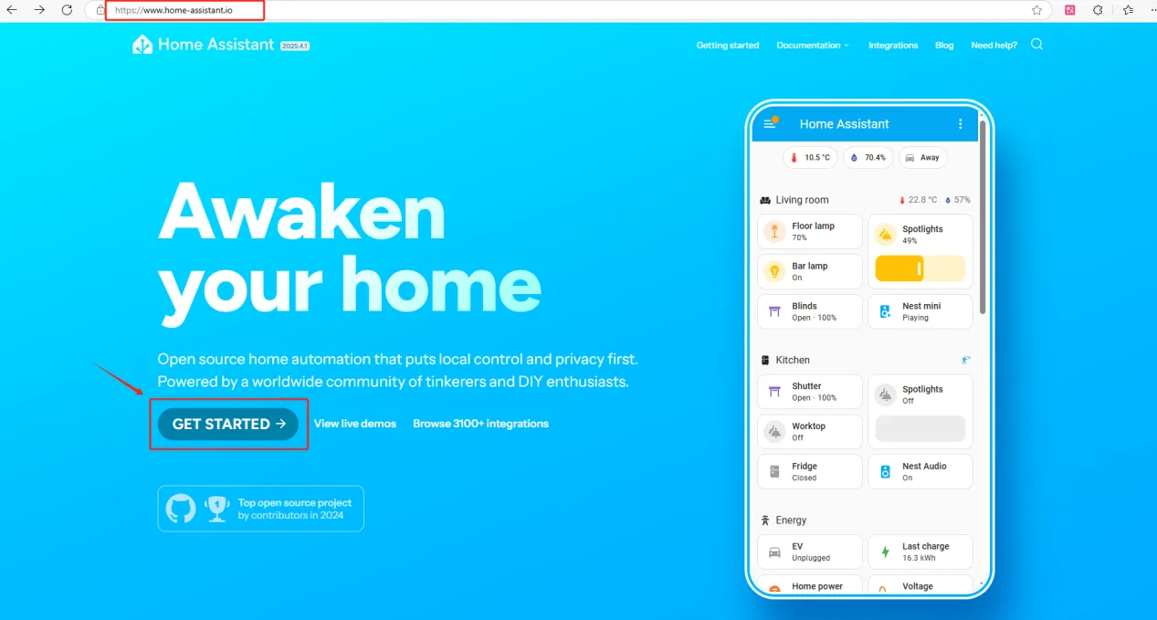

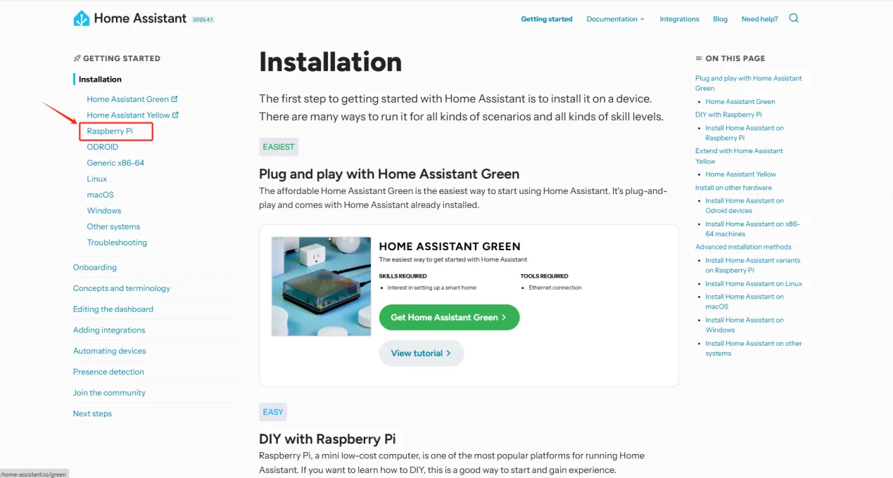

Open the official website of Home Assistant: https://www.home-assistant.io/
Select a Raspberry Pi and install the Home Assistant system according to this installation guide.

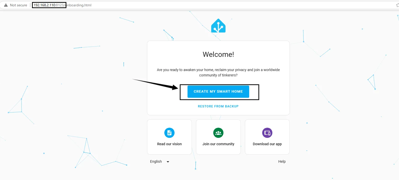

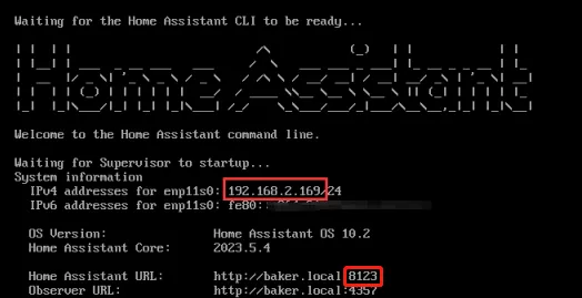

Note: The Raspberry Pi must be connected to a screen to view information. Once everything is ready, power on the Raspberry Pi and wait for it to load. The screen will display the following image.
Remember the IP address and the Home Assistant URL.
In my case, the IP address is: 192.168.2.110
So I enter 192.168.2.110:8123 in the browser.

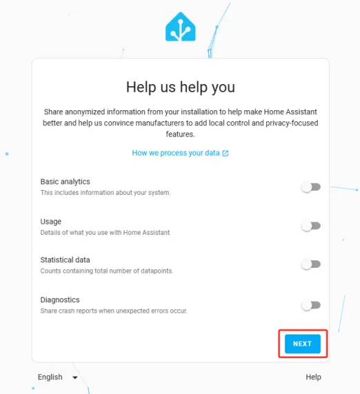

Next, start configuring the Home Assistant system.

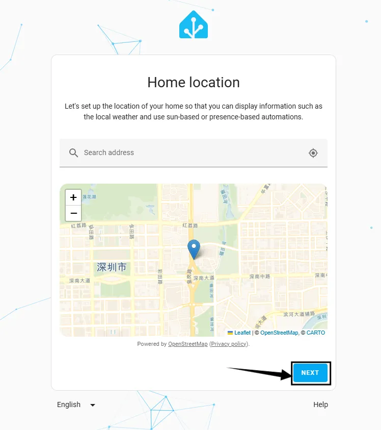

You can either manually set your location or allow it to be detected automatically.
By default, click 'Next'.

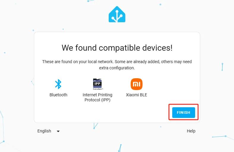

You can either add smart devices now or click Finish to add them later.
Here, we will add the devices later.

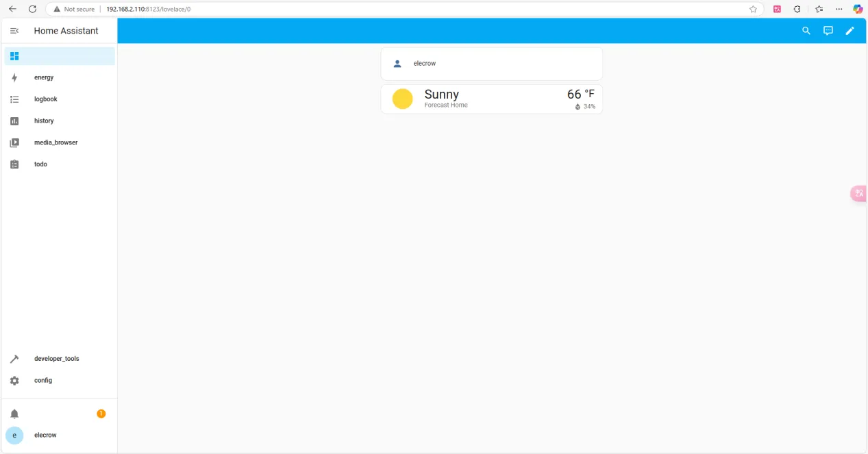

This will bring you to the main interface of Home Assistant.

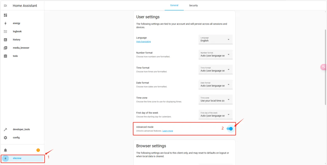

Click on the username and enable "Advanced Mode."

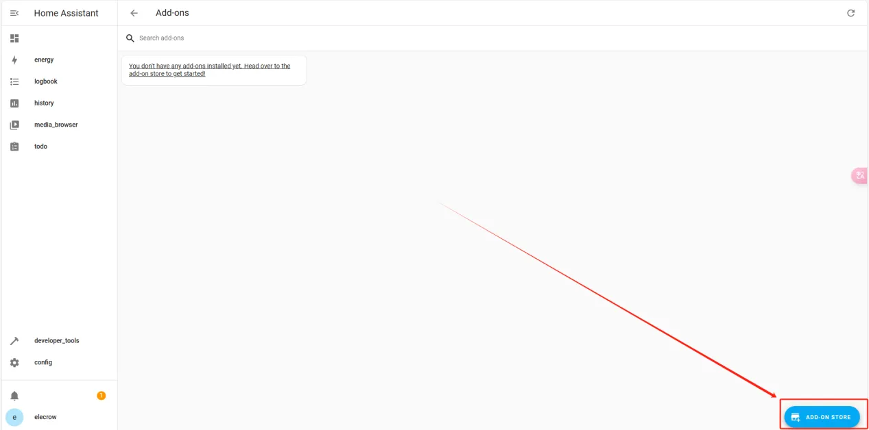

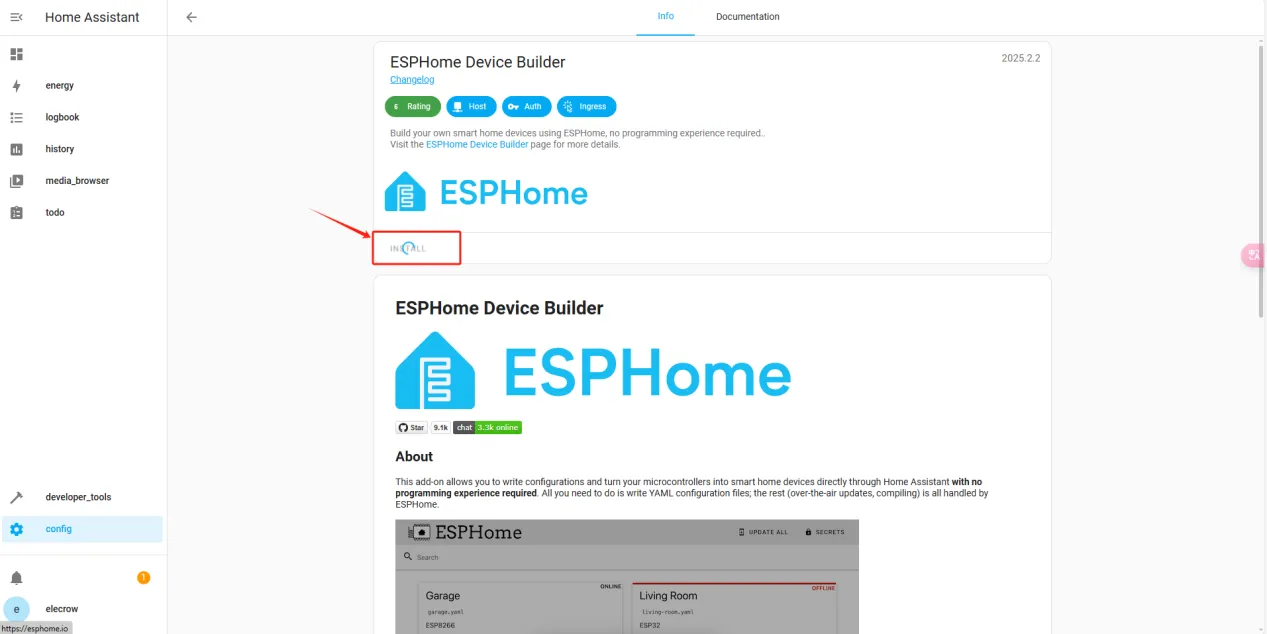

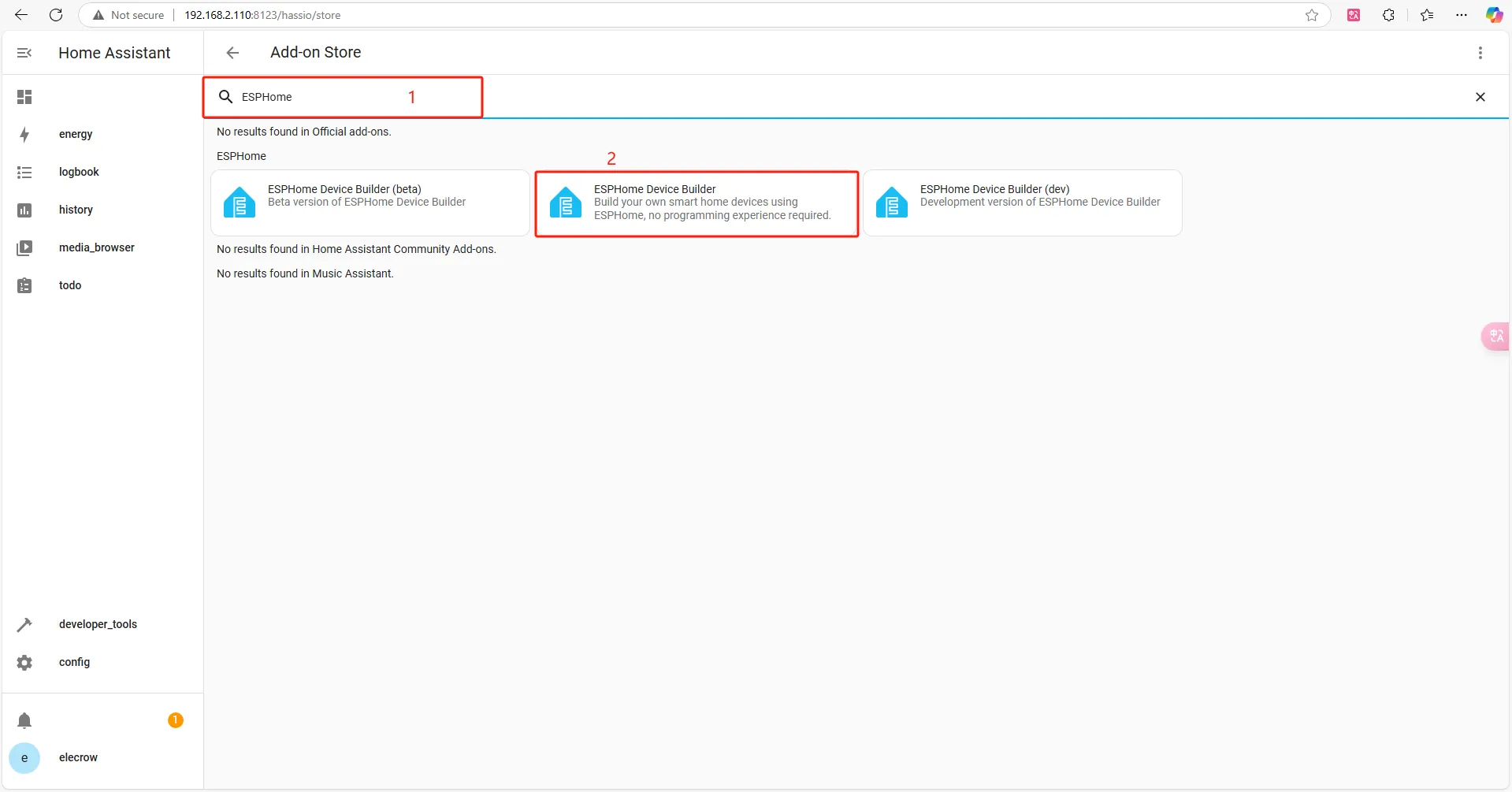

Click on "Settings" and then "Add-ons."

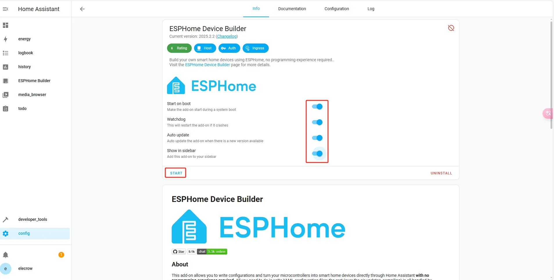

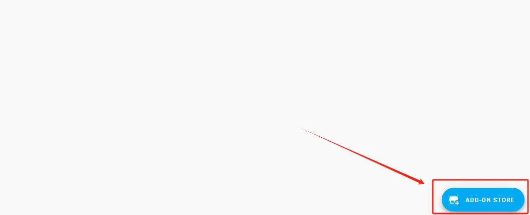

Click on "ADD-ON STORE" and type ESPHome to install it.
The installation is in progress, as shown in the image.

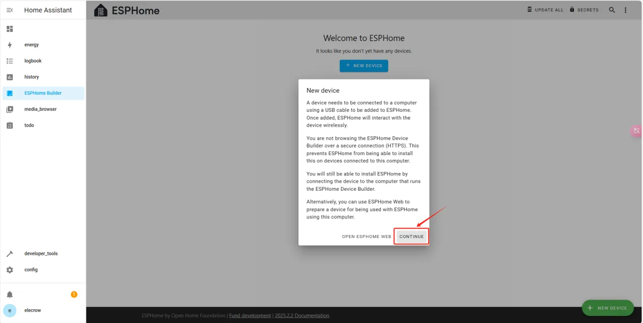

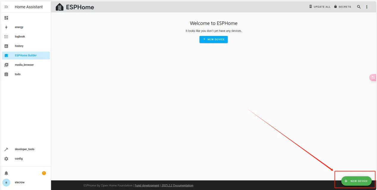

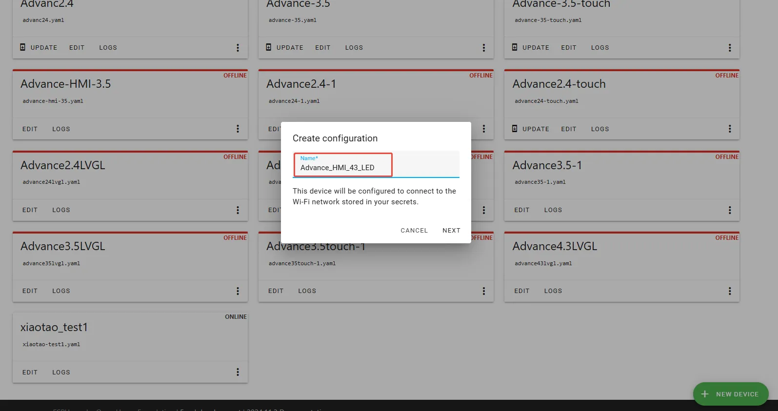

Once the installation is complete, we can start adding devices. Click on + New Device -> Continue.
Enter a name and click Next.

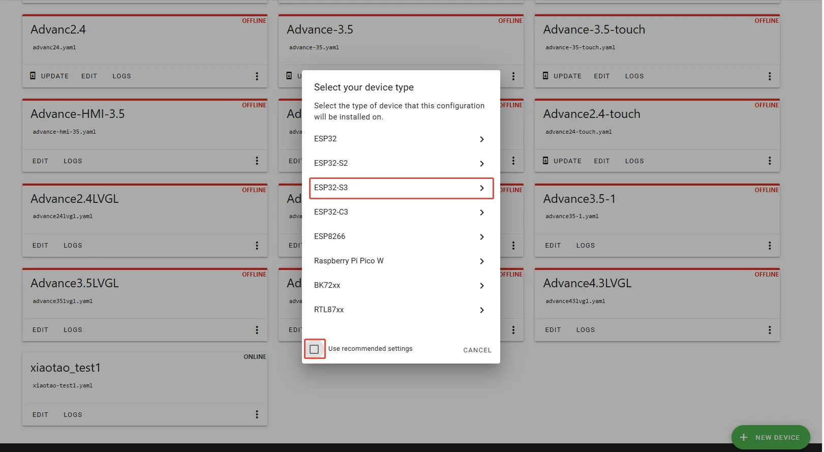

Here, do not check "Use recommended settings."
Select the main chip of the Crowpanel Advance ESP32 HMI Display, ESP32-S3.

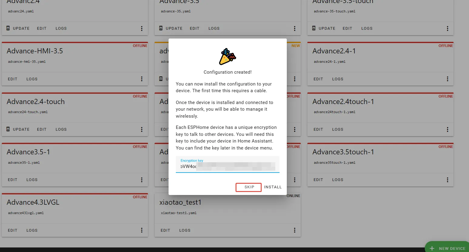

Here, click "SKIP".

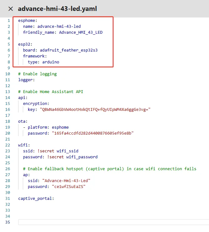

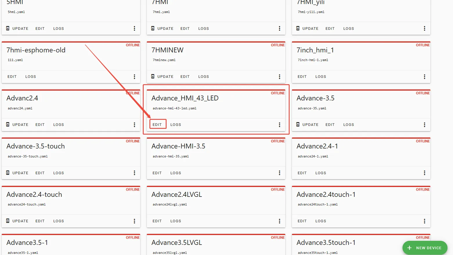

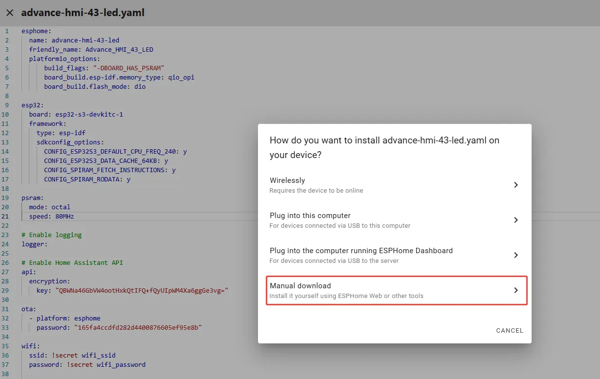

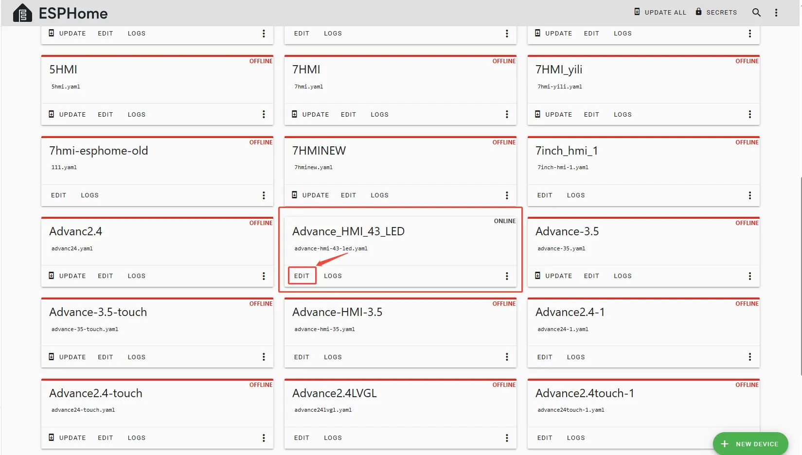

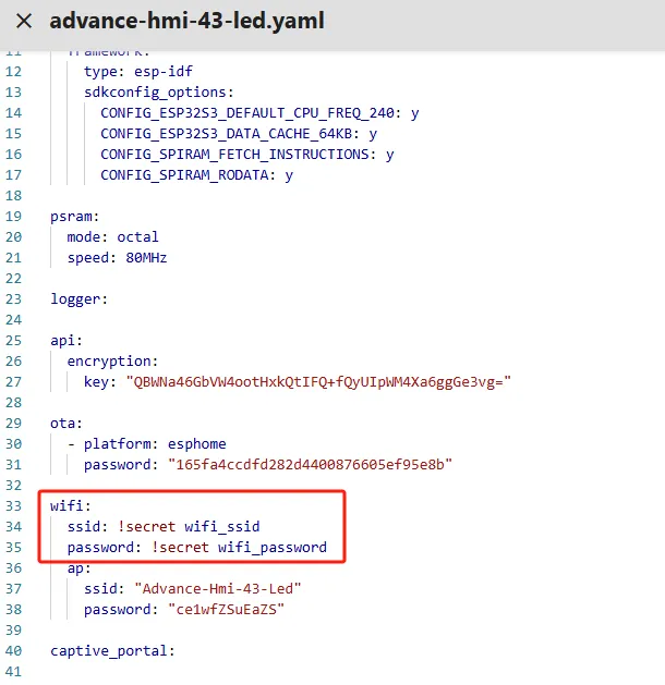

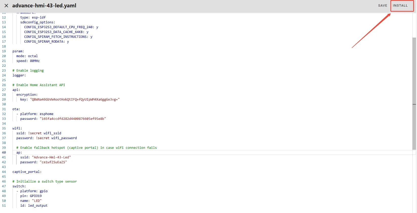

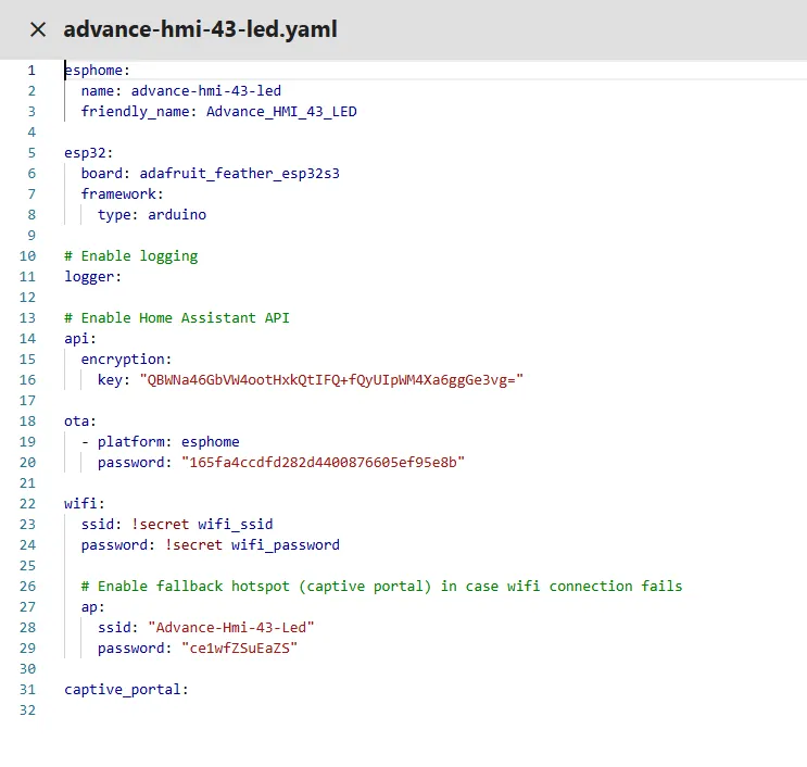

Then, return to the main interface, find the Advance_HMI_43_LED you just created, click "EDIT", and enter the code editor.

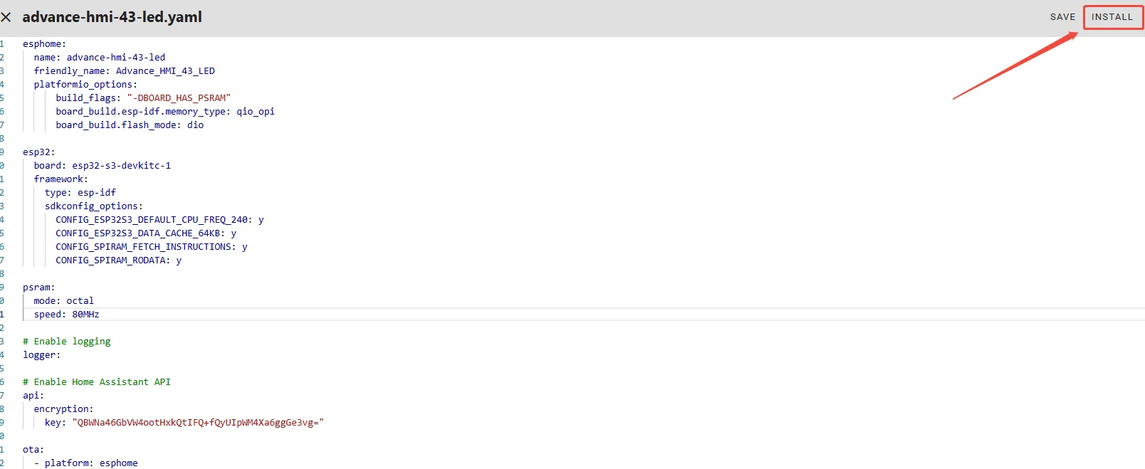

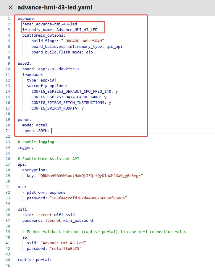

This code is automatically generated based on the previous steps. Next, we will make replacements in it, which will help optimize the code for more efficient operation.
Next, you can replace the relevant content in esphome and ESP32 as needed.
Remember to replace your own Wi-Fi name and password.

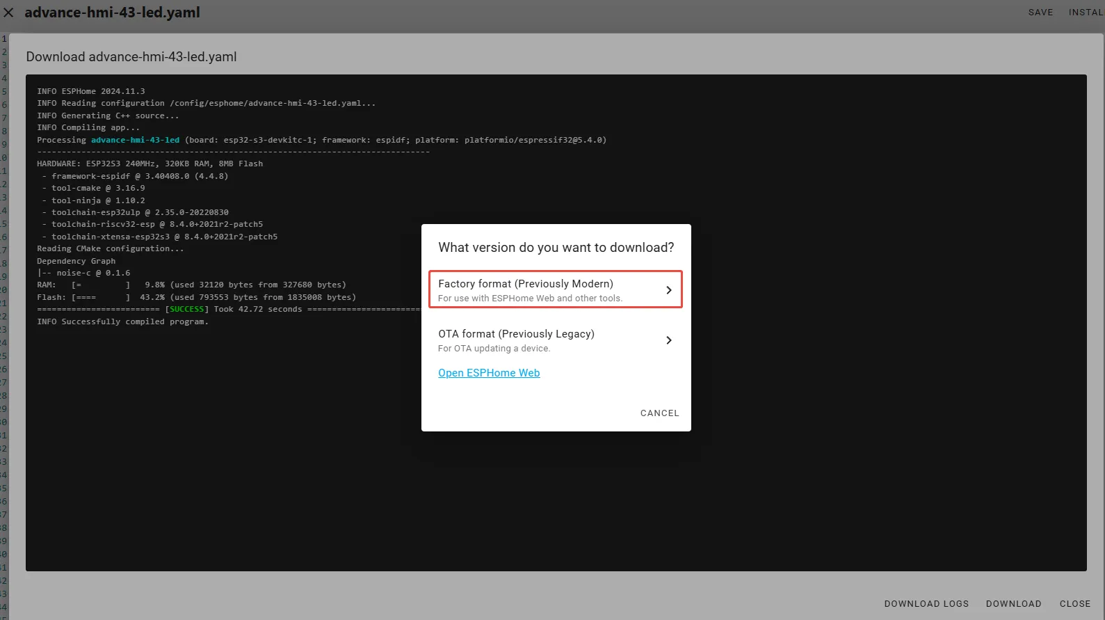

Once the code replacement is complete, click "INSTALL" in the top right corner.
Select "Manual download".

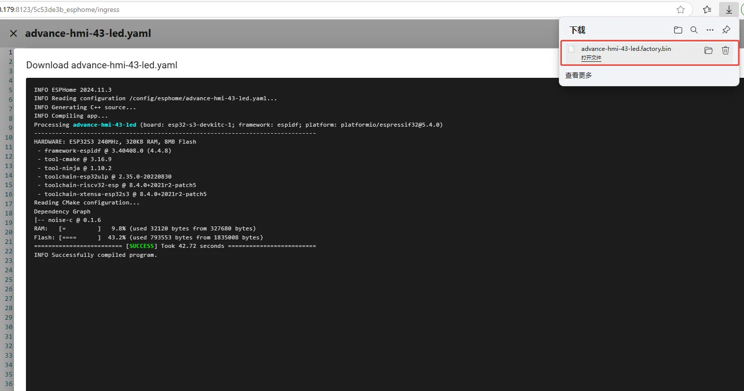

Wait for a few minutes until the installation is complete.
Then, select "Factory format".

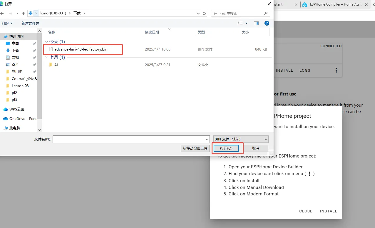

Once the download is complete, you will see the .bin file.
Remember the path of this .bin file.

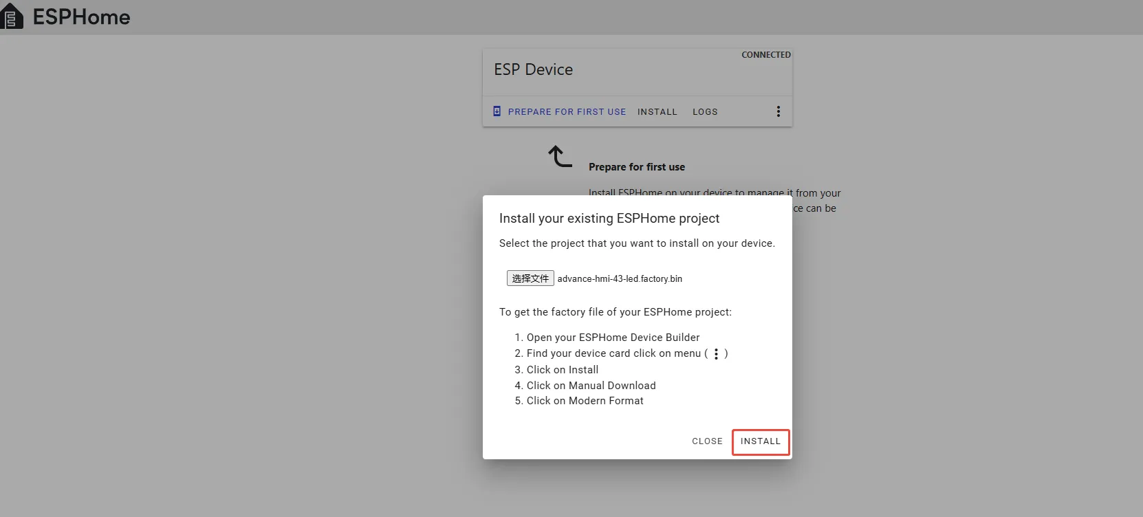

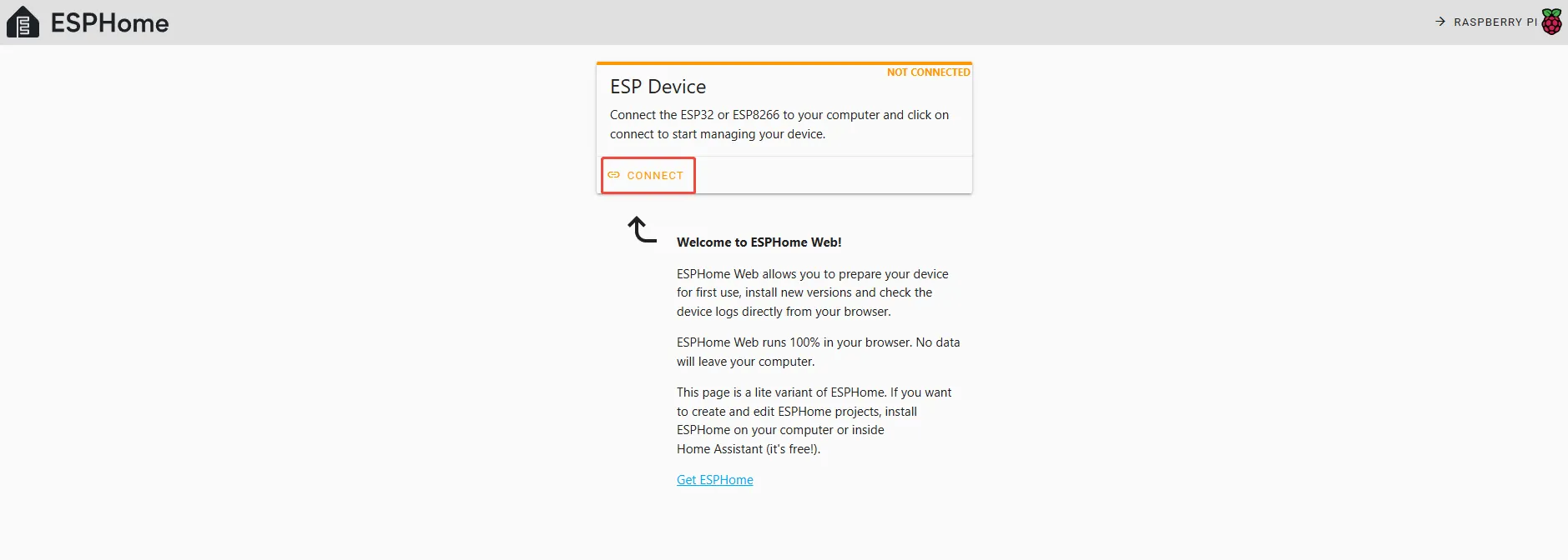

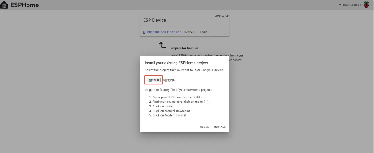

Open the following website: https://web.esphome.io/?dashboard_wizard
Next, we will flash this .bin file into the Crowpanel Advance ESP32 HMI Display.
Connect the Crowpanel Advance ESP32 HMI Display to your computer.
Click "Connect", select the COM port, and connect it.

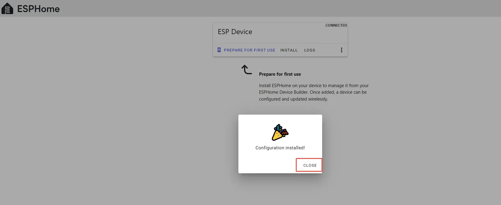

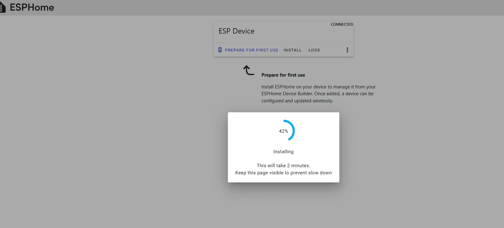

After connecting the Crowpanel Advance ESP32 HMI Display, click "Install".
Add the .bin file you just downloaded, then click "Install".
Wait for a few minutes.
After the installation is complete, click "Close".

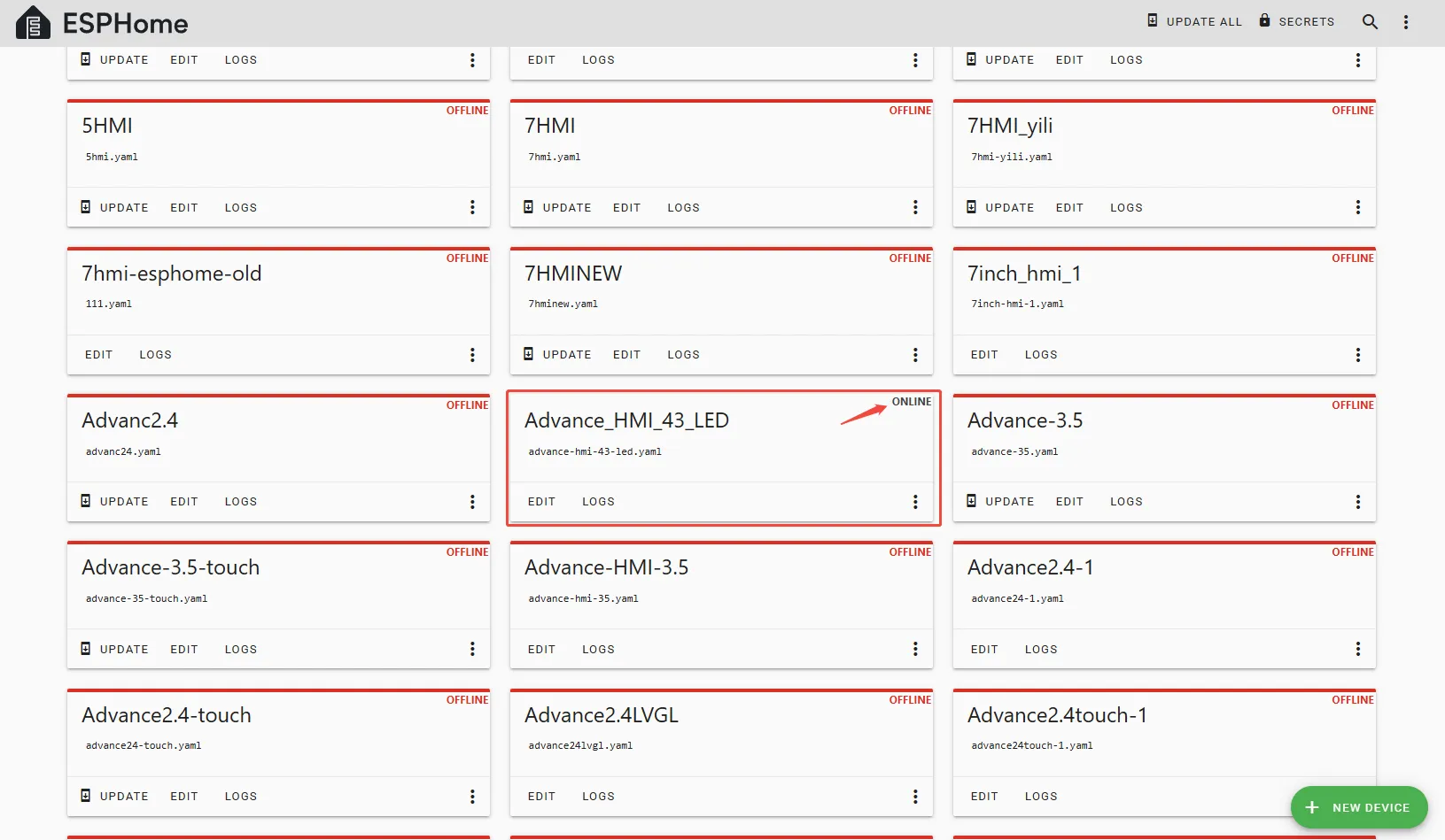

After successfully flashing the .bin file, return to the ESPHome page in Home Assistant. Restart the ESP32 display, and you should see the device you created earlier show as ONLINE in the top right corner.

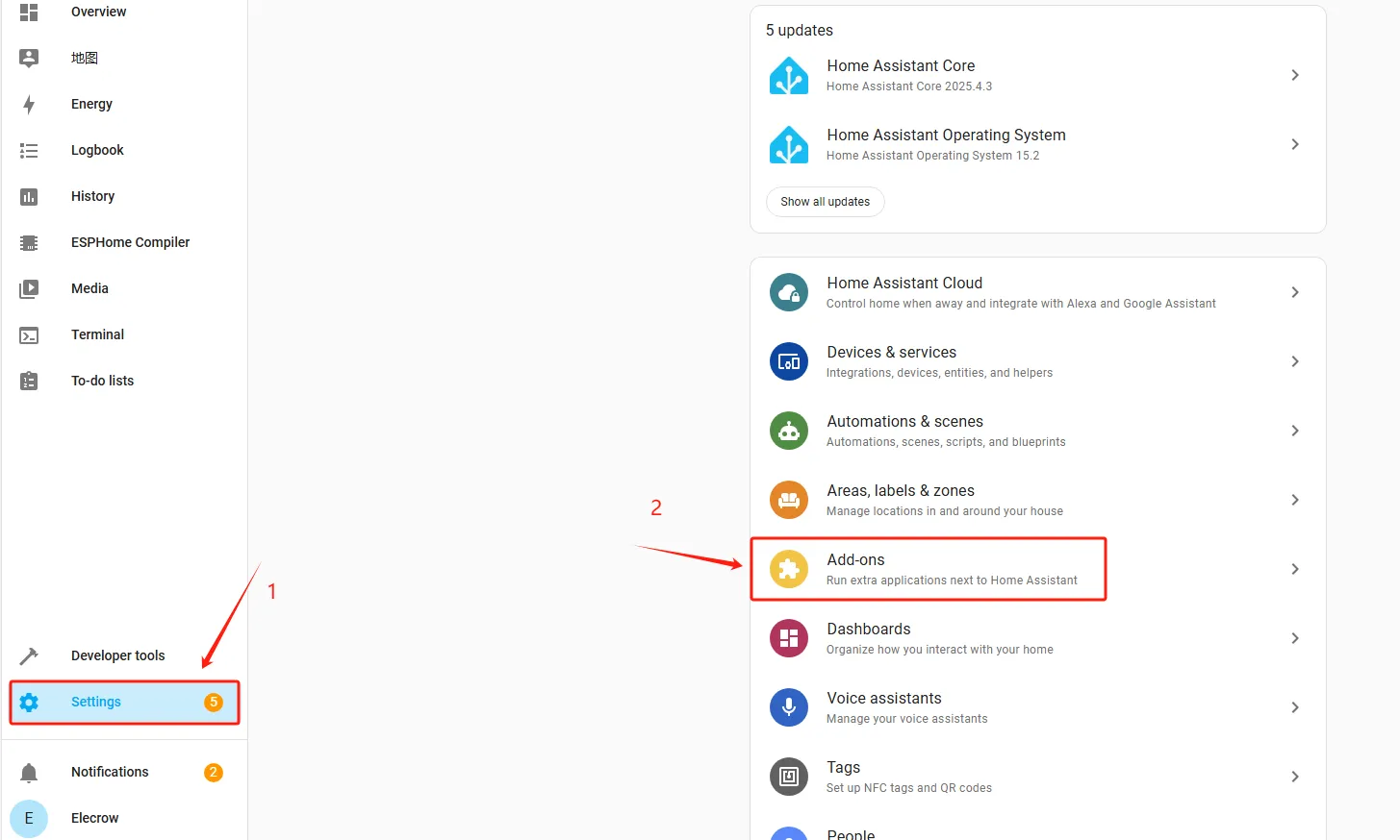

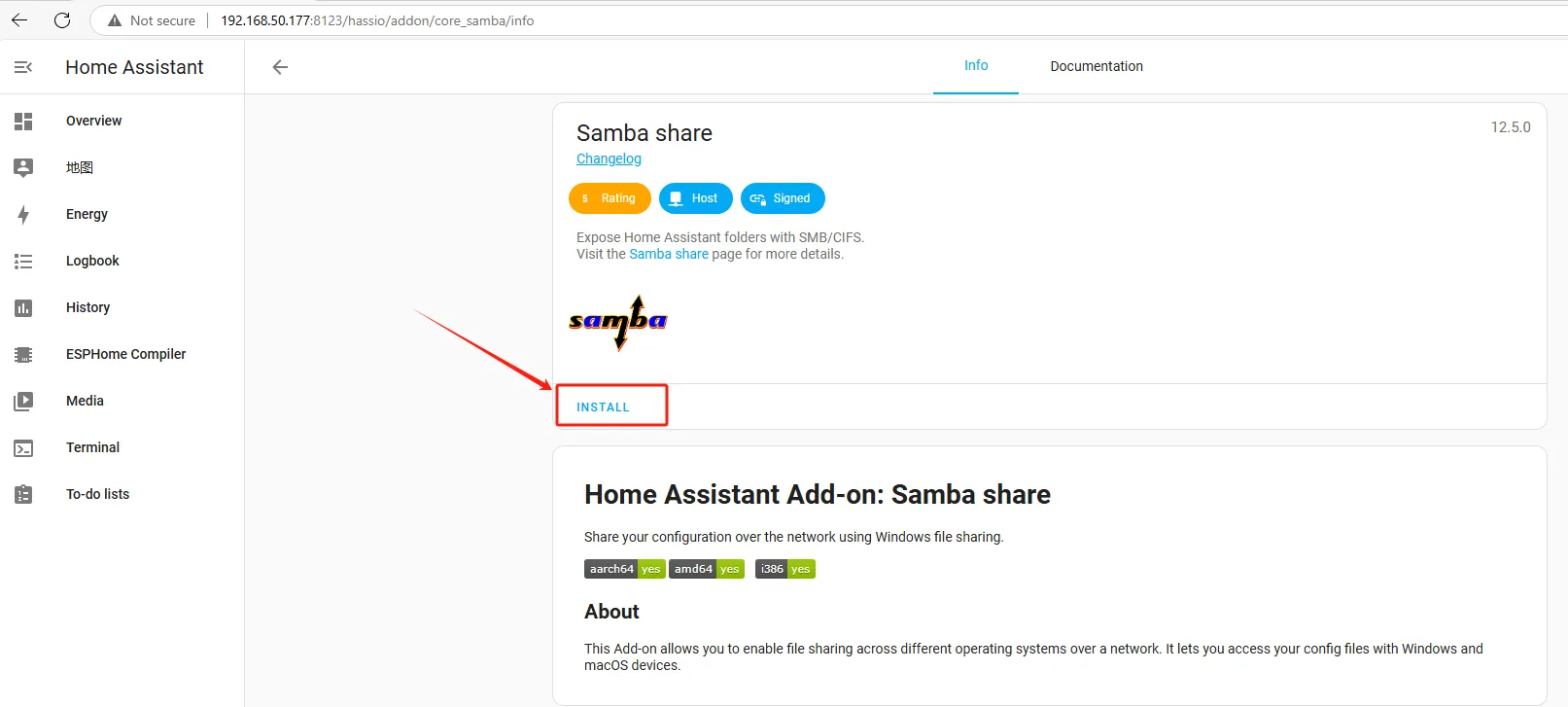

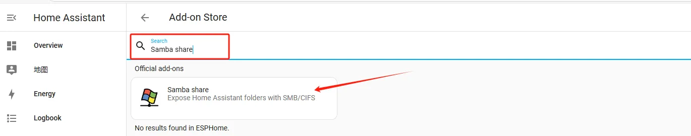

Click Settings and select Add-ons
Then, click the ADD-ON STORE at the bottom right corner
Search for Samba share at the top
Click INSTALL to install it

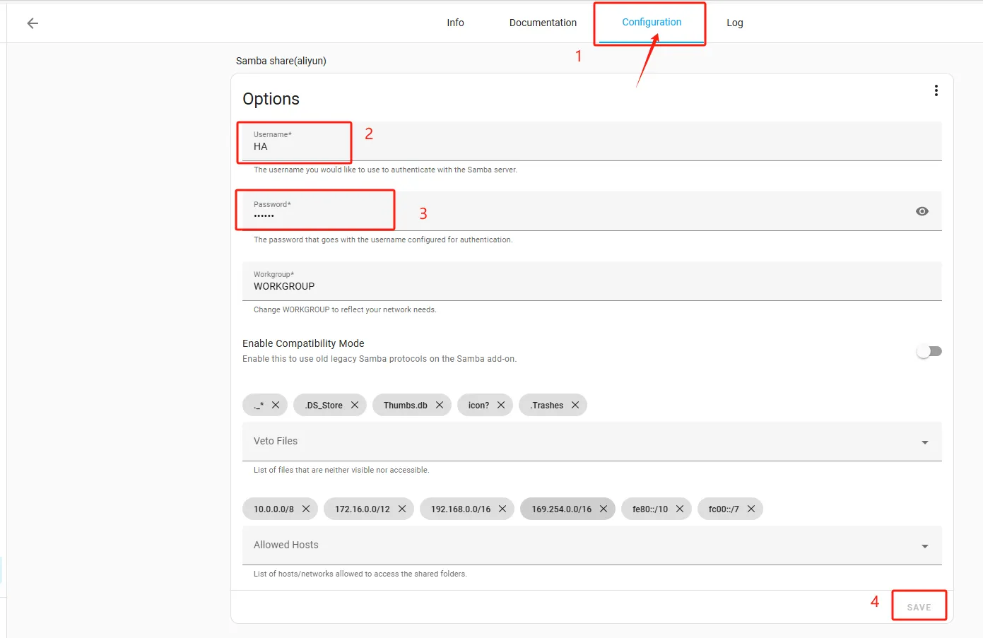

After installation, configure your Samba share with your own username and password—please remember them!

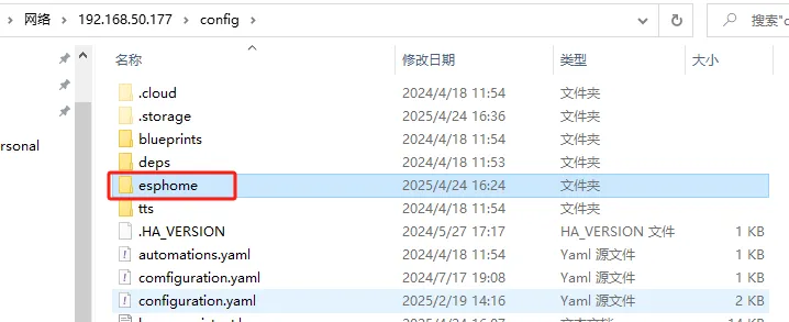

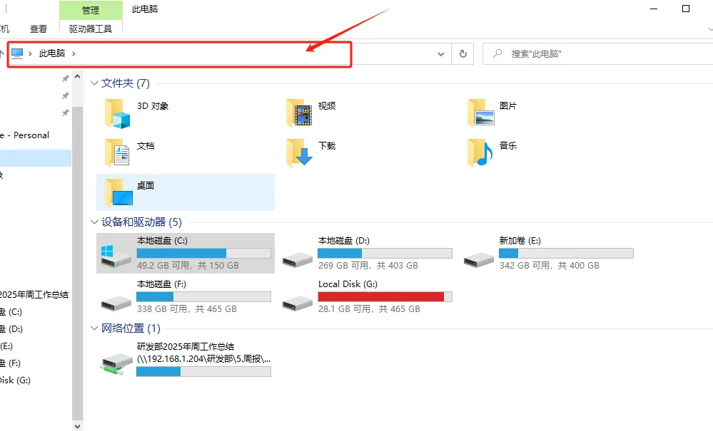

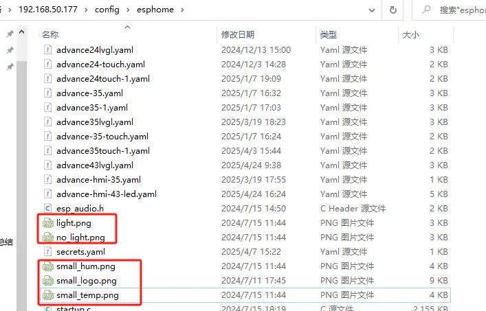

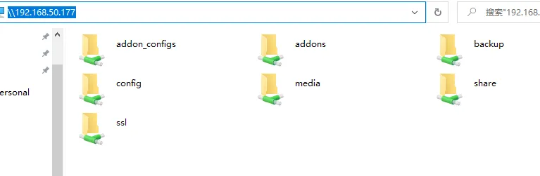

After saving, go to the File Explorer on your computer
Enter \ + your Home Assistant IP address

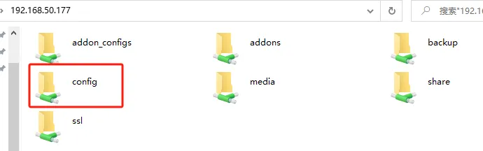

Go to config
Then choose esphome
Put the materials you just downloaded into the esphome folder
That completes the mission of Samba share.

1 WiFi
Here you need to use the Wi-Fi name and password under the same local network as your computer's IP.

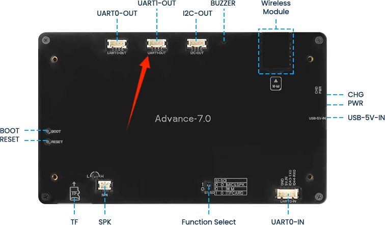

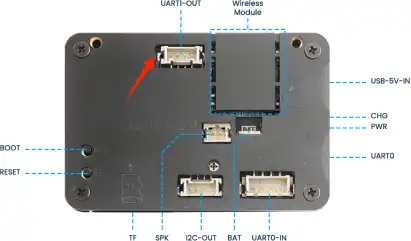

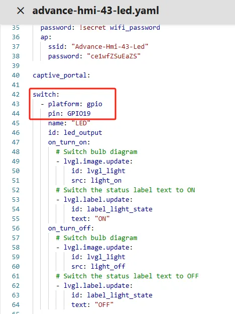

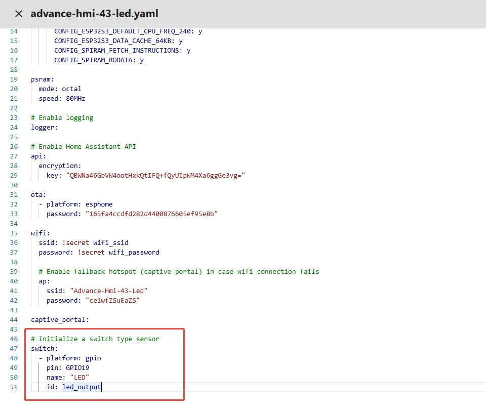

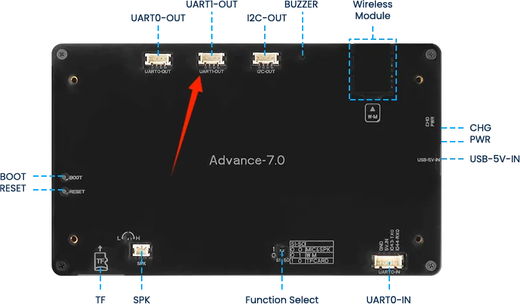

2 LED Pin
For this LED control pin
Here, GPIO19 corresponds to the UART1-OUT of the Crowpanel Advance ESP32 HMI Display that you have connected.
For the 7.0-inch, 5.0-inch, and 4.3-inch products, the required pin is GPIO19.
For the 3.5-inch, 2.8-inch, and 2.4-inch products, the required pin is GPIO18.
Note: Due to a hardware circuit issue with the 2.8-inch and 2.4-inch Crowpanel Advance ESP32 HMI Displays, the I2C address of the touchscreen conflicts with that of the DHT20 temperature and humidity sensor, making both unusable when connected simultaneously. Therefore, for the 2.8-inch and 2.4-inch displays, we only use the UART1-OUT interface to connect the DHT20 sensor, and the light bulb is not used with these two sizes. For other sizes, such as 7.0-inch, 5.0-inch, 4.3-inch, and 3.5-inch displays, both the DHT20 sensor and the small light bulb can be used.

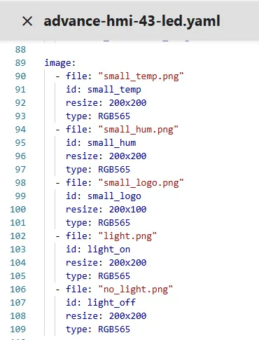

3 Materials
These are the materials we just uploaded, and you can resize these images here.

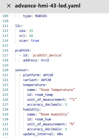

4 DHT20 Temperature and Humidity Sensor
Here, we initialize the temperature and humidity sensor connected to pins 15 and 16.
We also initialize the DHT20 temperature and humidity sensor.

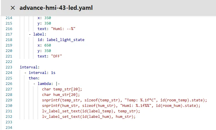

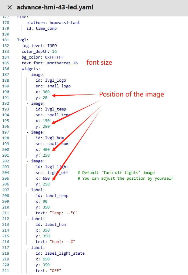

5 Material Positions
Here we can also customize the position and font of the materials.
6 Value Update
At the end, set the update time for the temperature and humidity values (refresh every second).
That’s the code introduction.

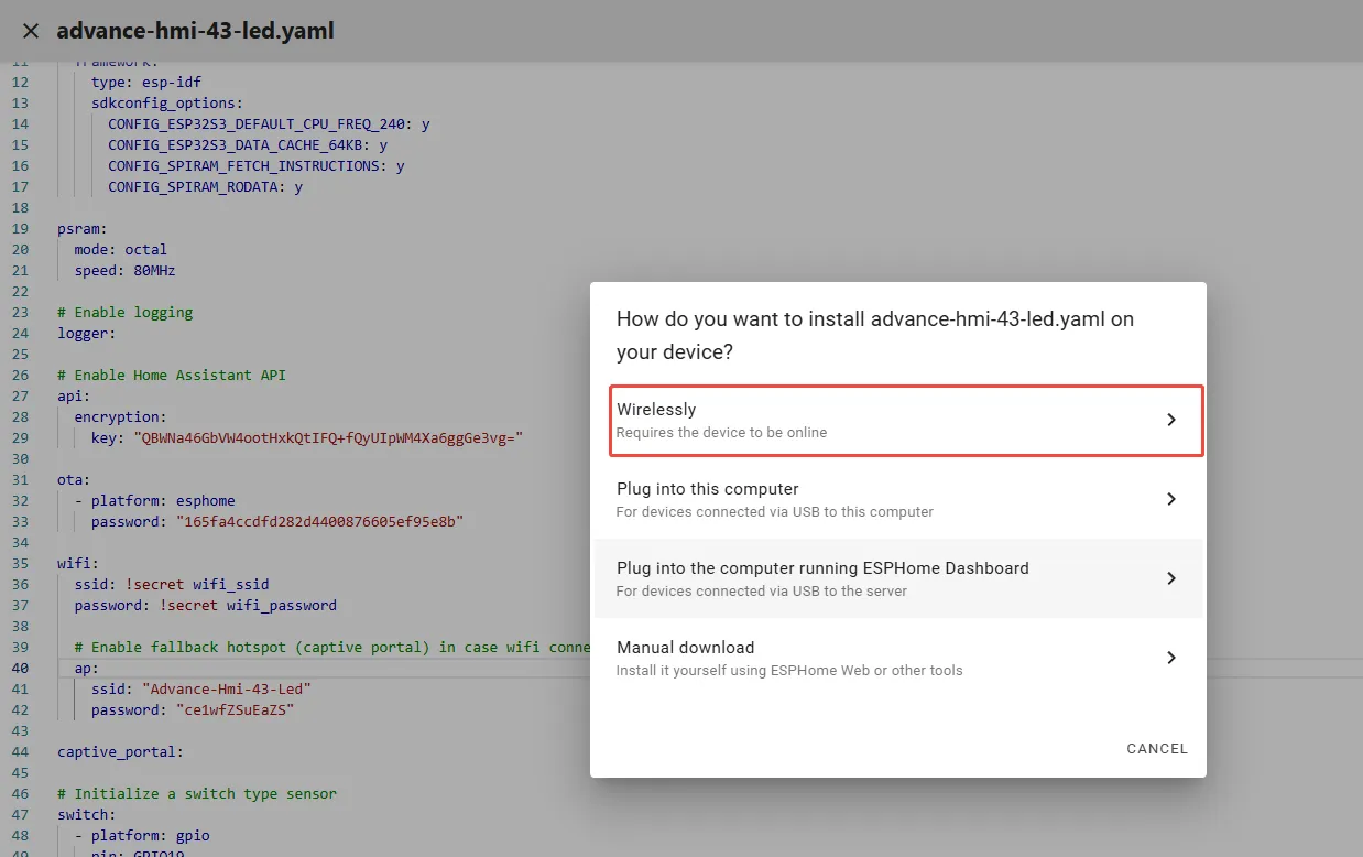

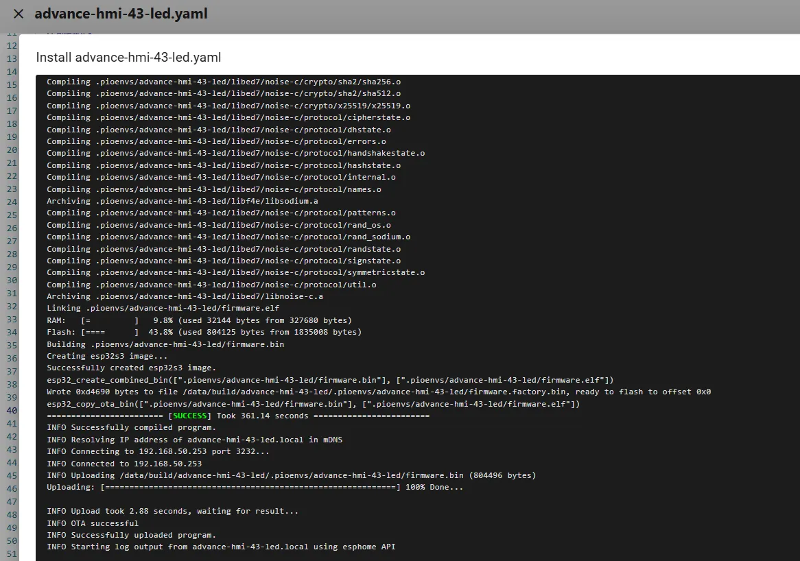

Next, we will flash the code.

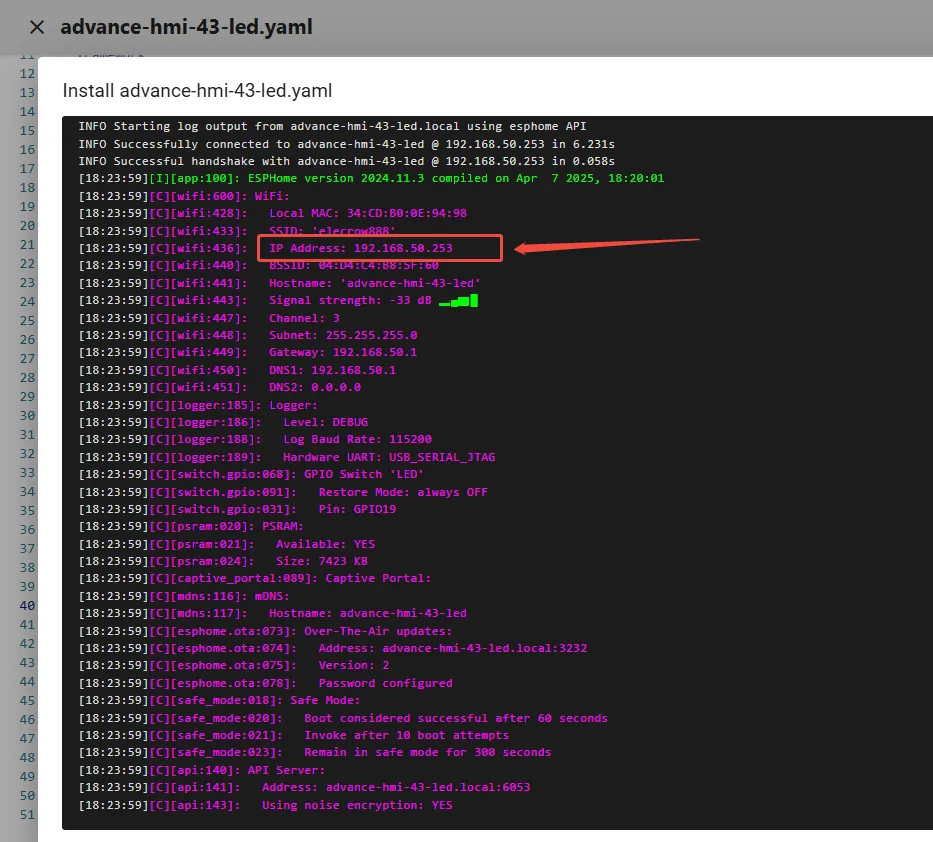

After editing the program, click "Install" and select "Wireless". This method is very convenient for us.

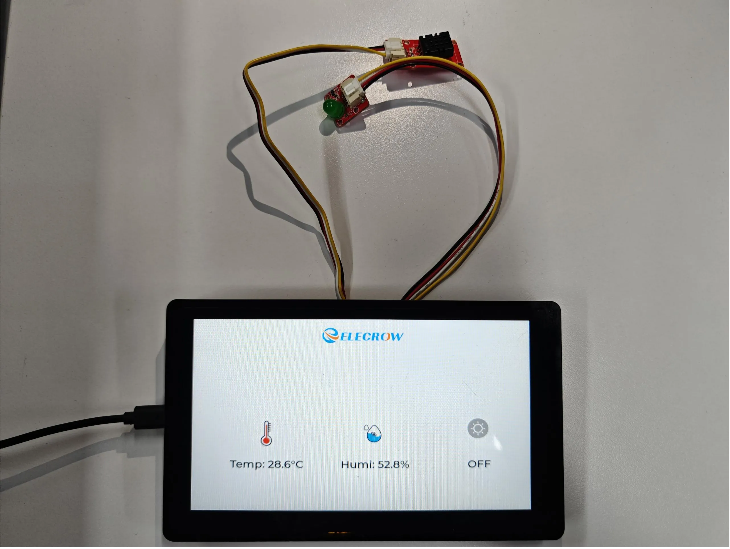

After a successful flash, the following interface will appear.
Scroll the mouse wheel to view the IP address of the Crowpanel Advance ESP32 HMI Display and make sure to remember it.

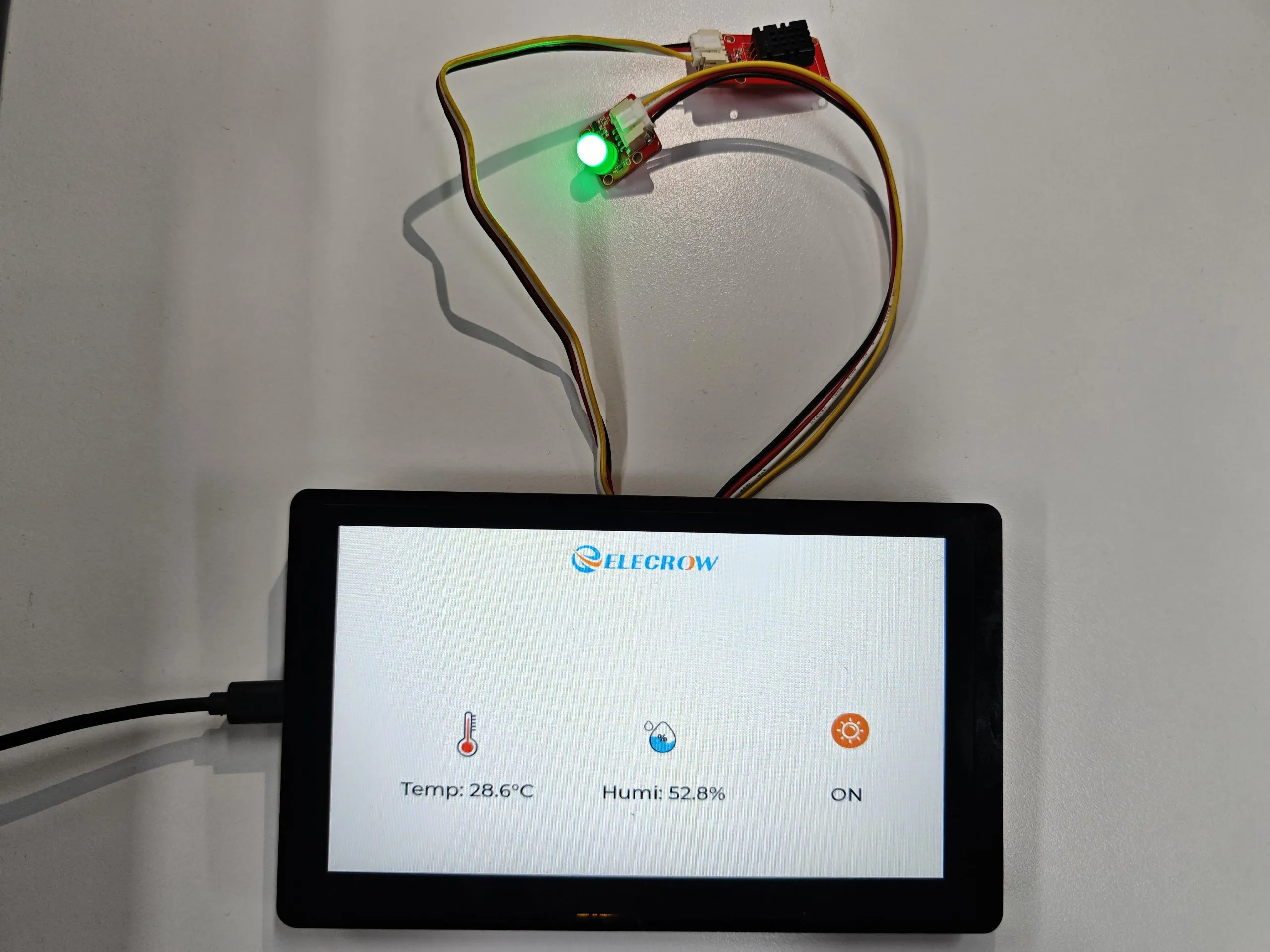

Once the code is flashed, you will see the same interface on your screen as we do.

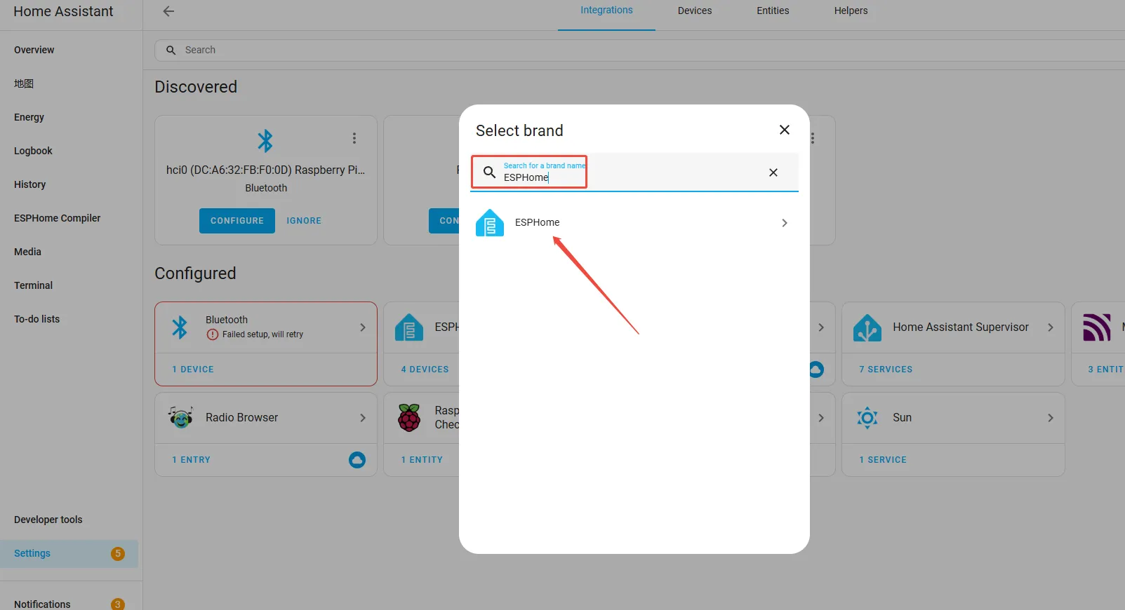

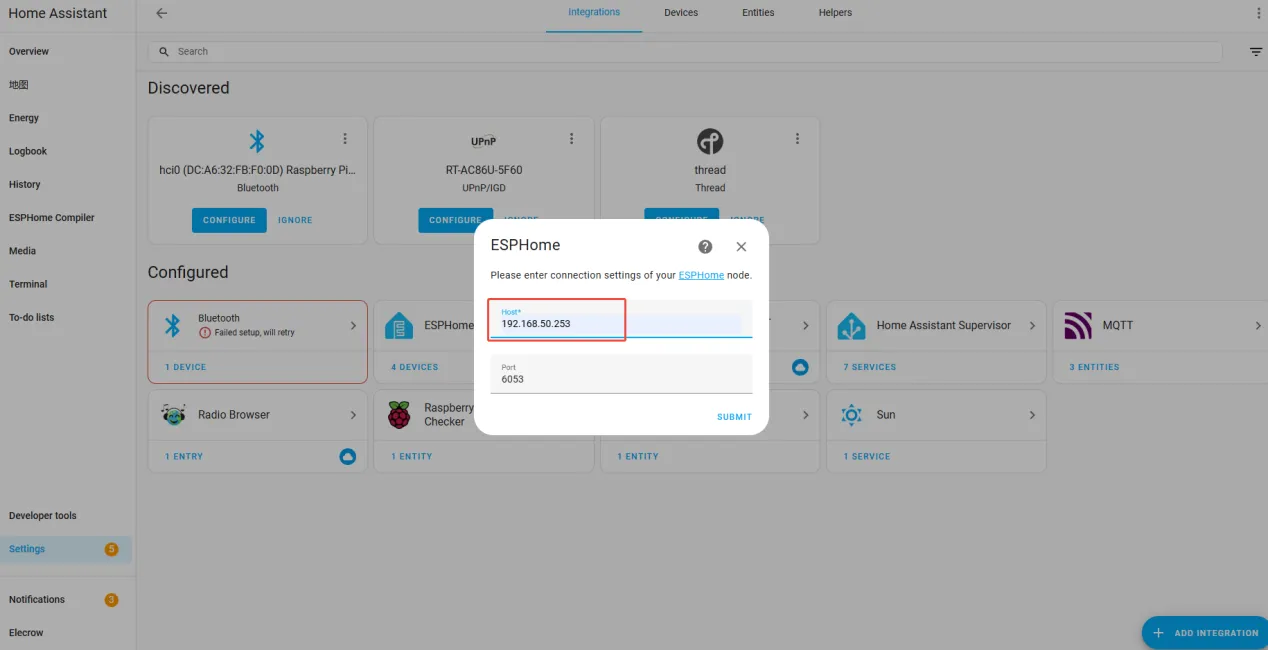

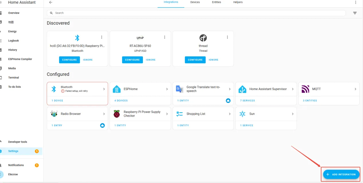

Add the device to ESPHome

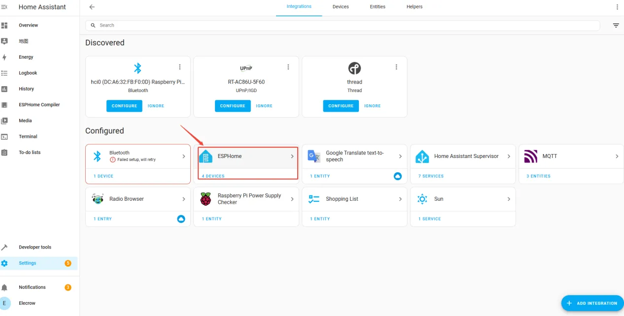

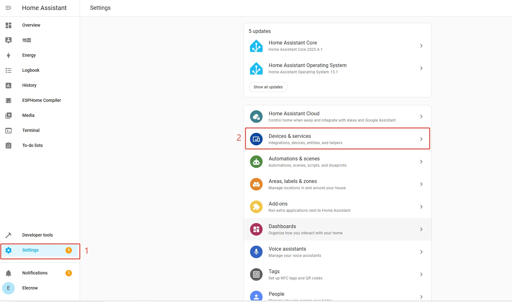

Click Settings → Devices & Services → Add Integration, then enter 'ESPHome' and click on it.
Enter the IP address (which you need to remember). The 'port' is automatically generated.

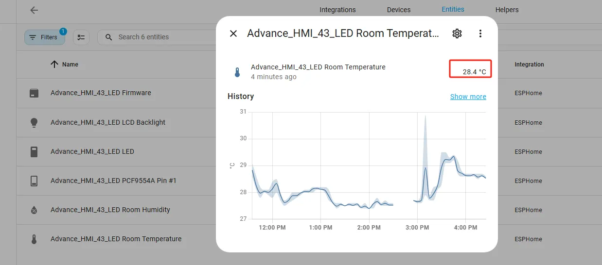

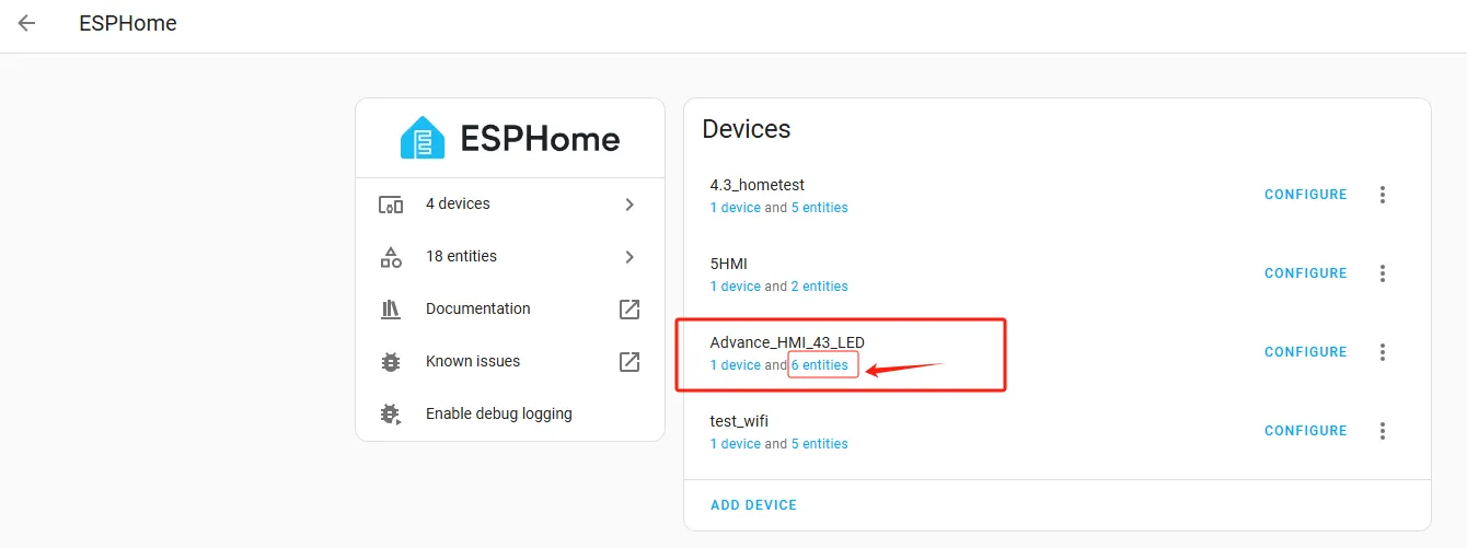

Then, we can see the device we just added.

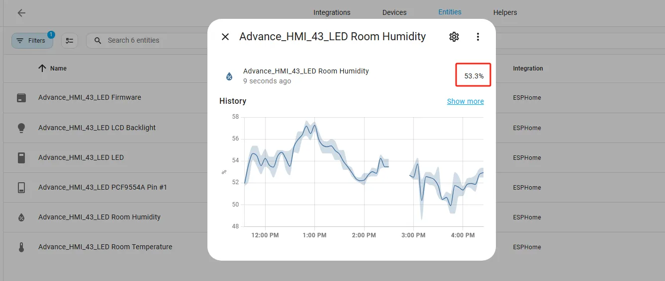

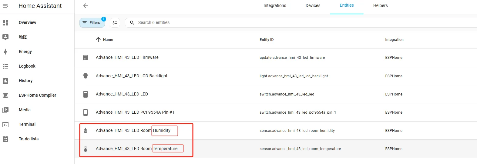

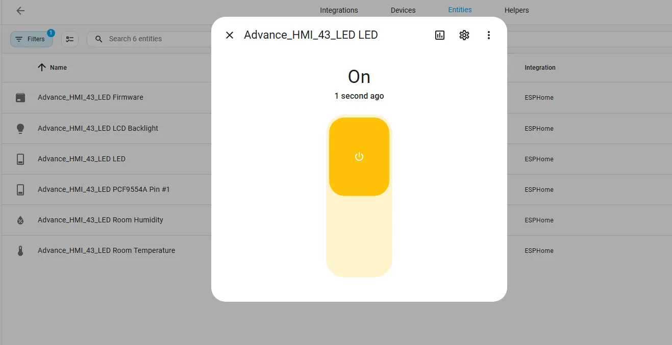

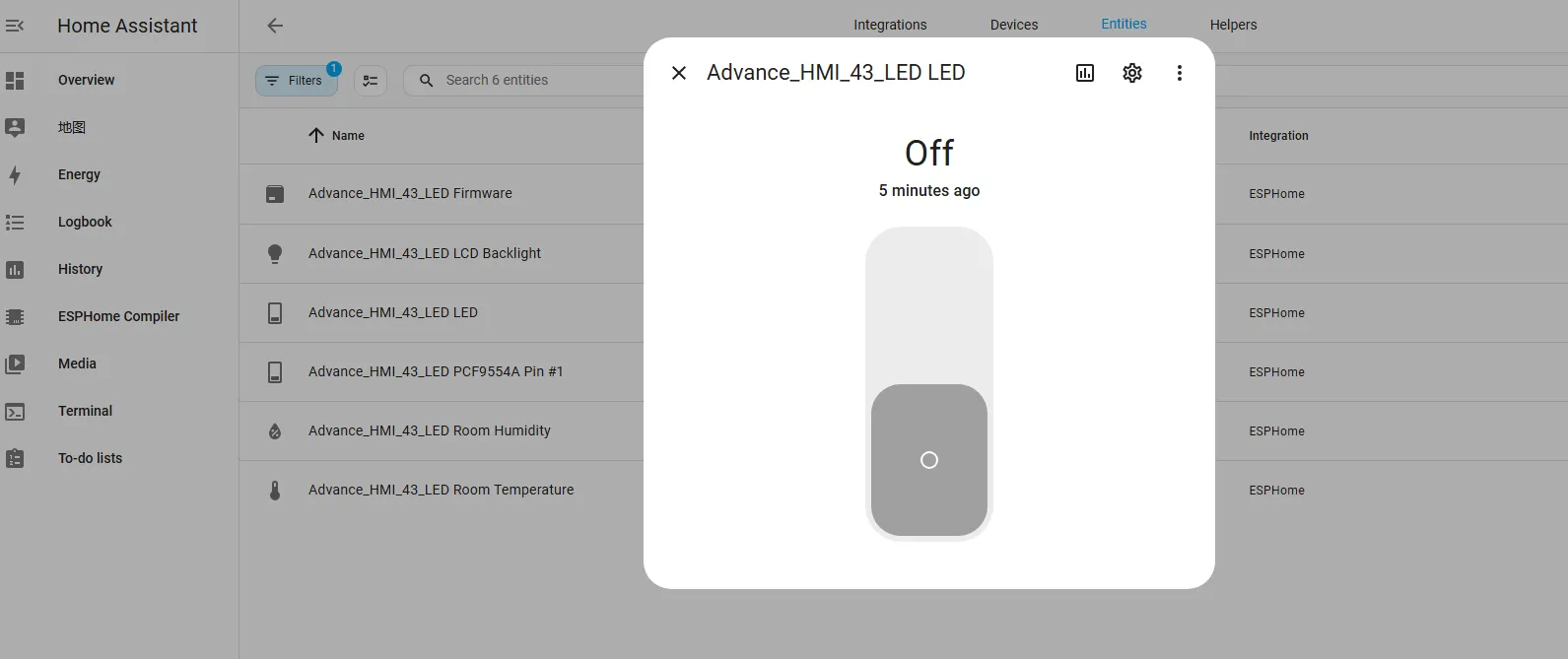

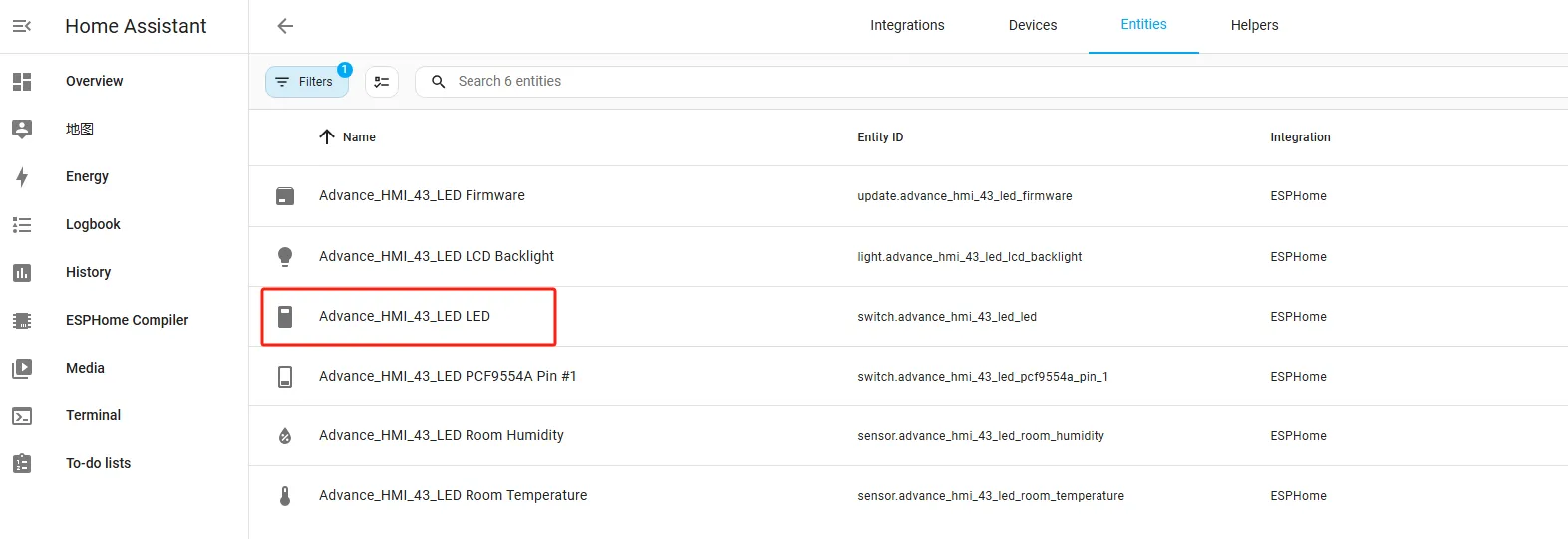

Click on "x entities" to view the available features on the device. x represents the number of entities, such as 6 entities shown below.
After opening and viewing the features, you should see the LED switch that we designed in the code.
Click on it, and you'll be able to successfully control the light bulb connected to the Crowpanel Advance ESP32 HMI Display.
You can also view the historical temperature and humidity data collected in the ESPHome backend.
