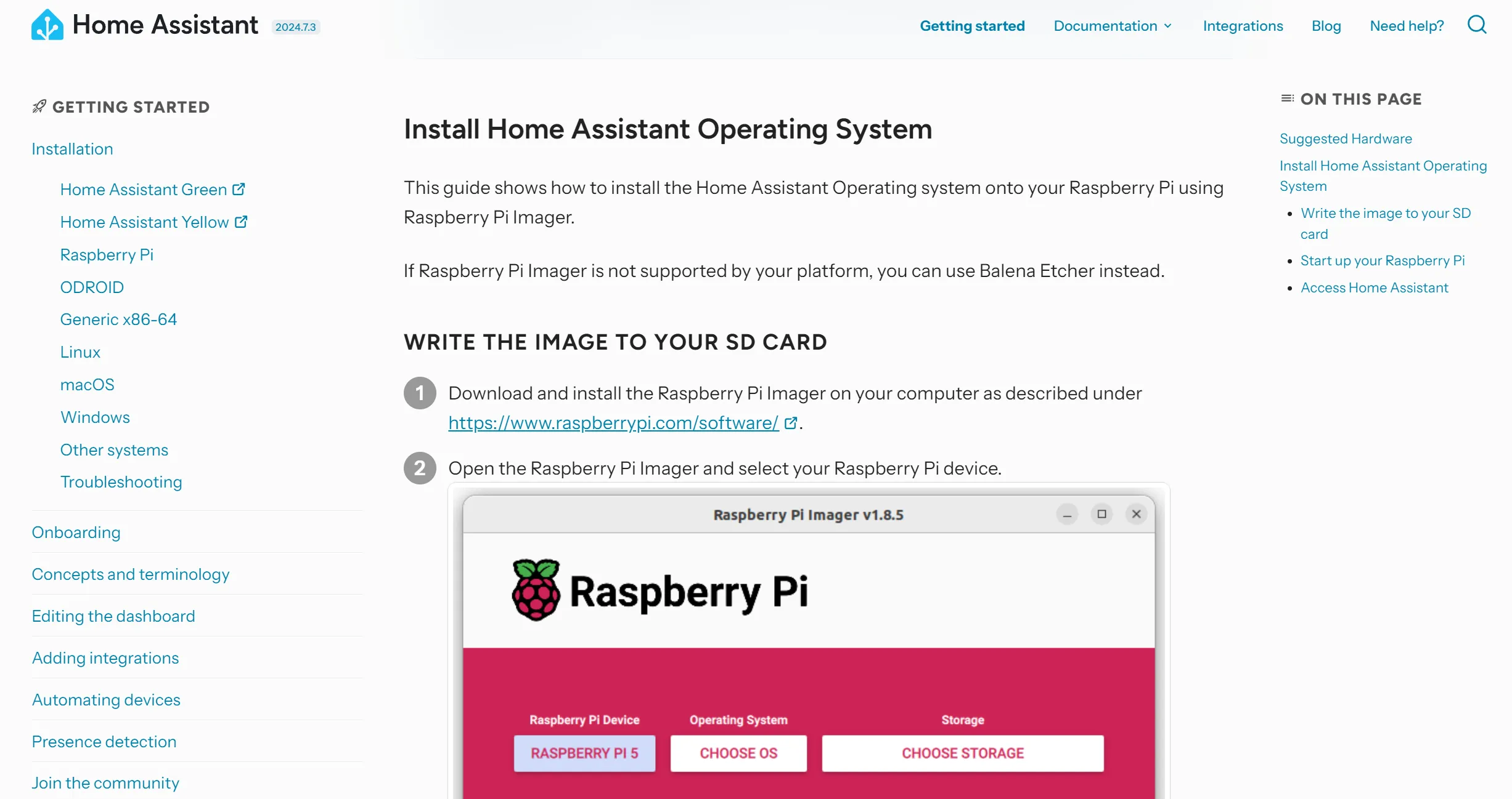

Install Home Assistant OS¶

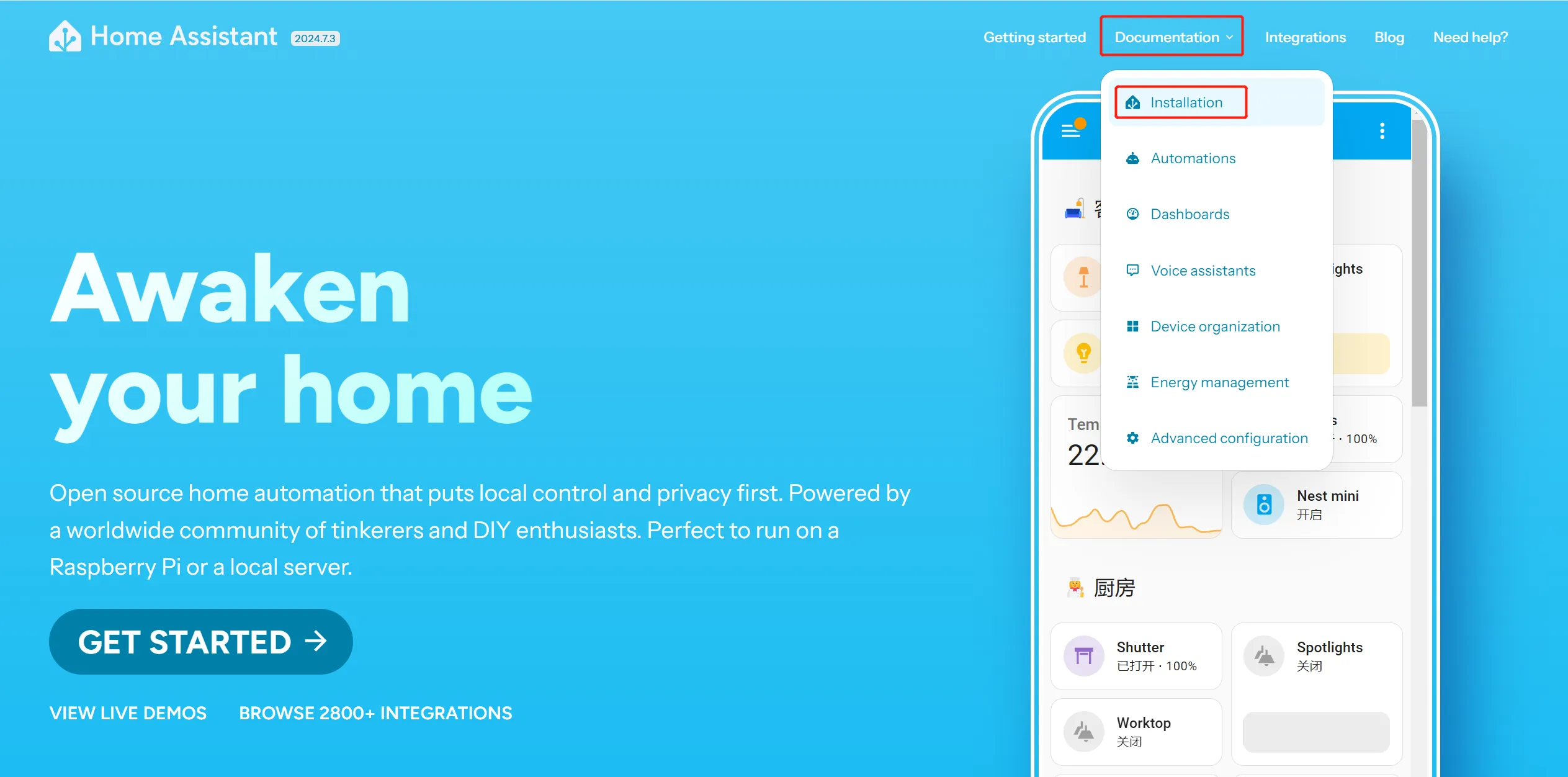

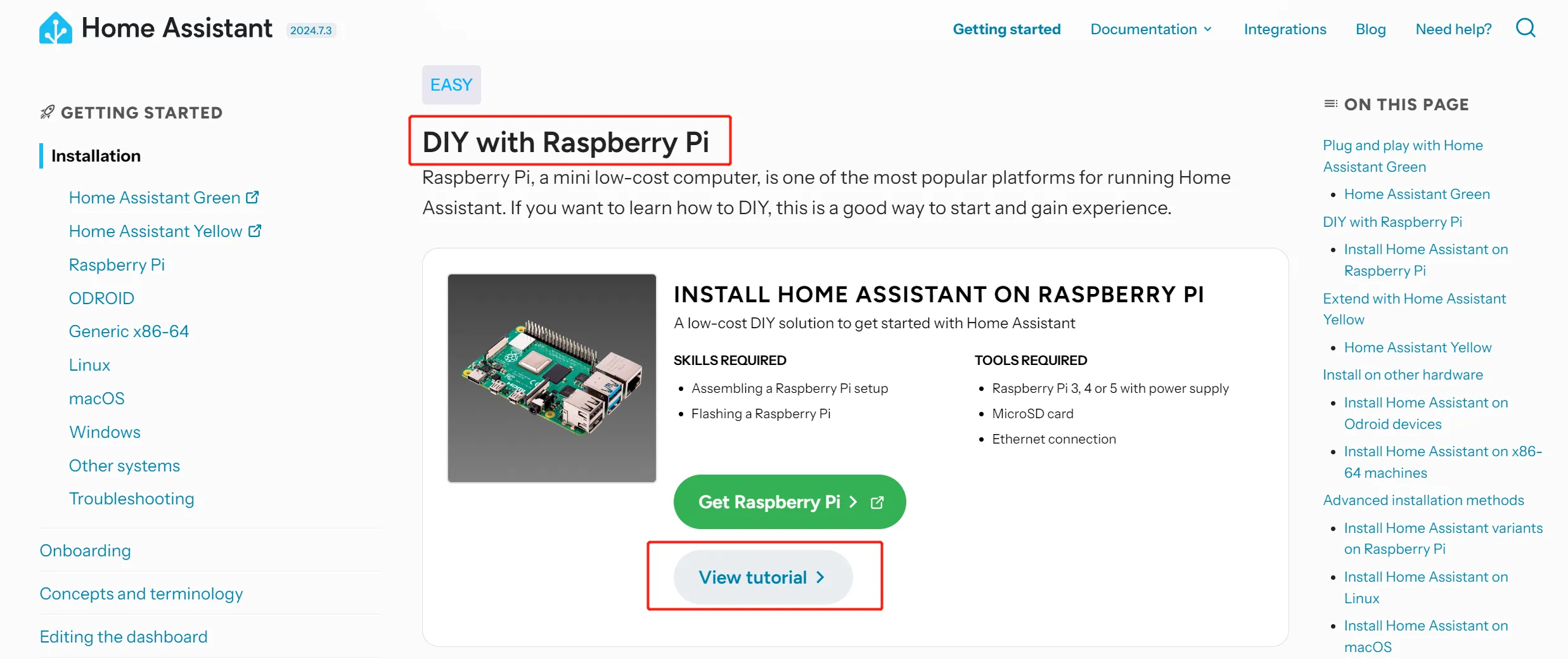

Go to https://www.home-assistant.io/, and click the "Installation" under "Documentation" on the homepage.
Scroll down to the "DIY with Raspberry Pi" section, and click "View tutorial".
Follow the Home Assistant tutorial to install Operating System.

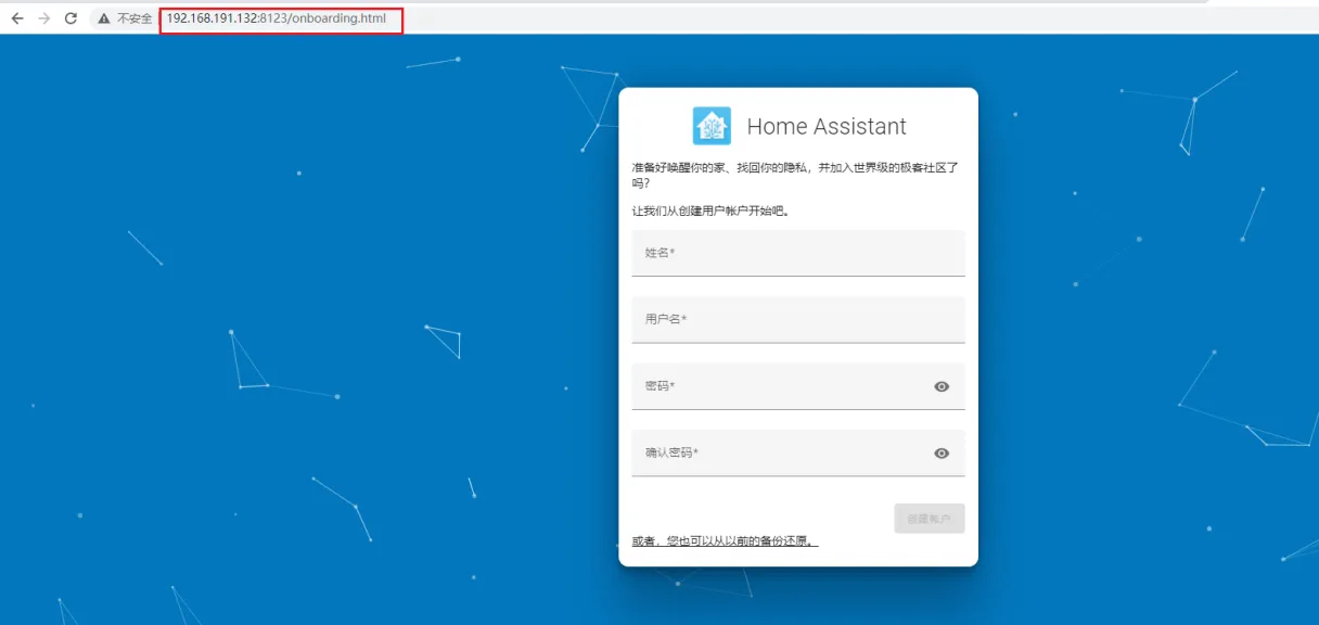

Within a few minutes after connecting the Raspberry Pi, you will be able to reach your new Home Assistant.
In the browser of your desktop system, enter homeassistant.local:8123.
Note
If you are running an older Windows version or have a stricter network configuration, you might need to access Home Assistant at homeassistant:8123 or
http://X.X.X.X:8123(replace X.X.X.X with your Raspberry Pi’s IP address).The time it takes for this page to become available depends on your hardware. On a Raspberry Pi 4 or 5, this page should be available within a minute.
- If it does not show up after 5 minutes on a Pi 4 or 5, maybe the image was not written properly.
- Try to flash the SD card again, possibly even try a different SD card.
- If this did not help, view the console output on the Raspberry Pi.
- To do this, connect a monitor via HDMI.

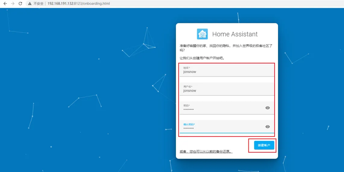

For the first visit, you need to create an account. Fill in the username and password, and create an account.

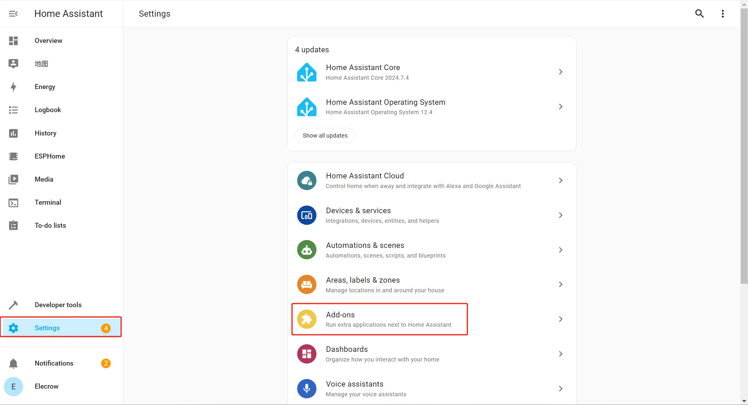

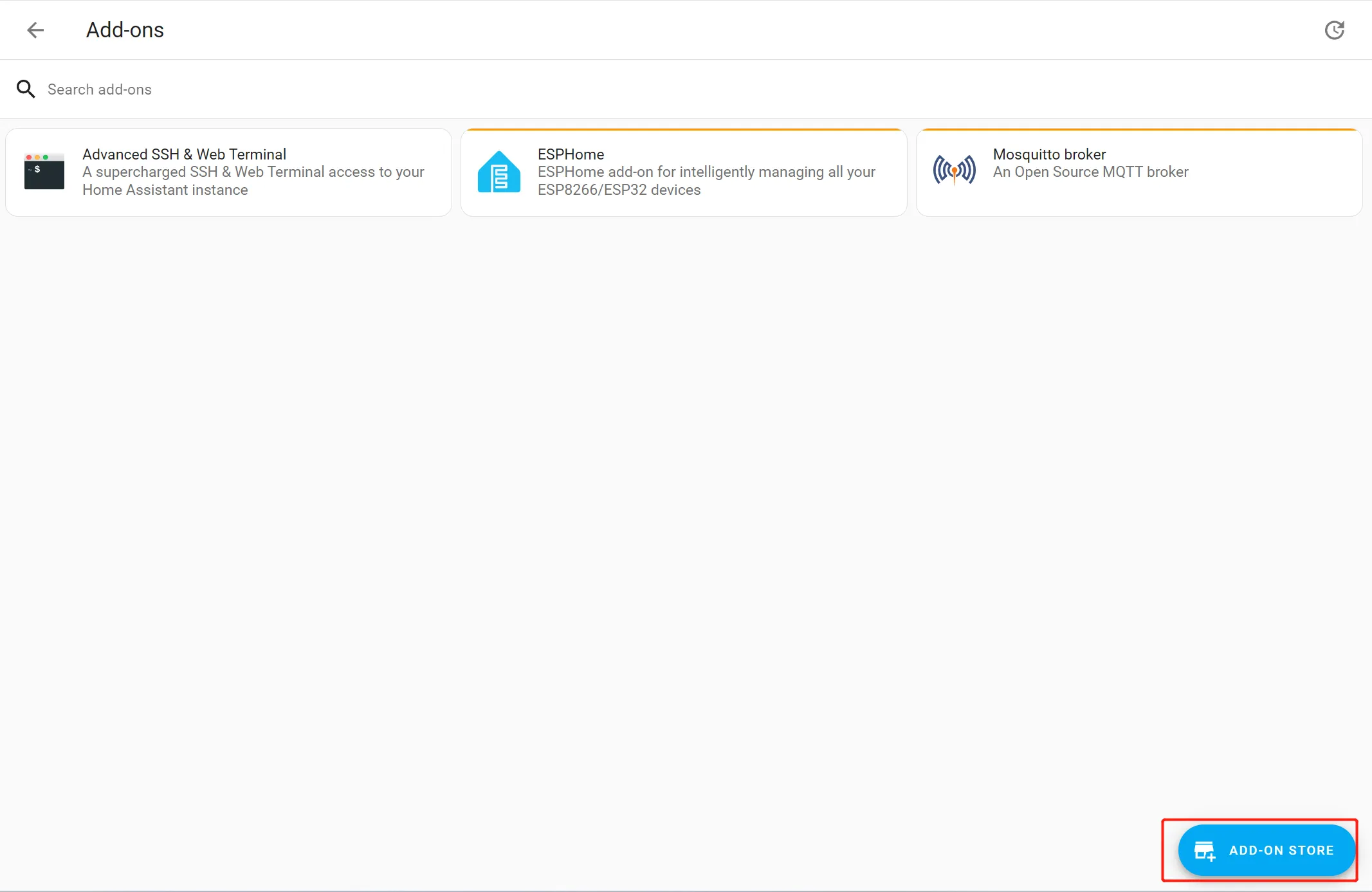

Click "Setting" -> "Add on"

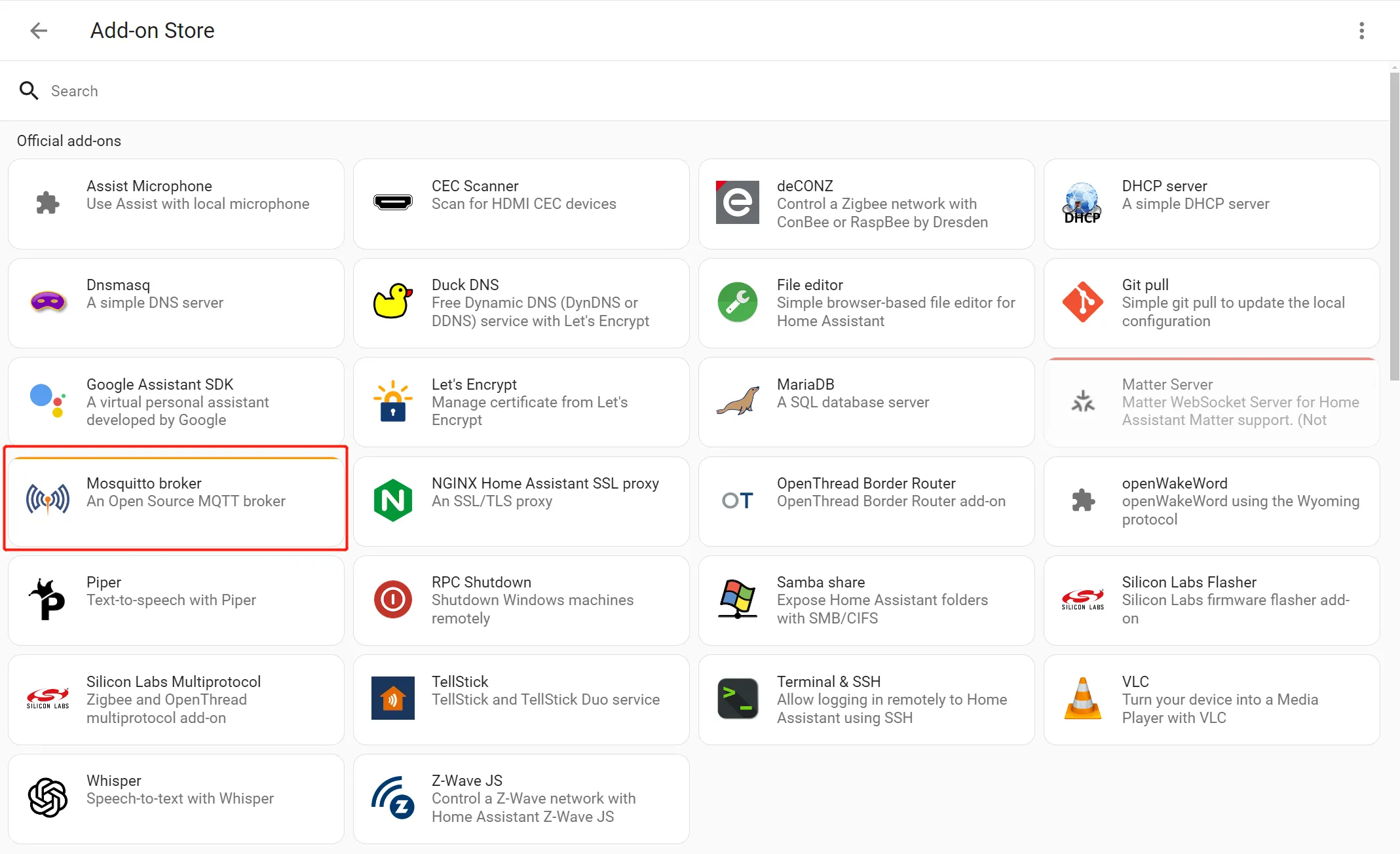

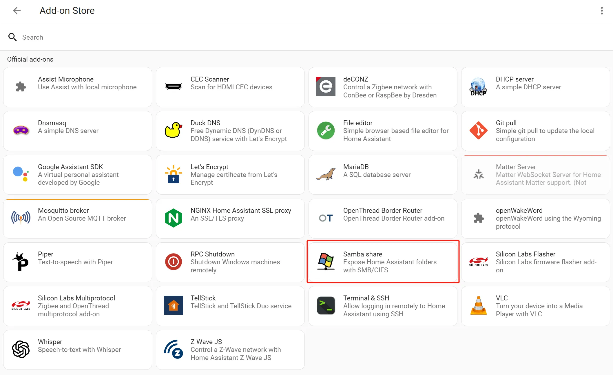

Click ADD-ON STORE

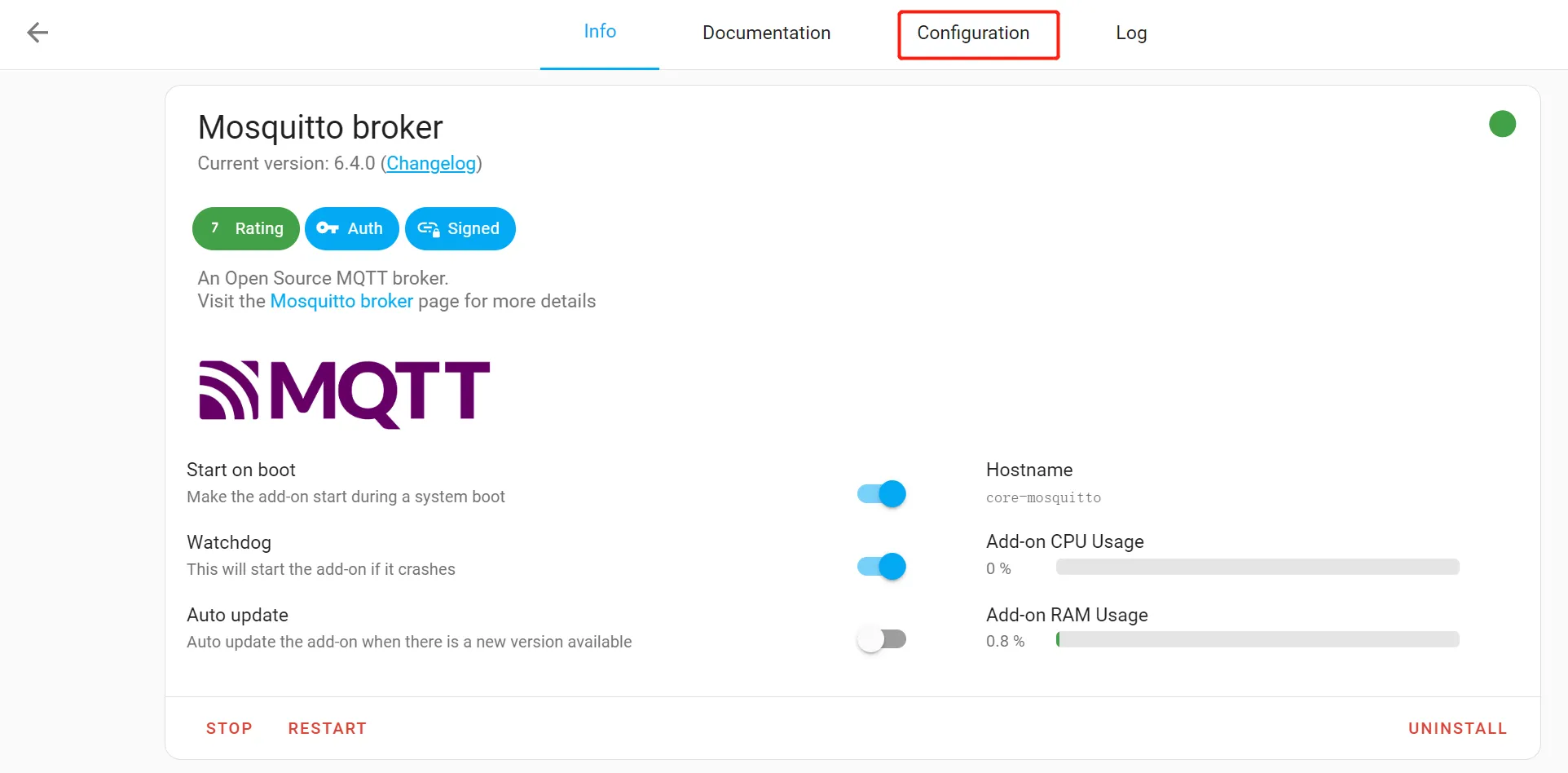

Select "Mosquitto broker" and install
Enable Mosquitto broker

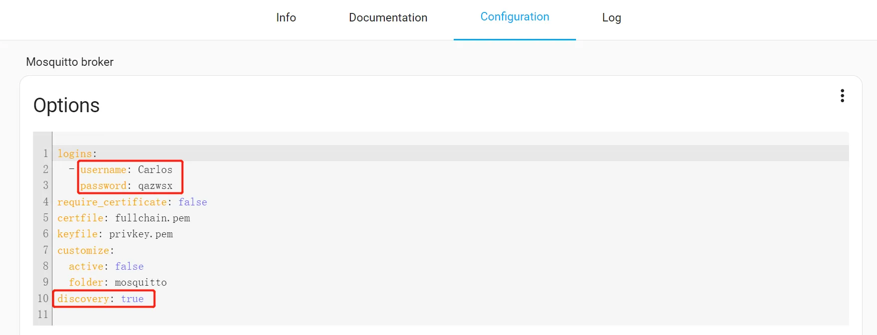

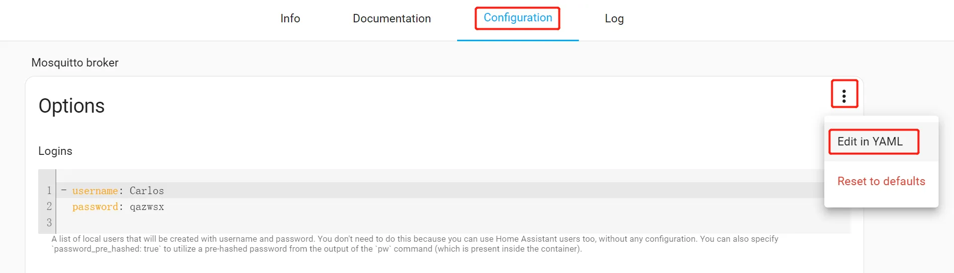

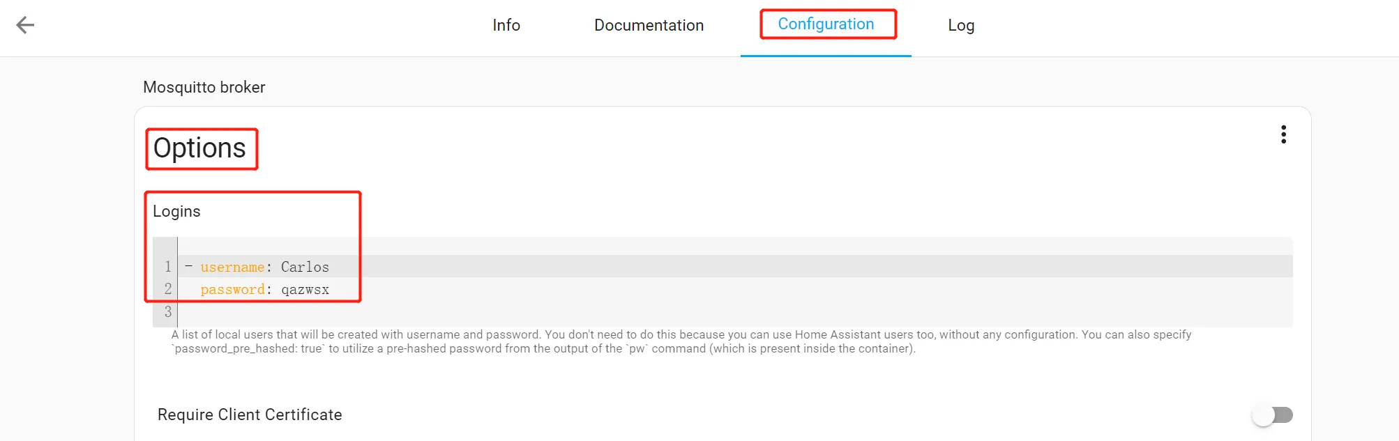

Then click "Configuration" -> "Options" -> "Logins", and set the username and password.
Click the three-dot icon, then click "Edit in YAML"
Modify the username and password, and set the discovery to "true".

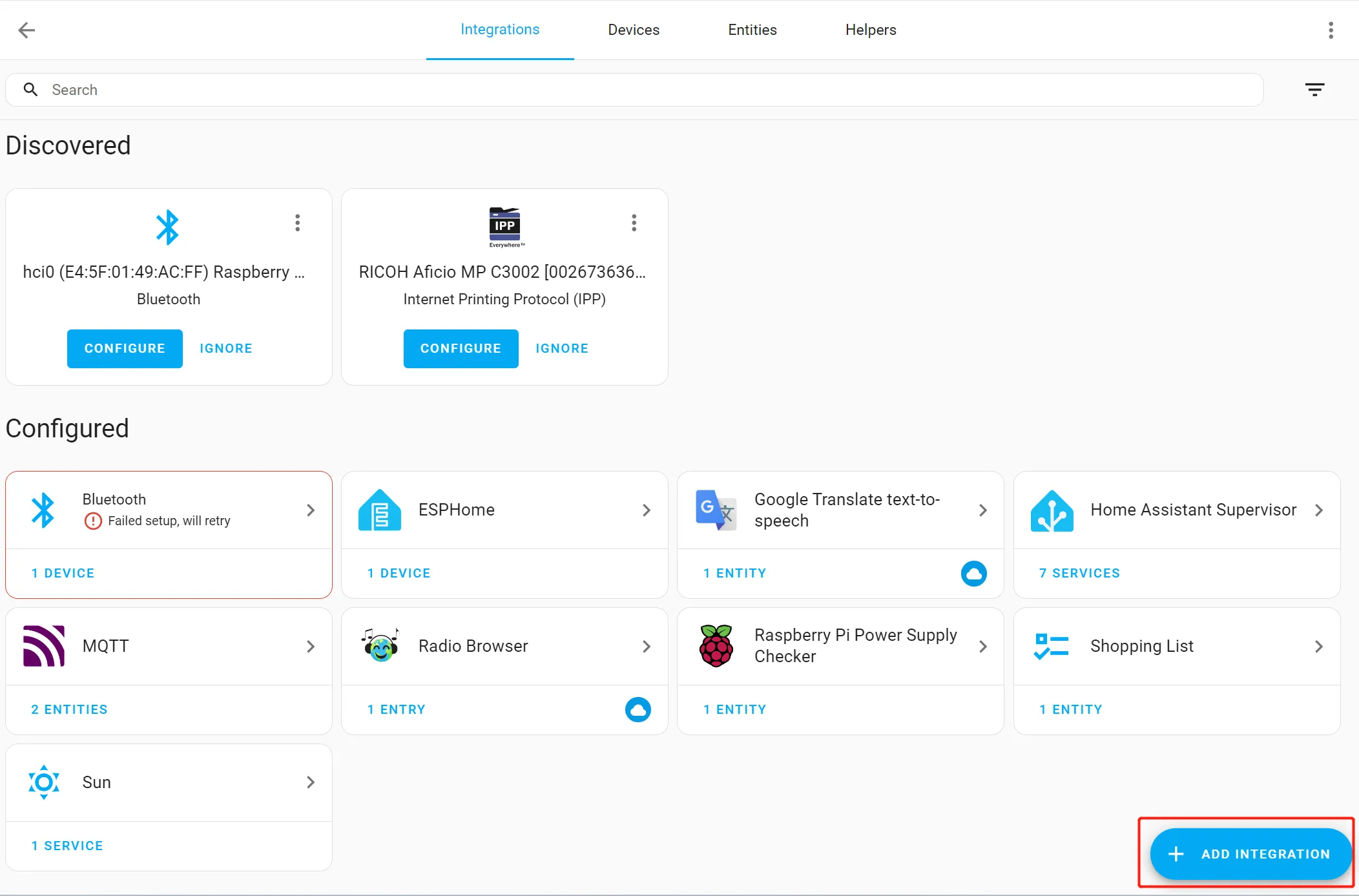

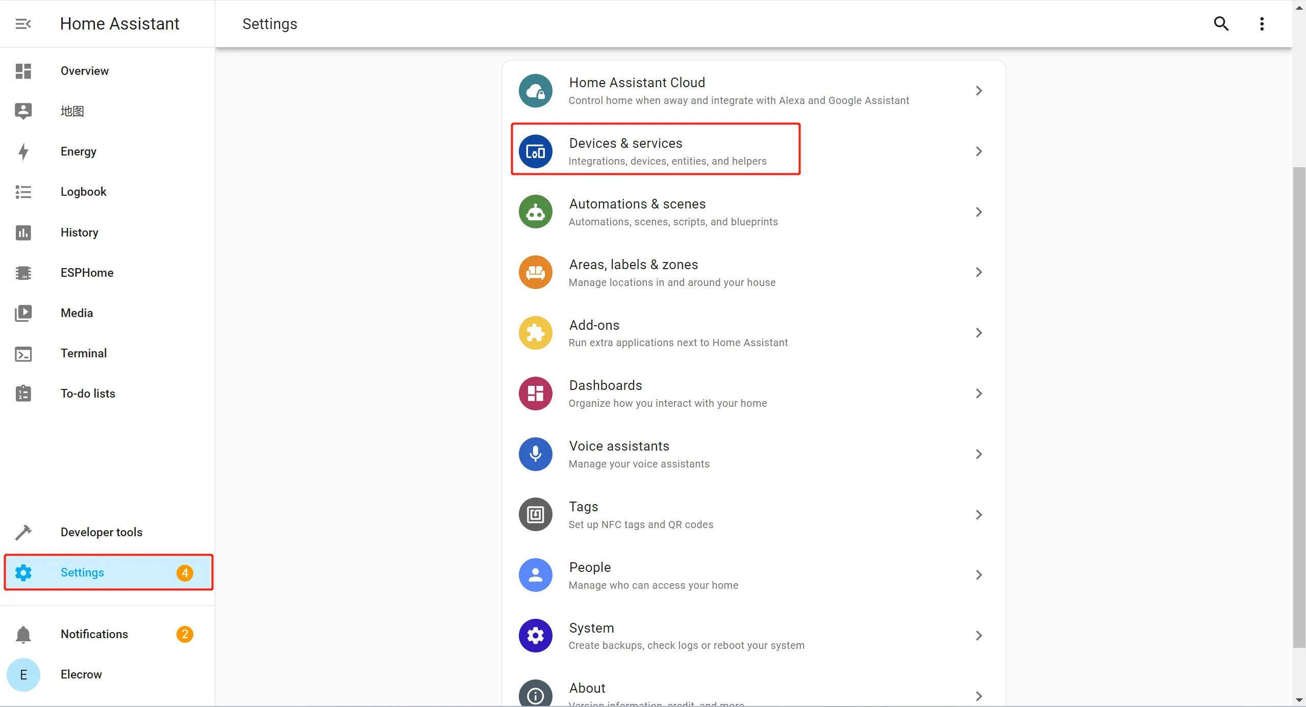

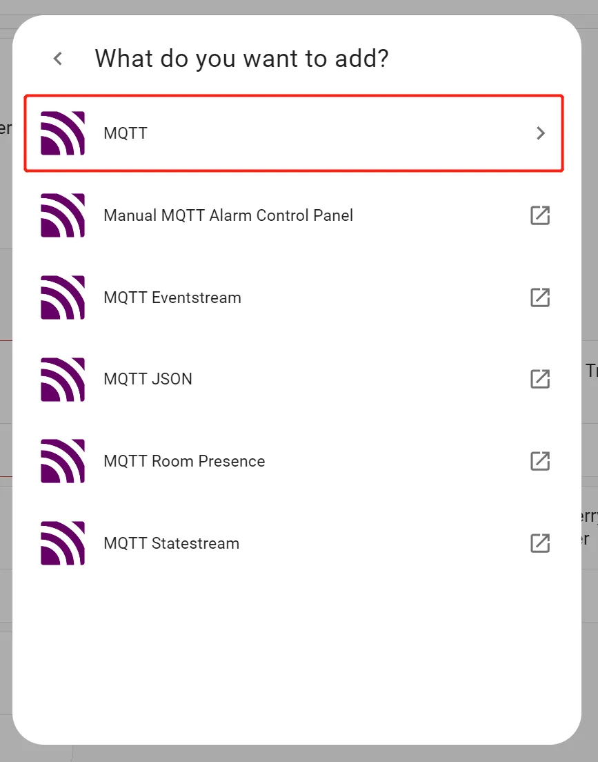

Click "Setting"-> "Devices&Service"

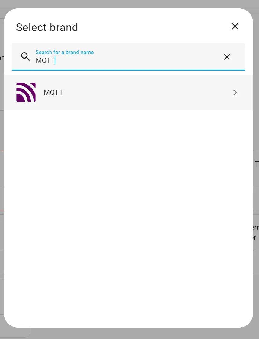

Click "ADD INTEGRATION"

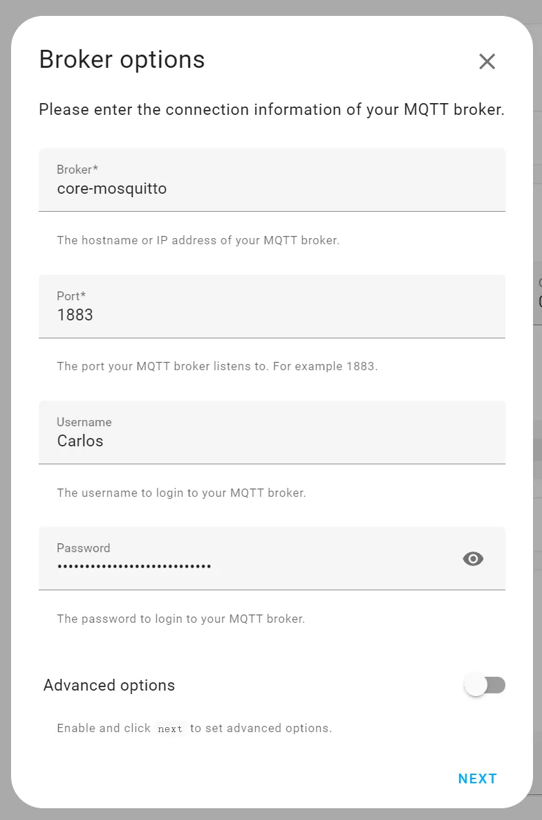

Search for "MQTT"
Configure the MQTT server information (the server address is the address and port number of the Raspberry Pi server, and the username and password are the username and password configured in step 6)

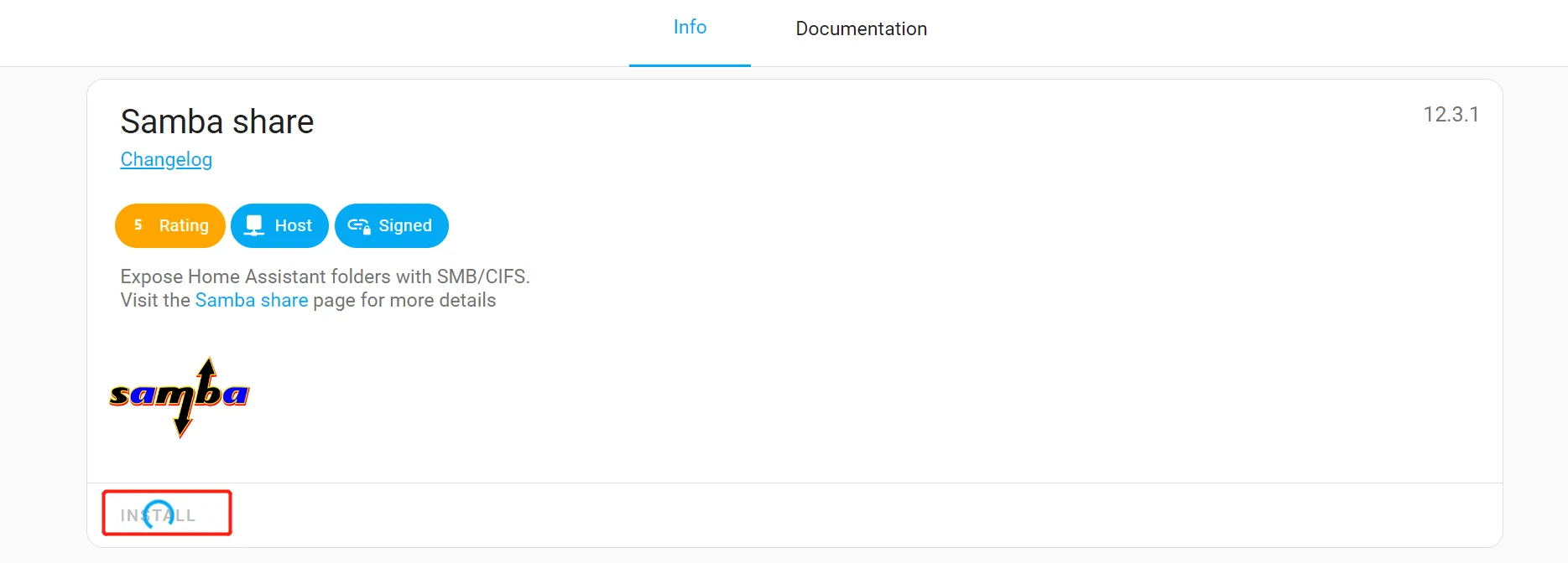

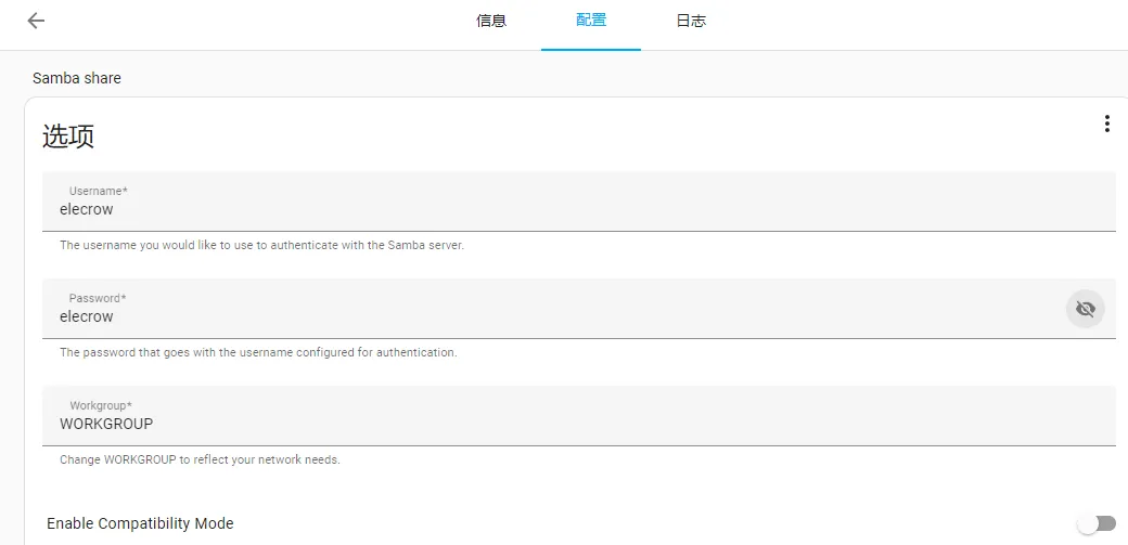

Click "Setting" -> "Add on" -> "ADD-ON STORE", and install Samba share
Enter the Samba share Configuration and enter the Username and Password

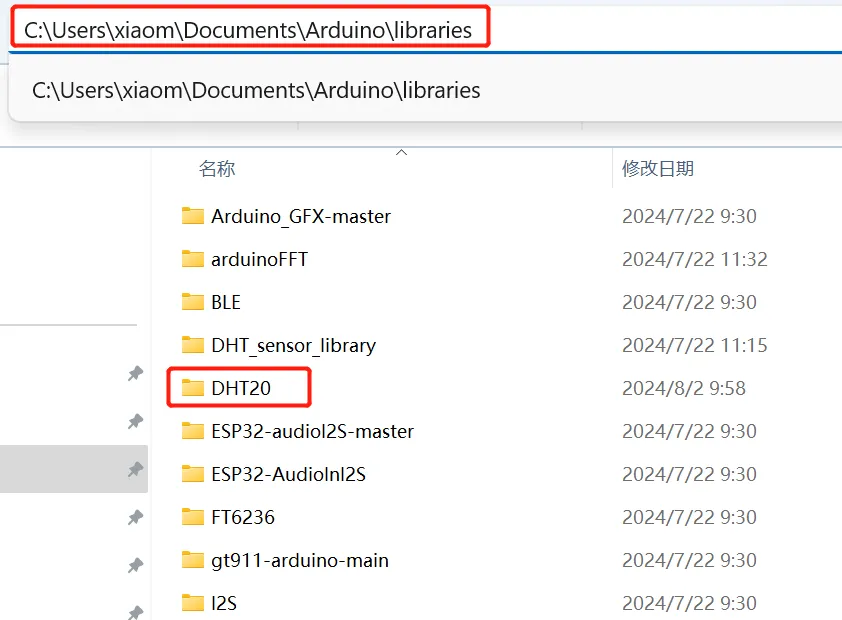

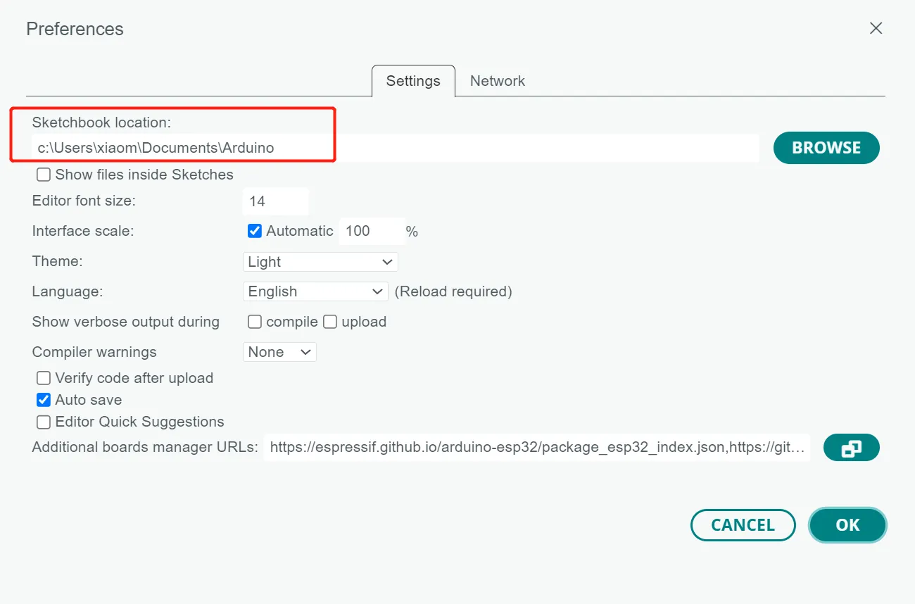

Install "DHT20" library.

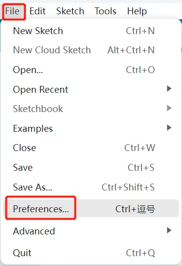

Copy the DHT20 in the libraries folder to the Sketchbook location.
To find the Sketchbook location, please open the Arduino IDE, click "File"->"Preferences"->"Sketchbook Location".

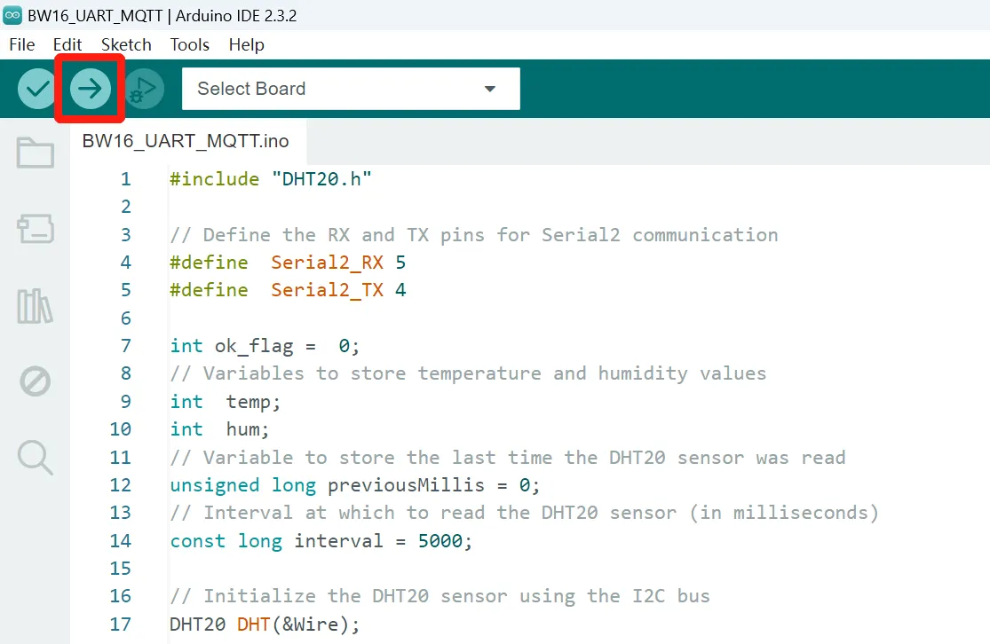

Enter the "HA_MQTT_Demo" folder and open BW16_UART_MQTT.ino

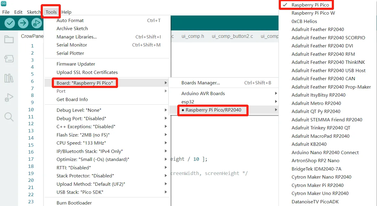

Click "Tool" -> "Board", and select the "Raspberry Pi Pico"
Connect the PICO W5 to the computer, and click "Tool"->"Port" to select the corresponding port number.
Click the "Upload" icon to upload the code. After the program is successfully downloaded, it will be prompted that the download is successful.

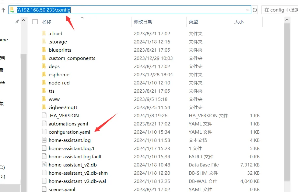

Open "File Explorer" and type in
\\192.168.50.233to enter "config" folder. Open configuration.yaml -
Add the following code in configuration.yaml to add the sensors.

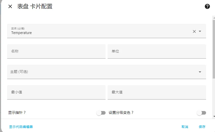

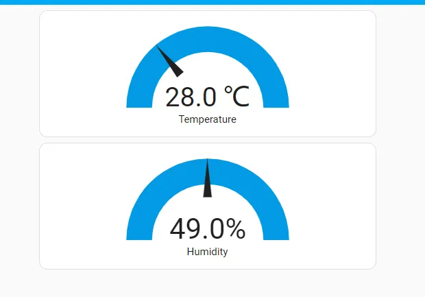

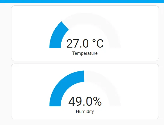

After saving the above code, go to the homepage -> Overview -> Edit Dashboard -> Add Card -> Select the entity just written in configuration.yaml in the card, the save.
Get the temperature and humidity of the environment in real time and display it on the server

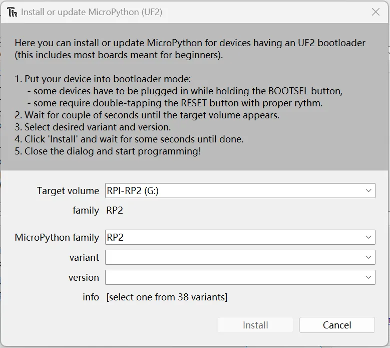

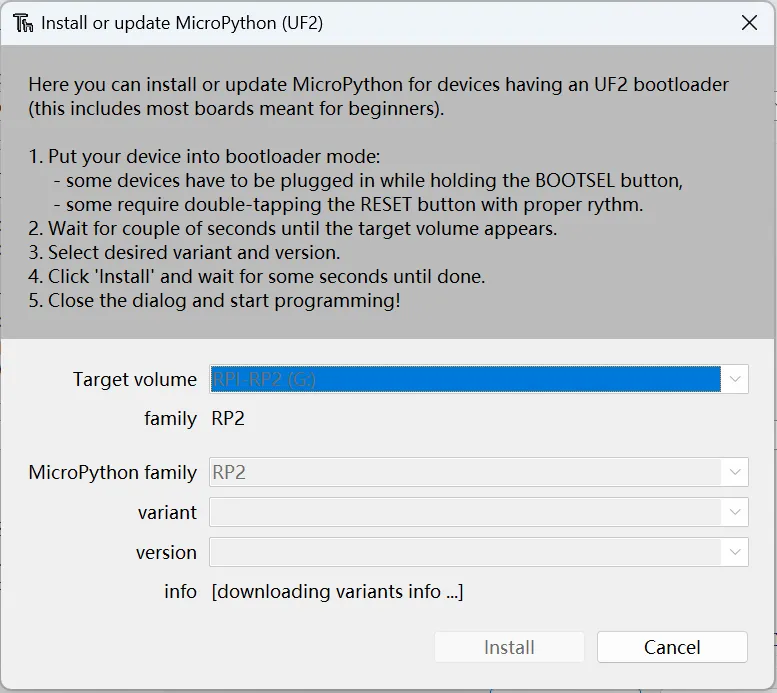

Connect the PICO W5 to the computer. And press BOOT button and REST button at the same time. There will be a U disk

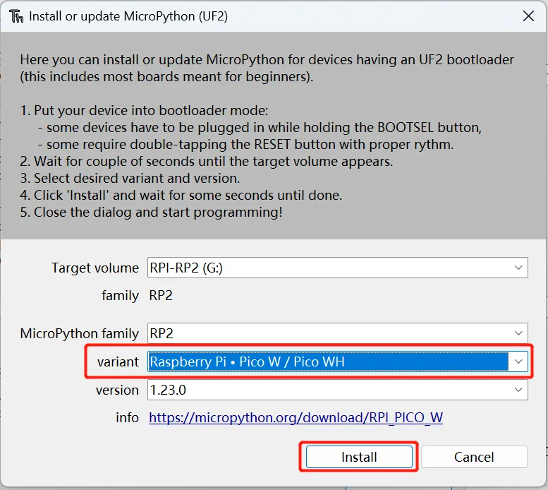

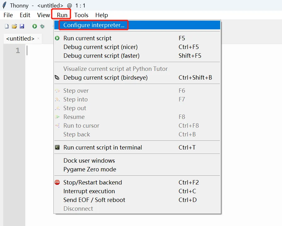

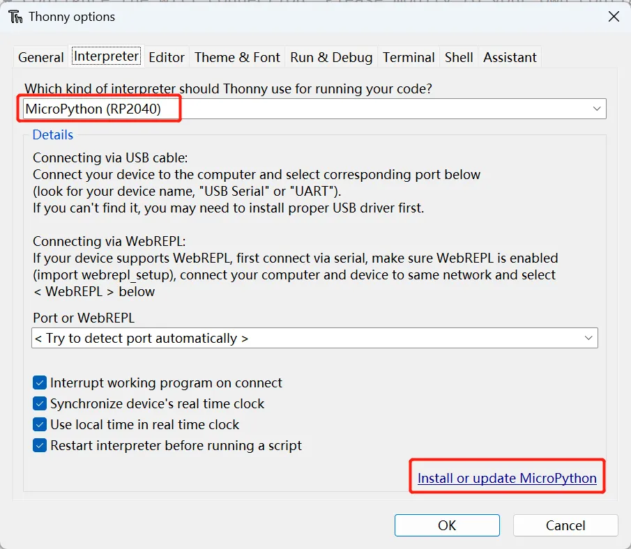

Open Thonny IDE and click "Run"->"Configure interpreter". Select "MicroPython(RP2040)" as the interpreter. Then click "Install and update MicroPython"
Waiting for the loading the downloading variants info...
After loading is complete, it will show:
Select the variant to and install the firmware.
Installation is done!

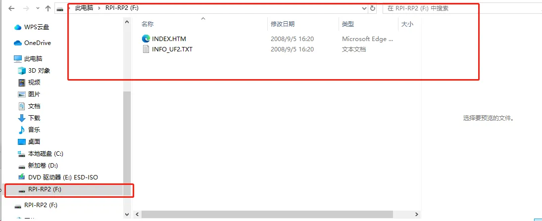

Drag the firmware to the U disk

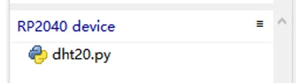

This tutorial requires the use of the DHT20 module, so you need to install the dht20 library.

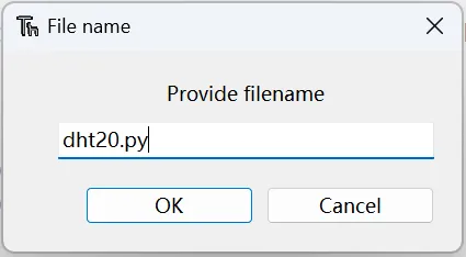

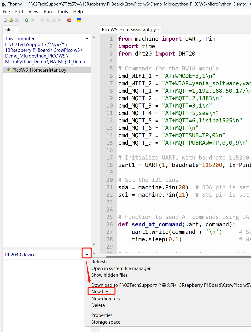

Click the menu icon in the upper right corner of RP2040 device. Select "New file..."
Name the file, note to add the file type suffix(.py)
Then copy the following to the editor.
# https://github.com/flrrth/pico-dht20 from machine import I2C from utime import sleep_ms class DHT20: """Class for the DHT20 Temperature and Humidity Sensor. The datasheet can be found at http://www.aosong.com/userfiles/files/media/Data%20Sheet%20DHT20%20%20A1.pdf """ def __init__(self, address: int, i2c: I2C): self._address = address self._i2c = i2c sleep_ms(100) # Added Columns self._i2c.writeto(0x38, bytearray(b'\x71')) sleep_ms(200) if not self.is_ready: self._initialize() sleep_ms(100) if not self.is_ready: raise RuntimeError("Could not initialize the DHT20.") @property def is_ready(self) -> bool: """Check if the DHT20 is ready.""" self._i2c.writeto(self._address, bytearray(b'\x71')) return self._i2c.readfrom(self._address, 1)[0] == 0x18 def _initialize(self): buffer = bytearray(b'\x00\x00') self._i2c.writeto_mem(self._address, 0x1B, buffer) self._i2c.writeto_mem(self._address, 0x1C, buffer) self._i2c.writeto_mem(self._address, 0x1E, buffer) def _trigger_measurements(self): self._i2c.writeto_mem(self._address, 0xAC, bytearray(b'\x33\x00')) def _read_measurements(self): buffer = self._i2c.readfrom(self._address, 7) return buffer, buffer[0] & 0x80 == 0 def _crc_check(self, input_bitstring: str, check_value: str) -> bool: """Calculate the CRC check of a string of bits using a fixed polynomial. See https://en.wikipedia.org/wiki/Cyclic_redundancy_check https://xcore.github.io/doc_tips_and_tricks/crc.html#the-initial-value Keyword arguments: input_bitstring -- the data to verify check_value -- the CRC received with the data """ polynomial_bitstring = "100110001" len_input = len(input_bitstring) initial_padding = check_value input_padded_array = list(input_bitstring + initial_padding) while '1' in input_padded_array[:len_input]: cur_shift = input_padded_array.index('1') for i in range(len(polynomial_bitstring)): input_padded_array[cur_shift + i] = \ str(int(polynomial_bitstring[i] != input_padded_array[cur_shift + i])) return '1' not in ''.join(input_padded_array)[len_input:] @property def measurements(self) -> dict: """Get the temperature (°C) and relative humidity (%RH). Returns a dictionary with the most recent measurements. 't': temperature (°C), 't_adc': the 'raw' temperature as produced by the ADC, 'rh': relative humidity (%RH), 'rh_adc': the 'raw' relative humidity as produced by the ADC, 'crc_ok': indicates if the data was received correctly """ self._trigger_measurements() sleep_ms(50) data = self._read_measurements() retry = 3 while not data[1]: if not retry: raise RuntimeError("Could not read measurements from the DHT20.") sleep_ms(10) data = self._read_measurements() retry -= 1 buffer = data[0] s_rh = buffer[1] << 12 | buffer[2] << 4 | buffer[3] >> 4 s_t = (buffer[3] << 16 | buffer[4] << 8 | buffer[5]) & 0xfffff rh = (s_rh / 2 ** 20) * 100 t = ((s_t / 2 ** 20) * 200) - 50 crc_ok = self._crc_check( f"{buffer[0] ^ 0xFF:08b}{buffer[1]:08b}{buffer[2]:08b}{buffer[3]:08b}{buffer[4]:08b}{buffer[5]:08b}", f"{buffer[6]:08b}") return { 't': t, 't_adc': s_t, 'rh': rh, 'rh_adc': s_rh, 'crc_ok': crc_ok } -
Click run, then the dht20.py will be added to RP2040 device

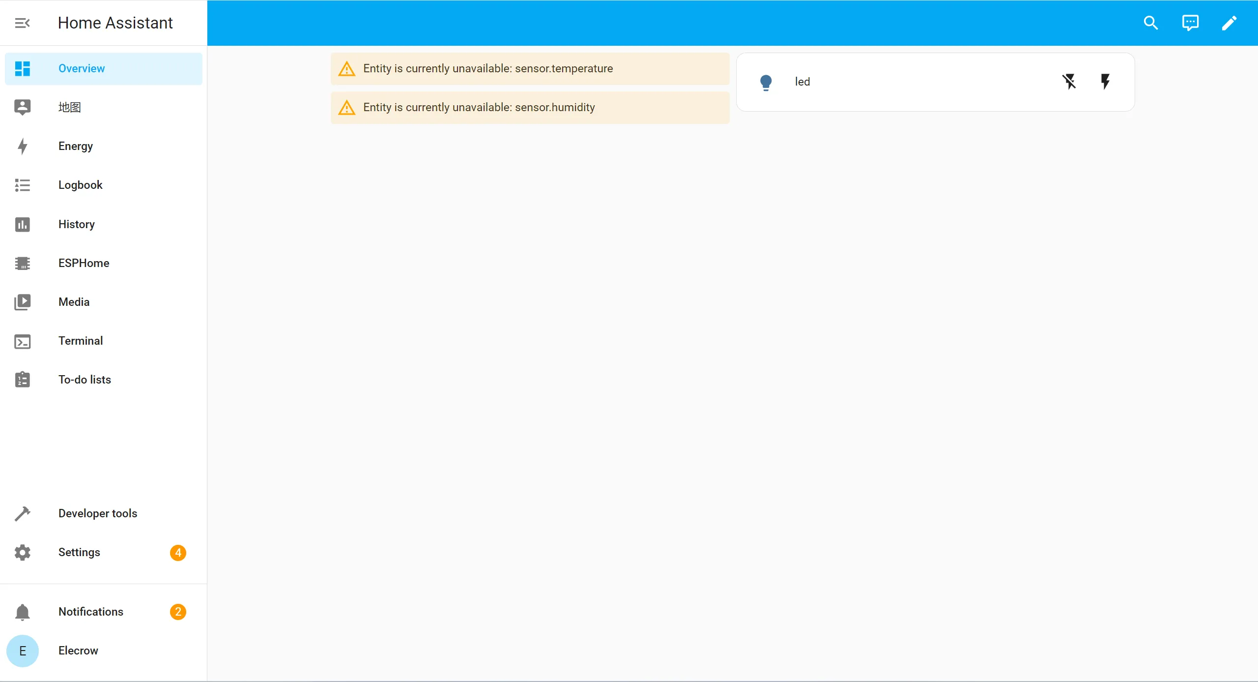

Connect the sensor the PICO W5 board. Then open the "PicoW5_Homeassistant.py" on Thonny IDE and run.

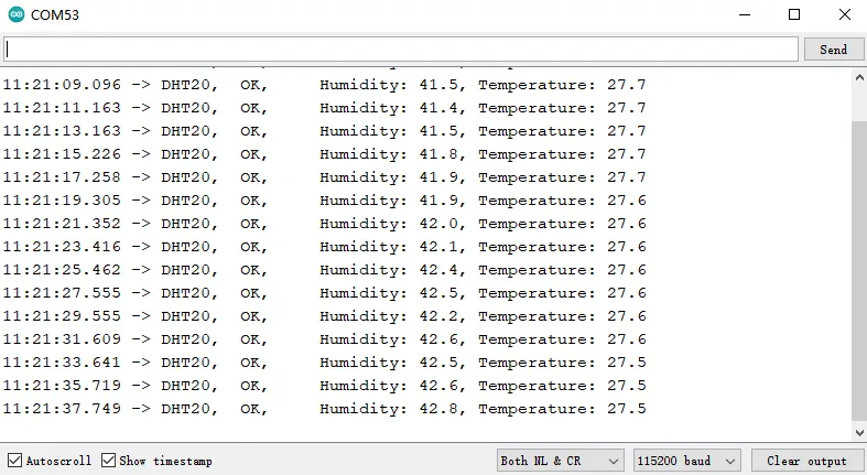

#include "DHT20.h" DHT20 DHT(&Wire); // or use 2nd I2C interface &Wire void setup() { Serial.begin(115200); Serial.println(__FILE__); Serial.print("DHT20 LIBRARY VERSION: "); Serial.println(DHT20_LIB_VERSION); Serial.println(); Wire.setSDA(20); // select your pin numbers here Wire.setSCL(21); // select your pin numbers here Wire.begin(); delay(2000); Serial.println("Type,\tStatus,\tHumidity (%),\tTemperature (C)"); } void loop() { // READ DATA Serial.print("DHT20, \t"); int status = DHT.read(); switch (status) { case DHT20_OK: Serial.print("OK,\t"); break; case DHT20_ERROR_CHECKSUM: Serial.print("Checksum error,\t"); break; case DHT20_ERROR_CONNECT: Serial.print("Connect error,\t"); break; case DHT20_MISSING_BYTES: Serial.print("Missing bytes,\t"); break; case DHT20_ERROR_BYTES_ALL_ZERO: Serial.print("All bytes read zero"); break; case DHT20_ERROR_READ_TIMEOUT: Serial.print("Read time out"); break; case DHT20_ERROR_LASTREAD: Serial.print("Error read too fast"); break; default: Serial.print("Unknown error,\t"); break; } // DISPLAY DATA, sensor has only one decimal. Serial.print("Humidity: "); Serial.print(DHT.getHumidity(), 1); Serial.print(",\t"); Serial.print("Temperature: "); Serial.println(DHT.getTemperature(), 1); delay(2000); } // -- END OF FILE -- -
After the code is successfully uploaded, the humidity and temperature value will be printed in the serial monitor.

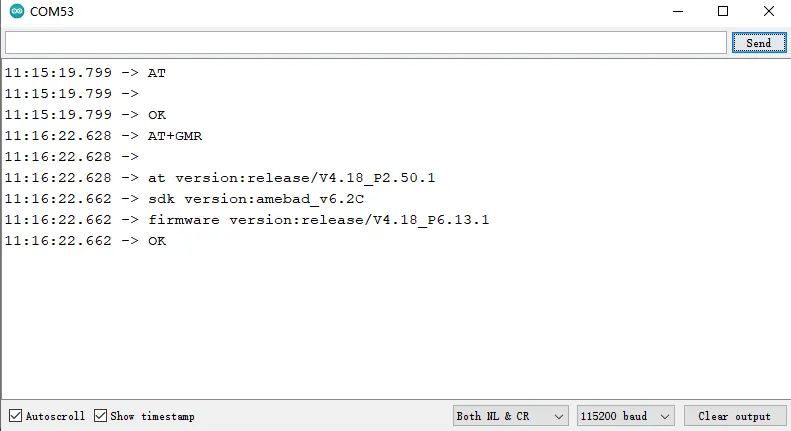

Examples 6 Control BW16 with AT Commands through UART1¶
The BW16 is soldered on board. The RX is connected with GP5, and the TX is connected with GP4.
Upload the BW16_UART.ino to CrowPico W5.
// Define the RX and TX pins for the second serial port #define Serial2_RX 5 // Set the RX pin #define Serial2_TX 4 // Set the TX pin // Initialize the second serial port void UART1_Init() { Serial2.setRX(Serial2_RX); // Set the RX pin for the second serial port Serial2.setTX(Serial2_TX); // Set the TX pin for the second serial port Serial2.begin(115200); // Start the second serial port at a baud rate of 115200 delay(1000); // Delay for 1 second to allow the serial port to initialize } // Setup function to initialize the main serial port and the second serial port void setup() { Serial.begin(115200); // Start the main serial port at a baud rate of 115200 UART1_Init(); // Initialize the second serial port } // Main loop function that prints "loop" and then delays void loop() { UART1_test(); } // Test function for the second serial port void UART1_test() { Serial2.println("AT"); delay(500); while (Serial2.available()) // Check if there is data available to read from the second serial port { Serial.write(Serial2.read()); // Write the data from the second serial port to the main serial port } Serial2.println("AT+GMR"); delay(500); while (Serial2.available()) // Check if there is data available to read from the second serial port { Serial.write(Serial2.read()); // Write the data from the second serial port to the main serial port } Serial.println(""); delay(500); } -

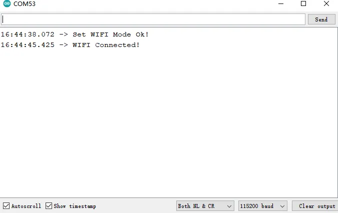

After the code is successfully uploaded, open the serial monitor.

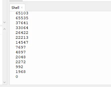

from machine import ADC, Pin import time # Initialize an ADC object using Pin 27 for analog input adc = ADC(Pin(27)) while True: # Read the analog value from the ADC and print it as a 16-bit unsigned integer print(adc.read_u16()) # Delay for 1 second to avoid overwhelming the output with too many readings time.sleep(1) -
The light intensity will be printed in the shell.

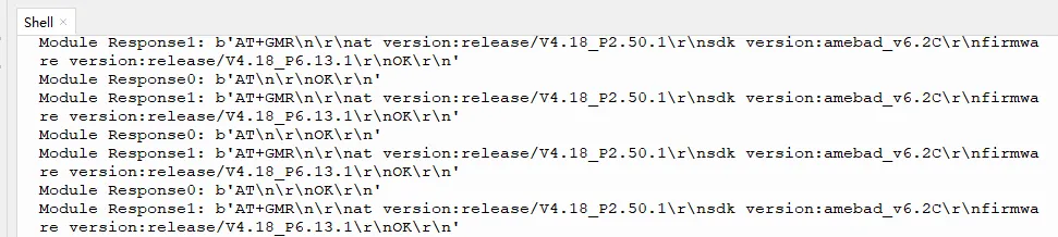

Run the Uart_Test.py
from machine import UART, Pin import time # Initialize UART1 with baudrate 115200, transmit on Pin(4), receive on Pin(5) uart1 = UART(1, baudrate=115200, tx=Pin(4), rx=Pin(5)) # Function to send AT commands def send_at_command(uart, command): uart1.write(command + '\n') # Send the command followed by a newline character time.sleep(0.1) # Wait for a response # Function to read the response from the module def read_response(uart): return uart1.read(1024) # Read a certain number of bytes from the UART buffer # Main loop while True: send_at_command(uart1, 'AT') # Send a test AT command to check the module's response response = read_response(uart1) print('Module Response0:', response) time.sleep(2) # Wait for 2 seconds before sending the next command send_at_command(uart1, 'AT+GMR') # Send a command to get the module's firmware version response = read_response(uart1) print('Module Response1:', response) time.sleep(2) # Wait for 2 seconds before the next iteration of the loop -
After the code is successfully uploaded, the AT command will be printed in the shell.

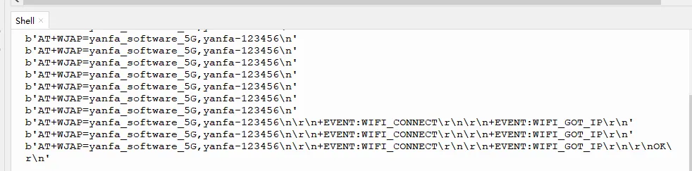

Examples 7 Connect to the 5G band Wi-Fi¶
Send the command to connect to WiFi to the bw16 module through uart1 and receive the information returned by the bw16 module.
Run the Connect_to_the_5G_band_Wi-Fi.py
