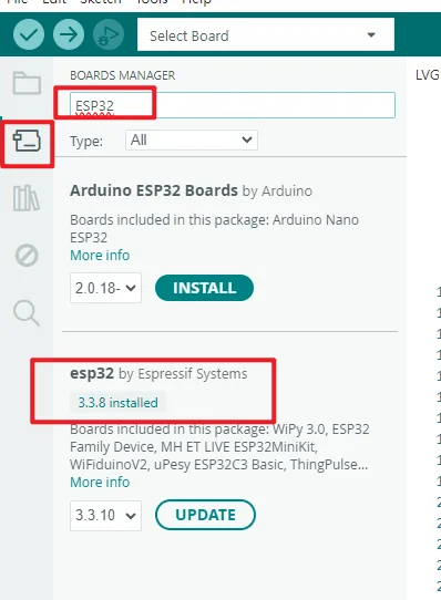

Board Version
esp32 by Espressif System 3.2.0

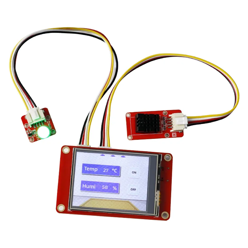

The example tutorial is an environmental monitoring project, demonstrate how to create a UI and use a DHT20 sensor to obtain the environment temperature and humidity and display it on the screen; and how to control the LED on and off by the buttons on the screen.
gif2
Hardware Preparation
CrowPanel ESP32 5.0'' HMI Crowtail-DHT20 Crowtail-LED
CrowPanel-ESP32-5-0inch.webp CROWTAIL-DHT20 CROWTAIL-LED
BUYNOW BUYNOW BUYNOW

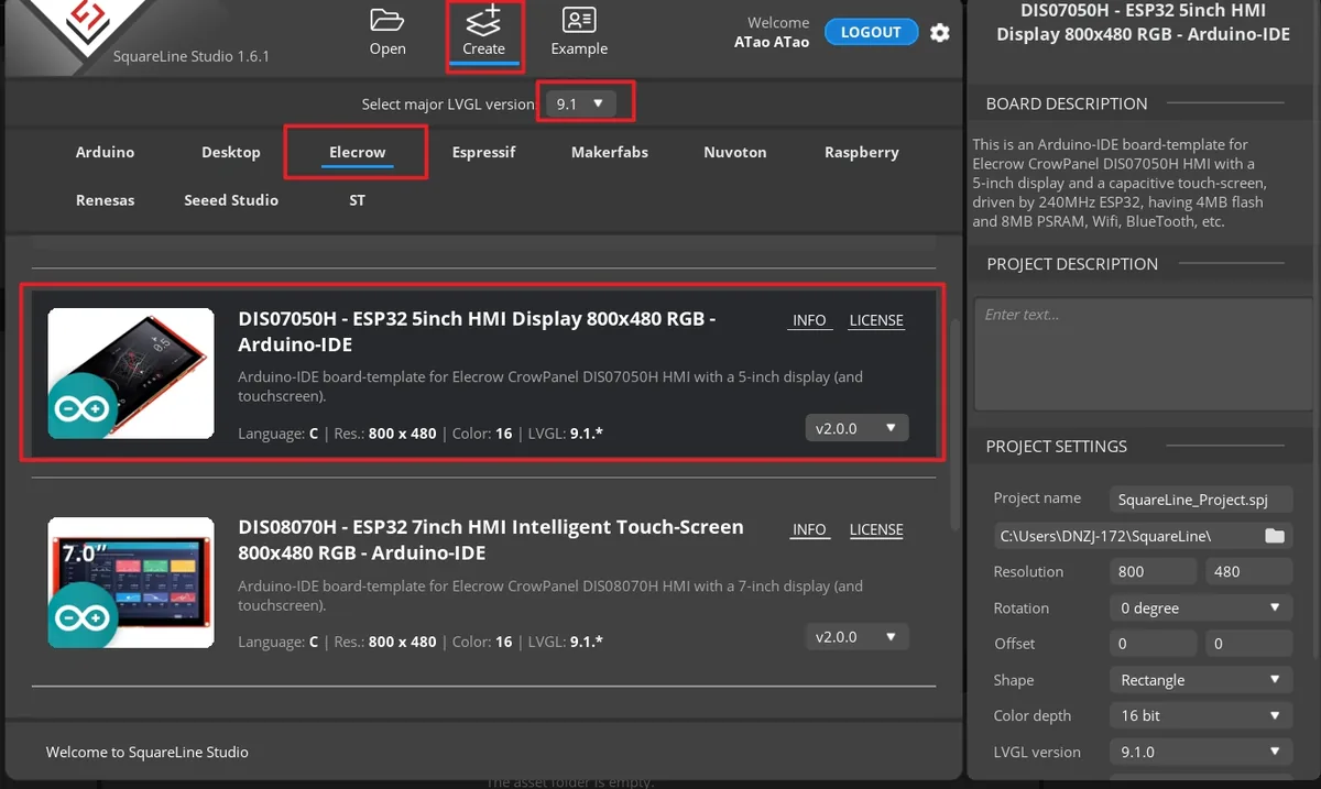

GetStartedWithSquareLine

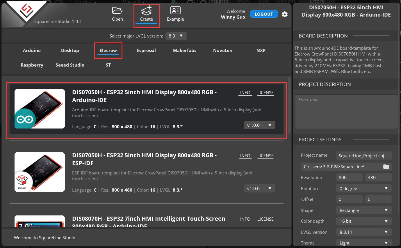

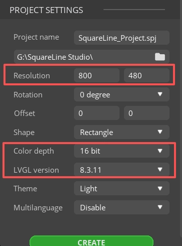

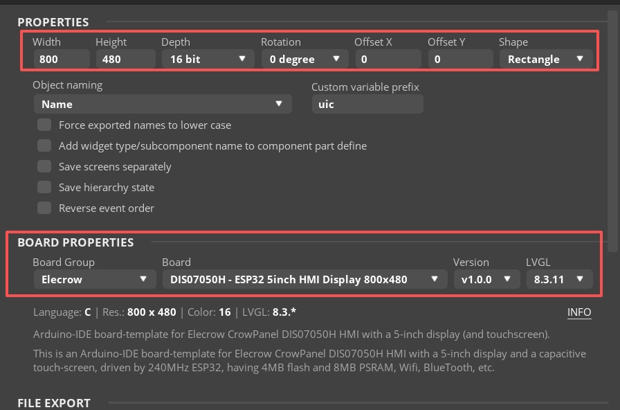

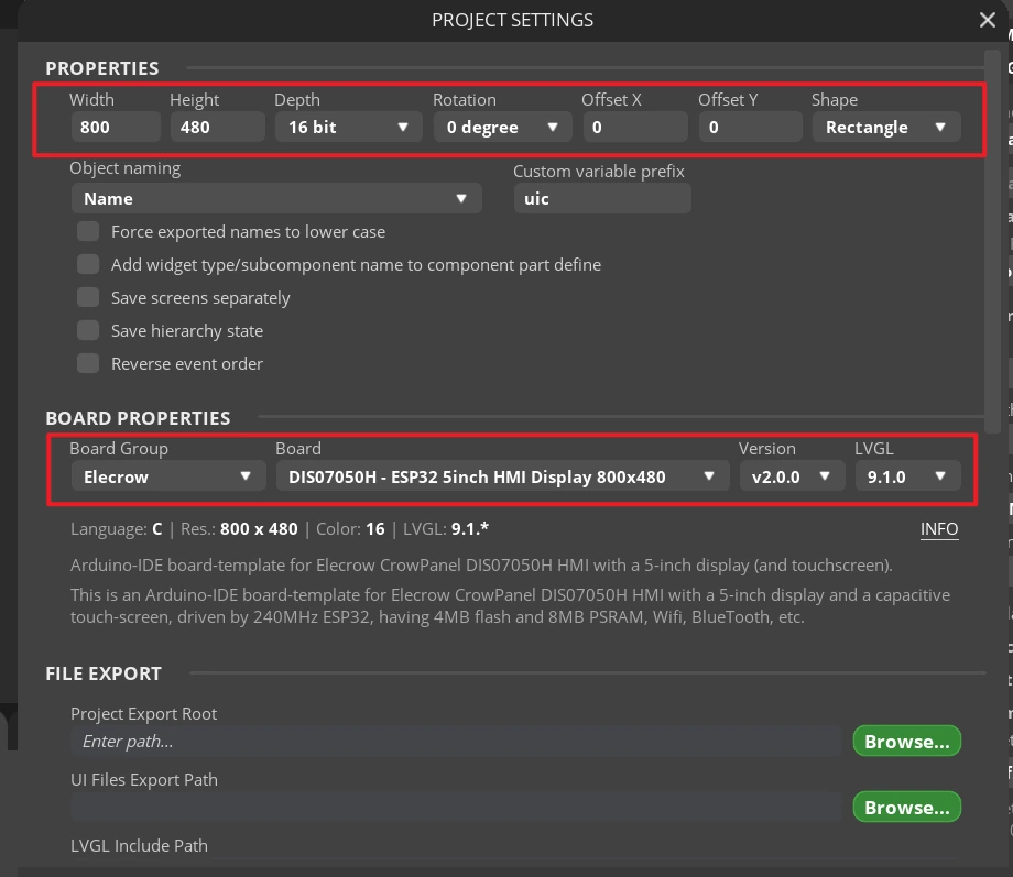

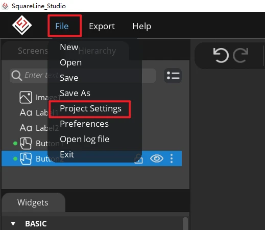

  1. Open the SquareLine Studio and create a project.
    Select "Elecrow"->"DIS07050H...Arduino-IDE"
    SLS-UI-1-1

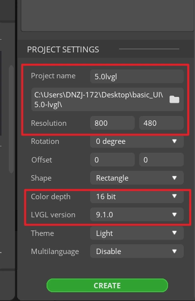

    Set the name of the project, set the screen resolution to 800*480, set the color depth to 16bit, and keep other default settings. After setting, click CREATE to create the project.
  2. After creation, enter the following interface with a blank background.

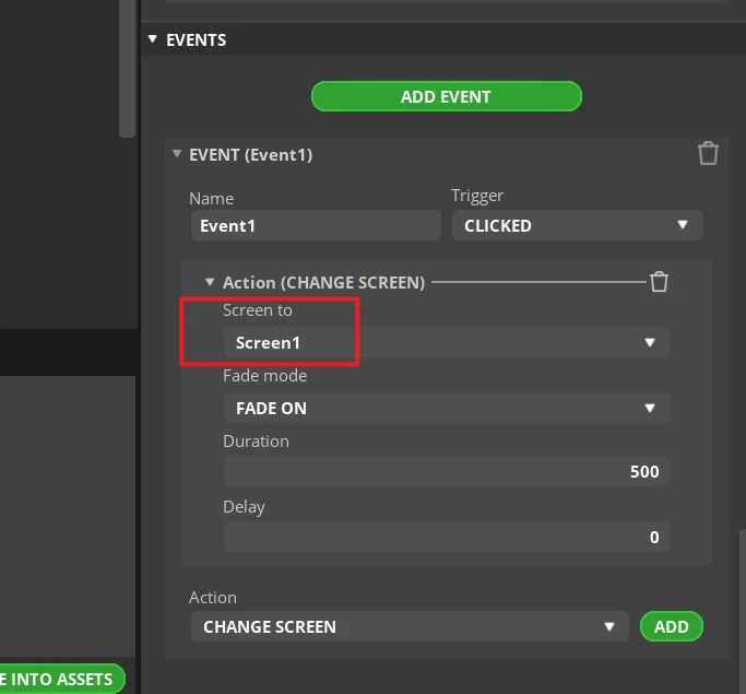

  7. Add events to buttons.
    SLS-UI-21
    2
    SLS-UI-23
    SLS-UI-24

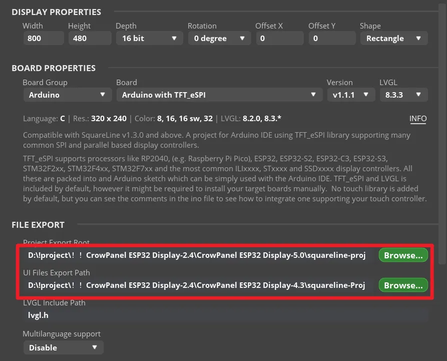

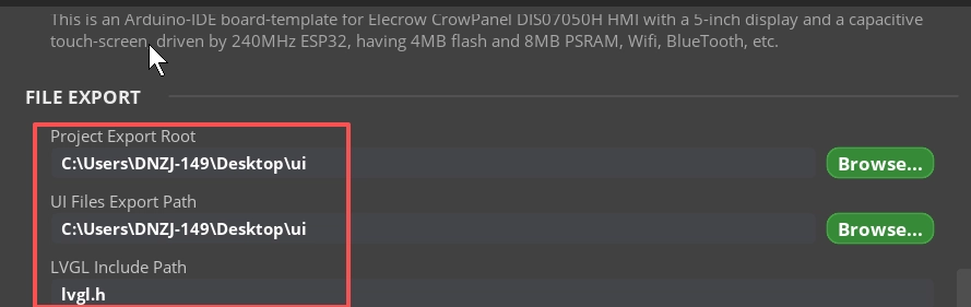

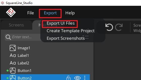

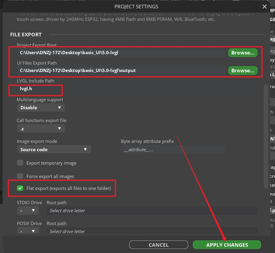

  8. Export UI files.
    SLS-UI-25
    3
    4
Then click "APPLY CHANGES".

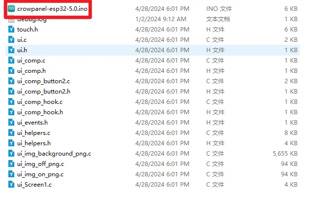

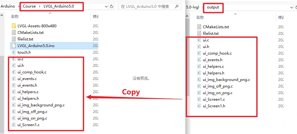

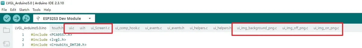

Please click download to download the main program(and the expert UI is included).SLS-UI-30

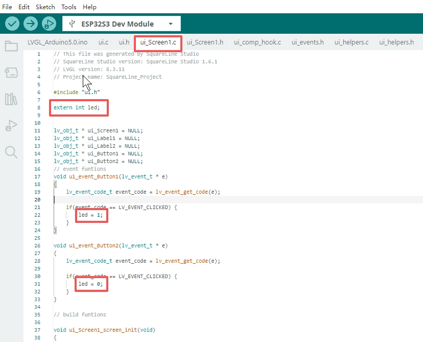

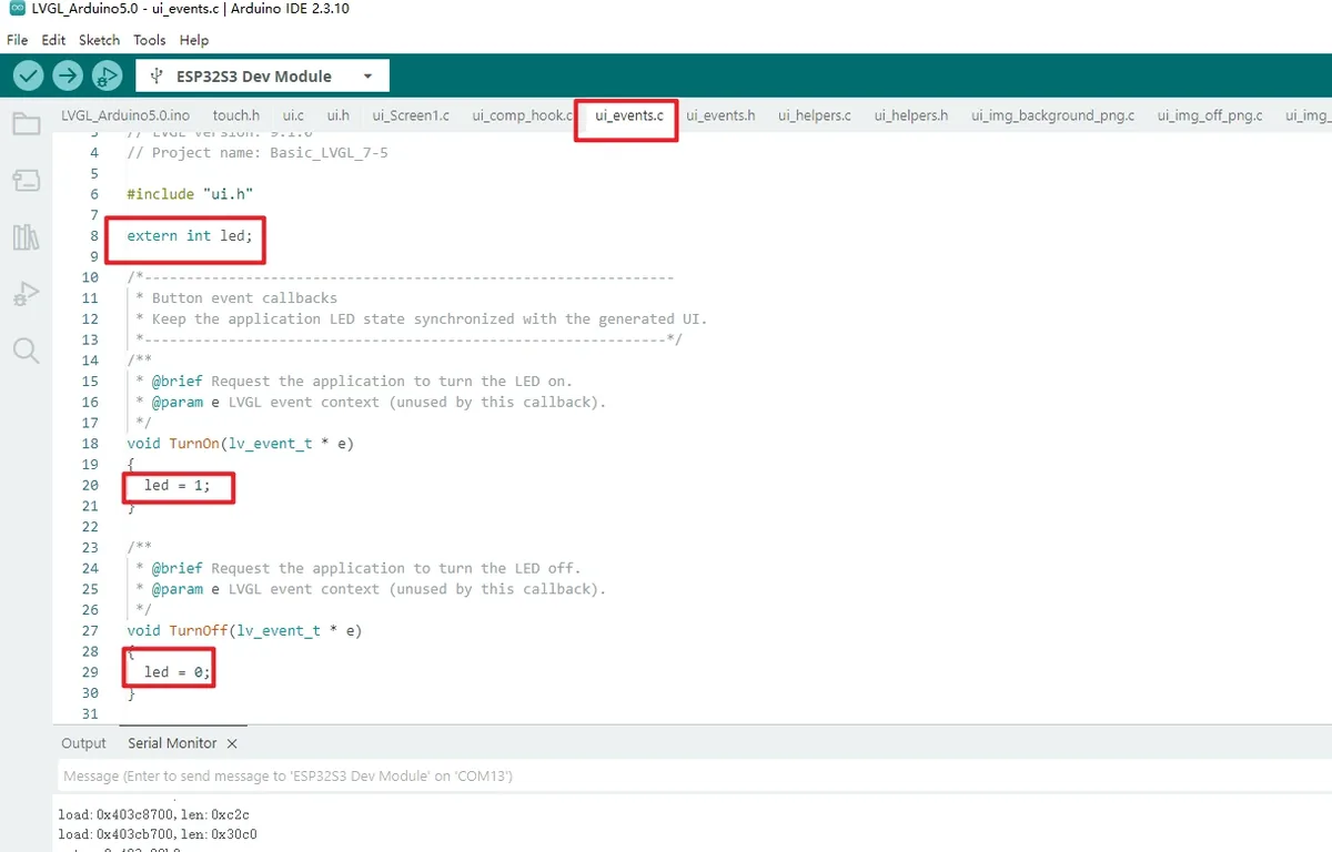

  1. Modify the button event code.
SLS-UI-31

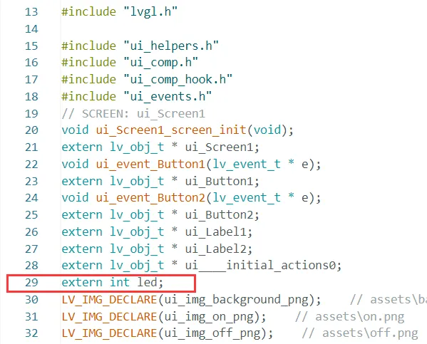

First, define a variable in the ui_Screen1.c file to store the status of the LED. In the main program, the LED light is controlled to turn on and off by judging the status of this variable.
Then replace the function calls inside the Button1 and Button2 functions with the functions for turning the LED on and turning the LED off
5

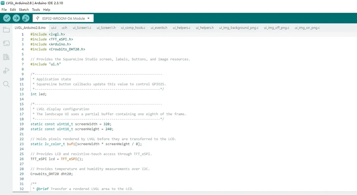

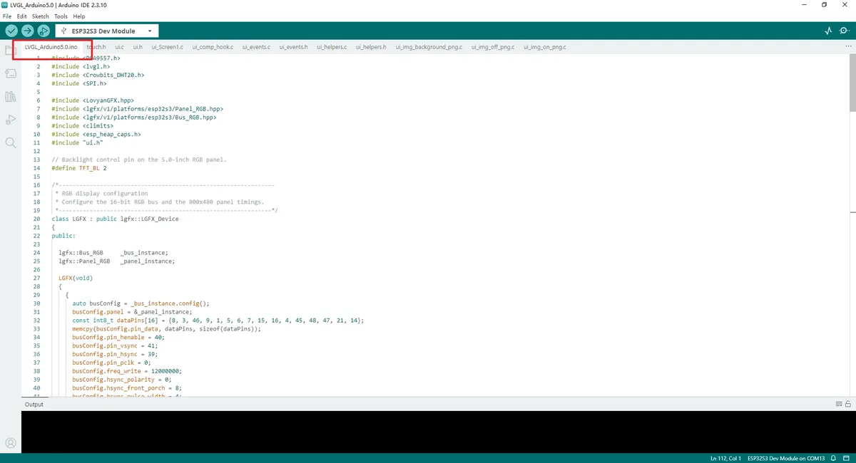

Build the Project with Arduino IDE

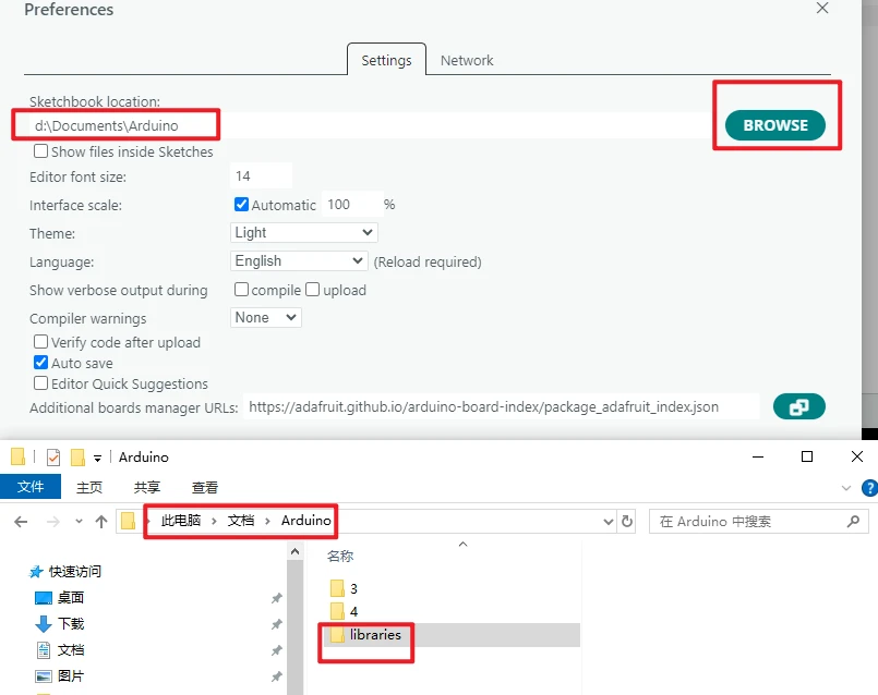

Get Started with Arduino IDE

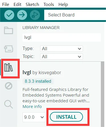

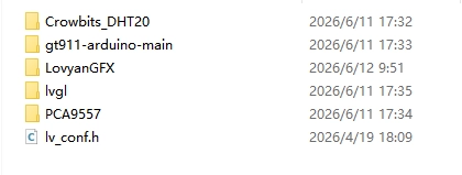

Install Libraries

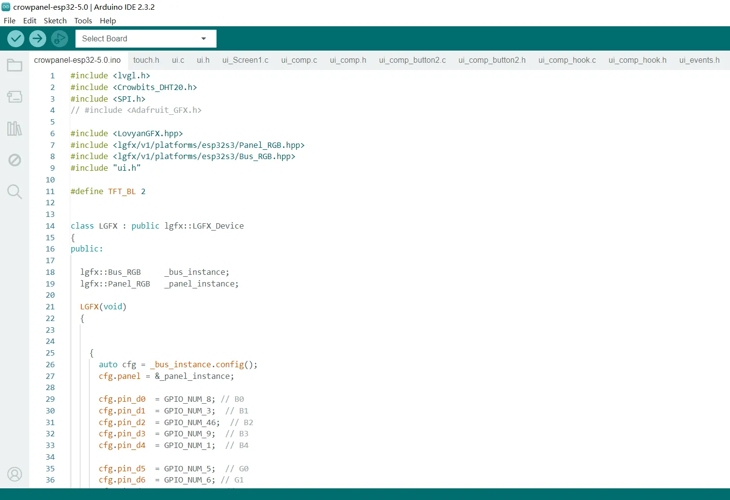

#include <PCA9557.h>
#include <lvgl.h>
#include <Crowbits_DHT20.h>
#include <SPI.h>
#include <LovyanGFX.hpp>
#include <lgfx/v1/platforms/esp32s3/Panel_RGB.hpp>
#include <lgfx/v1/platforms/esp32s3/Bus_RGB.hpp>
#include "ui.h"
  • #include <lvgl.h> : library for graphical interfaces.
  • #include <Crowbits_DHT20.h>: to read data from the DHT20 temperature and humidity sensor.
  • #include <LovyanGFX.hpp>: The LovyanGFX library is a library for drawing graphics on embedded systems, providing rich graphics functions and APIs.
  • lgfx/v1/platforms/esp32s3/Panel_RGB.hppand lgfx/v1/platforms/esp32s3/Bus_RGB.hpp: These two libraries are part of the LovyanGFX library, specifically for driving RGB color panels on ESP32-S3 microcontrollers. Panel_RGB.hpp provides functions for communicating with RGB panels, while Bus_RGB.hpp provides functions for communicating with RGB buses, which are often used to control devices such as LCD screens.
  • #include "ui.h": is a custom header file that contain UI-related functions or definitions.
Please click download to download the libraries we modified.

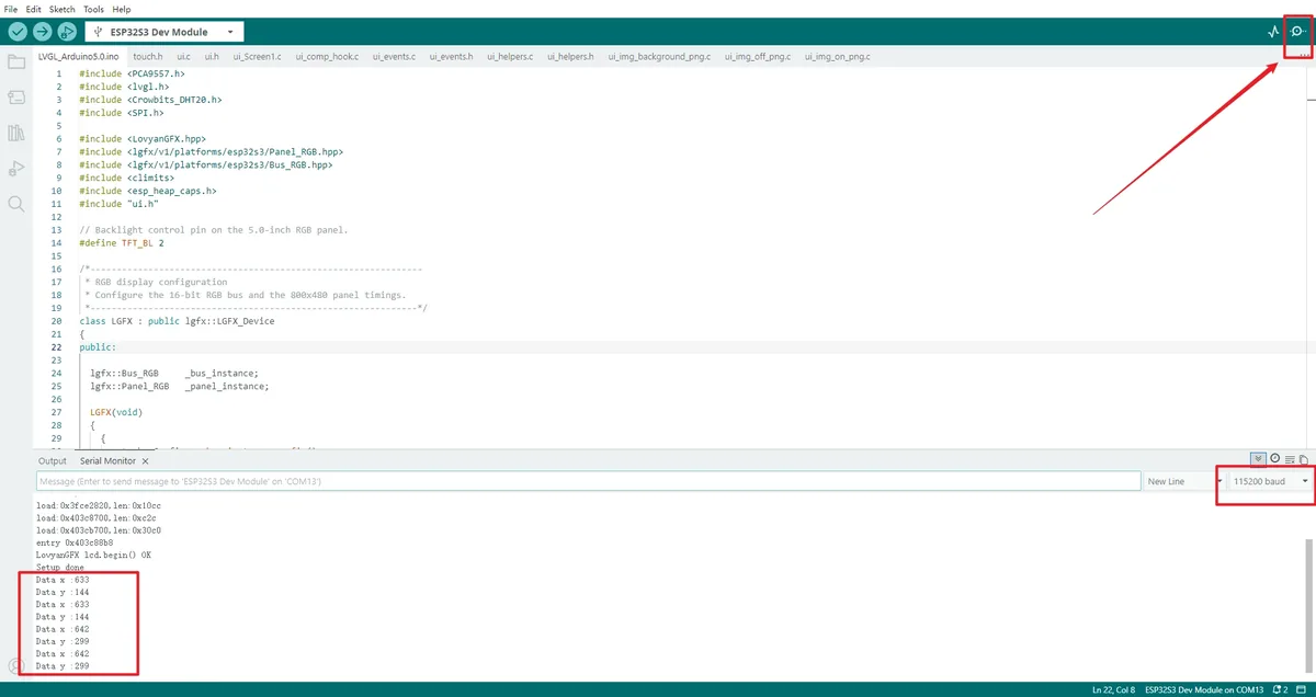

  • A simple touch input device reading function, which is used to convert touch events into the input device data format required by the LVGL library, and output the coordinate information of touch points through serial communication.
    void my_touchpad_read(lv_indev_drv_t *indev_driver, lv_indev_data_t *data)
      if (touch_has_signal())
        if (touch_touched())
          /*Set the coordinates*/
          data->point.x = touch_last_x;
          data->point.y = touch_last_y;
          Serial.print( "Data x :" );
          Serial.println( touch_last_x );
          Serial.print( "Data y :" );
          Serial.println( touch_last_y );
        else if (touch_released())
      else
      delay(15);

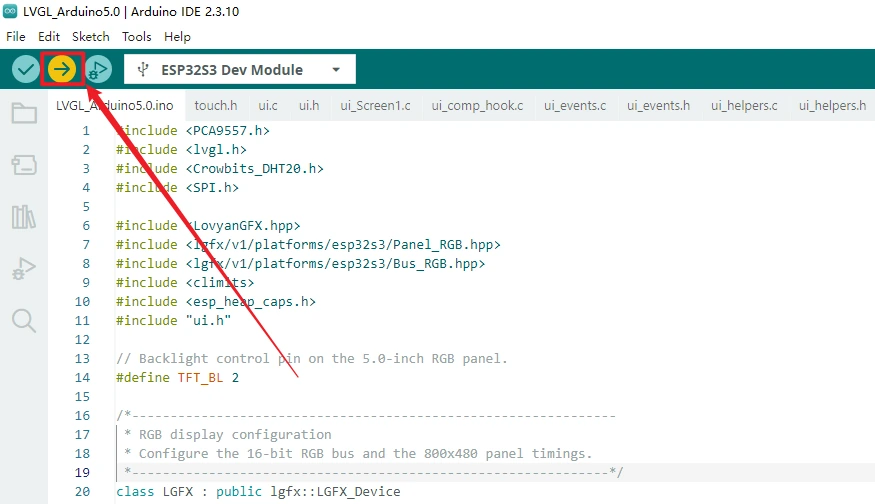

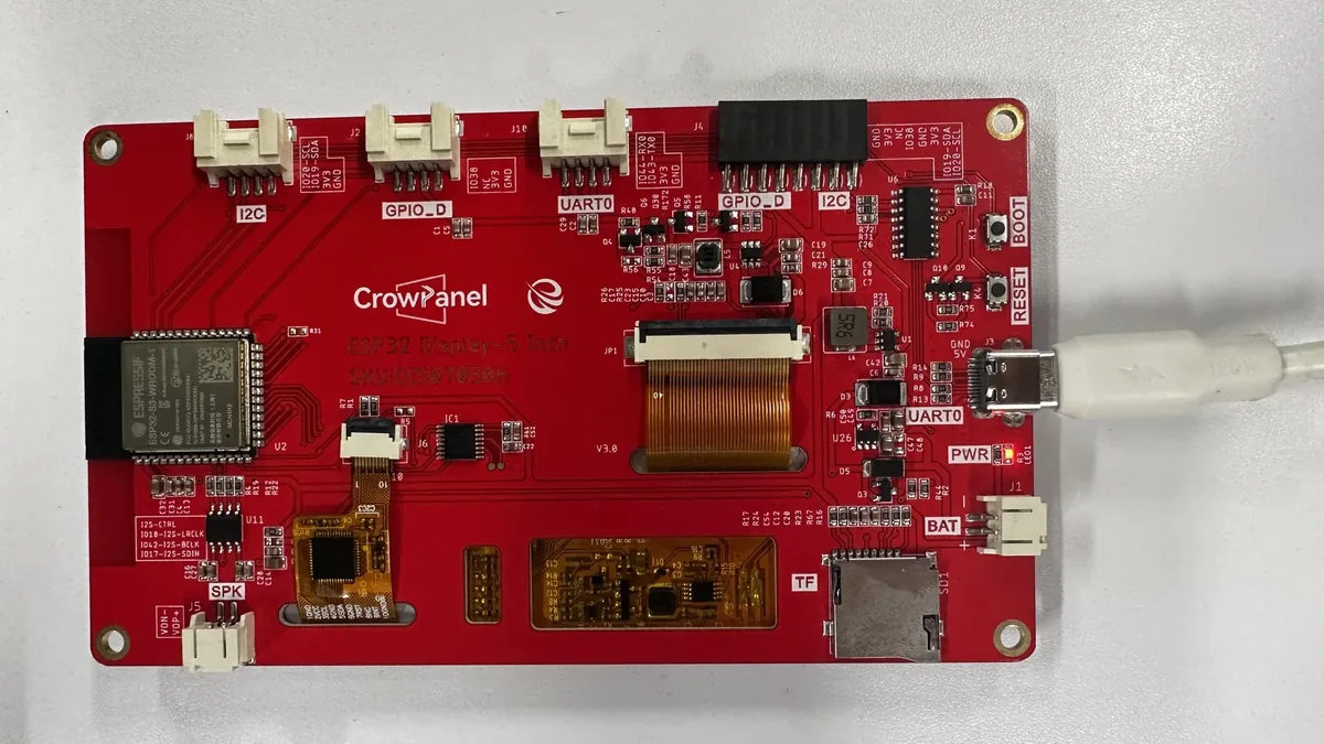

Upload the Code

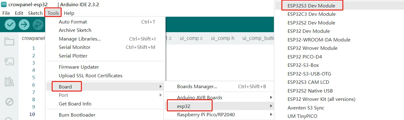

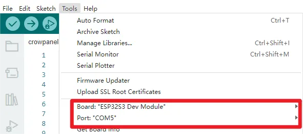

  1. After completing the installation of the ESP32 board according to "Get Started with Arduino IDE" and the installation of the library according to "Install Libraries", open the program and connect the ESP32 HMI 5.0-inch to the computer via a USB-C cable.
  2. Select Board: click "Tools" -> "Board" -> "esp32" and select "ESP32S3 Dev Module"
    select-board

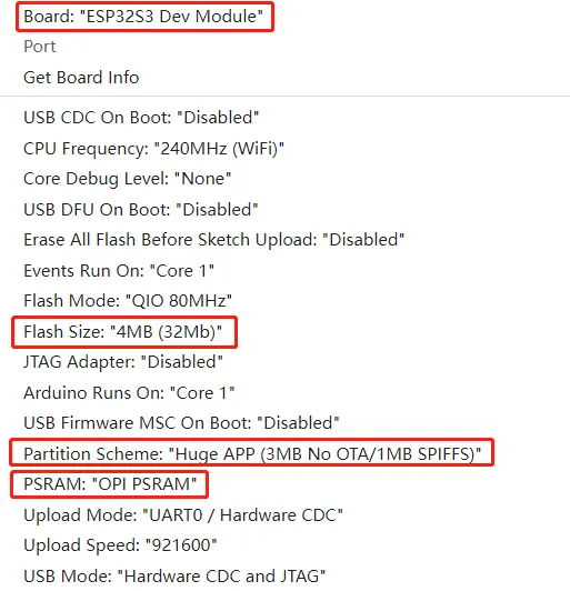

  3. Board Setting: Under the "Tools" menu, see "Flash Size" select 4MB(32Mb); "Partition scheme" and select "Huge APP(3MB No OTA/1MB SPIFFS)"; "PSRAM" select "OPI PSRAM"
    board-setting
  4. Select Port
    select-port

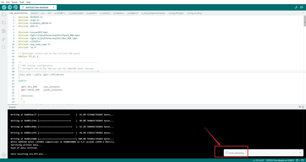

  5. Upload the code: click the "Upload" icon to upload the code.
    upload-the-code

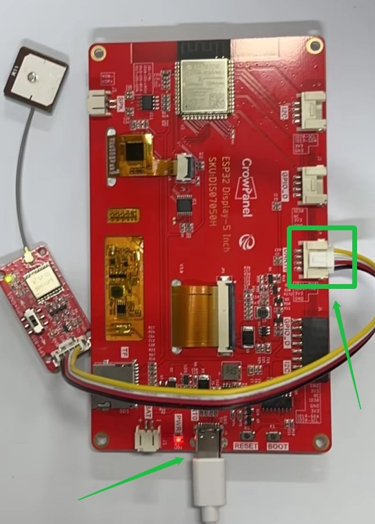

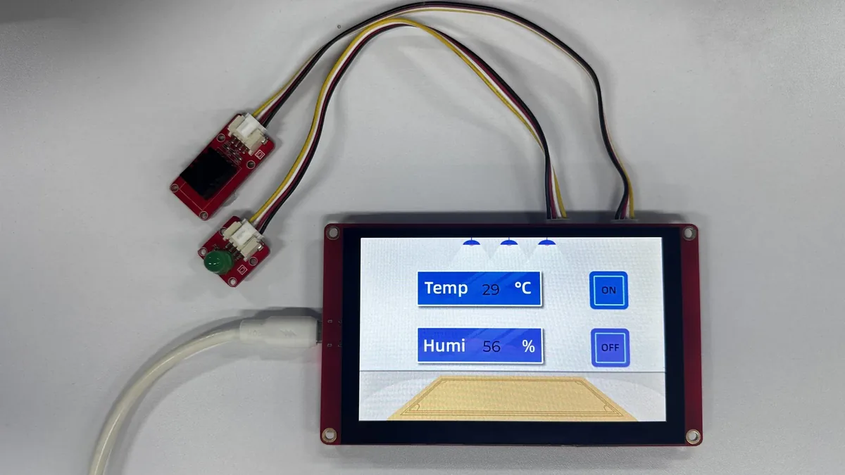

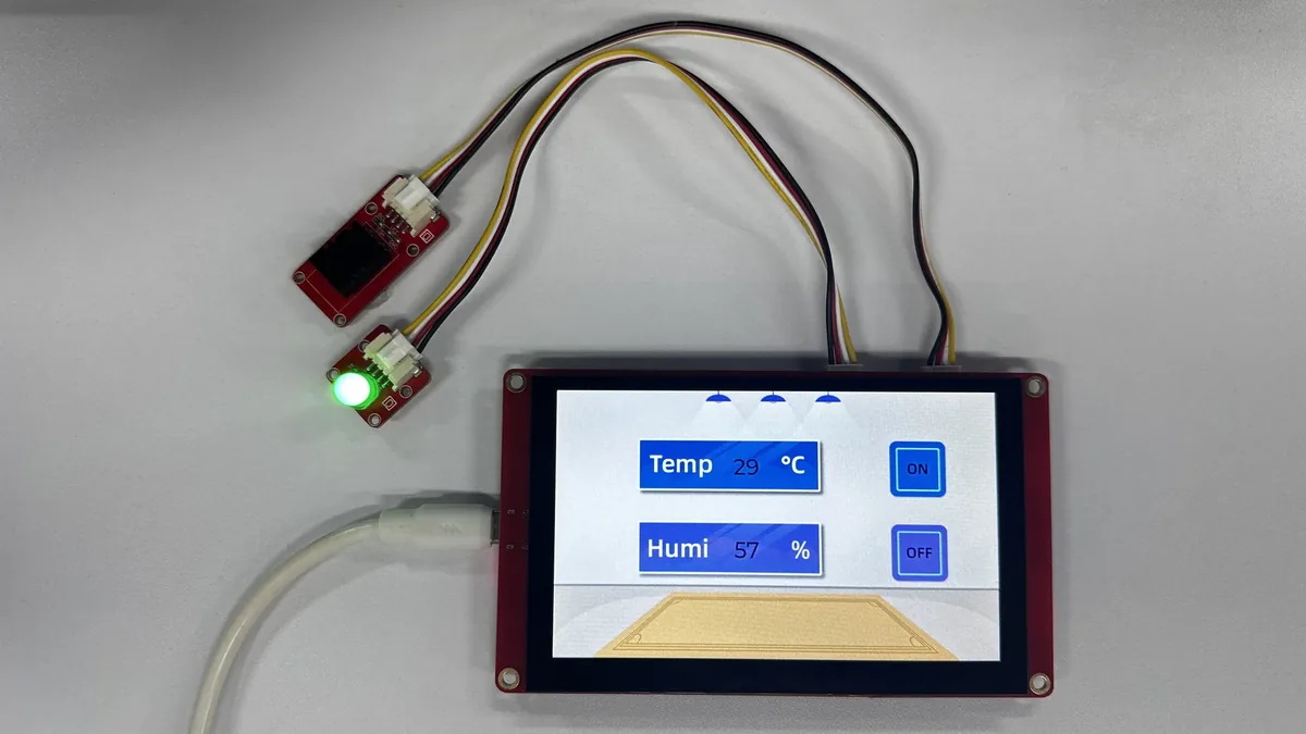

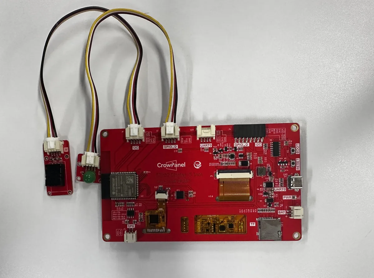

  6. After the program is successfully uploaded, connect the DHT20 sensor to the IIC port and the LED to GPIO_D (IO38), the temperature and humidity values will be displayed on the screen. Click the ON button on the screen and the LED will turn on. Click the OFF button and the LED will turn off.
gif2
Example Demo of ESP32 HMI Function

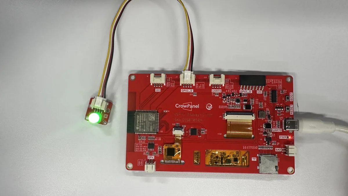

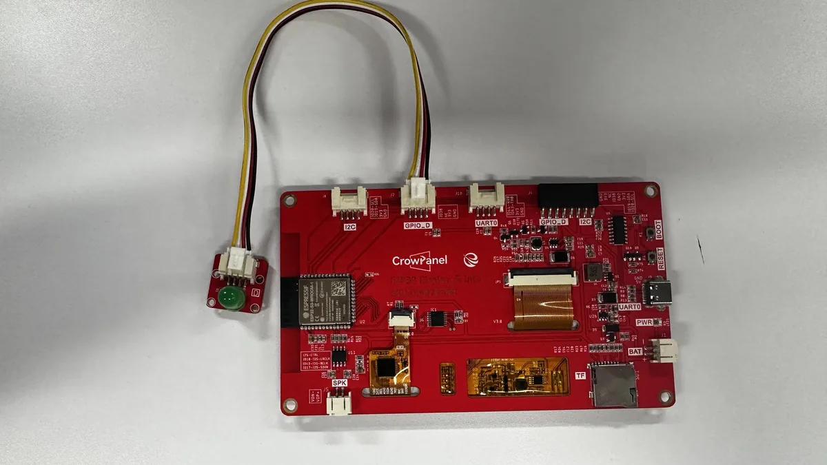

Example1: LED blinking.
Connect the LED to GPIO_D(IO38) port, and upload the following code to the board. The LED will blinking.
#define D_PIN 38
void setup() {
  Serial.begin(115200);
  pinMode(D_PIN, OUTPUT);
void loop() {
  digitalWrite(D_PIN, HIGH);
  delay(500);
  digitalWrite(D_PIN, LOW);
  delay(500);
GPIO38-LED

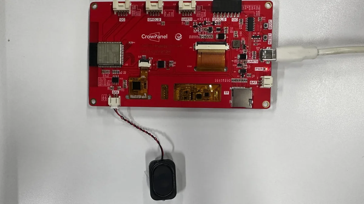

Example2: Play music
Plug the speaker into SPK port. Please check if you have installed the library ESP32-audioI2S(Copy the ESP32-audioI2S-master folder in the libraries downloaded above to the .../arduino/libraries directory). Upload the following code to the board.

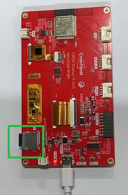

Example3: Initialize SD Card slot
Please insert an SD card formatted as FAT16 or FAT32. Other file system formats may fail to be read.

  SPI.begin(SD_SCK, SD_MISO, SD_MOSI);
  delay(100);
  if (SD_init() == 1)
    Serial.println("Card Mount Failed");
  else
    Serial.println("initialize SD Card successfully");

Example4: Initialize the touch
Upload the following code to the board, and open the serial monitor to check the touch information.
#include "touch.h"
void setup() {
  touch_init();
void loop() {
      Serial.print("Data x :");
      Serial.println(touch_last_x);
      Serial.print("Data y :");
      Serial.println(touch_last_y);

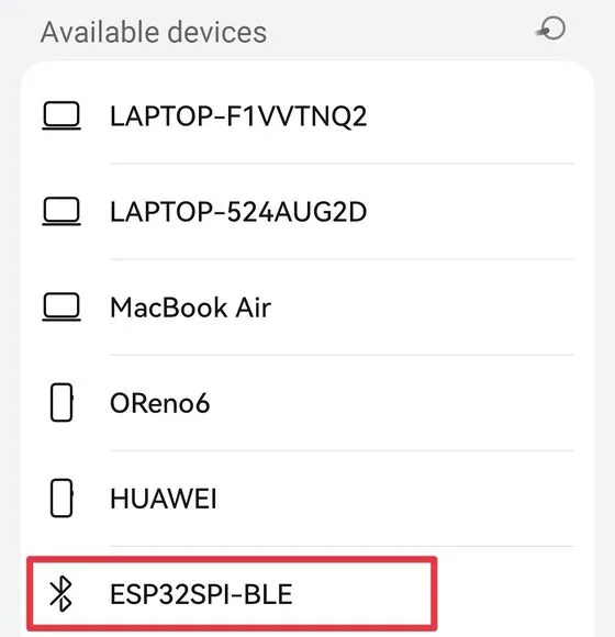

Example5: Initialize the interact communication of Bluetooth
Upload the following code to the board, and use the phone to search the Bluetooth device.
BLE

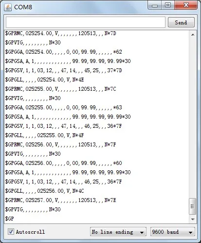

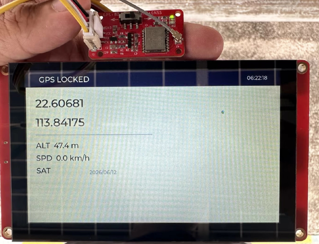

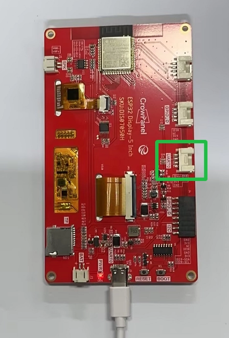

Example7: Connect Crowtail-GPS module via UART to Get Location
Because the USB-to-serial interface shares the same pins as the UART interface, the USB and UART functions cannot be used at the same time. Leave the UART interface disconnected when flashing/uploading the firmware.
8
Once the program has been successfully uploaded, connect the GPS module and reconnect power to the board via the USB port.
9
Note: For best results, choose a location with good weather and an open outdoor environment. This allows the GPS module to receive satellite signals properly, collect data, and display it on the screen.
10
GPS module purchase link:https://www.elecrow.com/crowtailgps-p-1515.html

  labelLon = lv_label_create(lv_scr_act());
  lv_label_set_text(labelLon, "0.00000");
  lv_obj_set_style_text_color(labelLon, lv_color_black(), 0);
  lv_obj_set_style_text_font(labelLon, &lv_font_montserrat_36, 0);
  lv_obj_align(labelLon, LV_ALIGN_TOP_LEFT, 30, 140);
  lv_obj_add_flag(labelLon, LV_OBJ_FLAG_HIDDEN);
  // Divider line
  lv_obj_t* line = lv_line_create(lv_scr_act());
  static lv_point_t line_points[] = {{30, 200}, {400, 200}};
  lv_line_set_points(line, line_points, 2);
  lv_obj_set_style_line_color(line, lv_color_hex(0xCCCCCC), 0);
  lv_obj_set_style_line_width(line, 2, 0);
  // Altitude
  labelAlt = lv_label_create(lv_scr_act());
  lv_label_set_text(labelAlt, "ALT  0.0 m");
  lv_obj_set_style_text_color(labelAlt, lv_color_black(), 0);
  lv_obj_set_style_text_font(labelAlt, &lv_font_montserrat_24, 0);
  lv_obj_align(labelAlt, LV_ALIGN_TOP_LEFT, 30, 220);
  lv_obj_add_flag(labelAlt, LV_OBJ_FLAG_HIDDEN);
  // Speed
  labelSpeed = lv_label_create(lv_scr_act());
  lv_label_set_text(labelSpeed, "SPD  0.0 km/h");
  lv_obj_set_style_text_color(labelSpeed, lv_color_black(), 0);
  lv_obj_set_style_text_font(labelSpeed, &lv_font_montserrat_24, 0);
  lv_obj_align(labelSpeed, LV_ALIGN_TOP_LEFT, 30, 260);
  lv_obj_add_flag(labelSpeed, LV_OBJ_FLAG_HIDDEN);
  // Satellites label
  lv_obj_t* satLabel = lv_label_create(lv_scr_act());
  lv_label_set_text(satLabel, "SAT");
  lv_obj_set_style_text_color(satLabel, lv_color_black(), 0);
  lv_obj_set_style_text_font(satLabel, &lv_font_montserrat_24, 0);
  lv_obj_align(satLabel, LV_ALIGN_TOP_LEFT, 30, 300);
  // Date
  labelDate = lv_label_create(lv_scr_act());
  lv_label_set_text(labelDate, "----/--/--");
  lv_obj_set_style_text_color(labelDate, lv_color_hex(0x888888), 0);
  lv_obj_set_style_text_font(labelDate, &lv_font_montserrat_16, 0);
  lv_obj_align(labelDate, LV_ALIGN_TOP_LEFT, 200, 310);
  lv_obj_add_flag(labelDate, LV_OBJ_FLAG_HIDDEN);
void updateGpsDisplay()
  static bool lastValid = false;
  char buf[48];
  // Switch display mode when status changes
  if (gps.valid != lastValid)
    if (gps.valid)
      // Positioned: show data, hide waiting prompt
      lv_obj_add_flag(labelSat, LV_OBJ_FLAG_HIDDEN);
      lv_obj_clear_flag(labelLat, LV_OBJ_FLAG_HIDDEN);
      lv_obj_clear_flag(labelLon, LV_OBJ_FLAG_HIDDEN);
      lv_obj_clear_flag(labelAlt, LV_OBJ_FLAG_HIDDEN);
      lv_obj_clear_flag(labelSpeed, LV_OBJ_FLAG_HIDDEN);
      lv_obj_clear_flag(labelDate, LV_OBJ_FLAG_HIDDEN);
    else
      // Not positioned: show waiting, hide data
      lv_obj_clear_flag(labelSat, LV_OBJ_FLAG_HIDDEN);
      lv_obj_add_flag(labelLat, LV_OBJ_FLAG_HIDDEN);
    lastValid = gps.valid;
  // Update status bar color
  lv_obj_t* statusBar = lv_obj_get_parent(labelStatus);
  if (gps.valid) {
    lv_obj_set_style_bg_color(statusBar, lv_color_hex(0x1B5E), 0); // Green
    lv_label_set_text(labelStatus, "  GPS LOCKED");
  } else {
    lv_obj_set_style_bg_color(statusBar, lv_color_hex(0xC000), 0); // Red
    lv_label_set_text(labelStatus, "  NO SIGNAL");
  // Update time
  lv_label_set_text(labelTime, gps.timeStr);
  if (!gps.valid)
    // Not positioned: only show satellite count
    snprintf(buf, sizeof(buf), "Satellites: %d", gps.sats);
    lv_label_set_text(labelSat, buf);
    return;
  // Positioned: update data
  snprintf(buf, sizeof(buf), "%.5f", gps.lat);
  lv_label_set_text(labelLat, buf);
  snprintf(buf, sizeof(buf), "%.5f", gps.lon);
  lv_label_set_text(labelLon, buf);
  snprintf(buf, sizeof(buf), "ALT  %.1f m", gps.alt);
  lv_label_set_text(labelAlt, buf);
  snprintf(buf, sizeof(buf), "SPD  %.1f km/h", gps.speed);
  lv_label_set_text(labelSpeed, buf);
  lv_label_set_text(labelDate, gps.dateStr);
// ==================== Setup & Loop ====================
PCA9557 Out;
void setup()
  gpsSerial.begin(9600, SERIAL_8N1, GPS_RX, GPS_TX);
  // IO expander init
  Wire.begin(19, 20);
  Out.reset();
  Out.setMode(IO_OUTPUT);
  Out.setState(IO0, IO_LOW);
  Out.setState(IO1, IO_LOW);
  delay(20);
  Out.setState(IO0, IO_HIGH);
  delay(100);
  Out.setMode(IO1, IO_INPUT);
  // Backlight
  pinMode(38, OUTPUT);
  digitalWrite(38, LOW);
  // Display init
  lcd.begin();
  lcd.fillScreen(TFT_BLACK);
  delay(200);
  // LVGL init
  lv_init();
  delay(100);
  touch_init();
  screenWidth = lcd.width();
  screenHeight = lcd.height();
  lv_disp_draw_buf_init(&draw_buf, disp_draw_buf, NULL, screenWidth * screenHeight / 10);
  lv_disp_drv_init(&disp_drv);
#ifdef TFT_BL
  pinMode(TFT_BL, OUTPUT);
  digitalWrite(TFT_BL, HIGH);
#endif
  // Create simple GPS UI
  createGpsUI();
  // Startup screen
  lv_obj_t* startup = lv_label_create(lv_scr_act());
  lv_label_set_text(startup, "GPS Display\nWaiting for satellites...");
  lv_obj_set_style_text_color(startup, lv_color_black(), 0);
  lv_obj_set_style_text_font(startup, &lv_font_montserrat_24, 0);
  lv_obj_set_style_text_align(startup, LV_TEXT_ALIGN_CENTER, 0);
  lv_obj_align(startup, LV_ALIGN_CENTER, 0, 0);
  lv_timer_handler();
  delay(1000);
  lv_obj_del(startup); // Delete startup screen
  Serial.println("GPS Display ready");
void loop()
  // Read GPS data
  while (gpsSerial.available()) {
    char c = gpsSerial.read();
    if (c == '\n' || c == '\r') {
      if (nmeaIndex > 0) {
        handleNMEA();
        nmeaIndex = 0;
    } else if (nmeaIndex < sizeof(nmeaLine) - 1) {
      nmeaLine[nmeaIndex++] = c;
  // Refresh screen every 800ms
  static uint32_t lastDraw = 0;
  if (millis() - lastDraw > 800) {
    updateGpsDisplay();
    lastDraw = millis();
  lv_timer_handler();
  delay(5);
