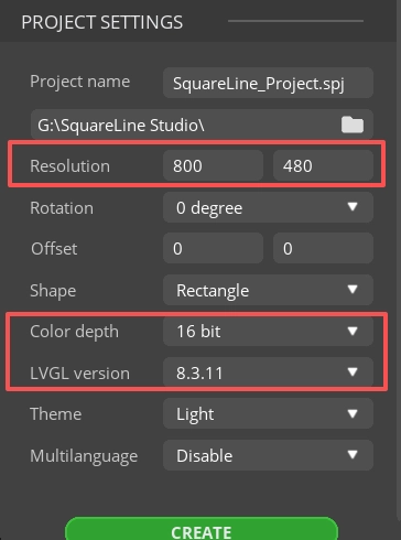

5.1 Create a new SquareLine Studio project.
4.3-inch, 5.0-inch, and 7.0-inch all have a resolution of 800×480.

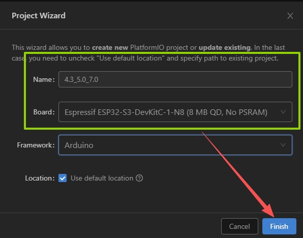

Click the PlatformIO icon, click QUIK ACCESS 'Open', then click '+New Project'.
Add a project name. Select "Espressif ESP32-S3-DevKitC-1-N8" for the board and Arduino for the framework.

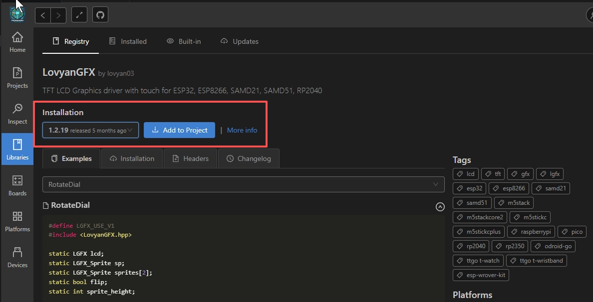

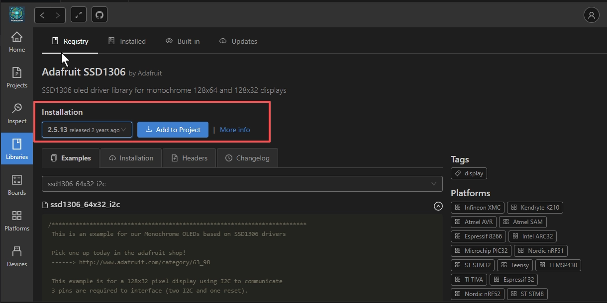

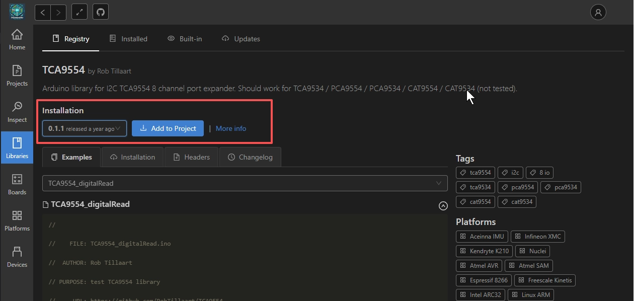

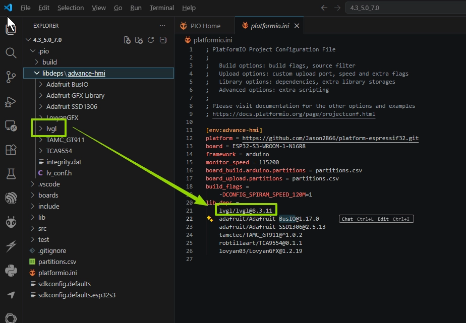

6.2 Add the necessary libraries to the PlatformIO project.

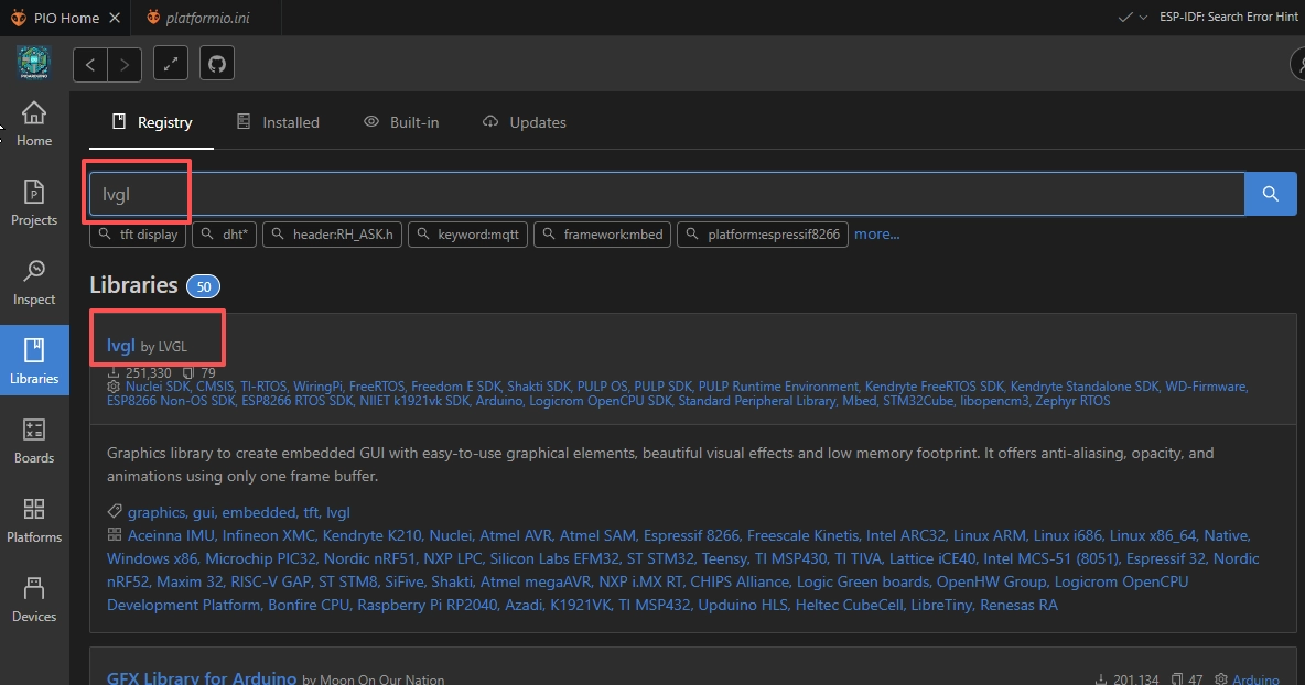

Click the PlatformIO icon, click ‘Libraries’, then search for the following libraries.
① Lvgl(8.3.11)
② LovyanGFX(1.2.19)
③ Adafruit SSD1306(2.5.13)

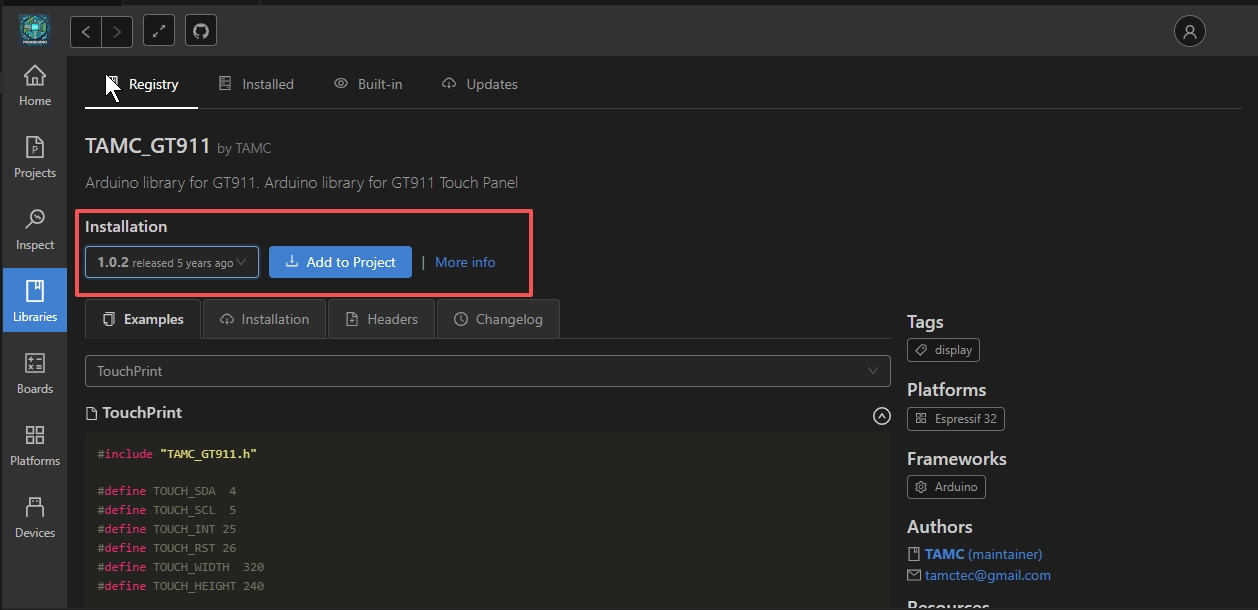

④ TAMC_GT911(1.0.2)
⑤ TCA9554(0.1.1)

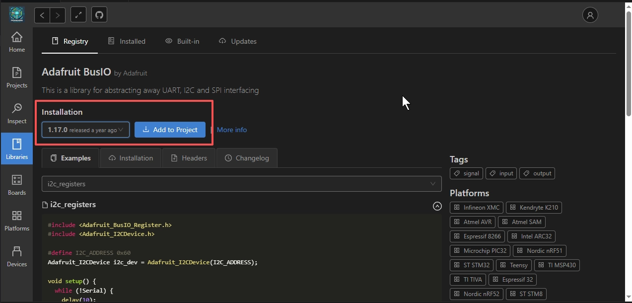

⑥ BusIO(1.17.0)

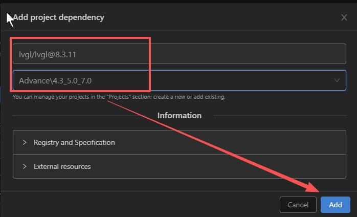

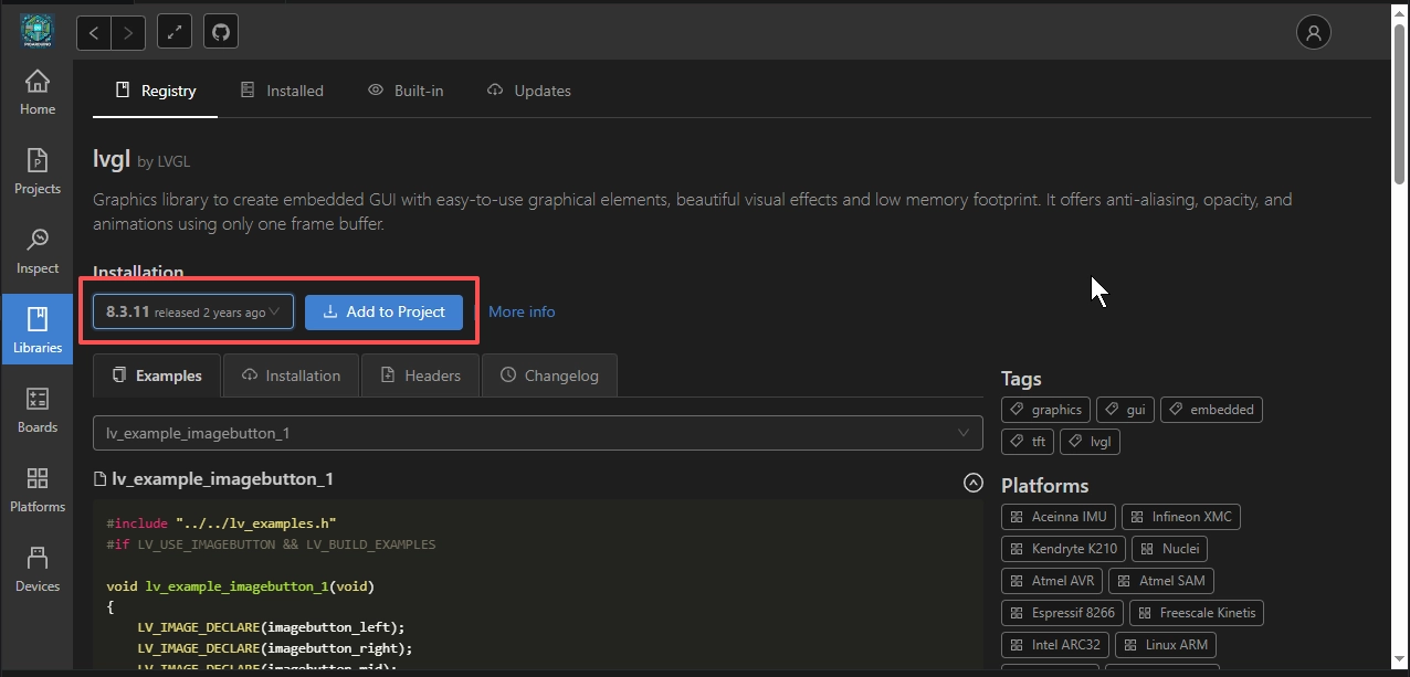

Click on the LVGL library.
103
Select version 8.3.11 (which needs to correspond to the version selected when creating the project in SquareLine Studio), and click "Add to Project".
104
Select the corresponding project name and click "Add".
105
If the library is successfully added to the project, the interface will automatically jump to the PlatformIO.ini file and automatically generate the project dependencies.
106
Note: If the platformio.ini file remains unchanged, but the library that has just been added is present in the pio->libdeps->esp32-s3-devkitc-1 folder, then click on "Compile". The PlatformIO plugin will pop up a window prompting you to change the library dependency link in the platformio.ini file.
Repeat the above steps and add the remaining libraries one by one (Please download the corresponding library according to the specified version.).
107
107
107
107
107
After all the required libraries have been added, the PlatformIO project will be as shown in the following figure.
112
Place the lv_conf.h we provide to the path: .pio\libdeps\esp32-s3-devkitc-1-myboard in the project folder.
https://github.com/Elecrow-RD/CrowPanel-Advance-4.3-HMI-ESP32-S3-AI-Powered-IPS-Touch-Screen-800x480/tree/master/example
Under the PlatfromIO/.pio/libdeps/esp32-s3-devkitc-1 path.

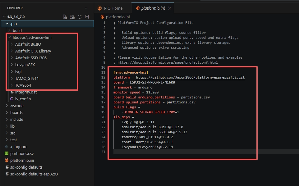

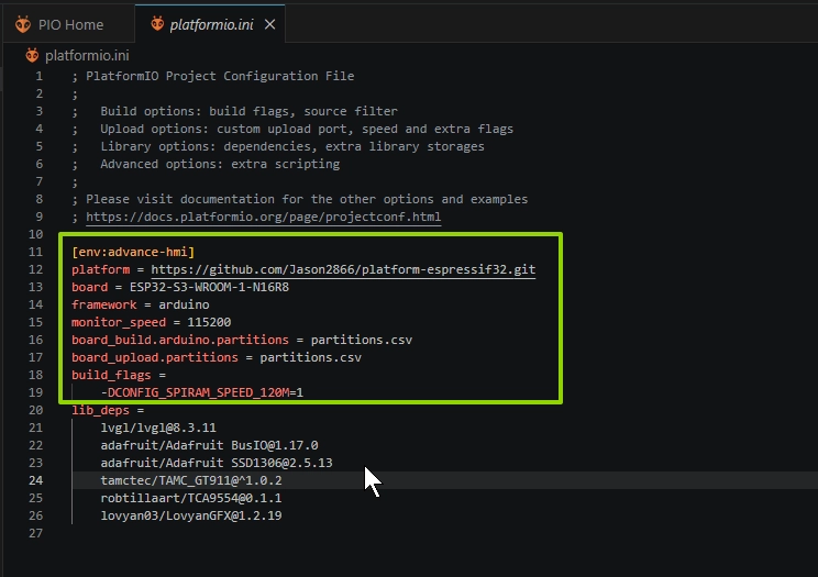

6.3 Add the chip configuration to the PlatformIO project
Open the platformio.ini file. This file is the configuration file of the PlatformIO project, which is used to define information such as the project's build environment, upload options, and library dependencies. Copy the following development board configuration into this file.
[env:advance-hmi]
platform = https://github.com/Jason2866/platform-espressif32.git
board = ESP32-S3-WROOM-1-N16R8
framework = arduino
monitor_speed = 115200
board_build.arduino.partitions = partitions.csv
board_upload.partitions = partitions.csv
build_flags =
    -DCONFIG_SPIRAM_SPEED_120M=1
113

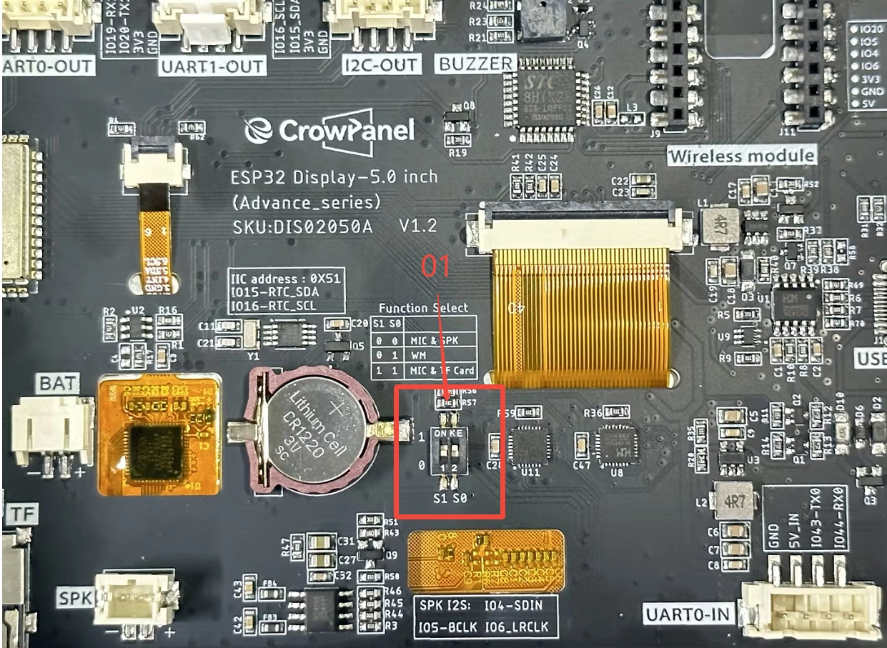

Note: For the 4.3-inch, 5.0-inch, and 7.0-inch models, the DIP switch on the back must be set to 01.
114
