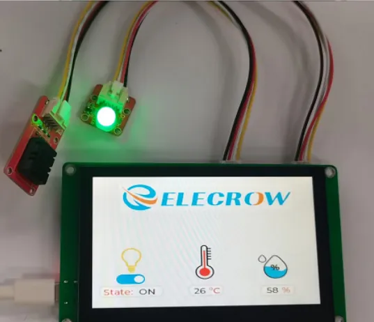

The example tutorial is an environmental monitoring project, demonstrate how to create a UI and use a DHT20 sensor to obtain the ambient temperature and humidity and display it on the screen; and how to control the LED on and off by the buttons on the screen.

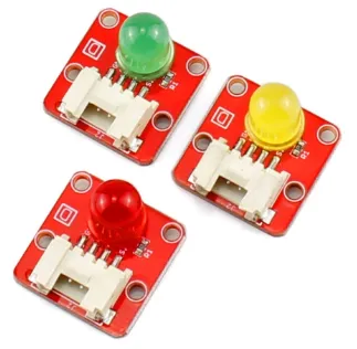

| CrowPanel PICO 4.3'' HMI | Crowtail-DHT20 | Crowtail-LED | USB-C Cable | 4 Pin Crowtail Cable |

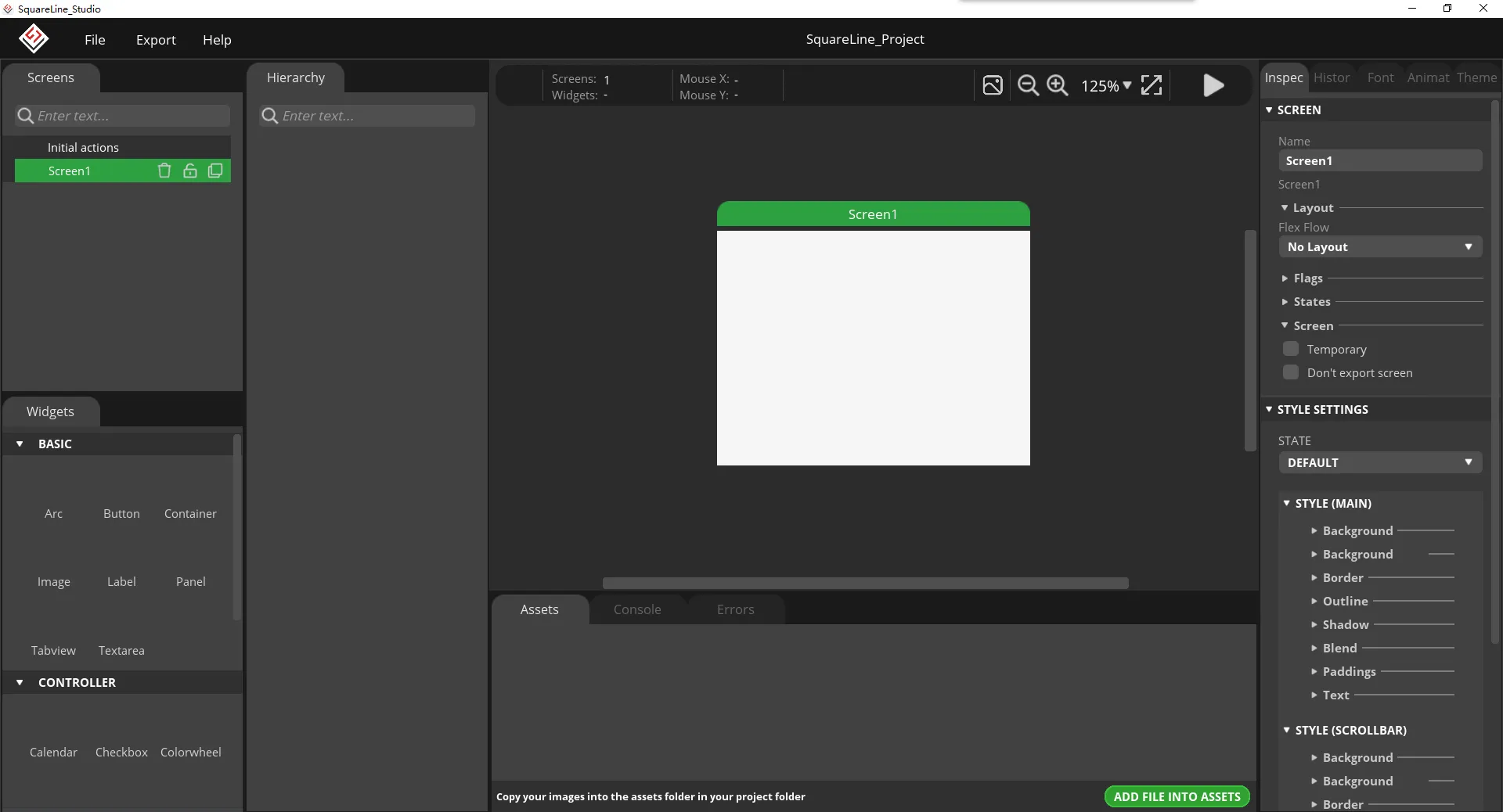

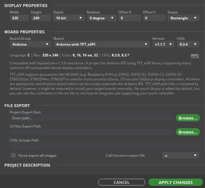

-  Open the SquareLine Studio and create a project. Select "Arduino"->"Arduino with TFT_eSPI". Noteļ¼ When select the Arduino framwork, there's only one optionĀ "Arduino with TFT_eSPI". By choosing this, the squareline studio will generate a template code suitable for the TFT_eSPI library. However, squareline studio not only supports the TFT_eSPI library, it supports a variety of libraries to suit different hardware and application needs. For example, Adafruit_GFX library, LovyanGFX etc. After using SLS to generate UI code, we then use different graphics libraries according to different hardware and modify the corresponding code to display the content you design.
-  Set the name of the project, set the screen resolution to 320*240, set the color depth to 16bit, and keep other default settings. After setting, click CREATE to create the project. - 16-bit color depth: can represent 65,536 colors through RGB 5:6:5 sub-pixel representation, that is, each RGB channel occupies 5 bits and 1 bit (a total of 16 bits) to represent colors.

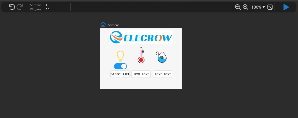

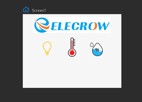

-  After creation, enter the following interface with a blank background.

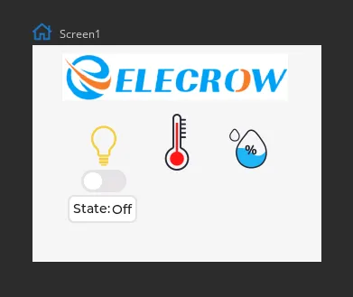

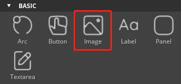

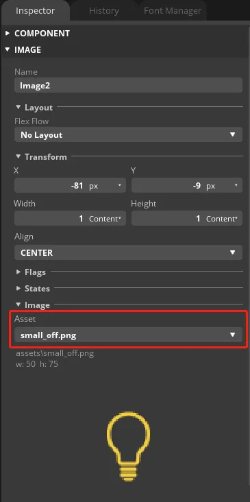

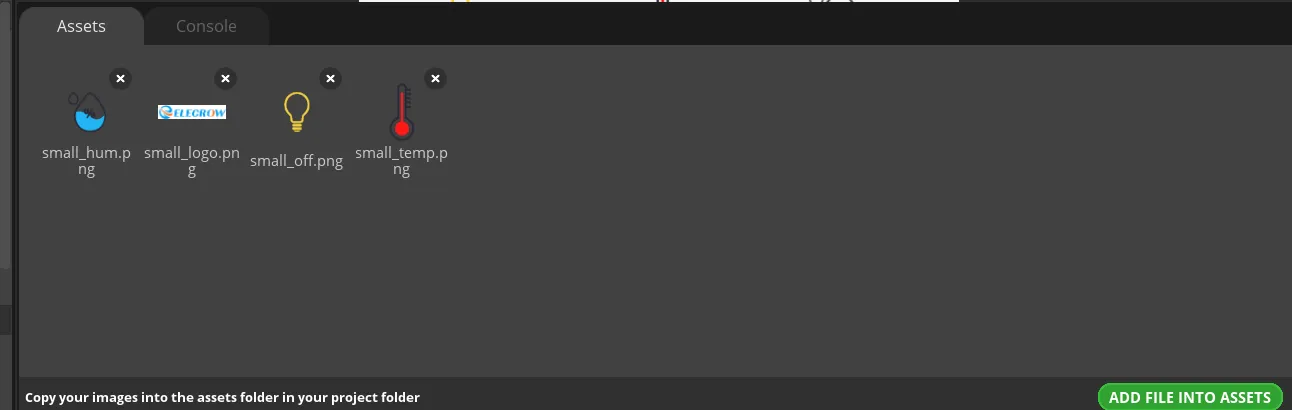

-  In the "Assets" area, click "ADD FILE TO ASSETS" to add custom images or icons. Please click  to download the custom images used in this tutorial. to download the custom images used in this tutorial.Noteļ¼ Images only support PNG format. The pixels of the image need to be smaller than the pixel size of the screen used in your project. The size of each image should not exceed 100k, preferably within 30k, to provide a smooth display effect.
-  Select "Image" to add icons. Repeat the above steps to add other icons.

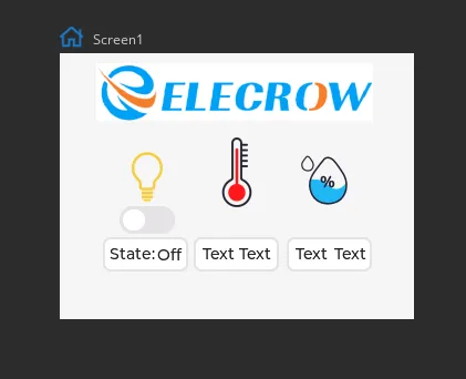

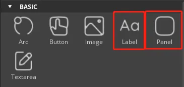

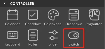

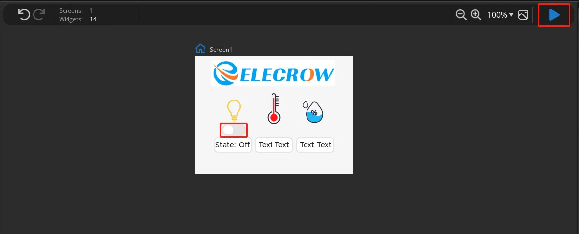

-  Find "CONTROLLER" and click "switch" , place the switch under small_off.webp Then find "BASIC" and click "Panel", and add two "Label" at the "Panel". Note the hierarchy.
-  Selected the "Label", the contents of the label can be modified in the "Inspector". Modified as shown in the following picture. Please add a "Panel" and two "Label" for the remaining two icons.

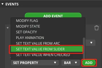

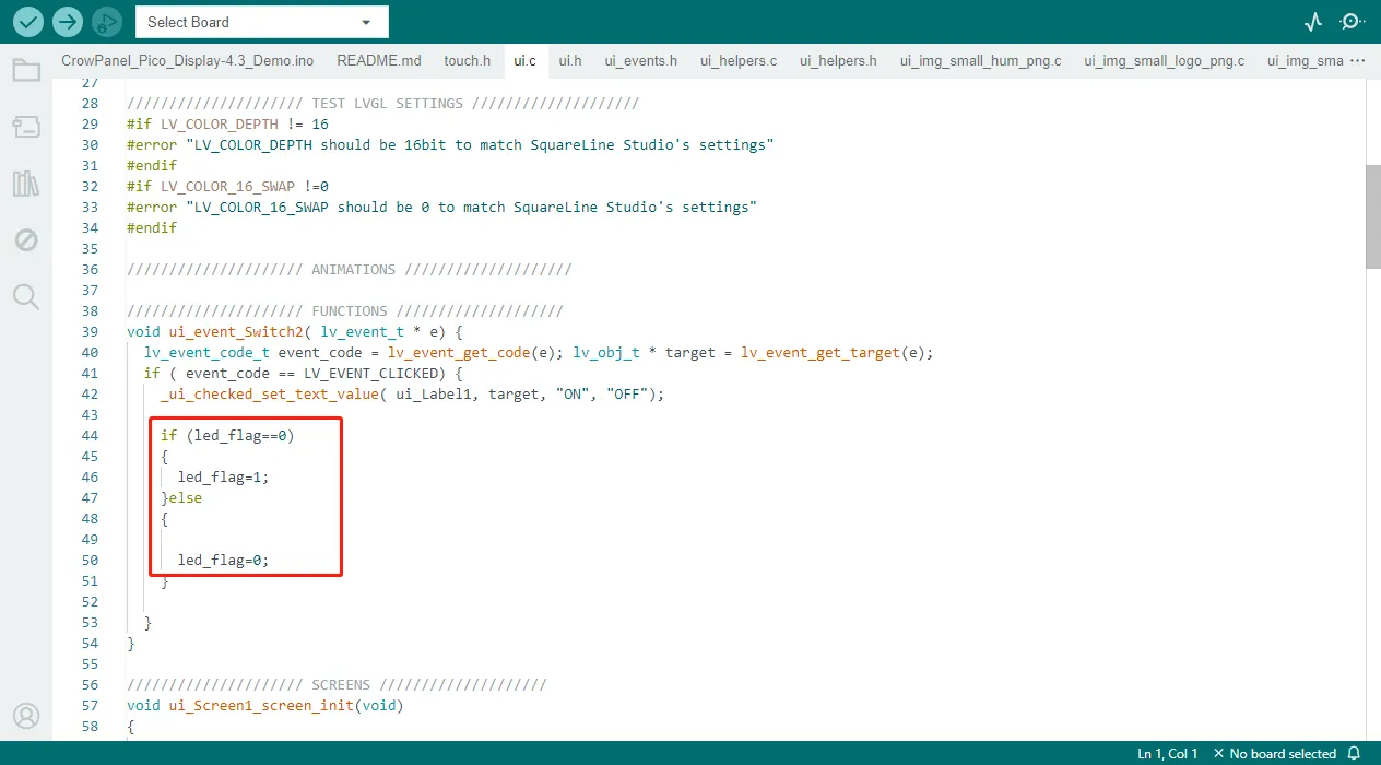

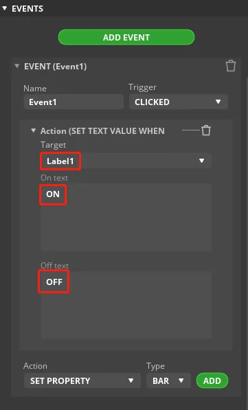

-  Select the "Switch" we built earlier, and add an event to "Switch". "Inspector"→"EVENTS"→"ADD EVENT"
-  Click the Play button in the upper right corner to check whether the event is added successfully.

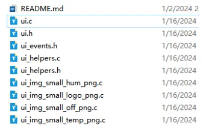

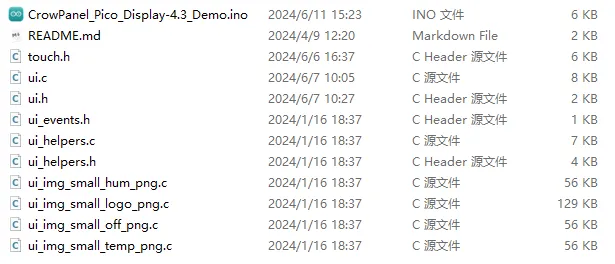

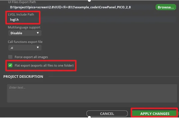

-  Export UI files. Click "File" -> "Project Settings" and make settings for the exported file. Set the export path of the file (set the path according to your own file). Fill in lvgl.h in LVGL Include Path. Check "Flat export(exports all files to one folder )". Then click "APPLY CHANGES". Tips: After selecting the flat export, the output files will be in the same folder, so that the output code does not need to modify the path in the program. If not, the output files will be classified and placed in different folders. The compiler may not be able to recognize different paths, which will cause some trouble. In this case, the user needs to modify it manually, so it is recommended to select all files to be output to the same folder. Export UI files. The exported files will be in the path we set earlier.
 The following picture is the output UI file
 Please click to download the main program(and the expert UI is included). to download the main program(and the expert UI is included).

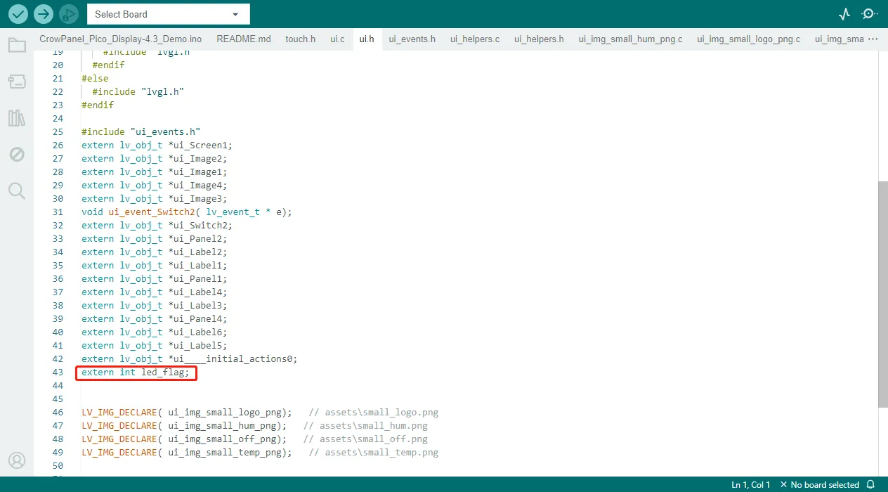

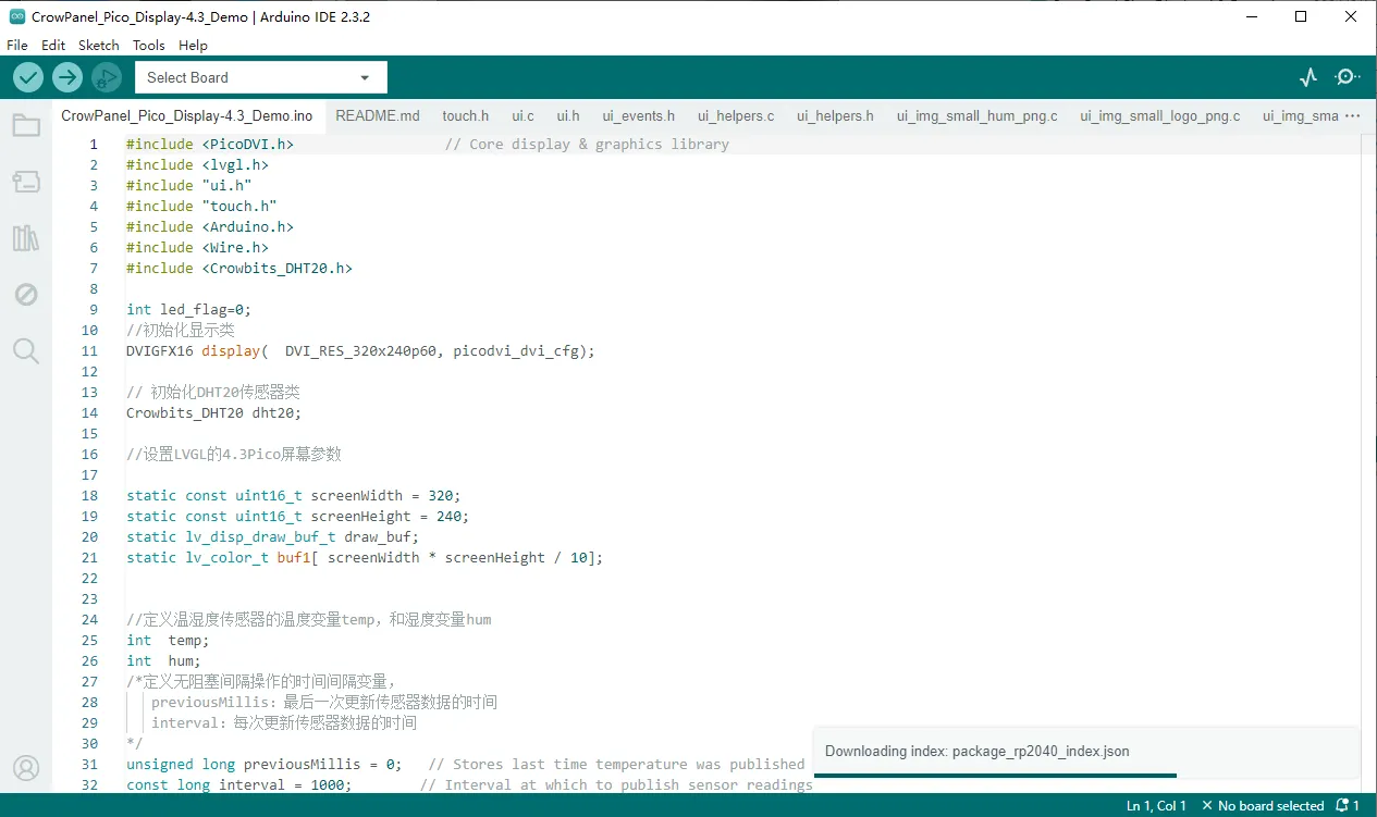

-  Open the main program. And all the UI file in the same folder will open too. First, define a variable in the ui.h file to store the status of the LED. In the main program, the LED light is controlled to turn on and off by judging the status of this variable. Then find "FUNCTION" in the ui. c file. Here is the corresponding code generated when we add events in SquareLine. Next we're going to learn about the Arduino main program and learn how to upload the code to the board.

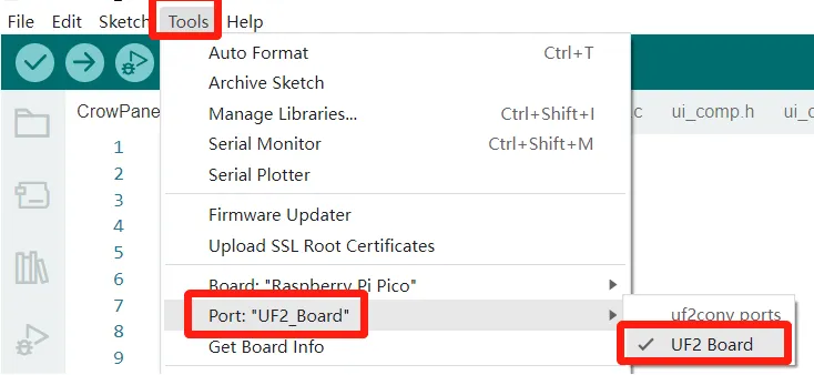

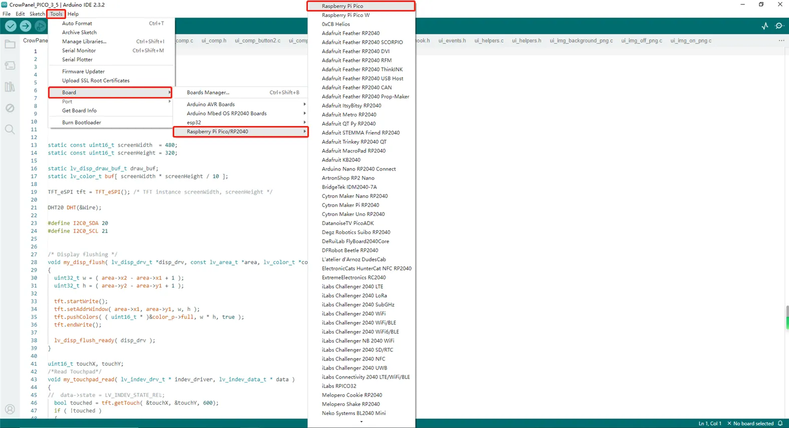

Build the Project with Arduino IDE¶
Get Started with Arduino IDE¶

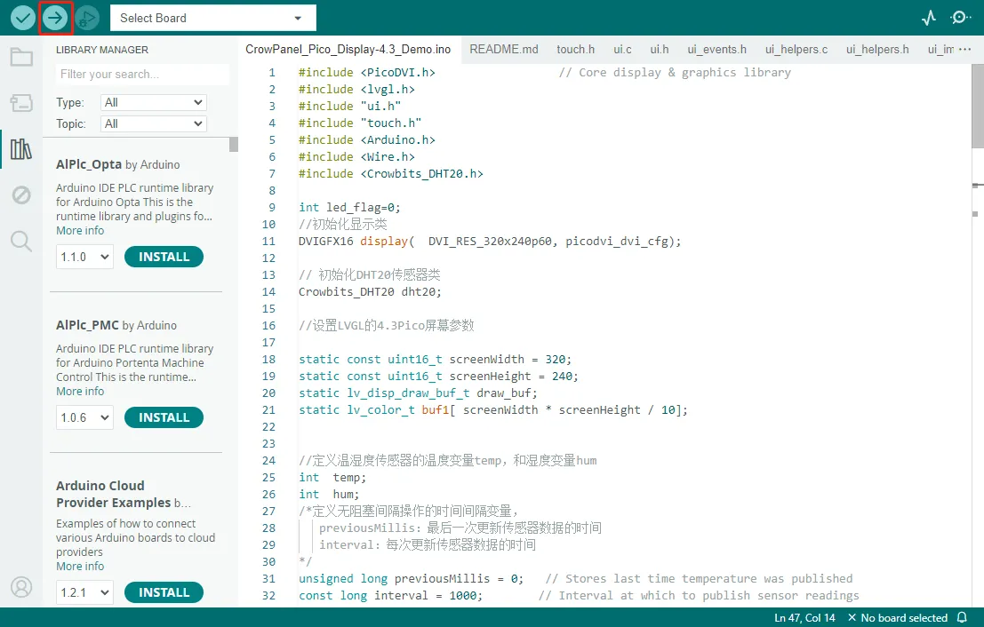

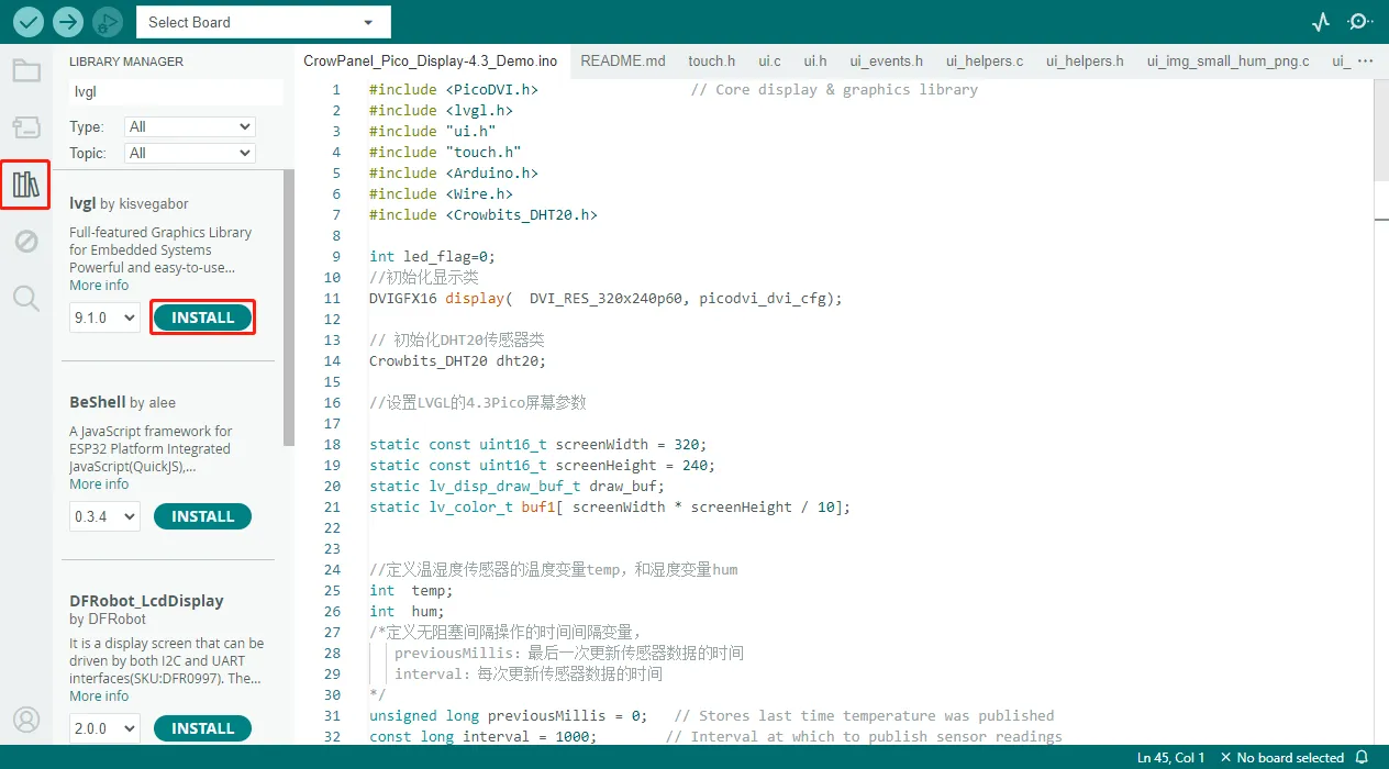

Please click the card below to learn how to install Arduino IDE, and install RP2040 board in the Arduino IDE.
Add Libraries¶
#include <PicoDVI.h>
#include <lvgl.h>
#include "ui.h"
#include "touch.h"
#include <Arduino.h>
#include <Wire.h>
#include <Crowbits_DHT20.h>
- #include <Arduino.h>: contains the Arduino core library, providing commonly used functions and data types.
- #include <lvgl.h>: is library for graphical interfaces, used for display control and drawing.
- "ui.h": is a custom header file that contain UI-related functions or definitions.
- #include <Wire.h>: here we use this library for I2C communication.
- "DHT20.h": to read data from the DHT20 temperature and humidity sensor.
Please click to download the libraries we modified.
Tips:
- If you install the lvgl libraries by Library Manager, you need to copy the demos folder and examples folder and paste them to src folder. And modify theĀ lv_conf_template.h file and rename it to lv_conf.h, and place it in libraries folder.(Please refer to the library provided)

#include <PicoDVI.h>                  // Core display & graphics library
#include <lvgl.h>
#include "ui.h"
#include "touch.h"
#include <Wire.h>

-  After completing the installation of the RP2040 board according to "Get Started with Arduino IDE" and the installation of the library according to "Add Libraries", open the program and connect the PICO HMI 3.5-inch to the computer via a USB-C cable.
-  Select Board: click "Tools" -> "Board" -> "Raspberry Pi Pico/RP2040" and select "Raspberry Pi Pico"
-  Select Port: Please hold the BOOT button and press the RESET button first, and the PICO HMI board will turn into a U disk. Then click "Tools" -> "Port" and select UF2...(Note: you need to press the button every time you need to connect the board with computerĀ through serial communication.)
-  Upload the code
-  After the program is successfully uploaded, connect the DHT20 sensor to the IIC port and the LED to GPIO_D.
Click the Switch. When the State is ON, the LED is on. When the State is OFF, the LED is off. Temperature and humidity values are monitored in real time.
