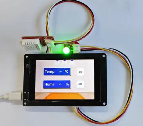

The example tutorial is an environmental monitoring project, demonstrate how to create a UI and use a Humidity&Temperature sensor to obtain the environment temperature and humidity and display it on the screen; and how to control the LED on and off by the buttons on the screen.
In this tutorial, we will show you how to design the UI with SquareLine Studio, and show you how to upload the code with Thonny IDE.

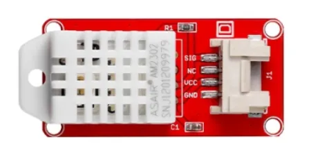

ESP32 Terminal RGB Crowtail-AM2302 Crowtail-LED
CrowPanel-ESP32-Content-T-RGB1 AM2302 CROWTAIL-LED

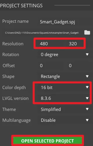

  2. Set the name of the project, set the screen resolution to 480*320, set the color depth to 16bit, and keep other default settings. After setting, click CREATE to create the project.
    SLS-UI-2

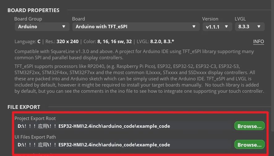

  9. Export UI files.
    SLS-UI-25
    SLS-UI-26
    Then click "APPLY CHANGES".

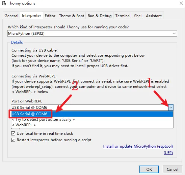

  1. Connect the CrowPanel ESP32 HMI with your computer.

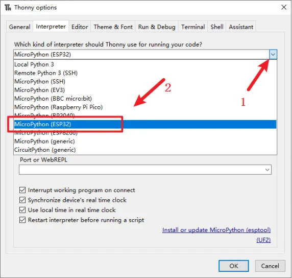

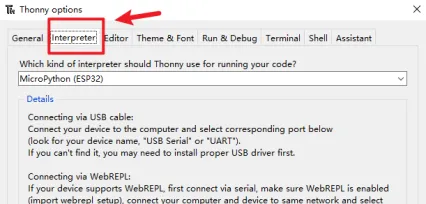

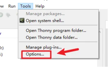

  2. Open Thonny IDE and click "Tools"->"Options"->"Interpreter".
  3. Select "MicroPython(ESP32)" for interpreter.
  4. Select the corresponding serial port(or Try to detect port automatically).
  5. Click "Install or update MicroPython (esptool)"
  6. Click the icon with 3 lines, and click "select local MicroPython image...".Select the "lv_micropython.v1.19.1-ili9341-xpt2046.bin" and install.
    Please click download to download the bin file.

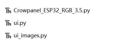

  • The main code is "CrowPanel_ESP32_RGB_3.5.py"
  • The "ui_image.py" is the libraries
  • The ui.by is exported from Squaline Studio and needs to be copied into the main program

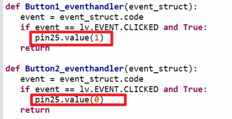

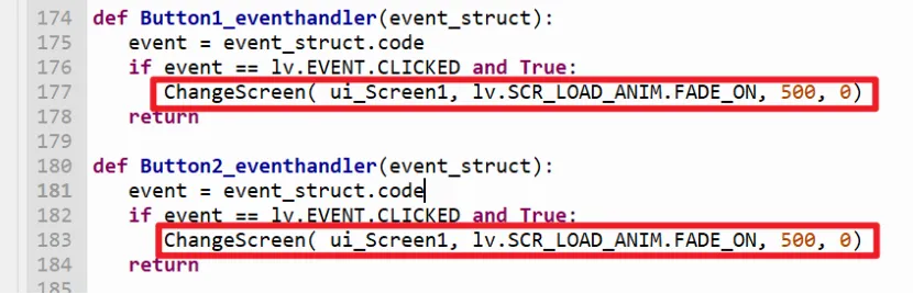

This part copies the code of ui.py generated by Squareline Studio. We need to modify the part that control the button.
From
button-1
to
button-2

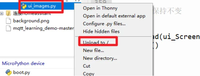

Upload the libraries
ui_image
  1. In the upper left corner of the thonny, enter the path where DHT20.py is located, right-click DHR20.py, and click Upload to/
  2. Waiting for uploading
  3. The DHT20.py will be added to the MicroPython device column.

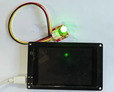

Example 1 LED Blinking
  • Plug the LED module to GPIO-D Port
  • Upload the led.py to board
  • The LED will blink
    led-blink

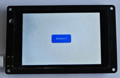

Example 2 Show the button on the screen
  • Upload the button-1-3.5.py to the board
    button-onscreen

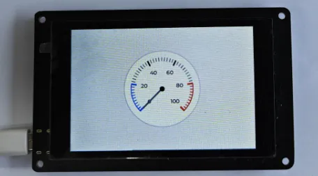

Example 3 Show the dial plate on the screen
  • Upload the biaopan-3.5.py to the board
    biaopan

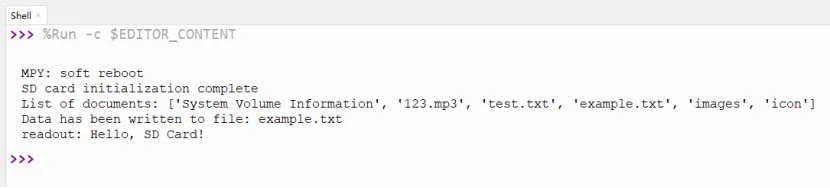

Example 5 Initialize SD card
  • Insert the SD card to the card slot
  • Upload the sd.py
    SDCARD
