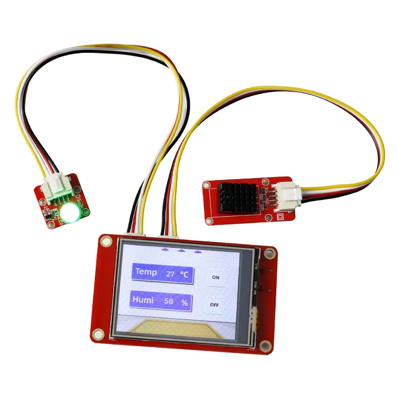

This example tutorial is a project for controlling the on and off of an LED. It demonstrates how to create a UI and how to control the on and off of an LED through buttons on the screen.
In this tutorial, we will show you how to design the UI with SquareLine Studio, and show you how to build a project on PlatformIO.

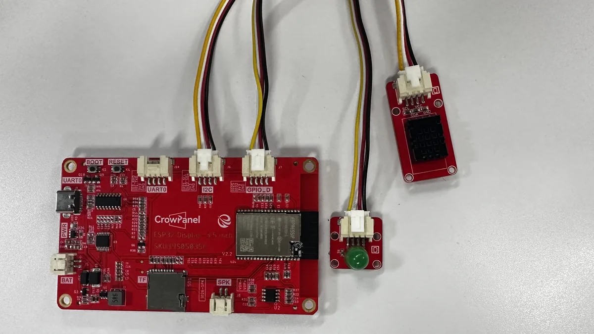

Hardware Preparation¶
| CrowPanel ESP32 3.5'' HMI | Crowtail-DHT20 | Crowtail-LED |

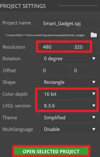

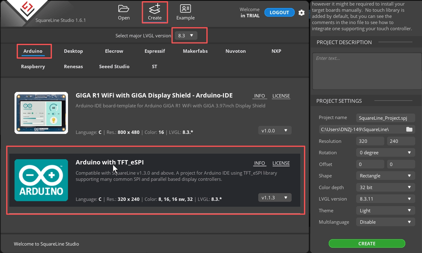

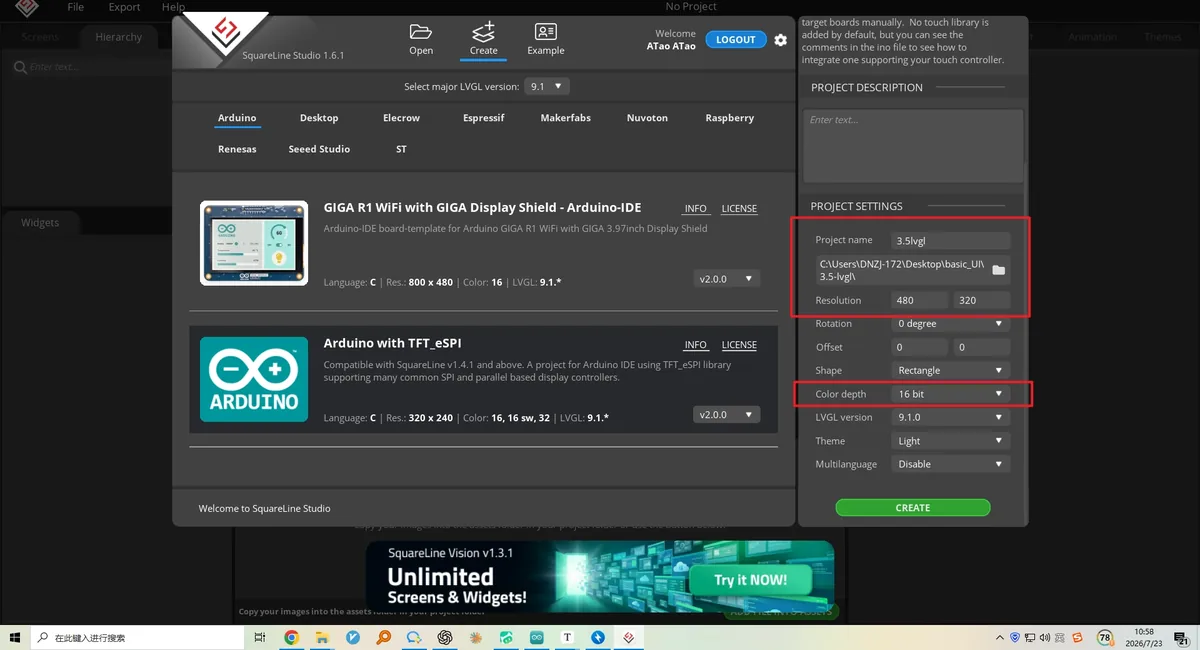

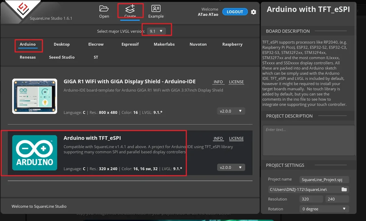

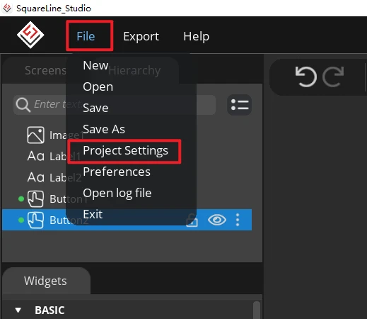

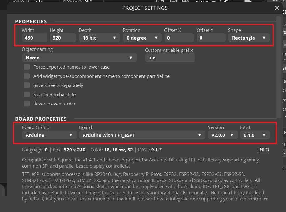

Open the SquareLine Studio and create a project. Select "Arduino"->"Arduino with TFT_eSPI".
Note:

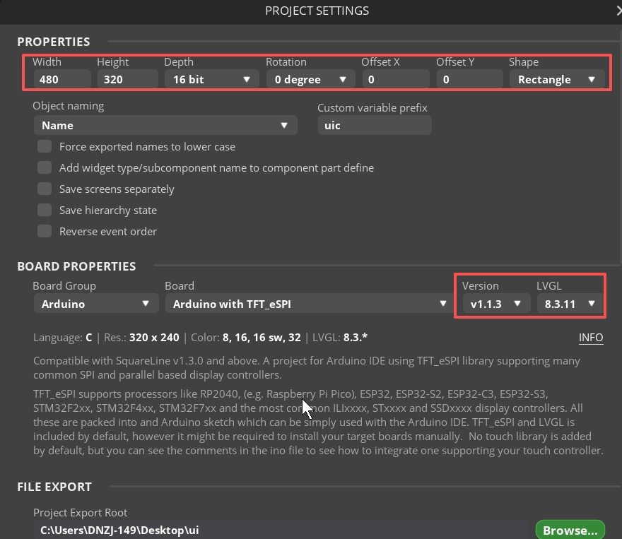

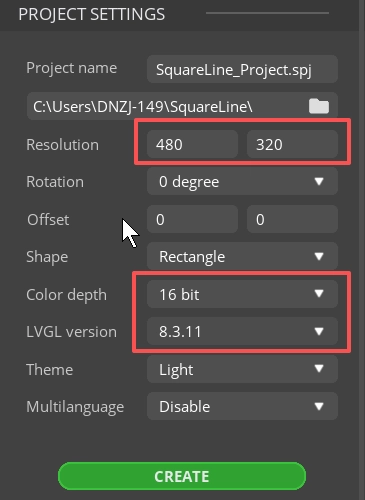

Set the name of the project, set the screen resolution to 480*320, set the color depth to 16bit, and keep other default settings. After setting, click CREATE to create the project.

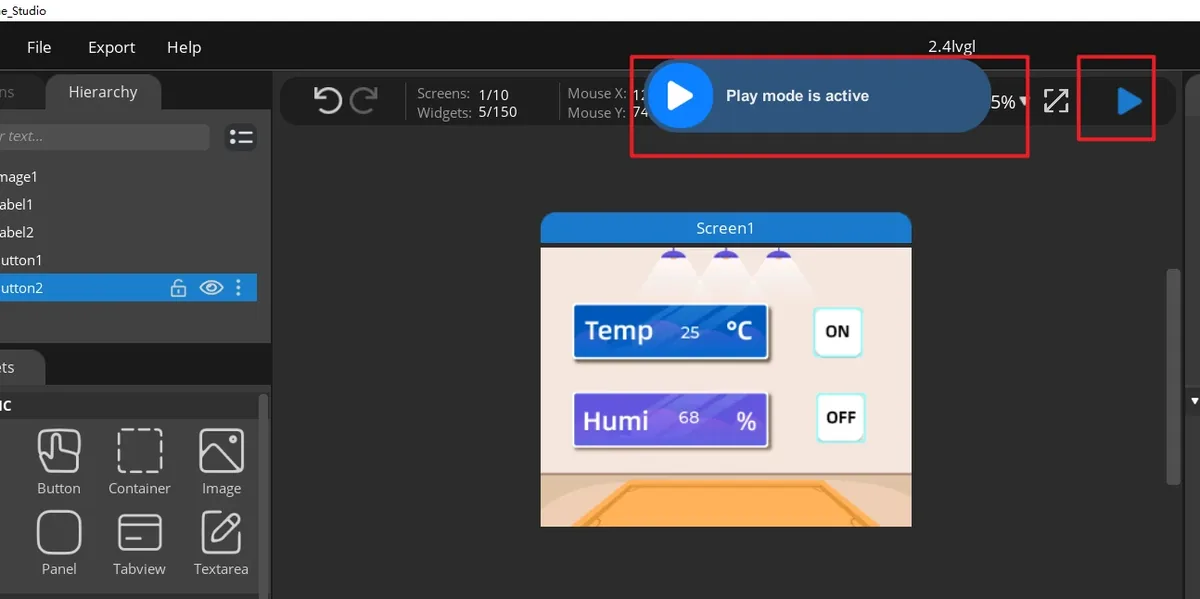

Add background.
Add Label widget to display temperature and humidity.

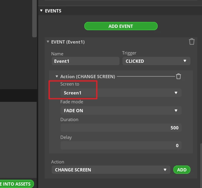

Add events to buttons.

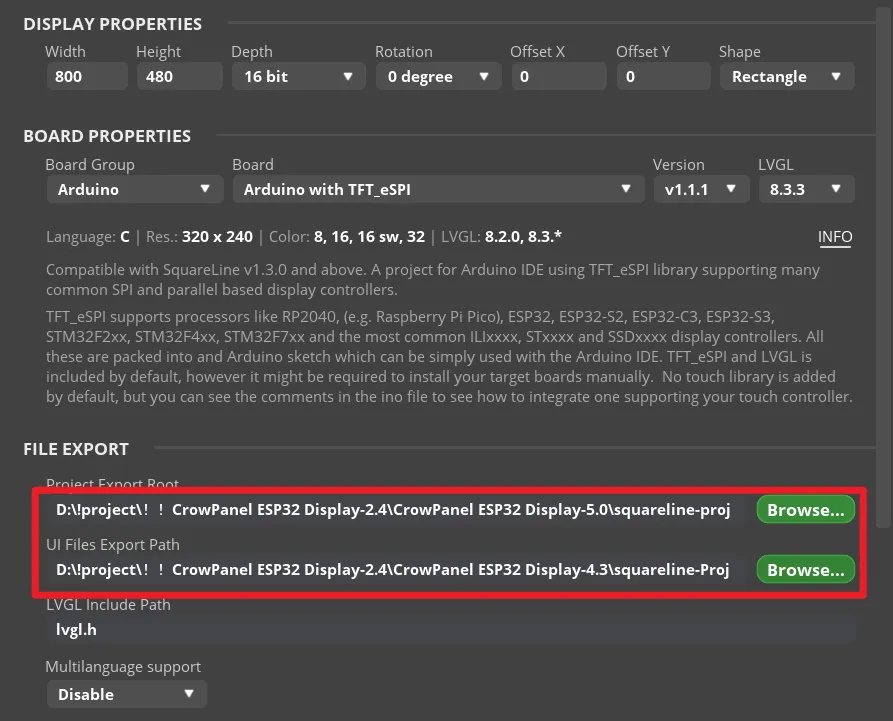

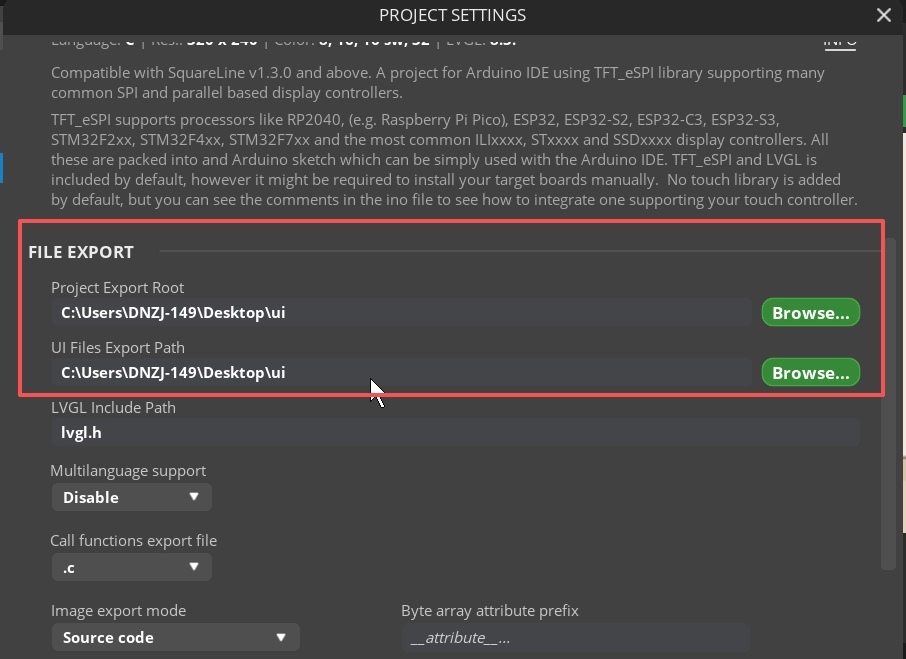

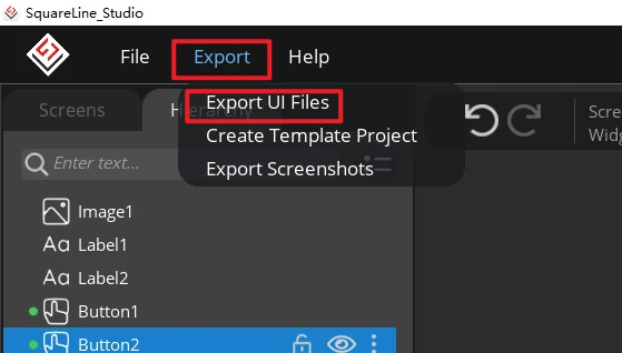

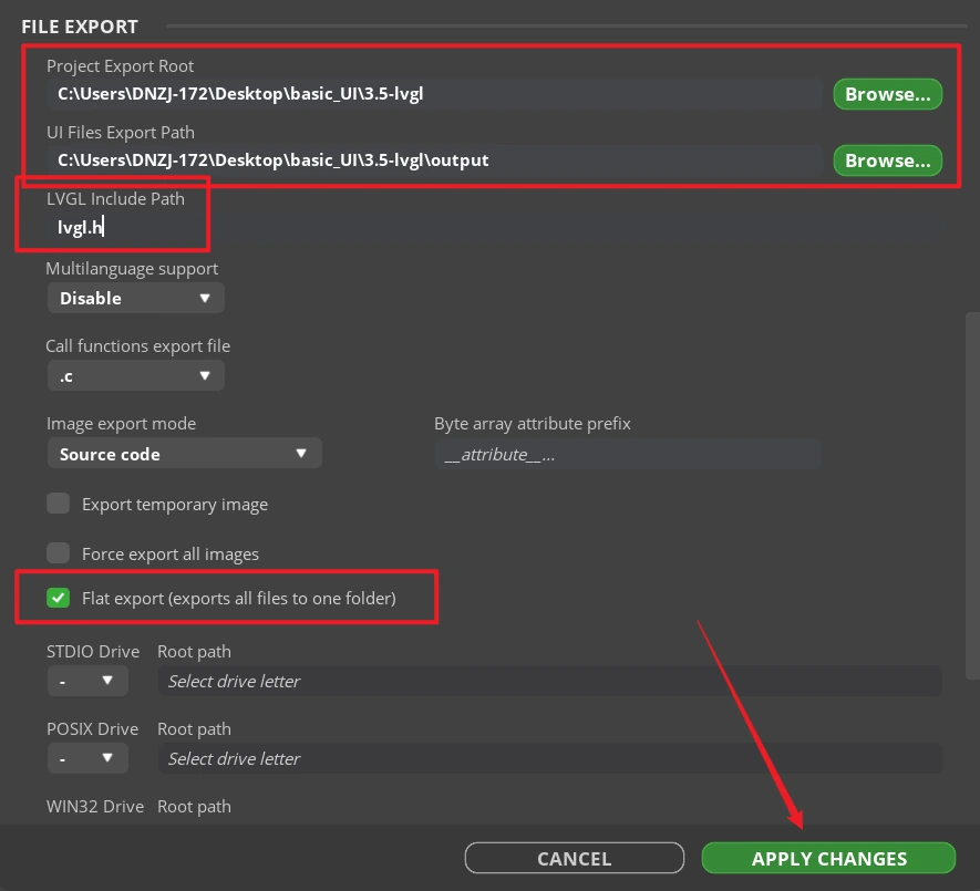

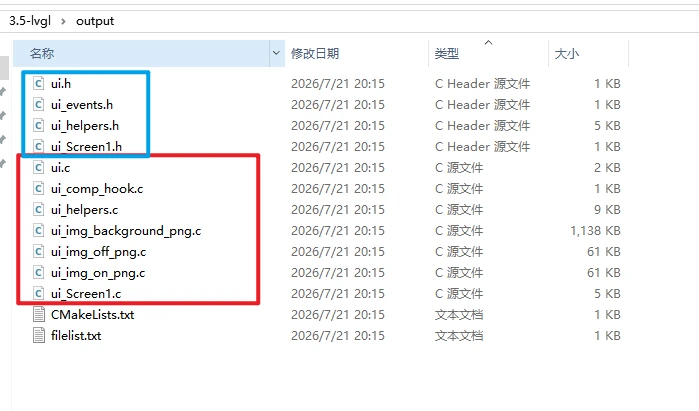

Export UI files.
Then click "APPLY CHANGES".

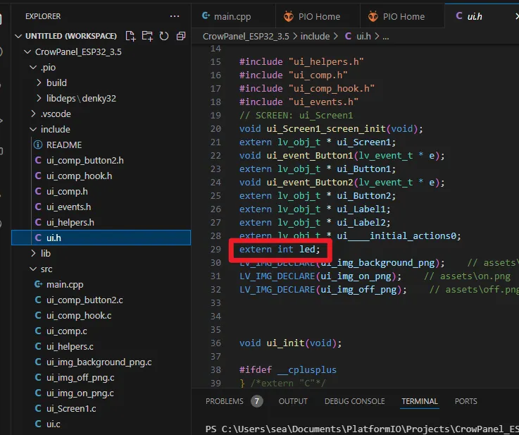

First, define a ‘extern int led;' in the ui.h file to store the status of the LED. The value of this variable is judged to control the on and off of the LED.
When button 1 (ON button) is pressed, set the LED value to 1.
When button 2 (OFF button) is pressed, set the LED value to 0.

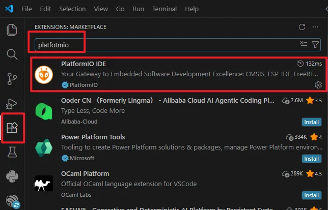

Get Started with PlatformIO¶
Please click the card below to enter the page to get started with PlatformIO.

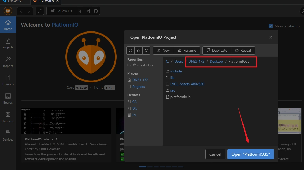

Create a new project¶

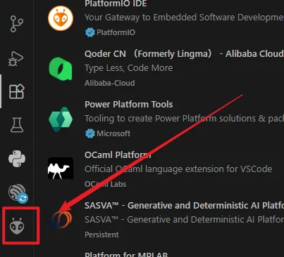

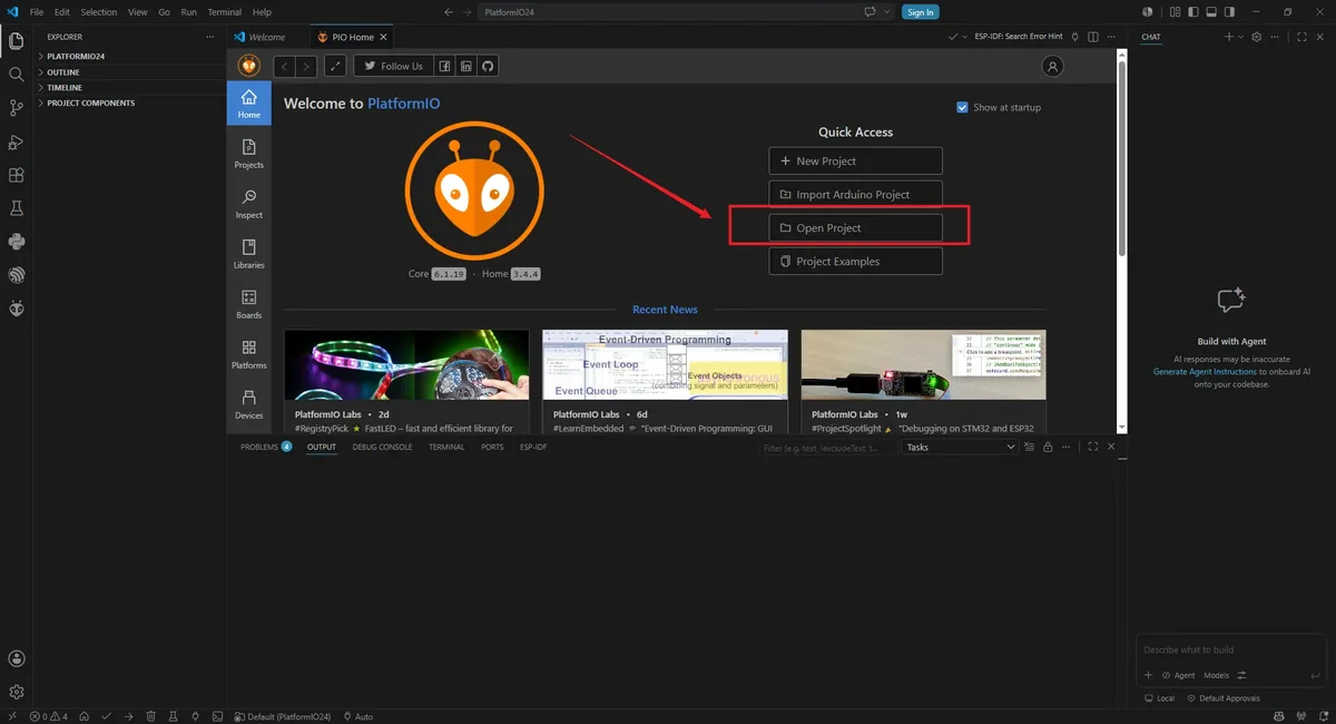

Open Visual Studio Code, click the PlatformIO icon, click QUICK ACCESS 'Open', then click '+New Project'.
Add a project name "CrowPanel_ESP32_3.5". Select "Denky(WROOM32)" for the board and "Arduino" for the framework.

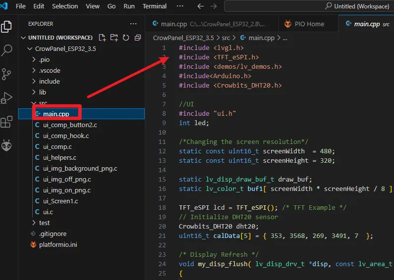

Write the main program in main.cpp.
#include <lvgl.h> #include <TFT_eSPI.h> #include <demos/lv_demos.h> #include<Arduino.h> #include <DHT20.h> //UI #include "ui.h" int led; /*Changing the screen resolution*/ static const uint16_t screenWidth = 480; static const uint16_t screenHeight = 320; static lv_disp_draw_buf_t draw_buf; static lv_color_t buf1[ screenWidth * screenHeight / 8 ]; TFT_eSPI lcd = TFT_eSPI(); /* TFT Example */ // Initialize DHT20 sensor DHT20 dht20; uint16_t calData[5] = { 353, 3568, 269, 3491, 7 }; /* Display Refresh */ void my_disp_flush( lv_disp_drv_t *disp, const lv_area_t *area, lv_color_t *color_p ) { uint32_t w = ( area->x2 - area->x1 + 1 ); uint32_t h = ( area->y2 - area->y1 + 1 ); lcd.startWrite(); lcd.setAddrWindow( area->x1, area->y1, w, h ); lcd.pushColors( ( uint16_t * )&color_p->full, w * h, true ); lcd.endWrite(); lv_disp_flush_ready( disp ); } uint16_t touchX, touchY; /*Read Touchpad*/ void my_touchpad_read( lv_indev_drv_t * indev_driver, lv_indev_data_t * data ) { bool touched = lcd.getTouch( &touchX, &touchY, 600); if ( !touched ) { data->state = LV_INDEV_STATE_REL; } else { data->state = LV_INDEV_STATE_PR; /*Setting the coordinates*/ data->point.x = touchX; data->point.y = touchY; Serial.print( "Data x " ); Serial.println( touchX ); Serial.print( "Data y " ); Serial.println( touchY ); } } void setup() { Serial.begin( 115200 ); /*Initializing the Serial Port*/ Serial2.begin( 9600 ); /*Initialize Serial Port 2*/ //IO Port Pins pinMode(25, OUTPUT); digitalWrite(25, HIGH); Wire.begin(22, 21); dht20.begin(); lv_init(); lcd.begin(); lcd.fillScreen(TFT_BLACK); delay(300); lcd.setTouch( calData ); //Backlight Pins pinMode(27, OUTPUT); digitalWrite(27, HIGH); lcd.setRotation(1); lv_disp_draw_buf_init( &draw_buf, buf1, NULL, screenWidth * screenHeight / 8 ); /*Initializing the display*/ static lv_disp_drv_t disp_drv; lv_disp_drv_init( &disp_drv ); /*Change the following line to display resolution*/ disp_drv.hor_res = screenWidth; disp_drv.ver_res = screenHeight; disp_drv.flush_cb = my_disp_flush; disp_drv.draw_buf = &draw_buf; lv_disp_drv_register( &disp_drv ); /*Initialize the (virtual) input device driver*/ static lv_indev_drv_t indev_drv; lv_indev_drv_init( &indev_drv ); indev_drv.type = LV_INDEV_TYPE_POINTER; indev_drv.read_cb = my_touchpad_read; lv_indev_drv_register( &indev_drv ); ui_init(); } void loop() { Serial.print(led); char DHT_buffer[6]; int a = (int)dht20.getTemperature(); int b = (int)dht20.getHumidity(); snprintf(DHT_buffer, sizeof(DHT_buffer), "%d", a); lv_label_set_text(ui_Label1, DHT_buffer); snprintf(DHT_buffer, sizeof(DHT_buffer), "%d", b); lv_label_set_text(ui_Label2, DHT_buffer); if(led == 1) digitalWrite(25, HIGH); if(led == 0) digitalWrite(25, LOW); lv_timer_handler(); /* let the GUI do its work */ delay( 10 ); }

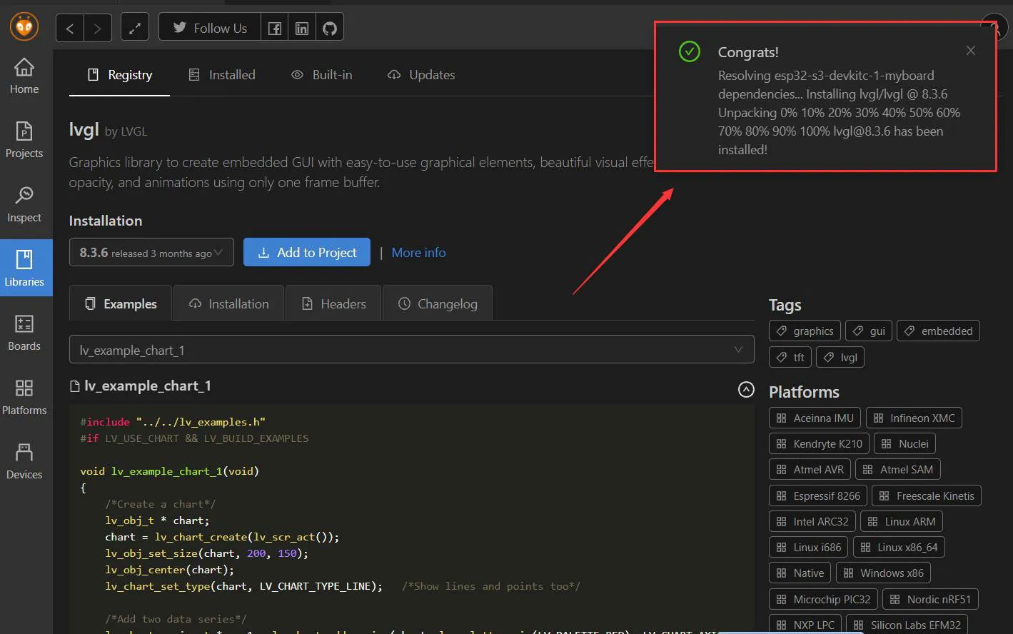

Add Libraries¶

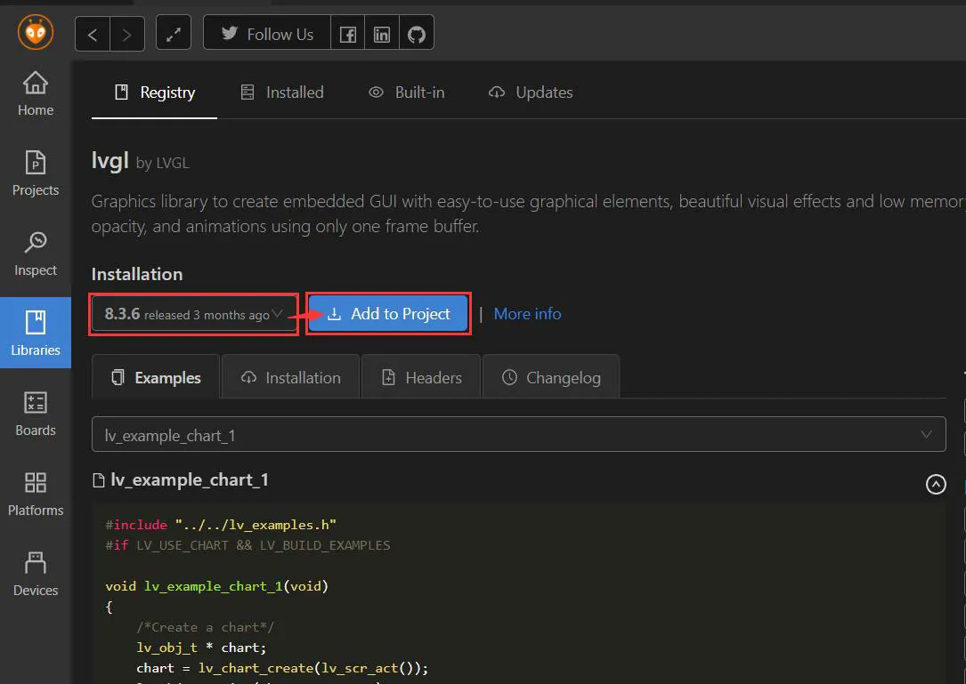

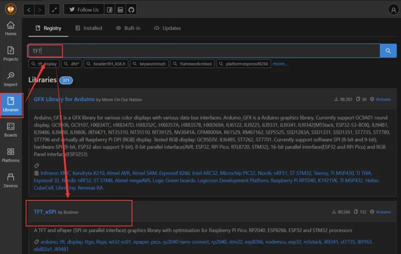

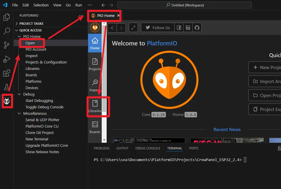

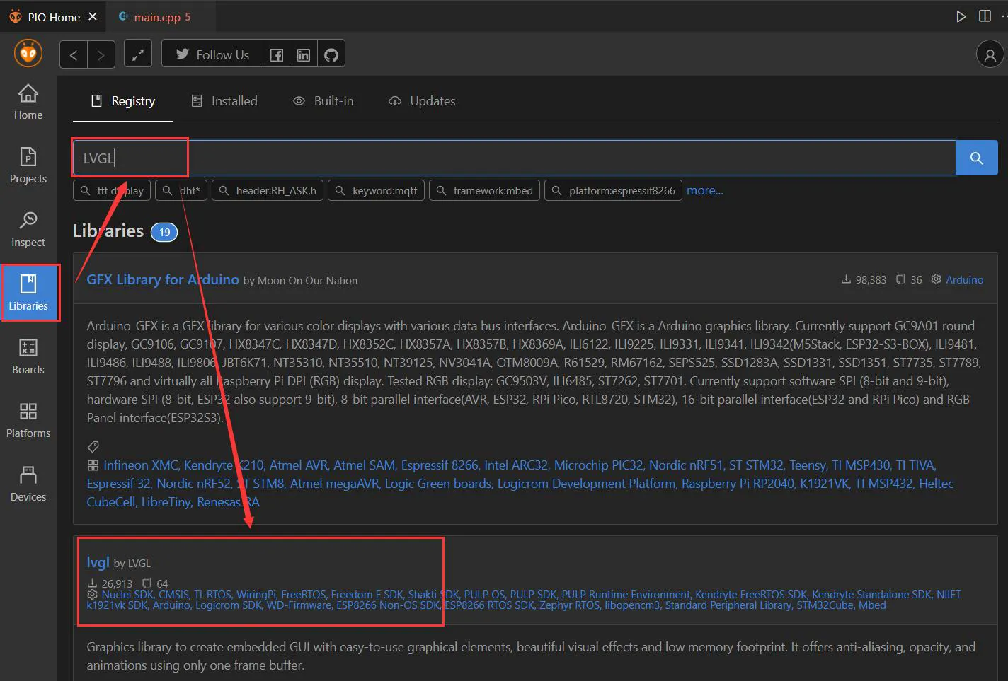

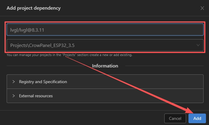

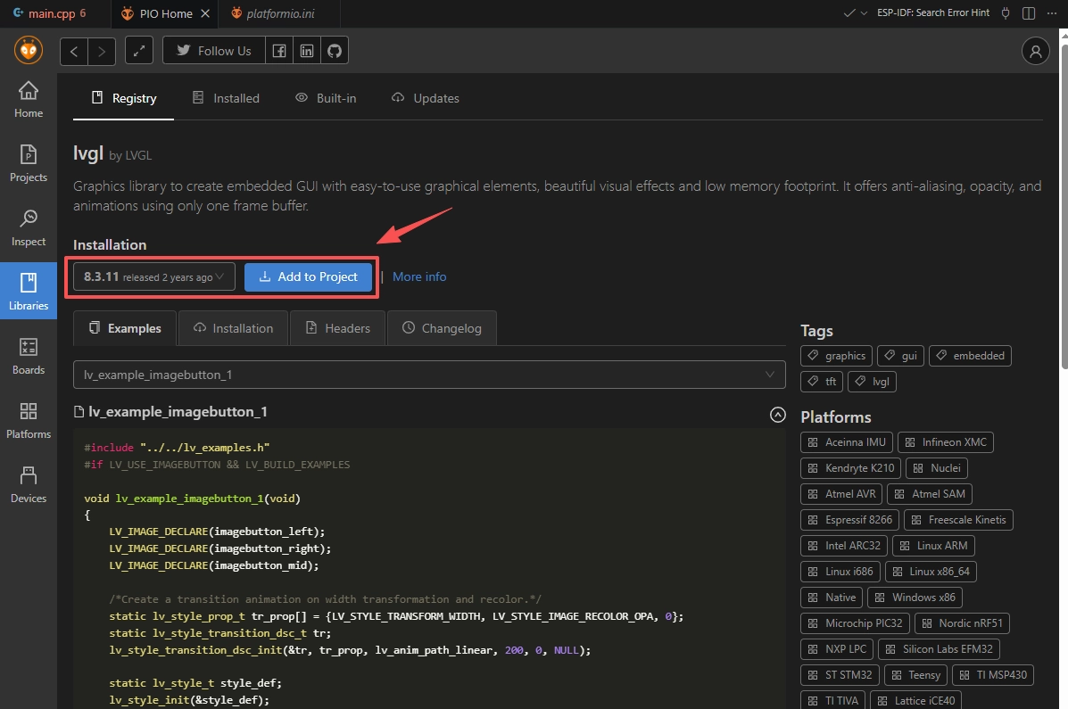

Click the PlatformIO icon, click QUIK ACCESS 'Open', then click 'Libraries'.

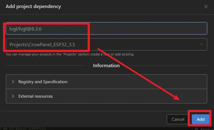

Search for LVGL, and add it to the project.

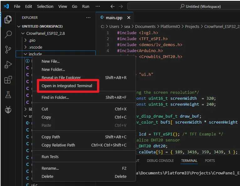

After adding, right click on lvgl and select "Open in Integrated Terminal"

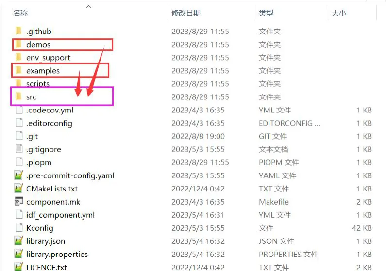

Copy the "demos" and "examples" folders to "src" folder

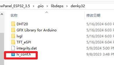

Place the lv_conf.h we provide to the path: .pio\libdeps\denky32 in the project folder.

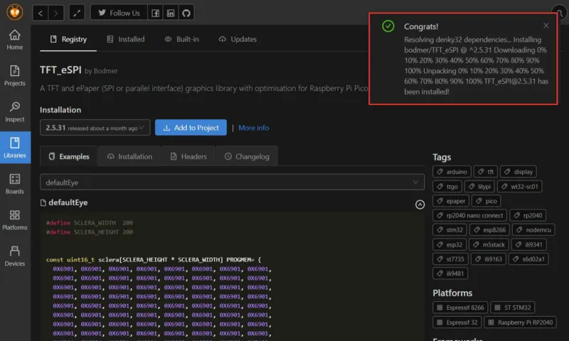

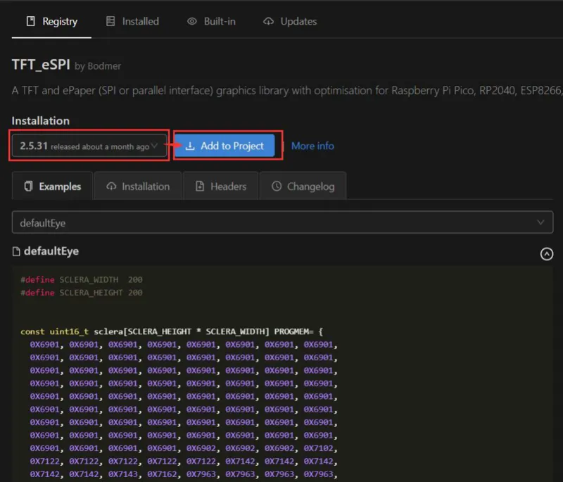

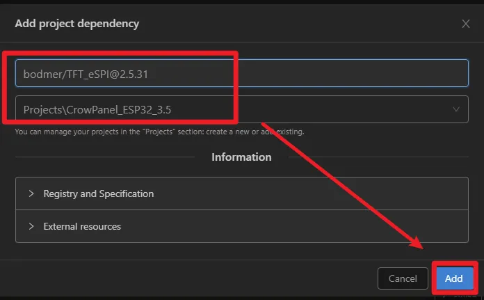

Add TFT_eSPI library.
We can see that the library has been added successfully!

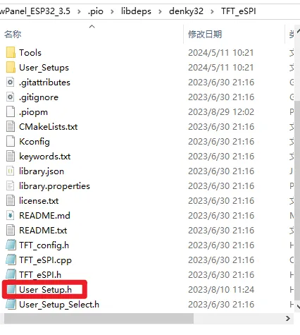

Delete the User_Setup.h in the TFT_eSPI folder and copy the provided User_Setup.h to the TFT_eSPI folder.

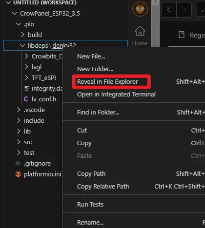

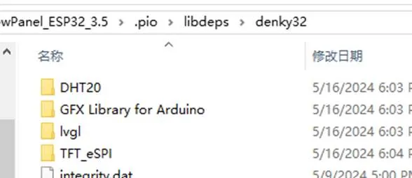

Add DHT20 library.
Right-click the "libdeps\denky32", click "Reveal in File Explorer", and select the DHT20 library we provided.

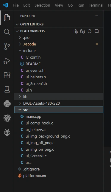

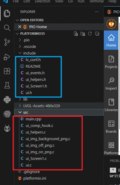

Add the UI file into PlatformIO Project¶

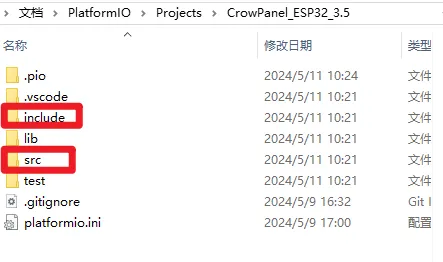

We need to add the UI file (generated from SquareLine Studio) to the PlatformIO project.

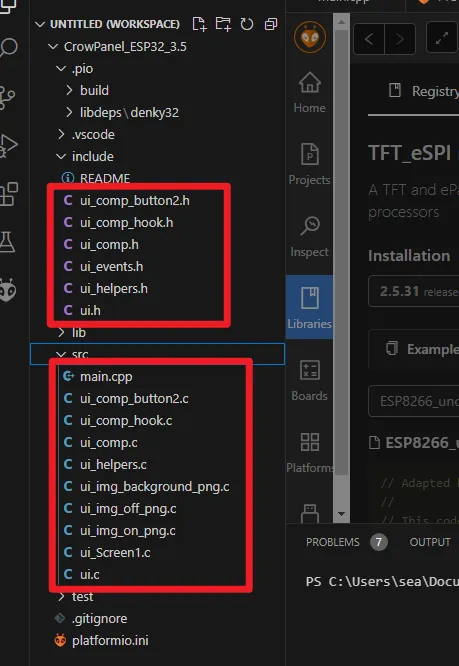

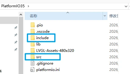

The .c files in the UI file should be placed in the /scr folder of the project file, and the .h files should be placed in the /include folder.

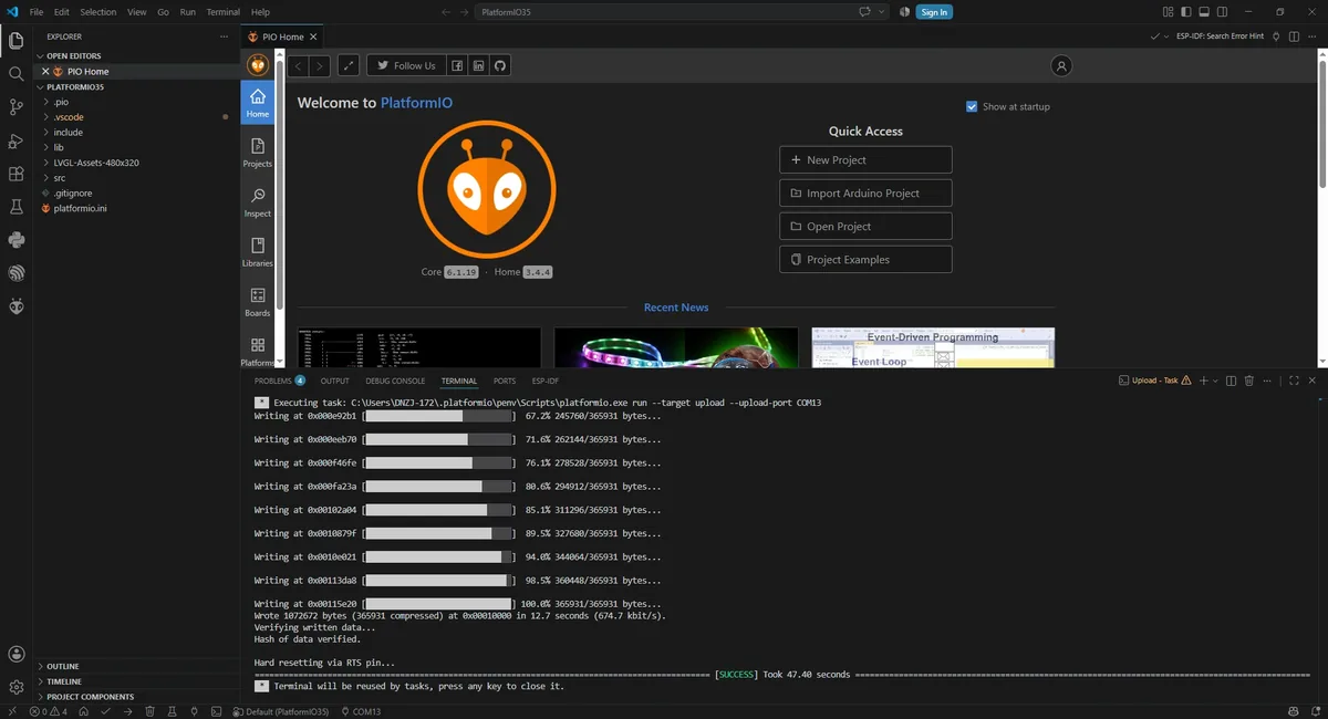

Upload the Code¶

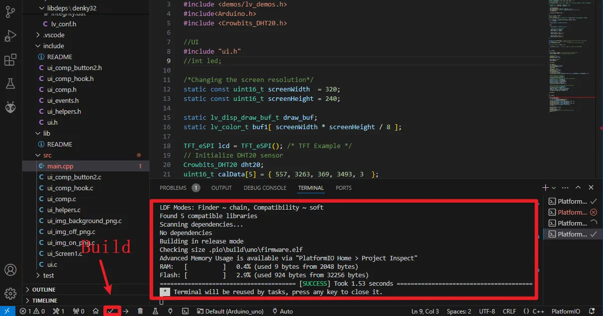

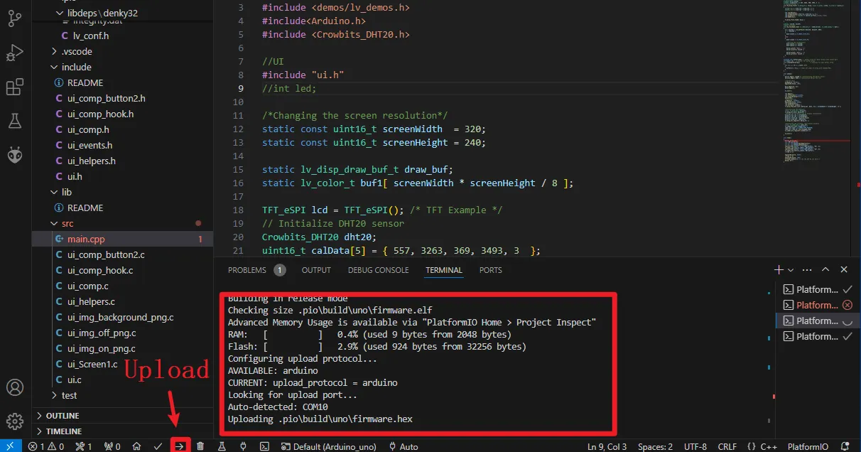

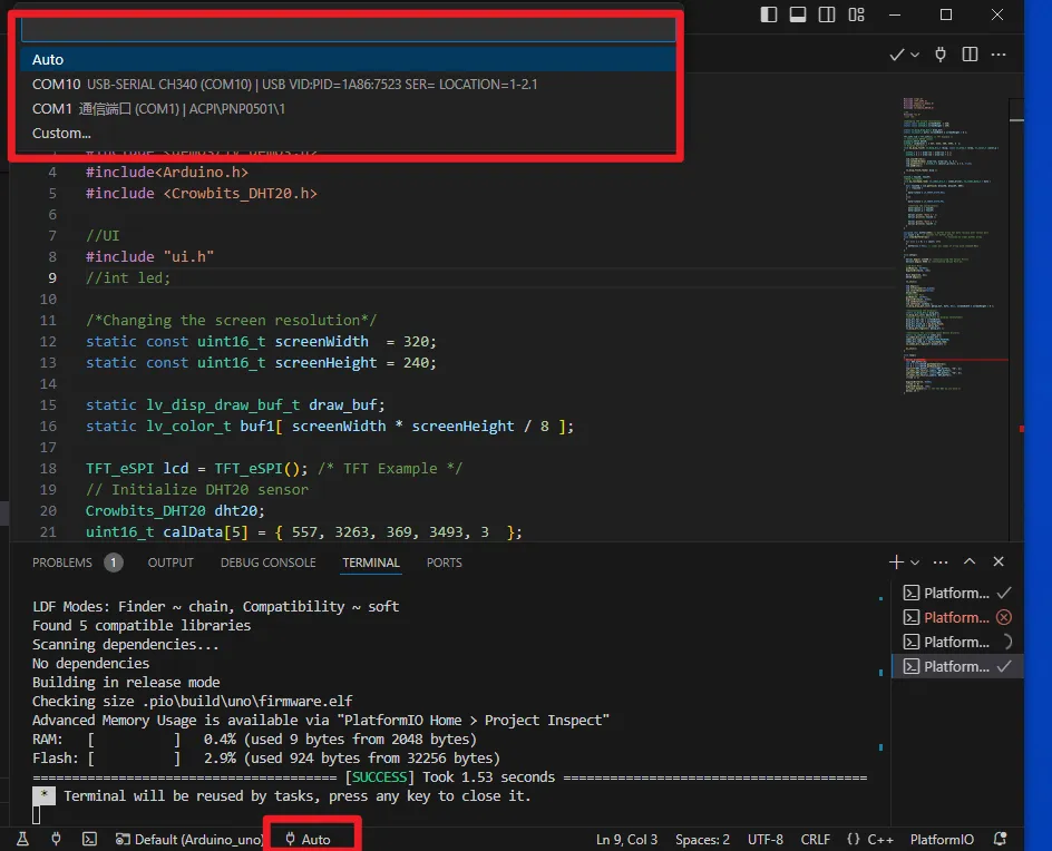

Compile the program.

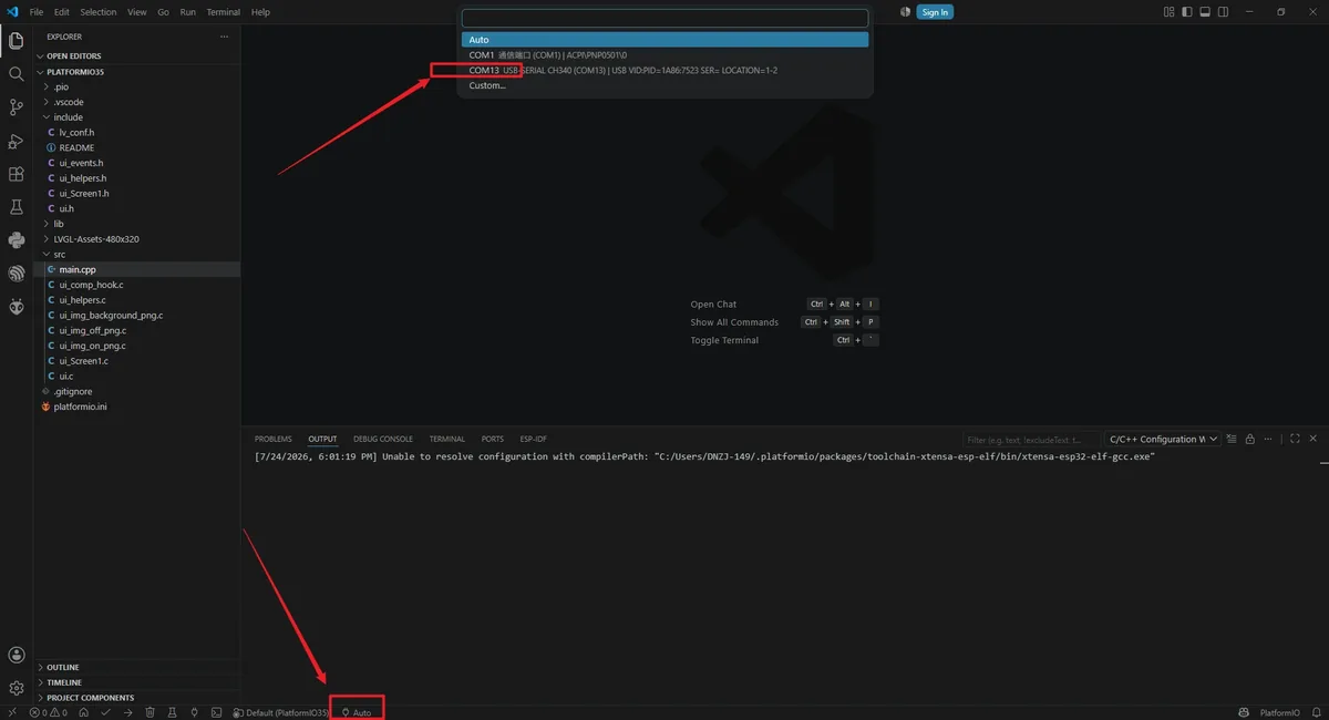

Select the serial port and upload the code.
Here we select Auto. The software will automatically select the corresponding serial port for program download. If the automatically selected serial port is incorrect, you can manually select the correct serial port.
Click the upload button to up the program to the board.

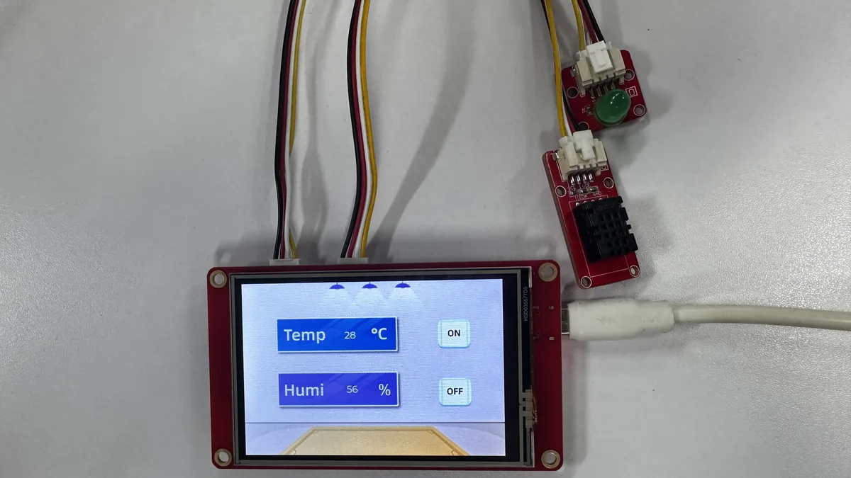

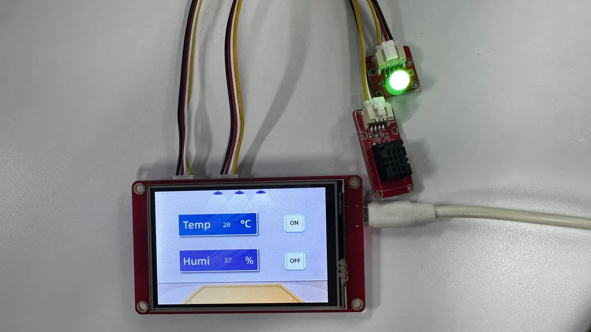

The program will run on the board!
