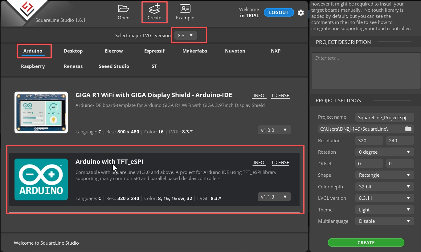

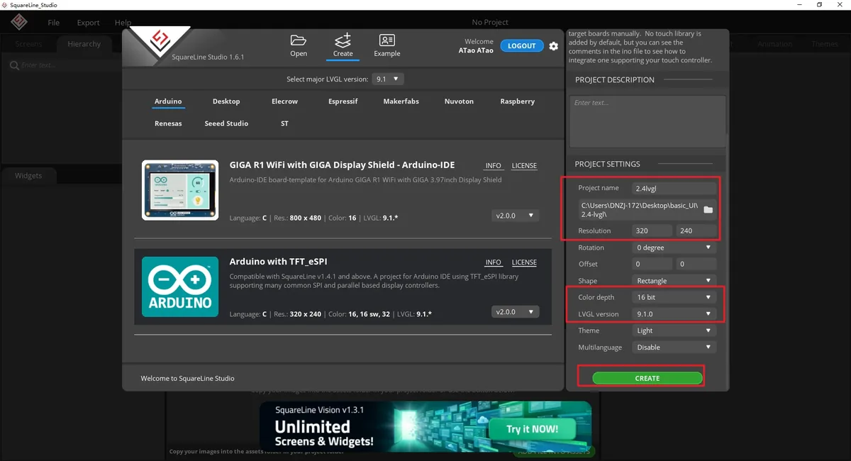

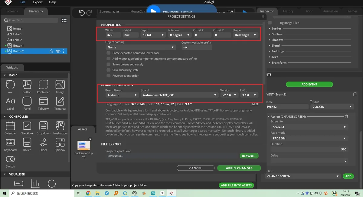

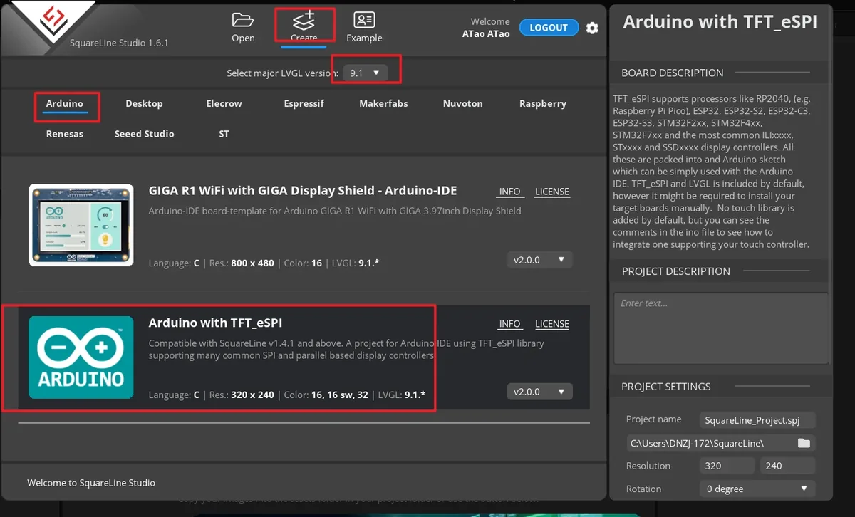

  1. Open the SquareLine Studio and create a project. Select "Arduino"->"Arduino with TFT_eSPI".
    Note:
    When select the Arduino framwork, there's only one option "Arduino with TFT_eSPI". By choosing this, the squareline studio will generate a template code suitable for the TFT_eSPI library. However, squareline studio not only supports the TFT_eSPI library, it supports a variety of libraries to suit different hardware and application needs. For example, Adafruit_GFX library, LovyanGFX etc.

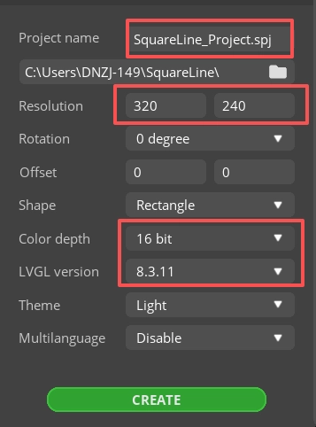

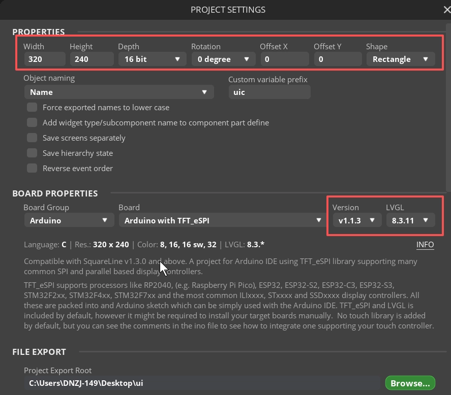

  2. Set the name of the project, set the screen resolution to 320*240, set the color depth to 16bit, and keep other default settings. After setting, click CREATE to create the project.
    2

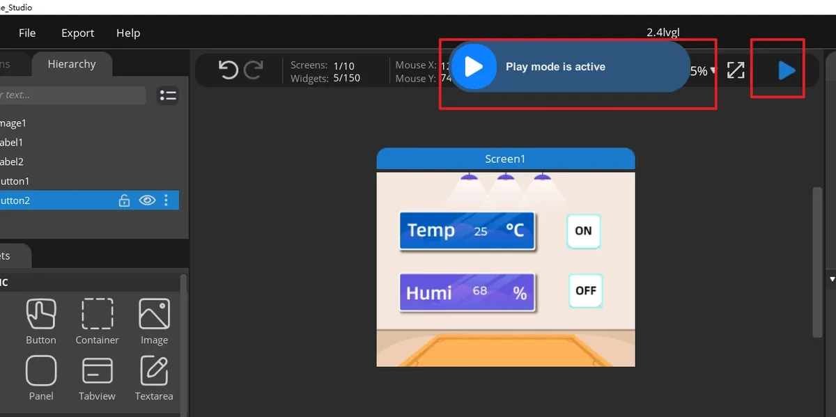

  7. Add Button widget to control the LED.
    SLS-UI-12
    SLS-UI-13
    SLS-UI-14
    SLS-UI-15
    SLS-UI-16
    SLS-UI-17
    SLS-UI-19
    SLS-UI-20

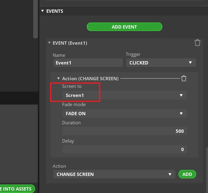

  8. Add events to buttons.
    SLS-UI-21
    SLS-UI-22
    SLS-UI-23
    SLS-UI-24

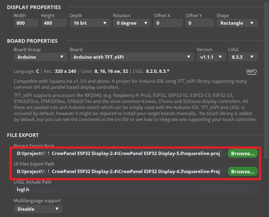

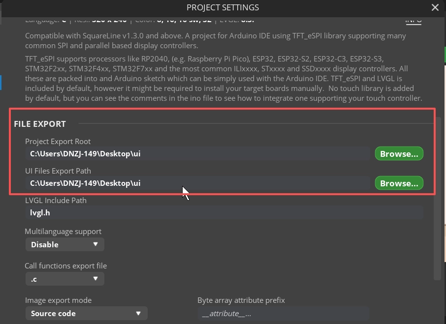

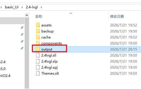

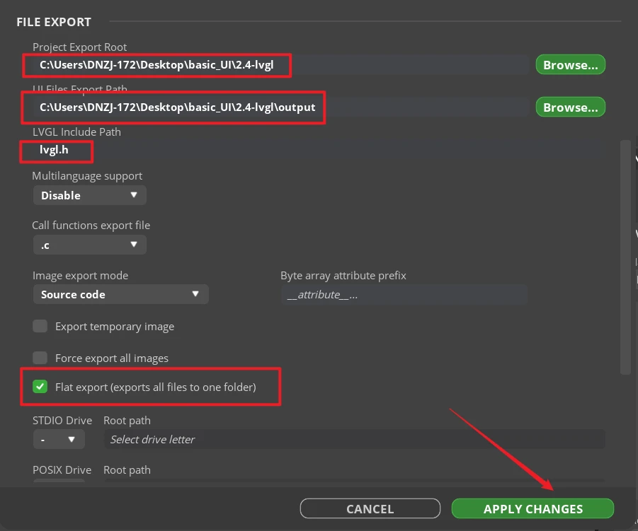

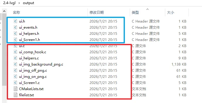

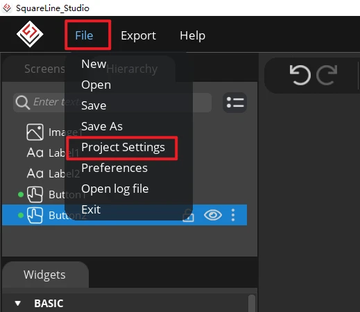

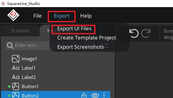

  9. Export UI files.
    SLS-UI-25
    3
    4
Then click "APPLY CHANGES".
SLS-UI-27
SLS-UI-28
SLS-UI-29

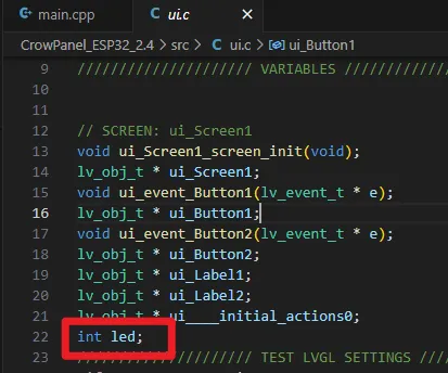

  1. Modify the button event code.
    First, define a ‘int led;' in the ui.c file to store the status of the LED. The value of this variable is judged to control the on and off of the LED.
    SLS-UI-31

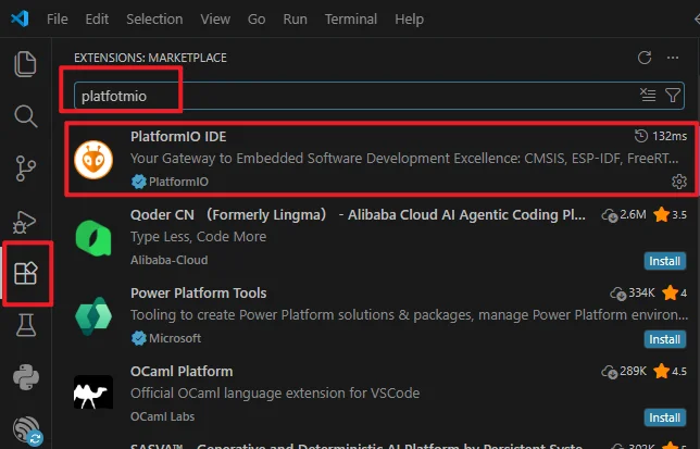

Create PlatformIO Project
Please click download to download the complete PlatformIO project — it works out of the box.
Now let's break down how this project was built step by step.
Get Started with PlatformIO
Please click the card below to enter the page to get started with PlatformIO.
GetStartedWithPlatformIO

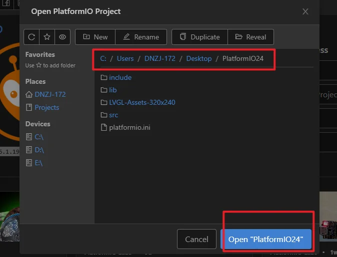

Create a new project

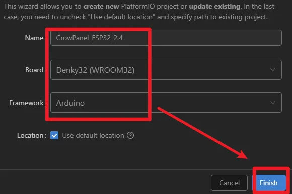

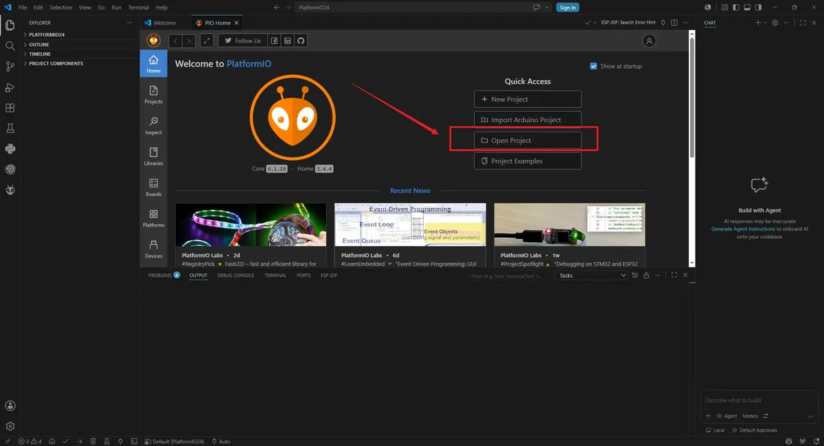

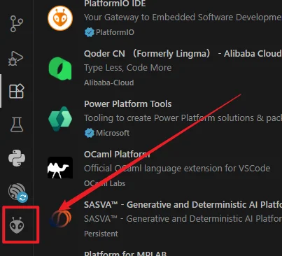

  1. Open Visual Studio Code, click the PlatformIO icon, click QUIK ACCESS 'Open', then click '+New Project'.
    PIO-2
  2. Add a project name "CrowPanel_ESP32_2.4". Select "Denky(WROOM32)" for the board and "Arduino" for the framework.
    PIO-3

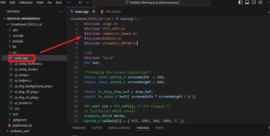

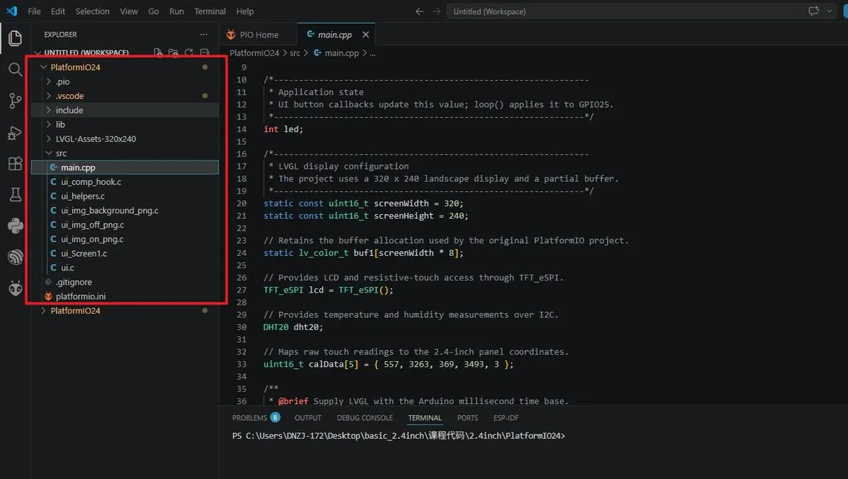

  3. Write the main program in main.cpp.
    PIO-5

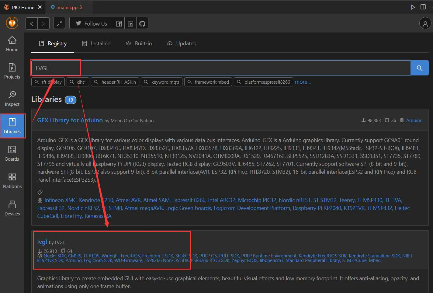

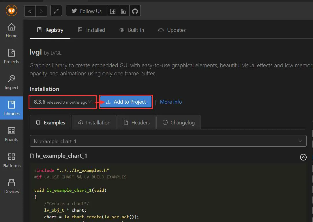

  1. Click the PlatformIO icon, click QUICK ACCESS→'Open', then click 'Libraries'.
    PIO-6

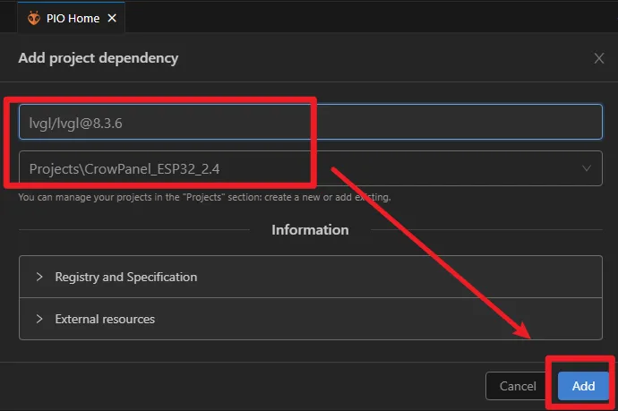

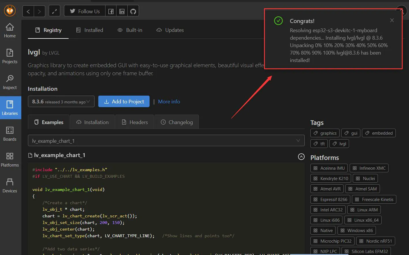

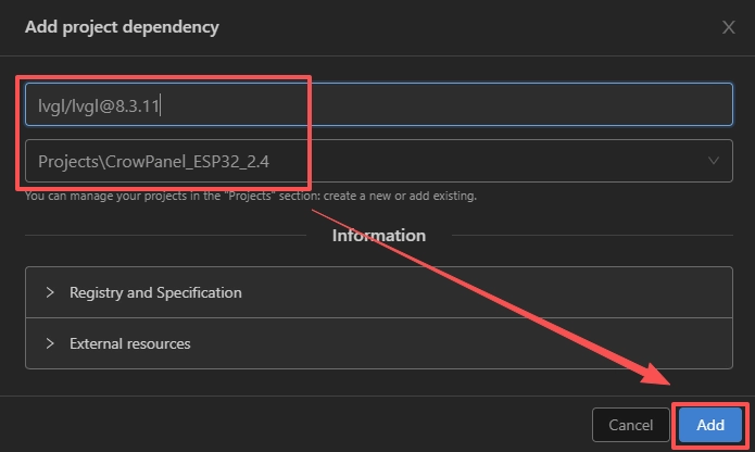

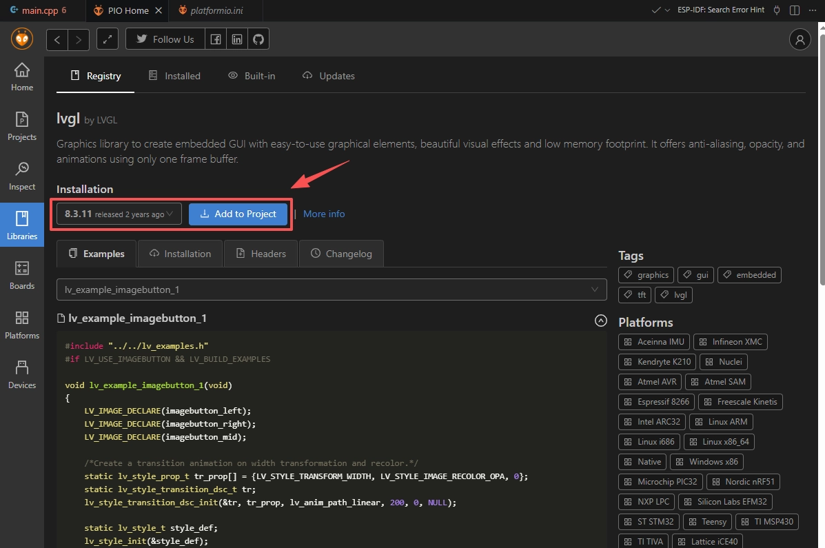

  2. Search for LVGL, and add it to the project.
    PIO-7
    5
    6

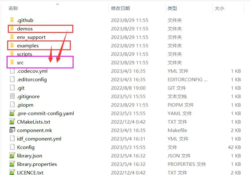

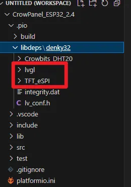

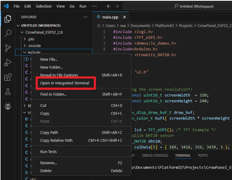

    After adding, right click on lvgl and select "Open in Integrated Terminal"
    PIO-17
    Copy the "demos" and "examples" folders to "src" folder

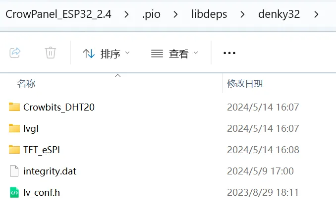

    Place the lv_conf.h we provide to the path: .pio\libdeps\denky32 in the project folder.
    PIO-19
    Please click download to download the lv_conf.h file.

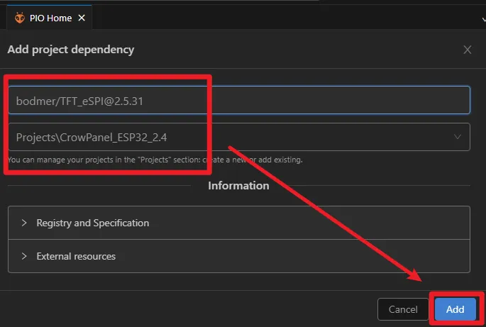

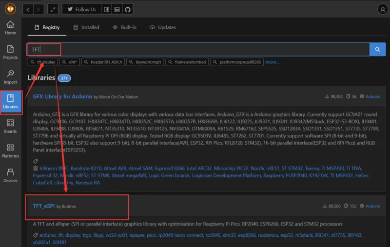

  3. Add TFT_eSPI library.
    PIO-11
    PIO-12
    PIO-13
    PIO-14
    We can see that the library has been added successfully!

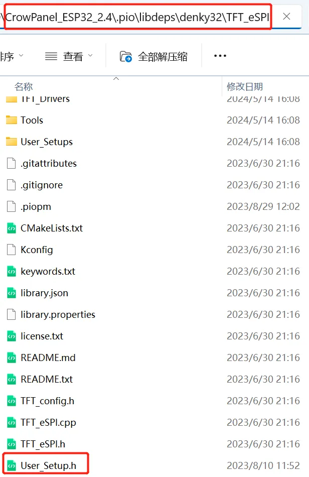

    Delete the User_Setup.h in the TFT_eSPI folder and copy the provided User_Setup.h to the TFT_eSPI folder.
    Please click download to download the User_Setup.h file.

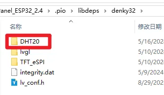

  4. Add DHT20 library.

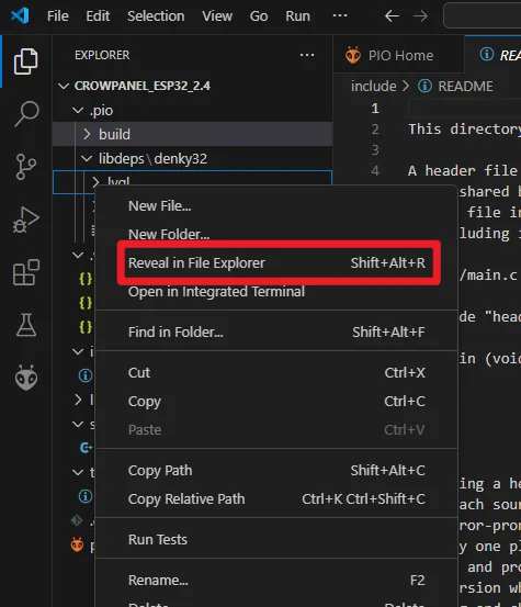

    Right-click the "libdeps\denky32", click "Reveal in File Explorer", and select the DHT20 library we provided.
    Please click download to download the DHT20 library.

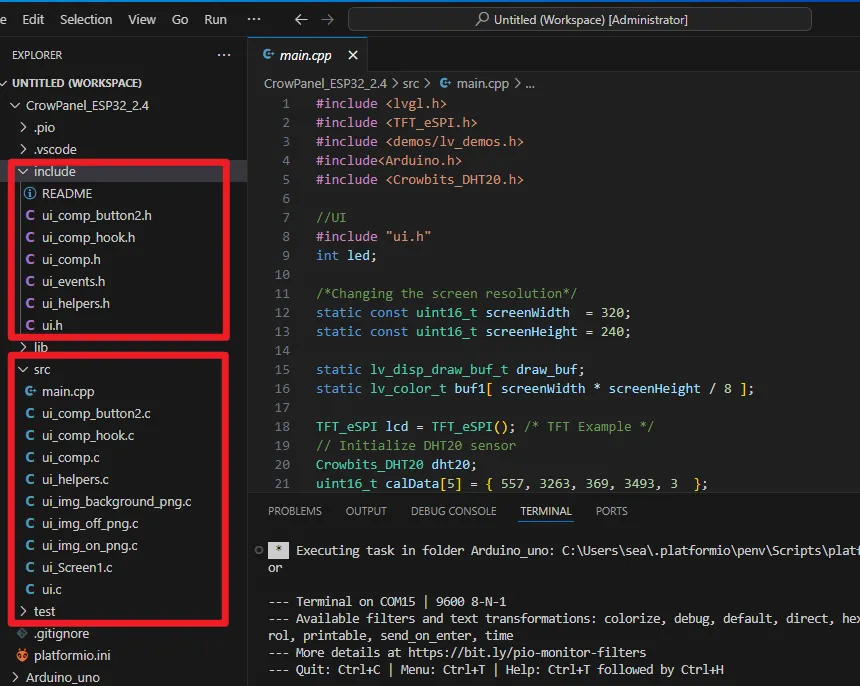

Add the UI file into PlatformIO Project
We need to add the UI file (generated from SquareLine Studio) to the PlatformIO project.

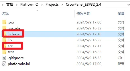

The .c files in the UI file should be placed in the /scr folder of the project file, and the .h files should be placed in the /include folder.
PIO-34
PIO-35

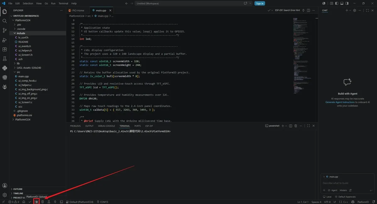

Upload the Code

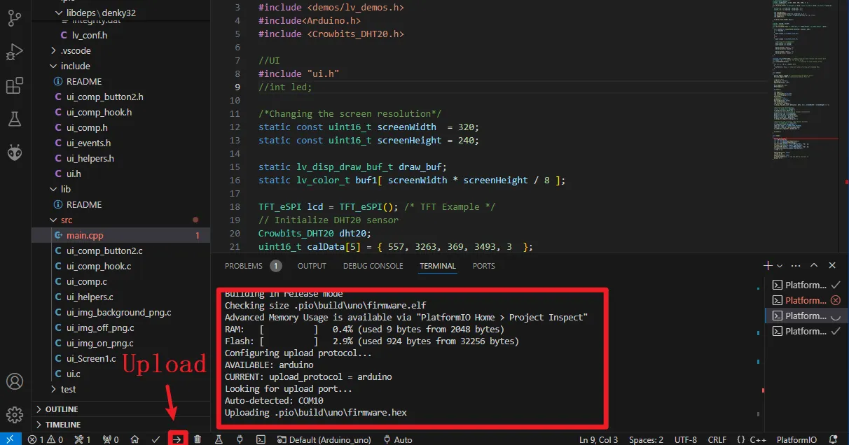

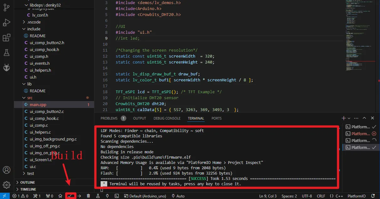

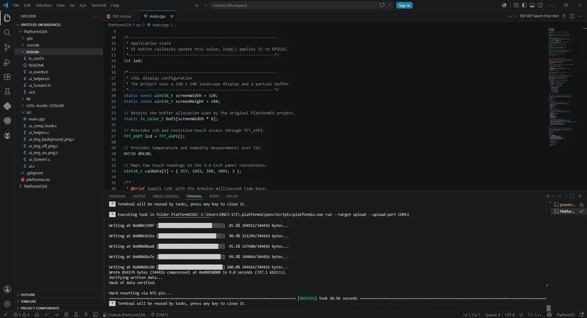

  1. Compile the program.
    Upload-code-1

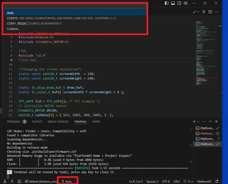

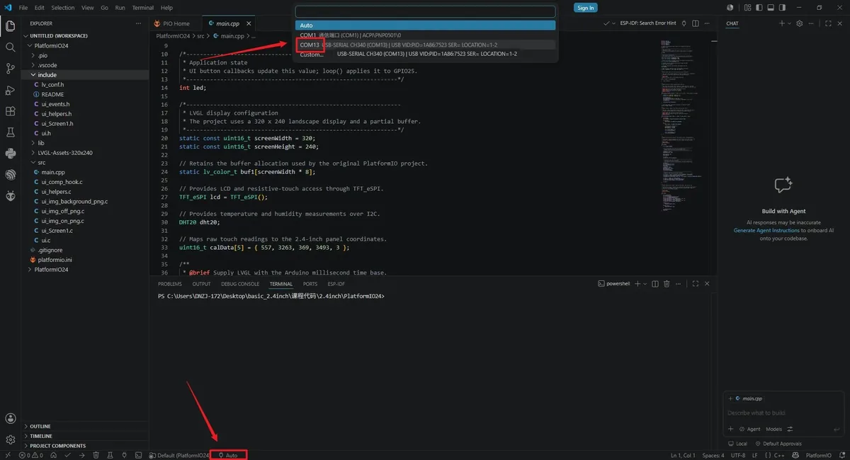

  2. Select the serial port and upload the code.
    Here we select Auto. The software will automatically select the corresponding serial port for program download. If the automatically selected serial port is incorrect, you can manually select the correct serial port.
    Upload-code-2

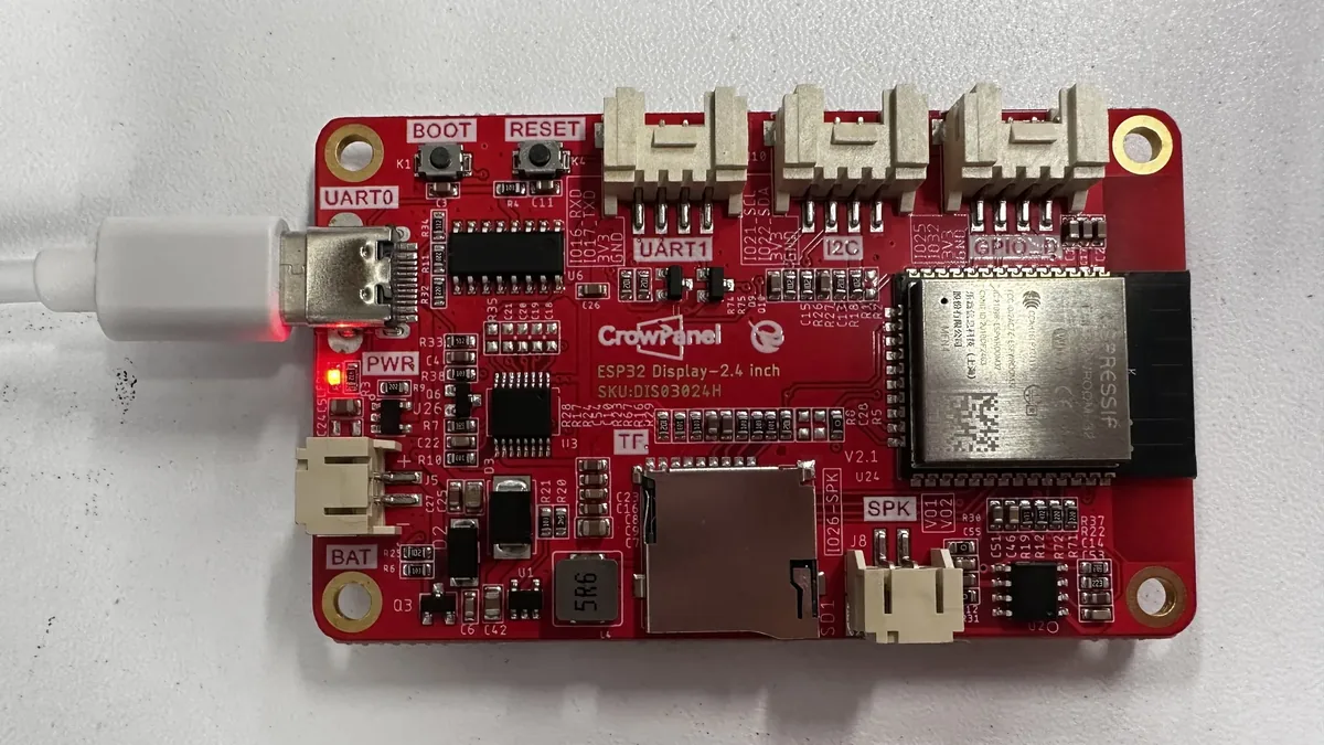

  3. Click the upload button to up the program to the board.
    Upload-code-3

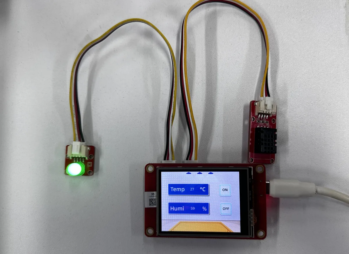

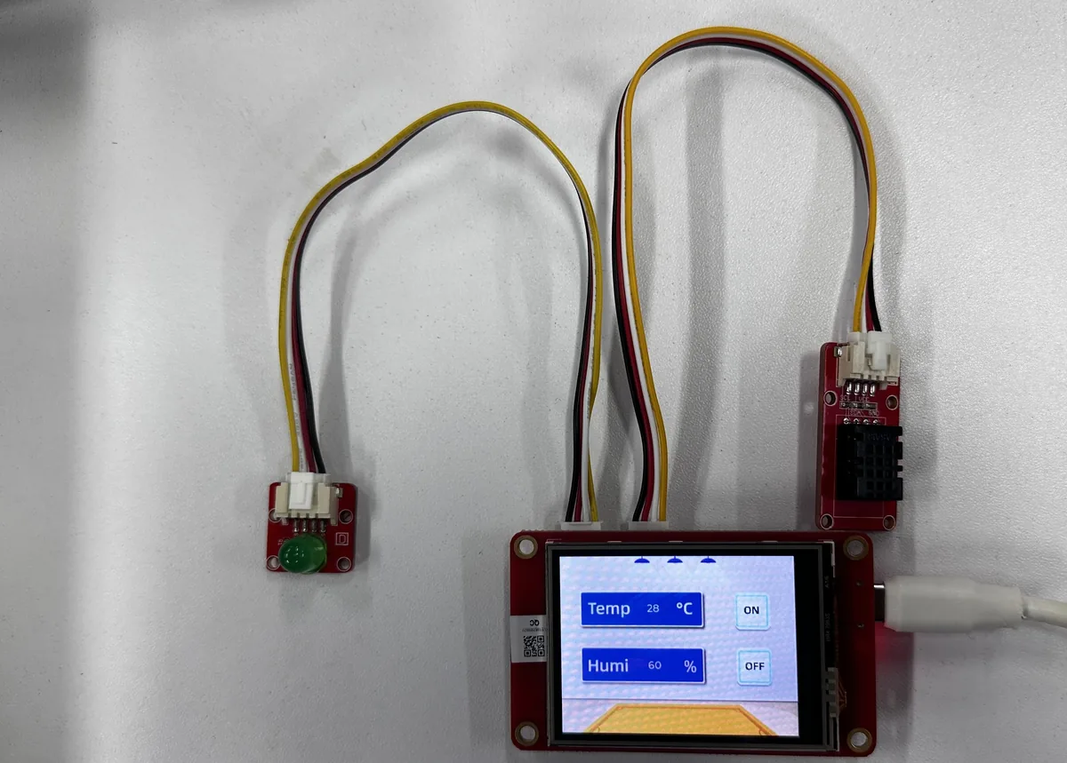

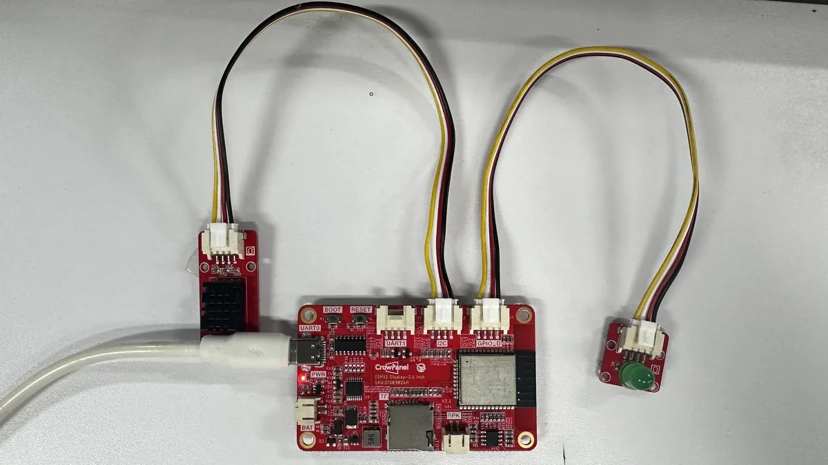

  4. The program will run on the board!
    ESP32-led
