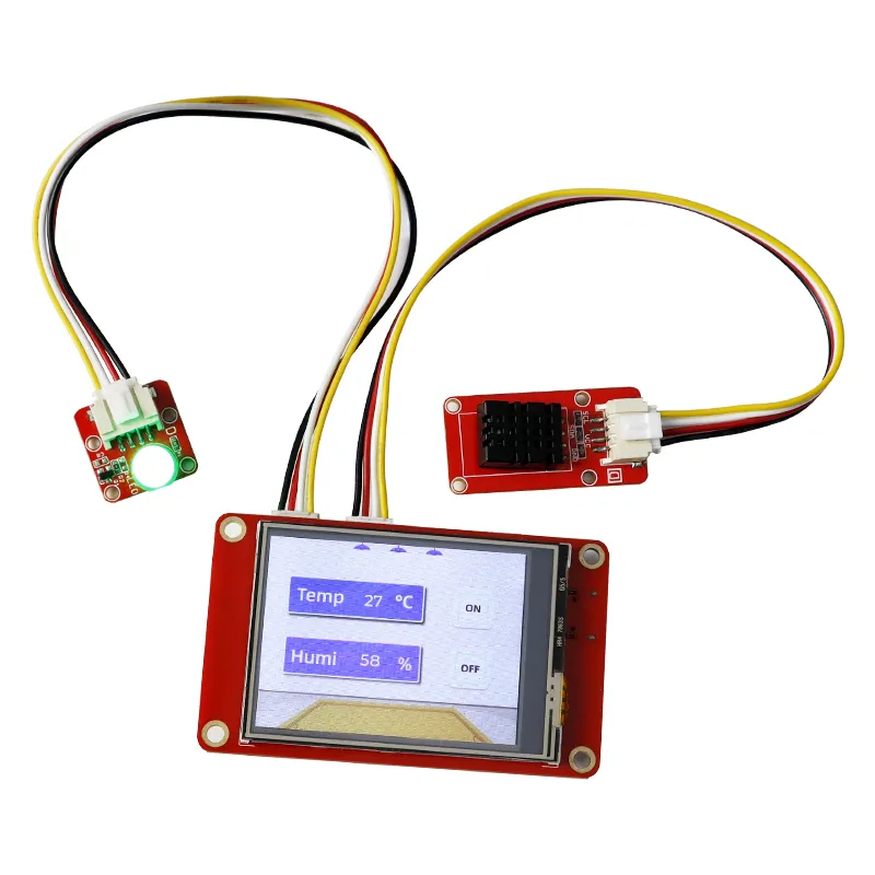

The example tutorial is an environmental monitoring project, demonstrate how to create a UI and use a DHT20 sensor to obtain the environment temperature and humidity and display it on the screen; and how to control the LED on and off by the buttons on the screen.

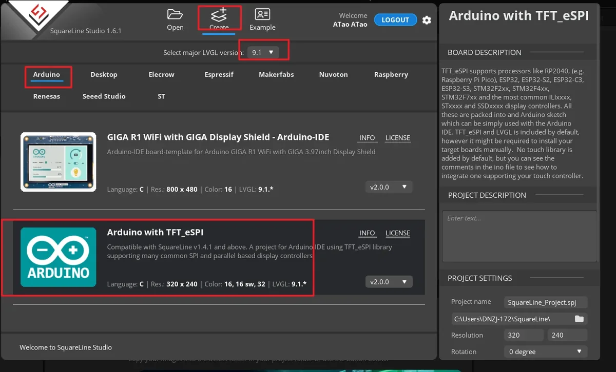

In this tutorial, we will show you how to design the UI with SquareLine Studio, and show you how to upload the code with ESP-IDF.
Hardware Preparation¶
| CrowPanel ESP32 3.5'' HMI | Crowtail-DHT20 | Crowtail-LED | Dupont-wire |

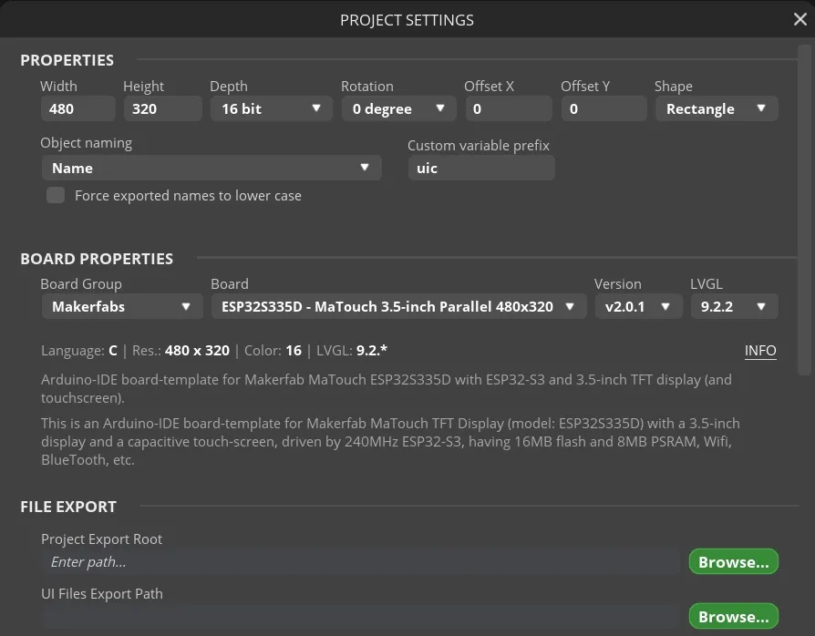

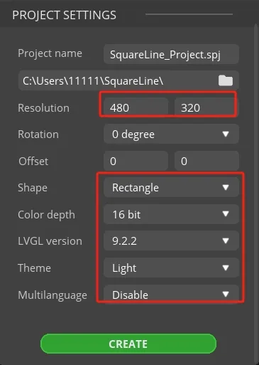

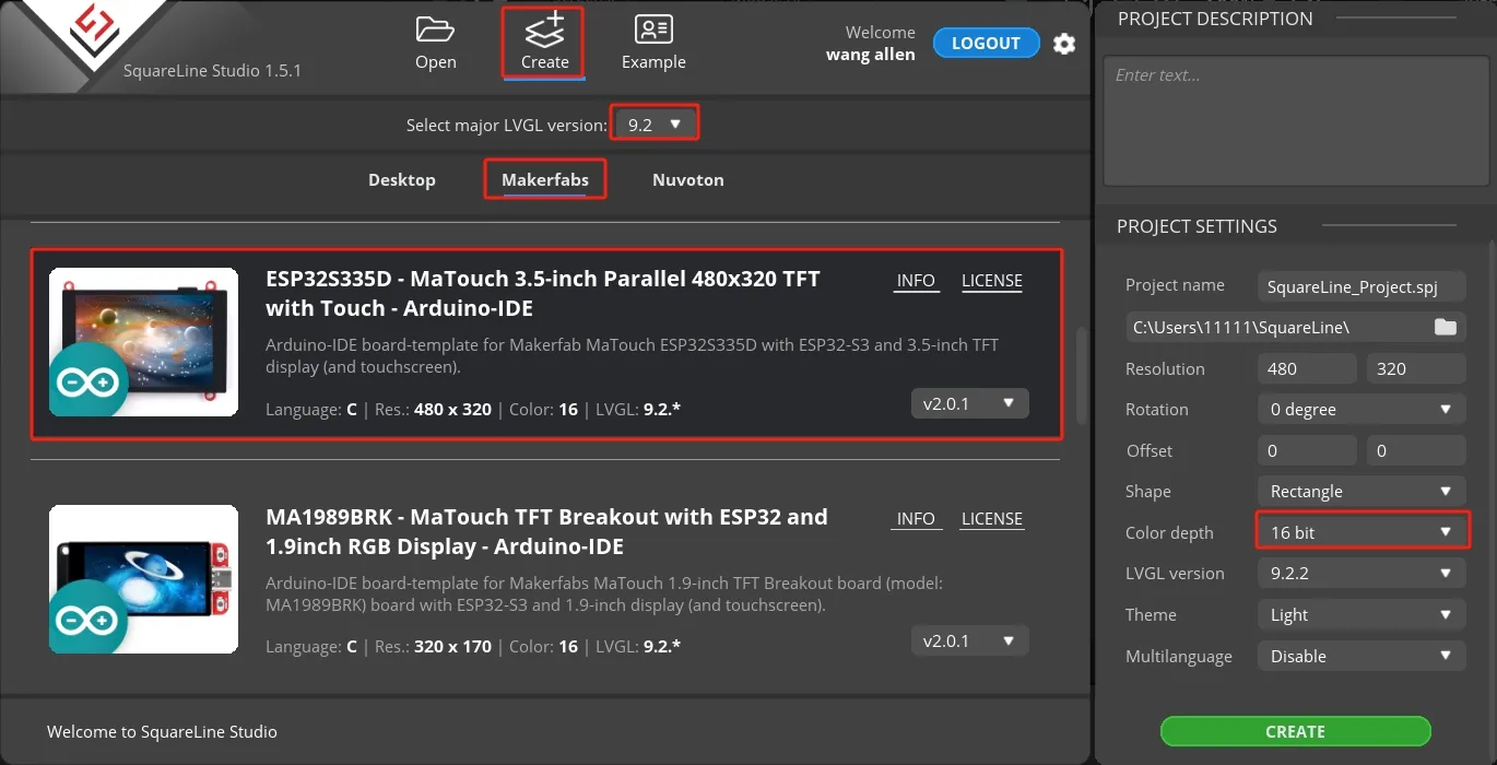

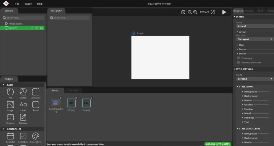

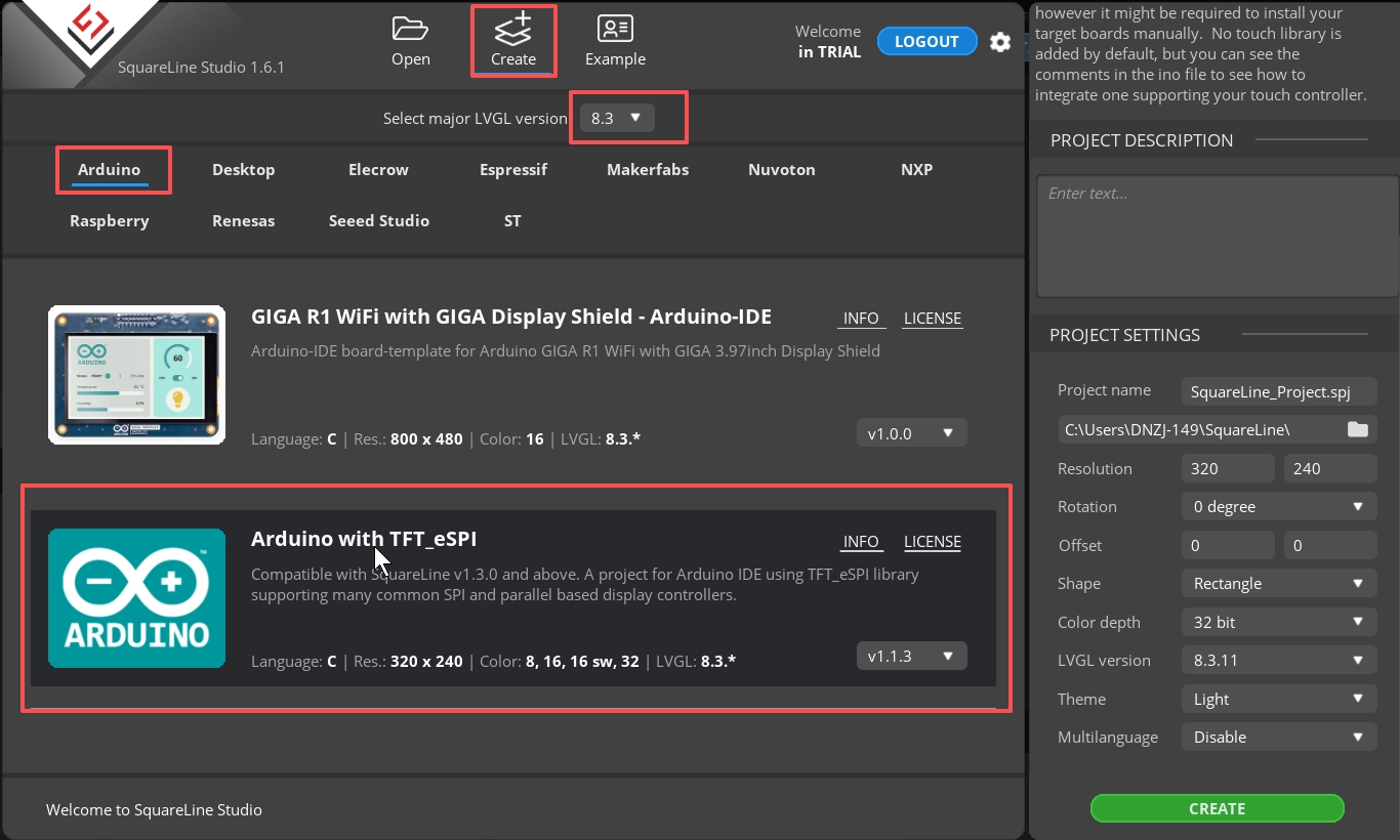

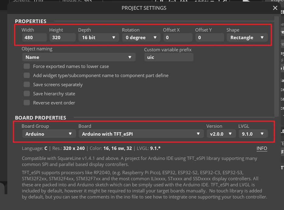

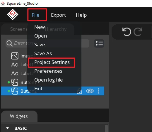

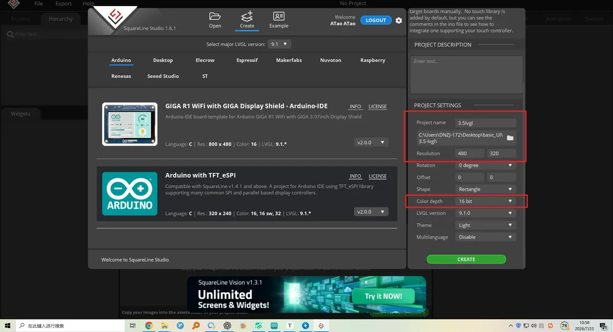

Open the SquareLine Studio and create a project.
Note:

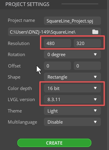

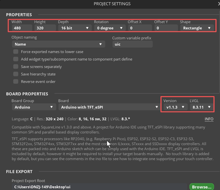

Set the name of the project, set the screen resolution to 480*320, set the color depth to 16bit, and keep other default settings. After setting, click CREATE to create the project.

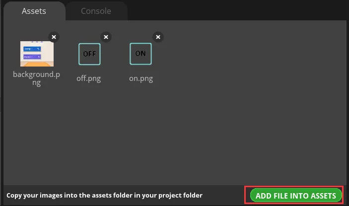

Please click
to download the custom images used in this tutorial.Note:

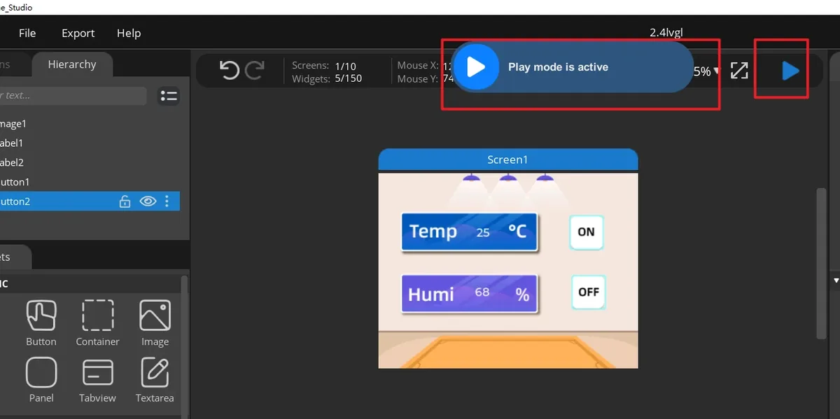

Add background.
Add Label widget to display temperature and humidity.
You can set the font colour and other attributes in STYLE SETTING→STYLE(MAIN).

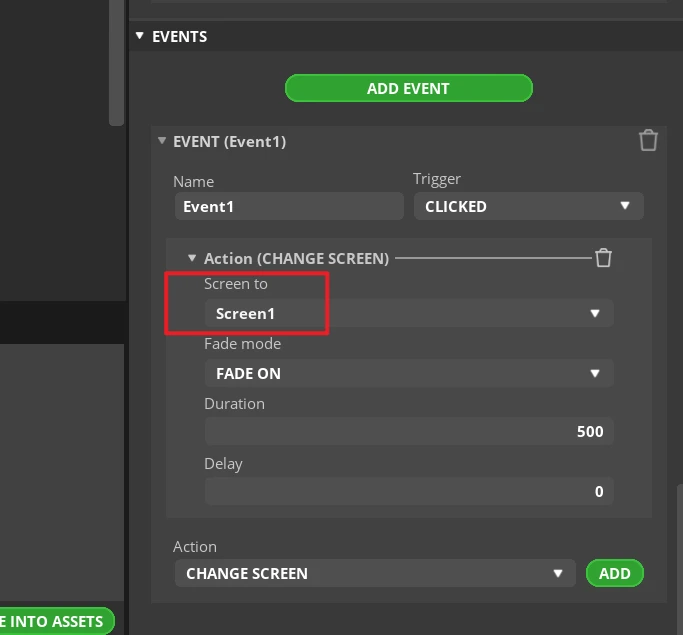

Add events to buttons.
Select "clicked" as the trigger condition, select a trigger event in "Action". It will be modified in the generated program to achieve the LED control function.

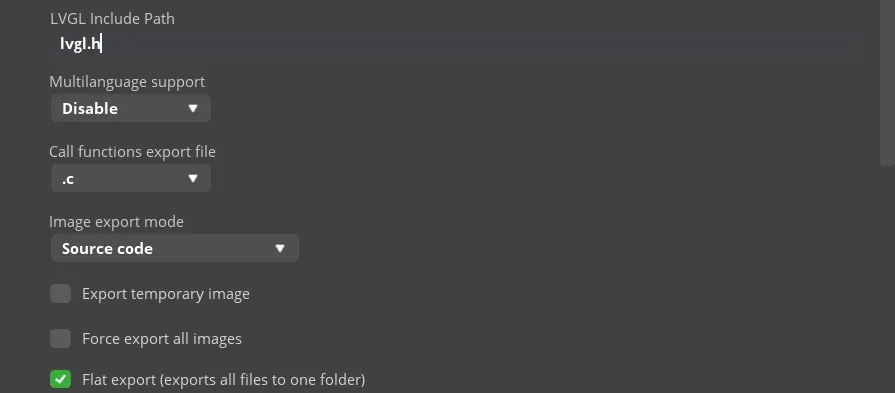

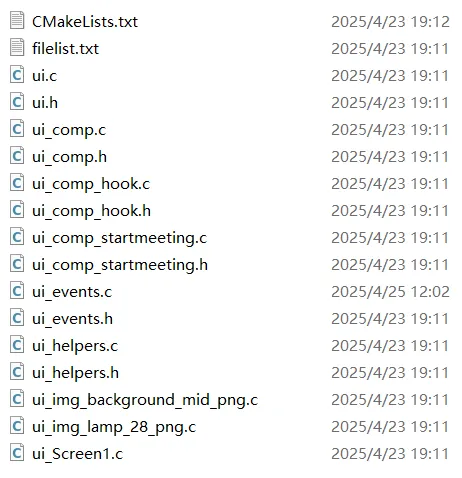

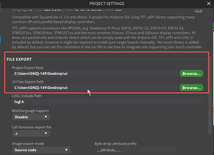

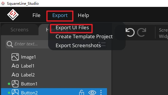

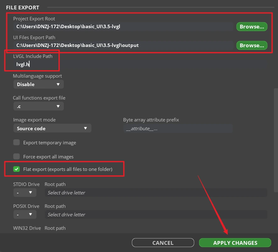

Export UI files.
Then click "APPLY CHANGES".

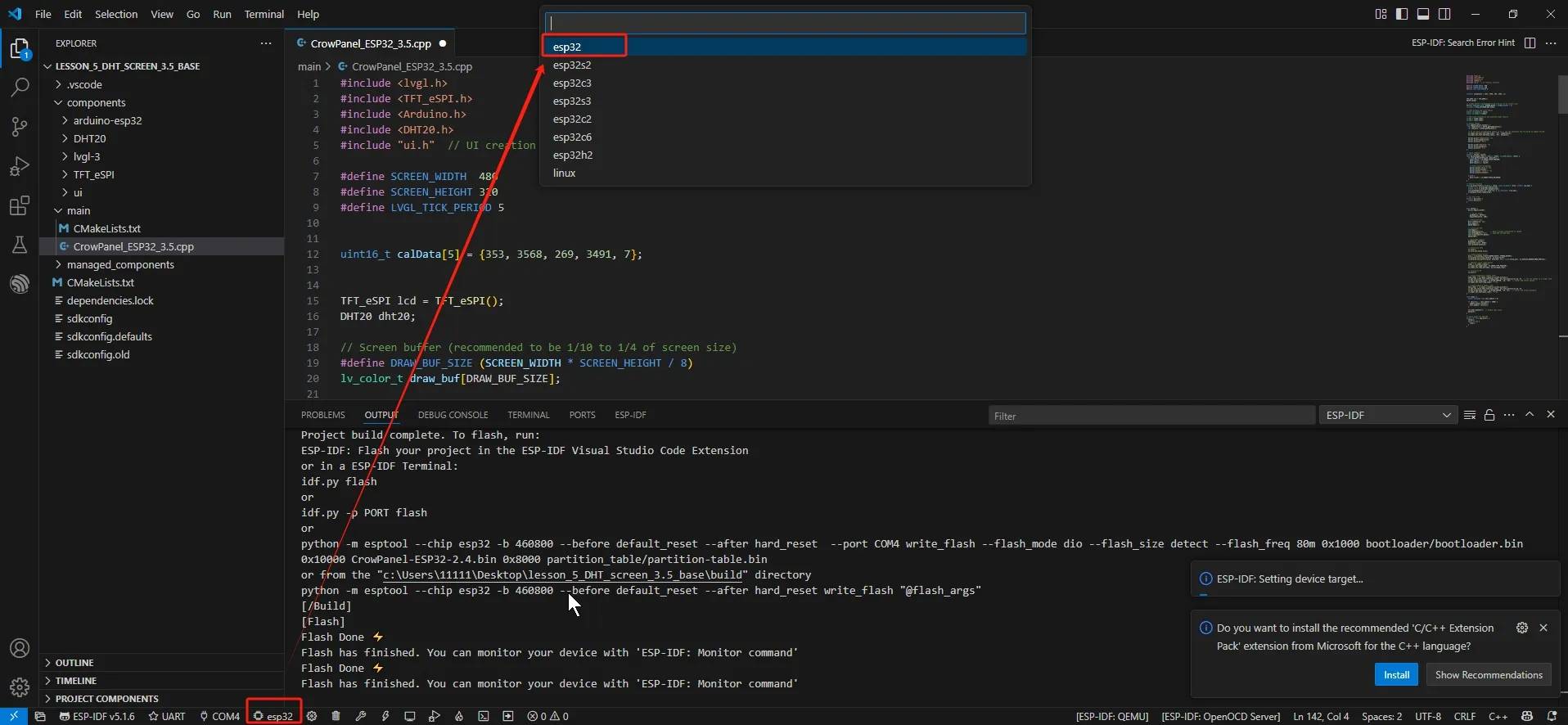

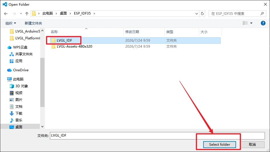

Get Started with ESP-IDF¶

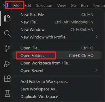

Please click the card below to learn how to install ESP-IDF. Create a blank project according to the "Get Started with ESP-IDF".
You can click
to download the complete project we provided. This project can be used directly. You can also create the project by following the tutorial.

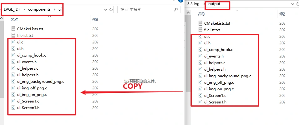

Setup UI file¶

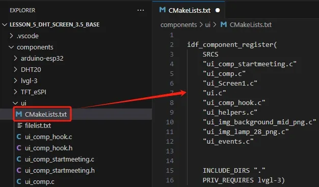

Add the UI file we exported earlier in Squareline.

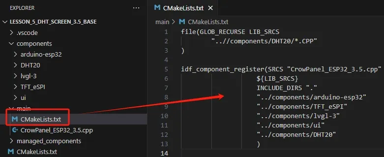

The CMakeList.txt file in the UI file needs to be modified as follows:
Setup main file¶
The CMakeList.txt file contains the Settings for the library. All required libraries should be included by directory address. The CPP file of DHT20 has an additional column.

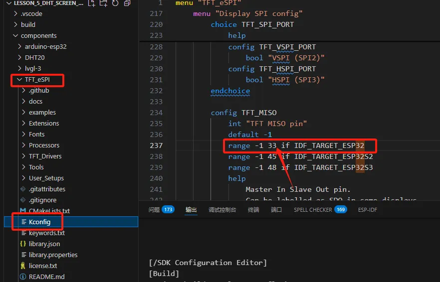

Note:Because we are using the "ESP32" chip, we need to configure the corresponding "TFT_MISO" option in the "Kconfig" file.¶

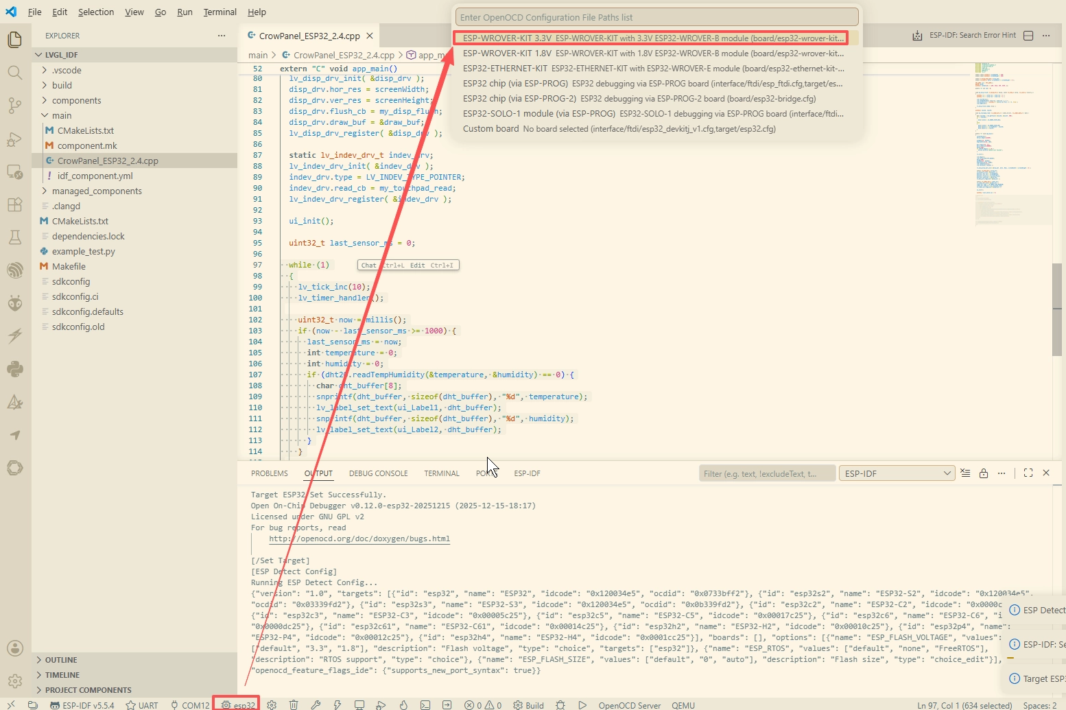

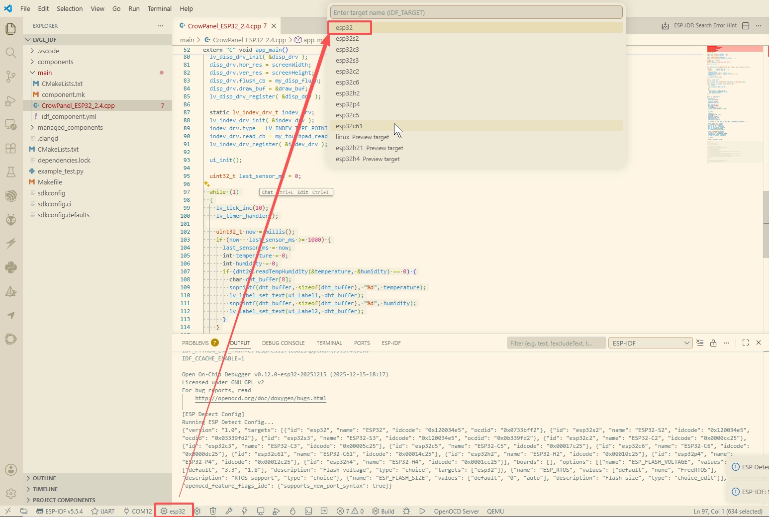

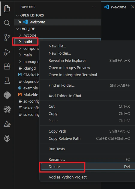

Setup board¶

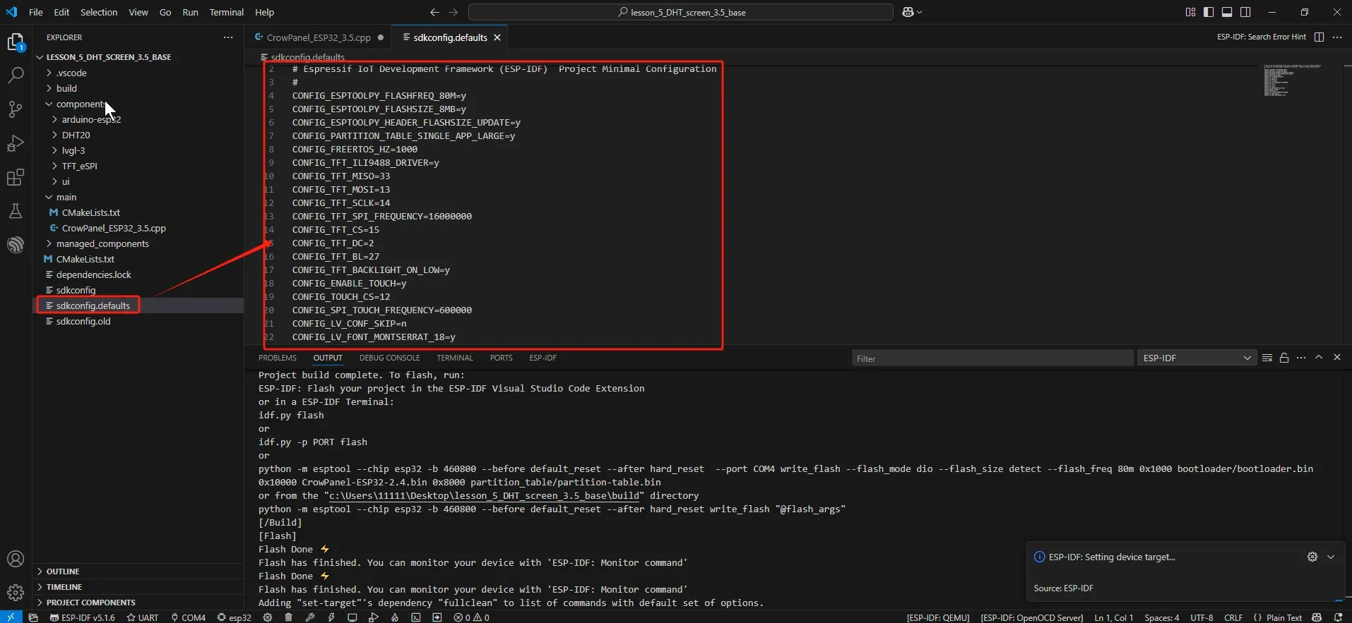

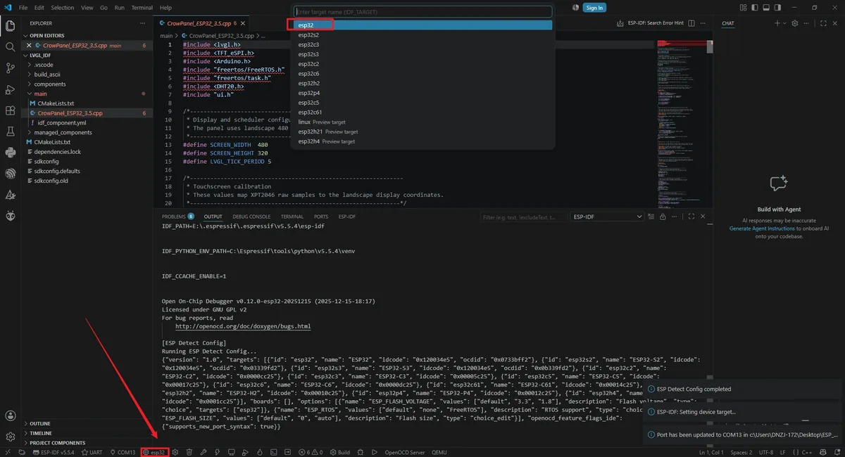

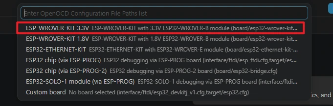

Menuconfig Setup section¶
All required configuration options are defined in the "sdkconfig.defaults" file.
Download the program¶

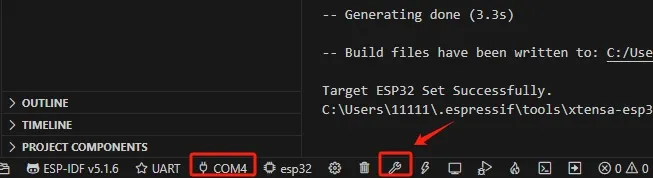

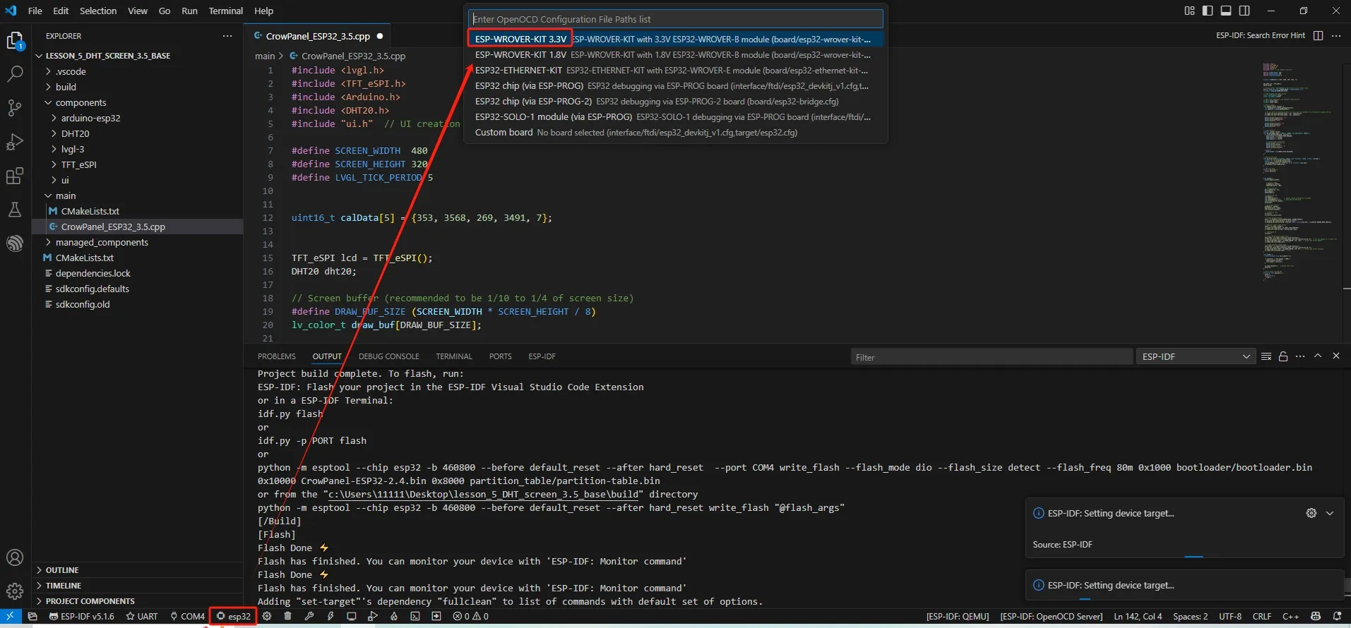

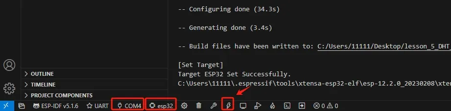

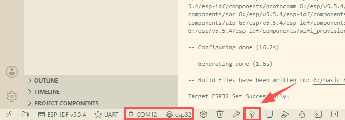

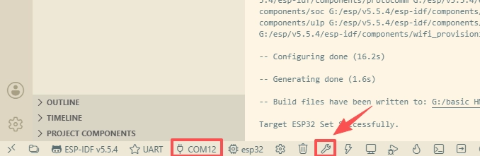

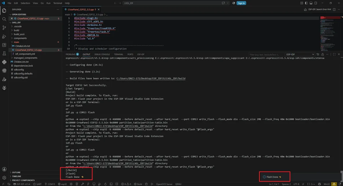

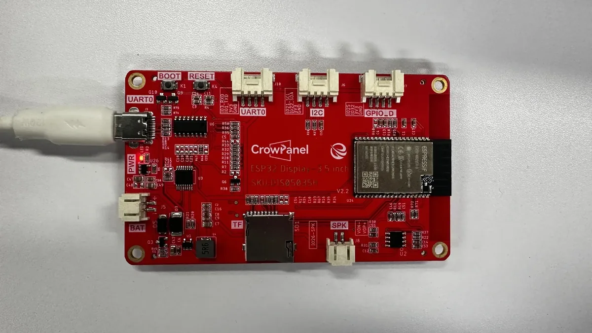

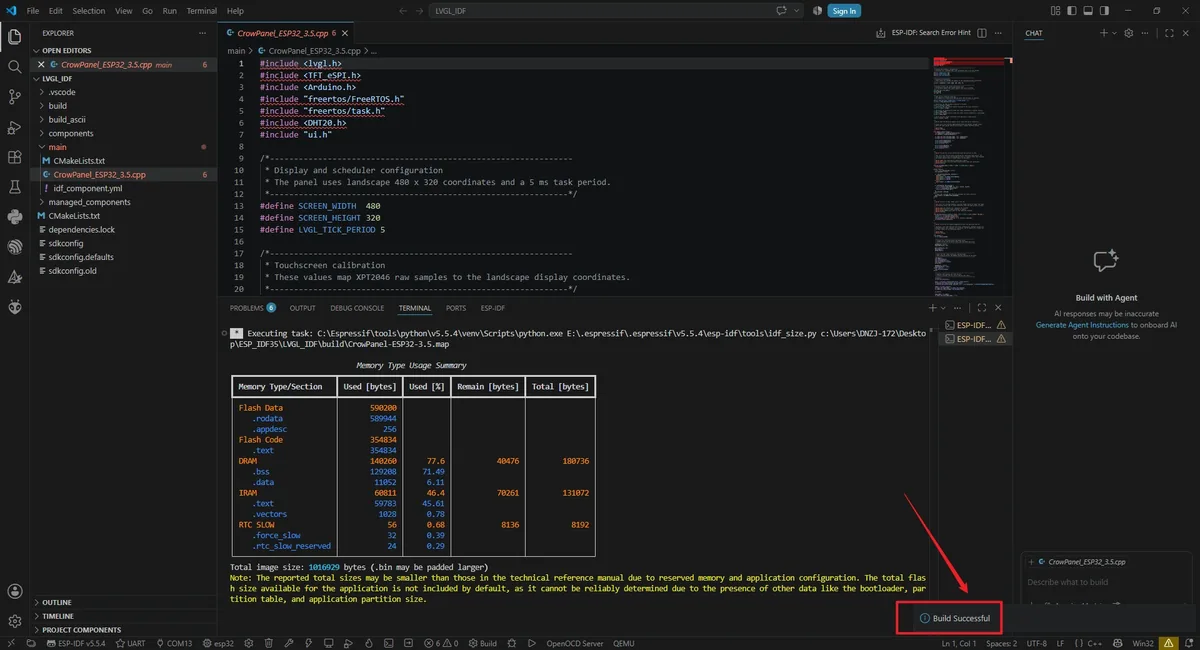

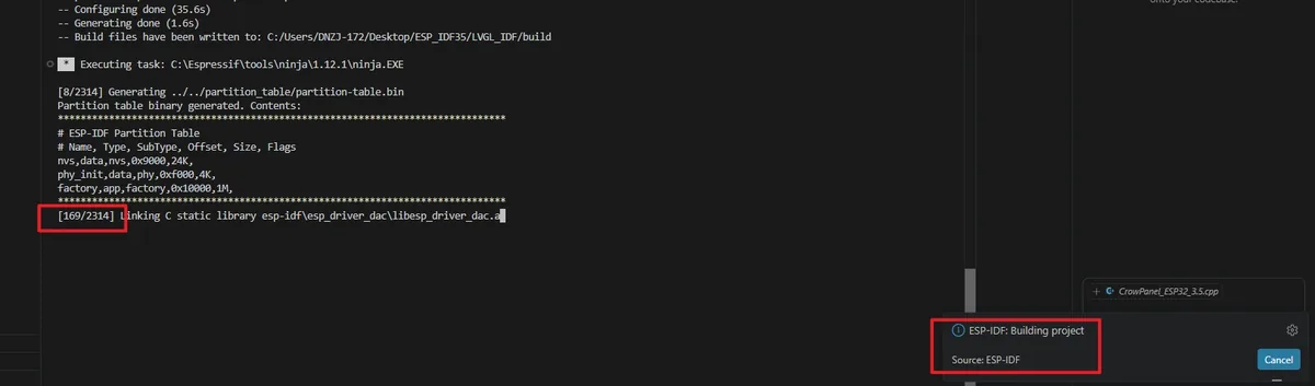

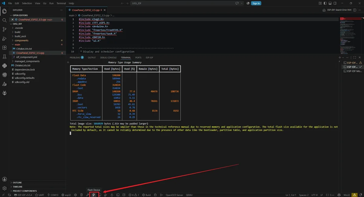

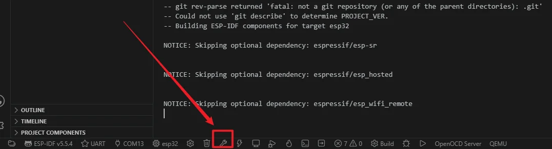

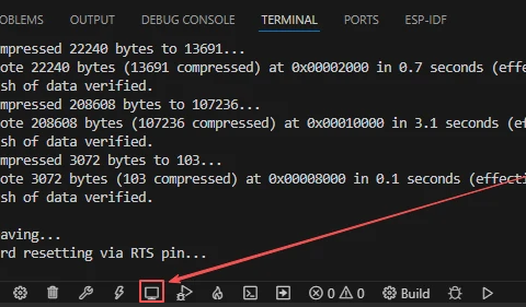

Connect the ESP32 Display to the PC and compile the program.

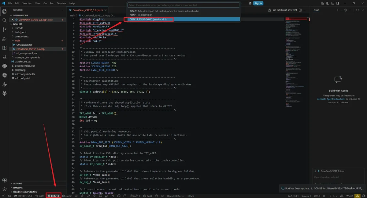

After confirming the serial port, select the UART mode.

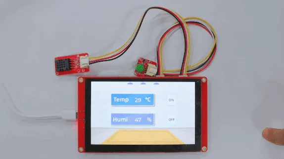

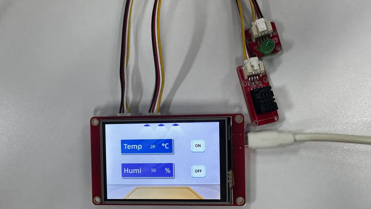

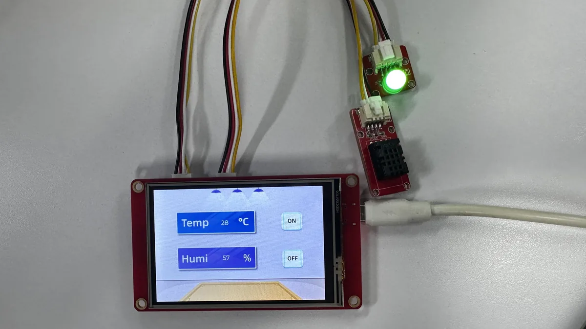

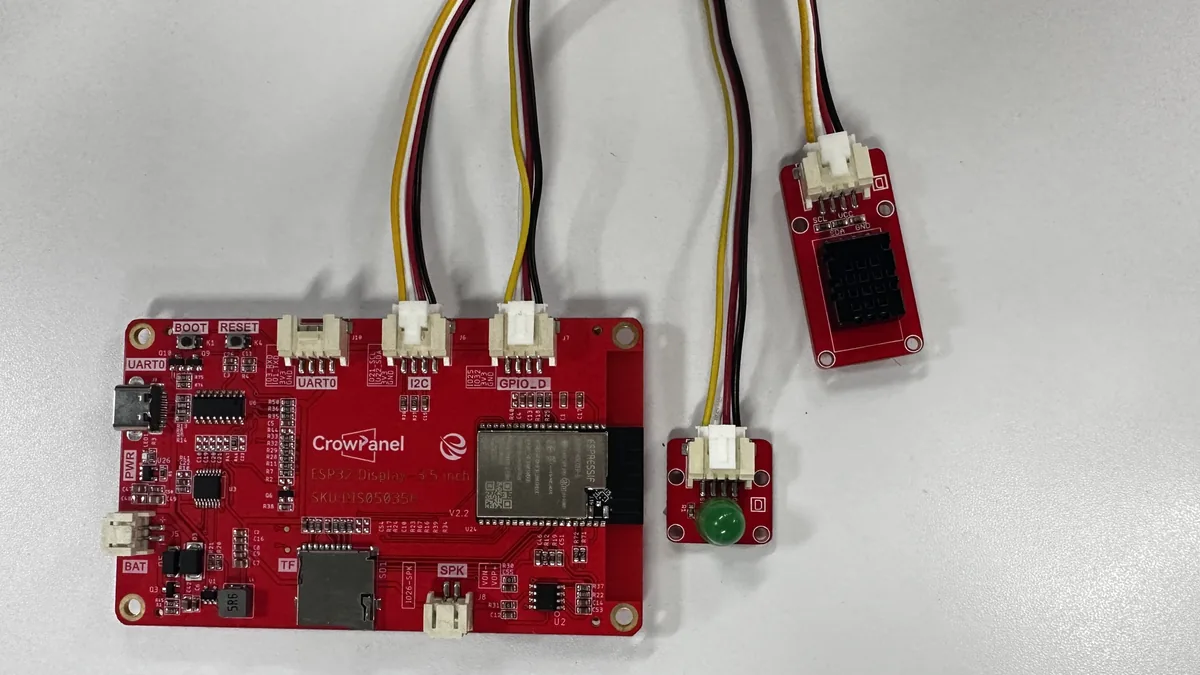

After the program is successfully downloaded, connect the DHT20 sensor to the IIC port and the LED to GPIO_D (IO25), the temperature and humidity values will be displayed on the screen. Click the ON button on the screen and the LED will turn on. Click the OFF button and the LED will turn off.
