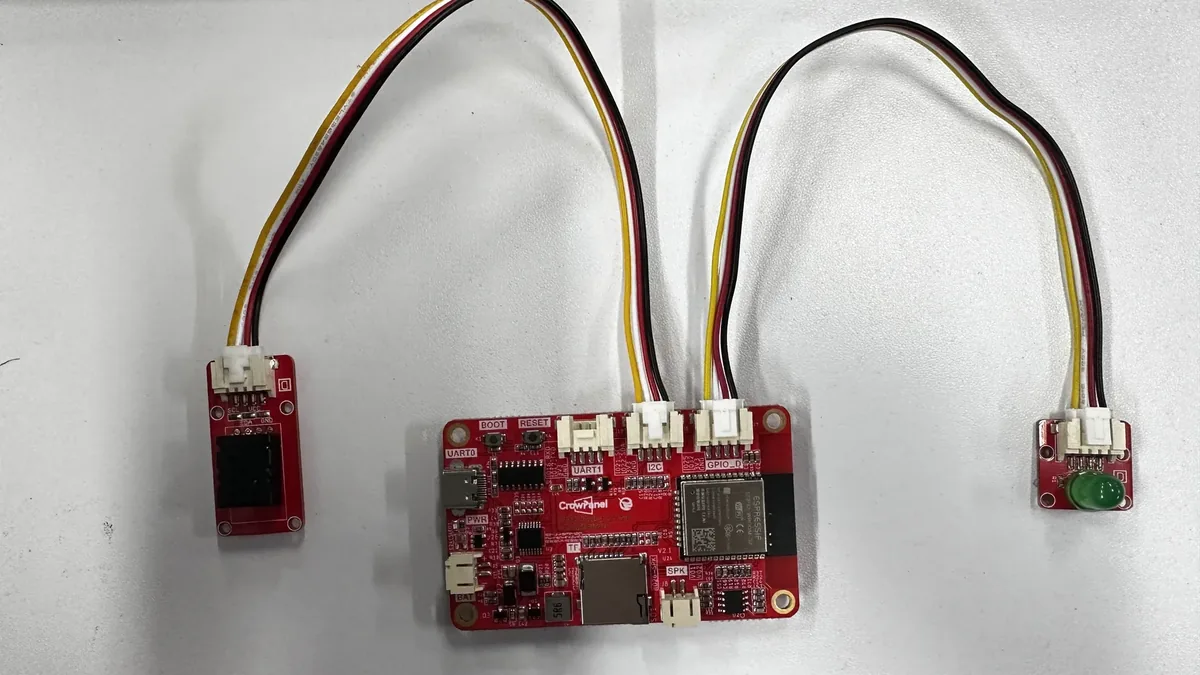

CrowPanel ESP32 2.4'' HMI Crowtail-DHT20 Crowtail-LED Dupont-wire
CrowPanel-ESP32-2.4inch CROWTAIL-DHT20 CROWTAIL-LED 4-PIN-FEMALE-WIRE

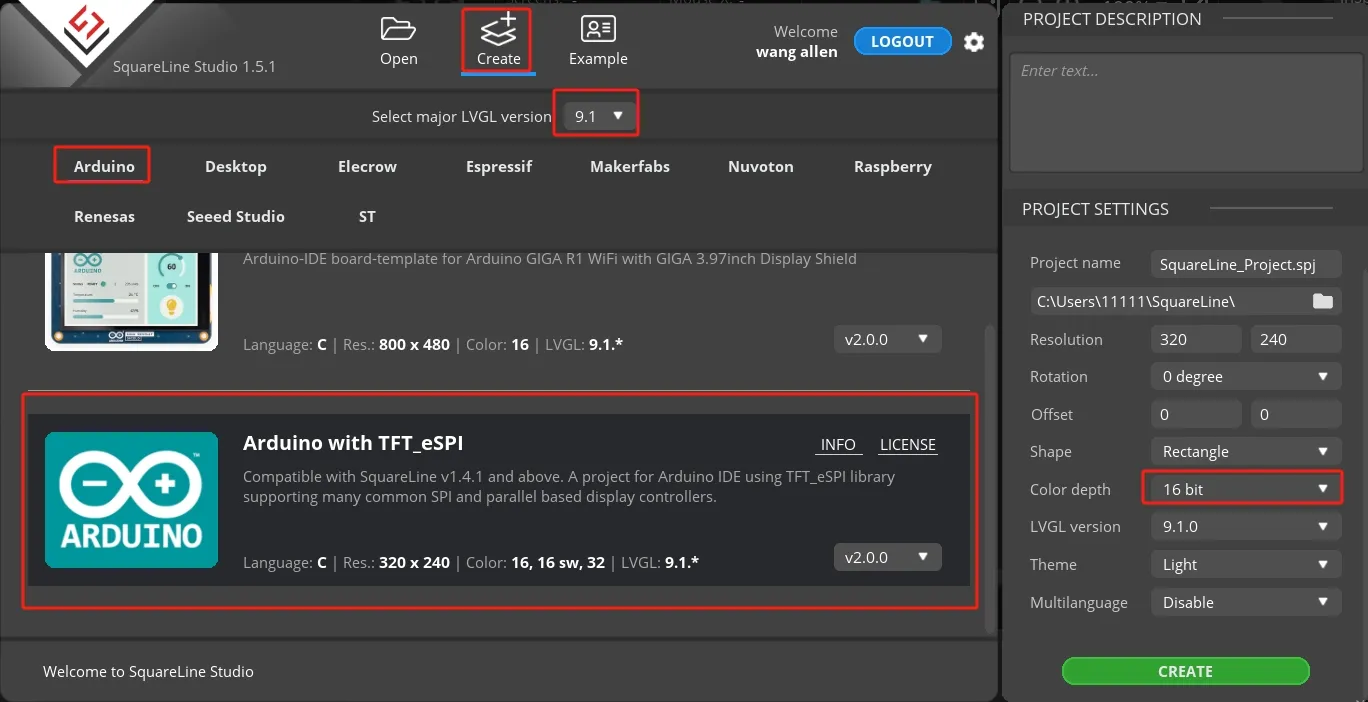

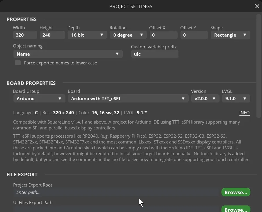

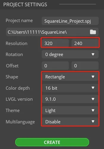

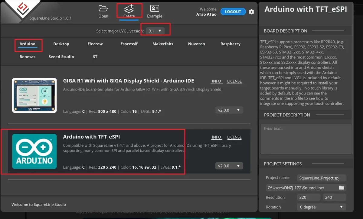

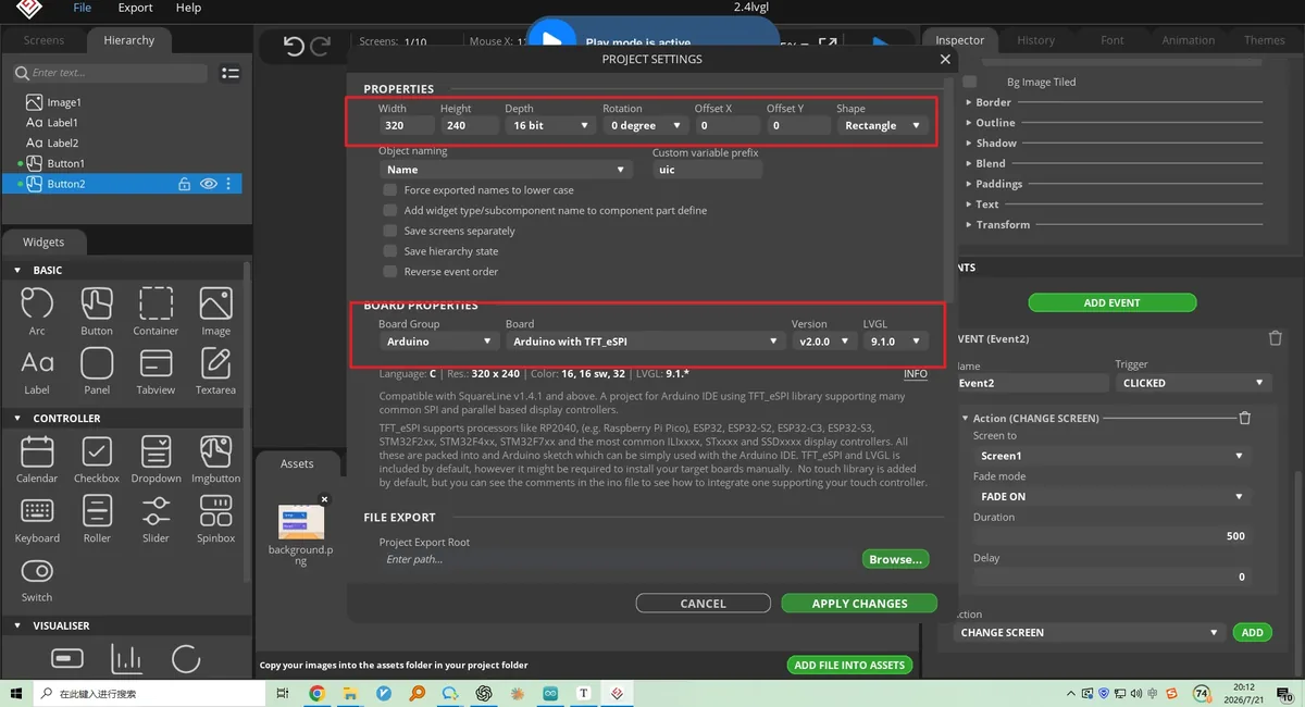

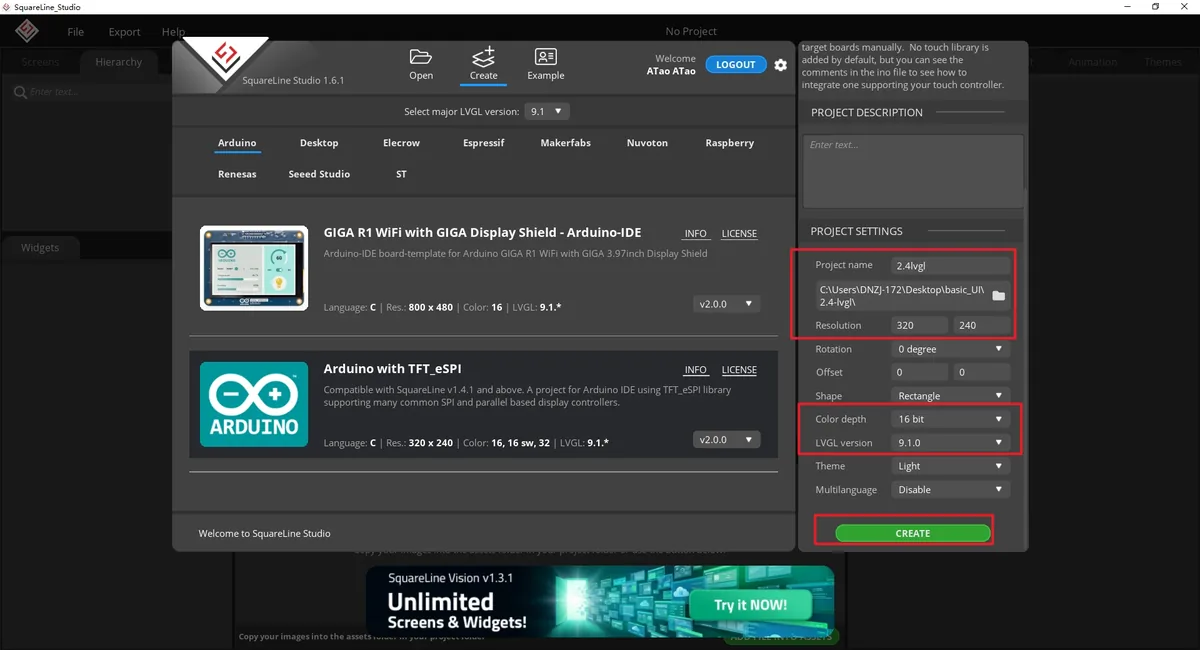

  1. Open the SquareLine Studio and create a project.
    img1-1
    Note:

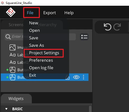

    Set the name of the project, set the screen resolution to 320*240, set the color depth to 16bit, and keep other default settings. After setting, click CREATE to create the project.

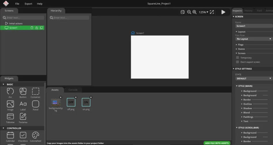

  2. After creation, enter the following interface with a blank background.

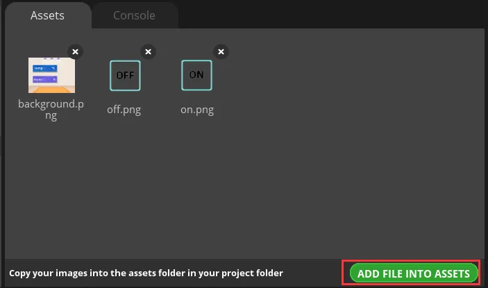

  3. In the "Assets" area, click "ADD FILE TO ASSETS" to add custom images or icons.
    Note:
  4. Add background.

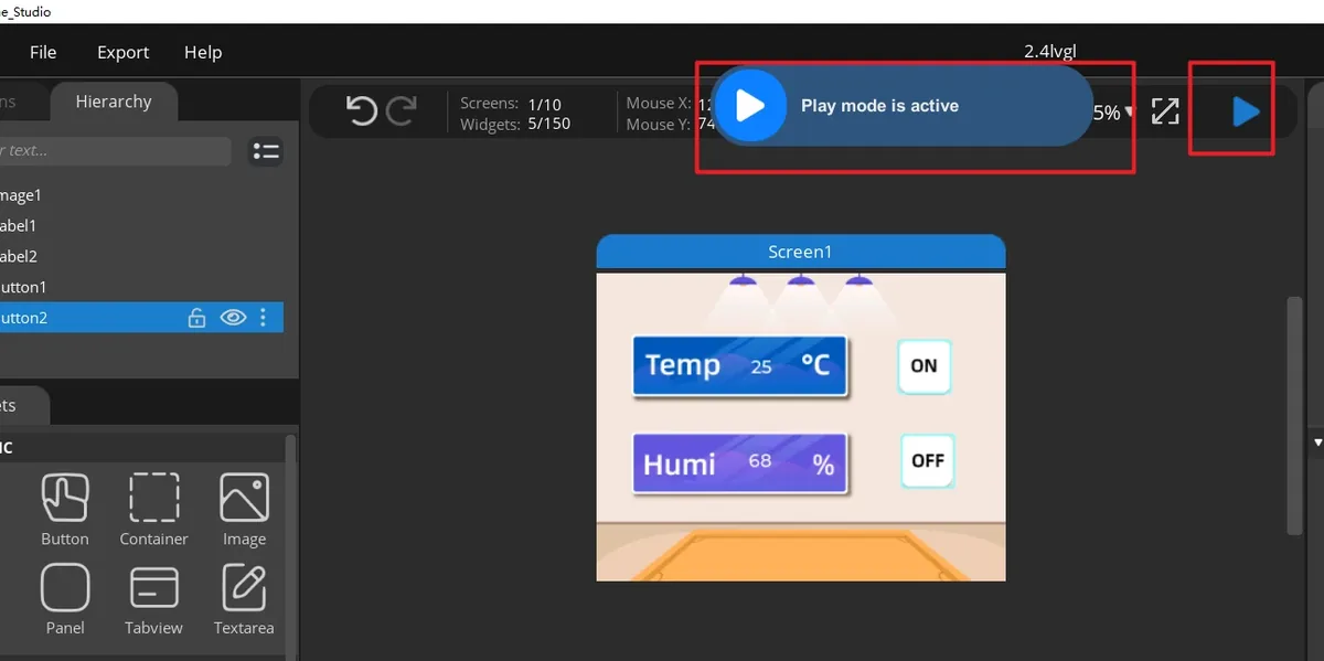

  6. Add Button widget to control the LED.

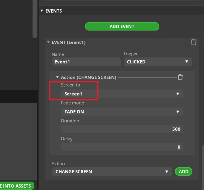

  7. Add events to buttons.
    Select "clicked" as the trigger condition, select a trigger event in "Action". It will be modified in the generated program to achieve the LED control function.

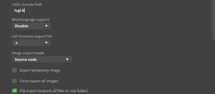

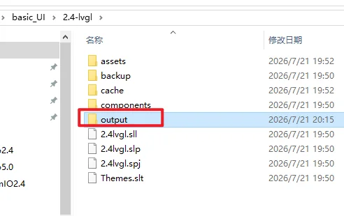

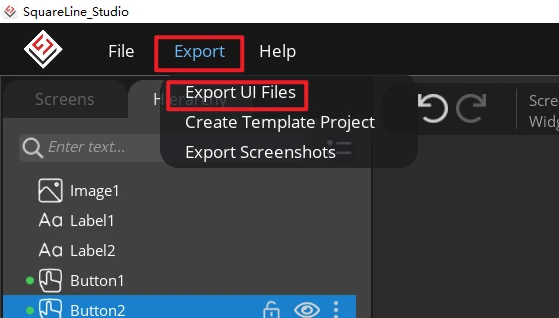

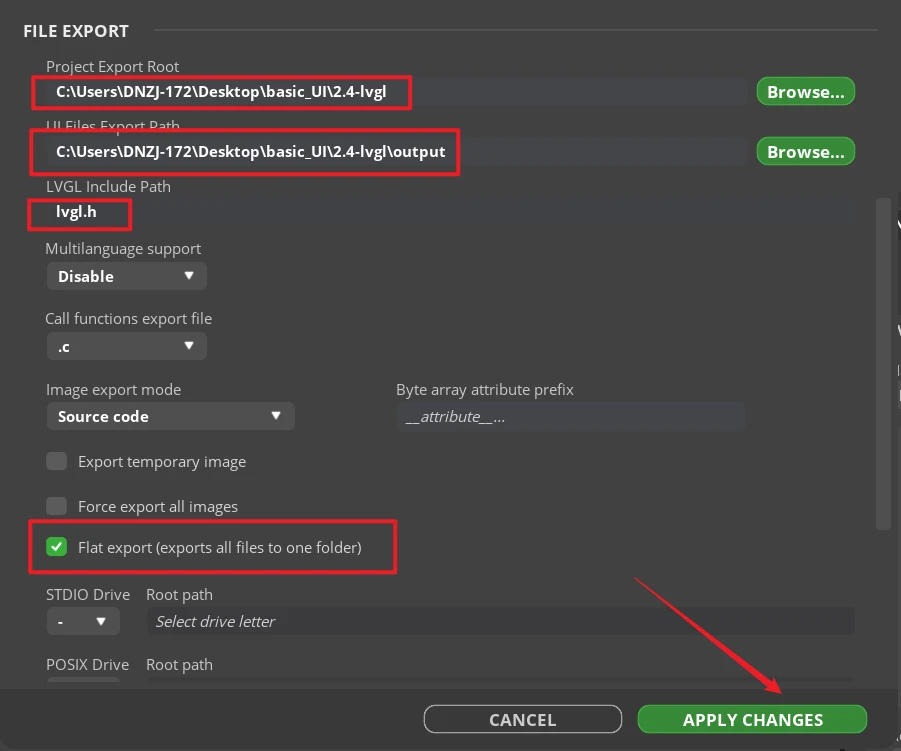

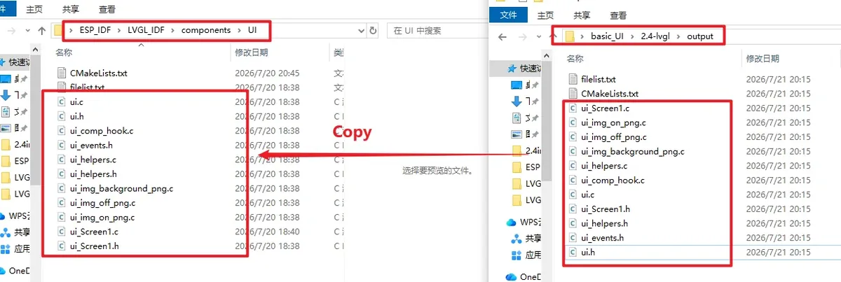

  8. Export UI files.
    Then click "APPLY CHANGES".
    You can click download to download the export UI files we provided.

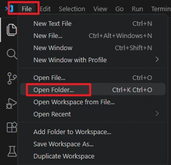

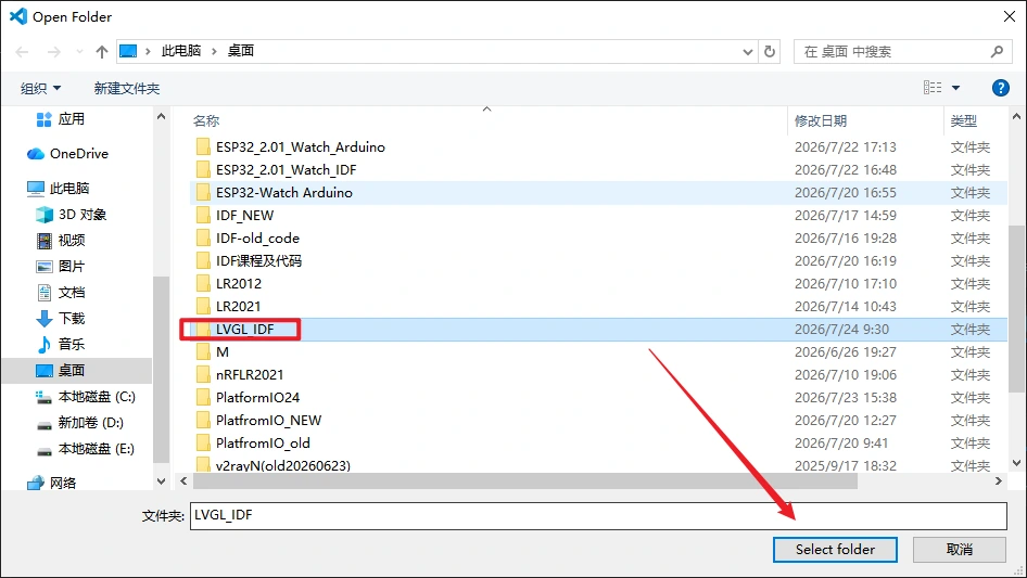

Please click the card below to learn how to install ESP-IDF. Create a blank project according to the "Get Started with ESP-IDF".
You can click download to download the complete project we provided. This project can be used directly. You can also create the project by following the tutorial.

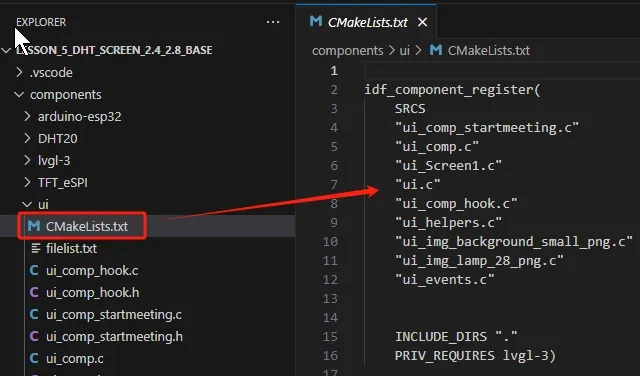

Create a new folder and name the folder 'components'. Add the libraries we provided to this folder.

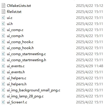

Setup UI file
Add the UI file we exported earlier in Squareline.

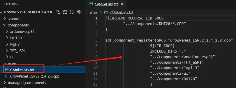

The CMakeList.txt file in the UI file needs to be modified as follows:
Setup main file
The CMakeList.txt file contains the Settings for the library. All required libraries should be included by directory address. The CPP file of DHT20 has an additional column.
The main program is written in CrowPanel_ESP32_2.4_2.8.cpp file.

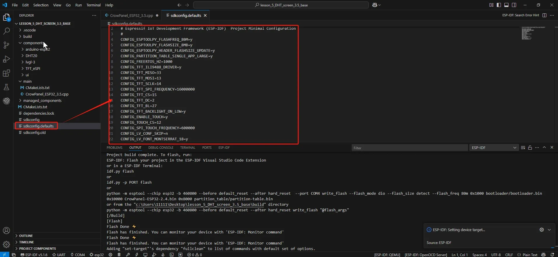

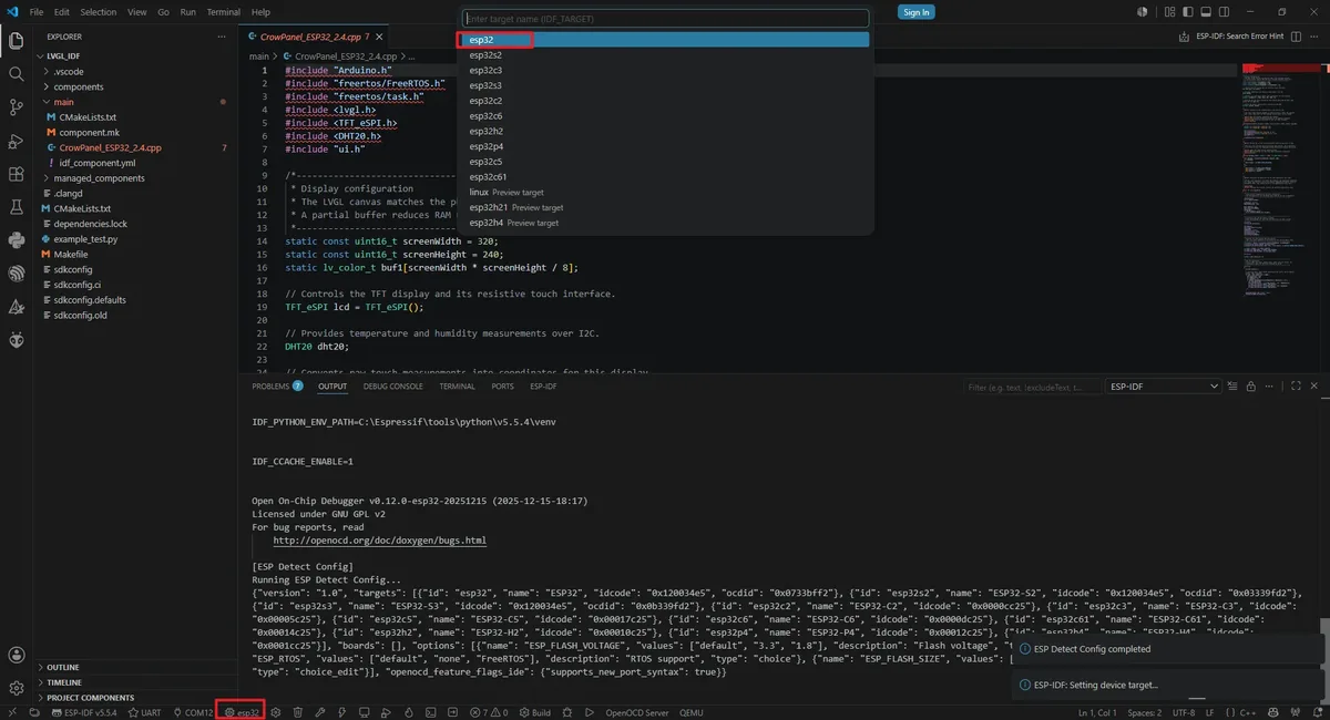

Setup board

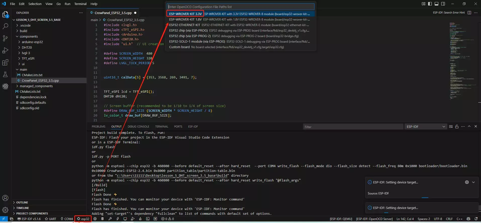

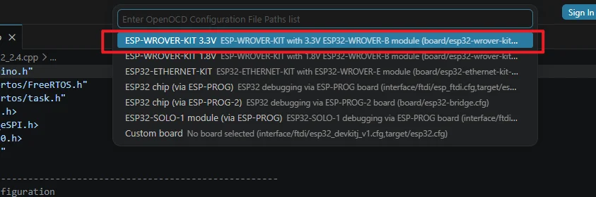

All required configuration options are defined in the "sdkconfig.defaults" file.

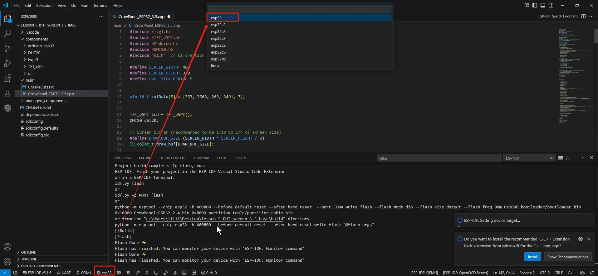

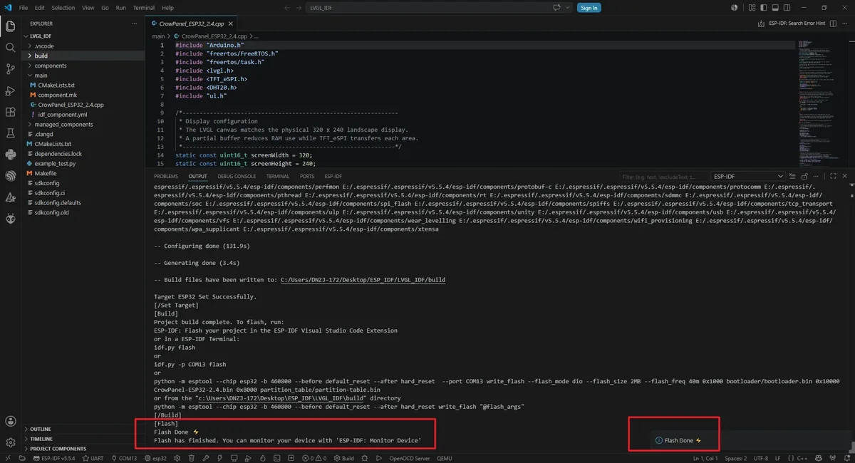

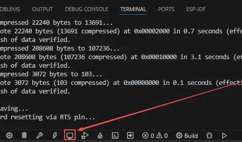

Download the program

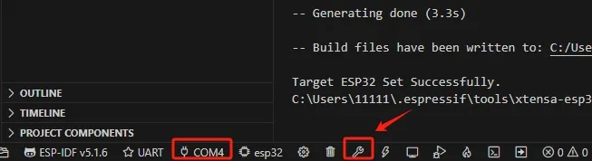

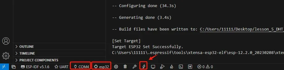

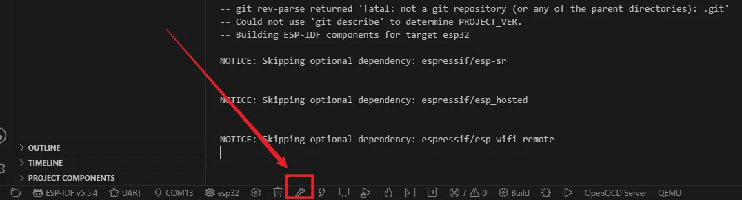

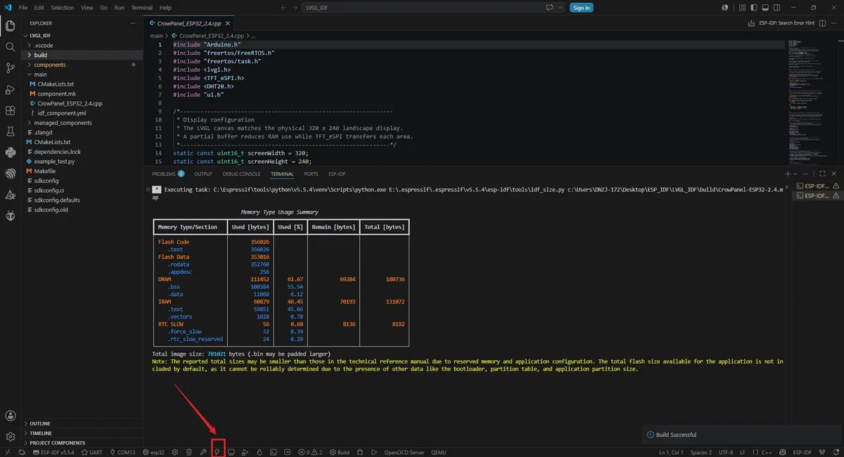

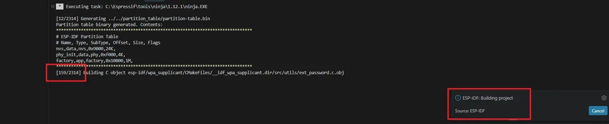

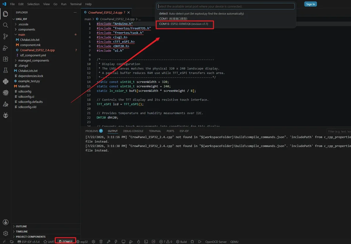

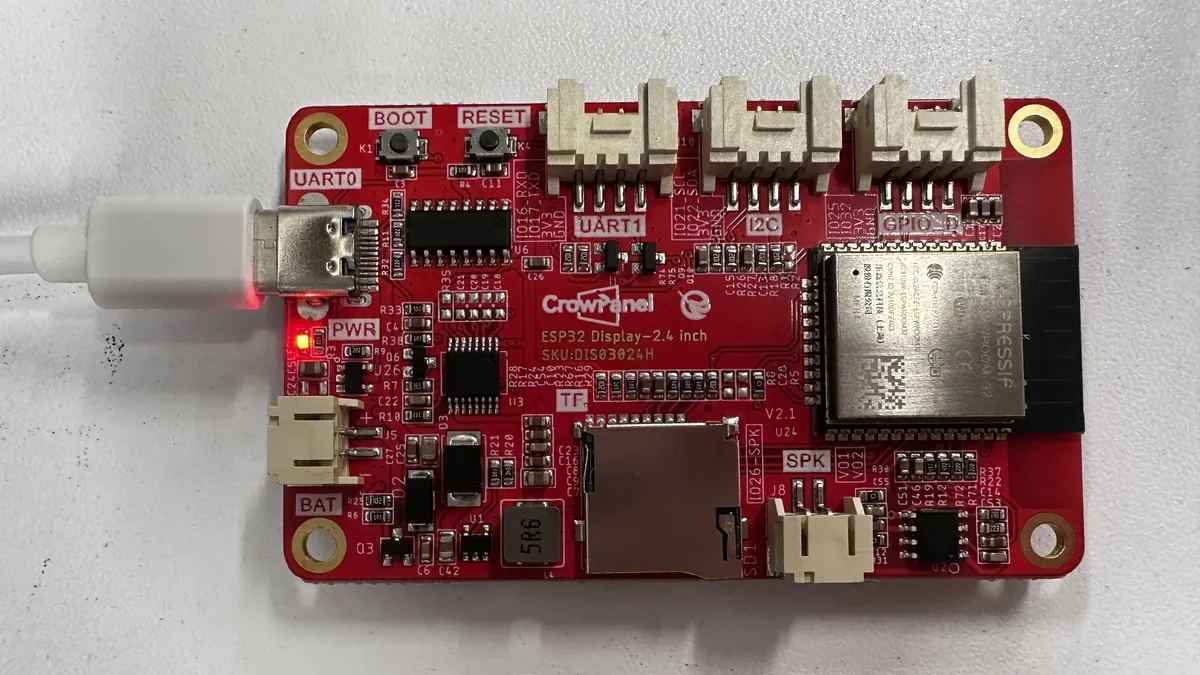

Connect the ESP32 Display to the PC and compile the program.
After confirming the serial port, select the UART mode.

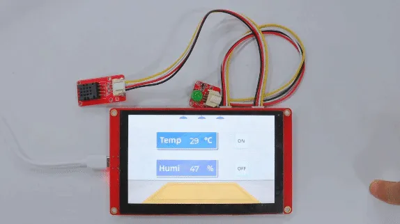

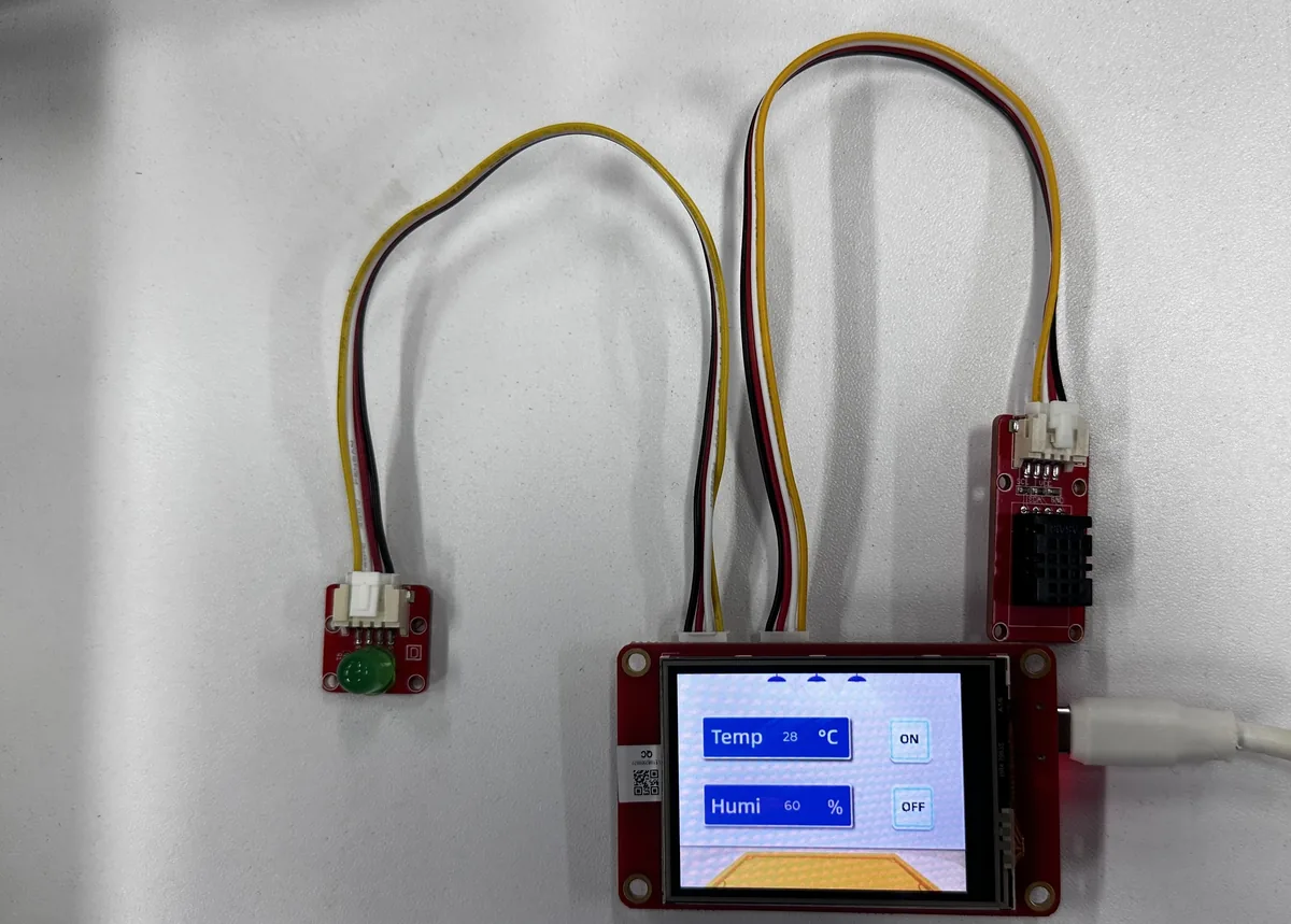

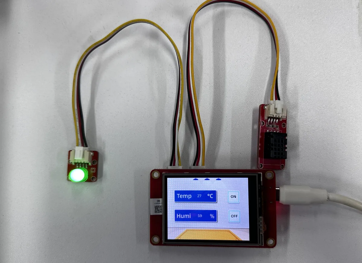

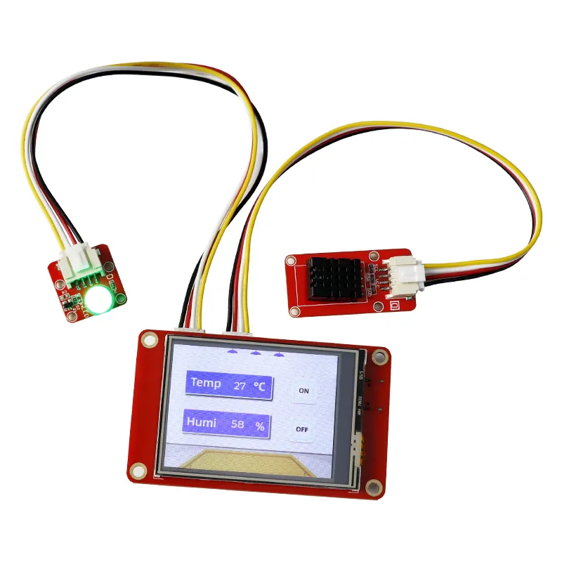

After the program is successfully downloaded, connect the DHT20 sensor to the IIC port and the LED to GPIO_D (IO25), the temperature and humidity values will be displayed on the screen. Click the ON button on the screen and the LED will turn on. Click the OFF button and the LED will turn off.
