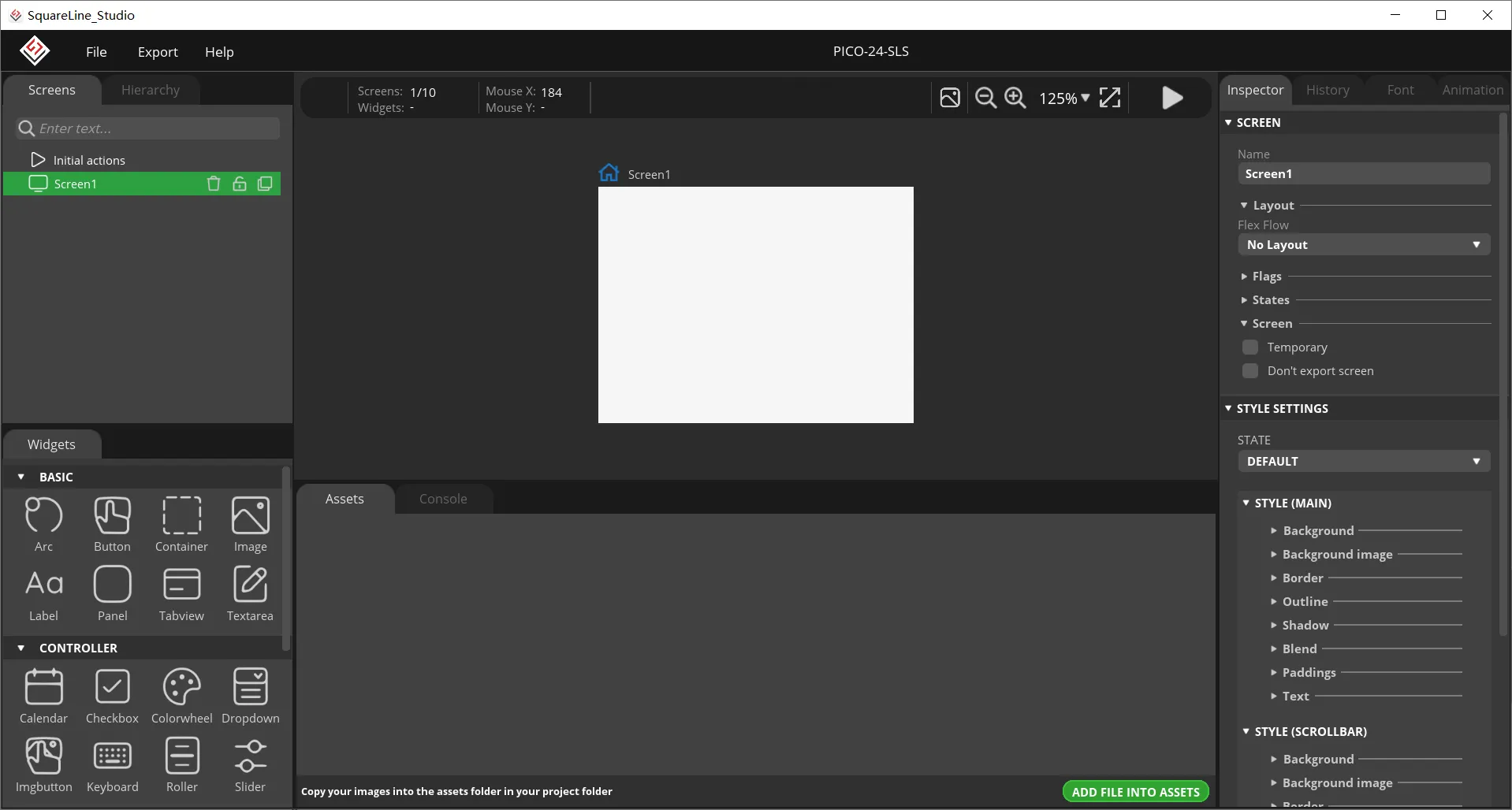

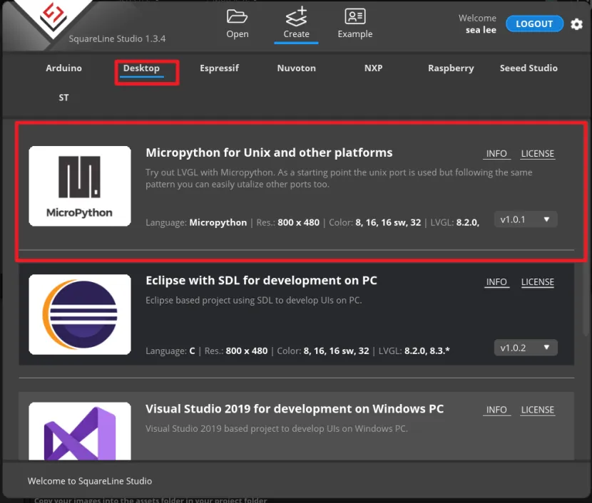

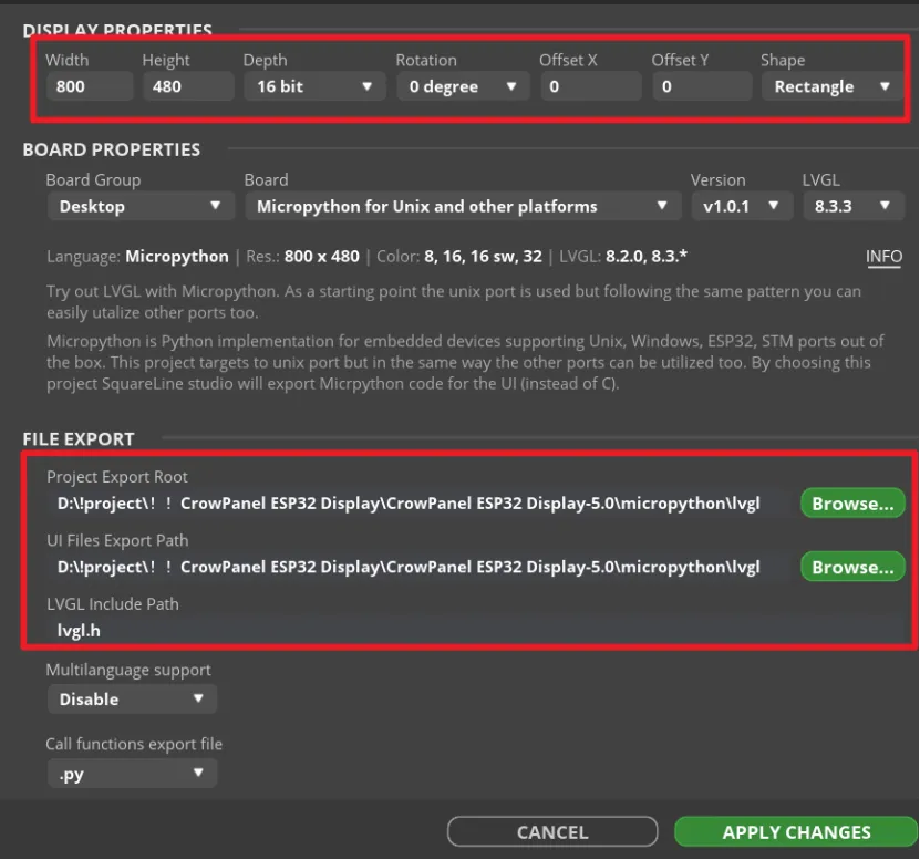

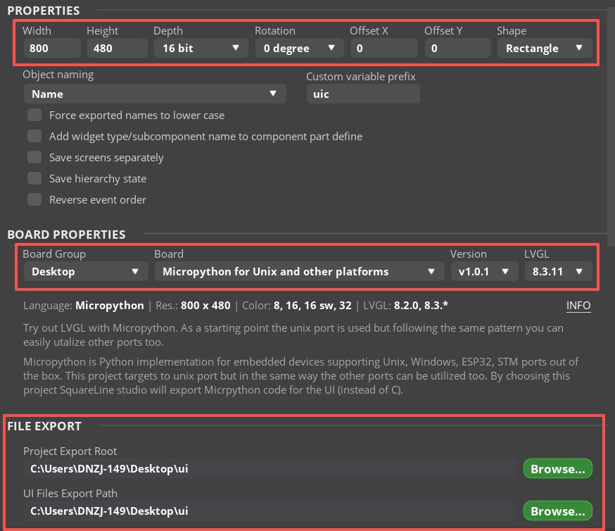

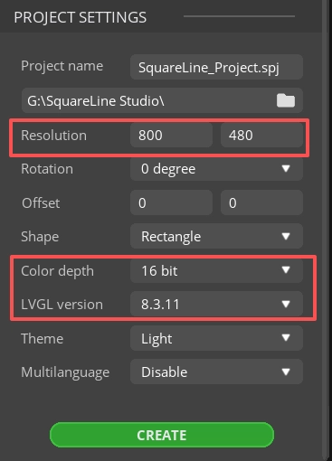

Open the SquareLine Studio and create a project. Select "Desktop"->"Micropython for Unix and other platform".
Set the name of the project, set the screen resolution to 800*480, set the color depth to 16bit, and keep other default settings. After setting, click CREATE to create the project.
- 16-bit color depth: can represent 65,536 colors through RGB 5:6:5 sub-pixel representation, that is, each RGB channel occupies 5 bits and 1 bit (a total of 16 bits) to represent colors.
After creation, enter the following interface with a blank background.

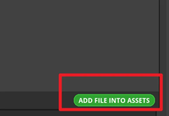

In the "Assets" area, click "ADD FILE TO ASSETS" to add custom images or icons.

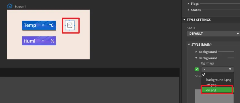

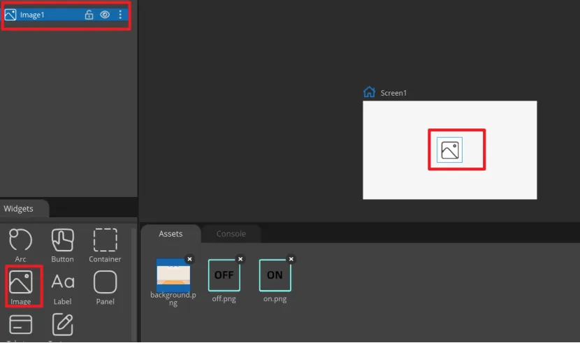

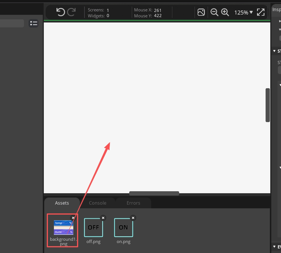

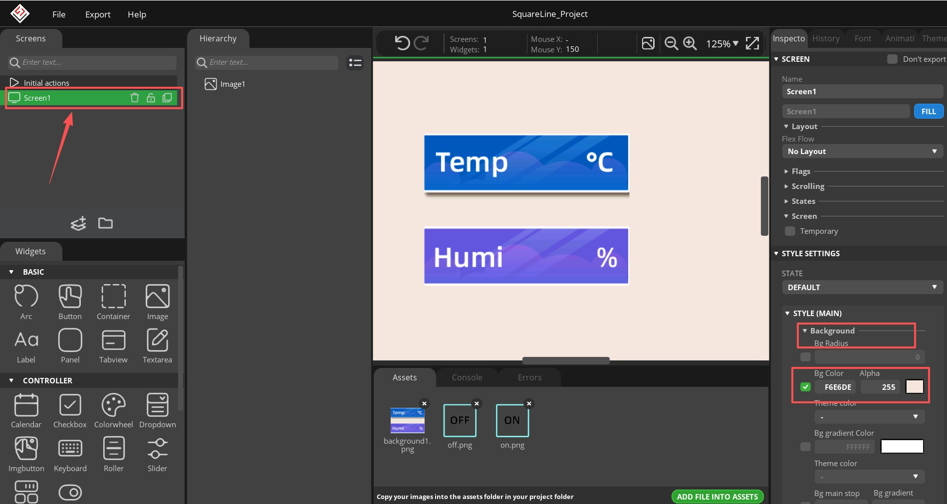

Add background.
Click "Image" to add the image widgets.

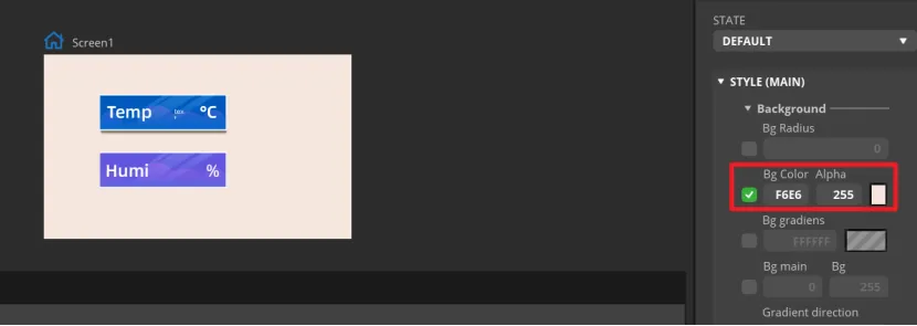

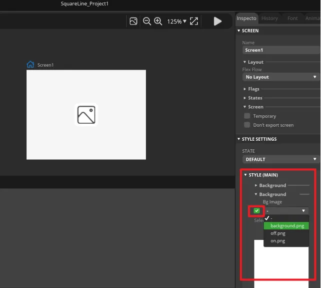

Find "Inspector"->"STYLE SETTING", click to expand "STYLE(MAIN)", then click the 2nd "Background". Check the "Bg Image" and select a background picture.
Adjust the position of the image.
Note: Because it requires a large amount of memory when running in Thonny IDE, the UI background resolution of this tutorial is small and not full screen, so it is necessary to modify the background to the same color as the image.

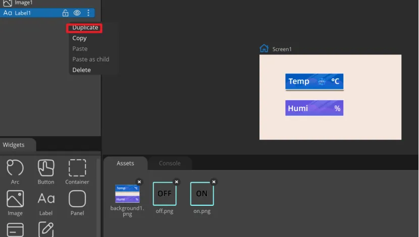

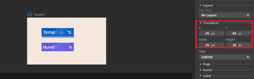

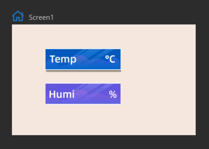

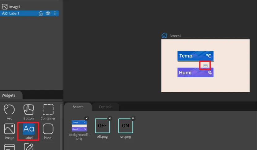

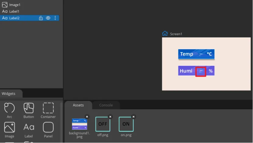

Add Label widget to show temperature and humidity value
Click "Label" in the "Widgets" area, and "Label1" will be added to the current Screen.
The content, position and size of the label can be adjusted by dragging the mouse. You can also directly enter numbers in the Inspector→LABEL→Transform to adjust. You can set the font color and other attributes in STYLE SETTING→STYLE(MAIN).
You can set the color and other attributes of the font in STYLE SETTING ->STYLE (MAIN).
Duplicate a Label2 to show humidity value.
Adjust the position.

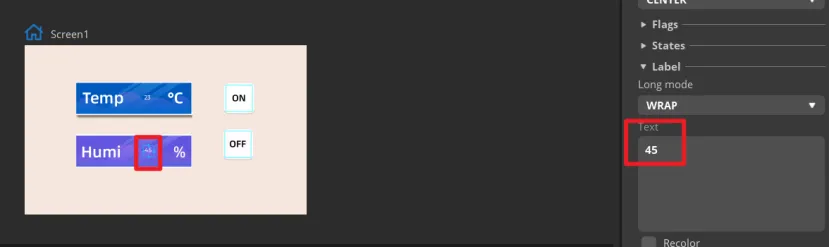

You can change the text of the label to set a default value.

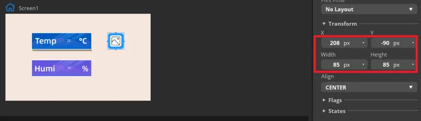

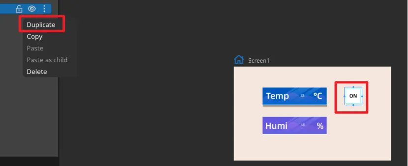

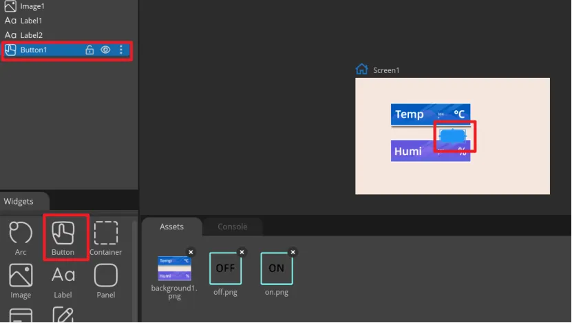

Add Button widget to control the LED.
Click "Button" in the "Widgets" area, and "Button1" will be added to the current Screen.
The position and size of the label can be adjusted by dragging the mouse. You can also directly enter numbers in the Inspector→BUTTON→Transform to adjust.

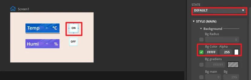

Add an identification symbol to the button. The button in this tutorial controls the LED switch, so you only need to mark the button "on" and "off". You can add LABEL widgets or add a background images to the button. This tutorial will demonstrate how to add a background image to a button.
Click the Button1, then find Inspector->STYLE SETTINGS ->STYLE(MAIN) ->Background, and select the image.

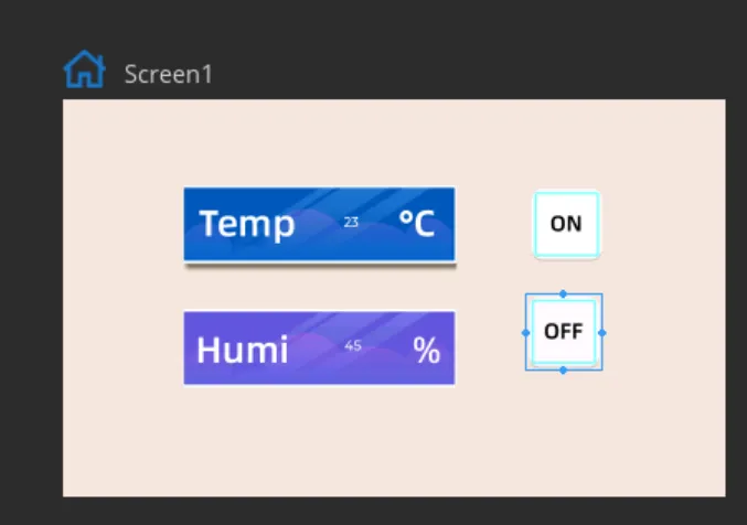

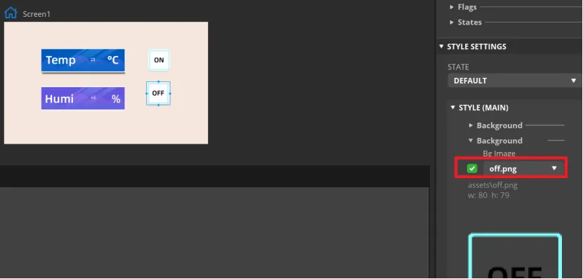

Duplicate a Button2 for "OFF".

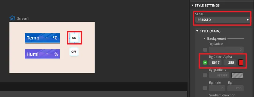

Set the status of the button to identify different states.
In "Inspector"->"STYLE SETTINGS"->"STATE", set display white background color by DEFAULT and red when on the PRESSED state.

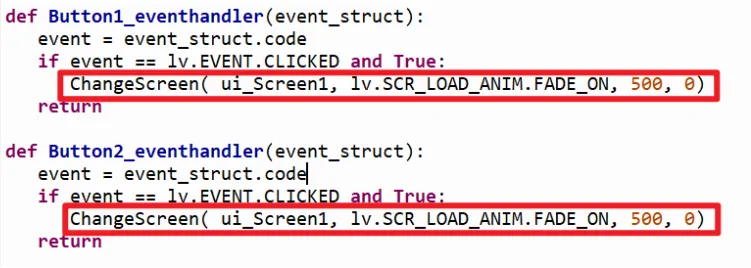

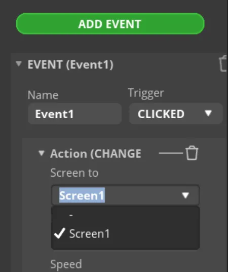

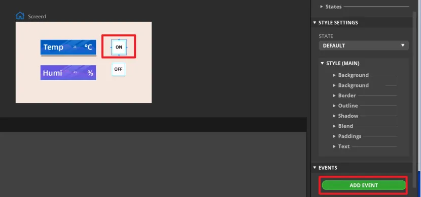

Add events to buttons.
Note: Because the button controls the on and off of the LED, we can add any event here to generate the code framework for the button event when exporting the UI file. We will modify the code of the button event to control the LED latter.

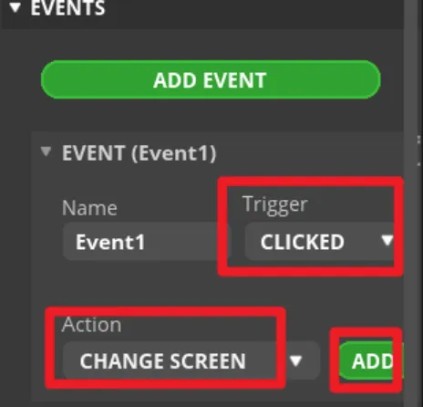

Select the button and click "ADD EVENT".
Select "released" as the trigger condition, select a trigger event in "Action". It will be modified in the generated program to achieve the LED control function.
Complete the event. Here I choose to change the screen, and the screen to be switched is Screen1.
Make the same settings for the "OFF" button.
Export UI files.

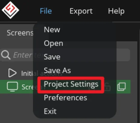

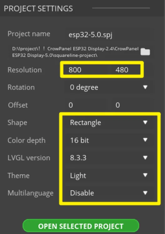

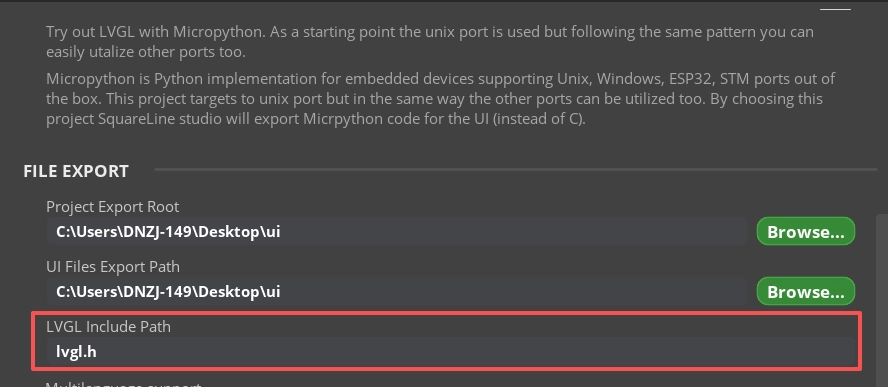

Click "File" -> "Project Settings" and make settings for the exported file.
Set the export path of the file (set the path according to your own file).
Fill in lvgl.h in LVGL Include Path. Check "Flat export(exports all files to one folder )".
Then click "APPLY CHANGES".

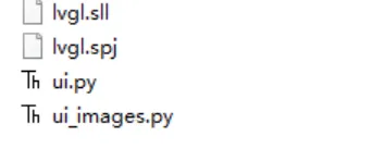

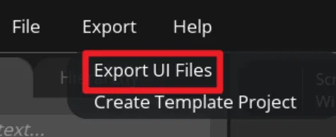

Export UI files. The exported files will be in the path we set earlier.
The UI file export is completed. Next we're going to learn about the main program and learn how to upload the code to the board with Thonny IDE.

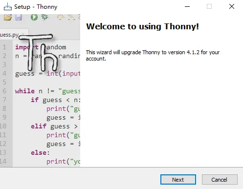

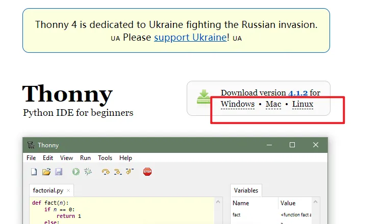

Download Thonny IDE¶
Go to the website https://thonny.org/ and download the corresponding software version (here we take the Windows version as an example)
Double-click the downloaded exe file to install the software.

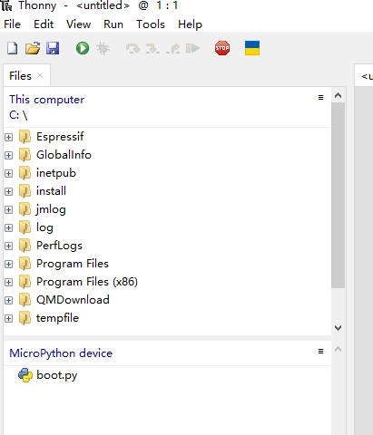

Upload firmware¶

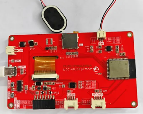

Connect the CrowPanel ESP32 HMI with your computer.

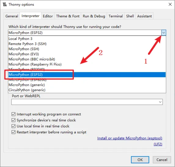

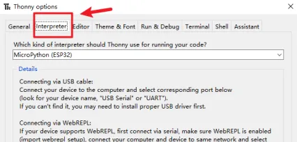

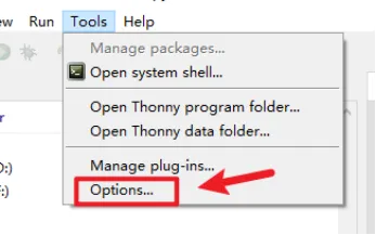

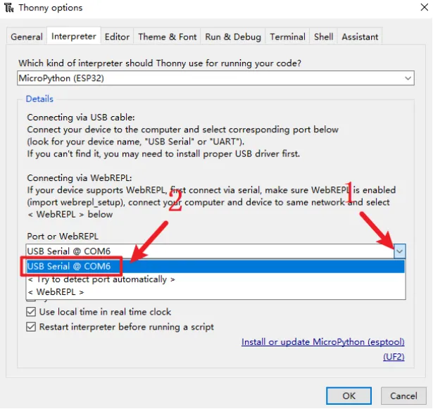

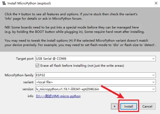

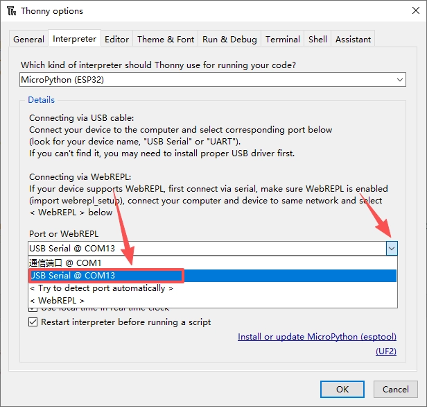

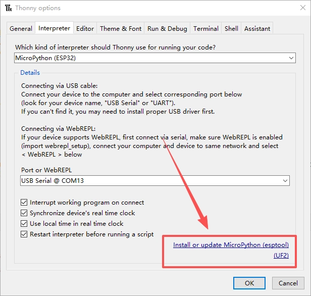

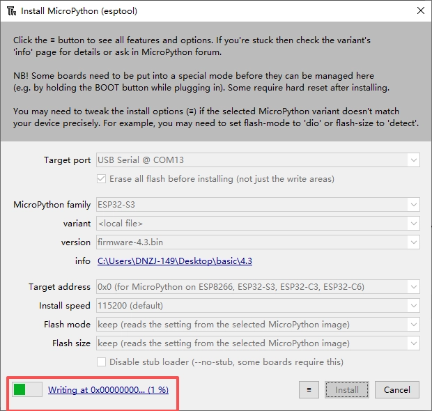

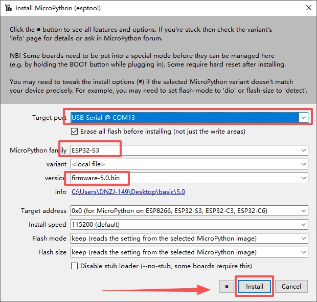

Open Thonny IDE and click "Tools"->"Options"->"Interpreter".

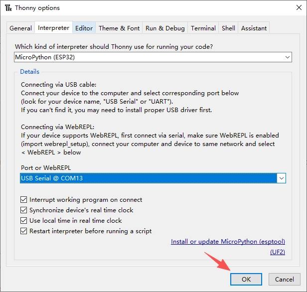

Select "MicroPython(ESP32)" for interpreter.

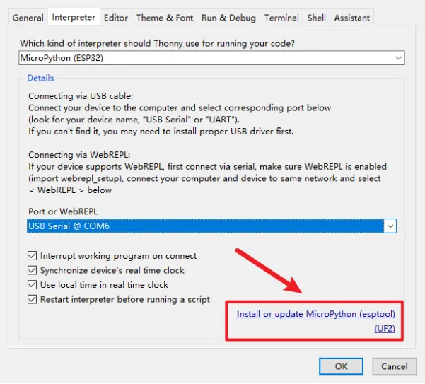

Select the corresponding serial port(or Try to detect port automatically).

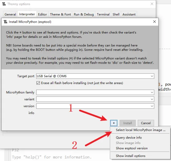

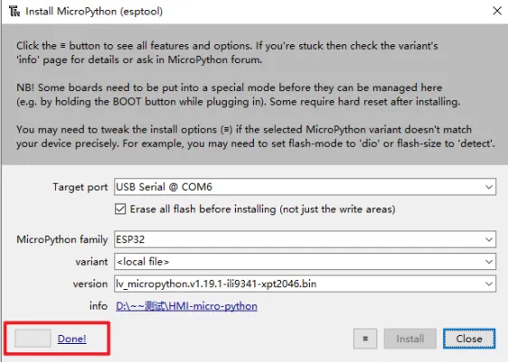

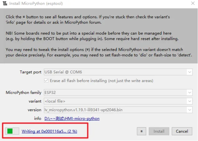

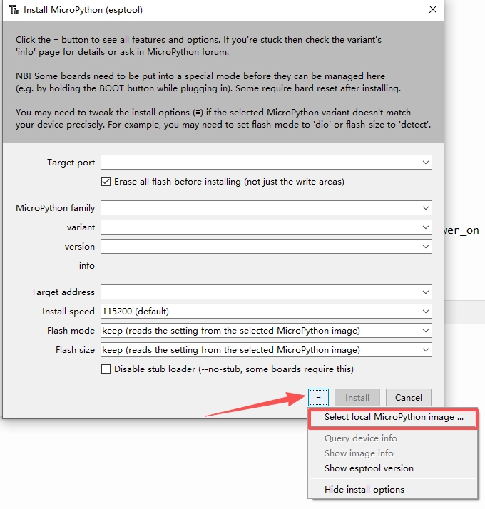

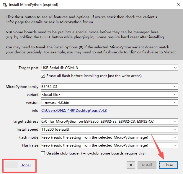

Click "Install or update MicroPython (esptool)"
Click the icon with 3 lines, and click "select local MicroPython image...".Select the "firmware-5.0-A.bin" and install.
Please click
to download the bin file.
Waiting for downloading...

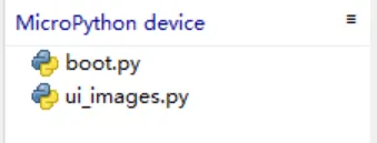

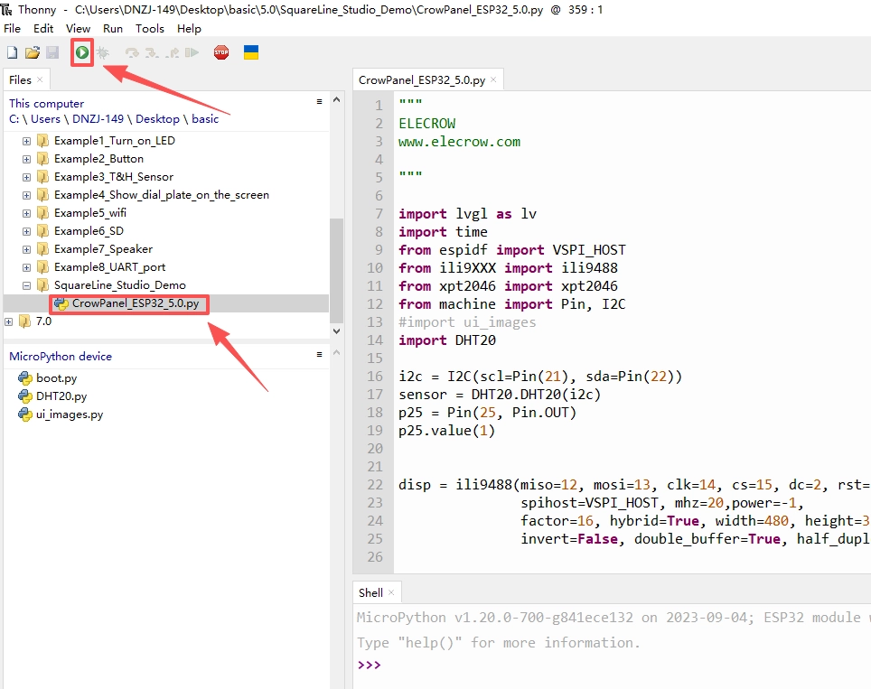

Edit the code¶
Please click to download the code file and libraries.

ui_Button1.set_style_bg_img_src( ui_images.ui_img_on_png, lv.PART.MAIN | lv.STATE.DEFAULT )
ui_Button1.set_style_bg_color(lv.color_hex(0xE61717), lv.PART.MAIN | lv.STATE.PRESSED )
ui_Button1.set_style_bg_opa(255, lv.PART.MAIN| lv.STATE.PRESSED )
ui_Button1.add_event_cb(Button1_eventhandler, lv.EVENT.ALL, None)
ui_Button2 = lv.btn(ui_Screen1)
ui_Button2.set_width(85)
ui_Button2.set_height(85)
ui_Button2.set_x(205)
ui_Button2.set_y(40)
ui_Button2.set_align( lv.ALIGN.CENTER)
SetFlag(ui_Button2, lv.obj.FLAG.SCROLLABLE, False)
SetFlag(ui_Button2, lv.obj.FLAG.SCROLL_ON_FOCUS, True)
ui_Button2.set_style_bg_color(lv.color_hex(0xFBF9F9), lv.PART.MAIN | lv.STATE.DEFAULT )
ui_Button2.set_style_bg_opa(255, lv.PART.MAIN| lv.STATE.DEFAULT )
ui_Button2.set_style_bg_img_src( ui_images.ui_img_off_png, lv.PART.MAIN | lv.STATE.DEFAULT )
ui_Button2.set_style_bg_color(lv.color_hex(0xB9B3B3), lv.PART.MAIN | lv.STATE.PRESSED )
ui_Button2.set_style_bg_opa(255, lv.PART.MAIN| lv.STATE.PRESSED )
ui_Button2.add_event_cb(Button2_eventhandler, lv.EVENT.ALL, None)
ui_Image1 = lv.img(ui_Screen1)
ui_Image1.set_src(ui_images.ui_img_background1_png)
ui_Image1.set_width(lv.SIZE.CONTENT) # 1
ui_Image1.set_height(lv.SIZE.CONTENT) # 1
ui_Image1.set_x(-90)
ui_Image1.set_y(-14)
ui_Image1.set_align( lv.ALIGN.CENTER)
SetFlag(ui_Image1, lv.obj.FLAG.ADV_HITTEST, True)
SetFlag(ui_Image1, lv.obj.FLAG.SCROLLABLE, False)
ui_Label1 = lv.label(ui_Screen1)
ui_Label1.set_text("23")
ui_Label1.set_width(25) # 1
ui_Label1.set_height(25) # 1
ui_Label1.set_x(-49)
ui_Label1.set_y(-89)
ui_Label1.set_align( lv.ALIGN.CENTER)
ui_Label1.set_style_text_color(lv.color_hex(0xFDF9F9), lv.PART.MAIN | lv.STATE.DEFAULT )
ui_Label1.set_style_text_opa(255, lv.PART.MAIN| lv.STATE.DEFAULT )
ui_Label1.set_style_text_font( lv.font_montserrat_16, lv.PART.MAIN | lv.STATE.DEFAULT )
ui_Label2 = lv.label(ui_Screen1)
ui_Label2.set_text("45")
ui_Label2.set_width(25) # 1
ui_Label2.set_height(25) # 1
ui_Label2.set_x(-48)
ui_Label2.set_y(60)
ui_Label2.set_align( lv.ALIGN.CENTER)
ui_Label2.set_style_text_color(lv.color_hex(0xFDFBFB), lv.PART.MAIN | lv.STATE.DEFAULT )
ui_Label2.set_style_text_opa(255, lv.PART.MAIN| lv.STATE.DEFAULT )
ui_Label2.set_style_text_font( lv.font_montserrat_16, lv.PART.MAIN | lv.STATE.DEFAULT )

UI code¶
This part copies the code of ui.py generated by Squareline Studio. We need to modify the part that control the button.
Modify from
to
def Button1_eventhandler(event_struct):
event = event_struct.code
if event == lv.EVENT.CLICKED and True:
pin38.value(1)
return
def Button2_eventhandler(event_struct):
pin38.value(0)
return

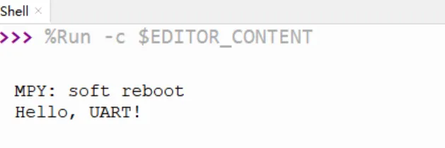

Upload the code¶

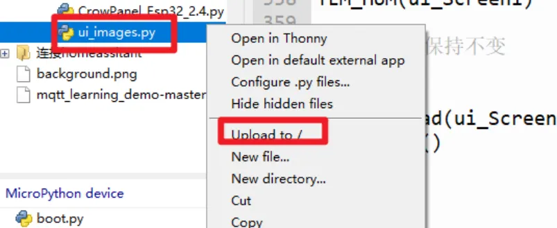

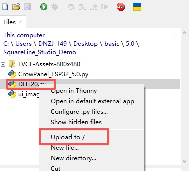

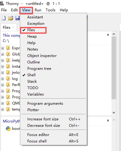

Upload the libraries¶
ui_image.py
In the upper left corner of the thonny, enter the path where ui_image.py is located, right-click ui_image.py, and click Upload to/
ui_image.py is added to MicroPython device successfully.

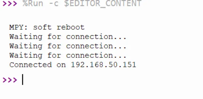

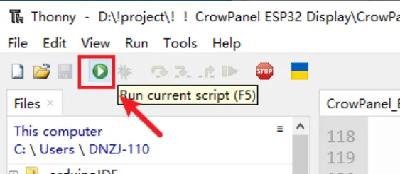

Upload the code¶
Click the "run" icon.
Successfully uploaded.

Example 4 Connect WiFi¶
Upload the following code to ESP32 HMI(note to modify the WiFi ssid and password to yours)
import network
import time
def connect():
ssid = 'yanfa_software'
password = 'yanfa-123456'
wlan = network.WLAN(network.STA_IF) # Create a WLAN object in station mode
wlan.active(True) # Activate the network interface
wlan.connect(ssid, password) # Connect to the specified WiFi network
while not wlan.isconnected(): # Wait for the connection to be established
print('Waiting for connection...')
time.sleep(1)
print('Connected on {ip}'.format(ip=wlan.ifconfig()[0])) # Print the IP address
connect()
Running result:

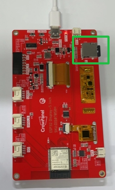

Example 5 Initialize SD card¶
import machine
import os
import sdcard
import uos
# SD Card Initialization
def init_sd():
# Creating SPI Objects
spi = machine.SPI(2, baudrate=1000000, polarity=0, phase=0, sck=machine.Pin(12), mosi=machine.Pin(11), miso=machine.Pin(13))
cs = machine.Pin(10, machine.Pin.OUT)
sd = sdcard.SDCard(spi, cs)
vfs = uos.VfsFat(sd)
uos.mount(vfs, "/sd")
print("SD card initialization complete")
print("List of documents:", os.listdir("/sd"))

Example 6 Playing music¶
Connect a speaker to the ESP32 HMI. Upload the following code.

Example 7 Initialize UART port¶
import machine
import time
# Initialize UART
uart = machine.UART(1, baudrate=115200, tx=43, rx=44)
def send_data(data):
uart.write(data) # Send data via UART
print("Sent:", data)
def receive_data():
if uart.any(): # Check for readable data
data = uart.read() # retrieve data
print("Received:", data)
return data
return None
# Example: Sending and Receiving Data
send_data('Hello, UART!\n')
while True:
received = receive_data()
if received:
# do something about it
pass
time.sleep(1)
Running result:
