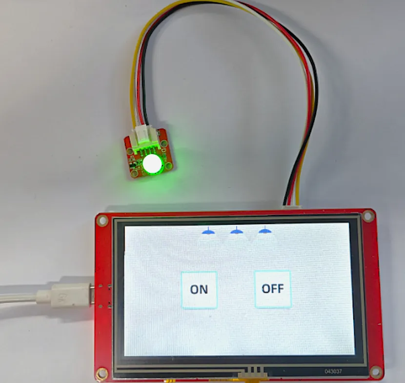

The example tutorial demonstrate how to create a UI and how to control the LED on and off by the buttons on the screen.
In this tutorial, we will show you how to design the UI with SquareLine Studio, and show you how to upload the code with Thonny IDE.

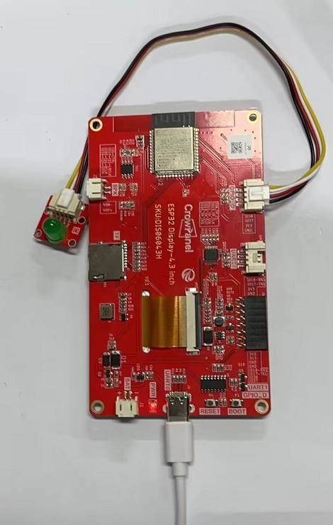

Hardware Preparation¶
| CrowPanel ESP32 4.3'' HMI | Crowtail-LED | Crowtail Cable |

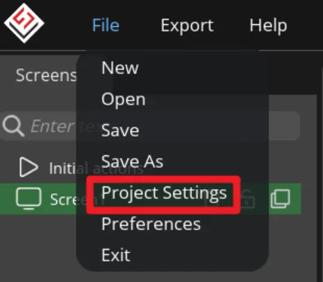

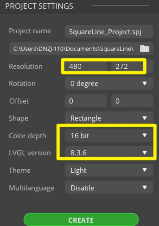

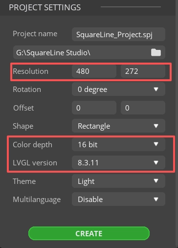

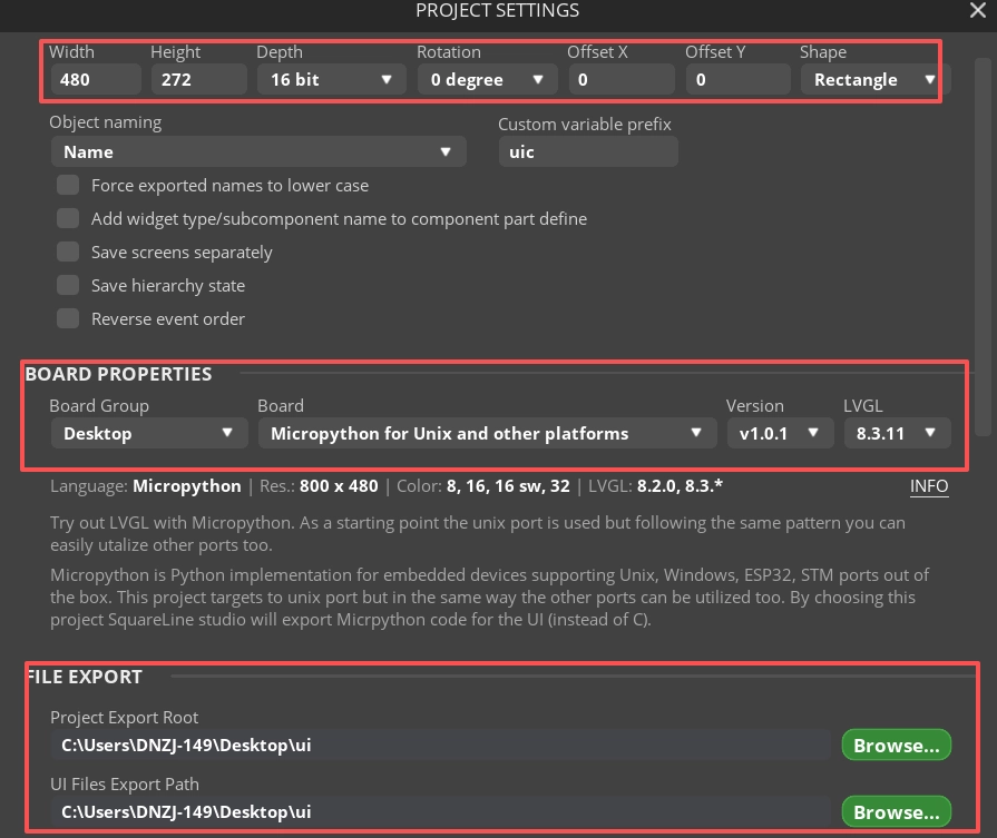

Open the SquareLine Studio and create a project. Select "Desktop"->"Micropython for Unix and other platform".

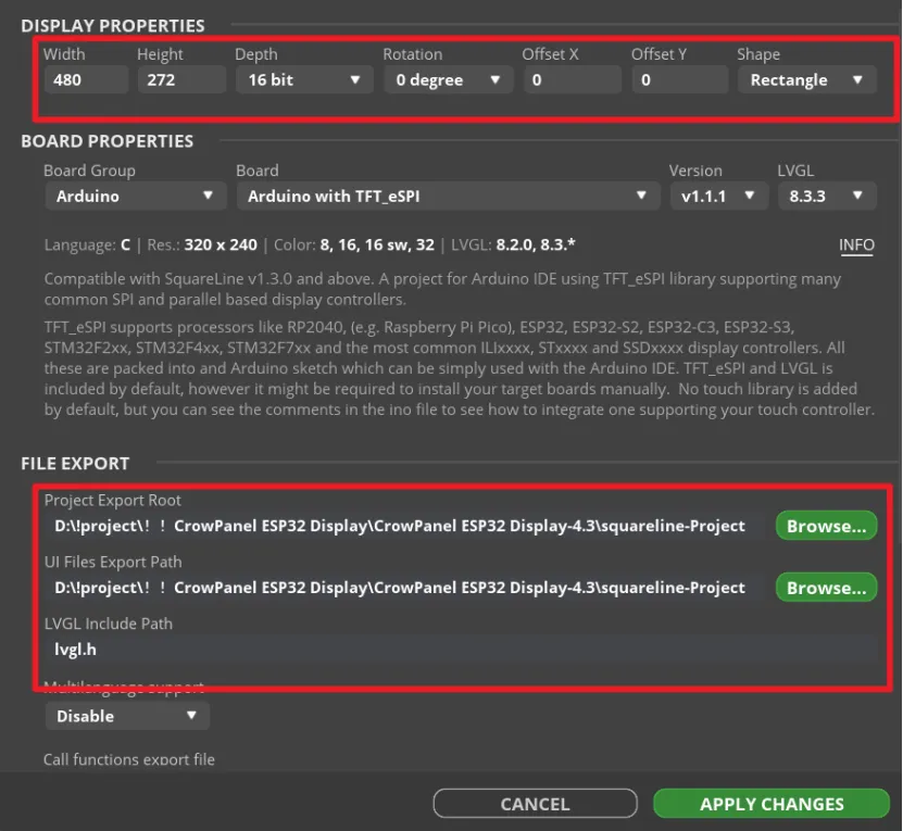

Set the name of the project, set the screen resolution to 480*272, set the color depth to 16bit, and keep other default settings. After setting, click CREATE to create the project.

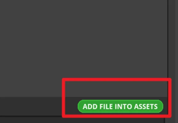

Please click
 to download the custom images used in this tutorial. -

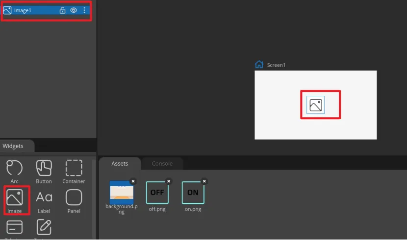

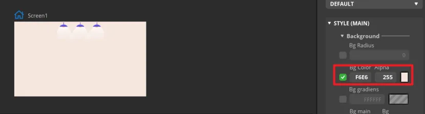

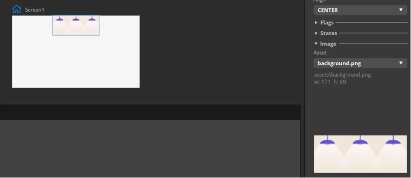

Add background.
Click "Image" to add the image widgets.

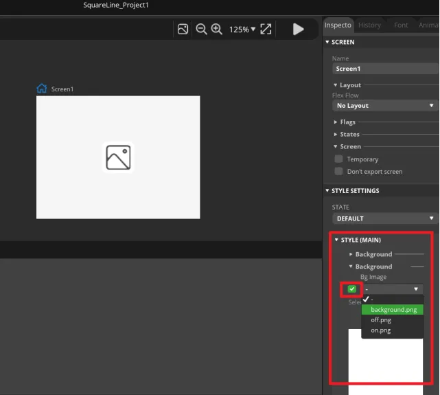

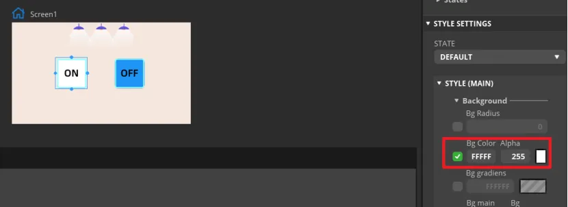

Find "Inspector"->"STYLE SETTING", click to expand "STYLE(MAIN)", then click the 2nd "Background". Check the "Bg Image" and select a background picture.

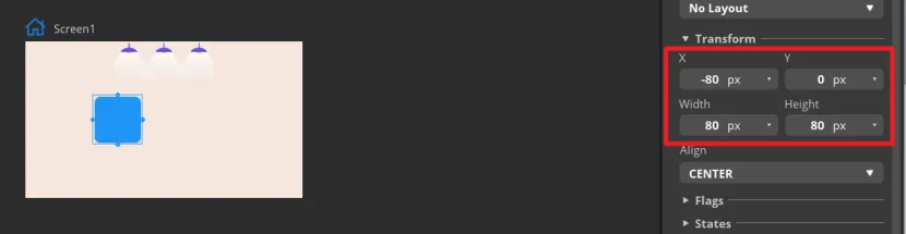

Adjust the position of the image.

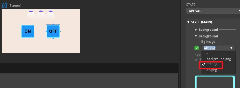

Note: Because it requires a large amount of memory when running in Thonny IDE, the UI background resolution of this tutorial is small and not full screen, so it is necessary to modify the background to the same color as the image.

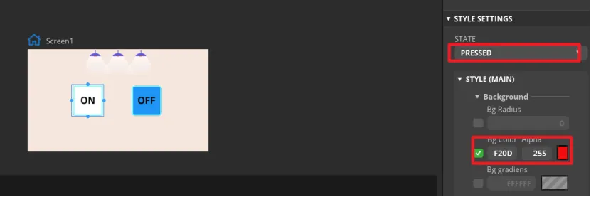

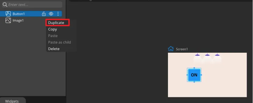

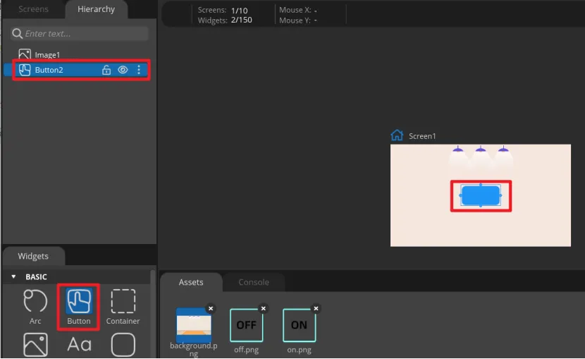

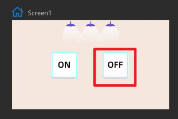

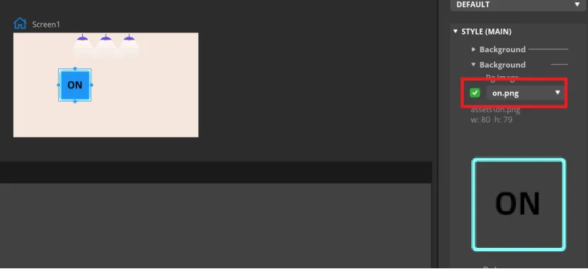

Add a Button2 for "OFF".

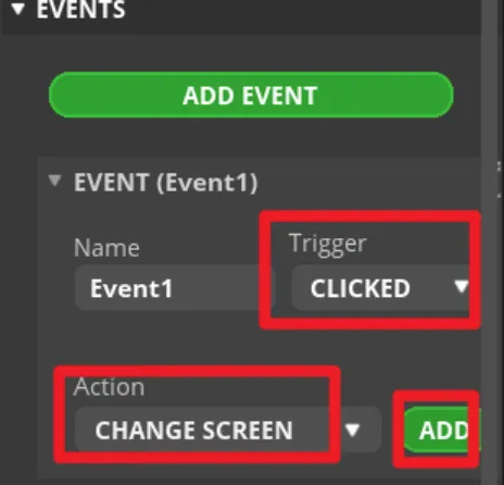

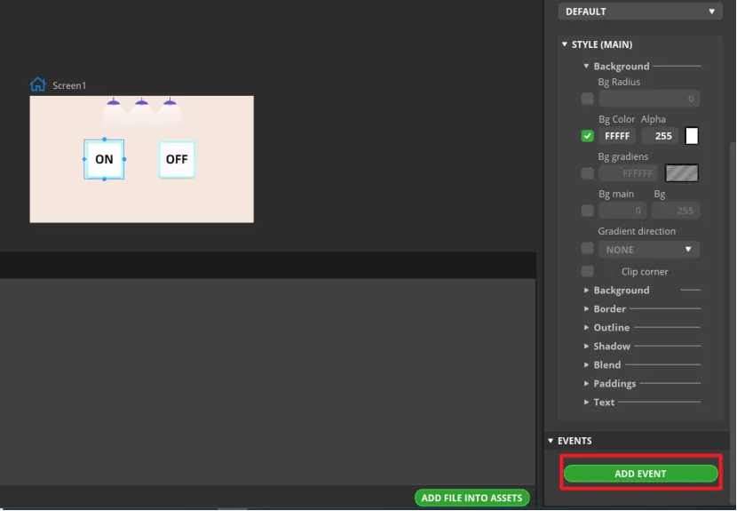

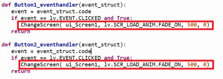

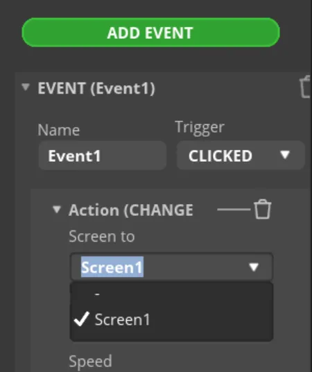

Add events to buttons.

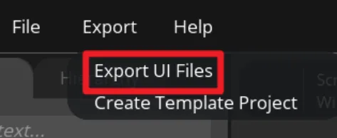

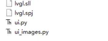

Export UI files.
Then click "APPLY CHANGES".
The UI file export is completed. Next we're going to learn about the main program and learn how to upload the code to the board with Thonny IDE.

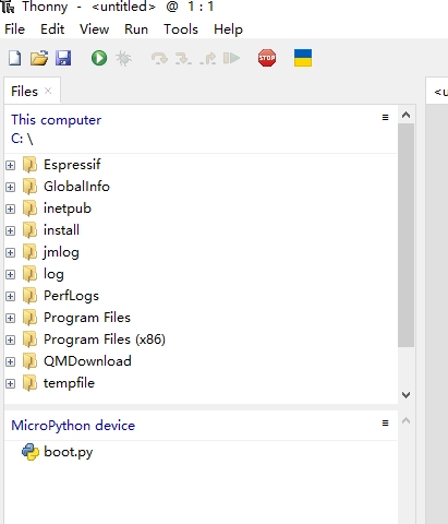

Connect the CrowPanel ESP32 HMI with your computer.

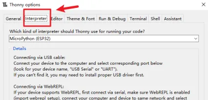

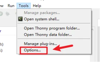

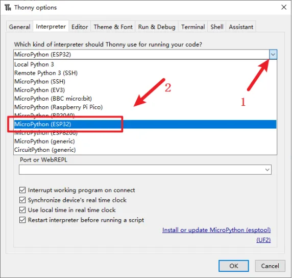

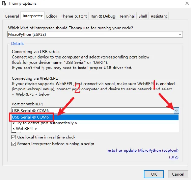

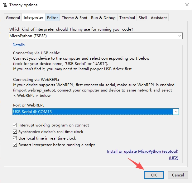

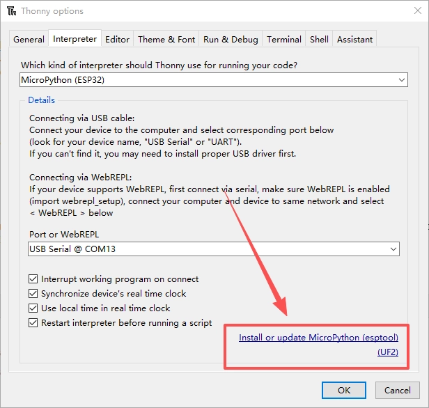

Open Thonny IDE and click "Tools"->"Options"->"Interpreter".
Select "MicroPython(ESP32)" for interpreter.

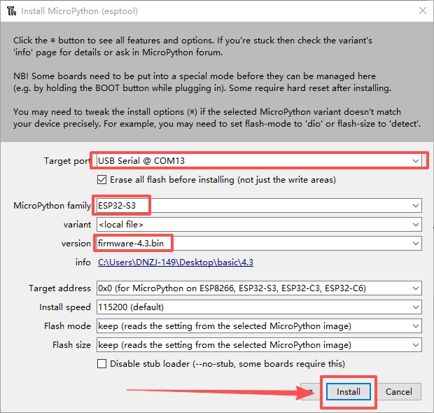

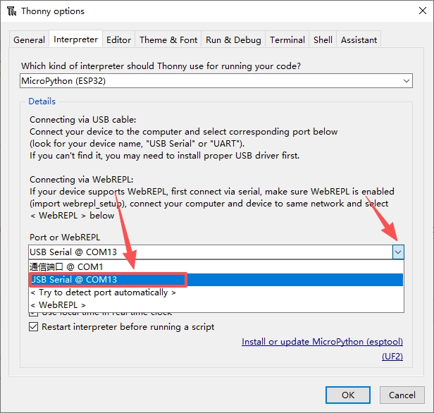

Select the corresponding serial port(or Try to detect port automatically).

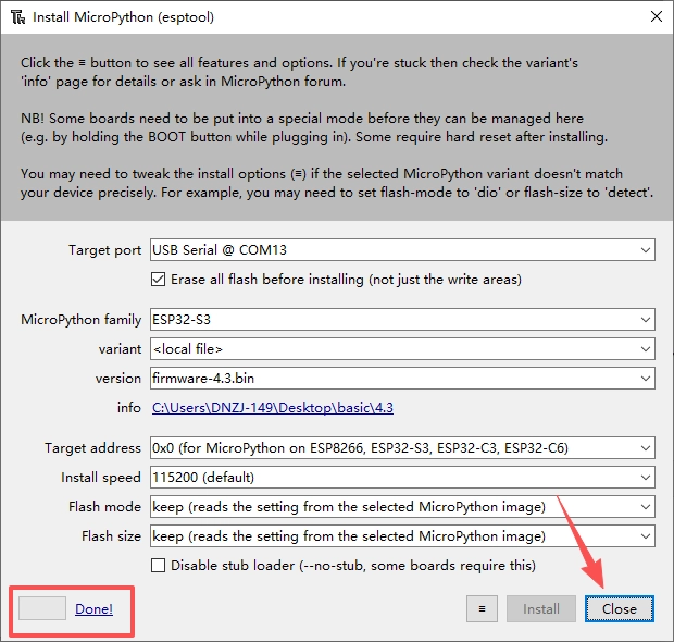

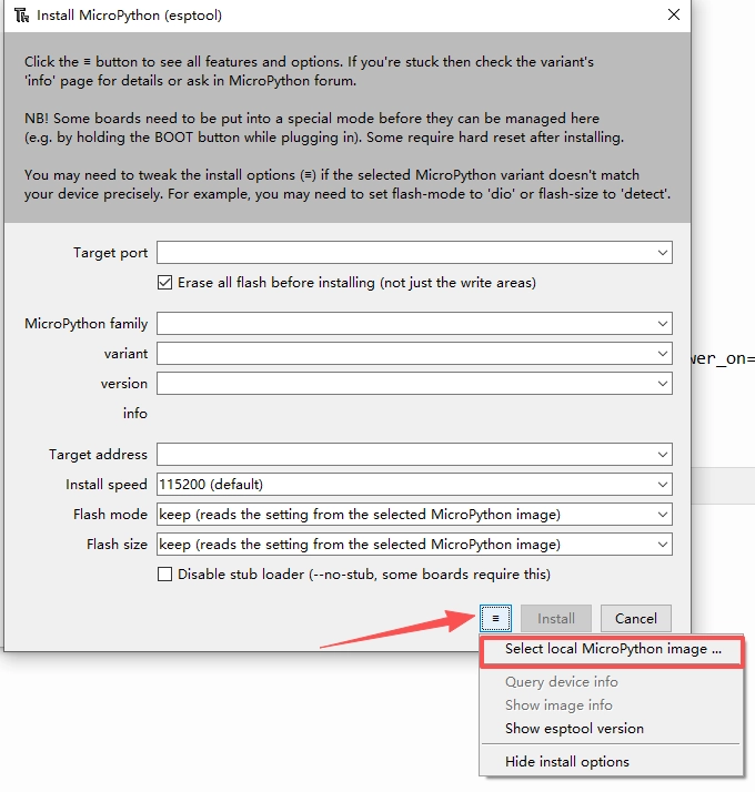

Click "Install or update MicroPython (esptool)"

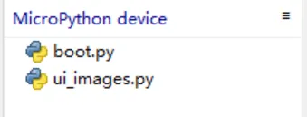

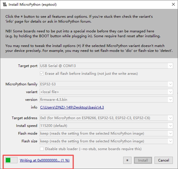

Click the icon with 3 lines, and click "select local MicroPython image...".Select the "firmware-4.3-A.bin" and install.
Waiting for downloading...

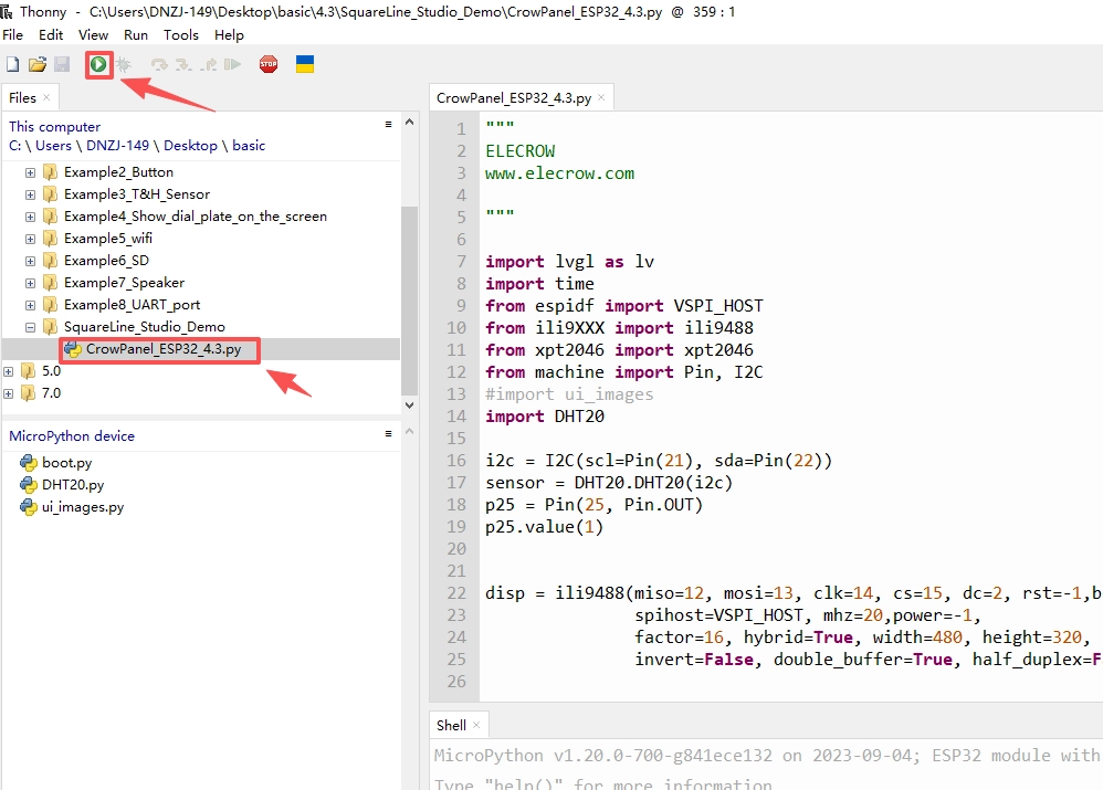

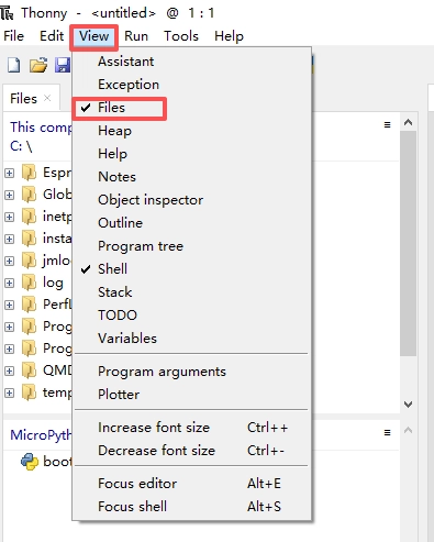

Edit the code¶
Please click
 to download the code file and libraries.

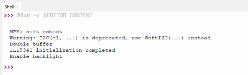

#Make by Elecrow
#Web:www.elecrow.com
import lvgl as lv
import lv_utils
import tft_config
from xpt import Touch
from machine import SPI, Pin
import time
import fs_driver
import ui_images
WIDTH = 480
HEIGHT = 272
pin38 = Pin(38, Pin.OUT)
pin38.value(0)
# tft drvier
tft = tft_config.config()
# touch drvier
spi = SPI(2, baudrate=1000000)
spi.init(sck=Pin(12), mosi=Pin(11), miso=Pin(13))
cs = Pin(0, mode=Pin.OUT, value=1)
int_pin = Pin(36)
xpt = Touch(spi, cs=cs, int_pin=int_pin)
xmin = 96
xmax = 1951
ymin = 175
ymax = 1908
orientation = 0
xpt.calibrate(xmin, xmax, ymin, ymax, 480, 272, orientation)
lv.init()
if not lv_utils.event_loop.is_running():
    event_loop=lv_utils.event_loop()
    print(event_loop.is_running())

This part copies the code of ui.py generated by Squareline Studio. We need to modify the part that control the button.
Modify from
to
def Button1_eventhandler(event_struct):
   event = event_struct.code
   if event == lv.EVENT.CLICKED and True:
      pin38.value(1)
   return
def Button2_eventhandler(event_struct):
      pin38.value(0)
   return
Upload the code¶
Please click
Upload the libraries¶

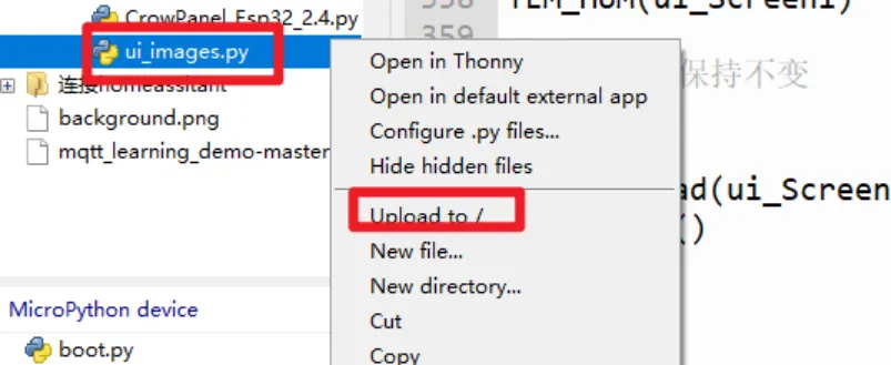

ui_image.py
In the upper left corner of the thonny, enter the path where ui_image.py is located, right-click ui_image.py, and click Upload to/
ui_image.py is added to MicroPython device successfully.
Upload the code¶
Click the "run" icon.
Successfully uploaded.

Example 1 Turn on/off the LED in a loop¶
Connect an LED module to the D port(pin38) of ESP32 4.3'' HMI, and upload the following code. The LED will turn on and off in a loop.
#Make by Elecrow
import time
from machine import Pin
while True:
    pin38.value(1)
    time.sleep(0.5)
    pin38.value(0)
    time.sleep(0.5)

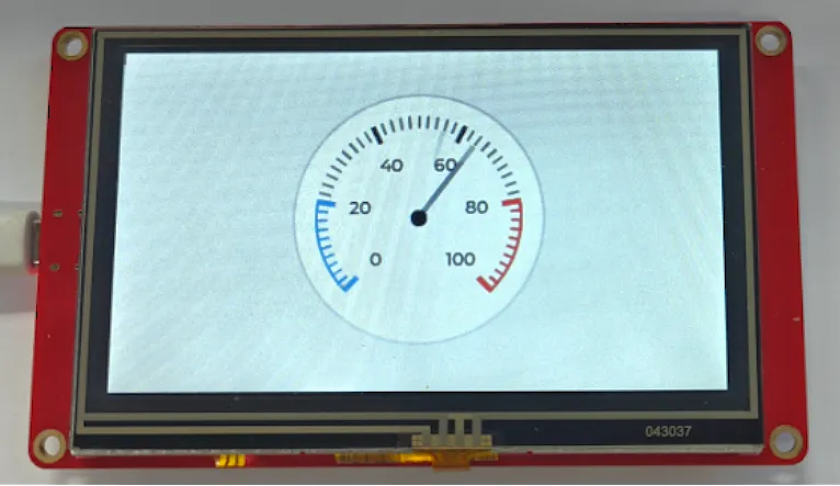

Example 2 Show dial plate on the screen¶
Upload the following code to the module, there will be a dial plate show on the screen.

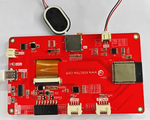

Example 4 Playing music¶
Connect a speaker to the ESP32 HMI. Upload the following code.

    time.sleep(1)
Running result:
