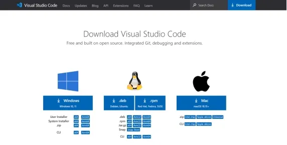

2. Install Visual Studio Code
Search for Visual Studio Code download on Google or enter the https://code.visualstudio.com/download, select the version compatible with your computer system and download Visual Studio Code installer. In this instructions we are selecting Windows.

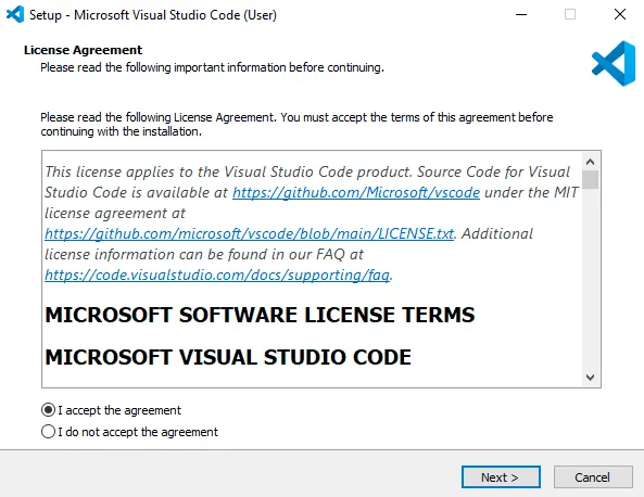

Double-click the VSCodeUserSetup file to install the Visual Studio Code.
Accept the license agreement and go next.

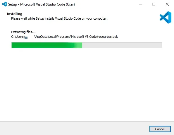

Click install and waiting for the installation ...

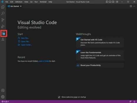

Click 'Finish' to exit the installation and (by default) launch Visual Studio Code:

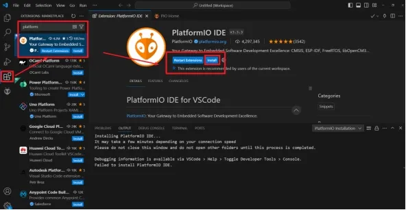

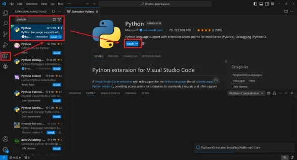

Open Visual Studio Code and open Extension Manager.
Install Python
Search for 'Python' and install.
Install PlatformIO
Search for 'PlatformIO' and install.

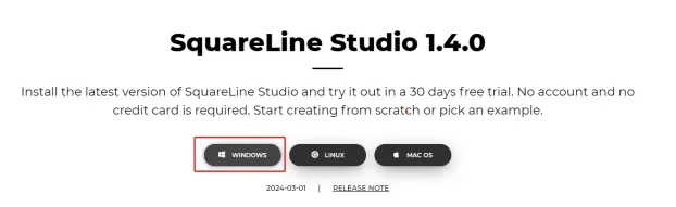

4.1 Installation Guide

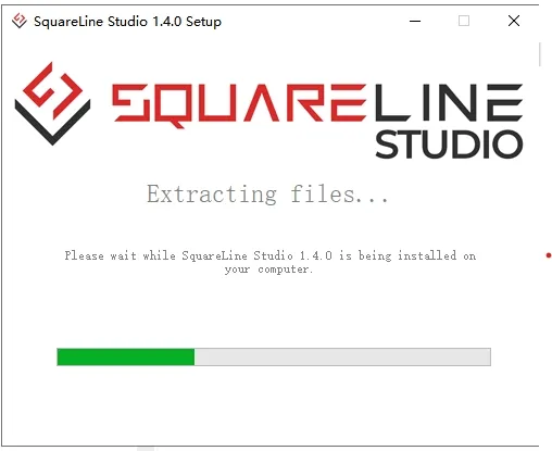

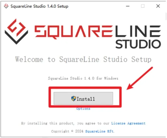

Download the version 1.4.0
Click install.

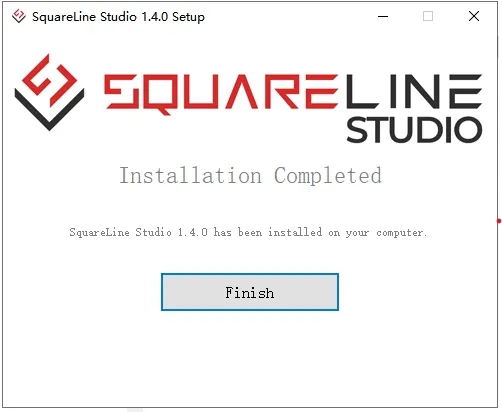

Wait for installation.
Installation finish.

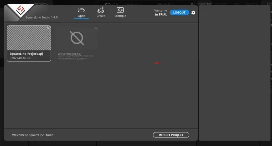

4.2 Software Function Introduction

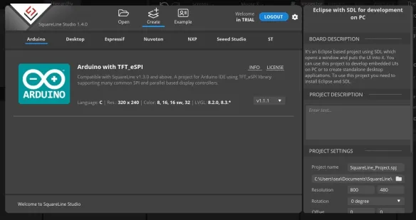

Open the software

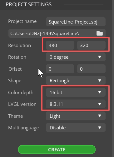

Note:Please select the corresponding resolution and color depth according to the screen specifications.

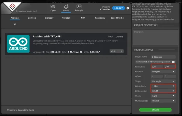

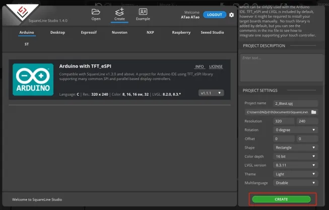

5.1 Create a new SquareLine Studio project.
Here, I take a 2.8-inch screen as an example. After determining the resolution, I fill it in

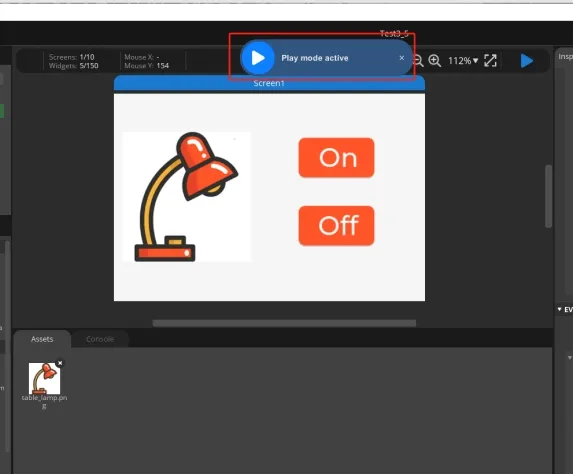

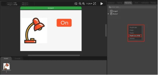

5.2 Add functions to the buttons to enable them to turn on and off lights
Select 'event' to add in the right sidebar.
After selecting, click ADD.
After adding, run

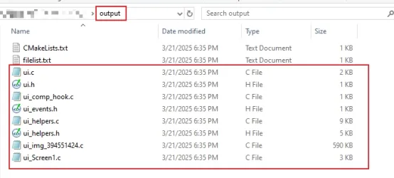

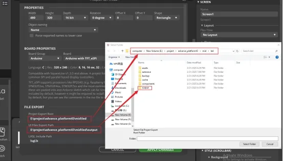

5.3 UI interface design completed, exporting UI files for easy use in subsequent code

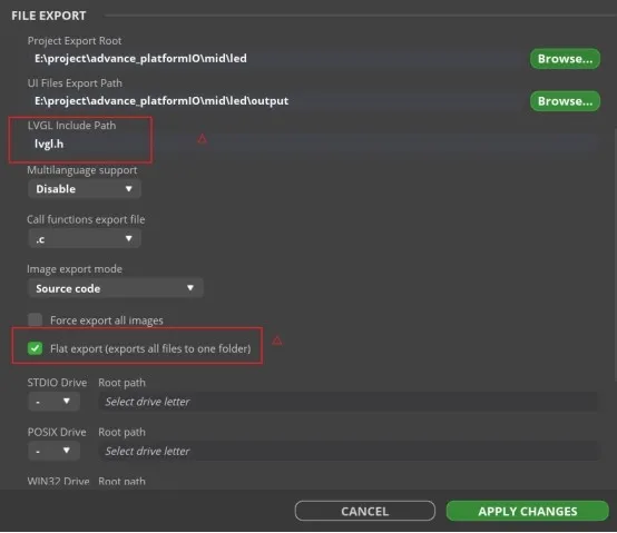

Click on Project Setting
Set export path.
Complete the setup and export file.

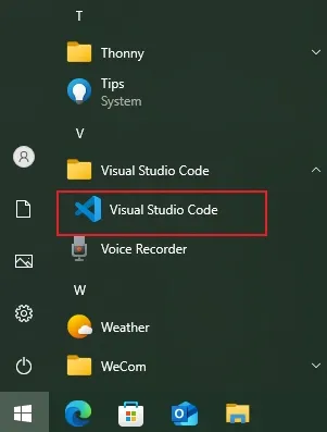

Double-click to open Visual Studio Code.

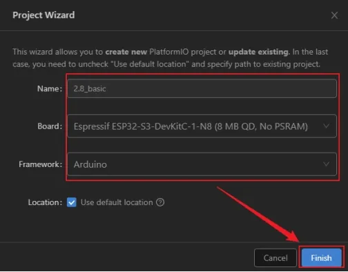

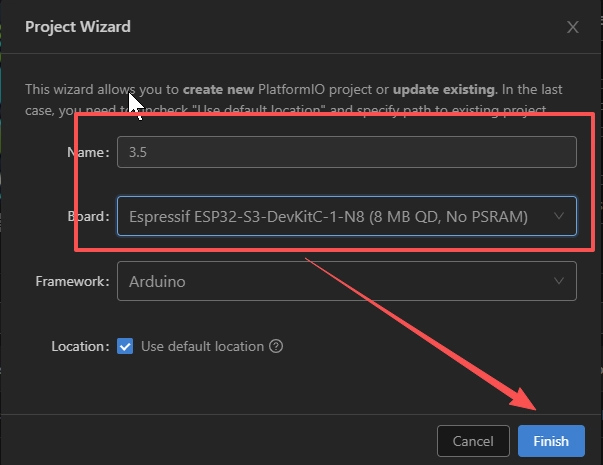

Click the PlatformIO icon, click QUIK ACCESS 'Open', then click '+New Project'.
Add a project name. Select "Espressif ESP32-S3-DevKitC-1-N8" for the board and Arduino for the framework.(In this lesson, the 2.8-inch development board is taken as an example.)

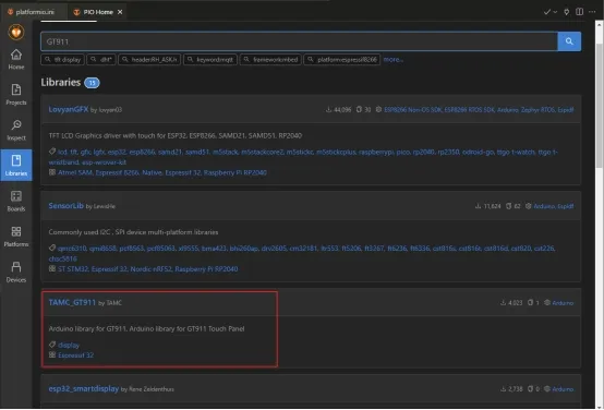

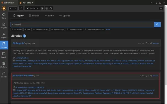

6.2 Add the necessary libraries to the PlatformIO project.

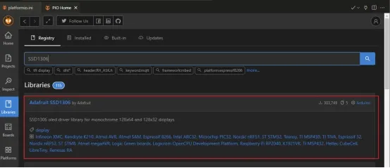

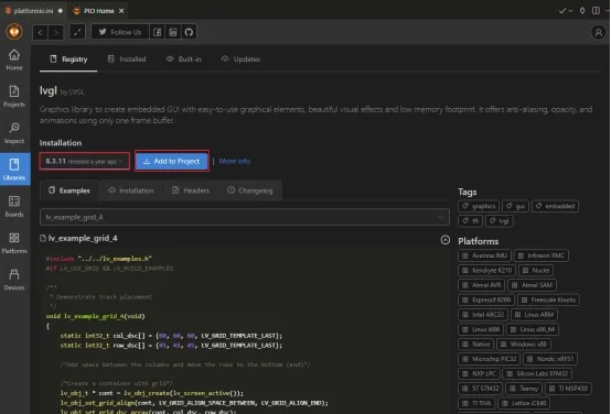

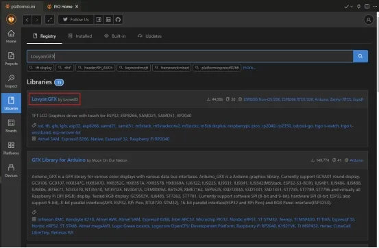

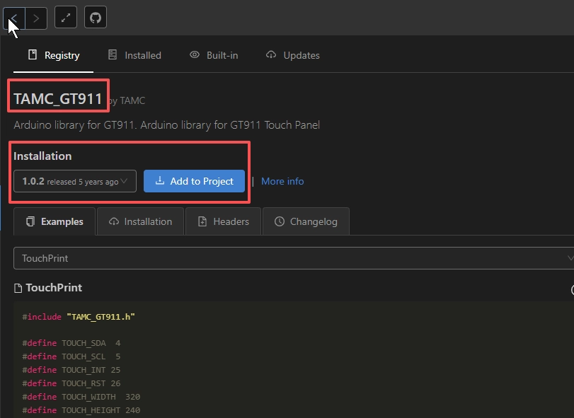

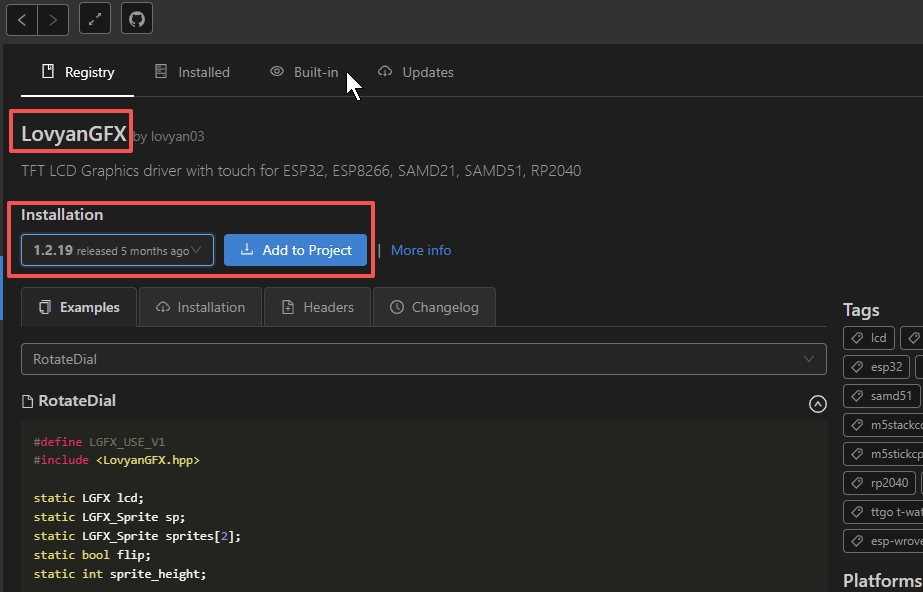

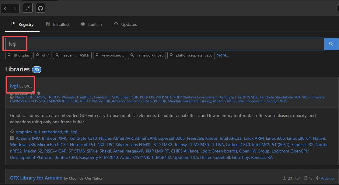

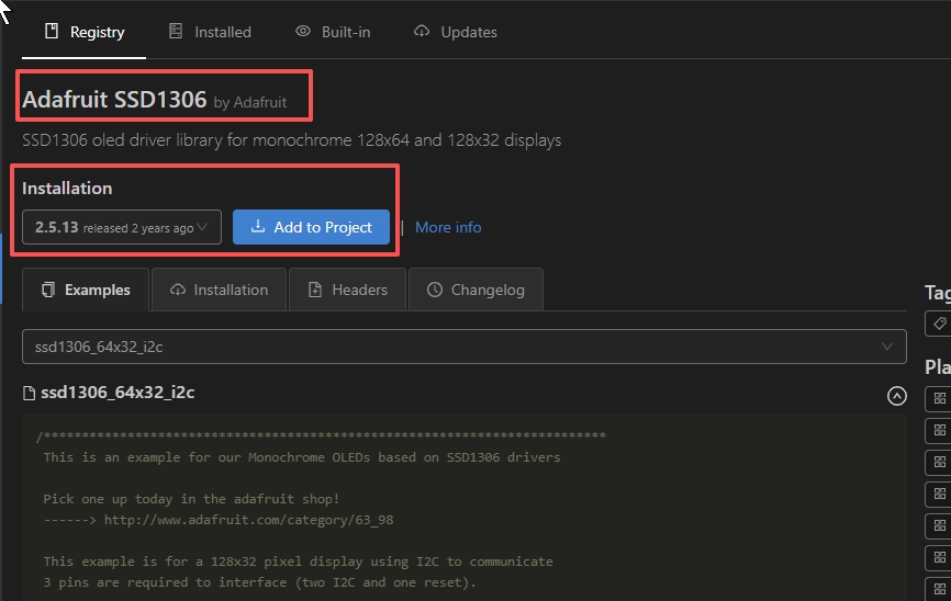

Click the PlatformIO icon, click ‘Libraries’, then search for the following libraries.
① Lvgl
② LovyanGFX
③ Adafruit SSD1306
④ TAMC_GT911
⑤ FT6336U

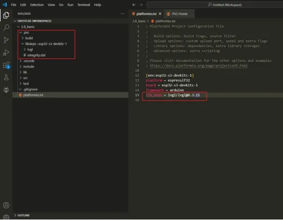

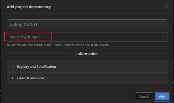

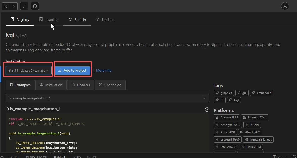

Click on the LVGL library.

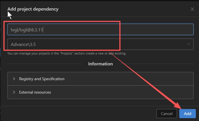

Select version 8.3.11 (which needs to correspond to the version selected when creating the project in SquareLine Studio), and click "Add to Project".
Select the corresponding project name and click "Add".

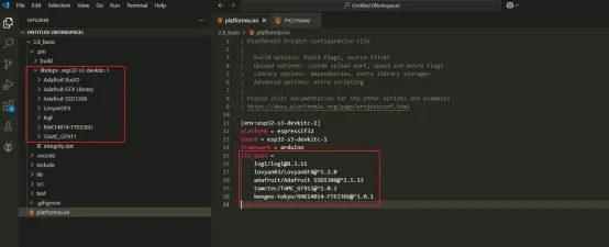

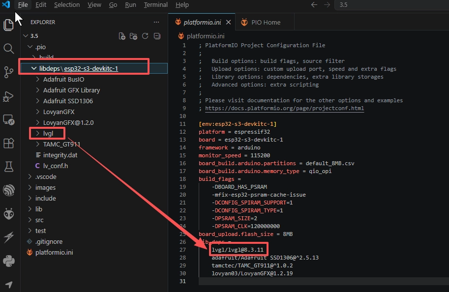

If the library is successfully added to the project, the interface will automatically jump to the PlatformIO.ini file and automatically generate the project dependencies.
Note: If the platformio.ini file remains unchanged, but the library that has just been added is present in the pio->libdeps->esp32-s3-devkitc-1 folder, then click on "Compile". The PlatformIO plugin will pop up a window prompting you to change the library dependency link in the platformio.ini file.
Repeat the above steps and add the remaining libraries one by one (just select the latest version by default for the library versions).
After all the required libraries have been added, the PlatformIO project will be as shown in the following figure.

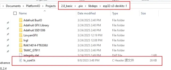

Place the lv_conf.h we provide to the path: .pio\libdeps\esp32-s3-devkitc-1-myboard in the project folder.

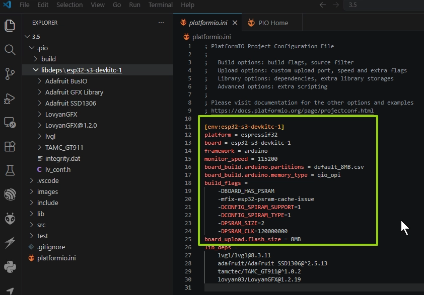

6.3 Add the chip configuration to the PlatformIO project
Open the platformio.ini file. This file is the configuration file of the PlatformIO project, which is used to define information such as the project's build environment, upload options, and library dependencies. Copy the following development board configuration into this file.
monitor_speed = 115200
board_build.arduino.partitions = default_8MB.csv
board_build.arduino.memory_type = qio_opi
build_flags =
​ -DBOARD_HAS_PSRAM
​ -mfix-esp32-psram-cache-issue
​ -DCONFIG_SPIRAM_SUPPORT=1
​ -DCONFIG_SPIRAM_TYPE=1
​ -DPSRAM_SIZE=2
​ -DPSRAM_CLK=120000000
board_upload.flash_size = 8MB

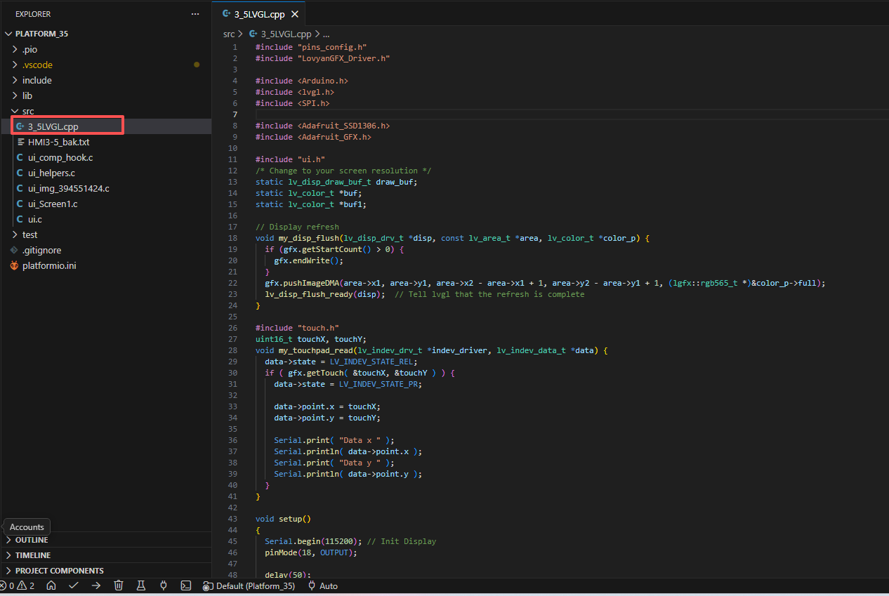

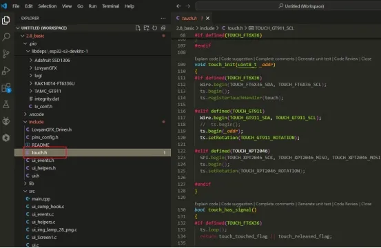

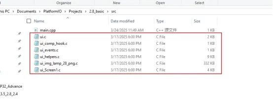

6.4 Add the necessary source files and header files to the PlatformIO project

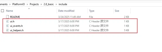

Find the UI source files and header files generated by SquareLine Studio.

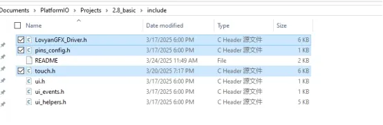

Copy the.c file in the UI file to the src folder of the PlatformIO project.
Copy the.h file in the UI file to the include folder of the PlatformIO project.

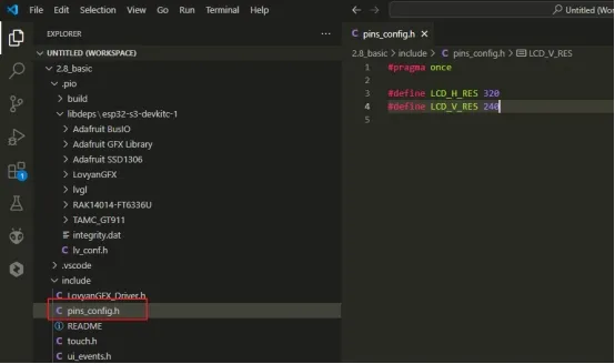

Similarly, add the display driver and pin definition header files to the include folder.

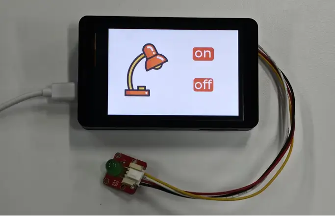

6.6 Burn the well-written PlatformIO project into the CrowPanel Advance ESP32 AI display

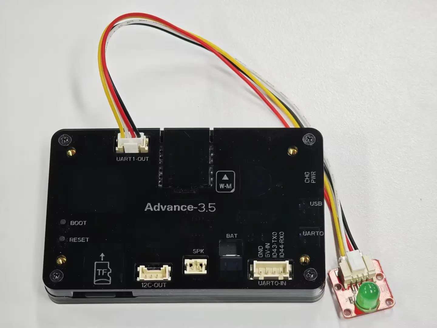

Connect the light bulb at the UART1 interface

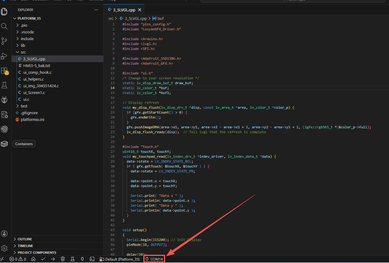

Select the corresponding serial port.

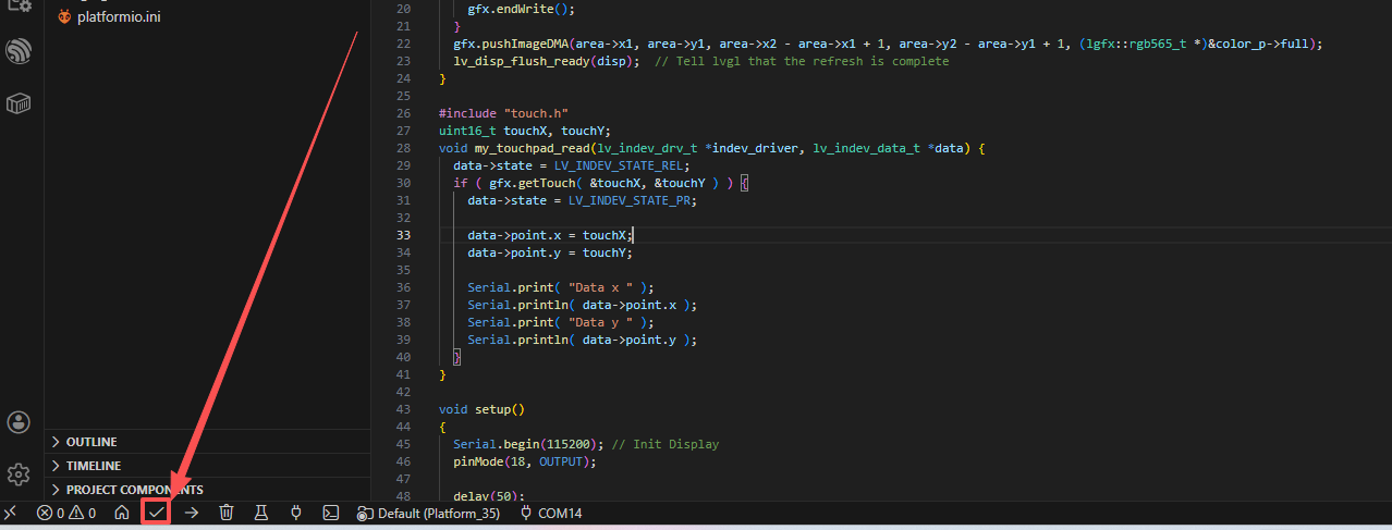

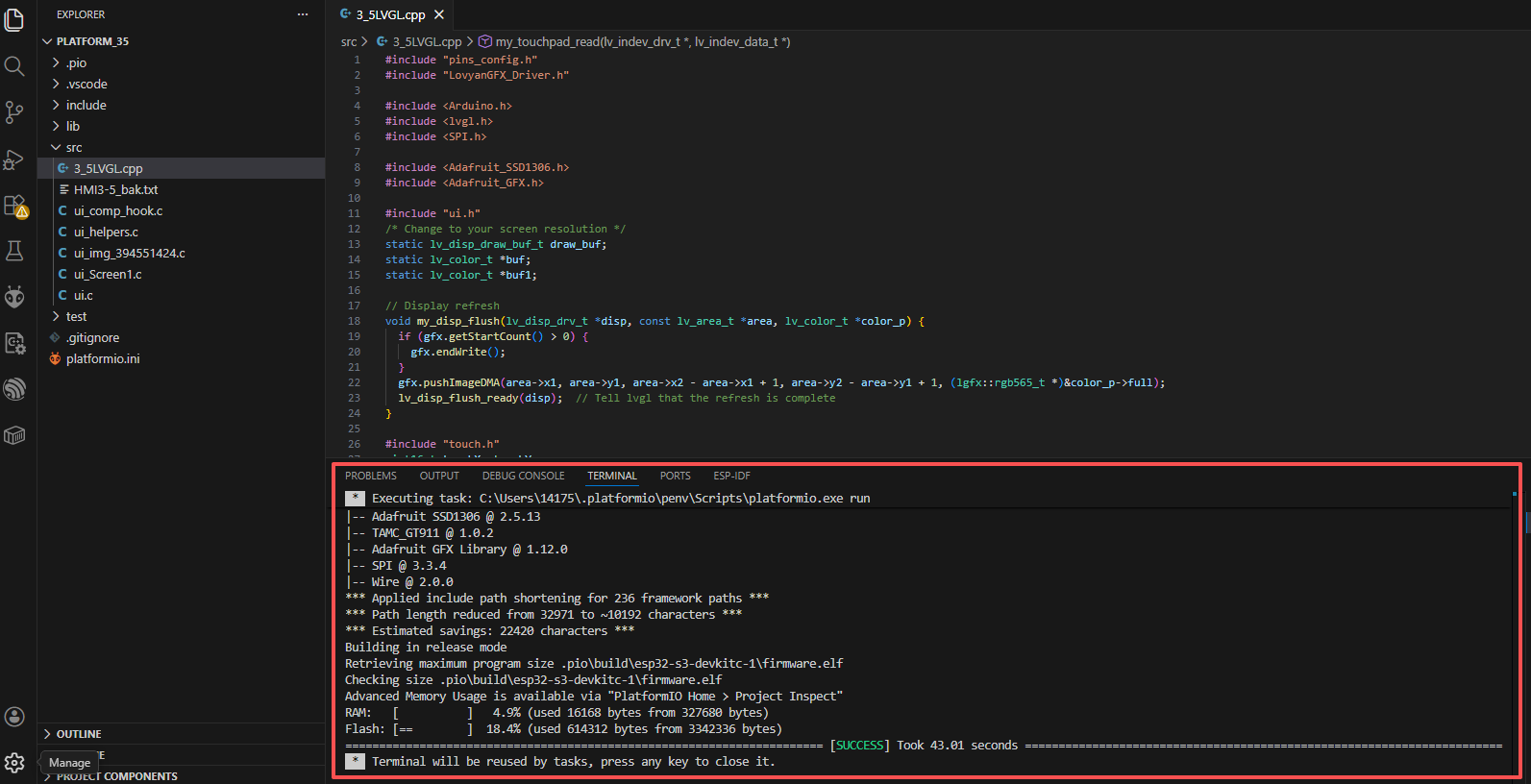

Click this button to build.
Wait for the compilation to be completed.

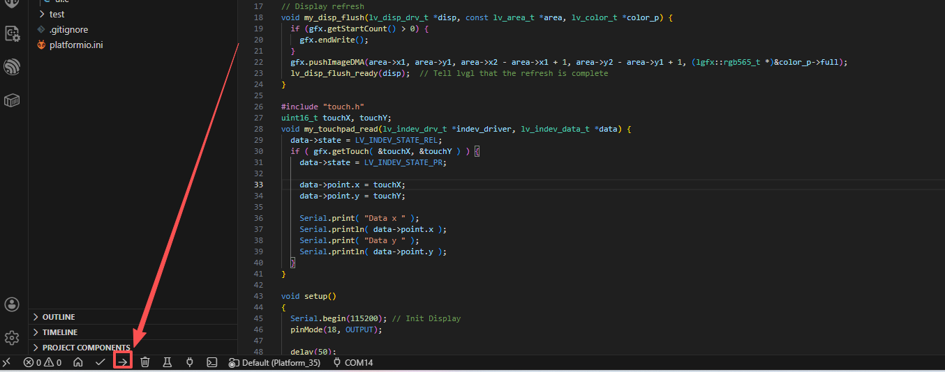

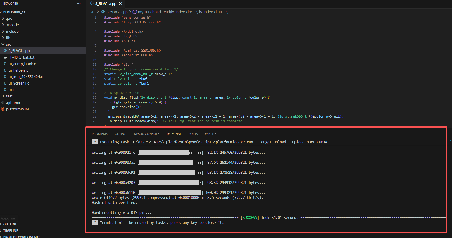

Click to burn.
Wait for the burning process to be completed.
So you can see the UI interface you just designed.
You can click the On and Off buttons to control the on/off of the lights
