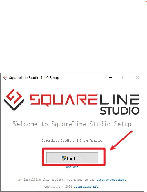

2.1 Installation Guide¶

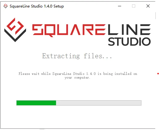

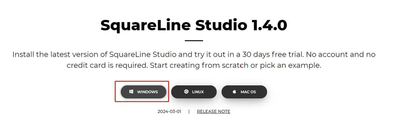

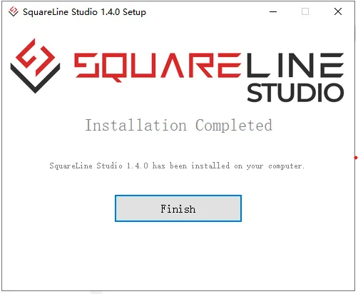

Download the version 1.4.0
Click install.
Wait for installation.
Installation finish.

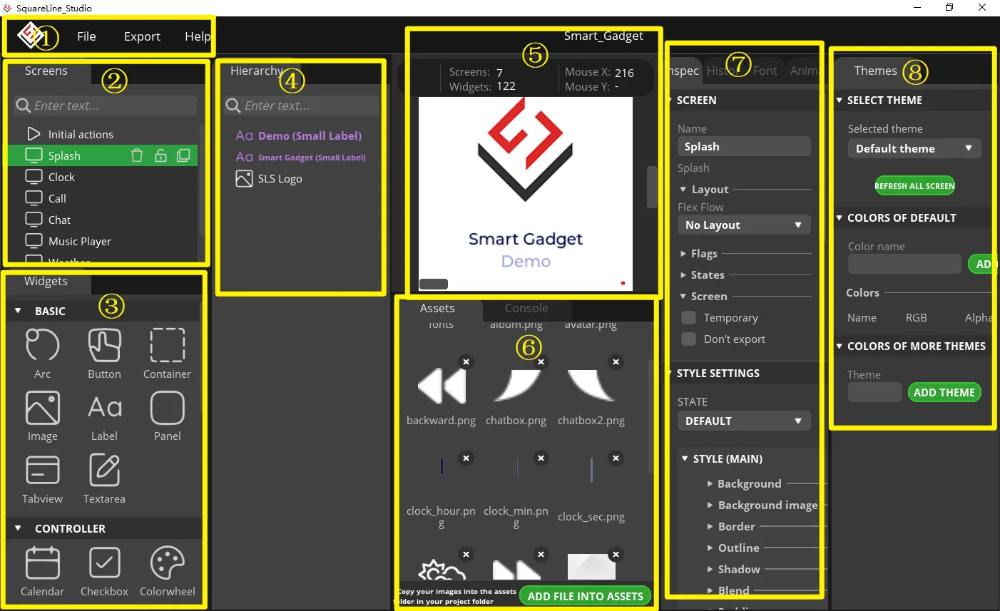

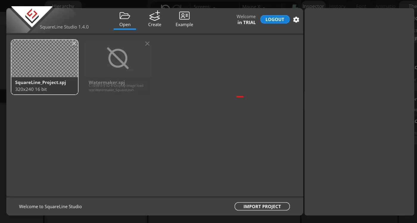

2.2 Software Function Introduction¶
Open the software

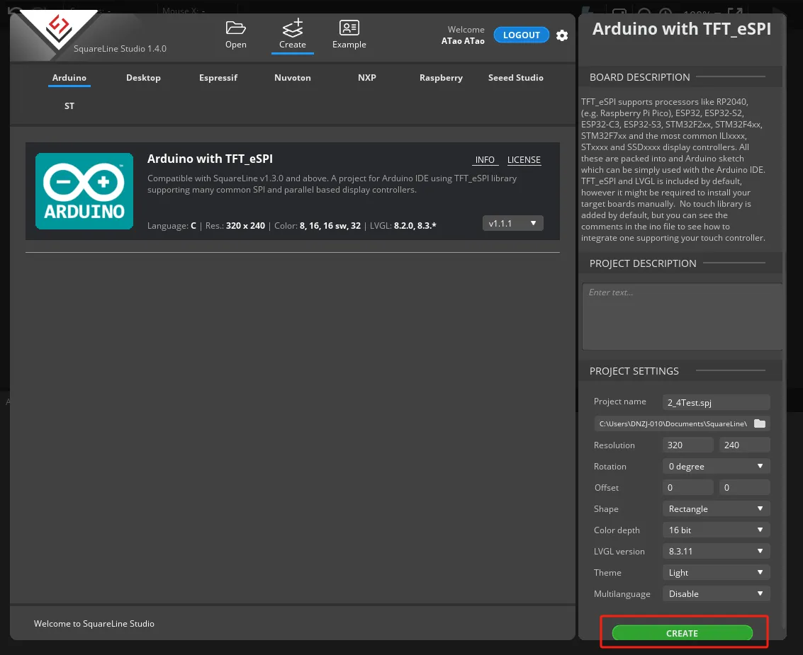

When select the Arduino framwork, there's only one option "Arduino with TFT_eSPI". By choosing this, the squareline studio will generate a template code suitable for the TFT_eSPI library. However, squareline studio not only supports the TFT_eSPI library, it supports a variety of libraries to suit different hardware and application needs. For example, Adafruit_GFX library, LovyanGFX etc.¶
After using SLS to generate UI code, we then use different graphics libraries according to different hardware and modify the corresponding code to display the content you design.¶
Note: Please select the corresponding resolution and color depth according to the screen specifications.¶
①Toolbar, including File, Export, and Help. Basic file operation bar, create or open files, export UI files and other operations. Click help and there are related introductory documents.¶
②Screen bar, the project screen will be listed here.¶
③Widget area, all widgets are here and can be selected and used according to project needs.¶
④Hierarchy area, it will show every widget used in each screen.¶
⑤This area shows the actual display effect, you can adjust the widgets or screen here.¶
⑥Material column, the added materials are displayed here.¶
⑦Setting bar, where you can make basic settings for each part, including the basic attributes and trigger operations of the part.¶
⑧Theme bar, different themes can be set.¶

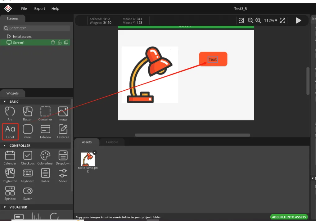

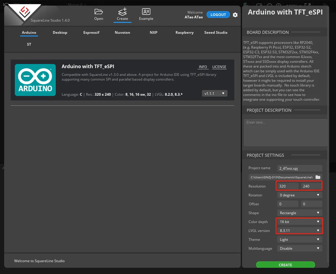

3 Use SquareLine Studio to create UI control interfaces¶
Here, I take a 2.4-inch screen as an example. After determining the resolution, I fill it in
Table_lamp image sizes are available for 3.5-inch, 4.3-inch, 5.0-inch, and 7-inch screens.

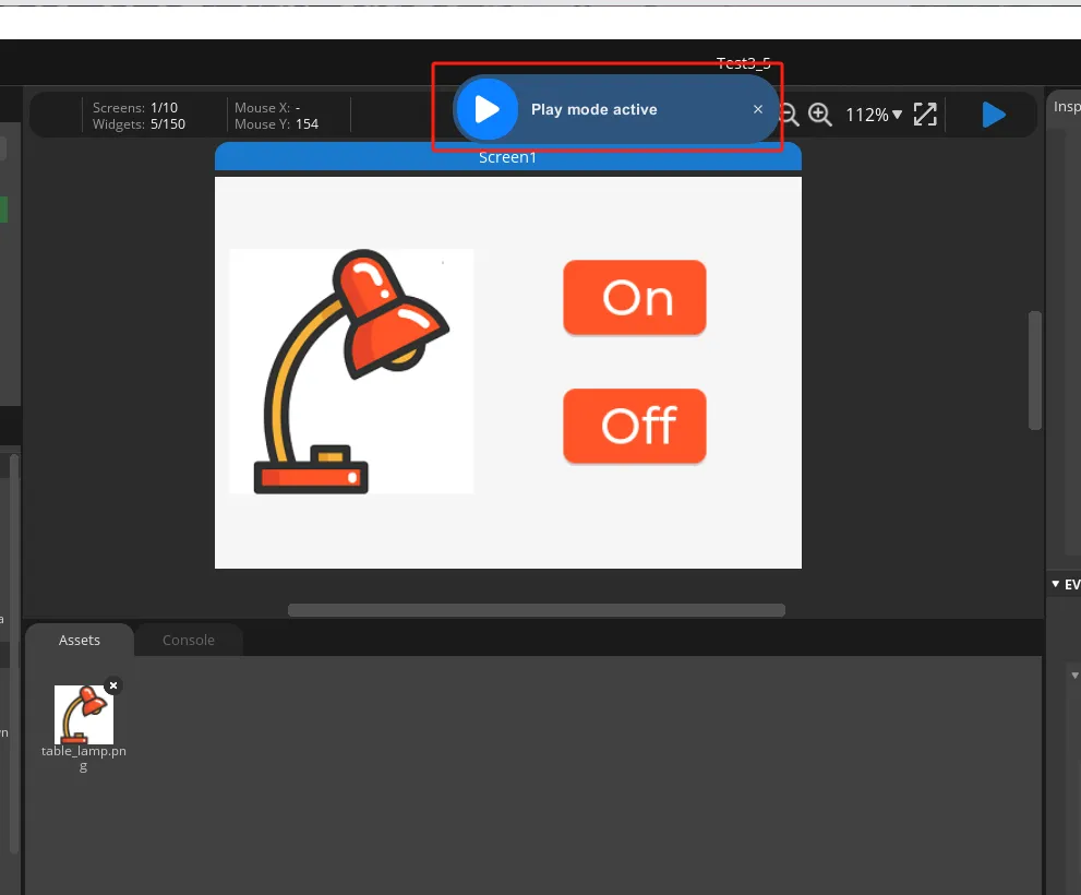

4 Add functions to the buttons to enable them to turn on and off lights¶
Select 'event' to add in the right sidebar
After selecting, click ADD.
After adding, run

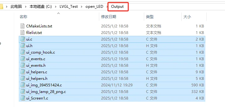

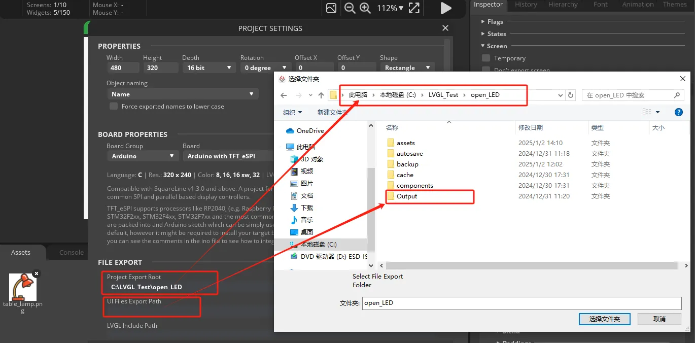

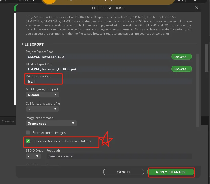

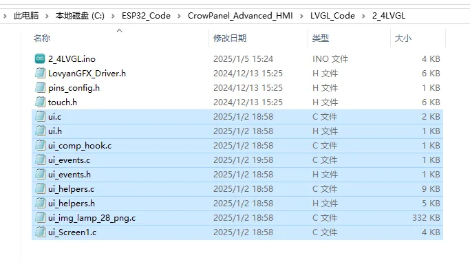

5 UI interface design completed, exporting UI files for easy use in subsequent code¶
Click on Project Setting
Set export path
Complete the setup and export file

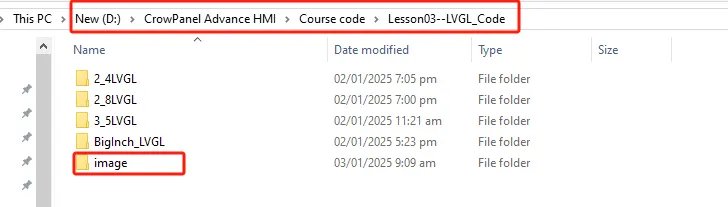

Copy and paste the exported code into the code folder we need to open
Then double-click 2_4LVGL.ino and open it using Arduino IDE

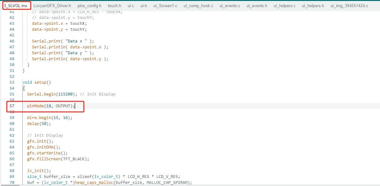

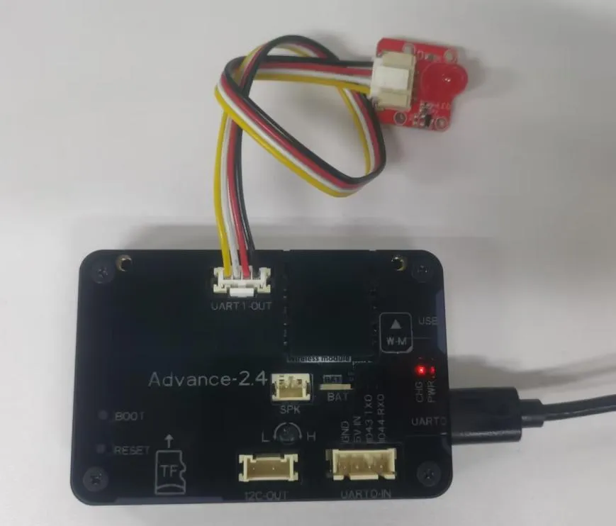

6 Connect the light bulb and add code to control the light bulb to turn on and off¶

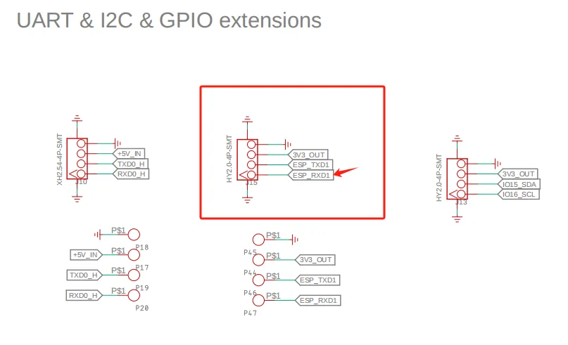

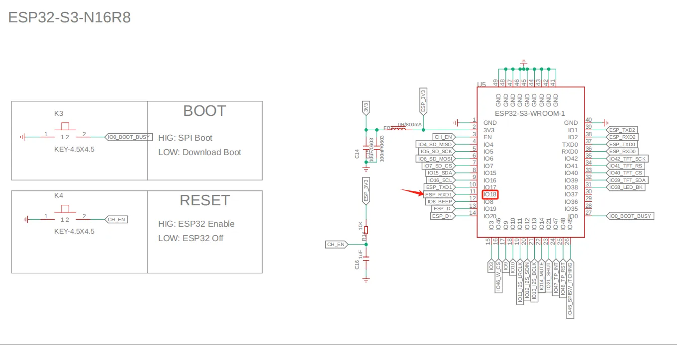

Connect the light bulb at the UART1 interface
Observing the schematic diagram of this size, it is known that the pin for UART1 to control the light bulb to turn on and off is 18
So in the code, set pin 18 as the output mode.
A large-sized screen requires setting 19 pins as the output mode.
The code for size 2.4 is the same as the code for size 3.5, only the UI display file configured is different

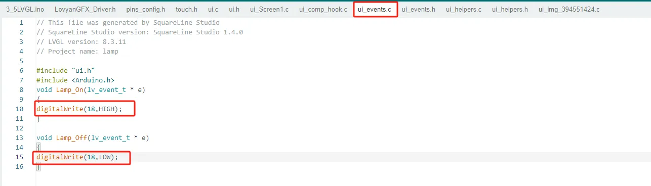

And add the function of turning on and off the light bulb in the ui_ event. c file.
(When the On button is clicked, the light is on; when the Off button is clicked, the light is off)

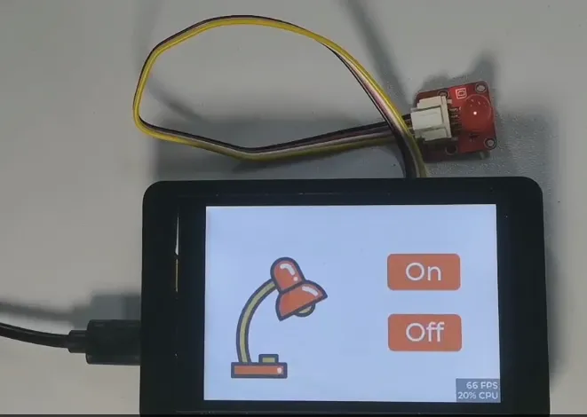

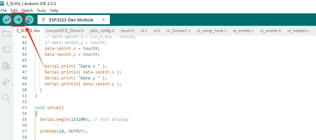

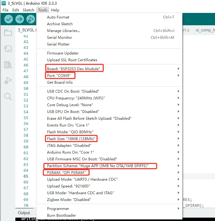

7 Configure the code running environment and upload the code¶
(!! Before uploading the code, please use different library files according to the size you are using. You can review the content of Lesson 2)
(For large-sized screens of 4.3 inches, 5.0 inches, and 7.0 inches, be sure to switch the mode to 0 1 state before uploading the code, because the pins of UART1 and W-M mode are both used in 0 1 mode, so that you can use the pins of UART1)

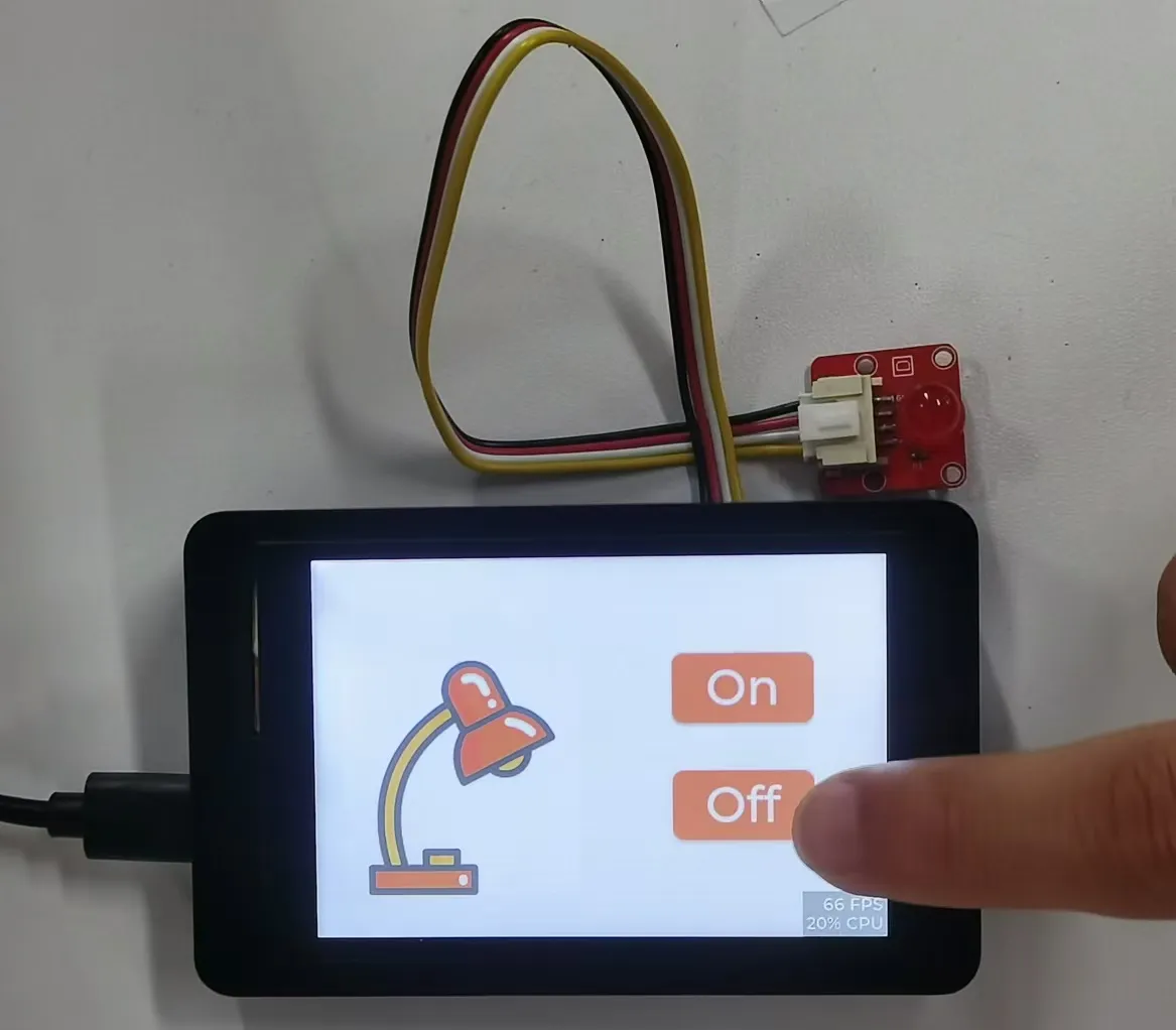

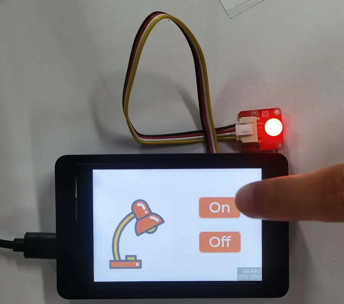

So you can see the UI interface you just designed
You can click the On and Off buttons to control the on/off of the lights
