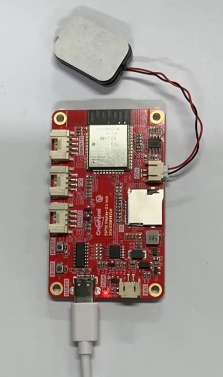

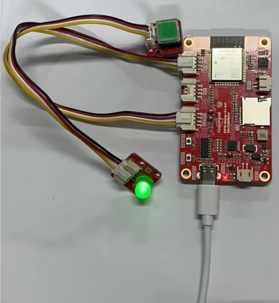

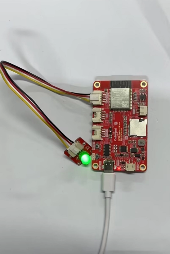

| CrowPanel ESP32 2.4'' HMI | Crowtail-DHT20 | Crowtail-LED |

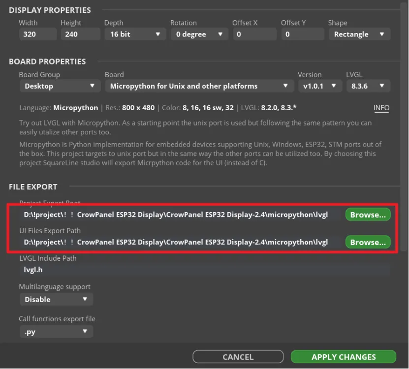

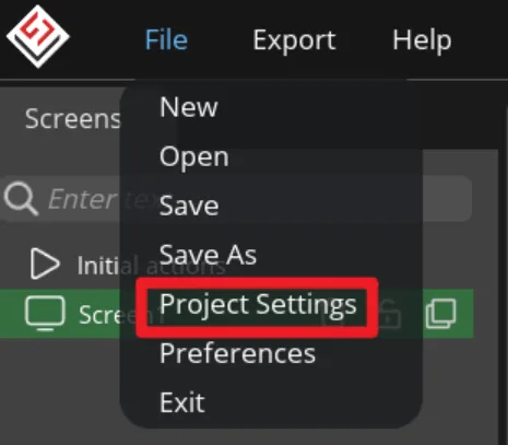

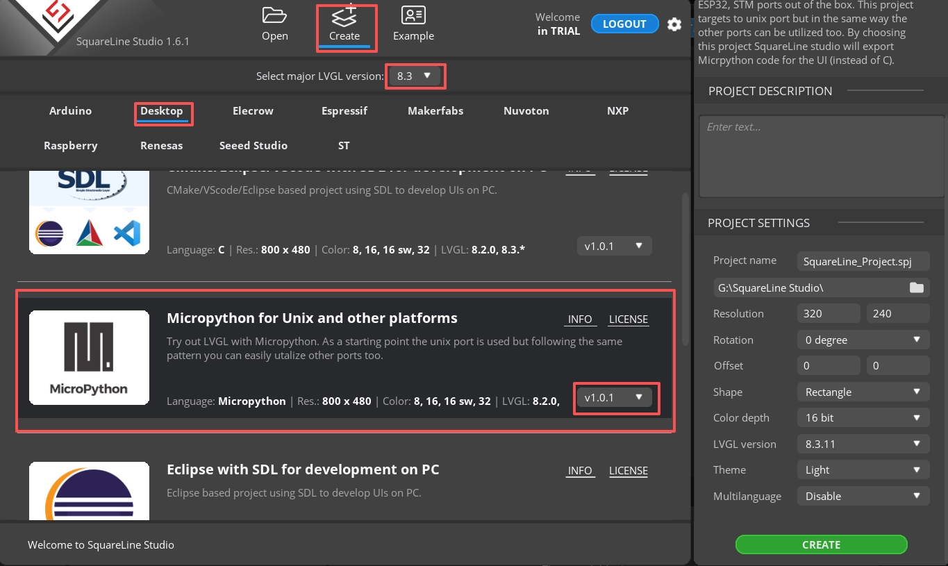

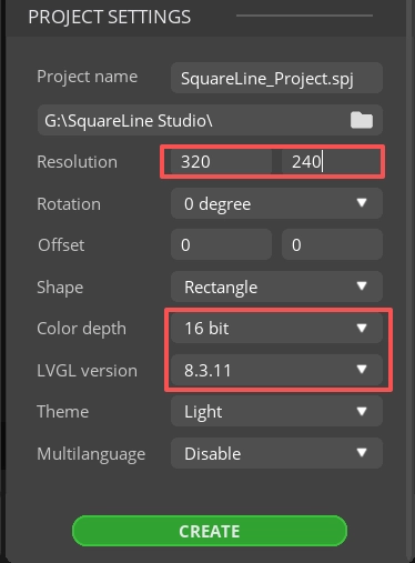

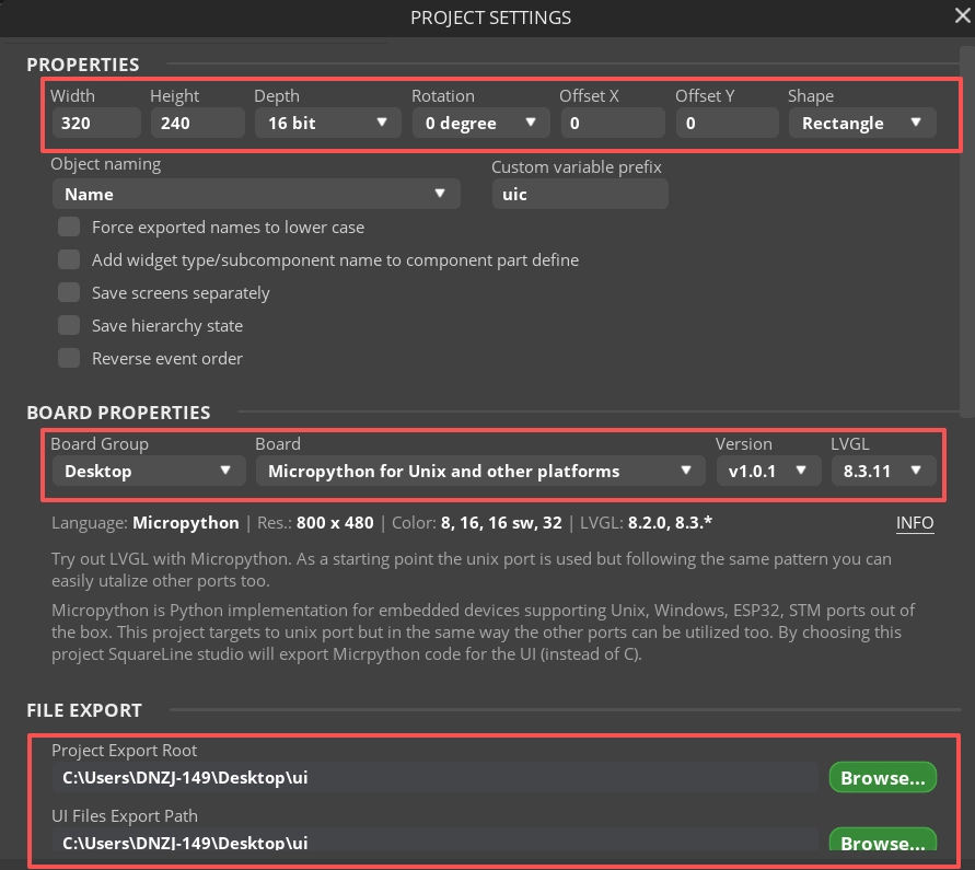

Open the SquareLine Studio and create a project. Select "Desktop"->"Micropython for Unix and other platform".
Set the name of the project, set the screen resolution to 320*240, set the color depth to 16bit, and keep other default settings. After setting, click CREATE to create the project.

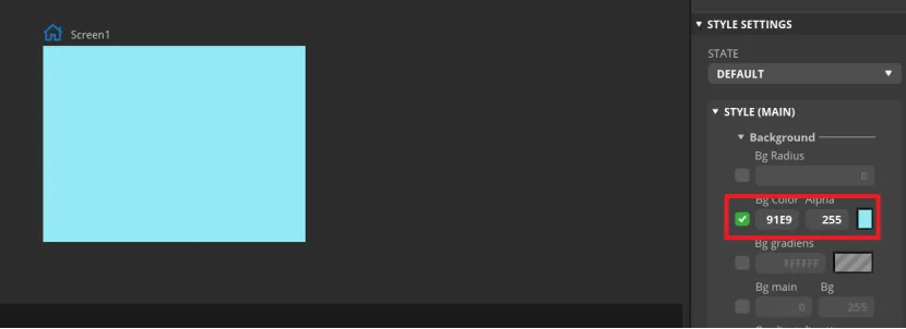

Add background.
Find "Inspector"->"STYLE SETTING", click to expand "STYLE(MAIN)", then click the 1st "Background". Check the "Bg ColorAlpha" and set the backgroud color.

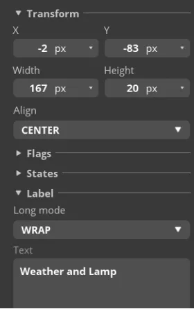

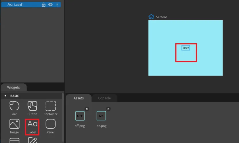

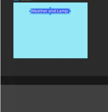

Add Label widget
The content, position and size of the label can be adjusted by dragging the mouse. You can also directly enter numbers in the Inspector→LABEL→Transform to adjust. You can set the font color and other attributes in STYLE SETTING→STYLE(MAIN).
Modify the text of Label1 as the title of the screen.

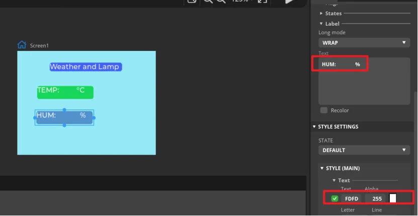

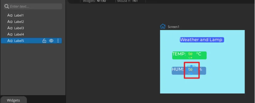

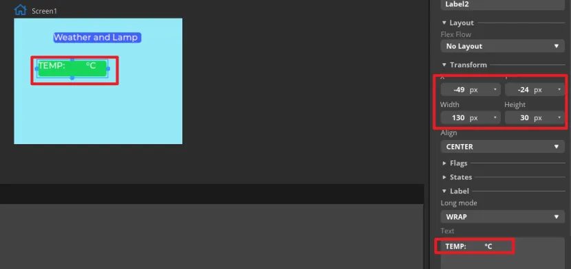

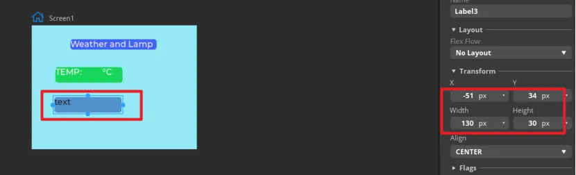

Add Label2 and Label3 as labels for temperature and humidity in the same way.

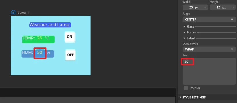

Add Label4 and Label5 to display the values of temperature and humidity

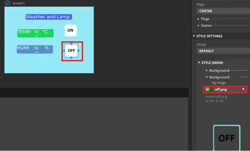

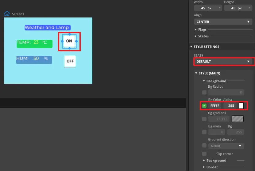

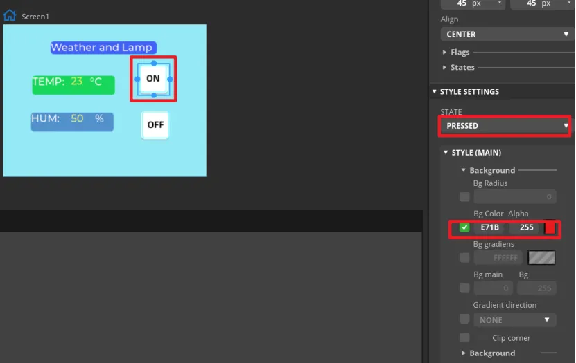

After all Labels are added, you can set the default display value of the Label.

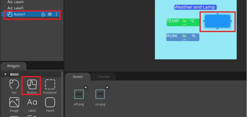

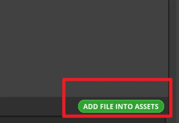

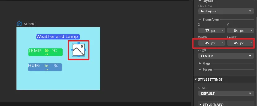

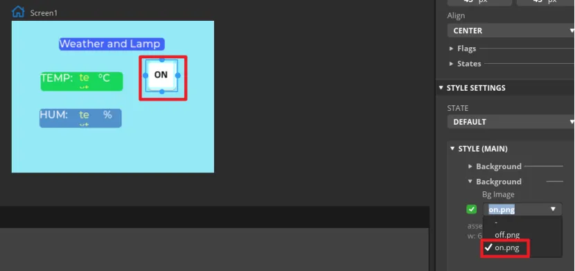

If you there are no pictures available, please click "ADD FILE TO ASSETS" to add custom images or icons in the "Assets" area.
Please click
to download the custom images for the button.Because UI files require a large amount of memory when running in Thonny IDE, the UI main page background in this tutorial does not use images to avoid being unable to run.

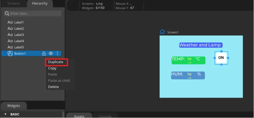

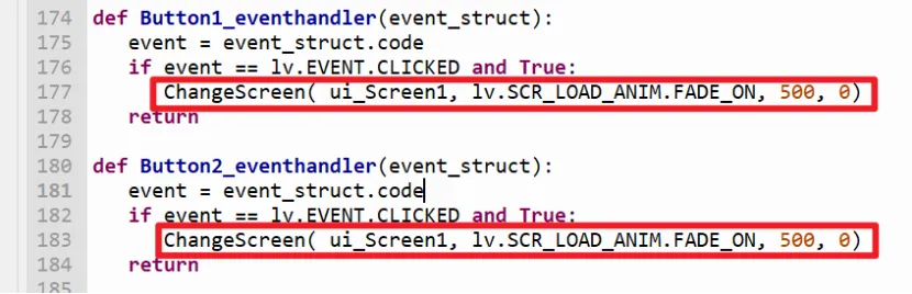

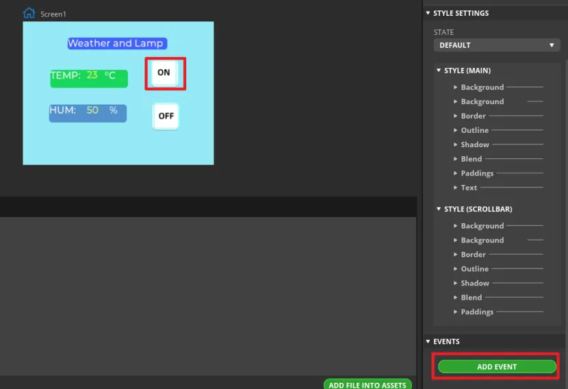

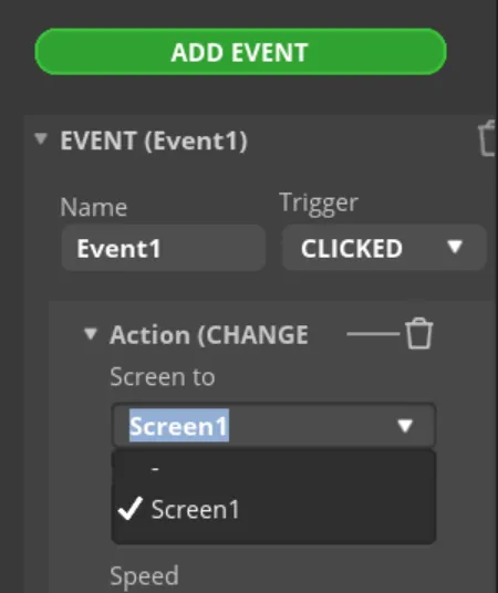

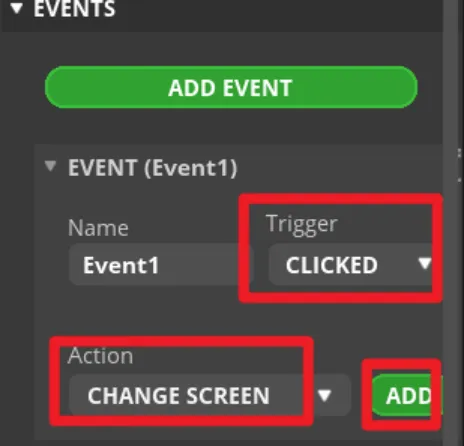

Add events to buttons.

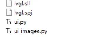

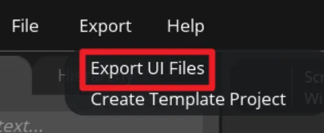

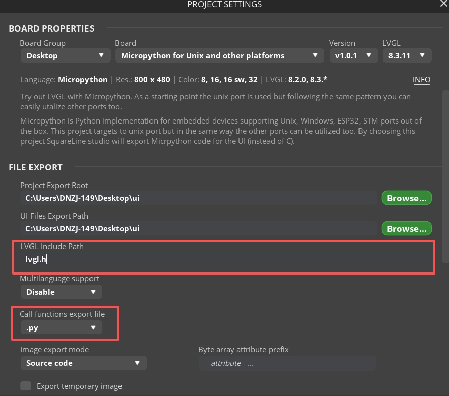

Export UI files.
Then click "APPLY CHANGES".
The UI file export is completed. Next we're going to learn about the main program and learn how to upload the code to the board with Thonny IDE.

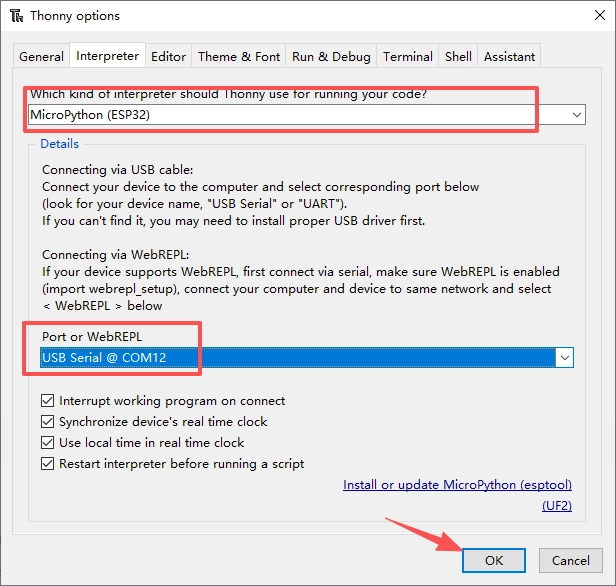

Connect the CrowPanel ESP32 HMI with your computer.

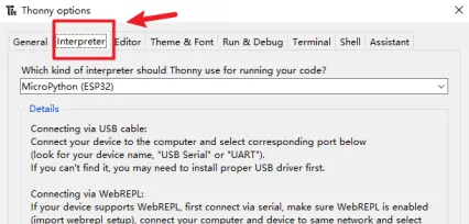

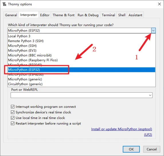

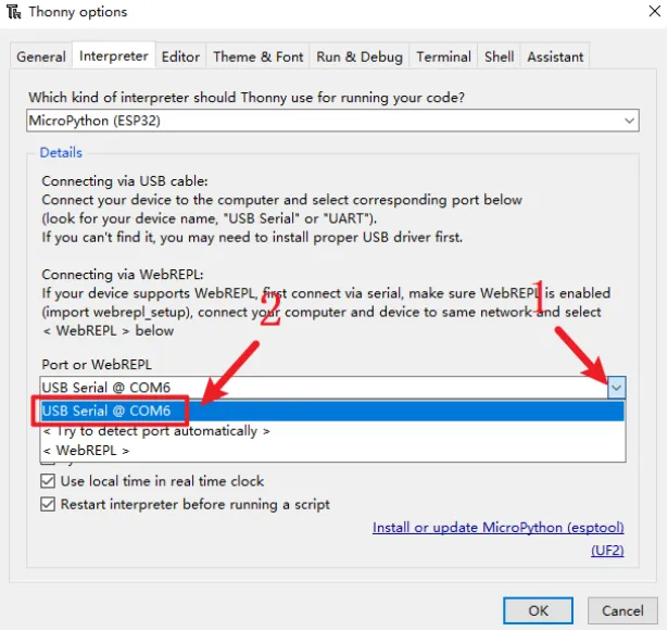

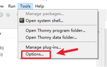

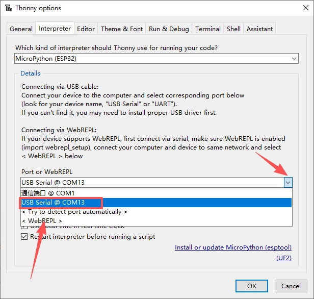

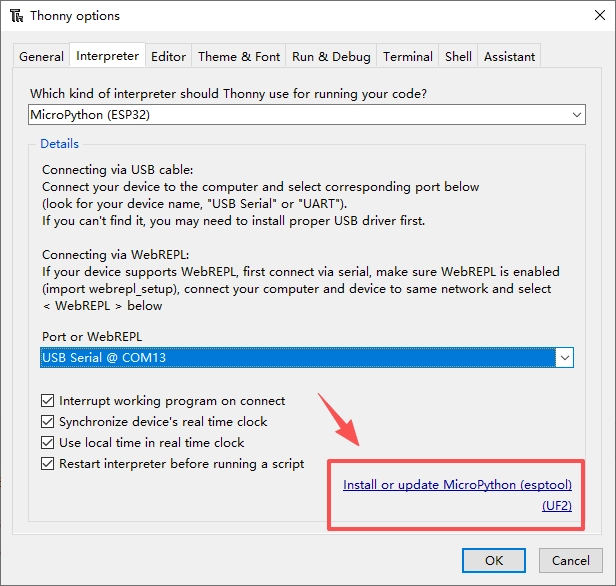

Open Thonny IDE and click "Tools"->"Options"->"Interpreter".
Select "MicroPython(ESP32)" for interpreter.
Select the corresponding serial port(or Try to detect port automatically).

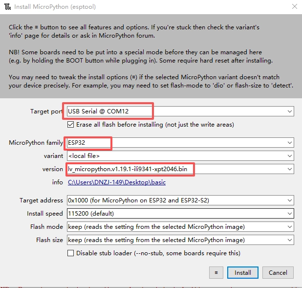

Click "Install or update MicroPython (esptool)"

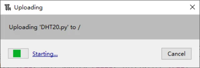

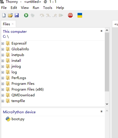

Click the icon with 3 lines, and click "select local MicroPython image...".Select the "lv_micropython.v1.19.1-ili9341-xpt2046.bin" and install.
Waiting for downloading...

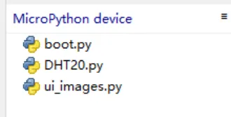

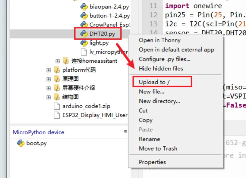

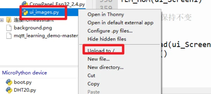

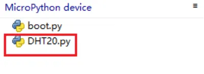

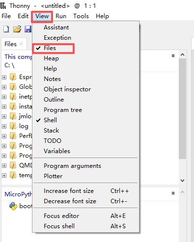

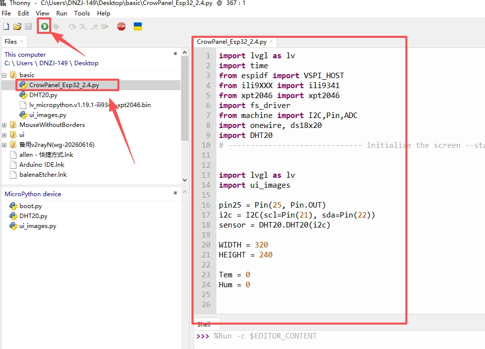

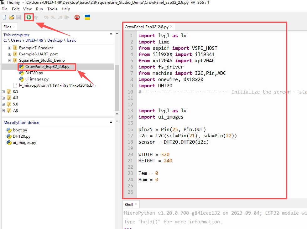

Edit the code¶
Please click
to download the code file and libraries.
import lvgl as lv

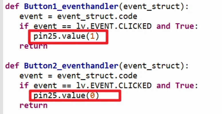

def Button1_eventhandler(event_struct):
event = event_struct.code
if event == lv.EVENT.CLICKED and True:
pin25.value(1)
return
def Button2_eventhandler(event_struct):
pin25.value(0)
return

ui_Button1 = lv.btn(ui_Screen1)
ui_Button1.set_width(45)
ui_Button1.set_height(45)
ui_Button1.set_x(77)
ui_Button1.set_y(-34)
ui_Button1.set_align( lv.ALIGN.CENTER)
SetFlag(ui_Button1, lv.obj.FLAG.SCROLLABLE, False)
SetFlag(ui_Button1, lv.obj.FLAG.SCROLL_ON_FOCUS, True)
ui_Button1.set_style_bg_color(lv.color_hex(0xFFFFFF), lv.PART.MAIN | lv.STATE.DEFAULT )
ui_Button1.set_style_bg_opa(255, lv.PART.MAIN| lv.STATE.DEFAULT )
ui_Button1.set_style_bg_img_src( ui_images.ui_img_on_webp, lv.PART.MAIN | lv.STATE.DEFAULT )
ui_Button1.set_style_bg_color(lv.color_hex(0xE71B1B), lv.PART.MAIN | lv.STATE.PRESSED )
ui_Button1.set_style_bg_opa(255, lv.PART.MAIN| lv.STATE.PRESSED )
ui_Button1.add_event_cb(Button1_eventhandler, lv.EVENT.ALL, None)
ui_Button2 = lv.btn(ui_Screen1)
ui_Button2.set_width(45)
ui_Button2.set_height(45)
ui_Button2.set_x(79)
ui_Button2.set_y(38)
ui_Button2.set_align( lv.ALIGN.CENTER)
SetFlag(ui_Button2, lv.obj.FLAG.SCROLLABLE, False)
SetFlag(ui_Button2, lv.obj.FLAG.SCROLL_ON_FOCUS, True)
ui_Button2.set_style_bg_color(lv.color_hex(0xFFFFFF), lv.PART.MAIN | lv.STATE.DEFAULT )
ui_Button2.set_style_bg_opa(255, lv.PART.MAIN| lv.STATE.DEFAULT )
ui_Button2.set_style_bg_img_src( ui_images.ui_img_off_webp, lv.PART.MAIN | lv.STATE.DEFAULT )
ui_Button2.set_style_bg_color(lv.color_hex(0xBAB3B3), lv.PART.MAIN | lv.STATE.PRESSED )
ui_Button2.set_style_bg_opa(255, lv.PART.MAIN| lv.STATE.PRESSED )
ui_Button2.add_event_cb(Button2_eventhandler, lv.EVENT.ALL, None)

This part copies the code of ui.py generated by Squareline Studio. We need to modify the part that control the button.
From
to

Upload the code¶
Please click
Upload the libraries¶
DHT20
In the upper left corner of the thonny, enter the path where DHT20.py is located, right-click DHR20.py, and click Upload to/
Waiting for uploading
The DHT20.py will be added to the MicroPython device column.
ui_image.py
In the upper left corner of the thonny, enter the path where ui_image.py is located, right-click ui_image.py, and click Upload to/
ui_image.py is added to MicroPython device successfully.

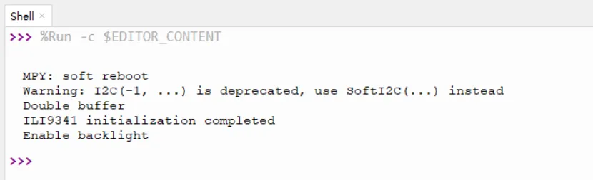

Upload the code¶
Click the "run" icon.
Successfully uploaded.

Example 1 Turn on/off the LED in a loop¶
Connect an LED module to the D port(pin25) of ESP32 2.4'' HMI, and upload the following code. The LED will turn on and off in a loop.
#Make by Elecrow
#Web:www.elecrow.com
import time
from machine import Pin
pin25 = Pin(25, Pin.OUT)
while True:
pin25.value(1)
time.sleep(0.5)
pin25.value(0)
time.sleep(0.5)
Example 2 Turn on/off the LED with a button¶
Connect an LED module to the D port(pin25), and connect a button to the UART_1 port(pin16). Upload the following code, then you can control the LED on/off by pressing the button.
import time
led = Pin(25, Pin.OUT)
button = Pin(16, Pin.IN, Pin.PULL_UP)
led.value(0)
while True:
if not button.value():
led.value(1)
else:
led.value(0)
time.sleep(0.1)

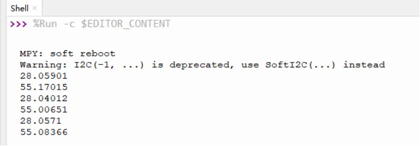

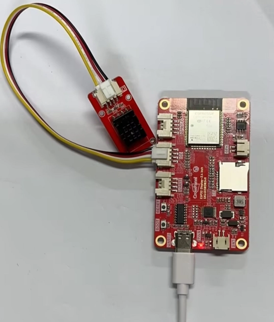

Example 3 Obtain temperature and humidity value¶
Plug DHT20 module to the IIC port. Add DHT20.py to the device(check the method in "Upload the libraries" section.) and upload the code below, the value of temperature and humidity will be printed.
import time
import DHT20
from machine import I2C, Pin
i2c = I2C(scl=Pin(21), sda=Pin(22))
sensor = DHT20.DHT20(i2c)
while True:
sensor.read_dht20()
print(sensor.dht20_temperature())
print(sensor.dht20_humidity())
time.sleep_ms(4000)

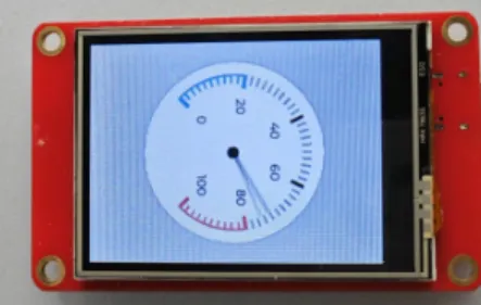

Example 4 Show dial plate on the screen¶
Upload the following code to the module, there will be a dial plate show on the screen.

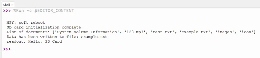

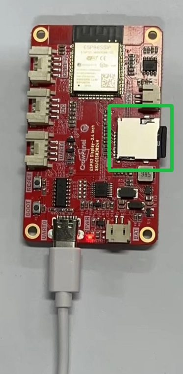

Example 6 Initialize SD card¶
Upload the following code to ESP32 HMI
import machine
import os
import sdcard
import uos
# SD Card Initialization
def init_sd():
# Creating SPI Objects
spi = machine.SPI(2, baudrate=1000000, polarity=0, phase=0, sck=machine.Pin(18), mosi=machine.Pin(23), miso=machine.Pin(19))
cs = machine.Pin(5, machine.Pin.OUT)
sd = sdcard.SDCard(spi, cs)
vfs = uos.VfsFat(sd)
uos.mount(vfs, "/sd")
print("SD card initialization complete")
print("List of documents:", os.listdir("/sd"))
# write to a file
def write_file(filename, data):
with open("/sd/" + filename, "w") as file:
file.write(data)
print("Data has been written to file:", filename)
# Read file
def read_file(filename):
with open("/sd/" + filename, "r") as file:
data = file.read()
print("readout:", data)
return data
# Example: Initialize SD card and read/write files
def main():
init_sd()
filename = "example.txt"
data = "Hello, SD Card!"
read_file(filename)
if __name__ == "__main__":
main()
Running result:
Example 7 Playing music¶
Connect a speaker to the ESP32 HMI. Upload the following code. ESP32 HMI will play the song 'Twinkle Twinkle Little Star'.
