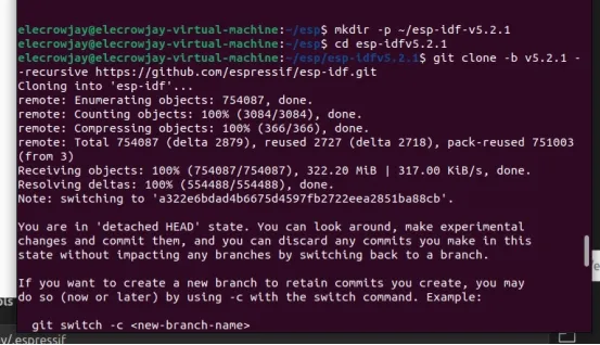

Step6:Pull the version idfv5.2.1.
Create a new folder.
Enter the command line in the terminal and clone the IDF of version v5.2.1 into this folder.
