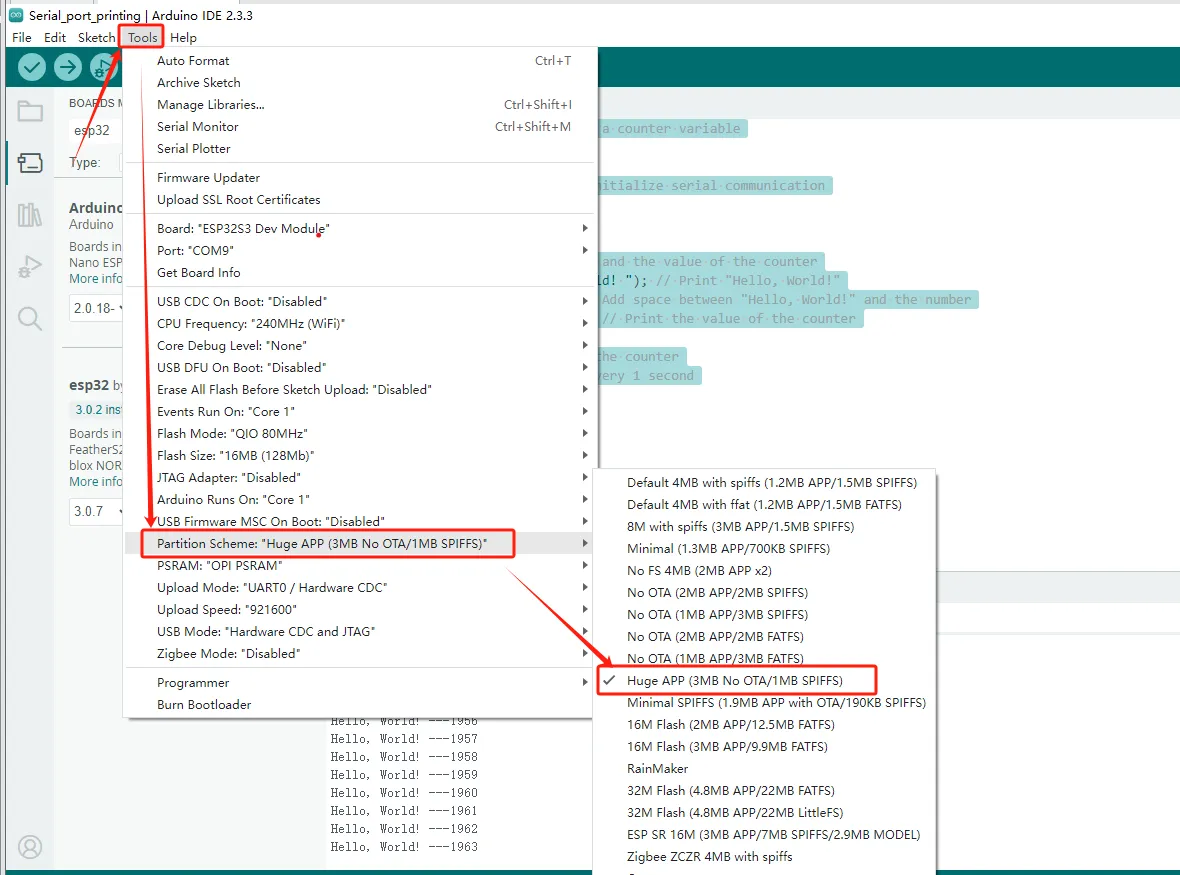

3.5 Configure the burning environment
3.5.1 Select development board
Path:Tools->Board->esp32->ESP32S3 Dev Module
3.5.2 Select Flash Size
Path:Tools->Flash Size->16MB(128Mb)
3.5.3 Select Partition Scheme
Path:Tools->Partition Scheme->Huge APP (3MB No OTA/1MB SPIFFS)
3.5.4 Select PSRAM
Path:Tools->PSRAM->OPI PSRAM
3.5.5 Finally, choose the serial port number you are using
Path:Tools->Port->(The port number you are using yourself)
3.6 Burn code
3.7 Wait for the burning to complete, open the serial port tool, and observe that Hello World is printed every second
