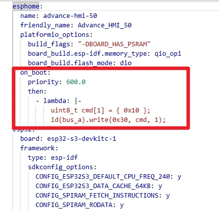

1 Screen backlighting¶
The new version (7" version 1.2; 5" and 4.3" version 1.1) has updated the backlight control from the original. The backlight in version 1.2 is controlled by the STC8H1K28 microcontroller, and the program lights the backlight by sending values to the address of this microcontroller (0x30). These values are 0x05, 0x06, 0x07, 0x08, 0x09, 0x10, where 0x05 is to turn off the backlight and 0x10 is the maximum brightness.

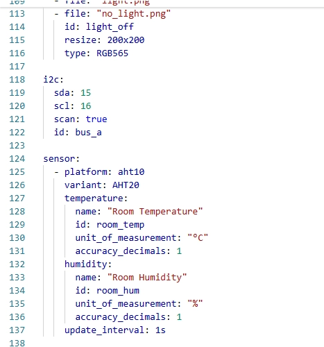

5 DHT20 Temperature and Humidity Sensor¶
Here, we initialize the temperature and humidity sensor connected to pins 15 and 16.
We also initialize the DHT20 temperature and humidity sensor.

7 Value Update¶
At the end, set the update time for the temperature and humidity values (refresh every second).
