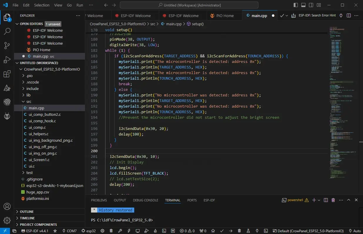

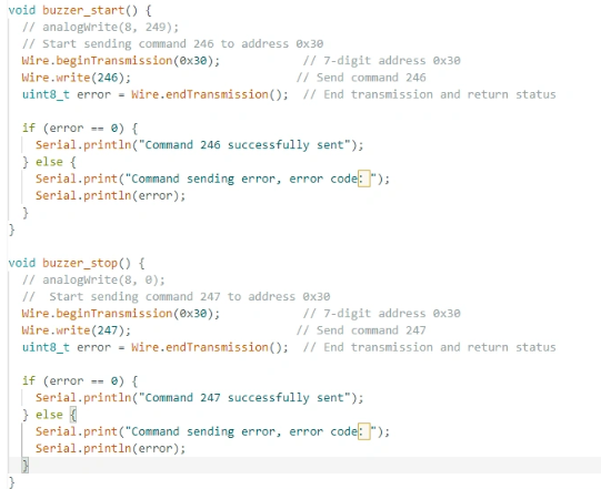

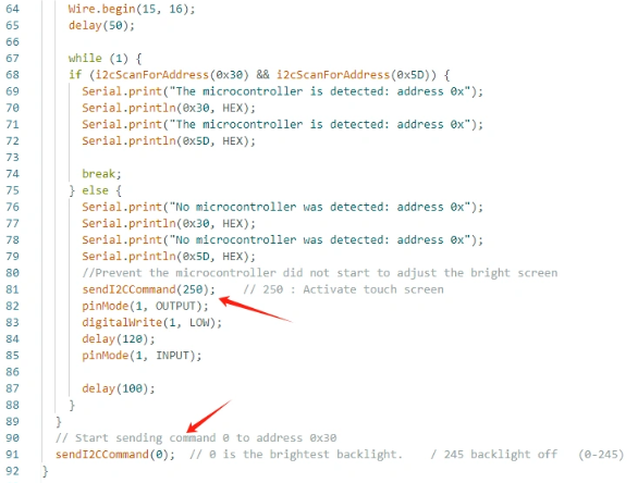

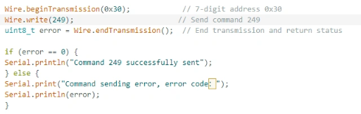

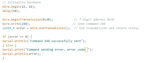

Version 1.1/1.2 Key Points.

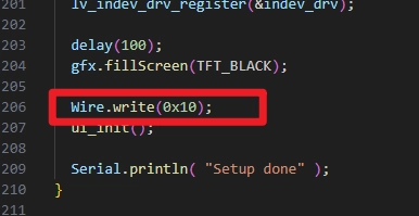

Version 1.1/1.2 updated the control of backlight on the basis of the original, the backlight of version 1.1/1.2 is controlled by STC8H1K28 microcontroller, and the backlight is lit in the program by sending the value to this microcontroller address (0x30). The values are 0x05, 0x06, 0x07, 0x08, 0x09 and 0x10, where 0x05 switches off the backlight and 0x10 is the maximum brightness.
When the main program is running, you need to query the i2c address all the time to prevent the microcontroller from not starting to adjust the bright screen.
advance 7.0 1.2
Send 0x10 in the main program to light up the screen backlight.
ced

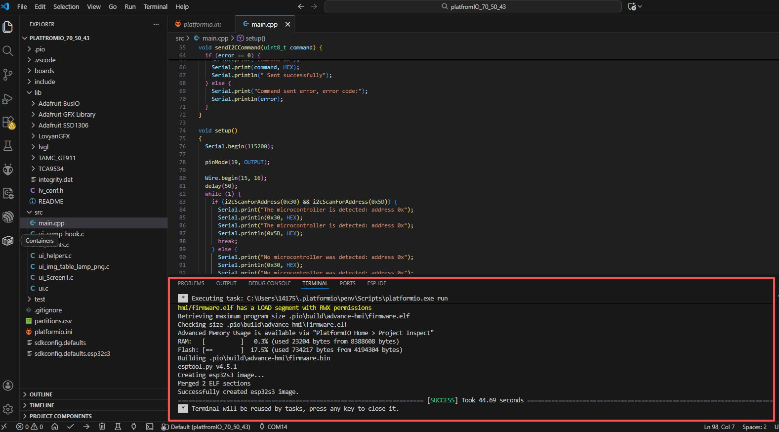

6.6 Burn the well-written PlatformIO project into the CrowPanel Advance ESP32 AI display

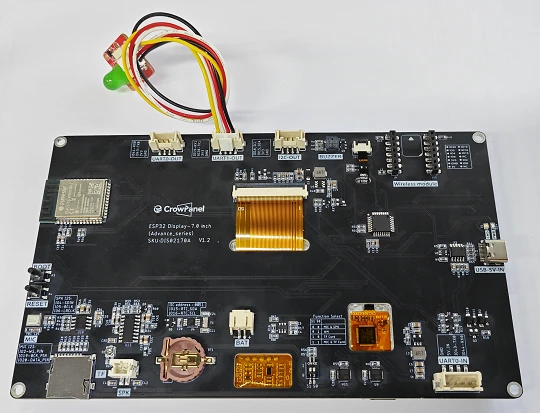

Connect the light bulb at the UART1-OUT interface
UART1-OUT-interface

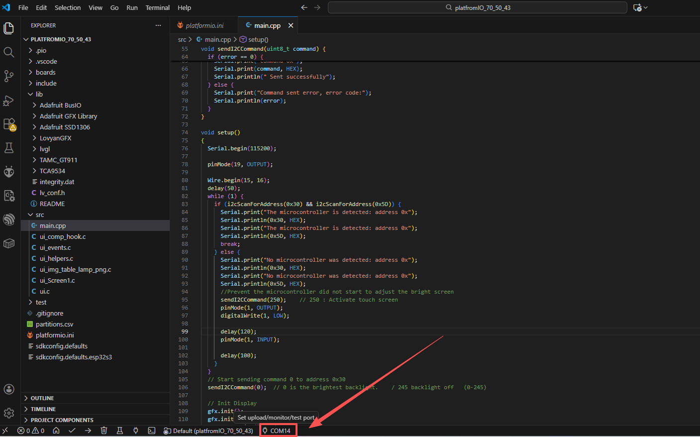

Select the corresponding serial port.

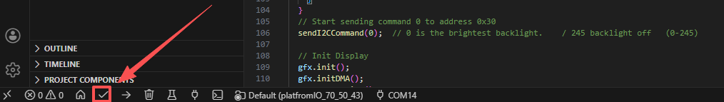

Click this button to build.
Wait for the compilation to be completed.

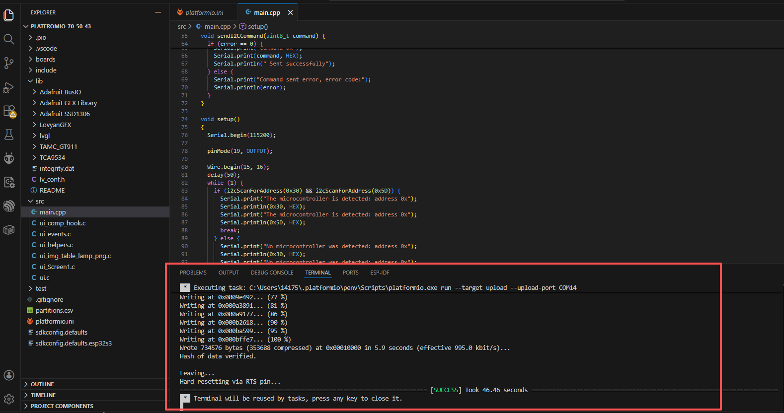

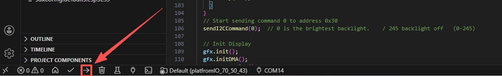

Click to burn.
Wait for the burning process to be completed.

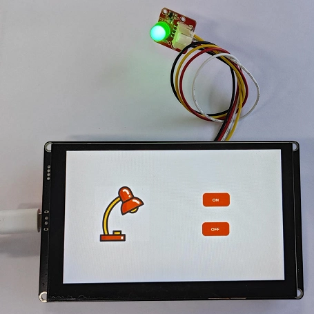

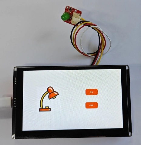

So you can see the UI interface you just designed.
UI interface
You can click the On and Off buttons to control the on/off of the lights
buttons
