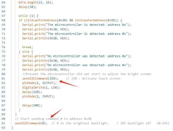

0x30 is the I2C address of the microcontroller (STC8H1K28).
0x5D is the I2C address of the touch IC (GT911).
sendI2CCommand(0) means sending command 0 to the microcontroller (address 0x30) to instruct it to set the screen brightness to maximum.
For 0 mentioned above, you can replace it with the following values:
- 0 is the brightest backlight.
- 0 to 245: The screen brightness will gradually increase to the minimum value
- 245 represents turning off the screen light

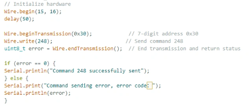

- It means sending the 248 command to the microcontroller (0x30) to instruct the speaker to turn on.

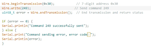

- It means sending the 249 command to the microcontroller (0x30) to instruct the speaker to turn off.

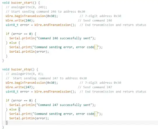

- You can also send command 246 to control the buzzer to turn on, and send command 247 to control the buzzer to turn off.
