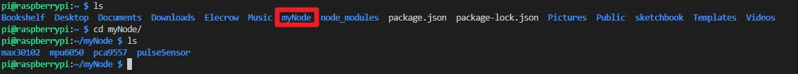

First, we need to create a directory. This directory is used to store all the information files of the custom node. For example, I create a myNode directory in my home directory to store all custom nodes.
Next, follow the example on the official website to create lower-case.

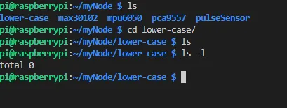

First create a directory lower-case and enter it.

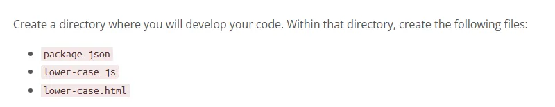

To create a simple node, you need the following three files.
paskage.json: the registration description file.
lower-case.js: the node driver file, written in javascript.
lower-case.html: the display style file of the node on the web page.

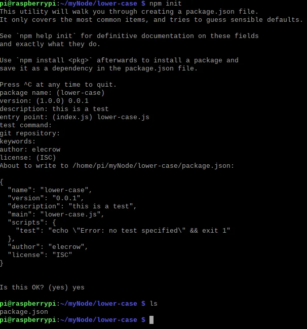

The .json file can be created as a template using the command npm init.
After enter npm init, the system will give a prompt, and you need to enter the corresponding description according to the prompt. After confirmation, a .json file will be automatically generated.

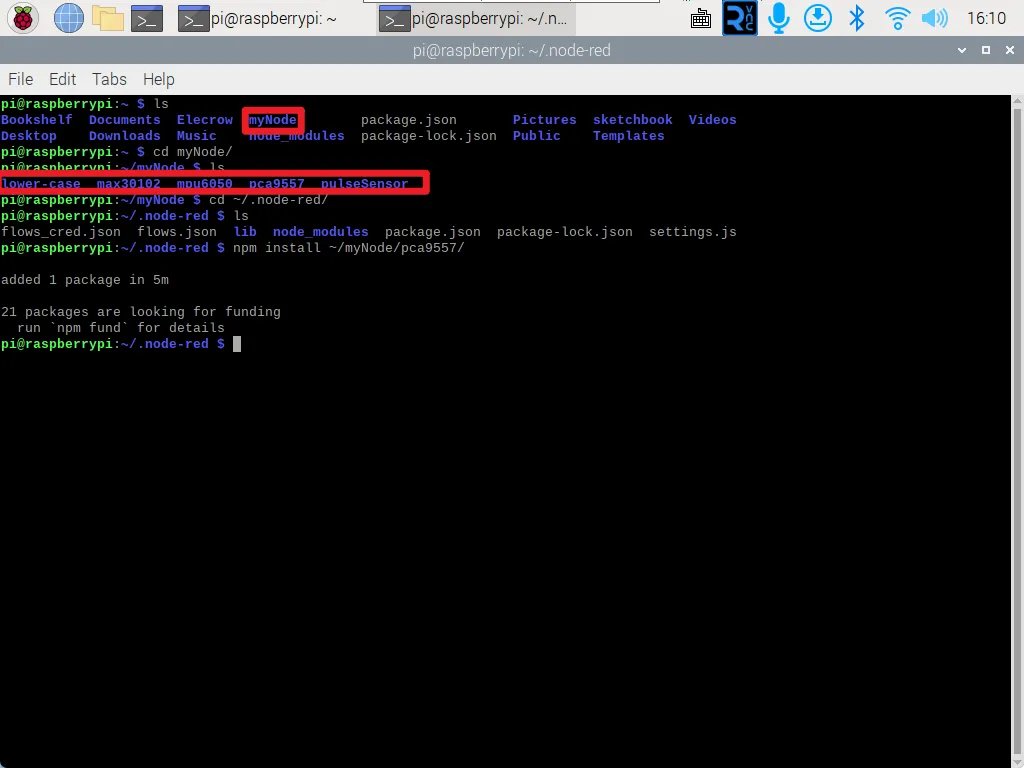

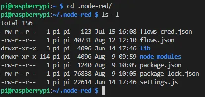

After you have the most basic files required above, you can go to the node installation directory and install the node. After the nodered software is installed(The PiTerminal image has NodeRed installed. Just click to open the NodeRed software and start the server running in the background.), a hidden directory .node-red/ will be generated in the system's home directory /home/pi
The node_modules directory stores all the driver directories for the nodes we have installed. We will temporarily use /home/pi/.node-red/ as the root directory of nodered. In the root directory, use the command:
npm install *****(here is the directory path of your node)
Take the node I created as an example. The custom node I created is in home/pi/myNode/lower-case/. The tree structure is as follows
So I can install it according to the relative (absolute) path (absolute path is recommended), that is: npm install /home/pi/myNode/lower-case
I put all the directories of custom nodes in /home/pi/myNode/. When installing the node, go to the /home/pi/.node-red/ directory and run the command to install it (remember to specify the directory path of the custom node)
Reboot server¶
After the installation is successful, restart the nodered server, and you can view your node lower-case in the node column on the left side of the panel

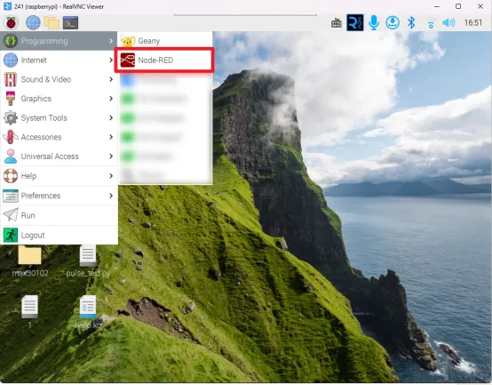

Since the NodeRed software is installed in the PiTerminal image, you only need to click to open the NodeRed software and let the server run in the background.

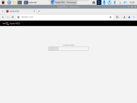

Now you can use any device in the LAN to access the local server's IP address + port number (fixed 1880) to access the NodeRed node panel. You can also directly open the browser in the Raspberry Pi system and enter 127.0.0.1:1880 to access

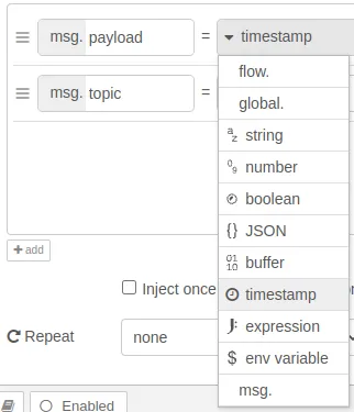

The
node is the most basic input node, which mainly outputs corresponding information to the downstream node. The type of information can be global variable type, string type, integer type, Boolean type, JSON data, buffer type or timestamp type, etc. Just double-click the inject node in the panel to perform the corresponding configuration.The function of the
node is to print the output information of the upstream node. The printed information data content will be displayed on the debugger. -

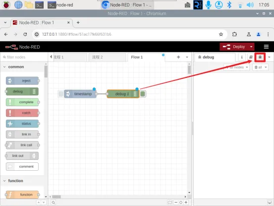

After placing the two nodes, you can connect the two nodes
Then click the red button Deploy (equivalent to compile) in the upper right corner.

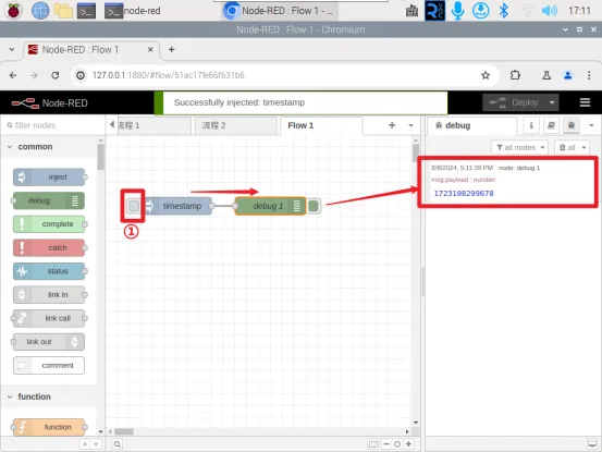

Clicking the blue square on the left side of timestamp is equivalent to triggering an inject output operation, and the corresponding debugging information will appear in the debug bar.
Note that the debugging information here is displayed using integer data, but the actual output information is a timestamp. You can configure the actual data you want to output in inject.

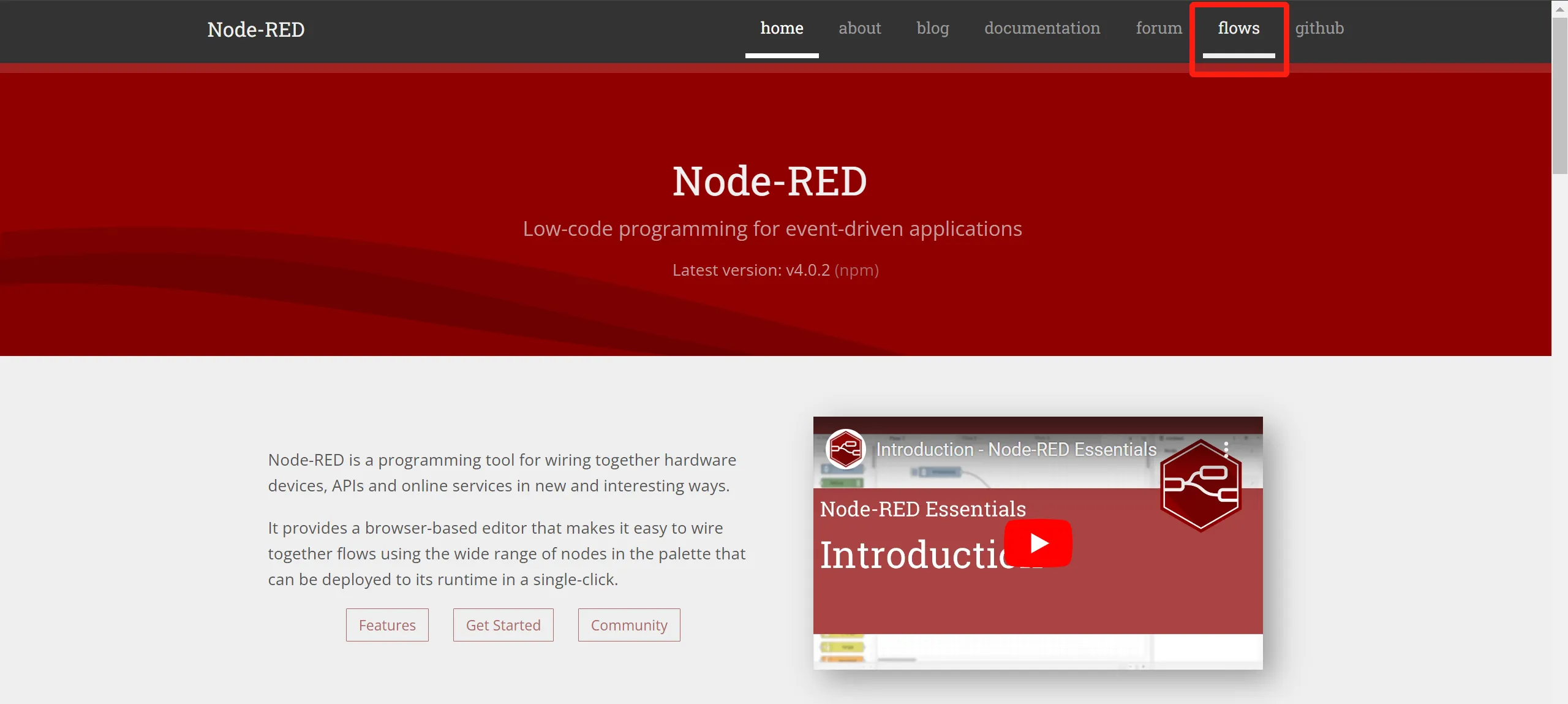

Enter https://nodered.org/, you can find "flows" in the top navigation bar. Various nodes can be found in it.

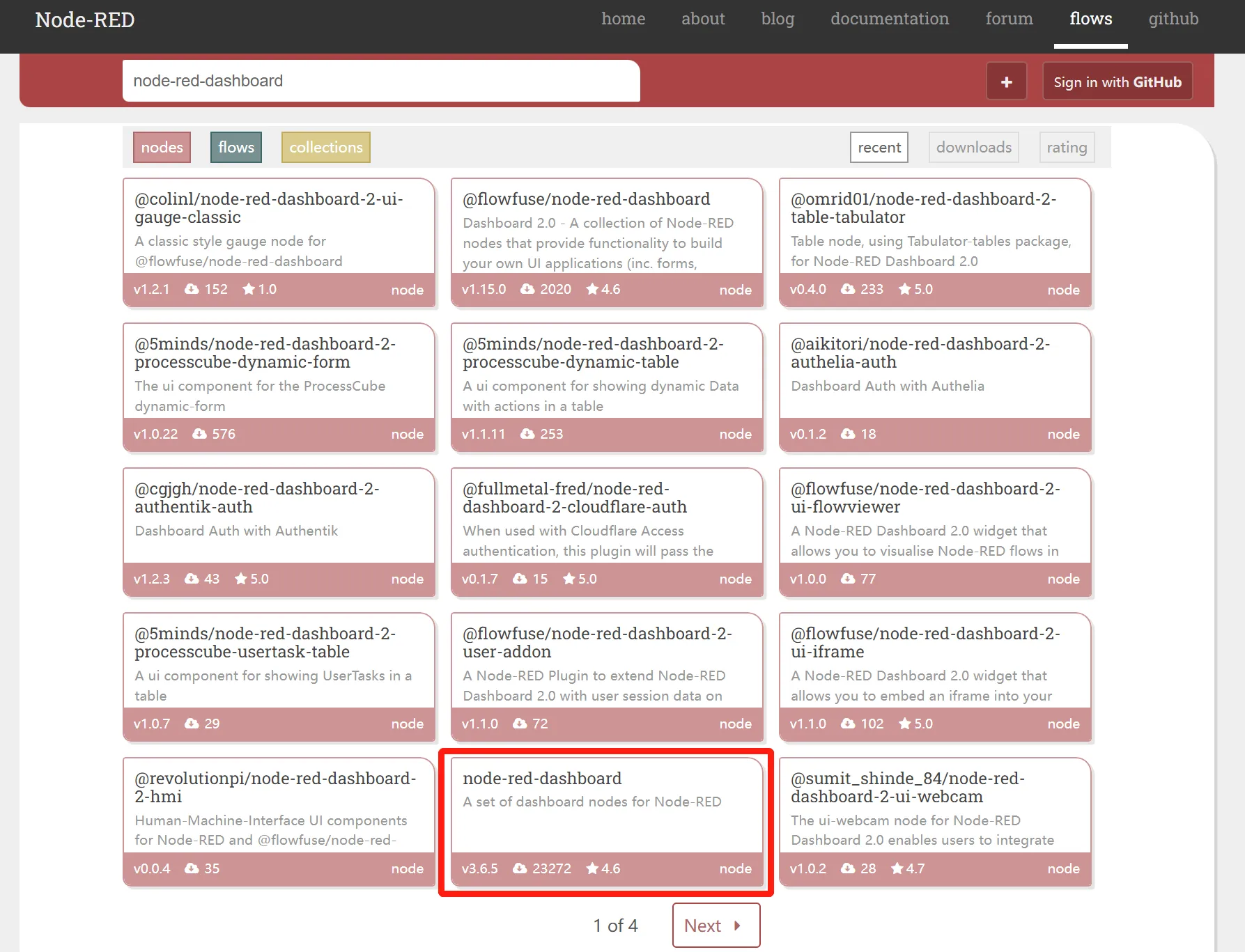

Search for node-red-dashboard. This module provides a set of nodes in Node-RED to quickly create a live data dashboard. Click the card and enter https://flows.nodered.org/node/node-red-dashboard. There will be detailed descriptions, usage, installation instructions, examples, etc.

cd ~/.node-redto enter the ~/.node-red directory of the Raspberry Pi, and then use the command:npm i node-red-dashboardto install node-red-dashboard.Method B(Recommended)

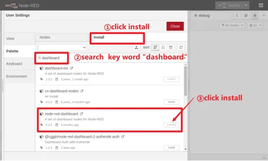

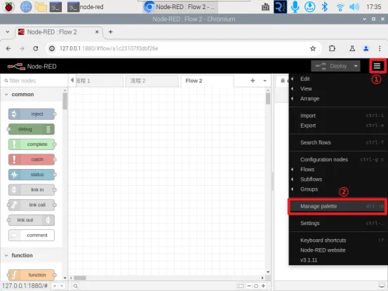

a. Open the browser in the Raspberry Pi system and enter 127.0.0.1:1880 to access the NodeRed node panel.
b. Click the drop-down menu and click "Manage palette".
c. Click "Install" in the Palette setting window, and search for "dashboard" or "node-red-dashboard". Find "node-red-dashboard" then click "Install".

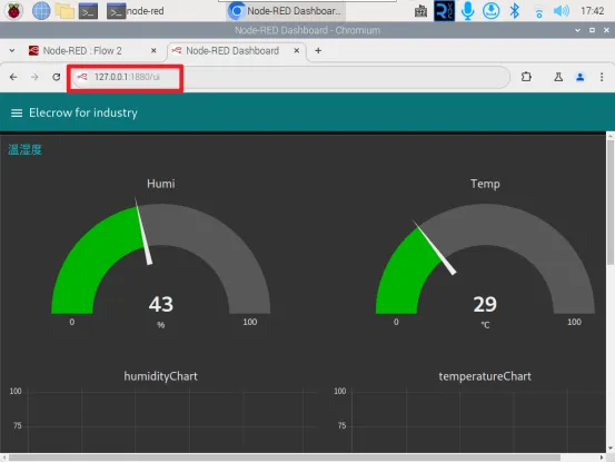

Drag the nodes to configure, then enter the URL: 127.0.0.1:1880/ui in the browser to access the corresponding ui
