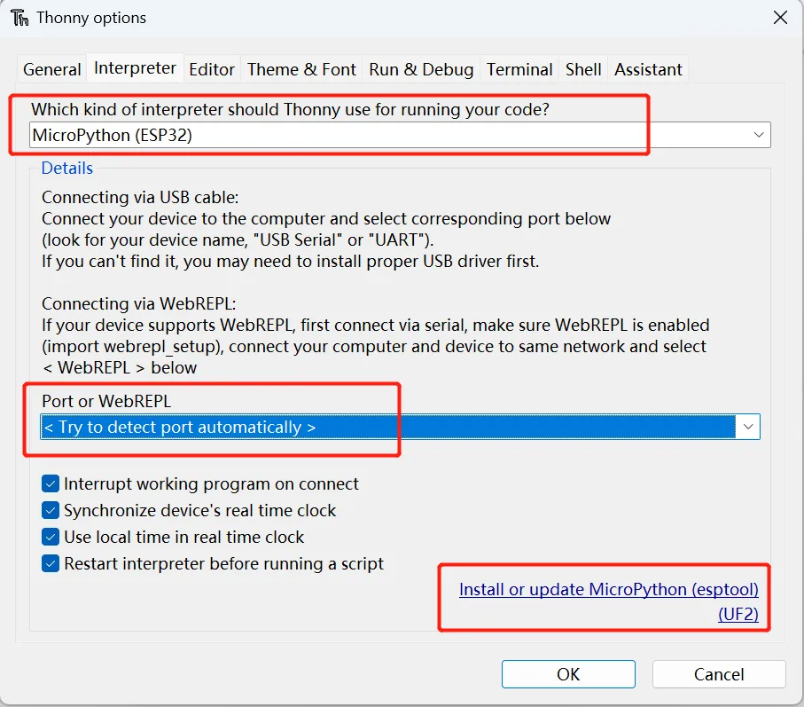

This tutorial demonstrates programming methods on Arduino IDE and Thonny IDE.
-  This tutorial demonstrates how to connect the ESP32 1.28-inch Round Display to the Home Assistant server on the Arduino IDE, and control the vibration motor. In addition, there are examples to demonstrate how to design lvgl widgets, control GPIO, connect Blutooth and connect WiFi, etc.
-  Since the program is too large to run on Thonny IDE, the memory of ESP32-C3 is insufficient. This tutorial only provides methods for using interfaces, without using lvgl to display image on the display.

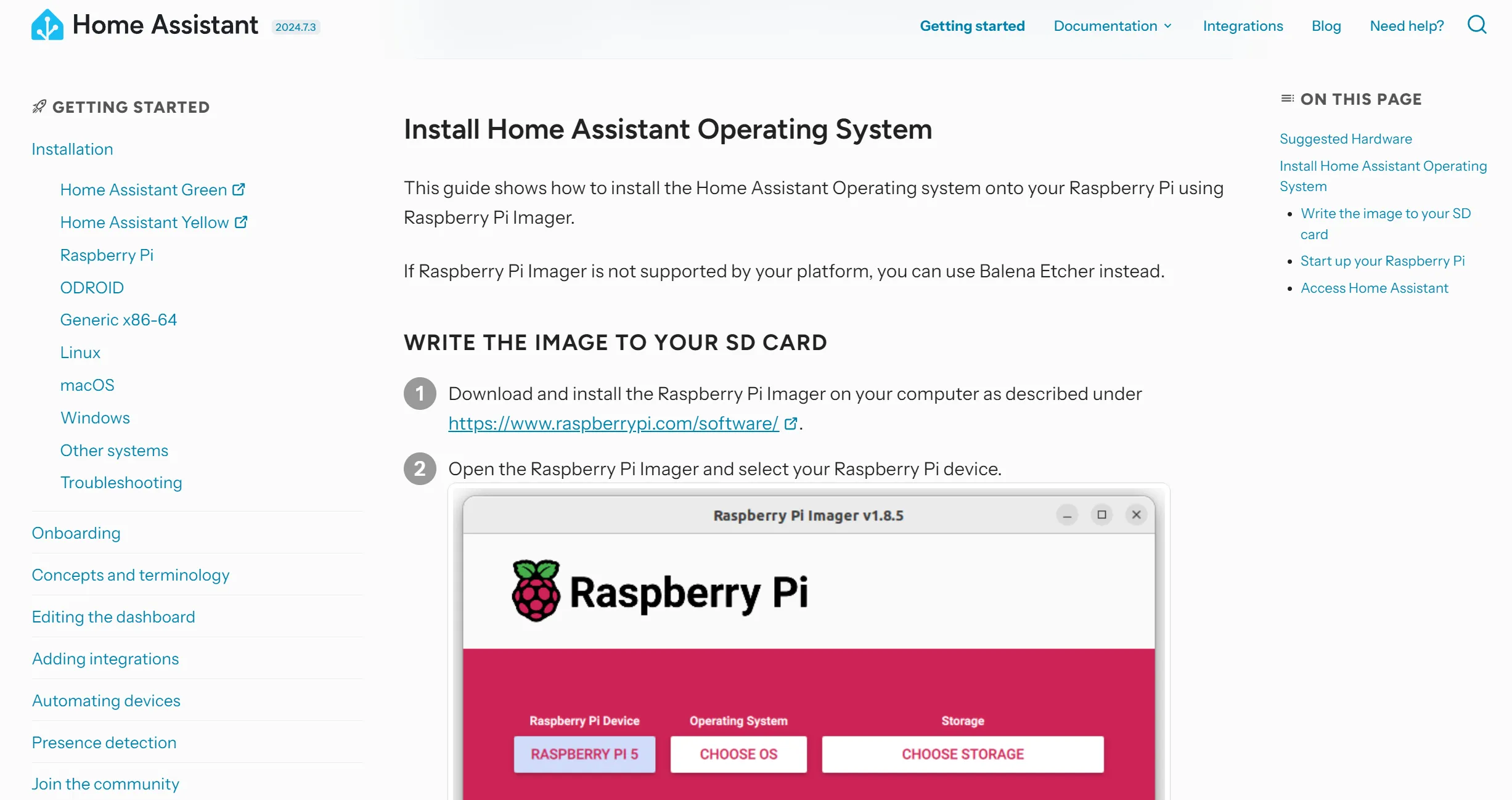

Install Home Assistant OS¶

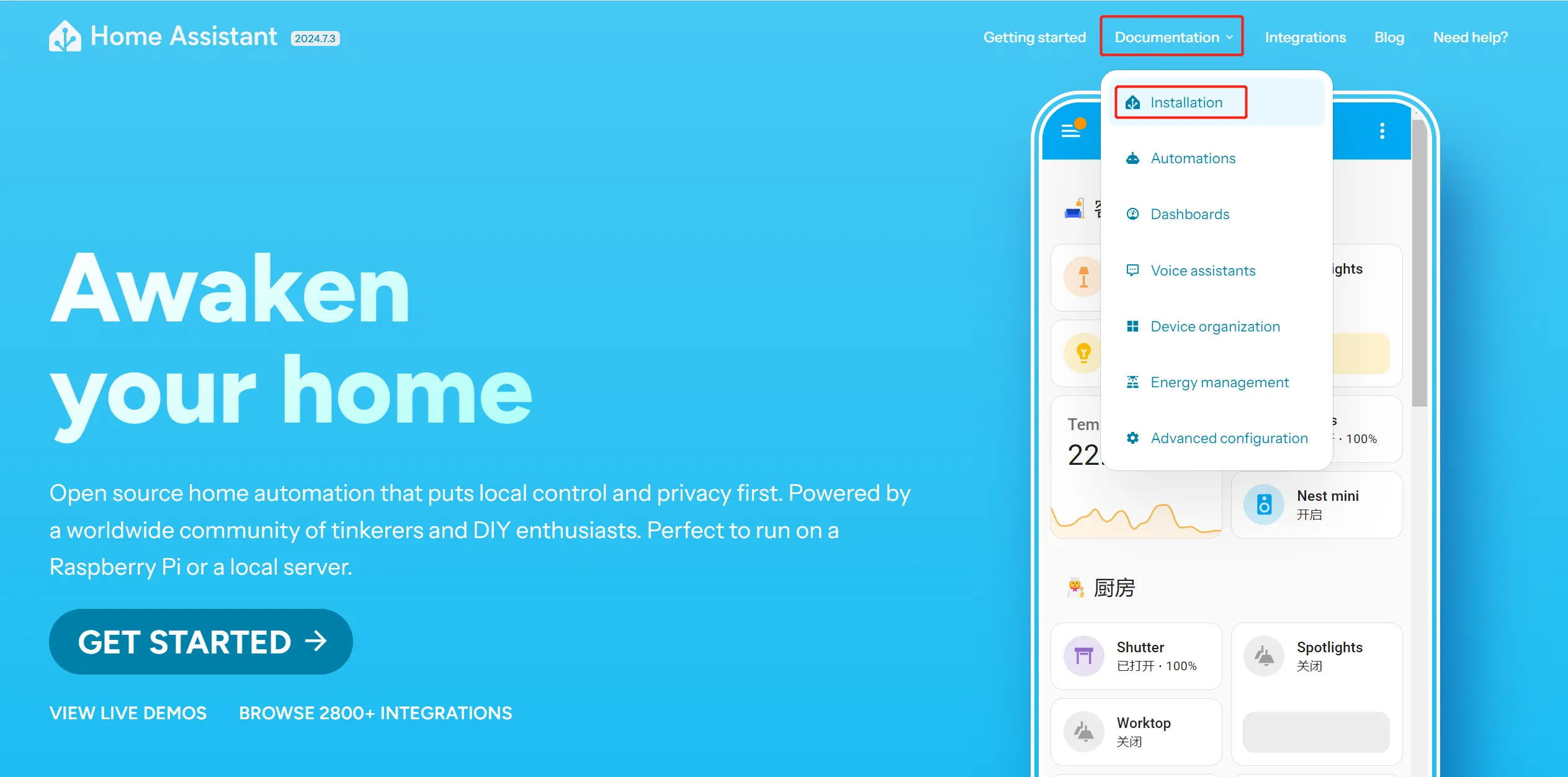

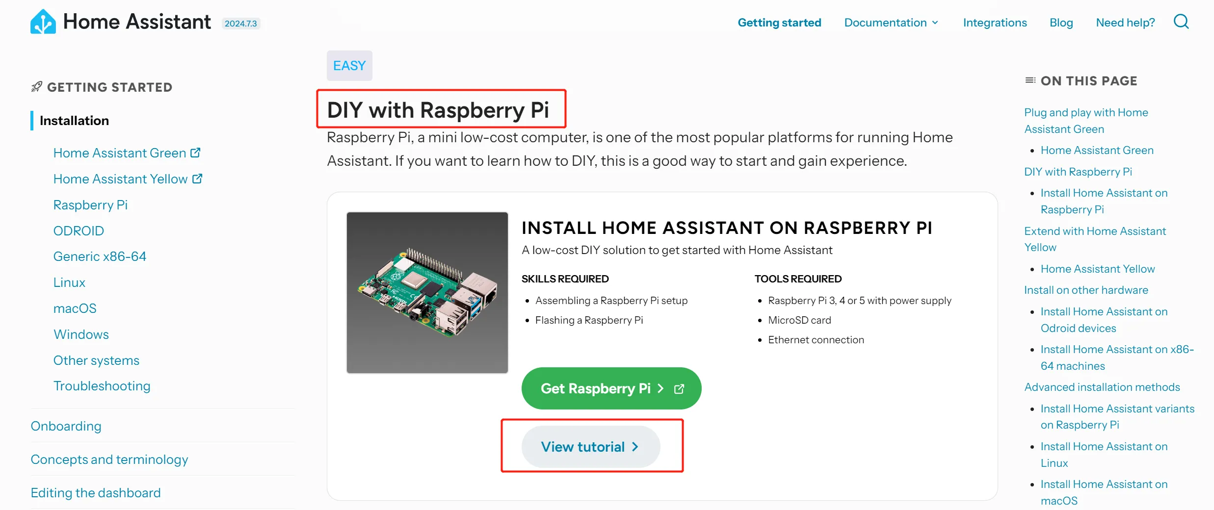

-  Go to https://www.home-assistant.io/, and click the "Installation" under "Documentation" on the homepage.
-  Scroll down to the "DIY with Raspberry Pi" section, and click "View tutorial".
-  Follow the Home Assistant tutorial to install Operating System.
-  Eject the SD card after the Home Assistant OS is written.
-  Start up your Raspberry Pi. - Insert the SD card into your Raspberry Pi.
- Plug in an Ethernet cable and make sure the Raspberry Pi is connected to the same network as your computer and is connected to the Internet.
- Connect the power supply to start up the device.

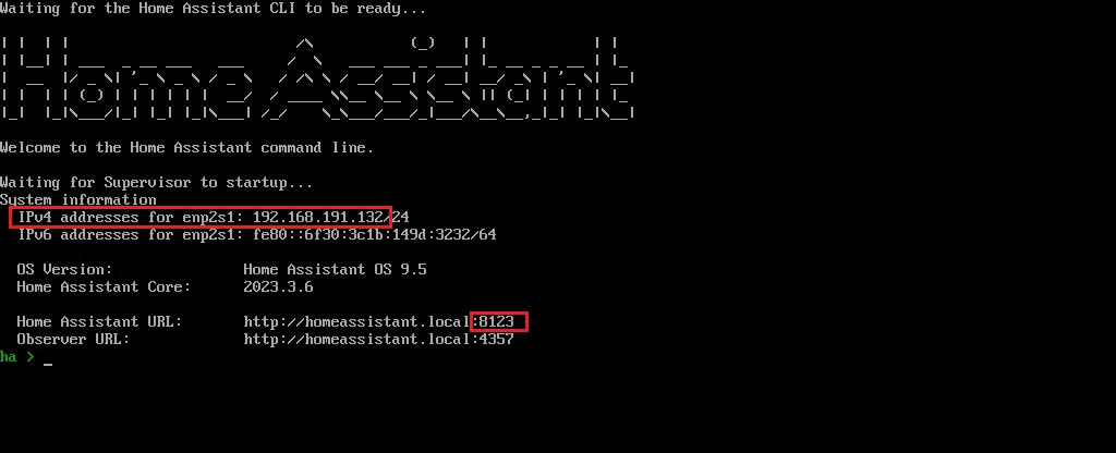

Register for Home Assistant¶
Within a few minutes after connecting the Raspberry Pi, you will be able to reach your new Home Assistant.
- 192.168.191.132: this is the IP address of my Raspberry Pi, it is assigned by the router.
-  8123: this is the port number, it is fixed.

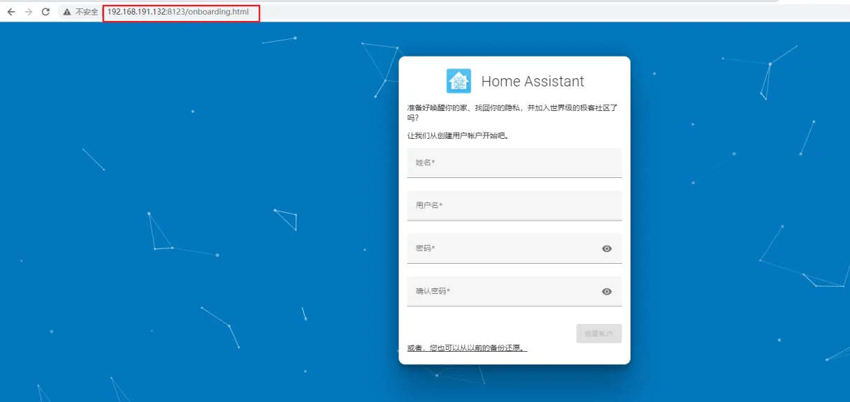

-  In the browser of your desktop system, enter homeassistant.local:8123. Note If you are running an older Windows version or have a stricter network configuration, you might need to access Home Assistant at homeassistant:8123 or http://X.X.X.X:8123(replace X.X.X.X with your Raspberry Pi’s IP address).The time it takes for this page to become available depends on your hardware. On a Raspberry Pi 4 or 5, this page should be available within a minute. - If it does not show up after 5 minutes on a Pi 4 or 5, maybe the image was not written properly.

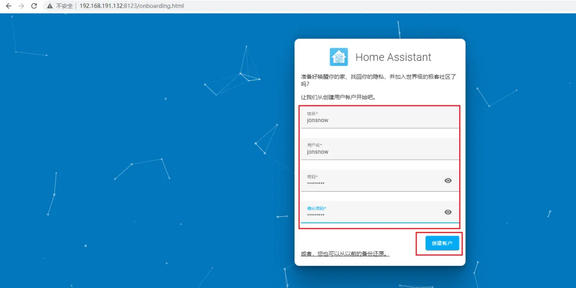

-  For the first visit, you need to create an account. Fill in the username and password, and create an account.
-  Region selection. You can manually locate or select automatic detection.
-  Next, click Next by default.
-  Then click Finish. It will prompt you to add a smart device. You can click Finish first and then set it up yourself.
-  Then enter the control panel interface

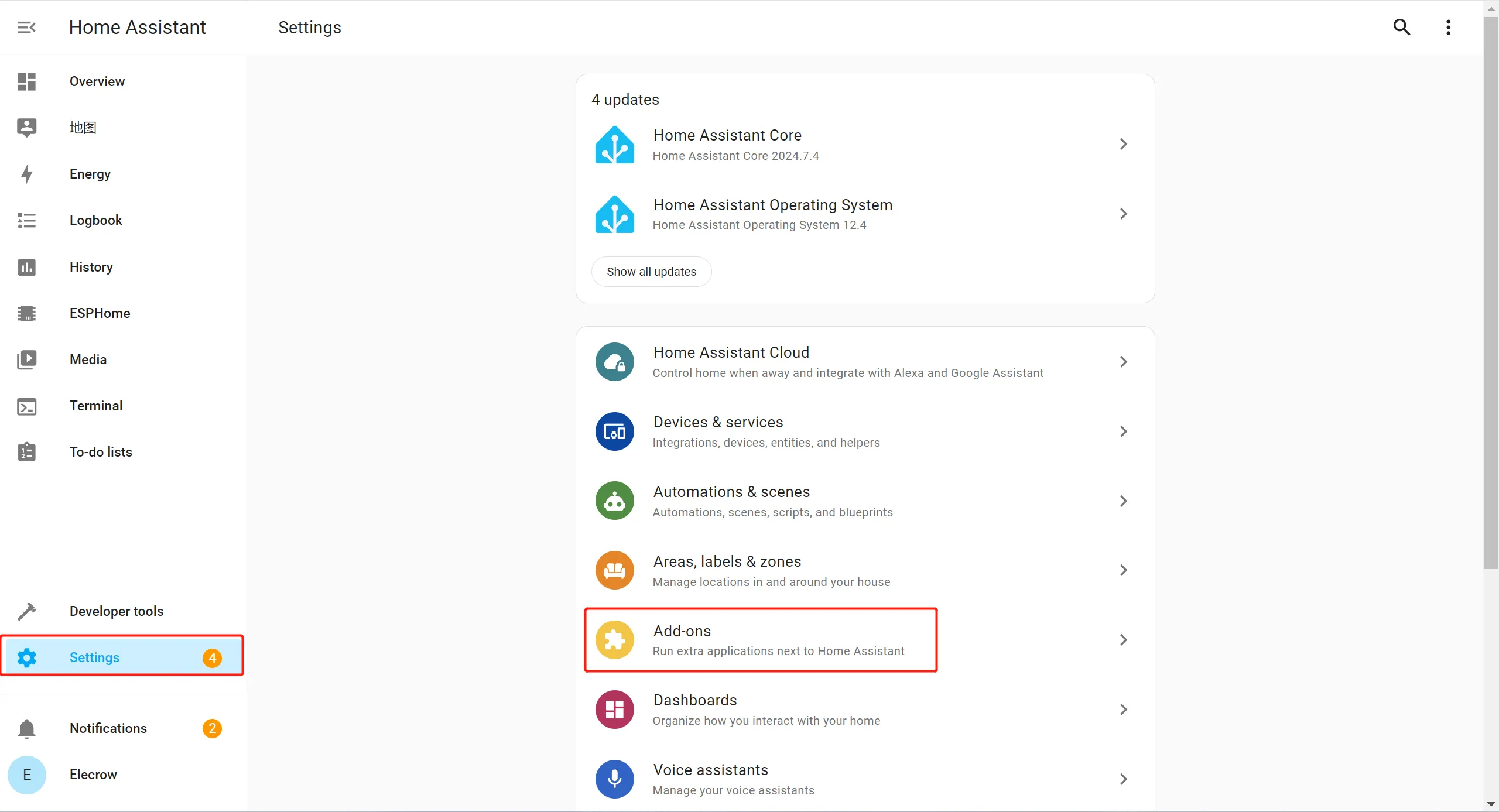

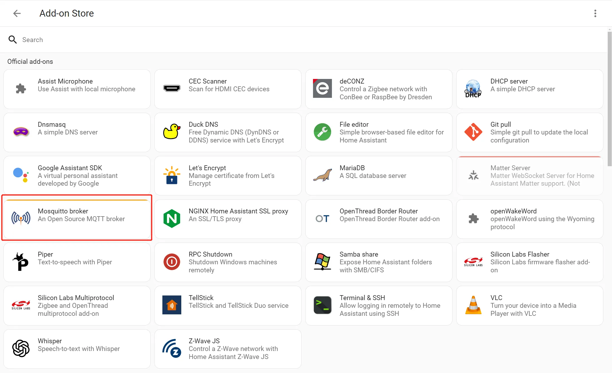

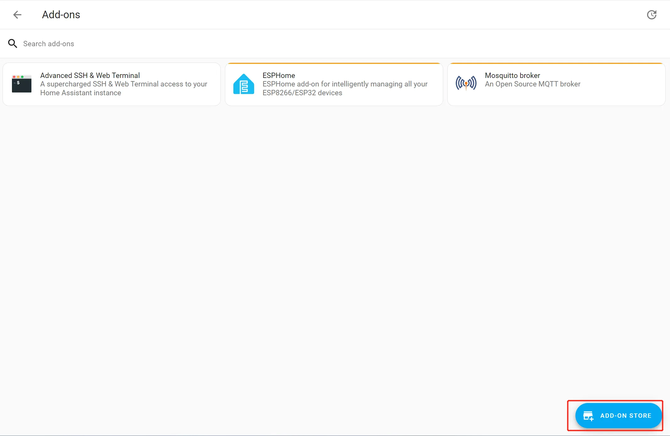

-  Click "Setting" -> "Add on"
-  Click ADD-ON STORE

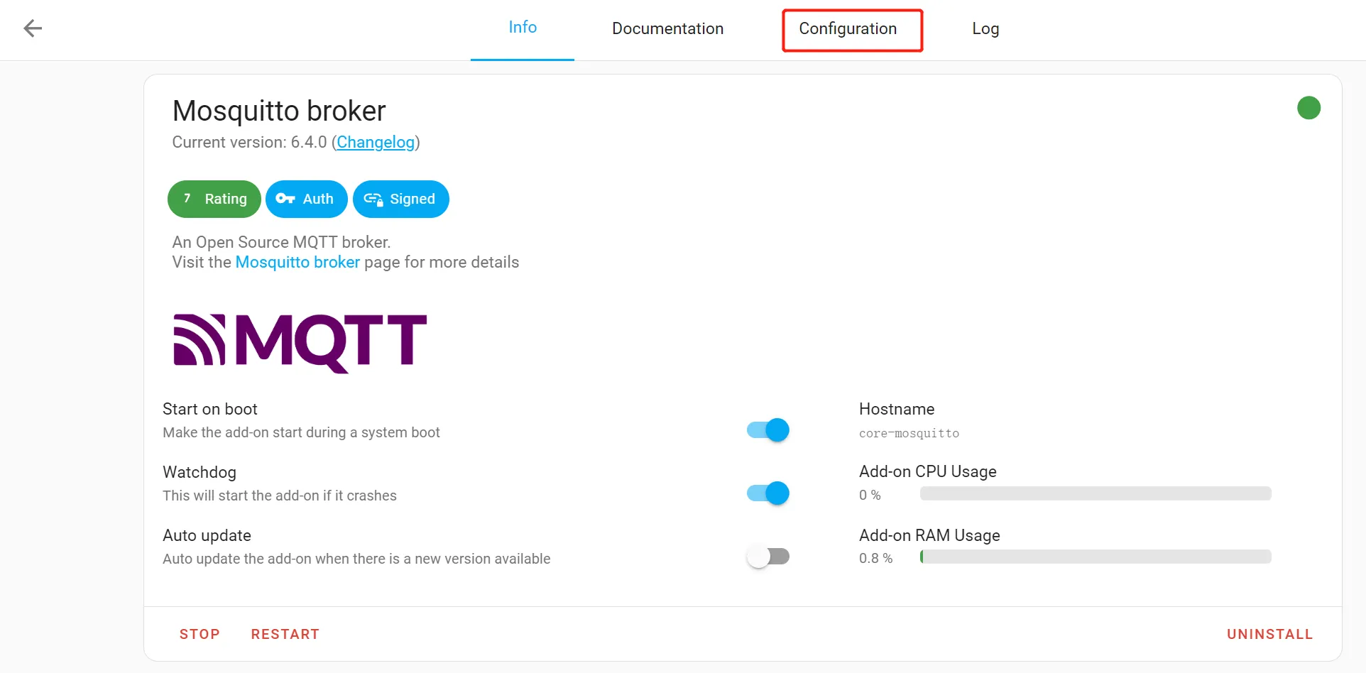

-  Select "Mosquitto broker" and install
-  Enable Mosquitto broker

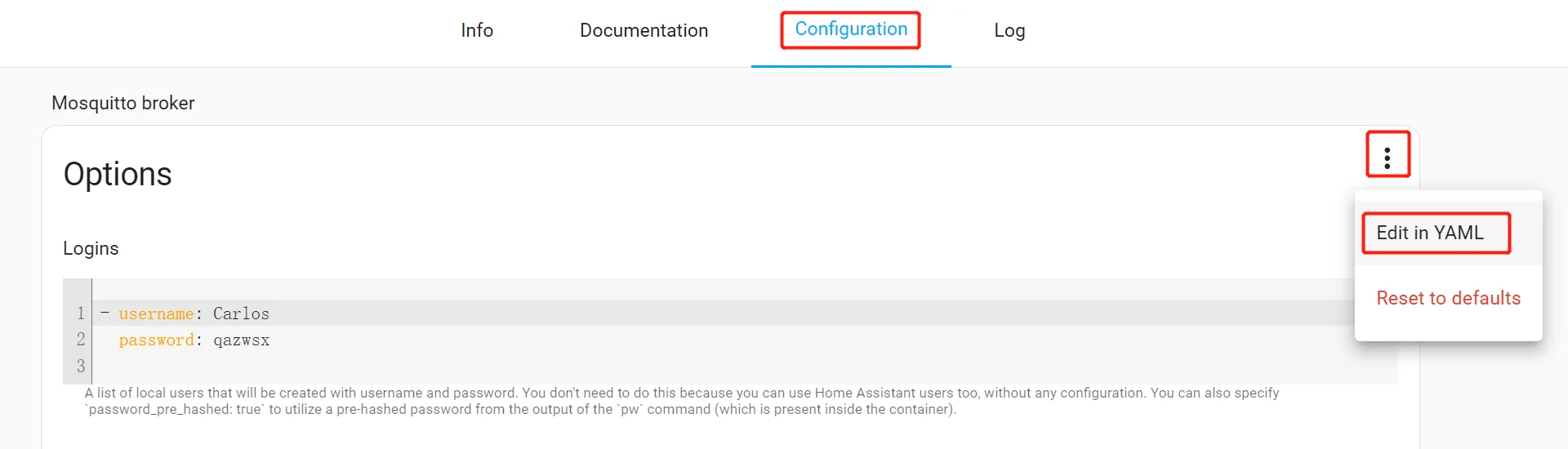

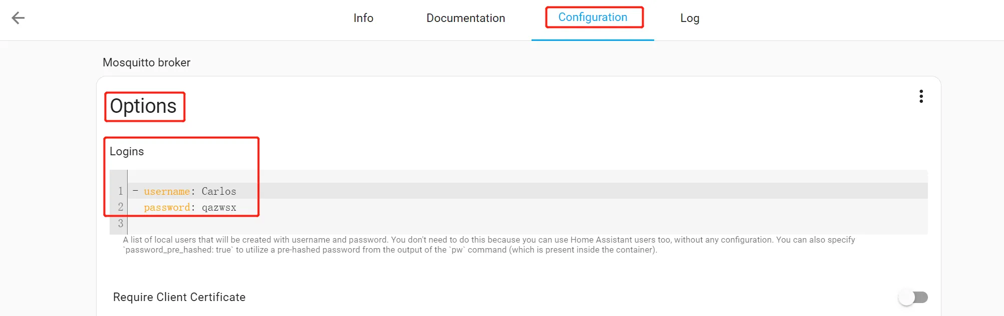

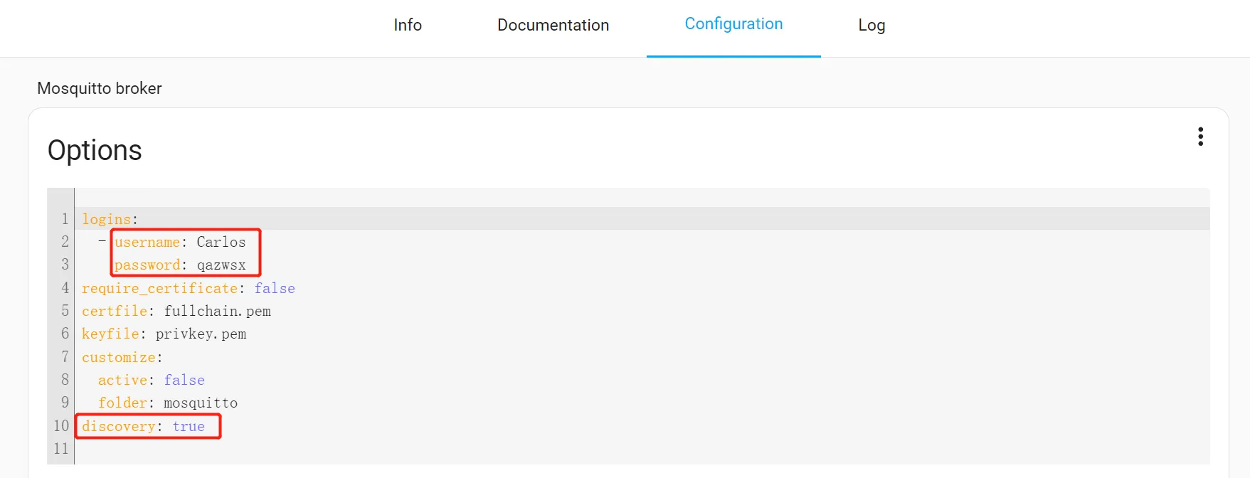

-  Then click "Configuration" -> "Options" -> "Logins", and set the username and password. Click the three-dot icon, then click "Edit in YAML" Modify the username and password, and set the discovery to "true".

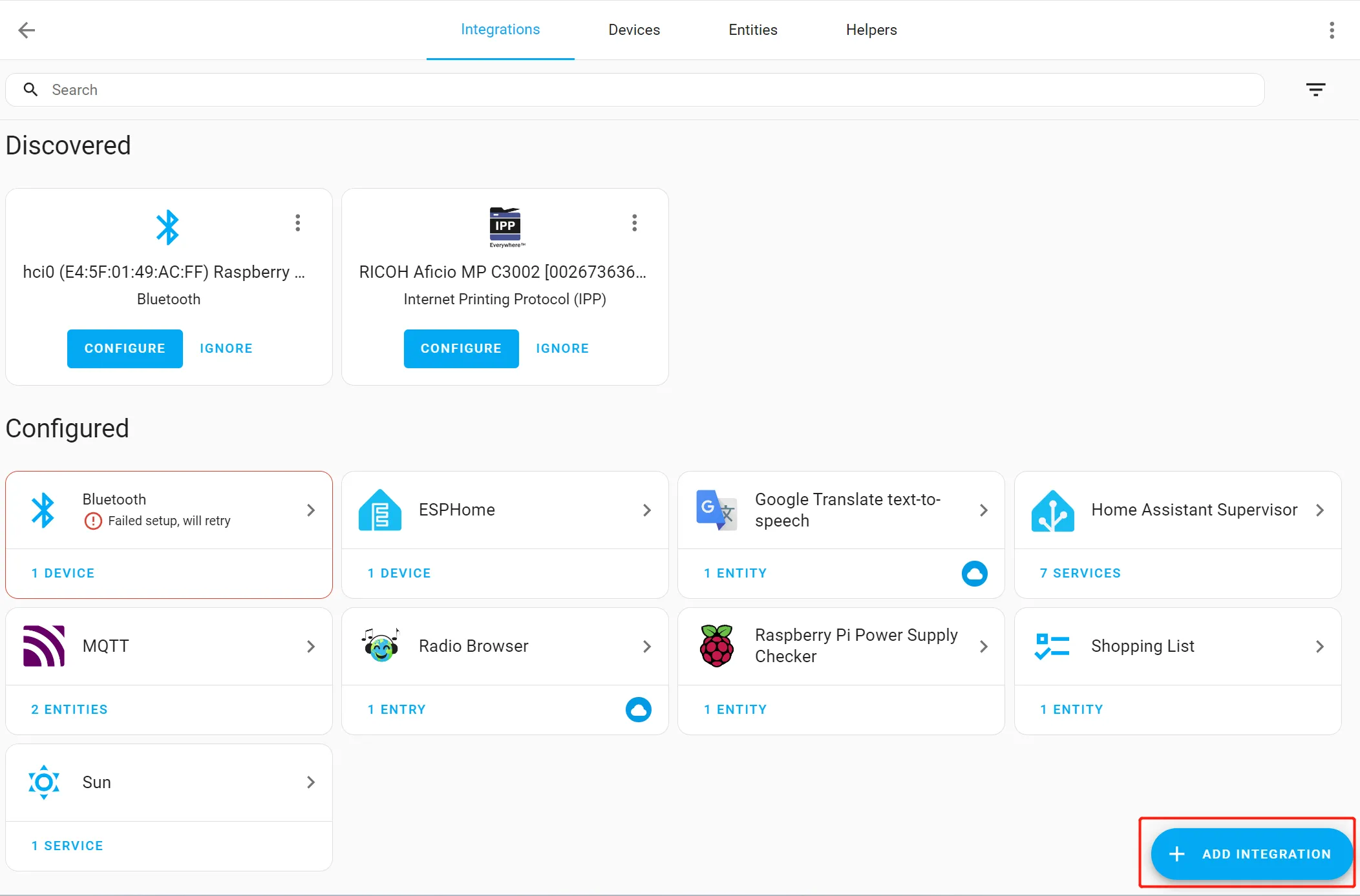

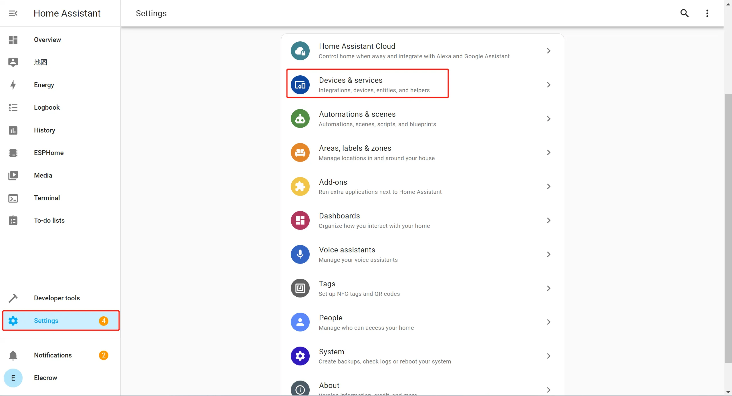

-  Click "Setting"-> "Devices&Service"

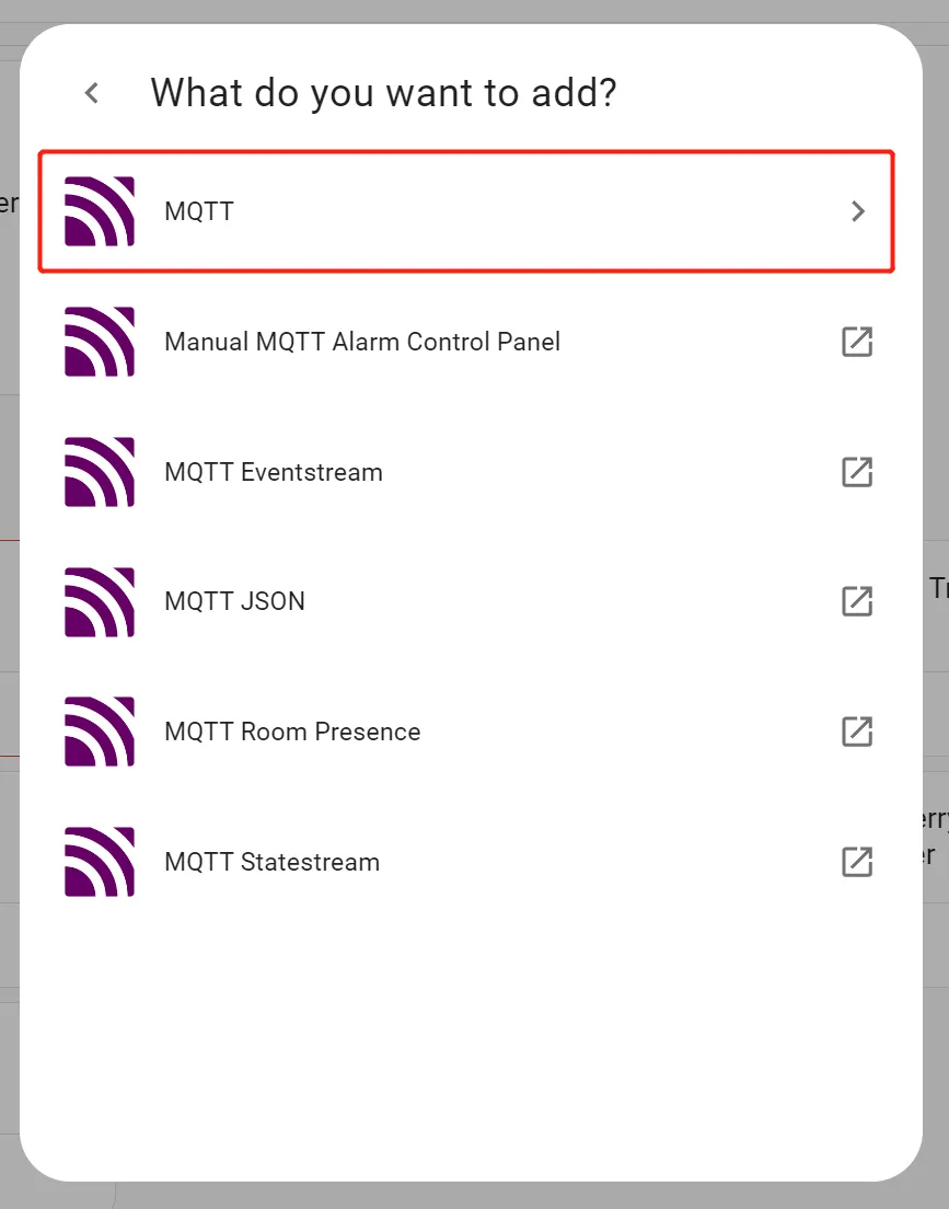

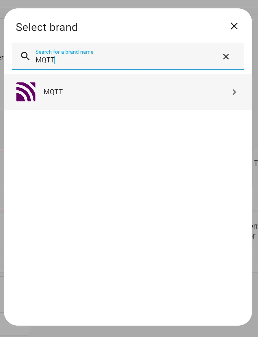

-  Click "ADD INTEGRATION"

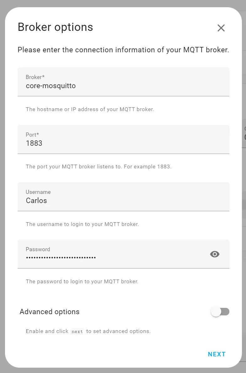

-  Search for "MQTT"
-  Configure the MQTT server information - the Broker is the IP address of the Raspberry Pi server
- the default port is 1883, it can be customized
- the username and password are the username and password configured in step 6

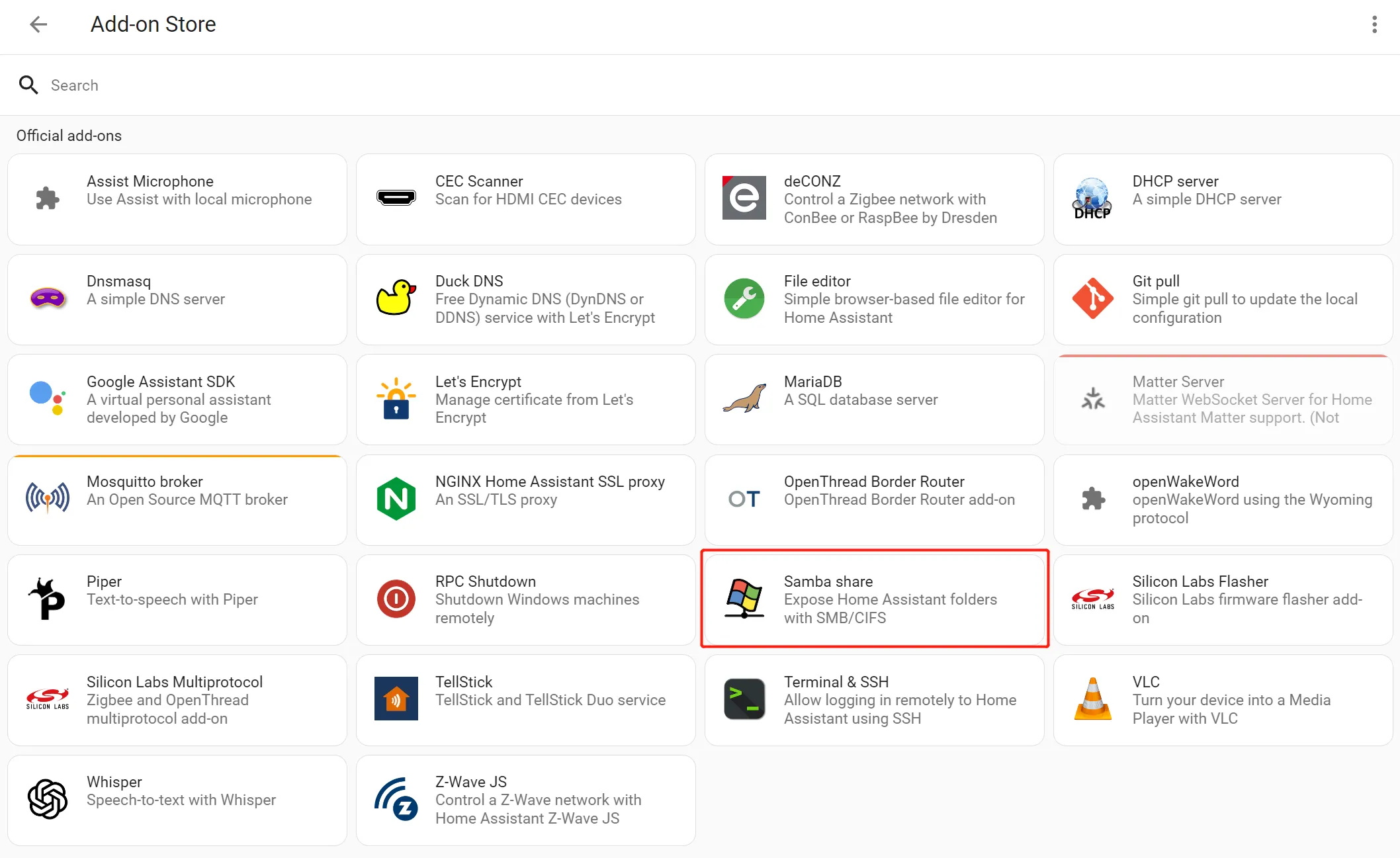

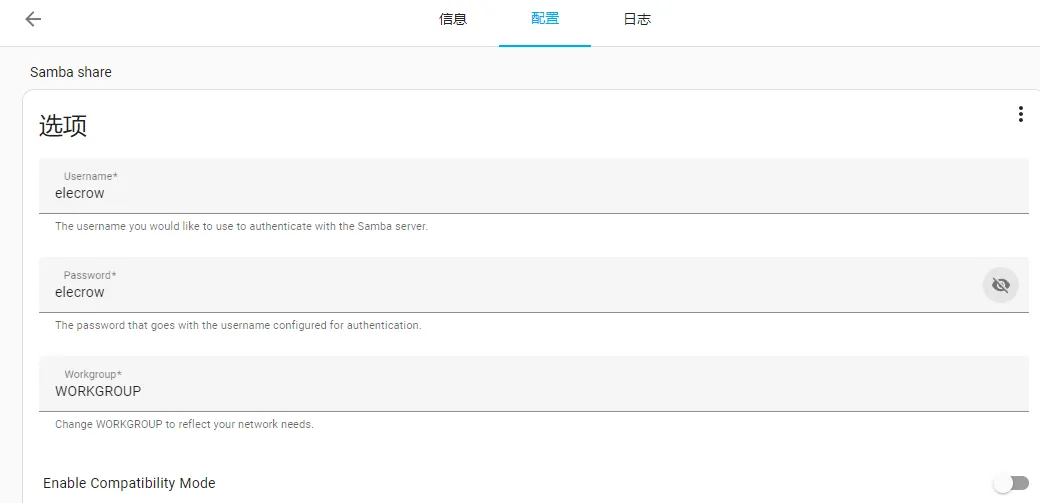

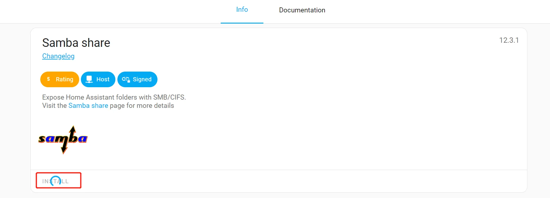

-  Click "Setting" -> "Add on" -> "ADD-ON STORE", and install Samba share
-  Enter the Samba share Configuration and enter the Username and Password

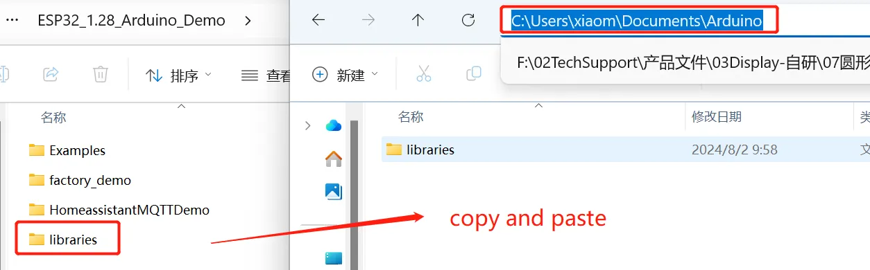

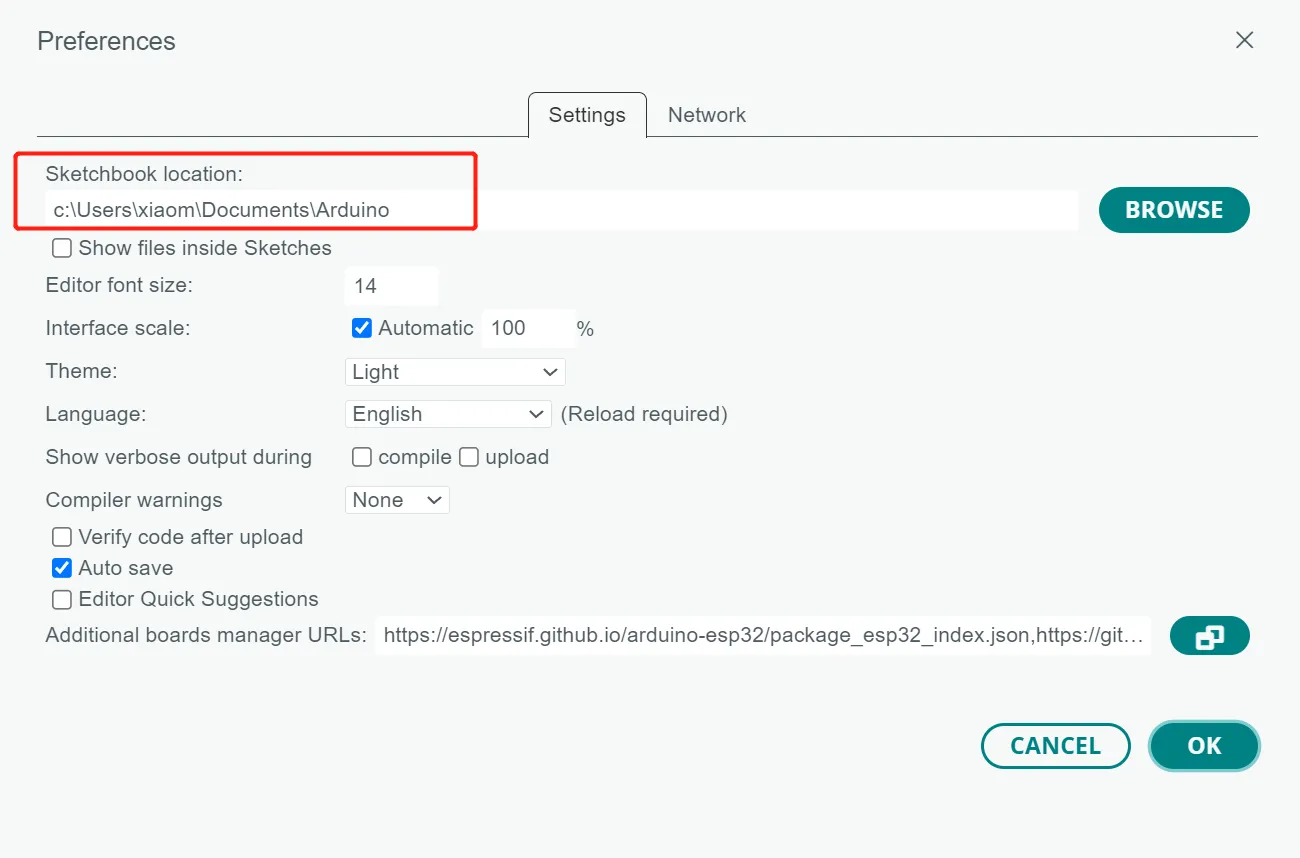

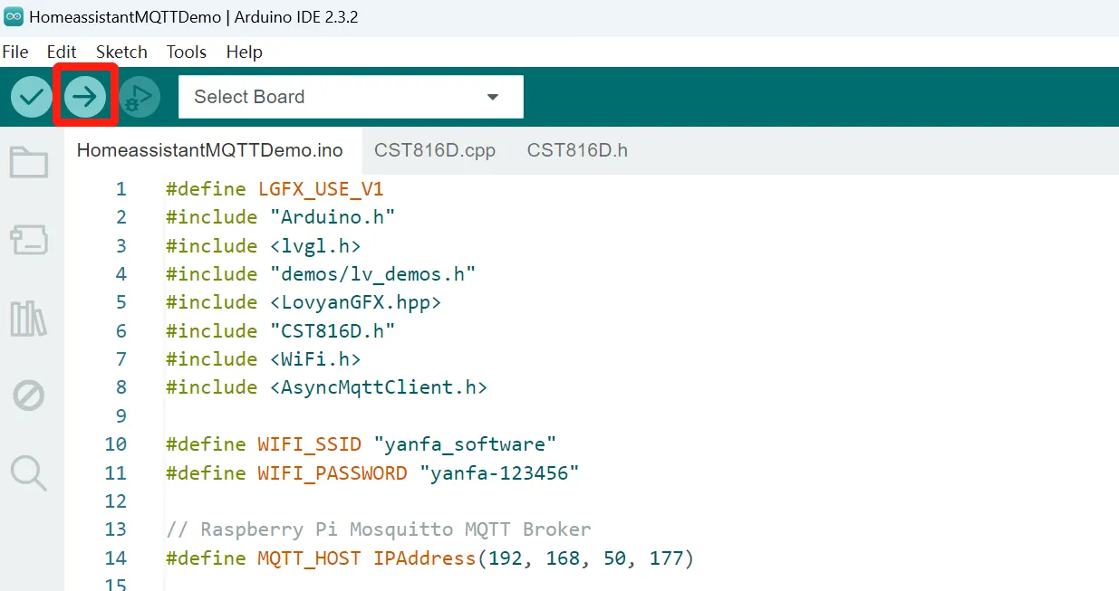

-  Install libraries. Copy the libraries folder we provided to the Sketchbook location. To find the Sketchbook location, please open the Arduino IDE, click "File"->"Preferences"->"Sketchbook Location".
-  Enter the "HomeassistantMQTTDemo" folder and open HomeassistantMQTTDemo.ino

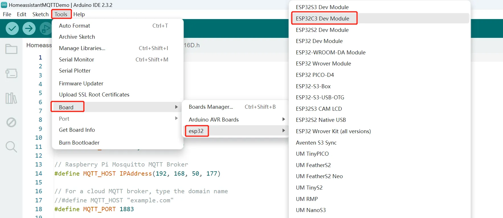

-  Click "Tool" -> "Board", and select the "ESP32C3 Dev Module"

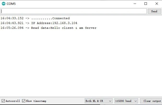

-  Connect the ESP32 1.28(R) display to the computer, and click "Tool"->"Port" to select the corresponding port number.
-  Click the "Upload" icon to upload the code. After the program is successfully downloaded, it will be prompted that the download is successful.

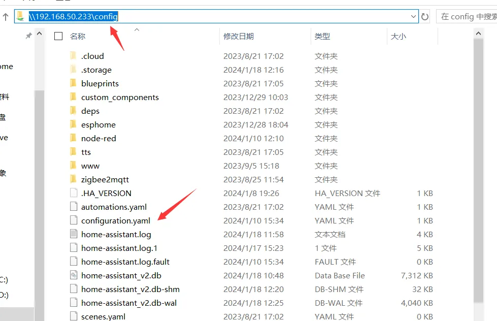

-  Open "File Explorer" and type in \\192.168.50.233to enter "config" folder. Open configuration.yaml

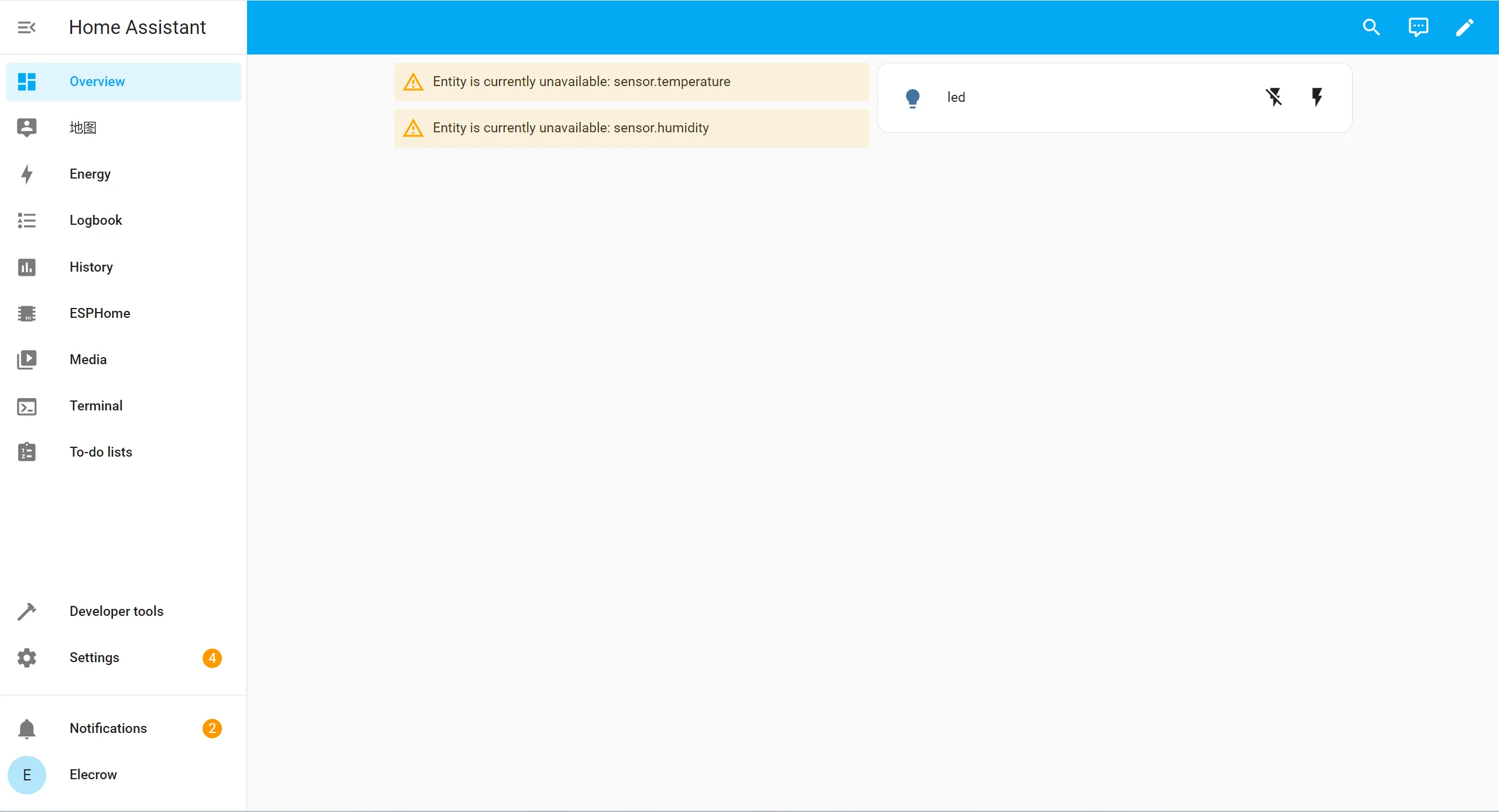

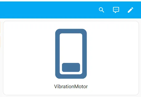

-  After saving the above code, go to the homepage -> Overview -> Edit Dashboard -> Add Card -> Select the entity just written in configuration.yaml in the card, the save.
-  You can control the 1.28-inch screen onboard vibration motor through the server

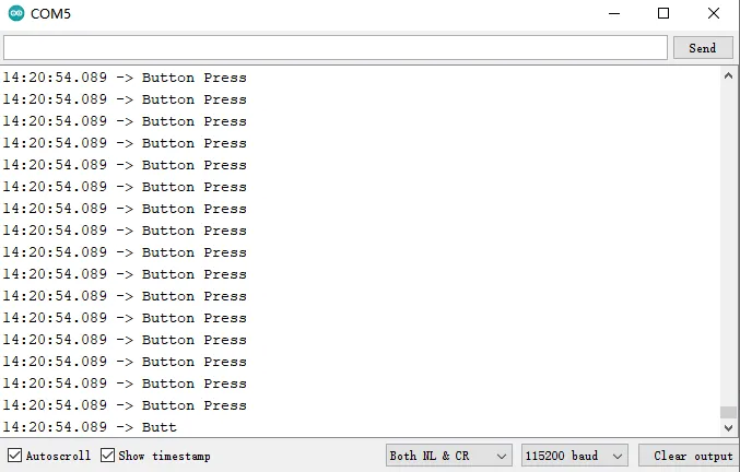

Upload the Button.ino code to the board
// Define the pin number for the button
const int buttonPin = 1;  // The pin number where the button is connected
// Variable to store the current state of the button
int buttonState = 0;  // Variable to hold the button's state, initially set to HIGH (0)
void setup() {
  Serial.begin(115200);  // Initialize serial communication at a baud rate of 115200
  pinMode(buttonPin, INPUT);  // Set the button pin as an input
void loop() {
  // Read the current state of the button (HIGH or LOW)
  buttonState = digitalRead(buttonPin);
  // If the button is pressed (connected to ground, state is LOW)
  if (buttonState == LOW) {
    Serial.println("Button Press");  // Print a message when the button is pressed
  // If the button is not pressed, it is in the release state (HIGH)
  else {
    Serial.println("Button release");  // Print a message when the button is released
  // Note: This loop will continuously read the button state and print messages.
  // This may not be the desired behavior in all applications.
  // Consider adding a delay or using a debouncing method for the button.

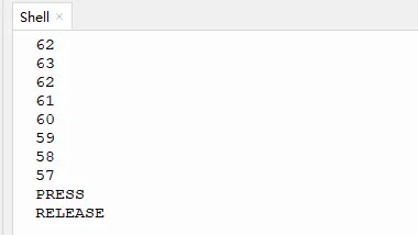

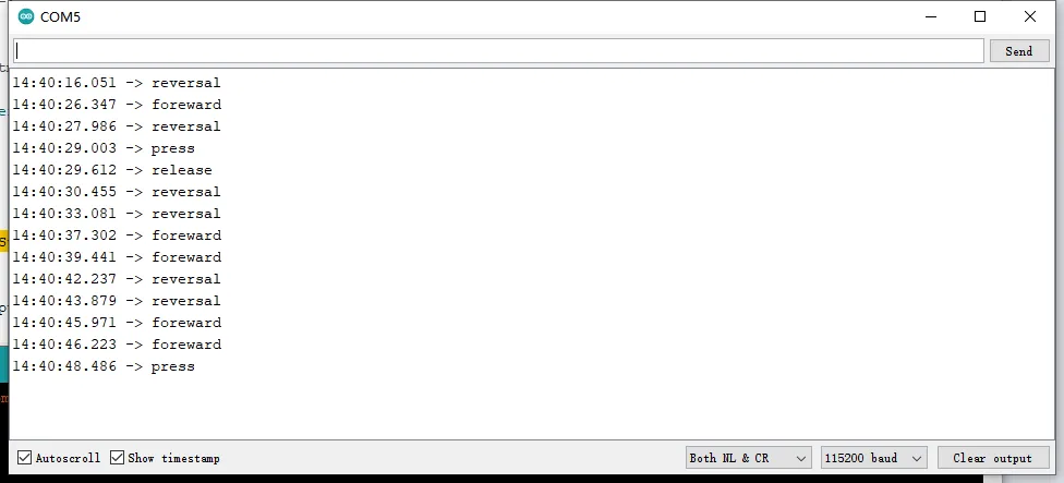

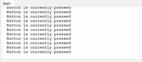

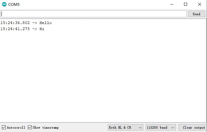

Open the serial monitor and press the button, the status of the button will be printed.

Open the serial monitor and toggle the encoder, the status of the encoder will be printed.

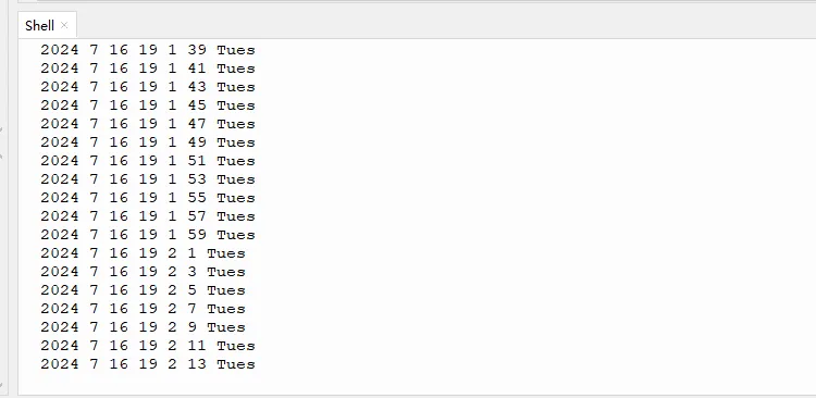

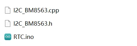

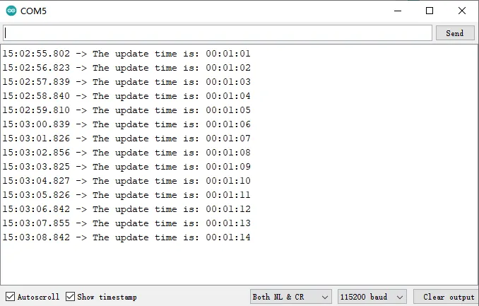

Example 4 Read RTC time¶
Open the RTC.ino in the "RTC" folder.
Upload the RTC.ino code to the board
#include "I2C_BM8563.h"
#define I2C_SDA 4  // Define the SDA pin for I2C communication
#define I2C_SCL 5  // Define the SCL pin for I2C communication
I2C_BM8563 rtc(I2C_BM8563_DEFAULT_ADDRESS, Wire);  // Create an RTC object using the default I2C address and Wire library
I2C_BM8563_DateTypeDef dateStruct;  // Define a structure to hold the date information
I2C_BM8563_TimeTypeDef timeStruct;  // Define a structure to hold the time information
// Function to initialize the RTC
void RTC_init() {
  rtc.begin();  // Begin communication with the RTC
  // The following lines are commented out and provided as an example
  // of how to set a custom time and date if needed:
  I2C_BM8563_TimeTypeDef timeStruct;  // Define a time structure
  timeStruct.hours   = 11;    // Set the hour (0 - 23)
  timeStruct.minutes = 59;   // Set the minute (0 - 59)
  timeStruct.seconds = 0;    // Set the second (0 - 59)
  rtc.setTime(&timeStruct);  // Set the time in the RTC
  I2C_BM8563_DateTypeDef dateStruct;  // Define a date structure
  dateStruct.weekDay = 3;    // Set the weekday (0 - 6, where 0 is Sunday)
  dateStruct.month   = 1;    // Set the month (1 - 12)
  dateStruct.date    = 24;   // Set the day of the month (1 - 31)
  dateStruct.year    = 2024; // Set the year
  rtc.setDate(&dateStruct);  // Set the date in the RTC
void setup() {
  Serial.begin(115200);  // Start serial communication at 115200 baud rate
  Wire.begin(I2C_SDA, I2C_SCL);  // Initialize the I2C bus with defined SDA and SCL pins
  RTC_init();  // Call the RTC initialization function
void loop() {
  rtc.getDate(&dateStruct);  // Get the current date from the RTC
  rtc.getTime(&timeStruct);  // Get the current time from the RTC
  // Print the current time in a formatted manner
  Serial.printf("The update time is: %02d:%02d:%02d\n",
                timeStruct.hours,
                timeStruct.minutes,
                timeStruct.seconds
  delay(1000);  // Wait for 1 second before updating the time again
Open the serial monitor, the time will be printed.

Example 6 Utilization of the Serial Port¶
Upload the code Uart.ino to the board
char val;  // Variable to store the read value from the serial buffer
void setup() {
  Serial.begin(115200);  // Initialize the serial communication at a baud rate of 115200
void loop() {
  // Check if there is data available in the serial buffer
  if (Serial.available()) {
    val = Serial.read();  // Read the data from the buffer and store it in 'val'
    Serial.print(val);  // Print the read character back to the serial monitor
This code snippet sets up a simple serial communication where the Arduino board listens for incoming serial data. When data is available, it reads the first byte of data, stores it in the variable val, and then prints it back to the serial monitor. This process continues to loop, allowing for real-time data reading and echoing.

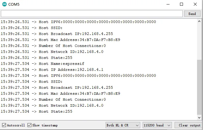

Example 7 The use of WiFi's AP (Access Point) mode¶
Upload the Wifi_AP.ino to the board
#include "WiFi.h"  // Include the WiFi library for ESP32
void setup() {
  Serial.begin(115200);  // Start the serial communication at a baud rate of 115200
  WiFi.softAP("ESP32C3_AP", "12345678");  // Set up the ESP32 as an Access Point with the SSID "ESP32C3_AP" and password "12345678"
void loop() {
  Serial.print("Host Name:");  // Print the host name of the ESP32
  Serial.println(WiFi.softAPgetHostname());
  Serial.print("Host IP Address:");  // Print the IP address of the Access Point
  Serial.println(WiFi.softAPIP());
  Serial.print("Host IPV6:");  // Print the IPv6 address of the Access Point
  Serial.println(WiFi.softAPIPv6());
  Serial.print("Host SSID:");  // Print the SSID of the Access Point
  Serial.println(WiFi.SSID());
  Serial.print("Host Broadcast IP:");  // Print the broadcast IP address of the Access Point
  Serial.println(WiFi.softAPBroadcastIP());
  Serial.print("Host Mac Address:");  // Print the MAC address of the Access Point
  Serial.println(WiFi.softAPmacAddress());
  Serial.print("Number Of Host Connections:");  // Print the number of devices connected to the Access Point
  Serial.println(WiFi.softAPgetStationNum());
  Serial.print("Host Network ID:");  // Print the network ID
  Serial.println(WiFi.softAPNetworkID());
  Serial.print("Host State:");  // Print the current state of the WiFi host (Access Point)
  Serial.println(WiFi.status());
  delay(1000);  // Wait for 1 second before printing the information again
This code sets up an ESP32 device as a WiFi Access Point with a specified SSID and password. In the loop() function, it prints various details about the Access Point, such as the host name, IP address, IPv6 address, SSID, broadcast IP, MAC address, number of connected clients, network ID, and the current WiFi state. This information is printed to the serial monitor every second.

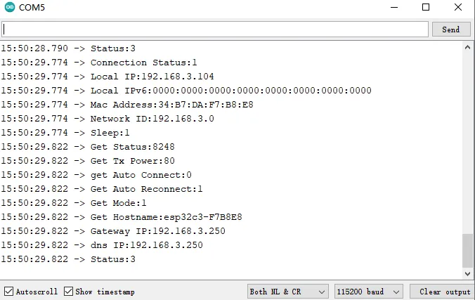

Example 8 The use of WiFi's STA (Station) mode¶
Upload the Wifi_STA.ino to the board
#include "WiFi.h"  // Include the WiFi library for ESP8266 or ESP32
void setup() {
  // Start WiFi connection with given SSID and password
  WiFi.begin("elecrow-test", "1223334444");
  // Enable auto-reconnect feature
  WiFi.setAutoReconnect(true);
void loop() {
  // Print the connection status: true if connected, false otherwise
  Serial.print("Connection Status:");
  Serial.println(WiFi.isConnected());
  // Print the local IP address of the device
  Serial.print("Local IP:");
  Serial.println(WiFi.localIP());
  // Print the local IPv6 address of the device
  Serial.print("Local IPv6:");
  Serial.println(WiFi.localIPv6());
  // Print the MAC address of the device
  Serial.print("Mac Address:");
  Serial.println(WiFi.macAddress());
  Serial.print("Network ID:");
  Serial.println(WiFi.networkID());
  // Print the sleep mode setting
  Serial.print("Sleep:");
  Serial.println(WiFi.getSleep());
  // Print the WiFi status bits
  Serial.print("Get Status:");
  Serial.println(WiFi.getStatusBits());
  // Print the transmission power setting
  Serial.print("Get Tx Power:");
  Serial.println(WiFi.getTxPower());
  // Print the auto connect setting
  Serial.print("get Auto Connect:");
  Serial.println(WiFi.getAutoConnect());
  // Print the auto reconnect setting
  Serial.print("Get Auto Reconnect:");
  Serial.println(WiFi.getAutoReconnect());
  // Print the current WiFi mode (1 - WIFI_OFF, 2 - WIFI_STA, 3 - WIFI_AP, 4 - WIFI_AP_STA)
  Serial.print("Get Mode:");
  Serial.println(WiFi.getMode());
  // Print the device's hostname
  Serial.print("Get Hostname:");
  Serial.println(WiFi.getHostname());
  // Print the gateway IP address
  Serial.print("Gateway IP:");
  Serial.println(WiFi.gatewayIP());
  // Print the DNS server IP address
  Serial.print("dns IP:");
  Serial.println(WiFi.dnsIP());
  // Print the current WiFi status
  Serial.print("Status:");
This code initializes the WiFi module to connect to a network with the specified SSID and password and enables auto-reconnect. In the loop() function, it prints various WiFi-related details such as connection status, IP addresses, MAC address, network ID, sleep mode, transmission power, auto connect and reconnect settings, WiFi mode, hostname, gateway IP, DNS IP, and the current status. The information is printed to the serial monitor every second.
Example 9 Using WiFi in STA (Station) mode as a TCP client¶
Upload the code WIFI_STA_TCP_Client to the board
#include <WiFi.h>
const char *ssid = "elecrow-test";  // The SSID of the WiFi network to connect to
const char *password = "1223334444";  // The password of the WiFi network
const IPAddress serverIP(192, 168, 3, 105);  // The IP address of the server to connect to
uint16_t serverPort = 9527;  // The port number on the server to connect to
WiFiClient client;  // Create an instance of the WiFiClient class to create a TCP connection
void setup() {
  delay(1000);  // Delay for 1000 milliseconds to give the serial console time to initialize
  WiFi.begin(ssid, password);  // Initiate a connection to the WiFi network
  // Wait for the WiFi connection to be established
  while (WiFi.status() != WL_CONNECTED) {
    delay(1000);
    Serial.print(".");
  Serial.println("Connected");  // Print a message to indicate the connection is established
  Serial.print("IP Address:");  // Print the IP address assigned to the device
void loop() {
  // Attempt to establish a TCP connection with the server
  if (client.connect(serverIP, serverPort)) {
    client.print("Hello world!");  // Send a "Hello world!" message to the server
    // Keep the connection open and interact with the server
    while (client.connected() || client.available()) {
      if (client.available()) {  // Check if there is data available from the server
        String line = client.readStringUntil('\n');  // Read a line of data from the server
        Serial.print("Read data:");  // Print a message indicating data was read
        Serial.println(line);
        client.write(line.c_str());  // Echo the received data back to the server
    Serial.println("Close Current Connection");  // Print a message indicating the connection is closed
    client.stop();  // Close the TCP connection
  } else {
    Serial.println("Access Failure");  // Print a message indicating the connection failed
    client.stop();  // Ensure the client stops any attempt to connect
  delay(5000);  // Wait for 5000 milliseconds before attempting to reconnect
This code sets up an ESP32 device to connect to a specified WiFi network in Station (STA) mode and then attempts to establish a TCP connection with a server. If the connection is successful, it sends a "Hello world!" message and then enters a loop to interact with the server, reading and echoing data until the connection is closed or fails. If the connection cannot be established, it prints an error message and waits for 5 seconds before trying again.

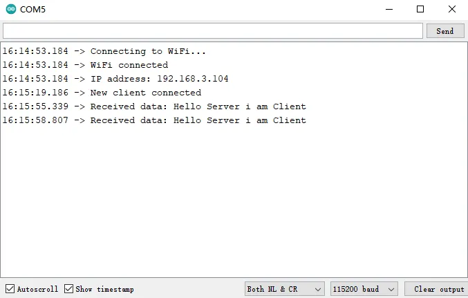

Example 10 Using WiFi in STA (Station) mode as a TCP server¶
Upload the code WIFI_STA_TCP_Server to the board
#include <WiFi.h>         // Include the WiFi library for ESP8266 or ESP32
#include <WiFiClient.h>   // Include the WiFiClient library for client functionality
const char* ssid = "elecrow-test";  // The SSID of the WiFi network
const char* password = "1223334444";  // The password of the WiFi network
WiFiServer server(1234);  // Create a WiFiServer object to handle incoming TCP connections on port 1234
void setup() {
  delay(1000);            // Delay for 1000 milliseconds to ensure the serial port is ready
    delay(1000);
    Serial.println("Connecting to WiFi...");
  server.begin();  // Start the server to listen for incoming connections
  Serial.println("WiFi connected");
  Serial.println("IP address: " + WiFi.localIP().toString());  // Print the IP address of the device
void loop() {
  // Check if there is a new client that has connected
  WiFiClient client = server.available();
  if (client) {
    Serial.println("New client connected");
    // Keep the connection open while the client is connected
    while (client.connected()) {
      if (client.available()) {  // Check if there is data available from the client
        String data = client.readStringUntil('\n');  // Read a line of data sent by the client
        Serial.print("Received data: ");
        Serial.println(data);  // Print the received data
        String response = "Server received: " + data;  // Create a response string
        client.println(response);  // Send the response back to the client
    client.stop();  // Close the connection once the client disconnects
    Serial.println("Client disconnected");
This code sets up an ESP32 device to connect to a specified WiFi network in Station mode and then starts a TCP server on port 1234. When a new client connects, the server accepts the connection and waits for data from the client. When data is received, it is echoed back to the client along with a message indicating that the server has received it. The connection is closed when the client disconnects.

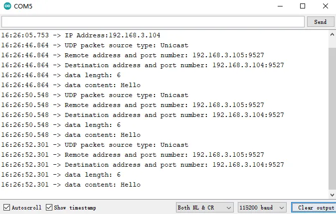

Example 11 Utilizing WiFi in Station (STA) mode to implement UDP (User Datagram Protocol)¶
Upload the code WIFI_STA_UDP to the board
#include <WiFi.h>
#include <AsyncUDP.h>
const char *ssid = "elecrow-test";  // SSID of the WiFi network
const char *password = "1223334444";  // Password of the WiFi network
AsyncUDP udp;  // Create an AsyncUDP object for handling UDP packets
unsigned int localUdpPort = 9527;  // Local UDP port number
unsigned int broadcastPort = localUdpPort;  // Port number for broadcasting
const char *broadcastData = "from esp32c3";  // Data to be sent as broadcast
// Callback function for handling incoming UDP packets
void onPacketCallBack(AsyncUDPPacket packet) {
  Serial.print("UDP packet source type: ");
  Serial.println(packet.isBroadcast() ? "broadcast data" : (packet.isMulticast() ? "Multicast" : "Unicast"));
  Serial.print("Remote address and port number: ");
  Serial.print(packet.remoteIP());
  Serial.print(":");
  Serial.println(packet.remotePort());
  Serial.print("Destination address and port number: ");
  Serial.print(packet.localIP());
  Serial.print(":");
  Serial.println(packet.localPort());
  Serial.print("data length: ");
  Serial.println(packet.length());
  Serial.print("data content: ");
  Serial.write(packet.data(), packet.length());
  Serial.println();
  // Send a reply back to the source of the packet
  packet.print("reply data");
  broadcastPort = packet.remotePort();  // Update the broadcast port to the remote port
void setup() {
  WiFi.begin(ssid, password);  // Initiate WiFi connection
  // Wait for WiFi to connect
  while (!WiFi.isConnected()) {
    delay(1000);
    Serial.print(".");
  Serial.println(WiFi.localIP());  // Print the assigned IP address
  // Start listening for UDP packets on the local port
  while (!udp.listen(localUdpPort)) {
  // Set the callback function to be called when a packet is received
  udp.onPacket(onPacketCallBack);
void loop() {
  delay(5000);  // Wait for 5 seconds
  // Send a broadcast message to the previously received remote port
  udp.broadcastTo(broadcastData, broadcastPort);
  // The following lines are commented out as they are not used in this example
  IPAddress broadcastAddr((~(uint32_t)WiFi.subnetMask())|((uint32_t)WiFi.localIP()));
  udp.writeTo(broadcastData, sizeof(broadcastData), broadcastAddr, localUdpPort);
This code sets up an ESP32 device to connect to a WiFi network in Station mode and then listens for incoming UDP packets on a specified local port using the AsyncUDP library. When a packet is received, it is handled by the onPacketCallBack function, which prints details about the packet and sends a reply back to the sender. The loop() function sends a broadcast message every 5 seconds to the port number from which the last received packet originated. The commented lines provide an alternative method for sending a broadcast message using a calculated broadcast address, but they are not used in this example.

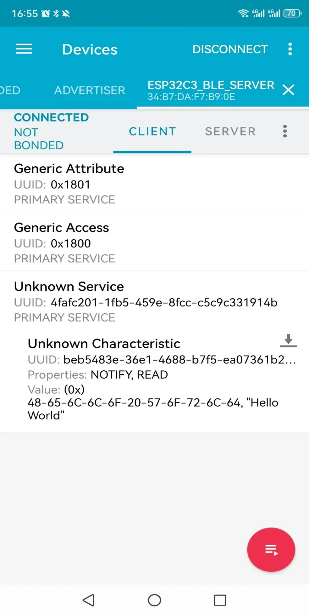

Example 12 Using Bluetooth services in Bluetooth mode¶
Upload the code BLE_Server.ino to the CrowPanel ESP32 Display 1.28(R) Inch-WATCH.
#include <BLEDevice.h>
#include <BLEUtils.h>
#include <BLEServer.h>
#define SERVICE_UUID        "4fafc201-1fb5-459e-8fcc-c5c9c331914b"  // UUID for the service
#define CHARACTERISTIC_UUID "beb5483e-36e1-4688-b7f5-ea07361b26a8"  // UUID for the characteristic
BLECharacteristic *pCharacteristic;  // Pointer to the BLE characteristic
void setup() {
  BLEDevice::init("ESP32C3_BLE_Server");  // Initialize the BLE device with a name
  BLEServer *pServer = BLEDevice::createServer();  // Create a BLE server
  BLEService *pService = pServer->createService(SERVICE_UUID);  // Create a service with the specified UUID
  // Create a characteristic with read and notify properties
  pCharacteristic = pService->createCharacteristic(
                       CHARACTERISTIC_UUID,
                       BLECharacteristic::PROPERTY_READ |
                       BLECharacteristic::PROPERTY_NOTIFY
  pCharacteristic->setValue("Hello World");  // Set the initial value of the characteristic
  pService->start();  // Start the service
  pServer->getAdvertising()->start();  // Start advertising the BLE device
void loop() {
  // This loop function does nothing in this example as the BLE server does not require
  // continuous processing in the loop once it's set up and running.
This code sets up an ESP32 device to act as a BLE (Bluetooth Low Energy) server with a single service and a single characteristic. The characteristic is set to allow both reading and notifying. The initial value of the characteristic is set to "Hello World," and the service and advertising are started. Once this setup is complete, the loop() function does not perform any additional actions, as the BLE server operates independently of the main program loop.

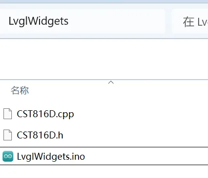

Example 13 Running the LVGL Widgets Demo¶
Open the LvglWidgets.ino in the LvglWidgets folder
Upload the code LvglWidgets to the CrowPanel ESP32 Display 1.28(R) Inch-WATCH

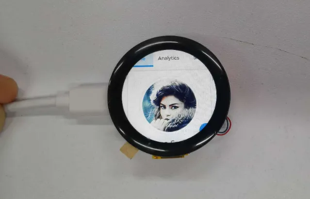

The LVGL demo will show on the screen

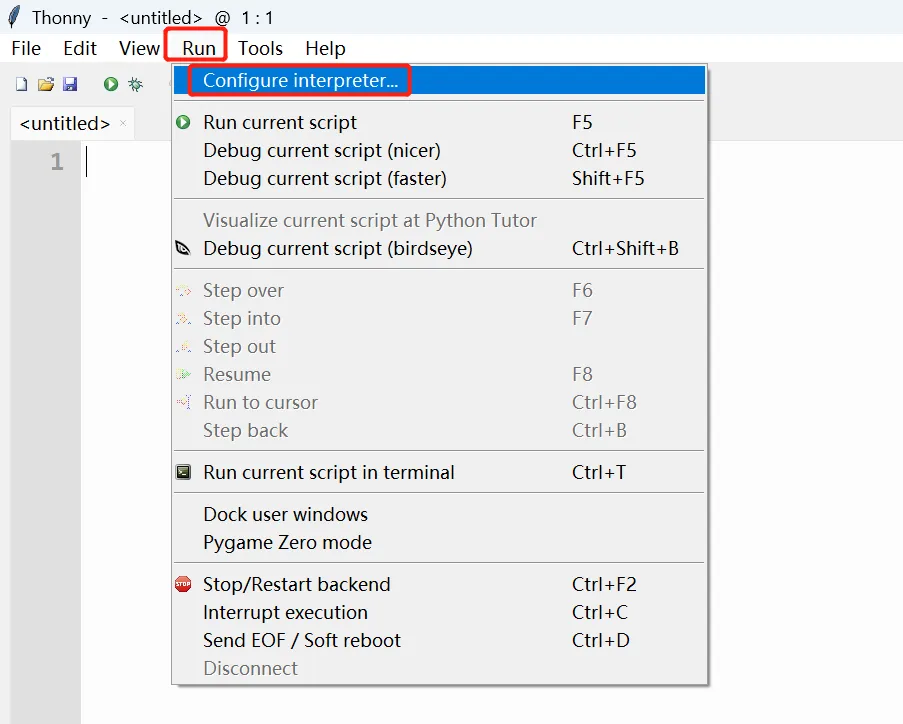

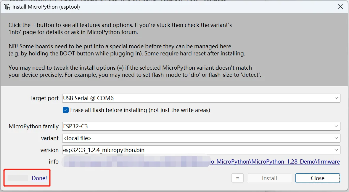

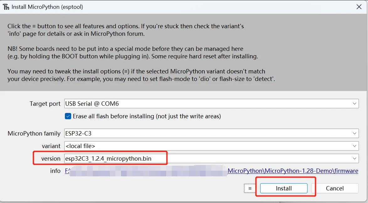

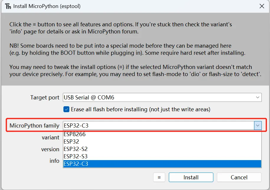

Upload Firmware¶
-  Connect the 1.28(R)-inch display to the computer.
-  Open Thonny IDE and click "Run"->"Configure interpreter". Select "MicroPython(ESP32)" as the interpreter. Then click "Install and update MicroPython"
-  Waiting for the loading the downloading variants info... After loading is complete, select the ESP32-C3 family Then click the three line icon in front of the "Install" icon, click "Select local MicroPython image ..." and choose the "esp32C3_1.2.4_micropython.bin" in the firmware folder. Then click "Install". Installation is done!

Run the Button.py
from machine import Pin
import time
# Set the GPIO pin number where the button is connected, GPIO 1 is used as an example
button_pin = 1
# Initialize the button, set as input mode, and enable the internal pull-up resistor
button = Pin(button_pin, Pin.IN, Pin.PULL_UP)
# Main loop, here we use polling to check if the button is being held down
while True:
    # Check if the button is pressed (read the level of the GPIO pin)
    if button.value() == 0:
        print("Button is currently pressed")
        # Additional code can be added here to handle the logic when the button is pressed
    time.sleep(0.1)  # Simple debounce delay
Press the button, the status of the button will be printed.
Example 2 Read the value of the encoder¶

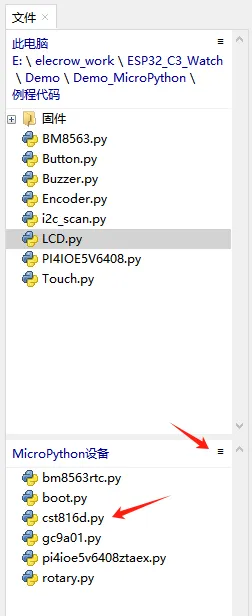

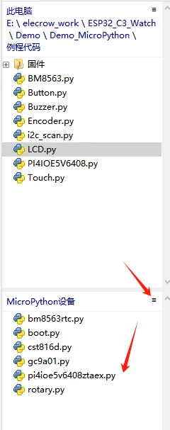

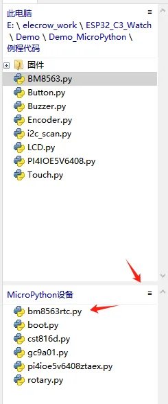

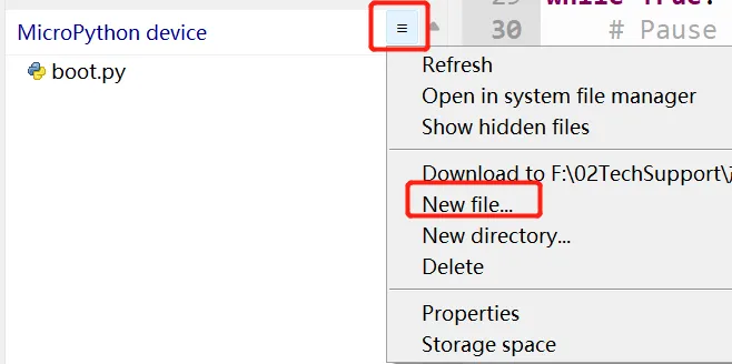

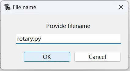

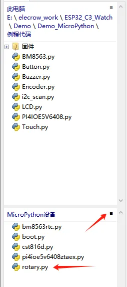

-  First add the rotary library Click the menu icon at MicroPython device, and click New file... Provide a file name. Please note to add the file suffix .py Copy the code to the editor and click run. The rotary.py will be added to the MicroPython device. import machine import utime as time from machine import Pin import micropython class Rotary: ROT_CW = 1 ROT_CCW = 2 SW_PRESS = 4 SW_RELEASE = 8 def __init__(self,dt,clk,sw): self.dt_pin = Pin(dt, Pin.IN) self.clk_pin = Pin(clk, Pin.IN) self.sw_pin = Pin(sw, Pin.IN) self.last_status = (self.dt_pin.value() << 1) | self.clk_pin.value() self.dt_pin.irq(handler=self.rotary_change, trigger=Pin.IRQ_FALLING | Pin.IRQ_RISING ) self.clk_pin.irq(handler=self.rotary_change, trigger=Pin.IRQ_FALLING | Pin.IRQ_RISING ) self.sw_pin.irq(handler=self.switch_detect, trigger=Pin.IRQ_FALLING | Pin.IRQ_RISING ) self.handlers = [] self.last_button_status = self.sw_pin.value() def rotary_change(self, pin): new_status = (self.dt_pin.value() << 1) | self.clk_pin.value() if new_status == self.last_status: return transition = (self.last_status << 2) | new_status try: if transition == 0b1110: micropython.schedule(self.call_handlers, Rotary.ROT_CW) elif transition == 0b1101: micropython.schedule(self.call_handlers, Rotary.ROT_CCW) except RuntimeError: pass self.last_status = new_status def switch_detect(self,pin): if self.last_button_status == self.sw_pin.value(): return self.last_button_status = self.sw_pin.value() if self.sw_pin.value(): micropython.schedule(self.call_handlers, Rotary.SW_RELEASE) else: micropython.schedule(self.call_handlers, Rotary.SW_PRESS) def add_handler(self, handler): self.handlers.append(handler) def call_handlers(self, type): for handler in self.handlers: handler(type)
-  Run the Encoder.py to the board from rotary import Rotary # Import the Rotary class from the rotary module. import utime as time # Import the utime module and alias it as 'time' for timing functions. # Create a Rotary object with the pin numbers for the rotary encoder and the interrupt pin. rotary = Rotary(19, 18, 8) # Initialize a variable to store the current value of the rotary encoder. val = 0 # Define a callback function that will be called when the rotary encoder is changed. def rotary_changed(change): global val # Declare 'val' as global to modify its value inside this function. # Check the type of change and update 'val' accordingly. if change == Rotary.ROT_CW: # If the rotary was turned clockwise. val = val + 1 # Increment the value. print(val) # Print the new value. elif change == Rotary.ROT_CCW: # If the rotary was turned counter-clockwise. val = val - 1 # Decrement the value. print(val) # Print the new value. elif change == Rotary.SW_PRESS: # If the rotary switch was pressed. print('PRESS') # Print 'PRESS'. elif change == Rotary.SW_RELEASE: # If the rotary switch was released. print('RELEASE') # Print 'RELEASE'. # Add the 'rotary_changed' function as a handler for rotary events. rotary.add_handler(rotary_changed) # Main loop that keeps the program running. while True: # Pause the loop for 100 milliseconds to reduce the frequency of execution and lower CPU usage. time.sleep(0.1)
-  Rotate the encoder in different directions, the value will increase or decrease, pressing the button will print "press", and releasing the button will print "release"
-  Add library Add bm8563rtc.py to the MicroPython device in the same way as in Example 2 from micropython import const _PCF8563_I2C_DEFAULT_ADDR = const(0x51) _PCF8563_CONTROL_STATUS1 = const(0x00) _PCF8563_CONTROL_STATUS1_TEST1 = const(0b1000_0000) _PCF8563_CONTROL_STATUS1_STOP = const(0b0010_0000) _PCF8563_CONTROL_STATUS1_TESTC = const(0b0000_1000) _PCF8563_CONTROL_STATUS2 = const(0x01) _PCF8563_CONTROL_STATUS2_TI_TP = const(0b0001_0000) _PCF8563_CONTROL_STATUS2_AF = const(0b0000_1000) _PCF8563_CONTROL_STATUS2_TF = const(0b0000_0100) _PCF8563_CONTROL_STATUS2_AIE = const(0b0000_0010) _PCF8563_CONTROL_STATUS2_TIE = const(0b0000_0001) _PCF8563_SECONDS = const(0x02) _PCF8563_MINUTES = const(0x03) _PCF8563_HOURS = const(0x04) _PCF8563_DAY = const(0x05) _PCF8563_WEEKDAY = const(0x06) _PCF8563_MONTH = const(0x07) _PCF8563_YEAR = const(0x08) _PCF8563_TIME_SIZE = const(7) _PCF8563_CENTURY_BIT = const(0b1000_0000) _PCF8563_MINUTE_ALARM = const(0x09) _PCF8563_HOUR_ALARM = const(0x0a) _PCF8563_DAY_ALARM = const(0x0b) _PCF8563_WEEKDAY_ALARM = const(0x0c) _PCF8563_ALARM_SIZE = const(4) _PCF8563_ALARM_DISABLE = const(0b1000_0000) _PCF8563_TIMER_CONTROL = const(0x0e) _PCF8563_TIMER_CONTROL_ENABLE = const(0b1000_0000) _PCF8563_TIMER_CONTROL_FREQ_4_096KHZ = const(0b0000_0000) _PCF8563_TIMER_CONTROL_FREQ_64HZ = const(0b0000_0001) _PCF8563_TIMER_CONTROL_FREQ_1HZ = const(0b0000_0010) _PCF8563_TIMER_CONTROL_FREQ_1_60HZ = const(0b0000_0011) _PCF8563_TIMER = const(0x0f) def _dec2bcd(decimal): high, low = divmod(decimal, 10) return (high << 4) | low def _bcd2dec(bcd): return (((bcd & 0xff) >> 4) * 10) + (bcd & 0x0f) class PCF8563: def __init__(self, i2c, *, addr=_PCF8563_I2C_DEFAULT_ADDR, alarm_irq=True): self.i2c = i2c self.addr = addr status = bytearray(1) self.i2c.writeto_mem(self.addr, _PCF8563_CONTROL_STATUS1, status) if alarm_irq: status[0] |= _PCF8563_CONTROL_STATUS2_AIE self.i2c.writeto_mem(self.addr, _PCF8563_CONTROL_STATUS2, status) def datetime(self, datetime=None): """ With no arguments, this method returns an 7-tuple with the current date and time. With 1 argument (being an 7-tuple) it sets the date and time. The 7-tuple has the following format: (year, month, mday, hour, minute, second, weekday) `year` is 1900..2099 `month` is 1..12 `mday` is 1..31 `hour` is 0..23 `minute` is 0..59 `second` is 0..59 `weekday` is 0..6 """ if datetime is None: data = self.i2c.readfrom_mem( self.addr, _PCF8563_SECONDS, _PCF8563_TIME_SIZE) # 0..59 bcd = data[0] & 0b01111111 second = _bcd2dec(bcd) # 0..59 bcd = data[1] & 0b01111111 minute = _bcd2dec(bcd) # 0..23 bcd = data[2] & 0b00111111 hour = _bcd2dec(bcd) # 1..31 bcd = data[3] & 0b00111111 mday = _bcd2dec(bcd) # 0..6 bcd = data[4] & 0b00000111 weekday = _bcd2dec(bcd) # 1..12 bcd = data[5] & 0b00011111 month = _bcd2dec(bcd) # If the century bit set, assume it is 2000. Note that it seems # that unlike PCF8563, the BM8563 does NOT automatically # toggle the century bit when year overflows from 99 to 00. # The BM8563 also wrongly treats 1900/2100 as leap years. century = 100 if (data[5] & _PCF8563_CENTURY_BIT) else 0 # Number of years since the start of the century bcd = data[6] & 0b11111111 year = _bcd2dec(bcd) + century + 1900 return (year, month, mday, hour, minute, second, weekday) (year, month, mday, hour, minute, second, weekday) = datetime data = bytearray(_PCF8563_TIME_SIZE) # 0..59 bcd = _dec2bcd(second) data[0] = bcd & 0b01111111 # 0..59 bcd = _dec2bcd(minute) data[1] = bcd & 0b01111111 # 0..23 bcd = _dec2bcd(hour) data[2] = bcd & 0b00111111 # 1..31 bcd = _dec2bcd(mday) data[3] = bcd & 0b00111111 # 0..6 bcd = _dec2bcd(weekday) data[4] = bcd & 0b00000111 # 1..12 bcd = _dec2bcd(month) data[5] = bcd & 0b00011111 # after 2000 set the century bit if year >= 2000: data[5] |= _PCF8563_CENTURY_BIT # 0..99 bcd = _dec2bcd(year % 100) data[6] = bcd & 0b11111111 return self.i2c.writeto_mem(self.addr, _PCF8563_SECONDS, data) def alarm(self, alarm=None): """ Sets or gets the alarm. If no arguments are provided, it returns the currently set alarm in the form of a 4-tuple. If 1 argument is provided (being a 4-tuple), the alarm is set. (hour, minute, mday, weekday) `hour` is 0..23 or None `minute` is 0..59 or None `mday` is 1..31 or None `weekday` is 0..6 or None If a tuple field is set to None then it is not considered for triggering the alarm. If all four fields are set to None, the alarm is disabled. """ if alarm is None: data = self.i2c.readfrom_mem( self.addr, _PCF8563_MINUTE_ALARM, _PCF8563_ALARM_SIZE) # 0..59 if _PCF8563_ALARM_DISABLE & data[0]: minute = None else: bcd = data[0] & 0b01111111 minute = _bcd2dec(bcd) # 0..23 if _PCF8563_ALARM_DISABLE & data[1]: hour = None else: bcd = data[1] & 0b00111111 hour = _bcd2dec(bcd) # 1..31 if _PCF8563_ALARM_DISABLE & data[2]: mday = None else: bcd = data[2] & 0b00111111 mday = _bcd2dec(bcd) # 0..6 if _PCF8563_ALARM_DISABLE & data[3]: weekday = None else: bcd = data[3] & 0b00000111 weekday = _bcd2dec(bcd) return (hour, minute, mday, weekday) (hour, minute, mday, weekday) = alarm data = bytearray(_PCF8563_ALARM_SIZE) # 0..59 if minute is None: data[0] = _PCF8563_ALARM_DISABLE else: data[0] = _dec2bcd(minute) data[0] &= 0b01111111 # 0..23 if hour is None: data[1] = _PCF8563_ALARM_DISABLE else: data[1] = _dec2bcd(hour) data[1] &= 0b00111111 # 1..31 if mday is None: data[2] = _PCF8563_ALARM_DISABLE else: data[2] = _dec2bcd(mday) data[2] &= 0b00111111 # 0..6 if weekday is None: data[3] = _PCF8563_ALARM_DISABLE else: data[3] = _dec2bcd(weekday) data[3] &= 0b00000111 return self.i2c.writeto_mem(self.addr, _PCF8563_MINUTE_ALARM, data) def alarm_active(self, clear=False): """ Returns True if the alarm is currently active. An active alarm can be cleared by setting the clear argument to True. """ data = bytearray(1) self.i2c.readfrom_mem_into(self.addr, _PCF8563_CONTROL_STATUS2, data) active = bool(data[0] & _PCF8563_CONTROL_STATUS2_AF) if clear: data[0] &= ~_PCF8563_CONTROL_STATUS2_AF # AF=0 means alarm cleared data[0] |= _PCF8563_CONTROL_STATUS2_TF # TF=1 mean timer unchanged self.i2c.writeto_mem(self.addr, _PCF8563_CONTROL_STATUS2, data) return active
-  Open and run BM8563.py, the RTC time will be printed.

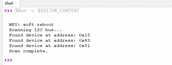

Example 5 I2C Device Sanner¶
Run the i2c_scan.py
from machine import Pin, I2C
import time
# Set up the I2C pins, using the default I2C pins for ESP32
sda = Pin(4)  # SDA pin
scl = Pin(5)  # SCL pin
# Initialize the I2C bus
i2c = I2C(0, scl=scl, sda=sda)
# Scan for devices on the I2C bus
print("Scanning I2C bus...")
# Iterate through the possible I2C address range
for addr in range(127):
    try:
        # Attempt to read a byte from the device at the current address
        i2c.readfrom(addr, 1)
        print("Found device at address:", hex(addr))
    except:
        # If an exception occurs, it means the device is not present at this address
        pass
print("Scan complete.")
The I2C device will be printed.

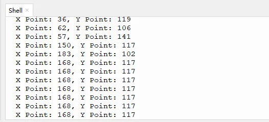

-  Open and run Touch.py. from machine import Pin, I2C # Import the Pin and I2C classes from the machine module. from cst816d import Touch_CST816D # Import the Touch_CST816D class from the cst816d module. import time # Import the time module for delay functions. # Create an instance of the Touch_CST816D class, initializing in point mode (mode=1). Touch = Touch_CST816D(mode=1) # Set the mode attribute of the Touch object to 1, indicating point mode. Touch.Mode = 1 # Call the Set_Mode method to configure the touch chip in the specified mode. Touch.Set_Mode(Touch.Mode) # Main loop that keeps the program running. while True: # Call the get_point method to read the current touch point coordinates. Touch.get_point() # Print the X and Y coordinates of the touch point. print("X Point: {}, Y Point: {}".format(Touch.X_point, Touch.Y_point)) # Delay the loop for 100 milliseconds to reduce CPU usage and wait for the next reading. time.sleep_ms(100) # Use sleep_ms for a shorter delay.
-  Touch the screen, the coordinates of the touched point will be printed.

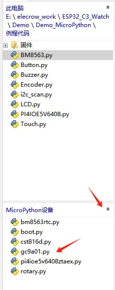

-  Add library Add gc9a01.py to the MicroPython device in the same way as in Example 2
-  Open and run LCD.py from machine import Pin,I2C from pi4ioe5v6408ztaex import PI4IOE5V6408 from gc9a01 import LCD_1inch28 import time # Initialize the I2C bus with the specified pins and frequency i2c = I2C(0, sda=Pin(4), scl=Pin(5), freq=400_000) # Create an instance of the PI4IOE5V6408 class with the I2C bus io_expander = PI4IOE5V6408(i2c) io_expander.write_pin(4, True) time.sleep(1) io_expander.write_pin(2, True) time.sleep(1) LCD = LCD_1inch28() LCD.text("Elecrow",90,120,LCD.blue) LCD.show() time.sleep(5) while True: LCD.fill(LCD.red) LCD.show() time.sleep(1) LCD.fill(LCD.green) LCD.show() time.sleep(1) LCD.fill(LCD.blue) LCD.show() time.sleep(1)
-  There will be "Elecrow" shown on the screen, then the screen color will turn red, green, and blue in a cycle.
