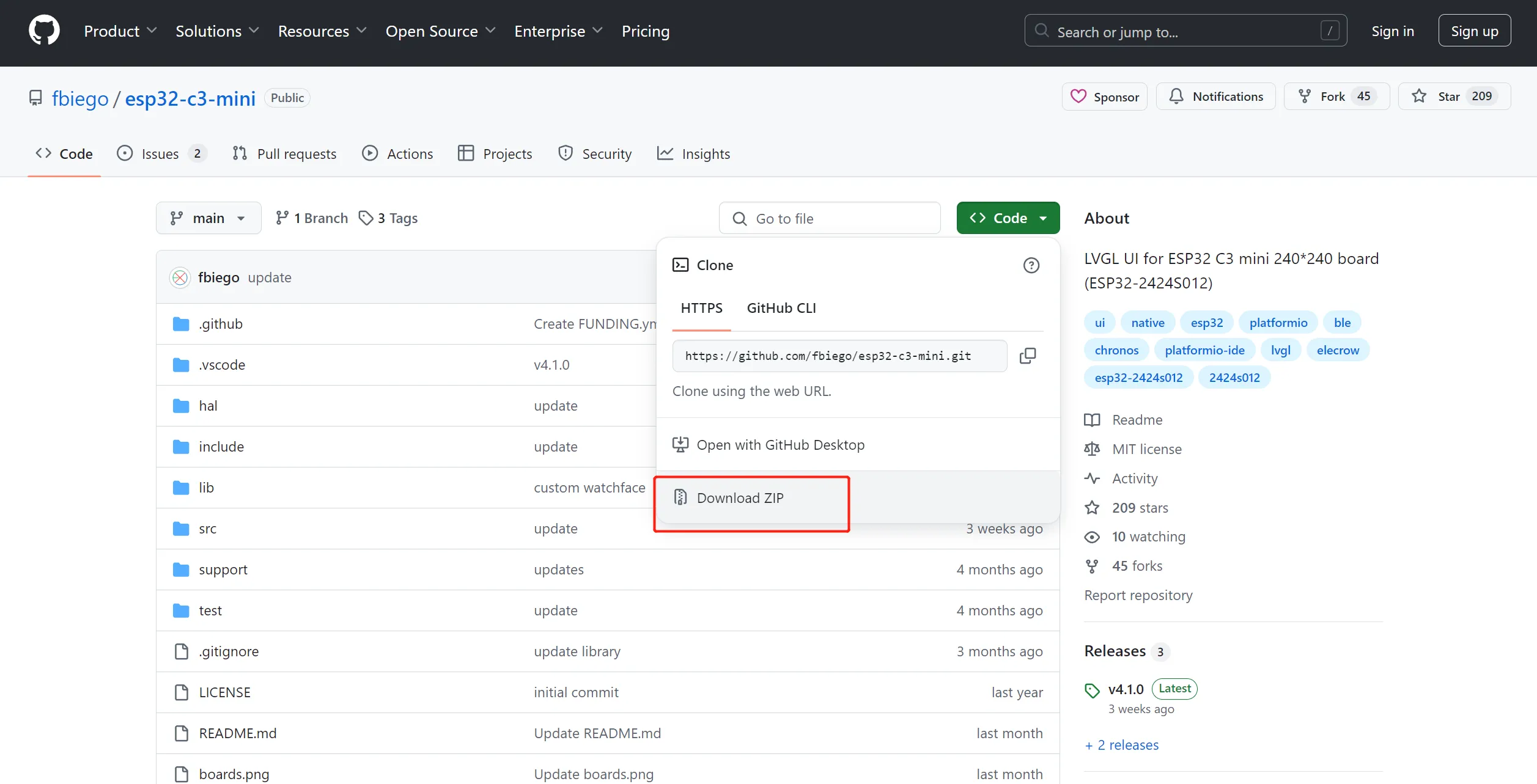

-  Download the esp32-c3-mini project at: https://github.com/fbiego/esp32-c3-mini

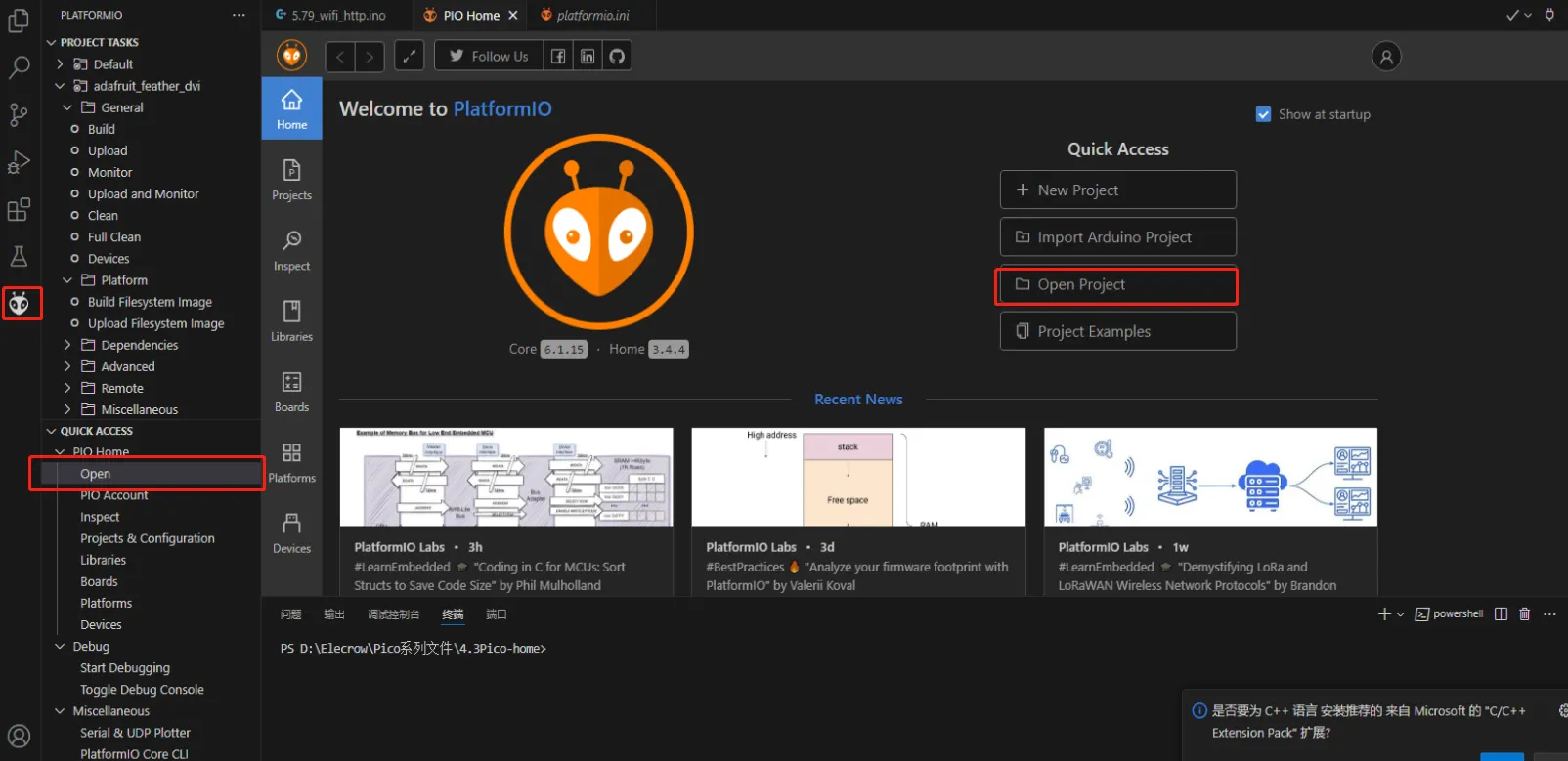

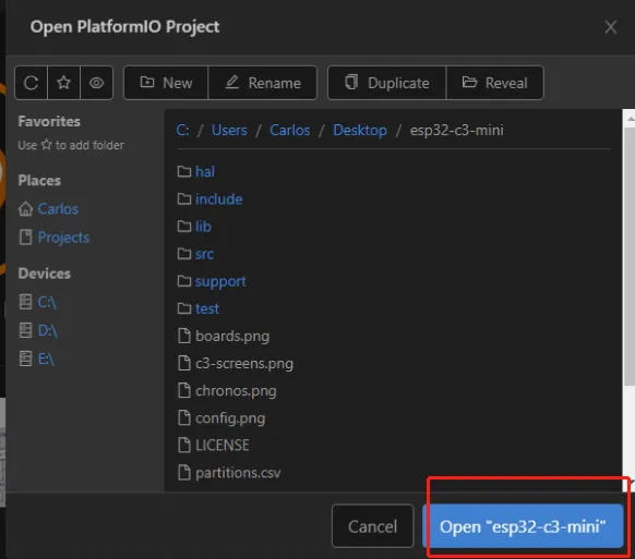

-  Open VS code and click the PlatformIO icon. Click "Open"->"Open Project"
-  Find "esp32-c3-mini" and open it.

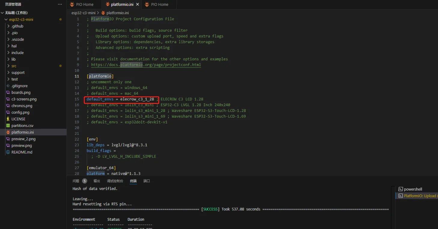

-  Click platform.ini and modify it. The board select elecrow_c3_1_28: delete the ";" before elecrow_c3_1_28

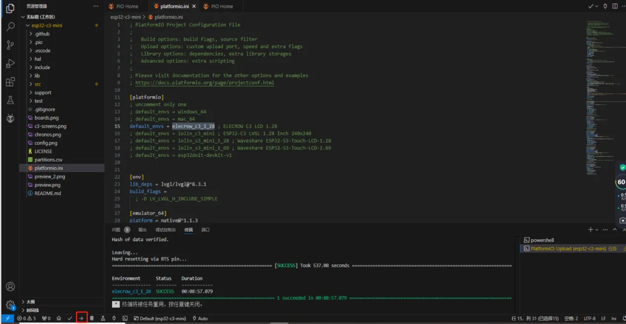

-  Upload the code to the board.

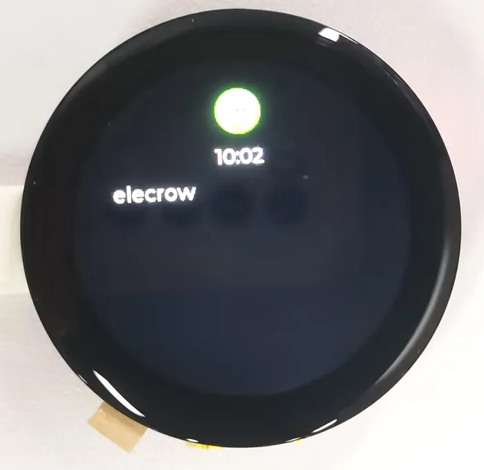

-  The program will run on the display.

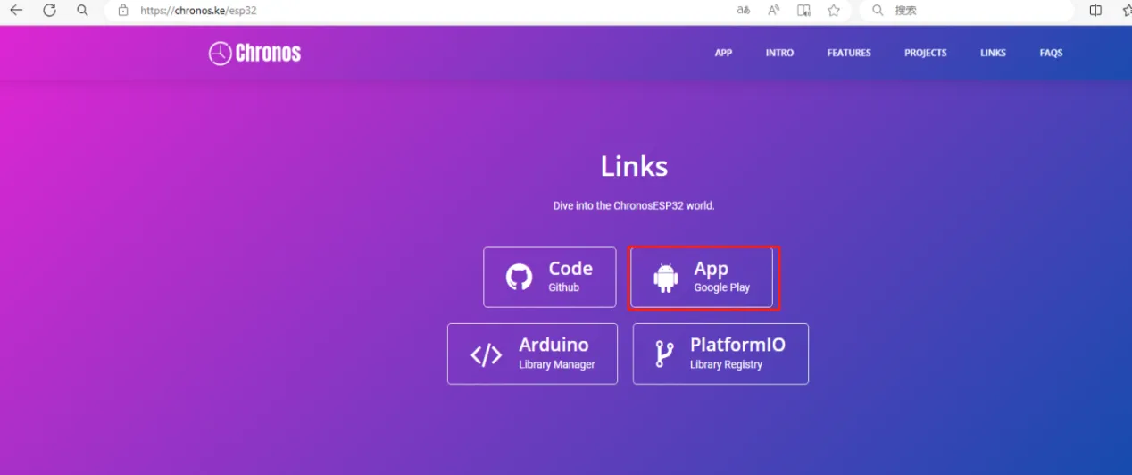

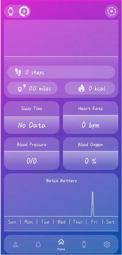

-  Download the APP Chronos - ESP32 on Google Play.(Note: this APP is not compatible with iPhone)

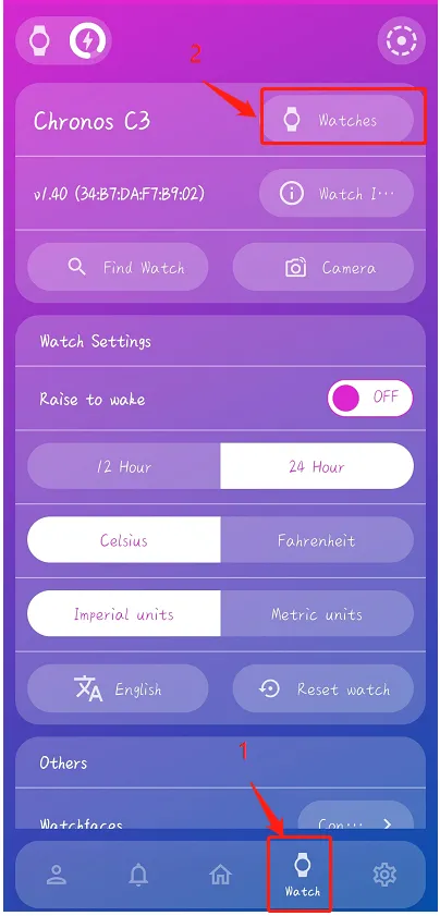

-  Open the Chronos on your phone, and log in.
-  Click the watch icon, the search for the ESP32 round display.

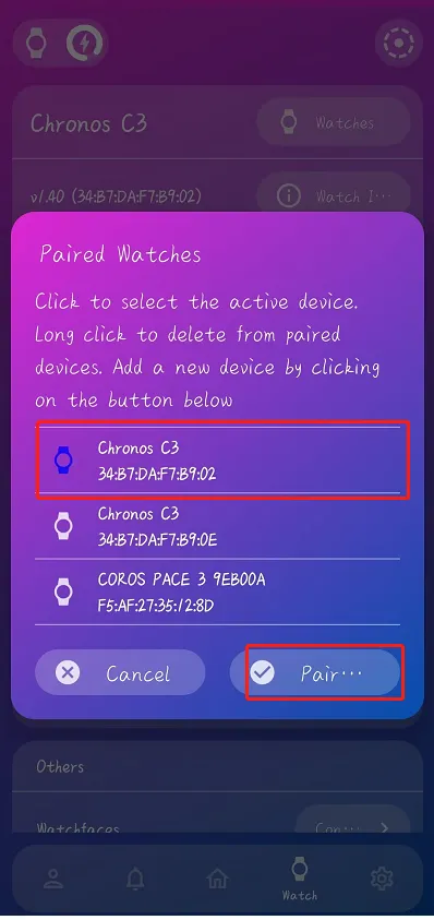

-  Select the display and click pair...

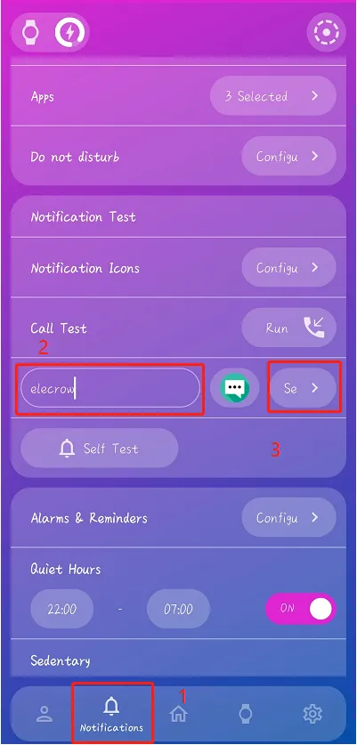

-  After connecting the device, you can send information to the display.
